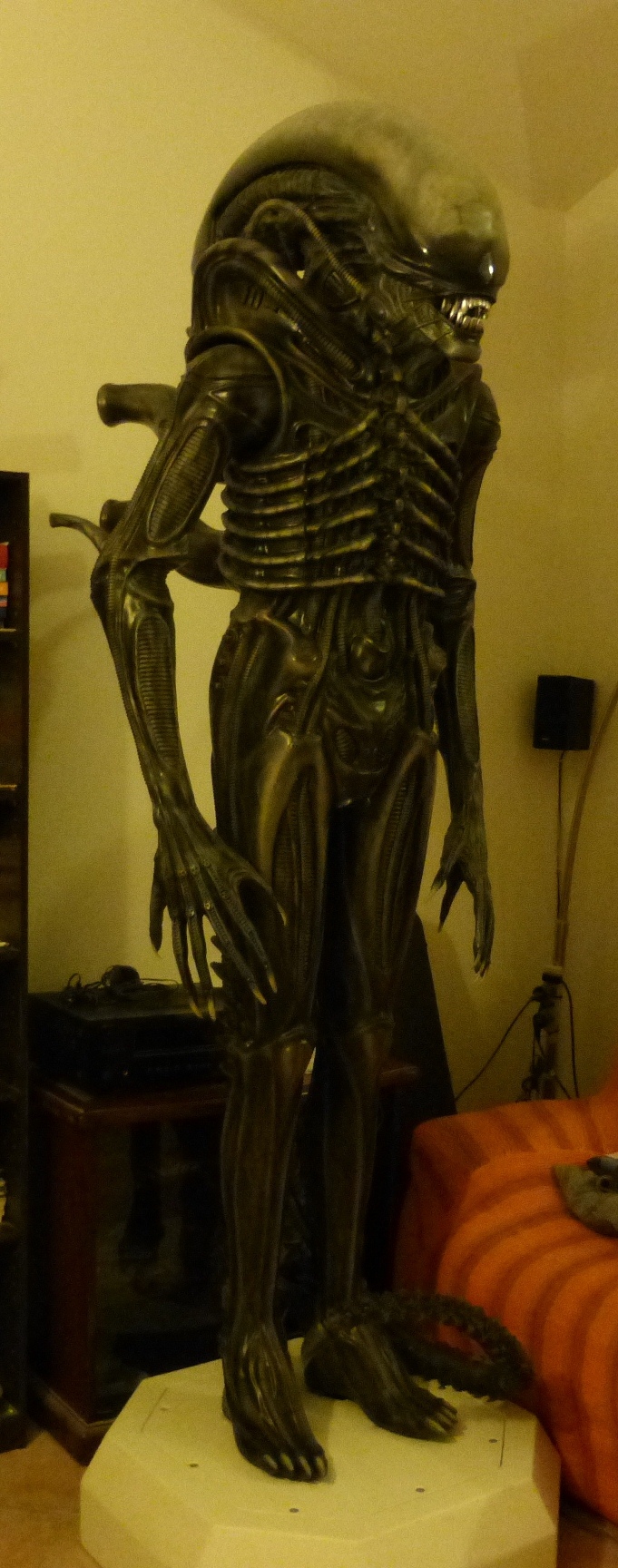

Finished my life-size sculpture of Giger Alien Version

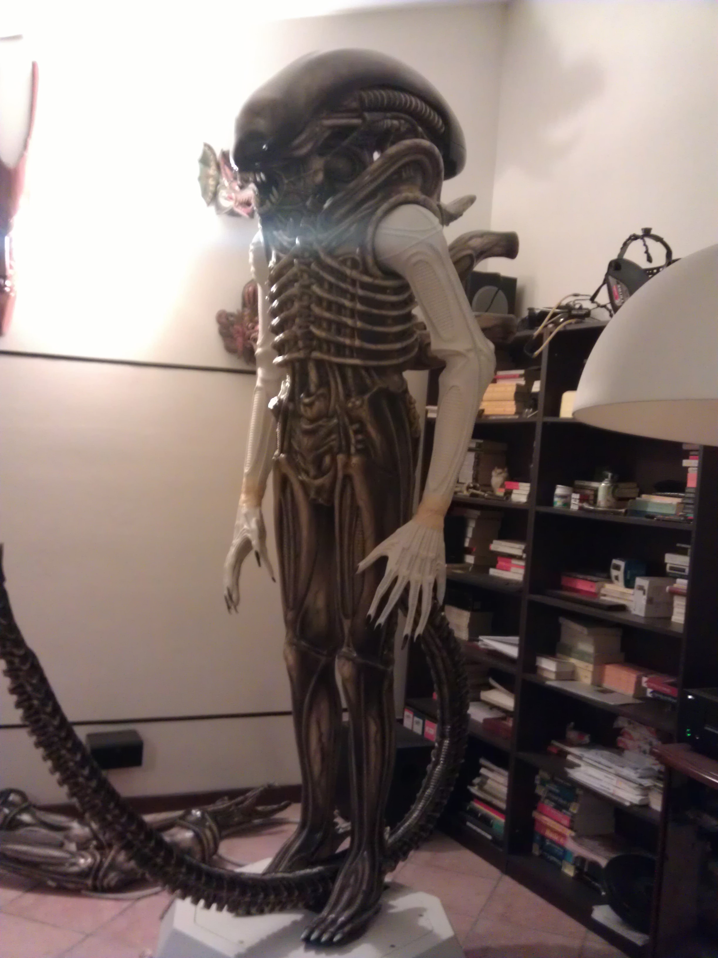

Hello everyone, I have almost finished arms. Soon I will make a new jaw closed.
See you soon.

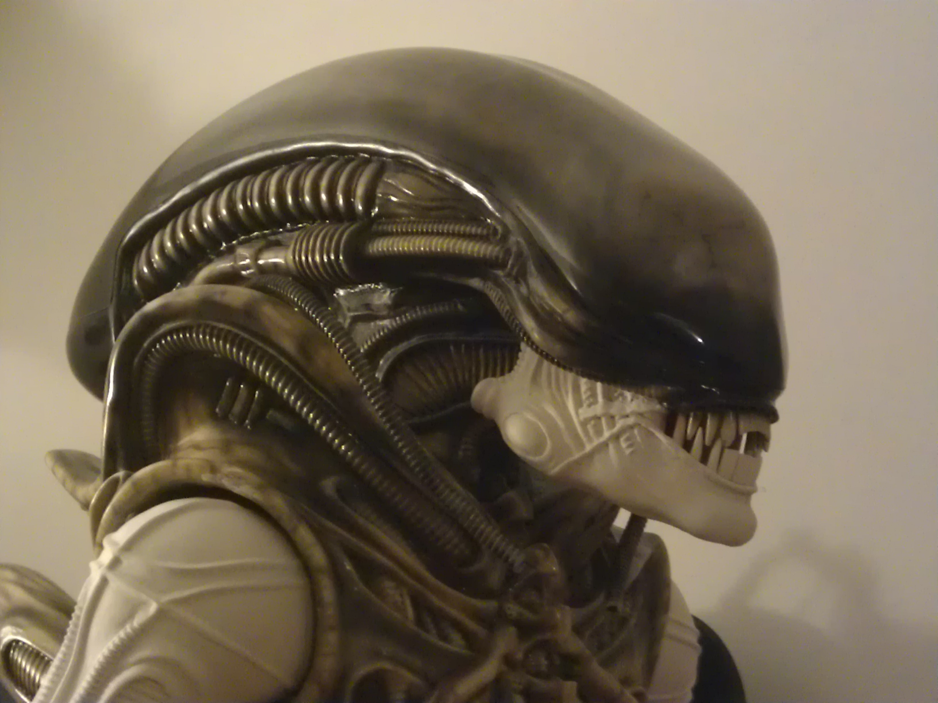

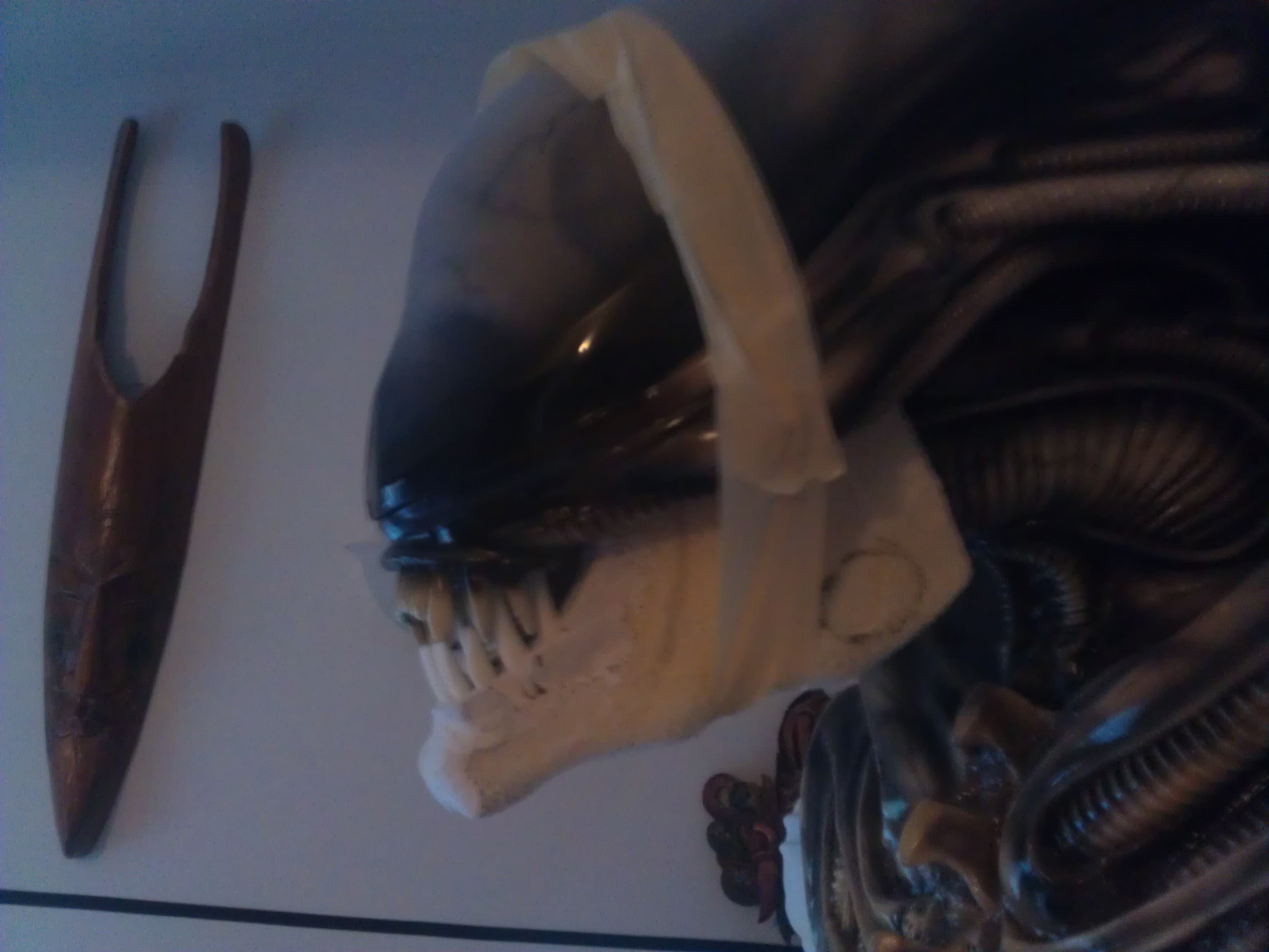

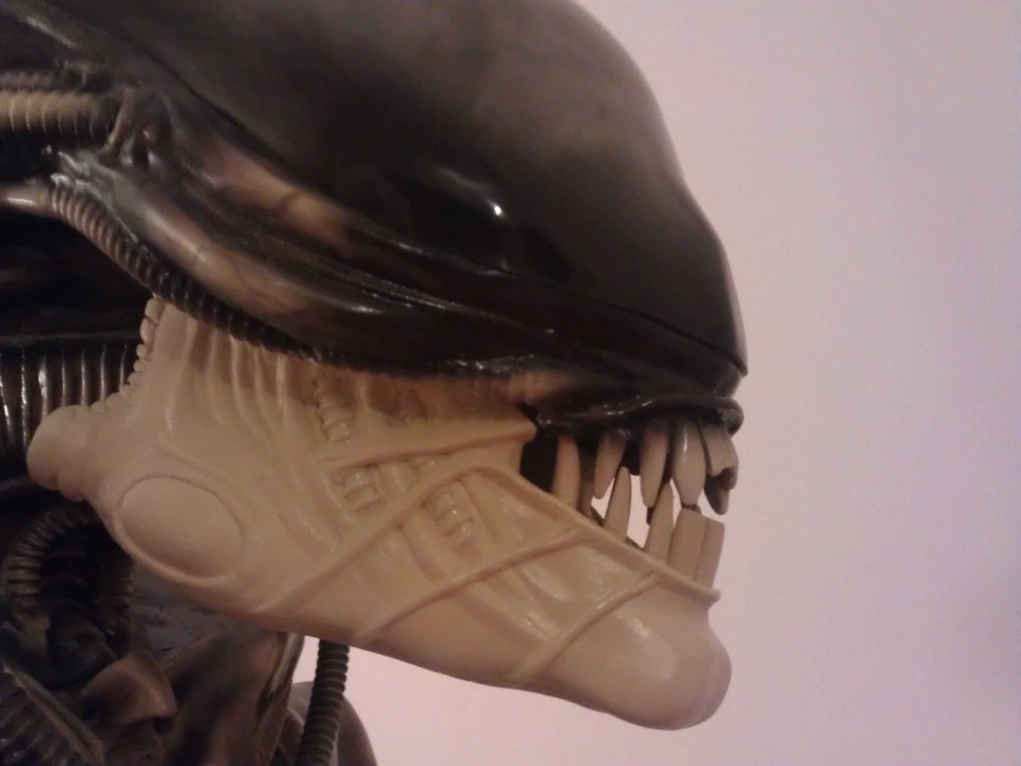

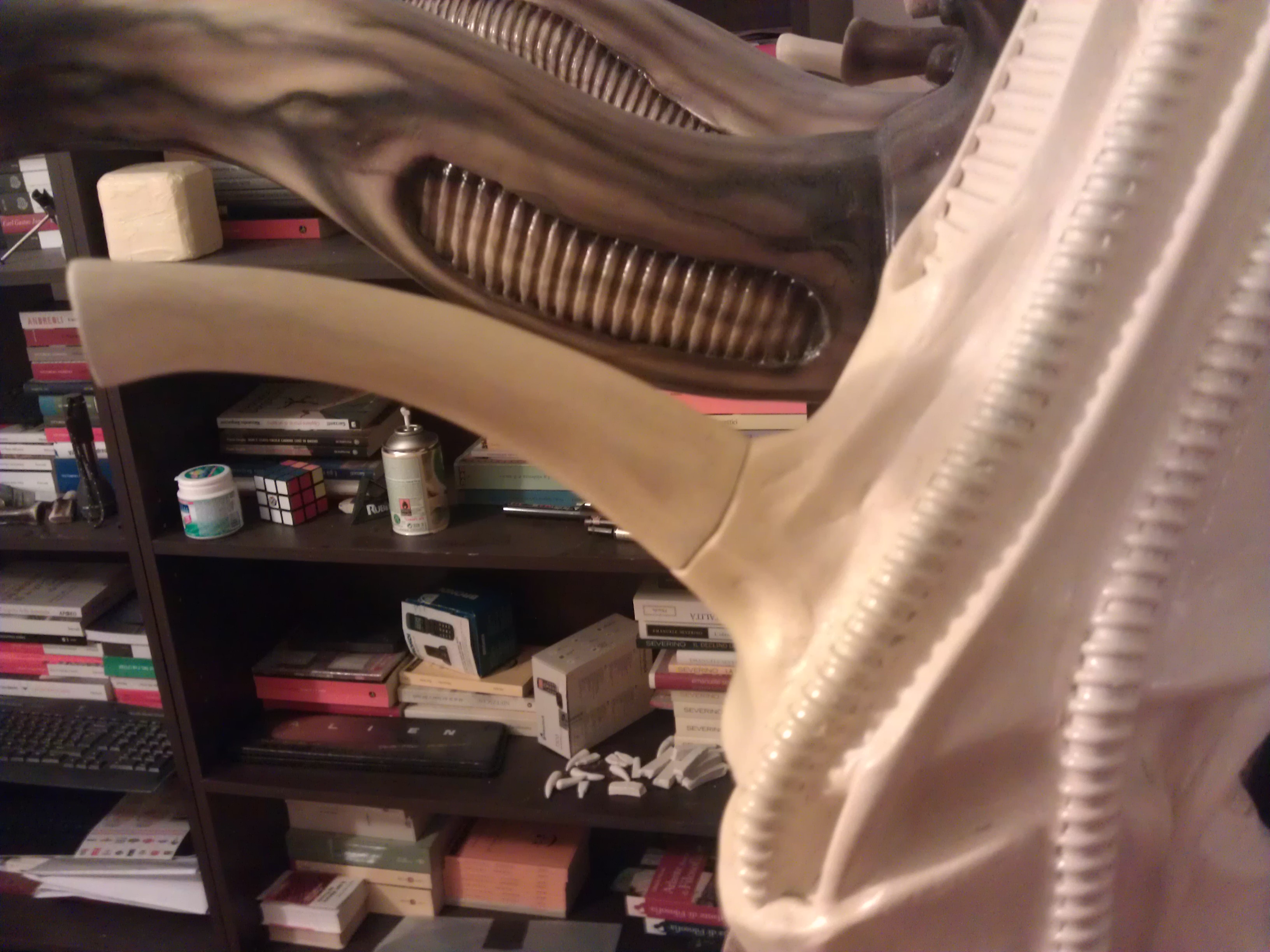

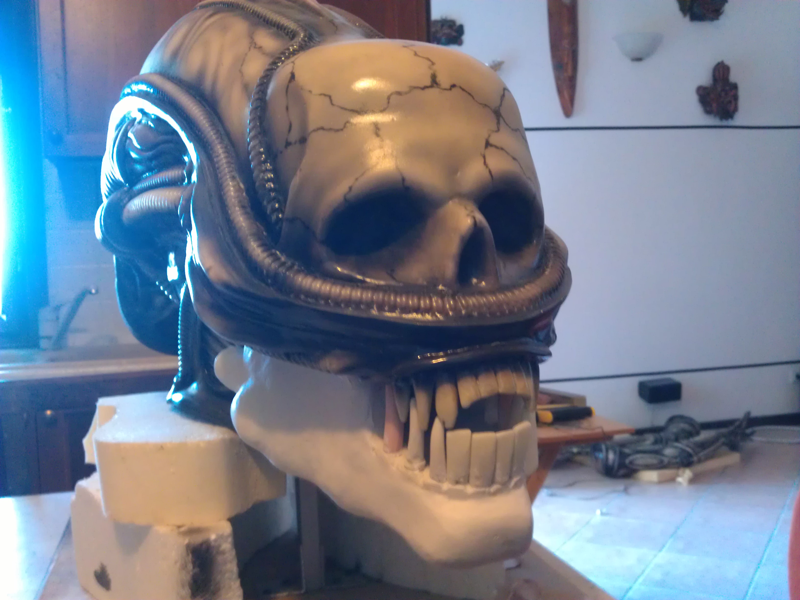

Thanks Leigh, this is a draft of the jaw. If I had made the movable jaw as in your alien, now I should not do it again. Patience. ;) See you soon.
Re: My life-size sculpture of Giger Alien Version
It looks good :thumbsup :)
It took me quite a while to get the teeth to mesh & for the jaw to stay forward as it opened. It involved a lot of adjusting the jaw hinge point until I was happy.

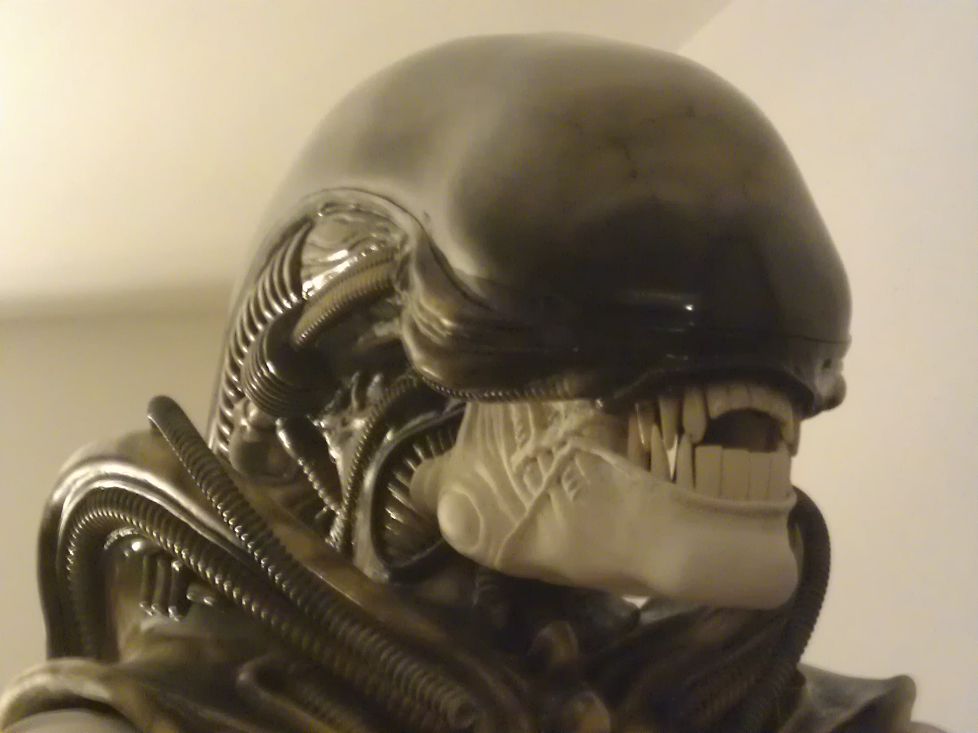

Hello Leigh,just today,as I stared at the jaw,I realized that it is not easy to turn without rubbing the teeth. To make it easier,use an image editor to find the center of rotation, putting his jaw on a layer other than the head?

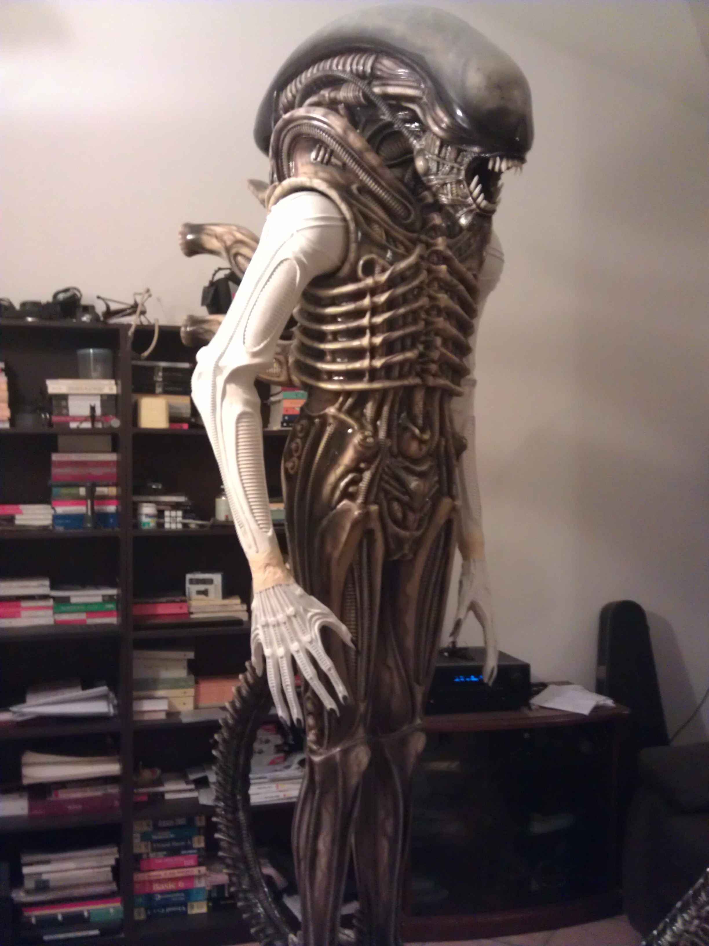

Thanks crawjaw. here in RPF there are sculptors with exceptional technical ability,which I still do not have or I have not yet ventured. They are capable of very precise things that seem real and,sometimes,even lives. They manage to combine sculpture,electronics, molds, CAD drawings and paintings of the highest level. There are so many things that I do not know how to do and materials that I never used, but I plan to learn as much as possible. Here you also learn by observing the technical steps that the authors kindly offer. This is a great incentive both to learn,and to gain self-confidence and improve. I am happy I gave you good feelings. Meanwhile I enclose the progress on the new jaw.
See you again soon.

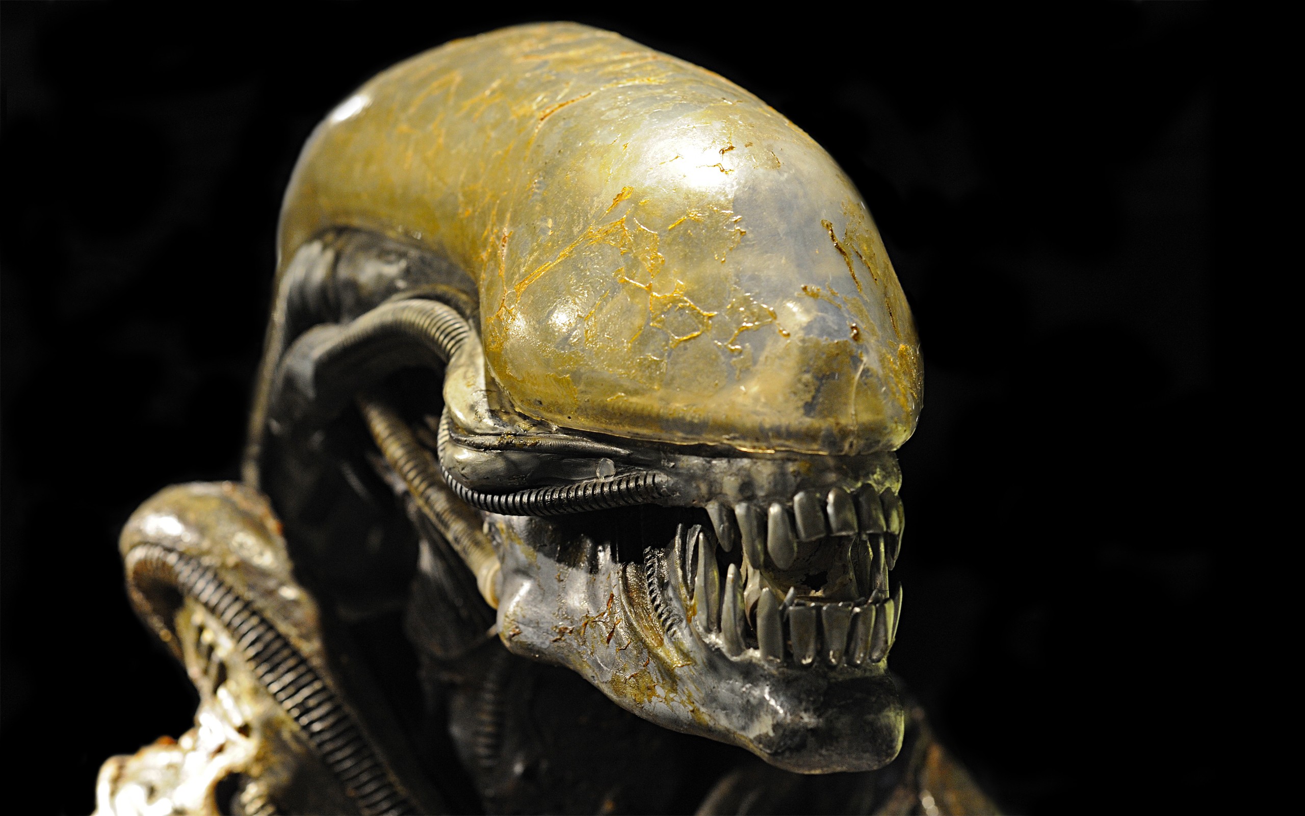

Just today I found a picture where we can see how it was done the mold of transparent dome.
As I had imagined, to realize the one with the undercuts, you need to cut leaving the printer, because otherwise it would not be extractable. I also see that the rear ellipsoidal, is entire, rather than divided as I have seen in some original heads. Maybe there were different versions? Then I do not understand the clay placed under the mold. However, unless one has a friend who produces thermoformed, this remains a work to do at home, also building the system of thermoforming. If you'll just make the mold for the next alien, I will continue to do so as my previous.
Its a good pic! I've had this pic in my collection for a long time now, if you look closely at the back you can see the web that's formed due to the extreme undercut :)

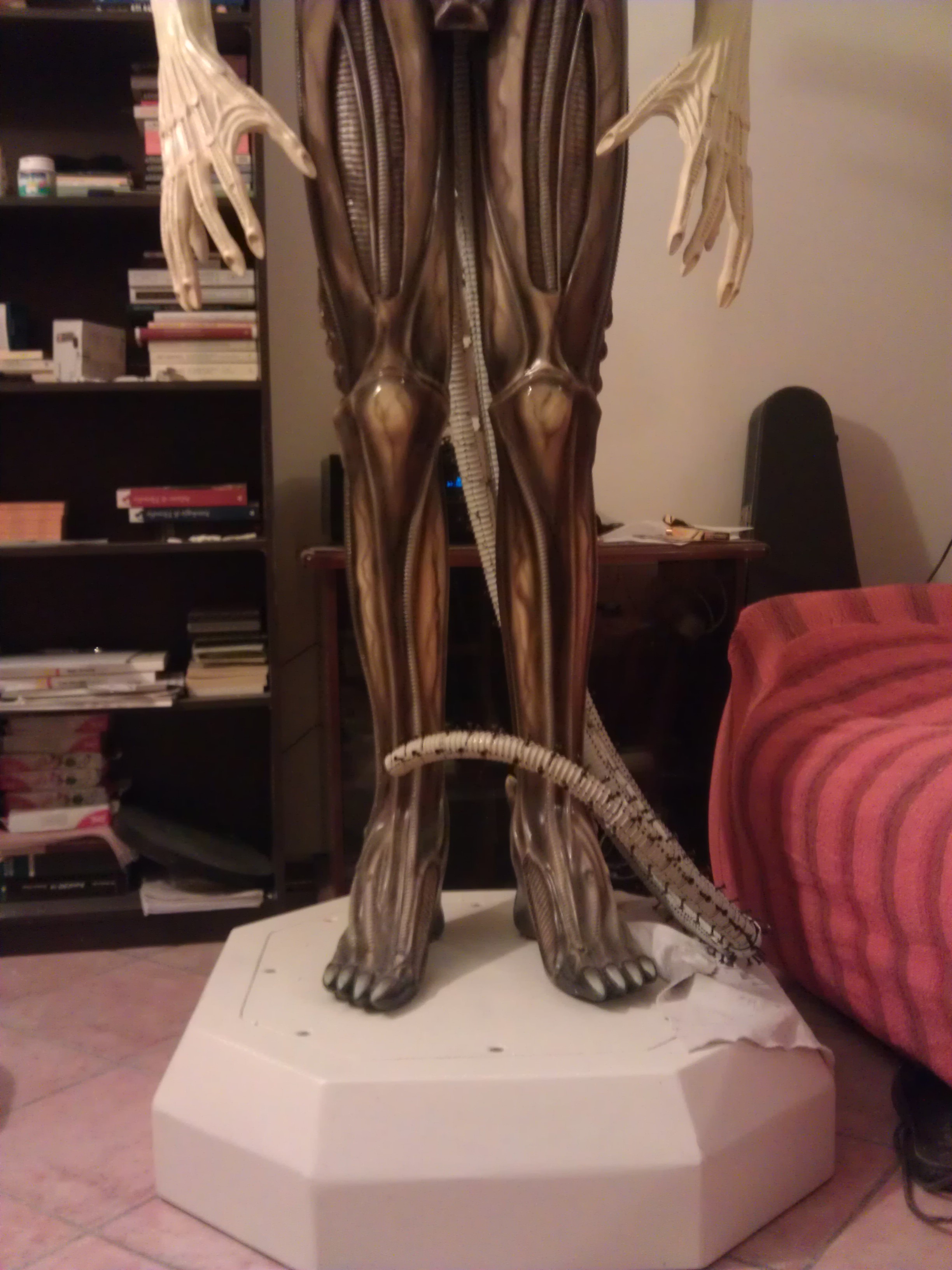

Some solutions ...

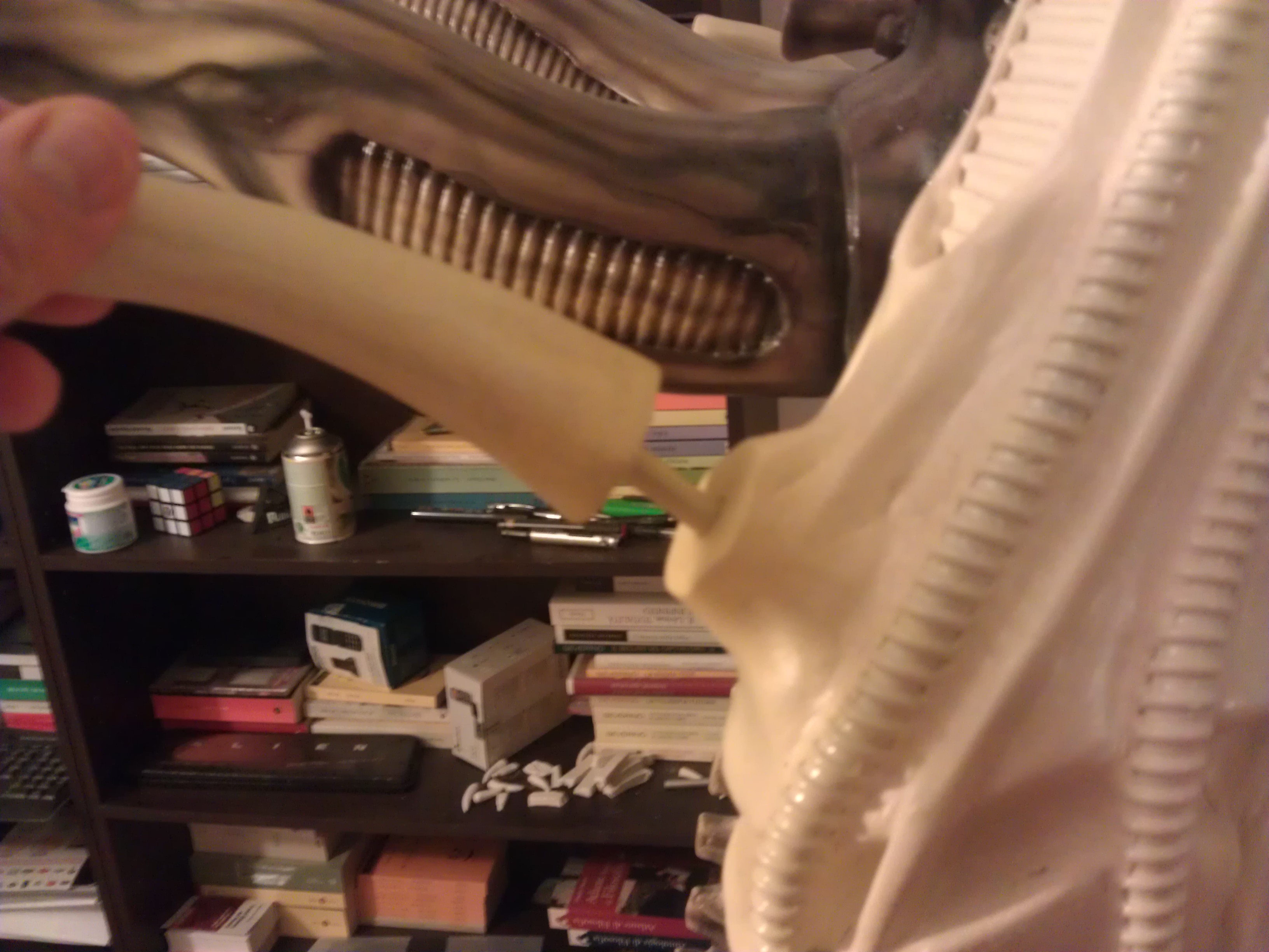

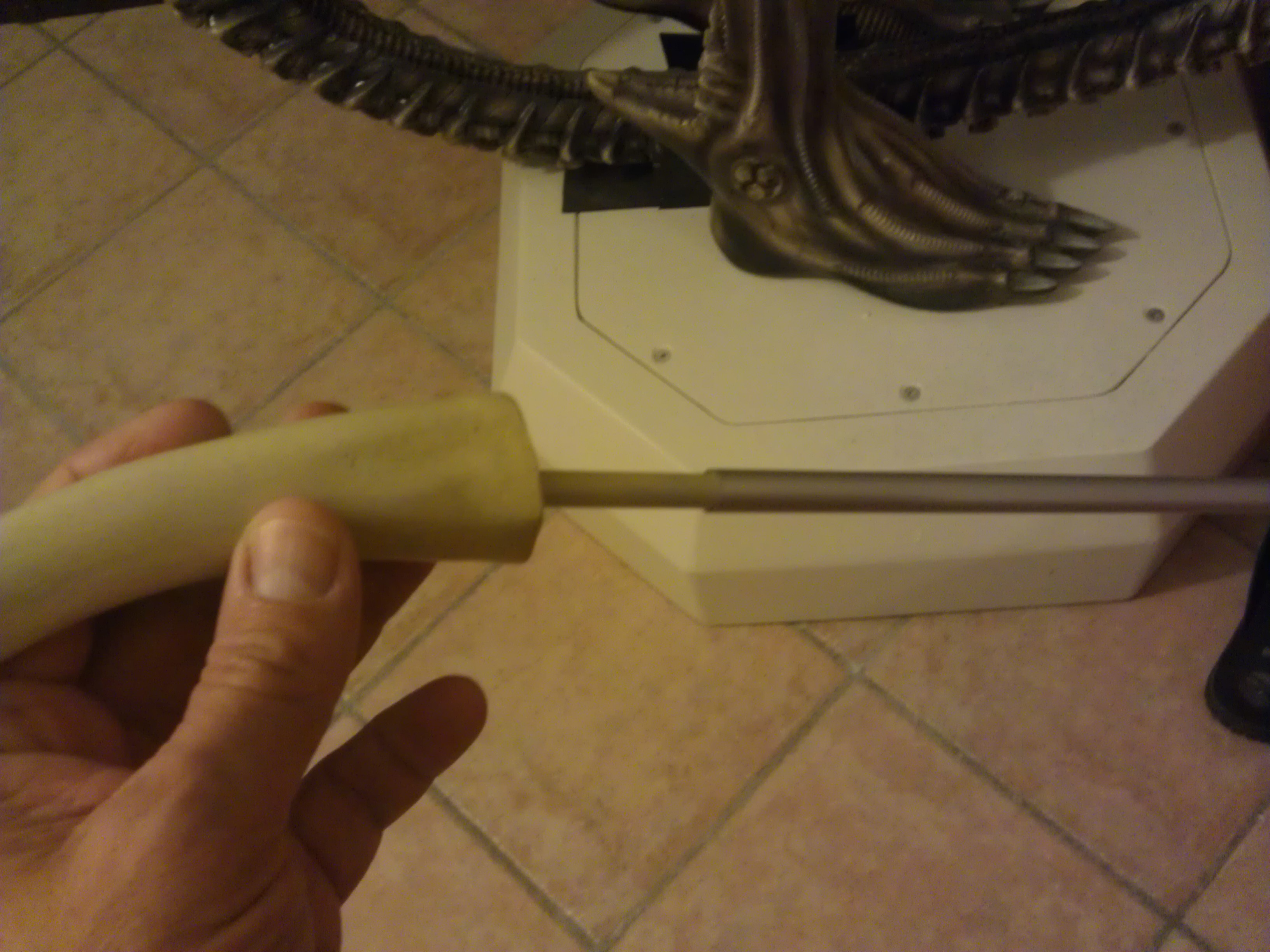

This is the assembly system for the bone of the elbow: A rod of aluminum 8mm diameter inserted in an aluminum pipe. is rightly precise, easy to insert, clearance and friction.

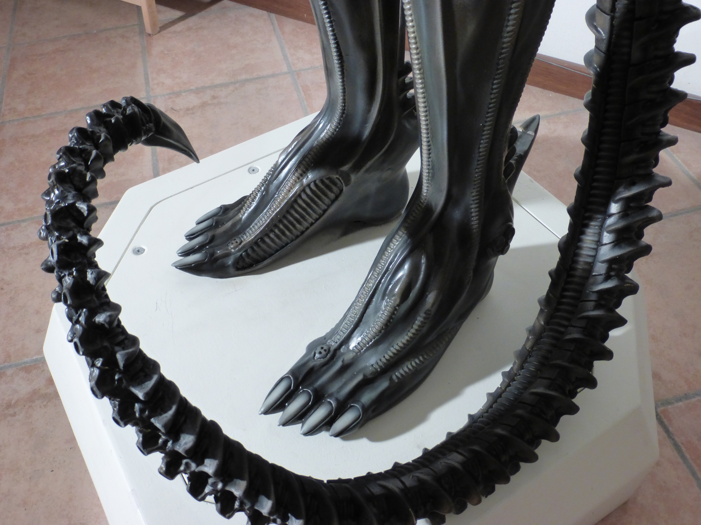

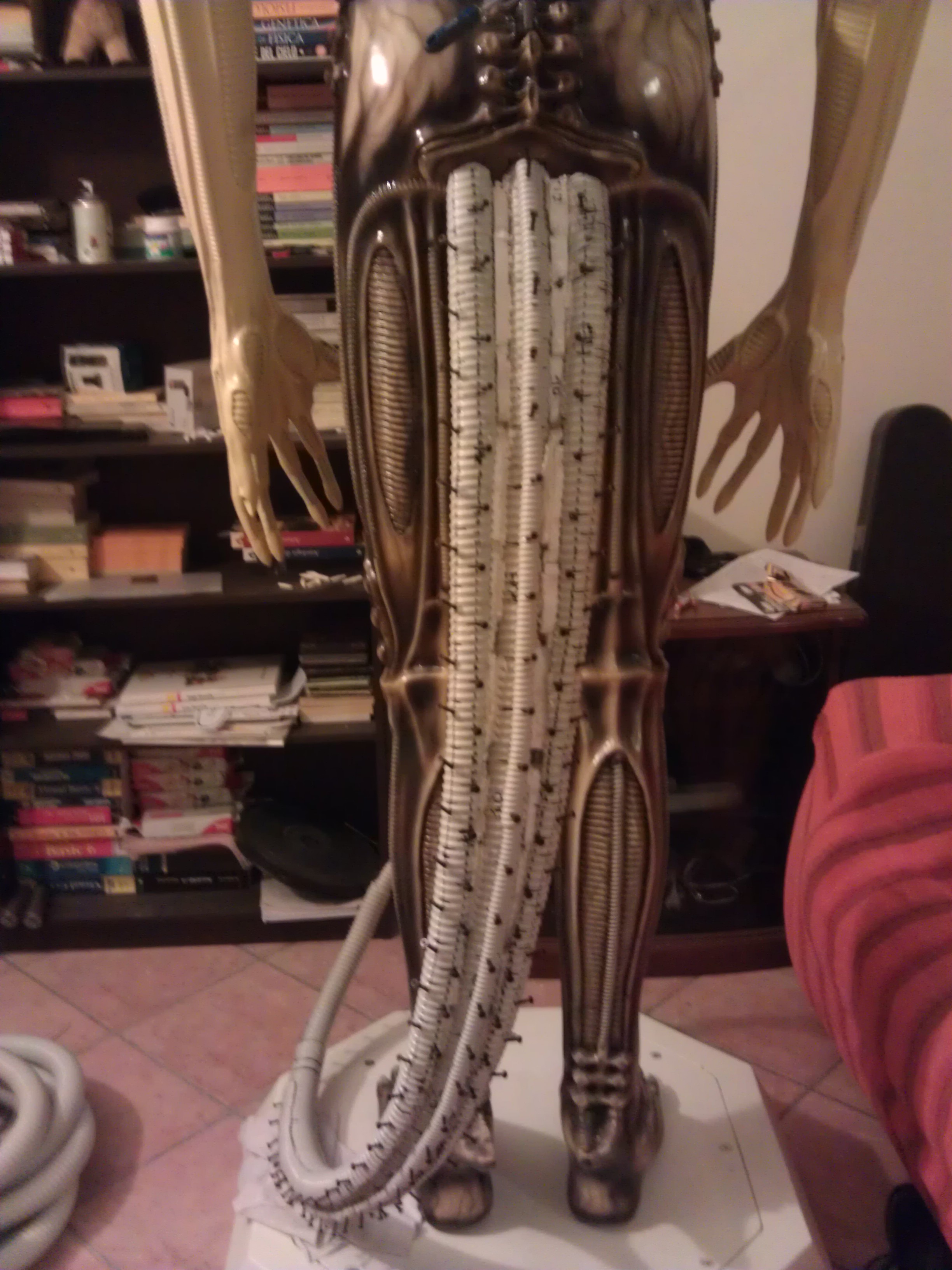

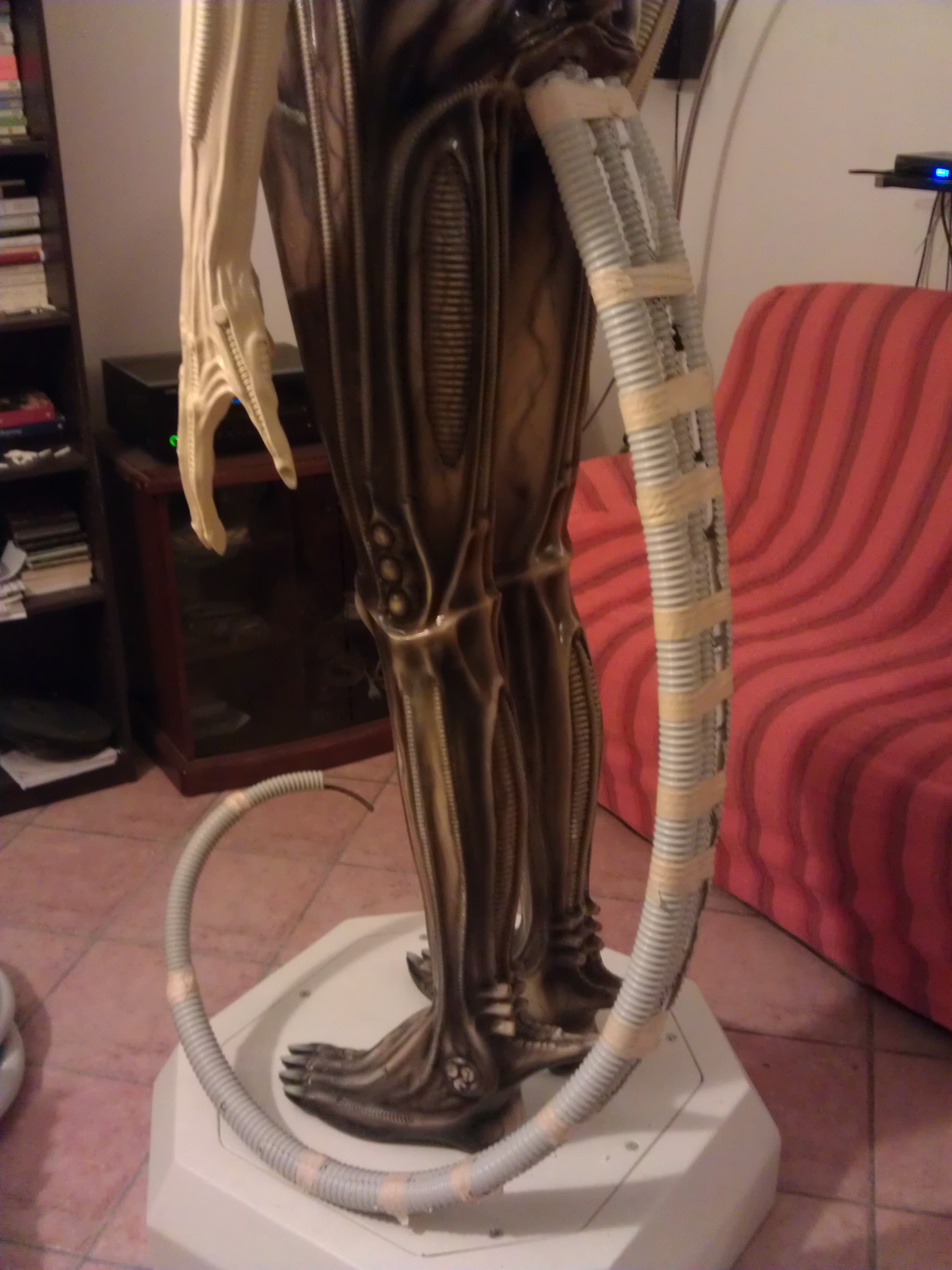

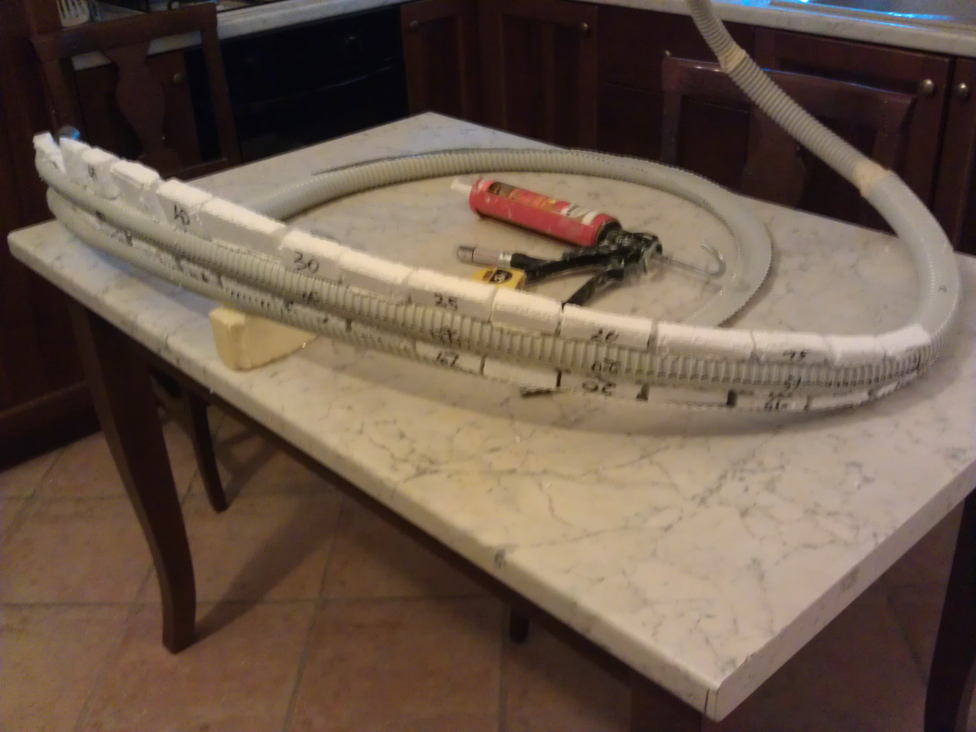

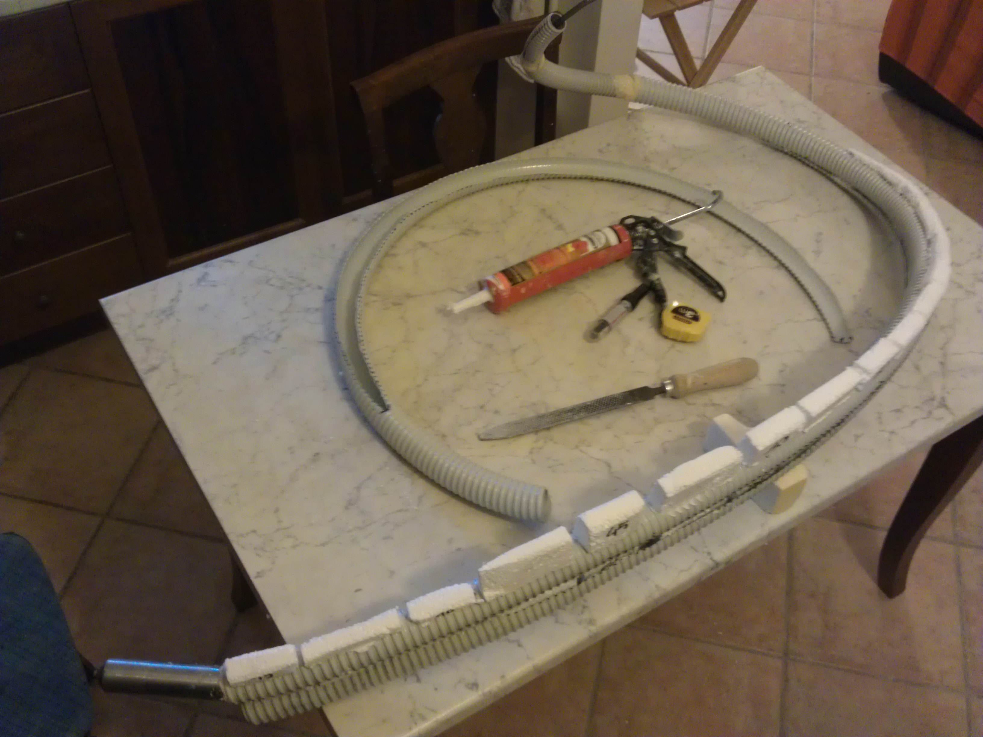

Than the previous, I improved the construction of the tail, both for the size decreasing towards the tip, both for the coupling between the pipes. As an end result should be more linear and clean. I'll have to hide the end of the tubes (where they overlap) with the vertebrae.
This week I should finish the tail. Then, since the bottom and the final sanding the new parts, I will paint everything.

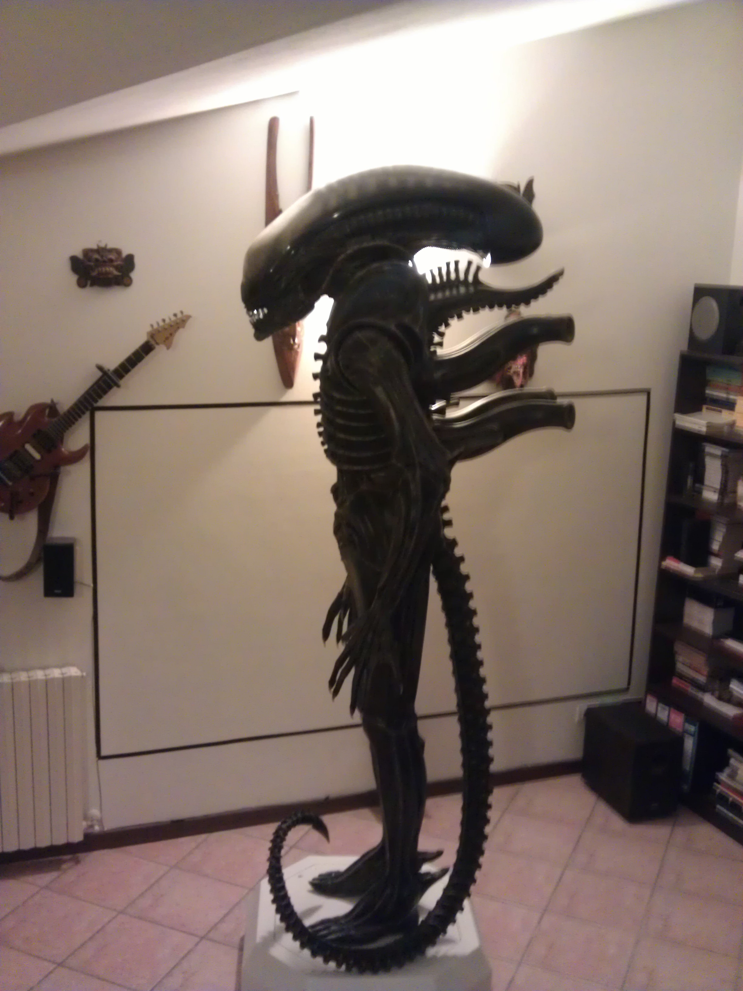

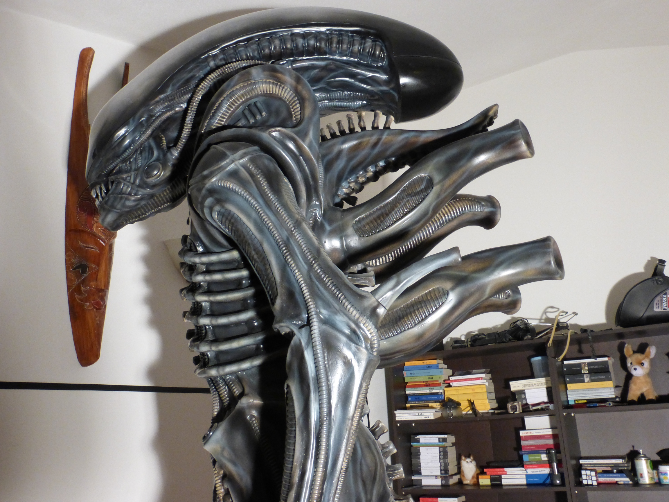

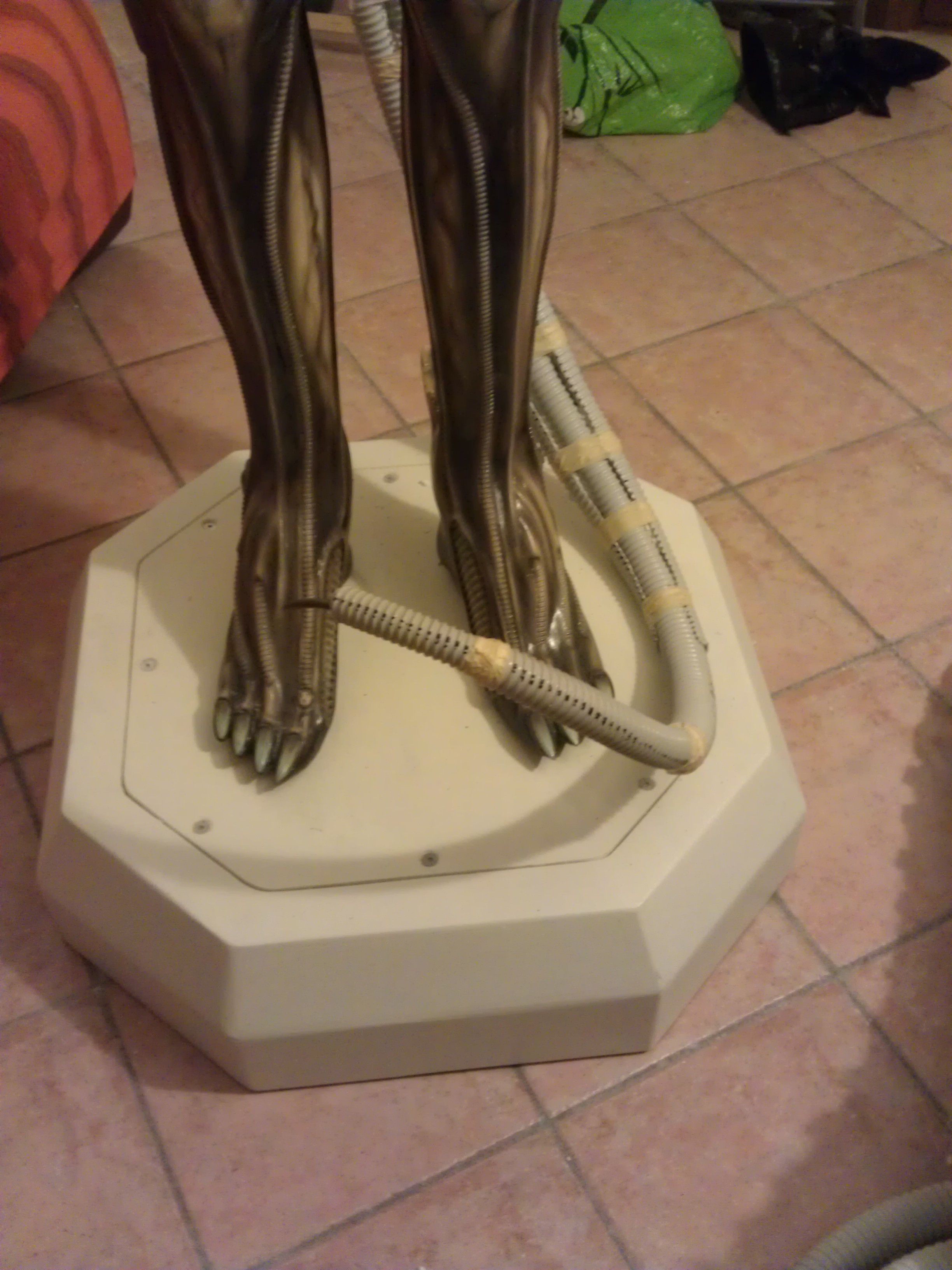

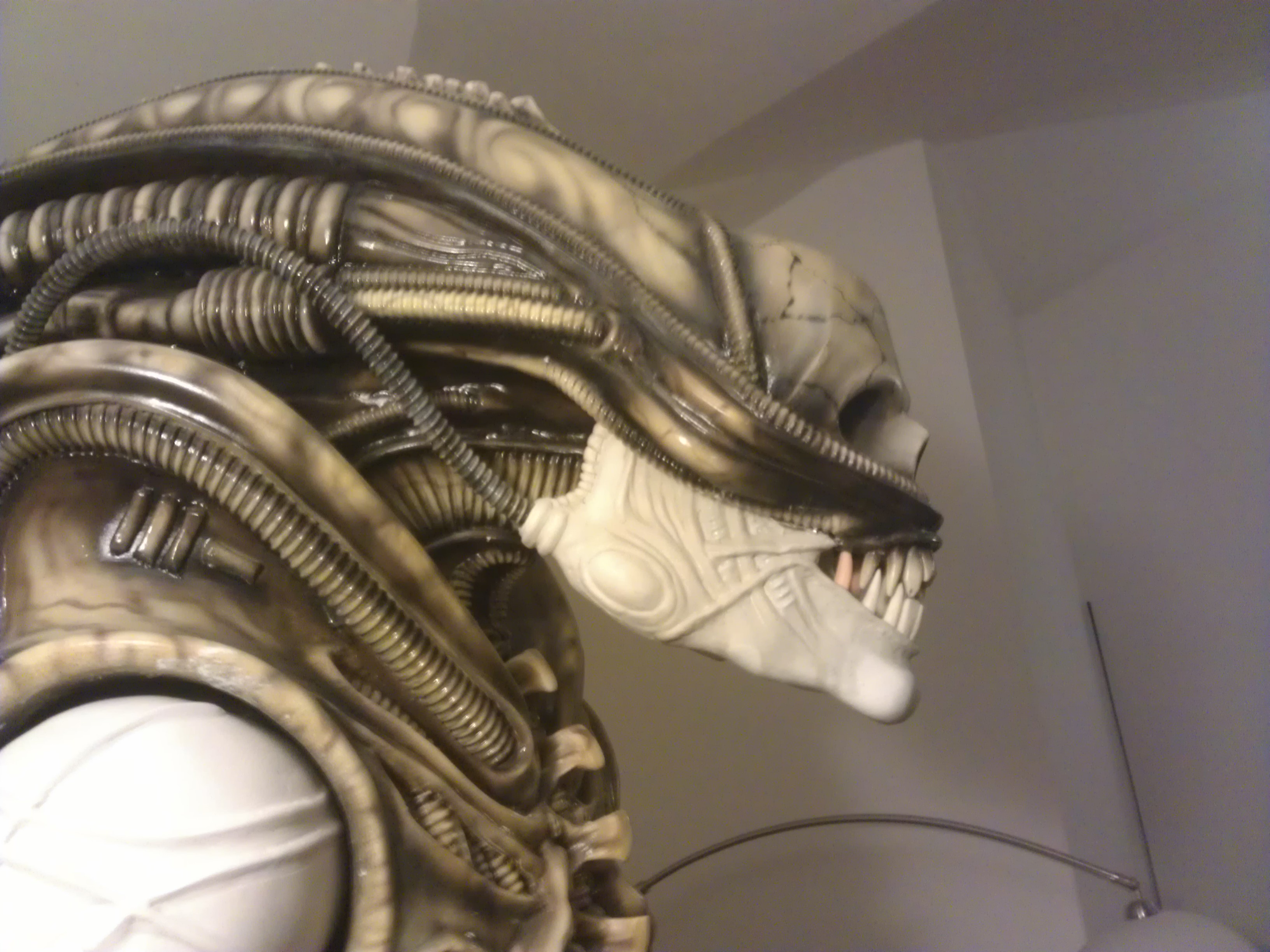

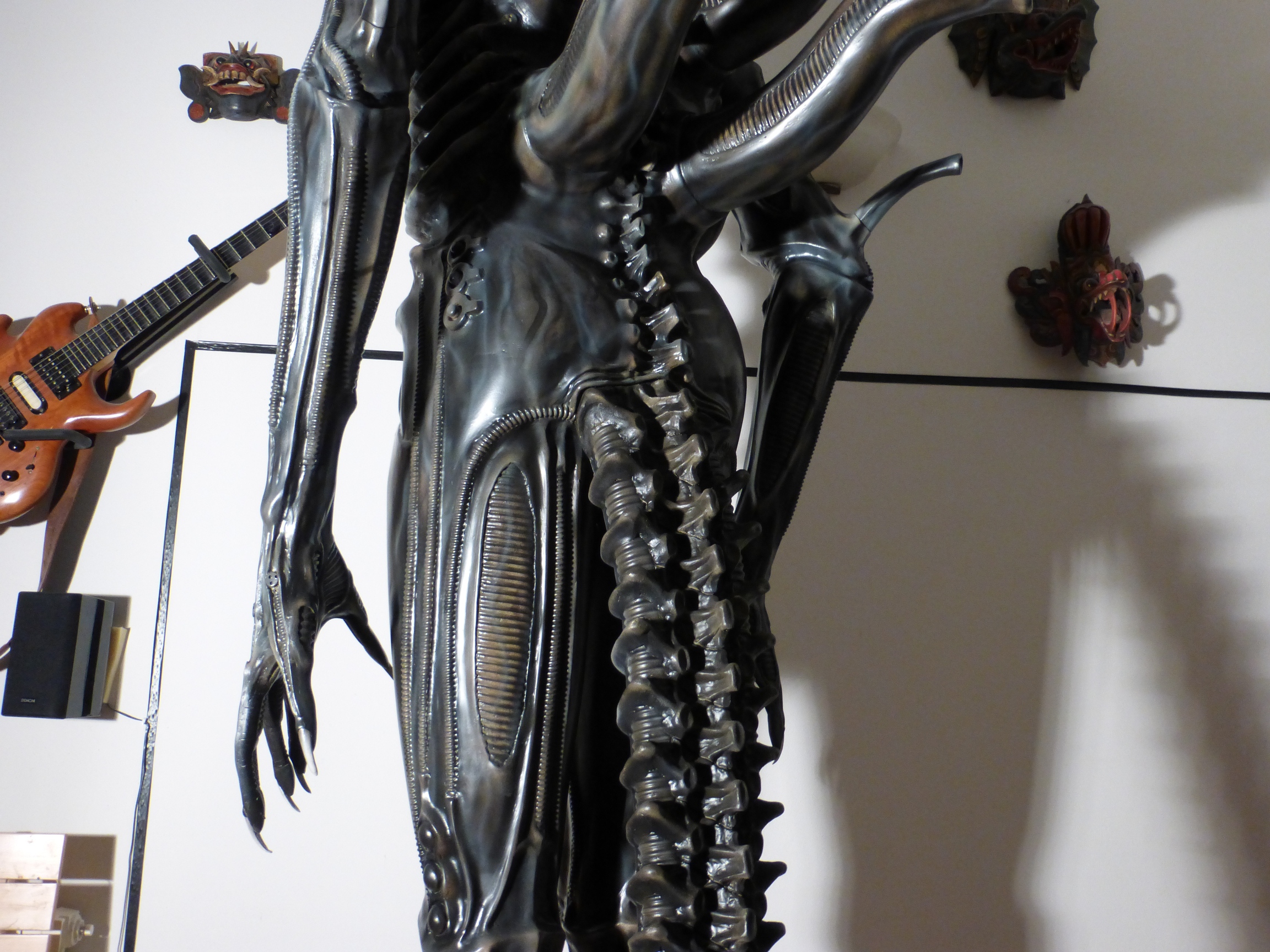

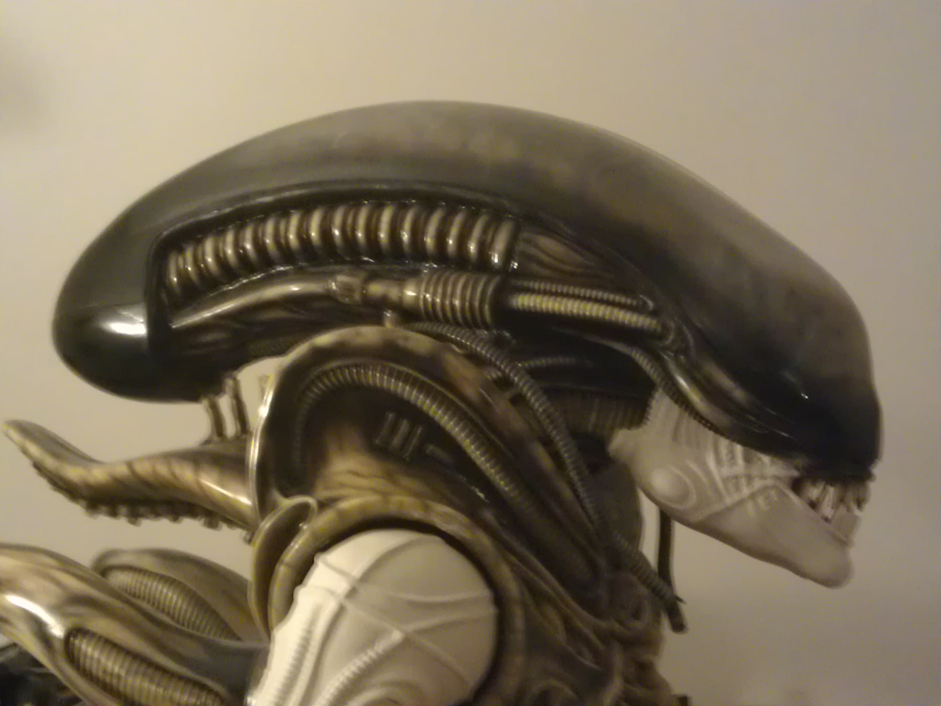

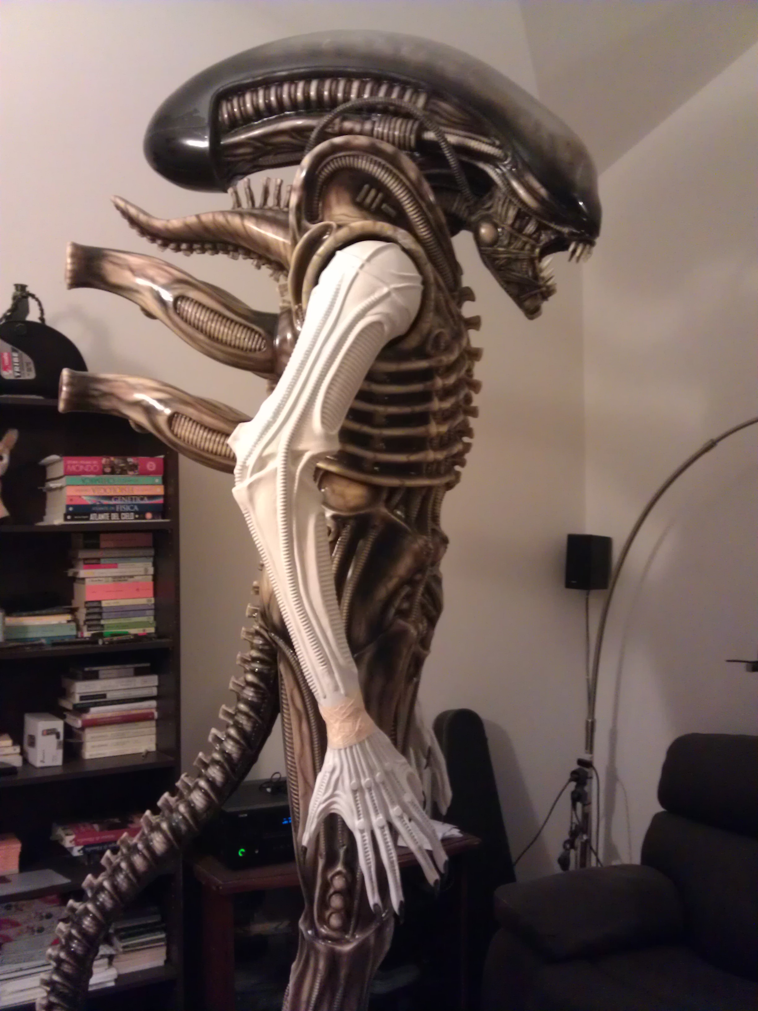

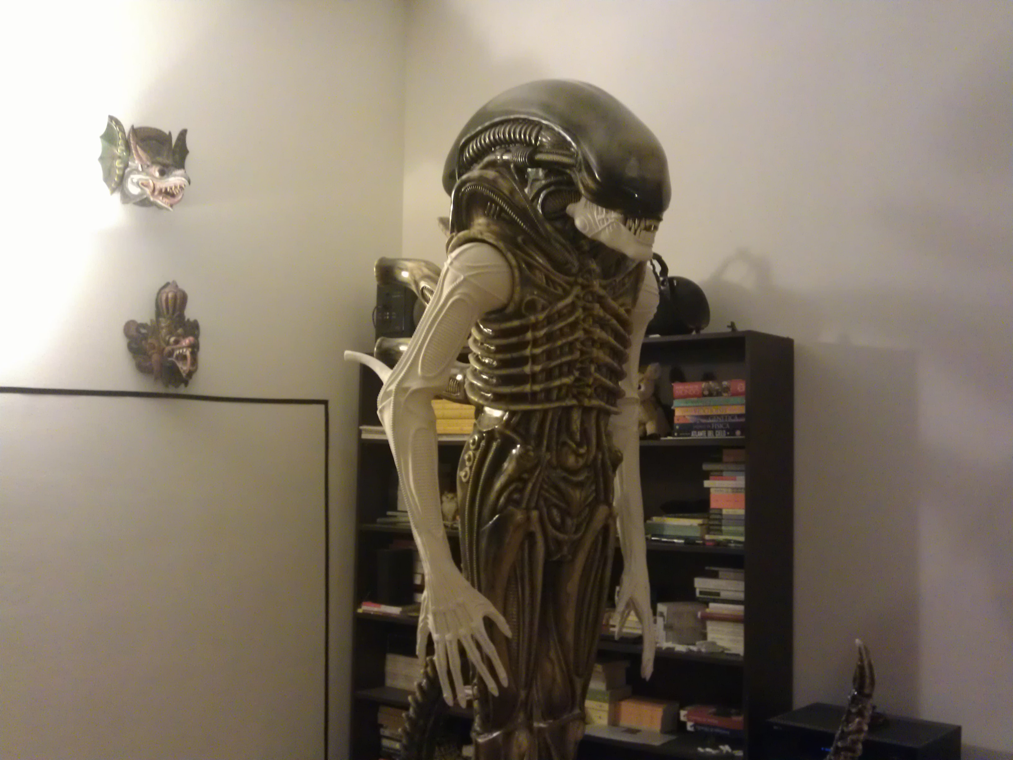

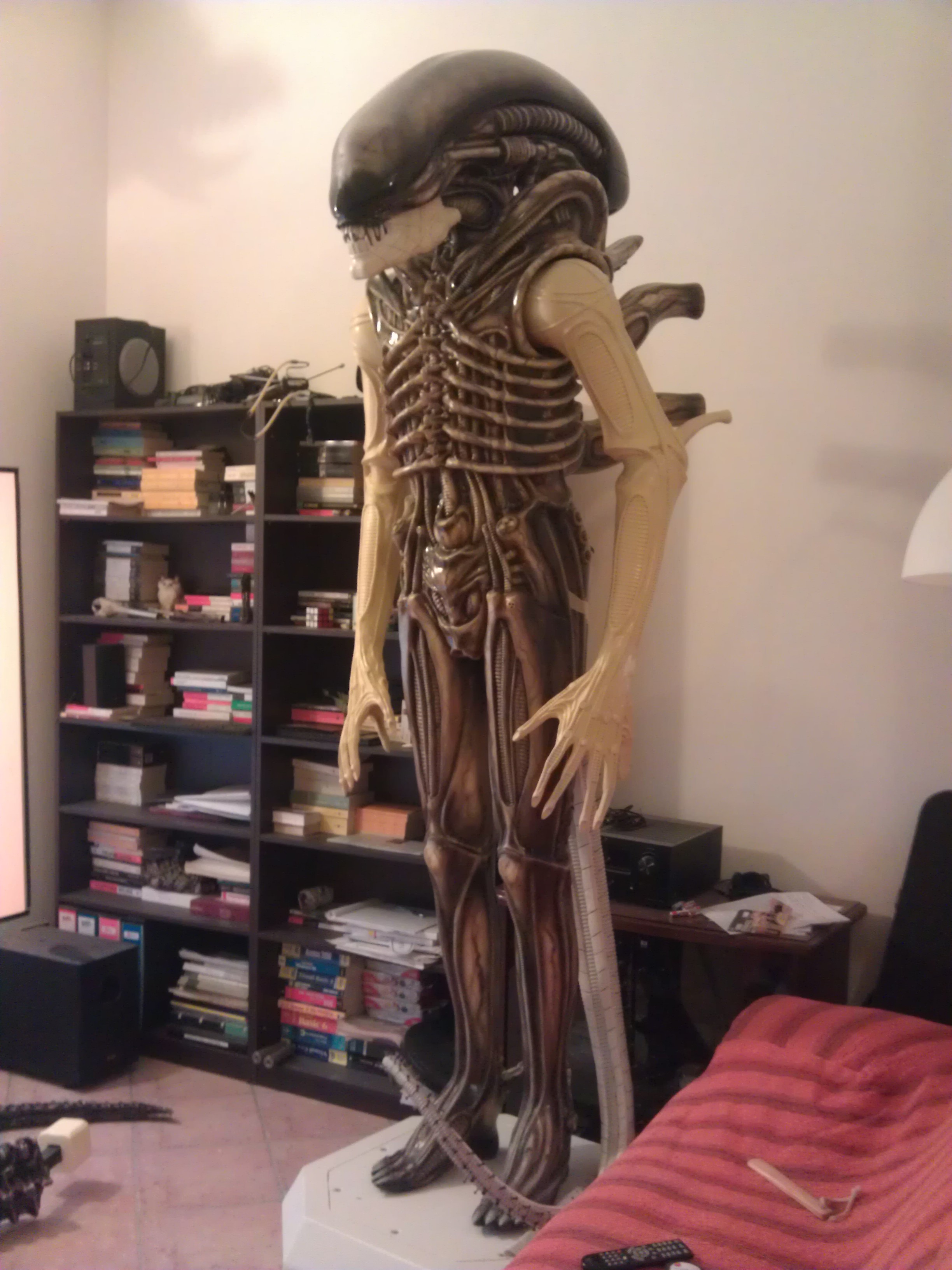

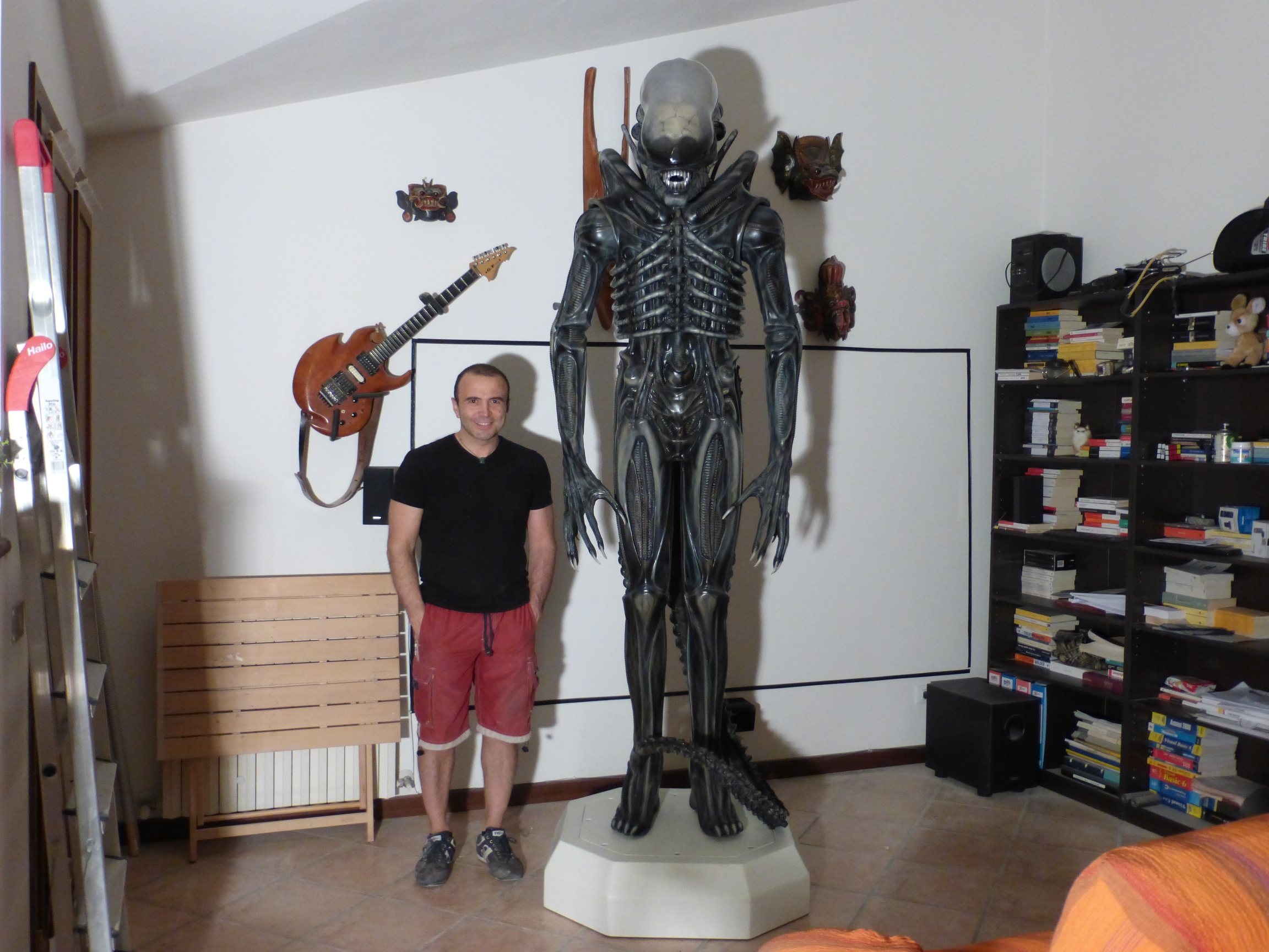

Hello everyone, here's arms and jaw painted with the new color,more like the original. I'll have to add some nuance beige. And a little dirty at the base of the teeth chrome. Of course I'll have to do the same action on the whole body. I should finish within the next week. So this thread will be closed .... finally. :)
Superb !!!
Excellent! :)
Hello guys and thanks for the comments.

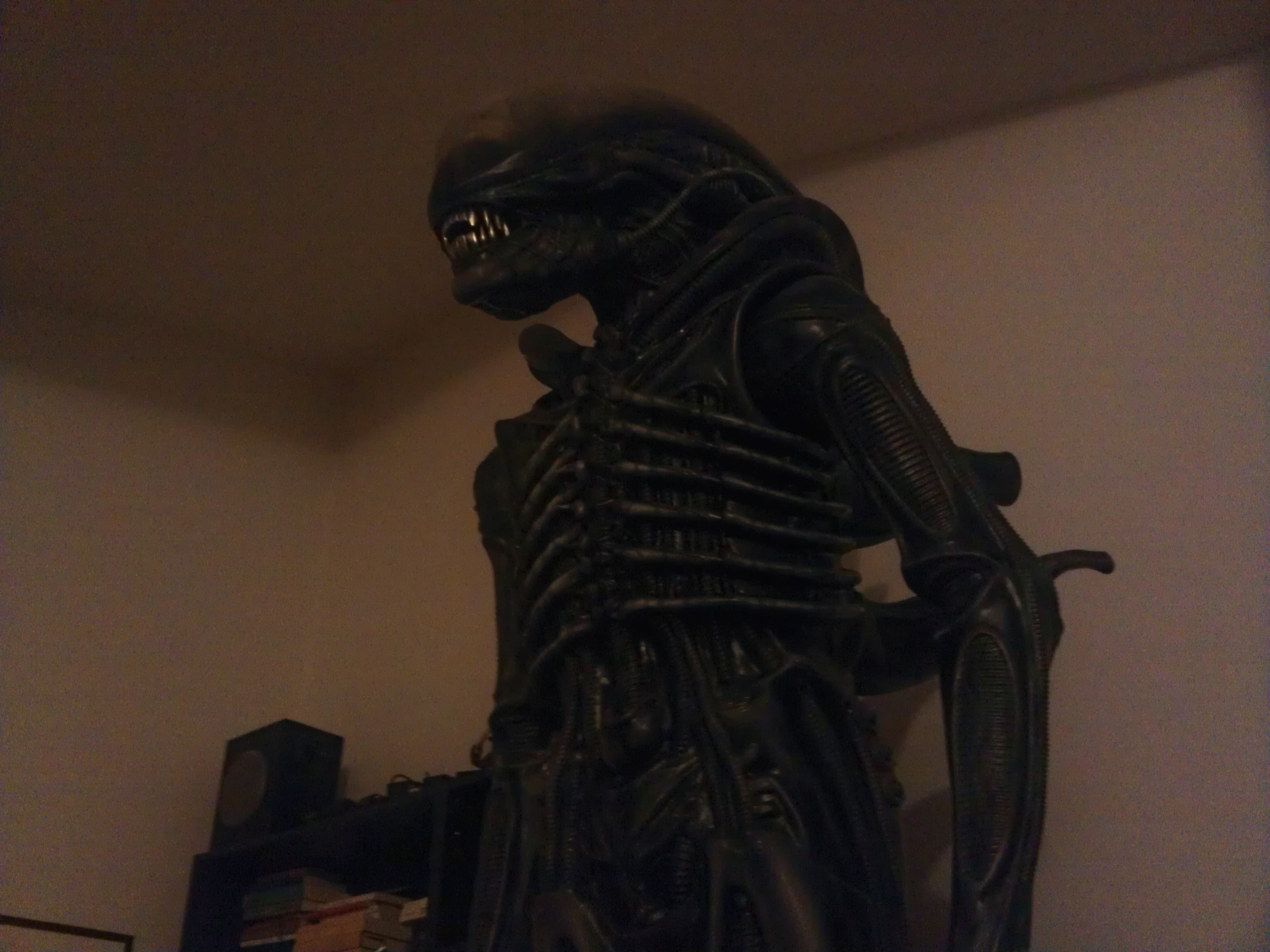

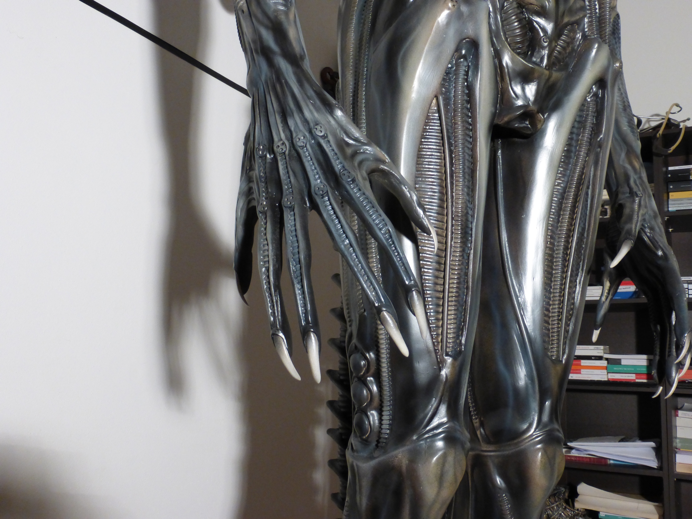

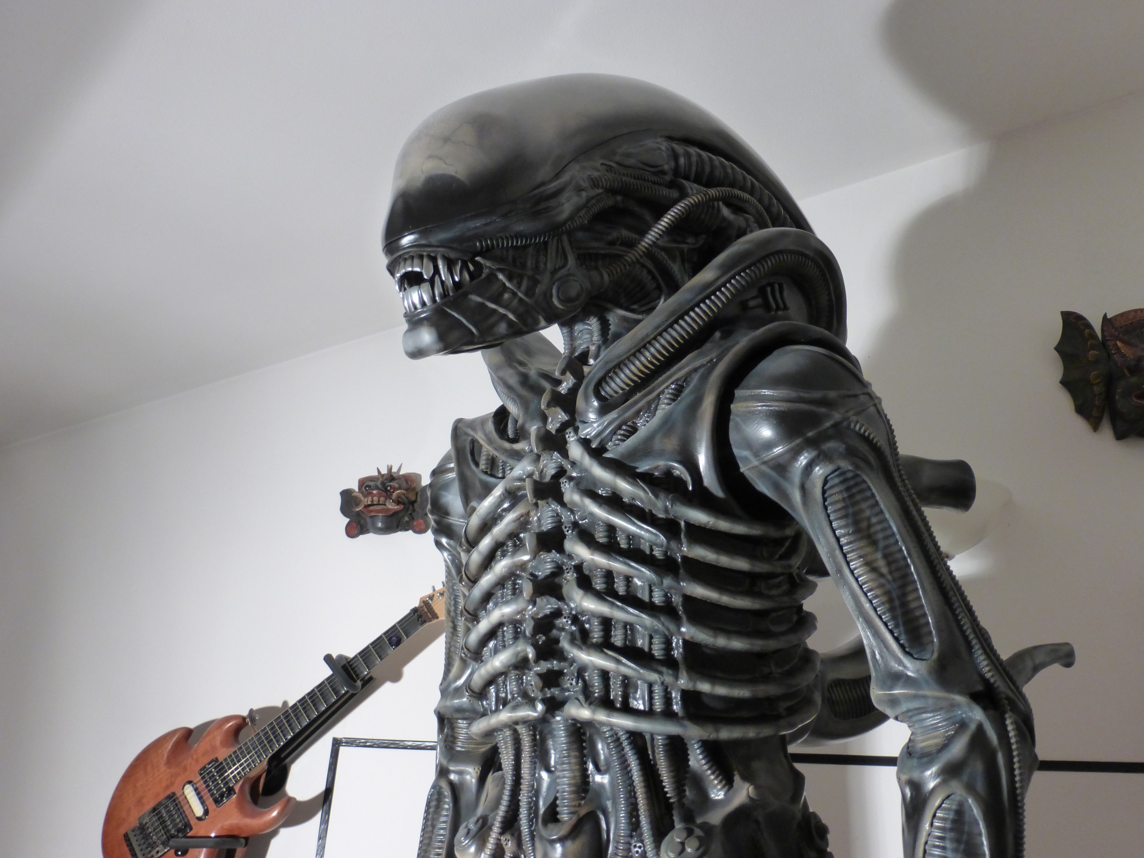

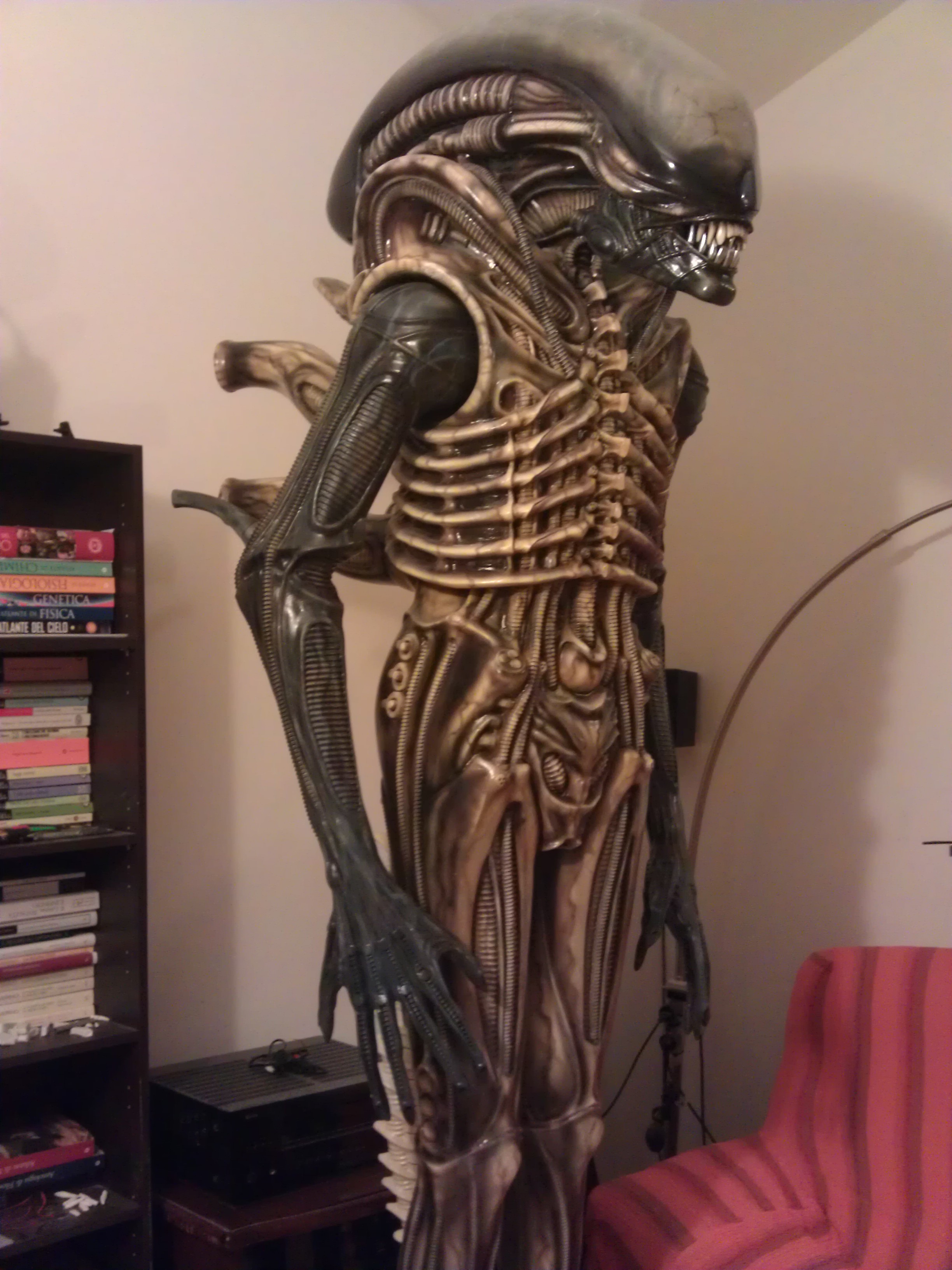

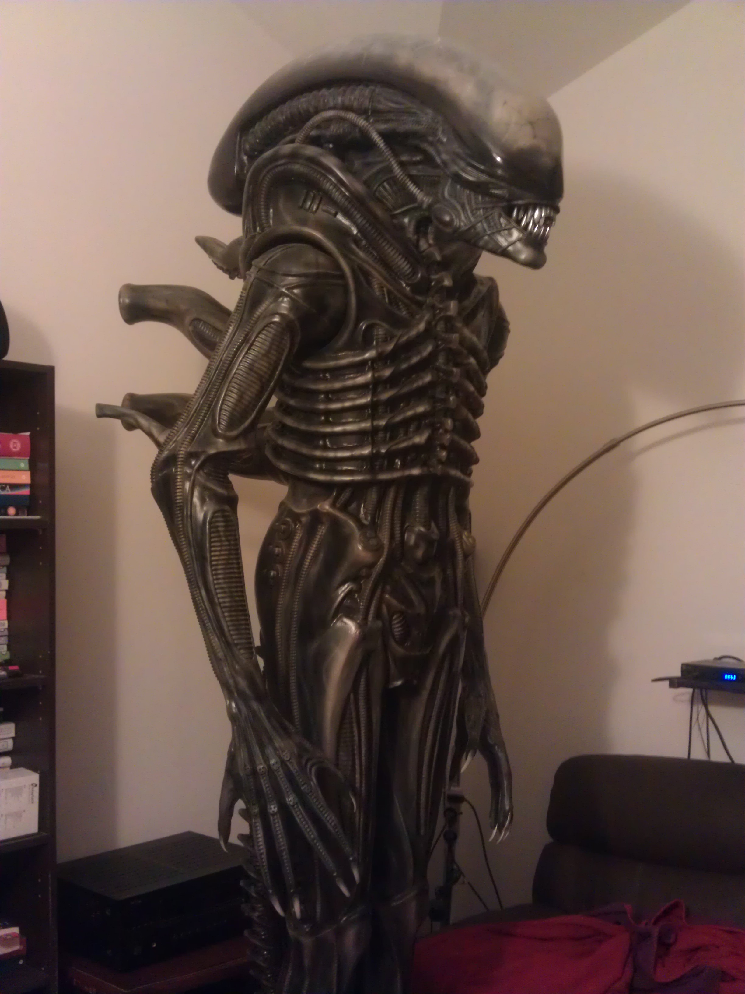

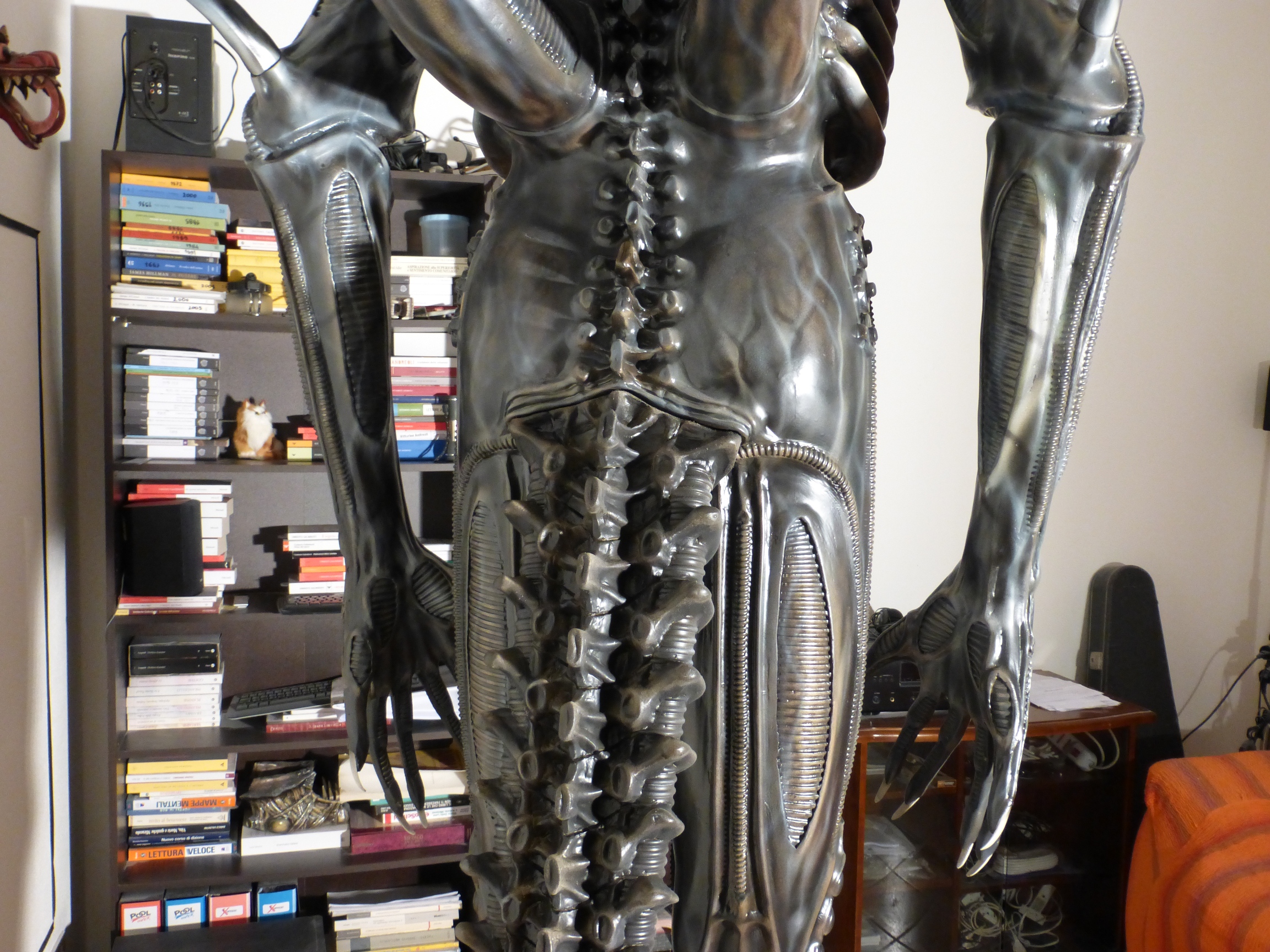

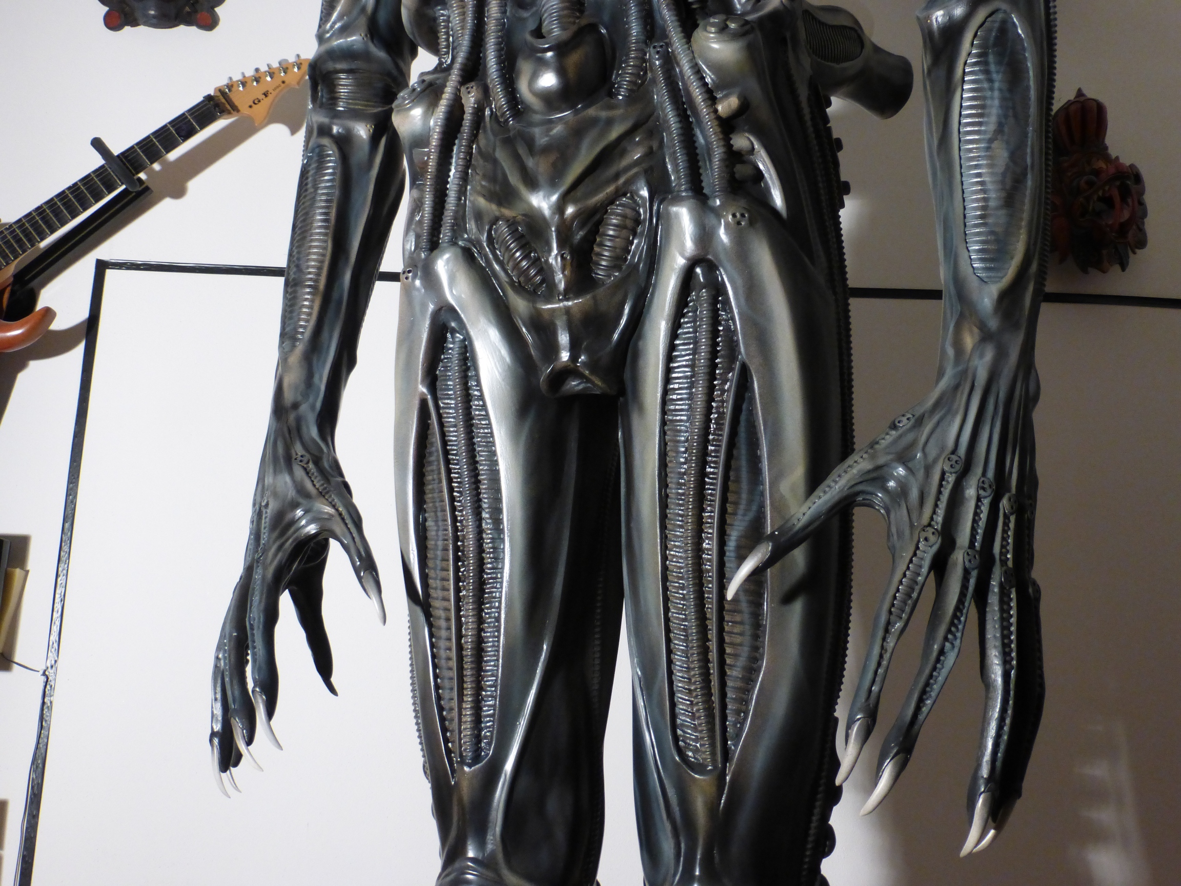

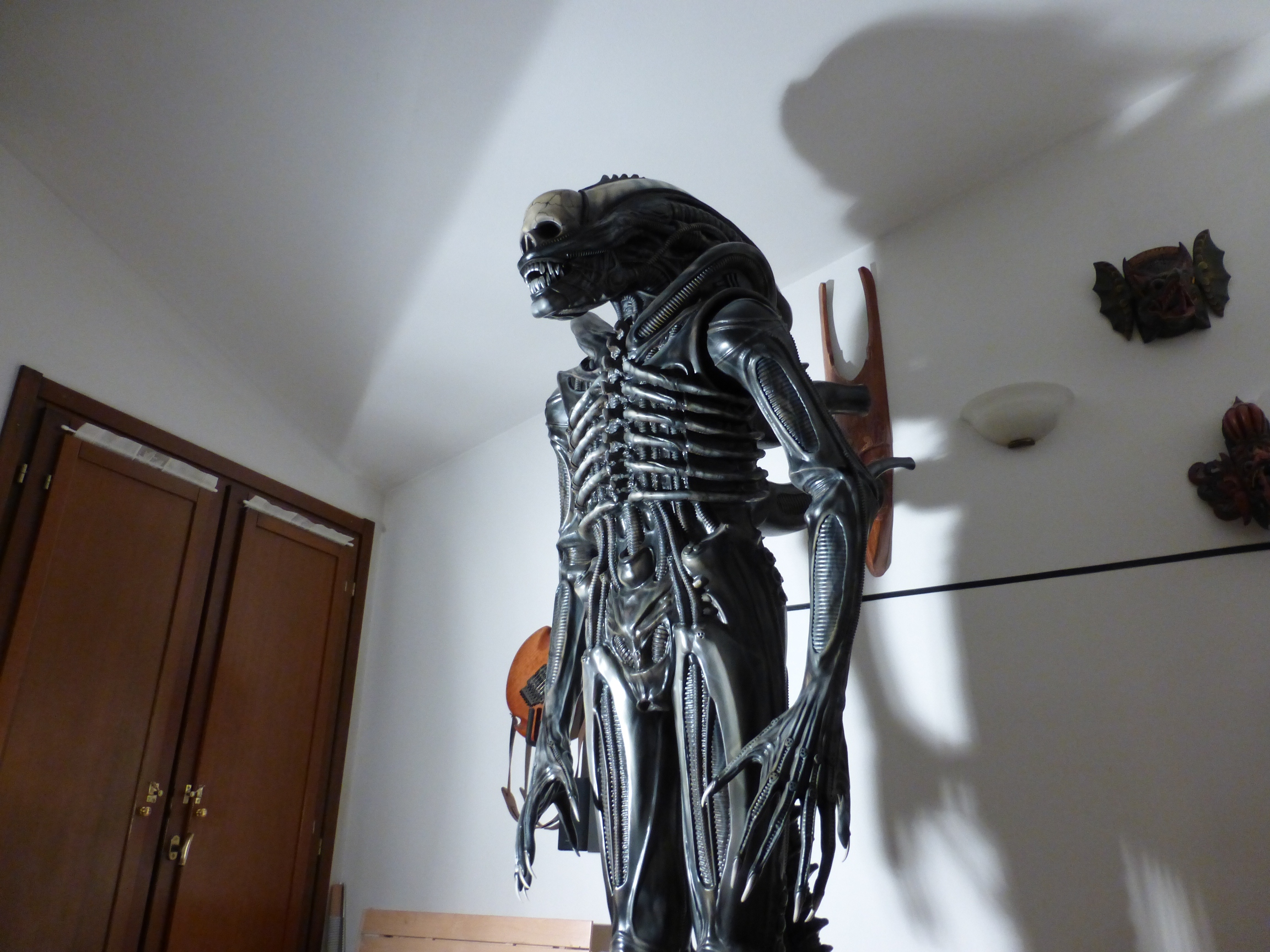

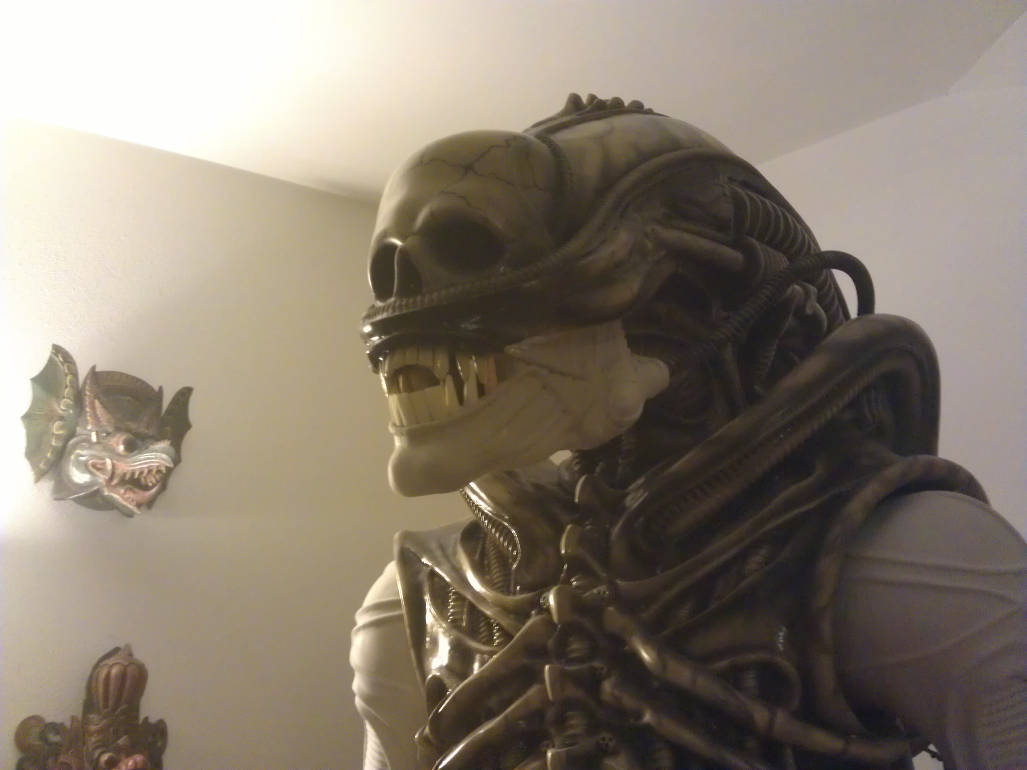

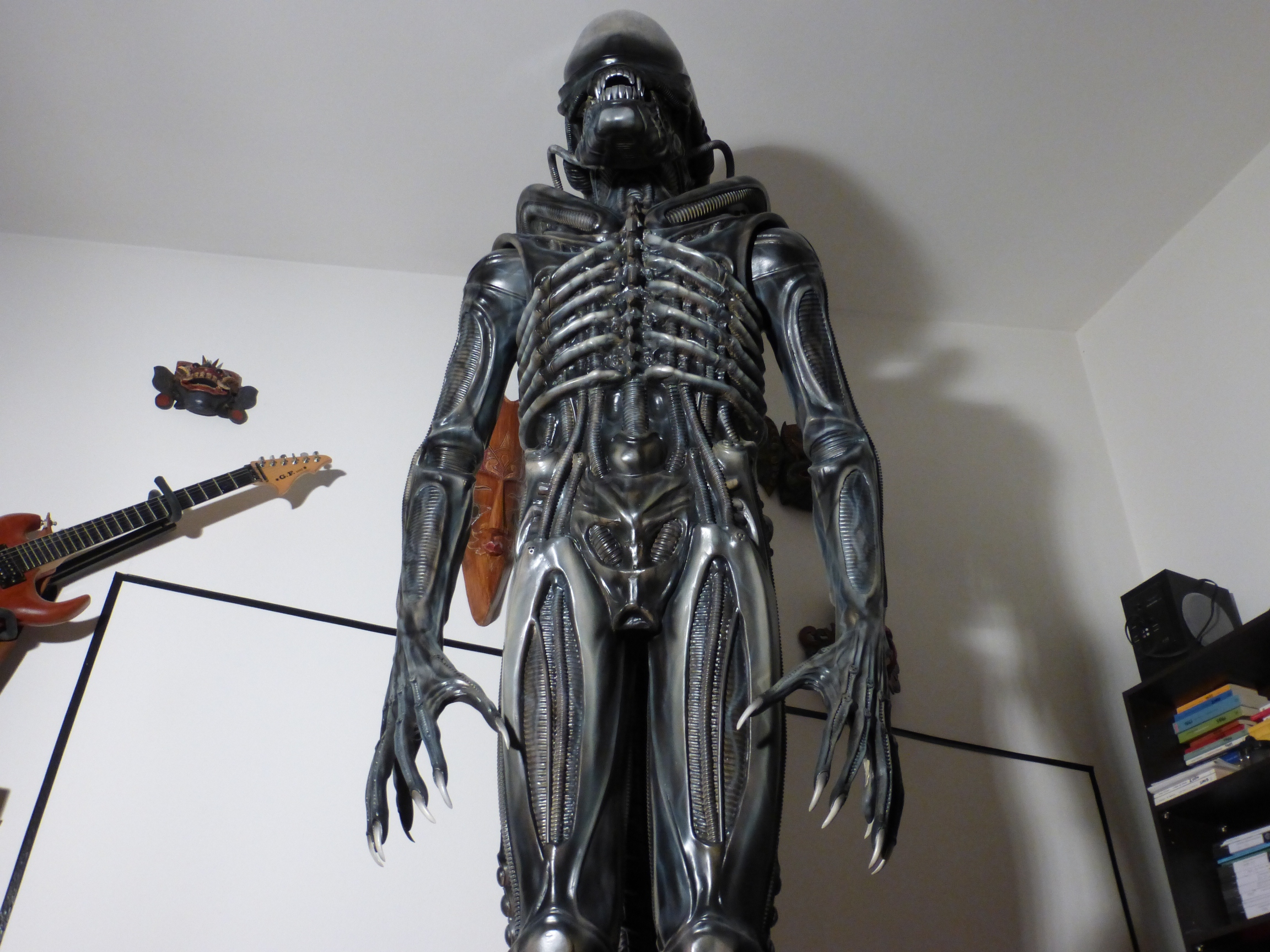

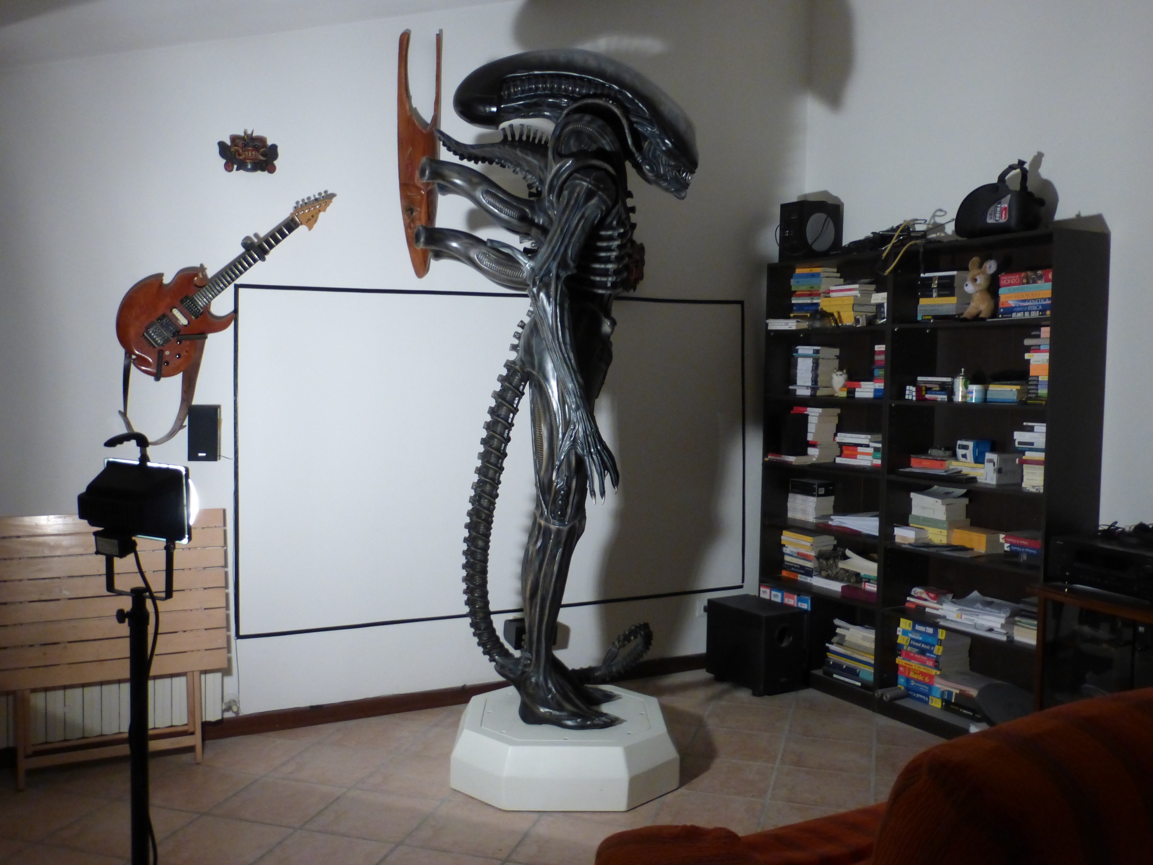

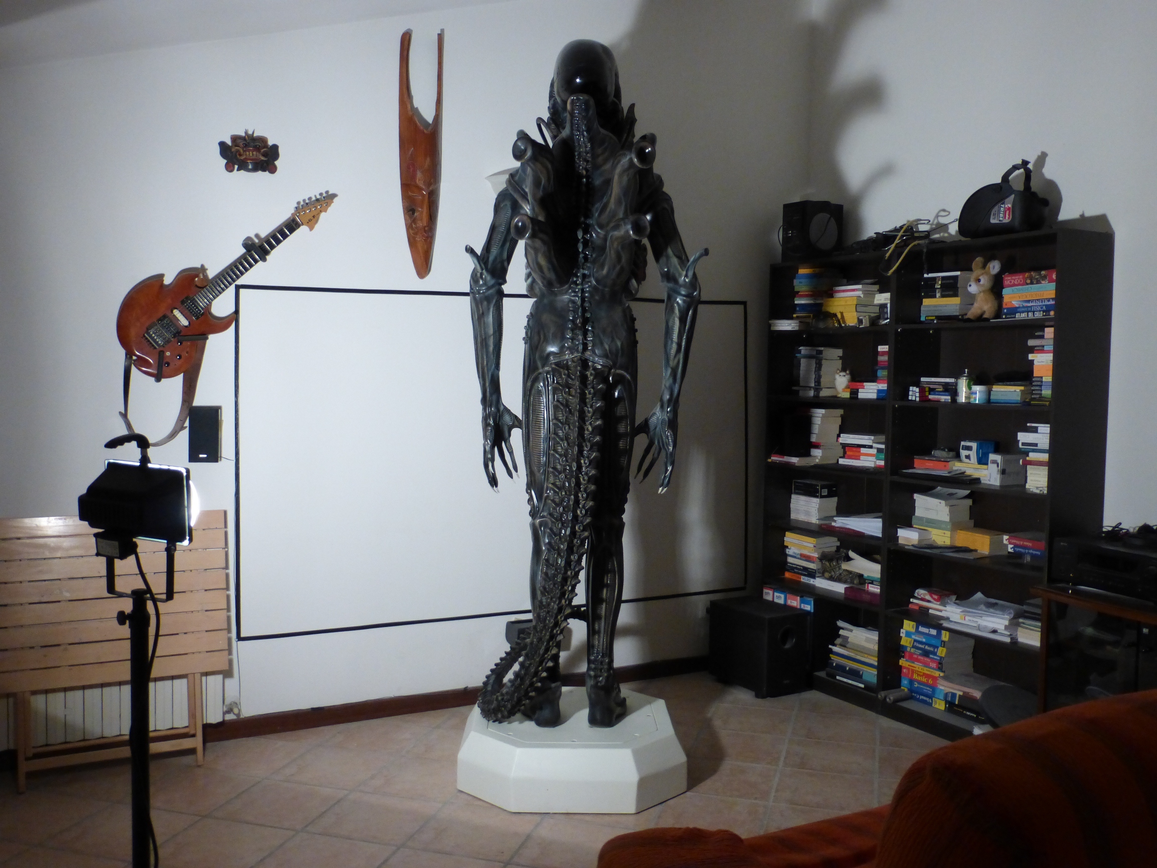

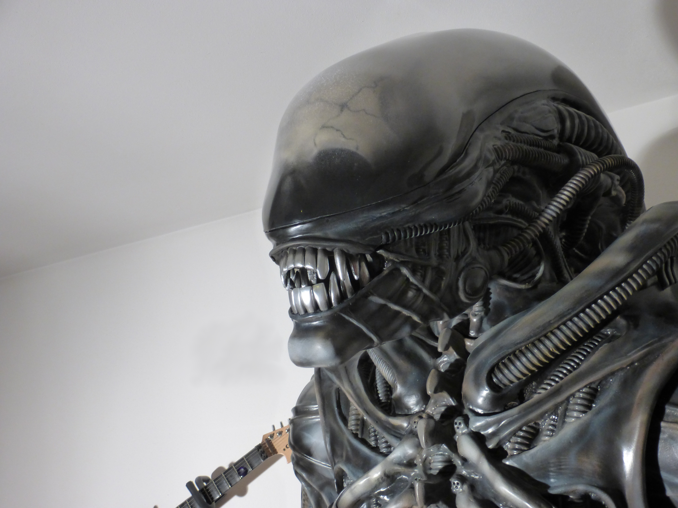

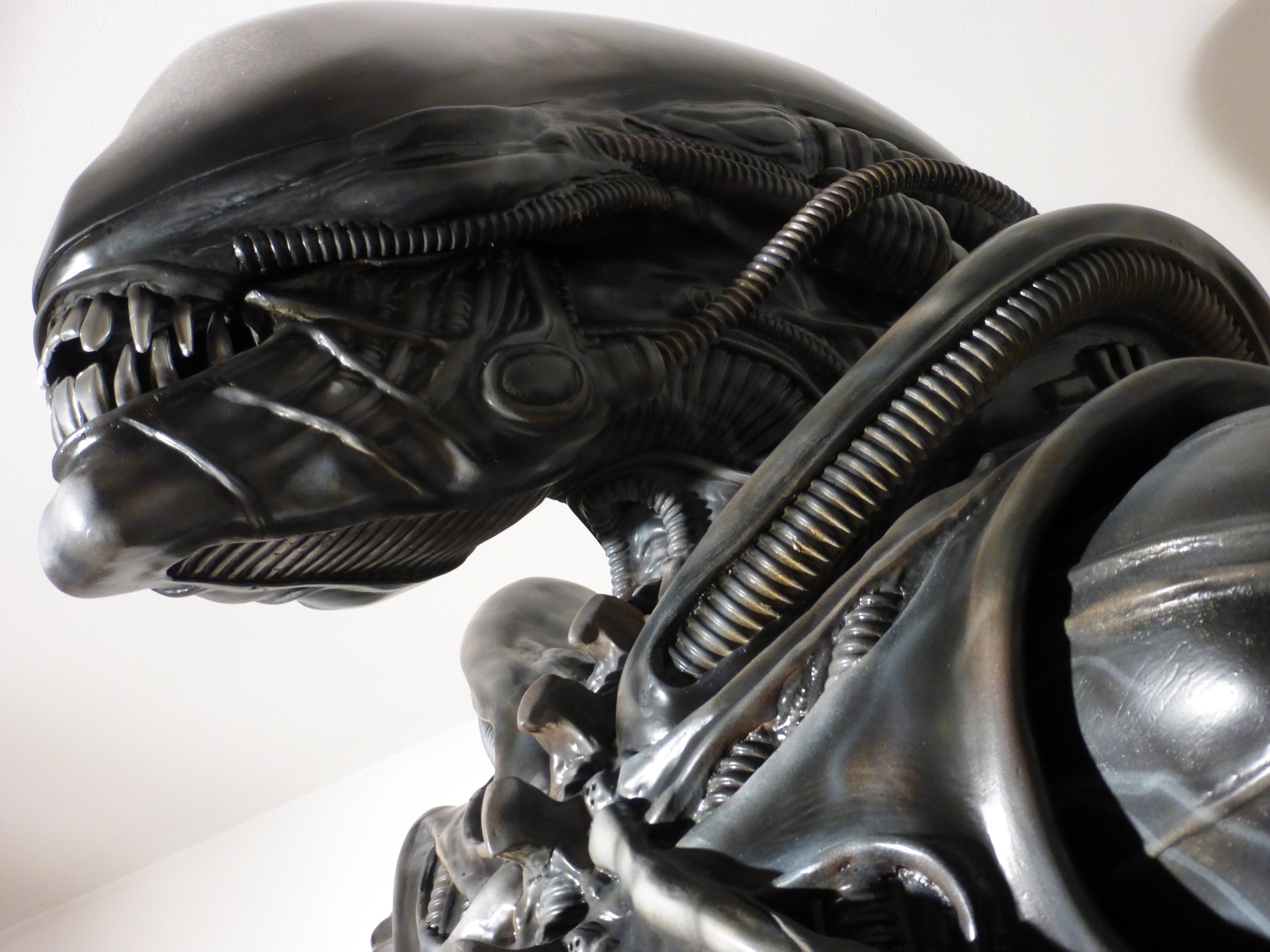

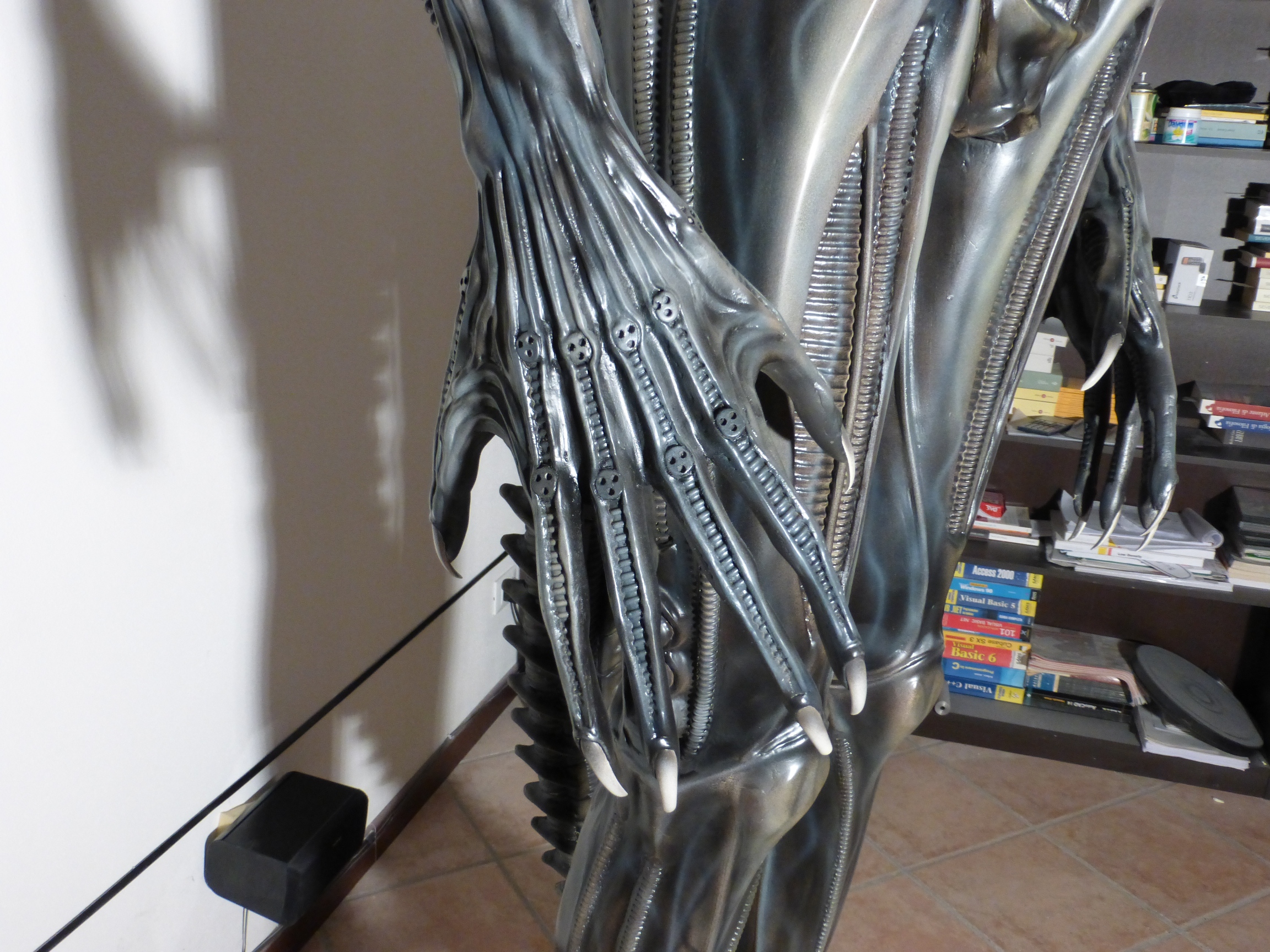

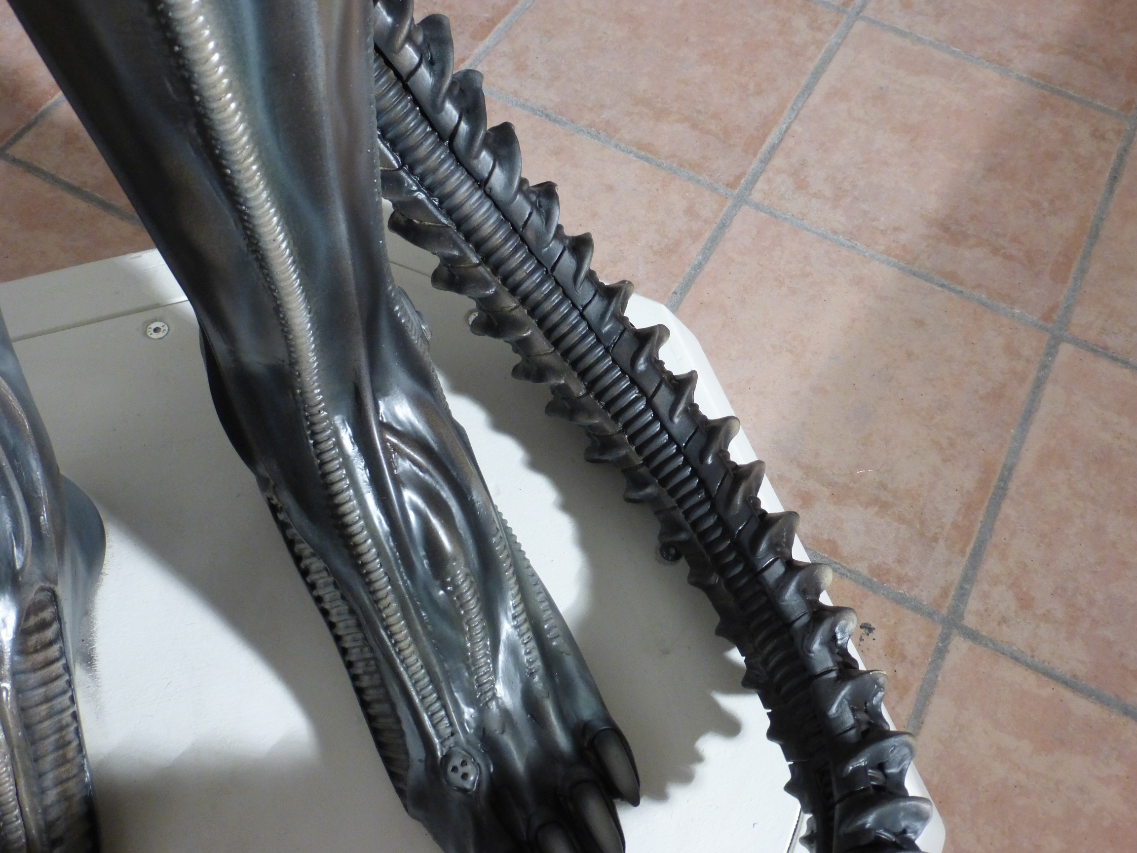

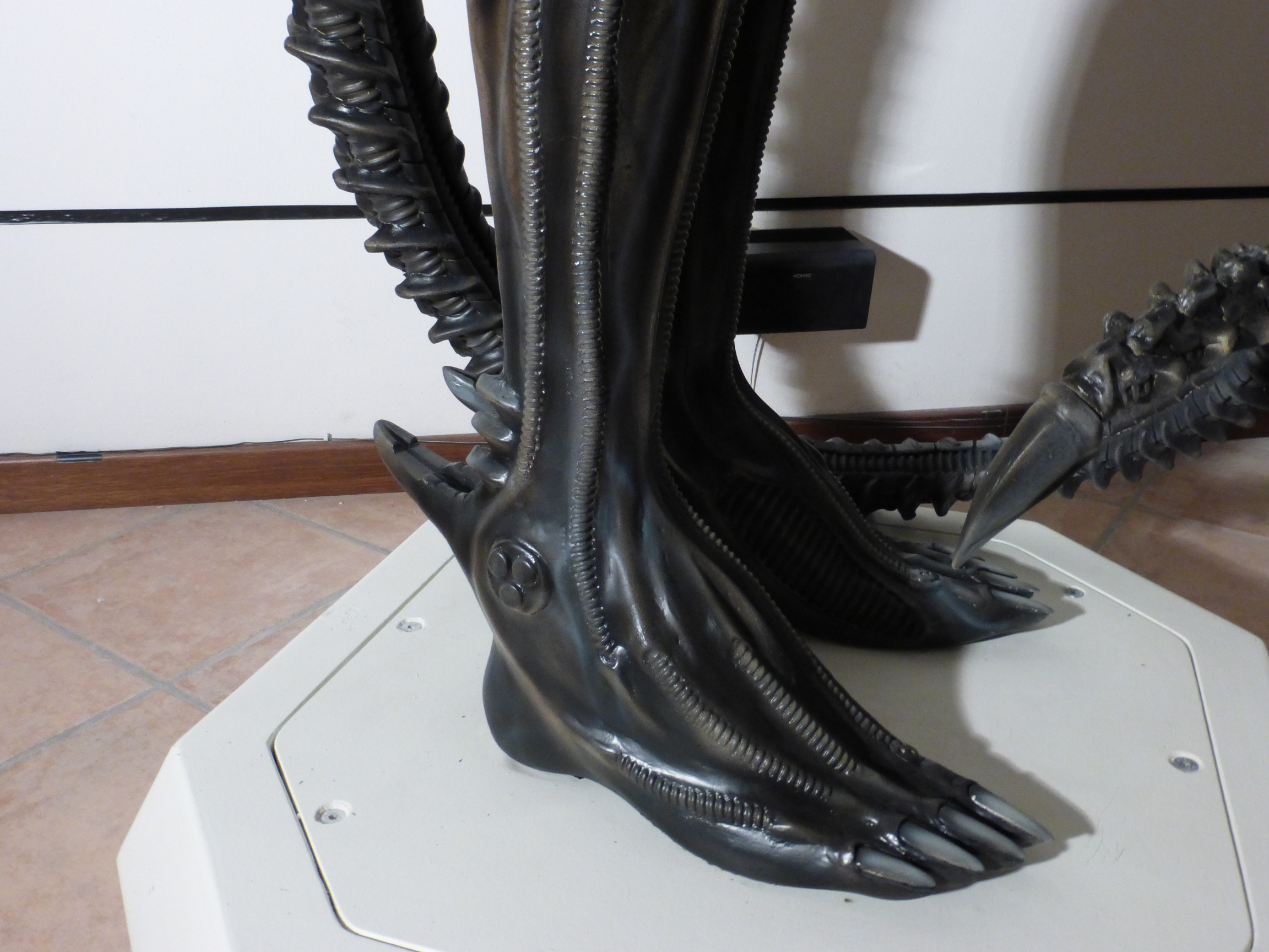

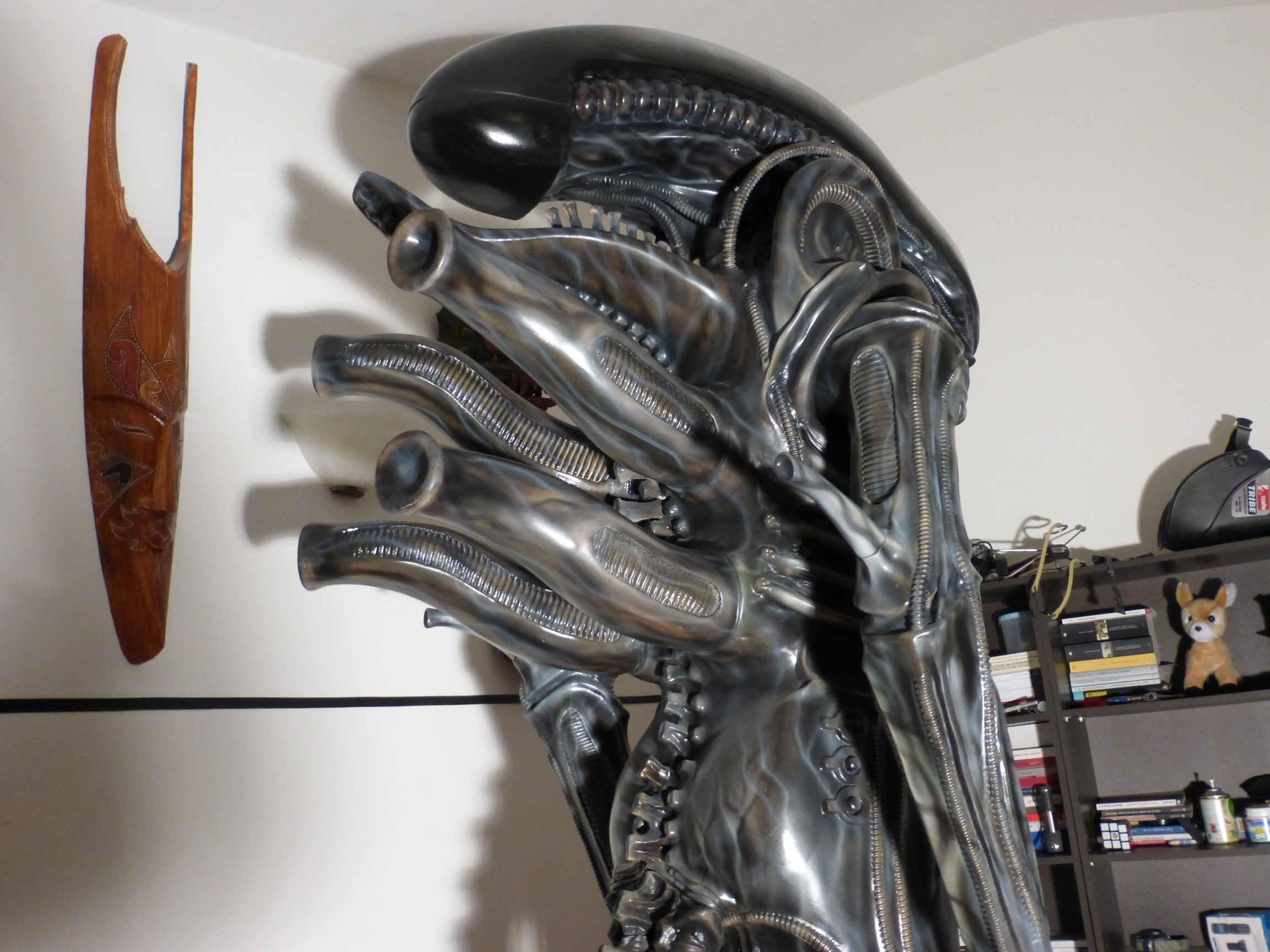

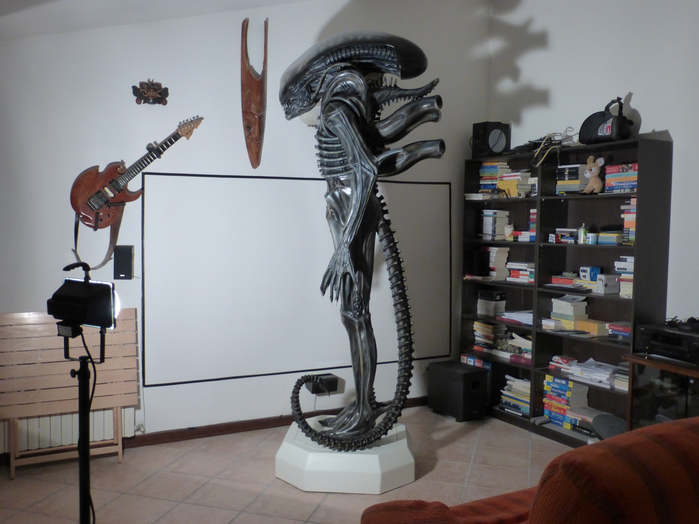

This alien is finished. There would be inside the mouth, but I will calmly and I'm not going to reopen this thread. I do not know how to rename the thread title to add "finished". If someone knows it and is not too complicated to explain, I'd be glad to hear it. Enjoy the movie by putting it in HD. See you again soon. ;)
P1000201.JPGP1000202.JPGP1000203.JPGP1000204.JPGP1000206.JPGP1000207.JPGP1000208.JPGP1000210.JPGP1000211.JPGP1000212.JPGP1000213.JPGP1000214.JPGP1000215.JPGP1000216 2.JPGP1000217.JPGP1000219.JPGP1000222.JPGView attachment 381459
I love the darker paint job!
Beautiful work, sir.
Wow so there it is in all of it's mighty glory. You have done an incredible job with this beautiful beast my friend congratulations. The paint work is awesome and i love the pose you went with. Couldn't be better. 100/100
Amazing work! Now I want one of my own :)
Thank you all.
Pnag, if you do not live far away, you could save the postage and come and get it with the truck and the cash. :) Maybe it would be a affordable price.
Daring, the next will make them first-hand with a black background, and then light shades, rather than the opposite (as I did with this one), so I would save time and colors.
Nial, although I think this enough to say that I have ALIEN at home, I think the next will be even better.
Thank you all and the next episode. :)
