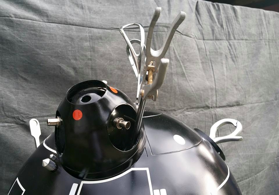

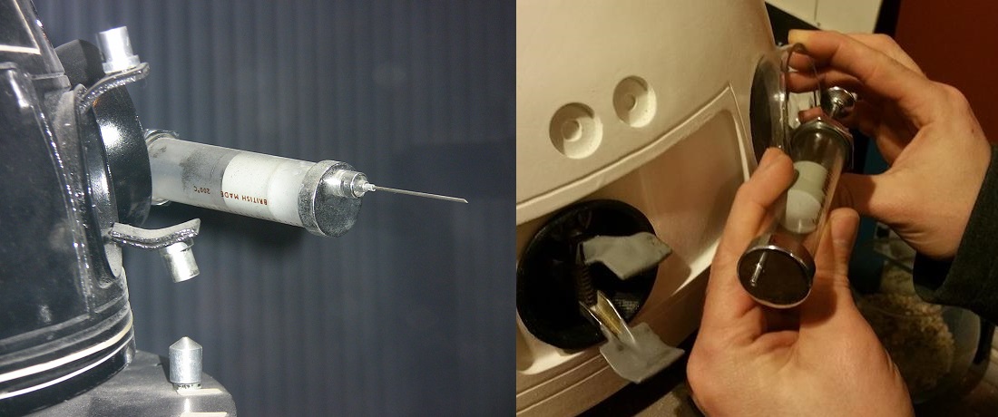

Making big strides this last week or so.
I've gotten all of the cups designed with the help of a friend and they've been 3D printed. Those will be molded and become part of the kit. I also picked up some 3" hemi's from Plastruct for the cup for the syringe as well as finally gotten a pretty good start on the rear claw. Next step is to mold it and reshape it then remold to the right shape.
Oh....within a week or so I should have the topper done.
My goal is to offer the kit with all of the structural parts, most of the little bits that are planted all over the thing, and rear claw. The remainder of the parts are readily available on ebay for around $275 total, and it hardly seems worth trying to mold a bunch of $25 parts and then sell them for about the same. The only expensive part is the tonsil tool...which I am working on a cheaper alternative for.
So here are some progress pics...
compare1.jpg10988285_336201866583728_9057587883949828662_n.jpgclaw compare.jpgtonsil compare.jpgsyringe cup compare.jpg

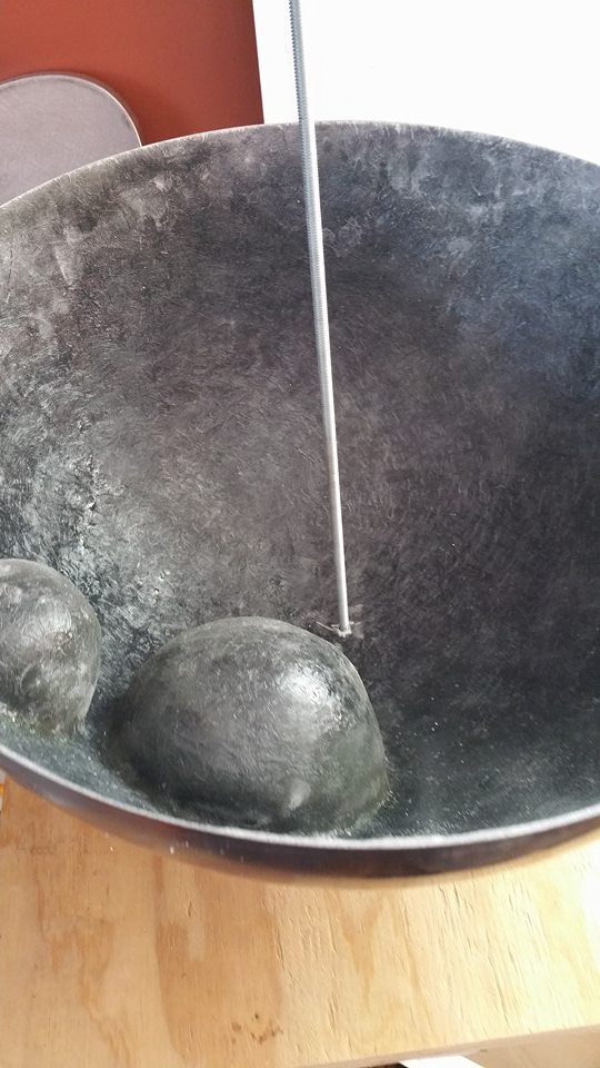

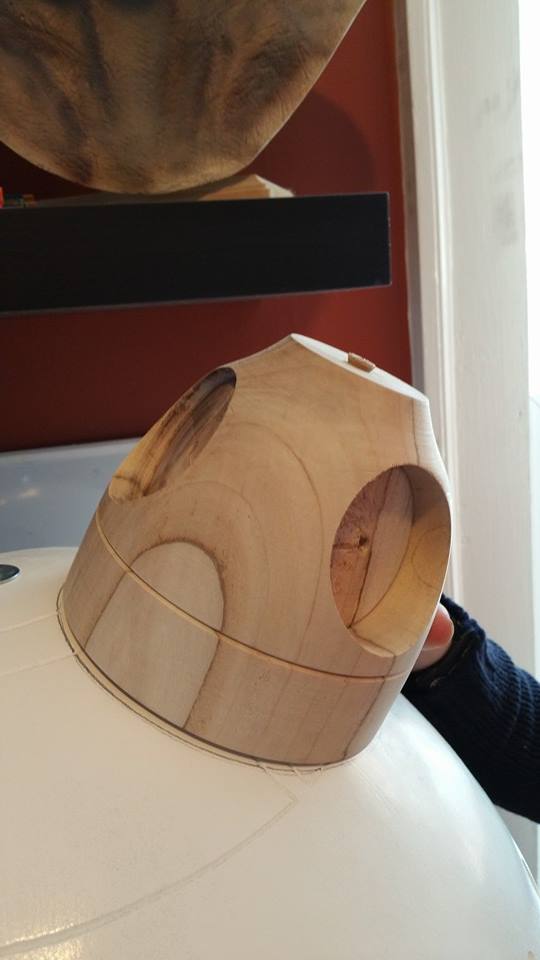

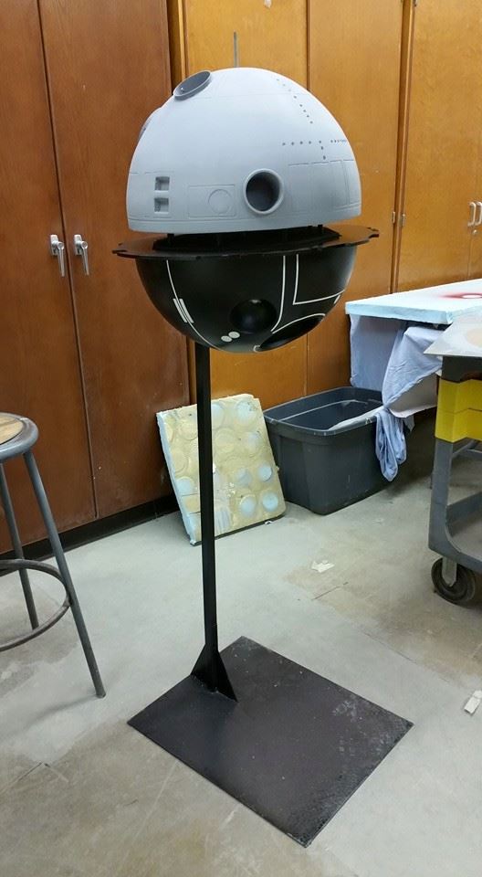

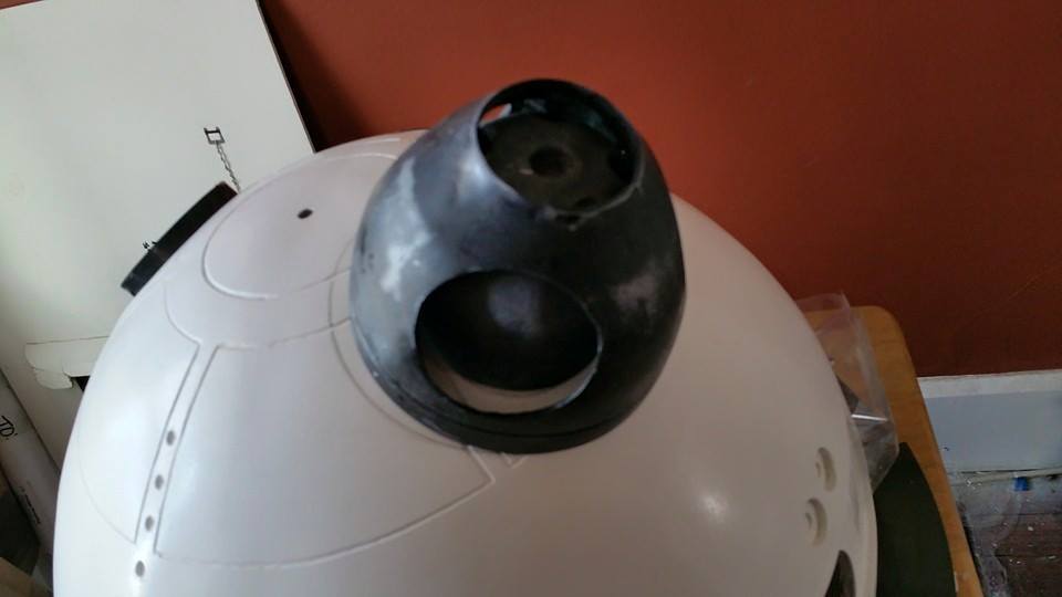

The topper is back from the pattern maker. It's a little tall but it's designed that way on purpose so I can sand it to size once it comes out of the mold. These parts will be roto cast in black resin. I should have that done in the next few days.

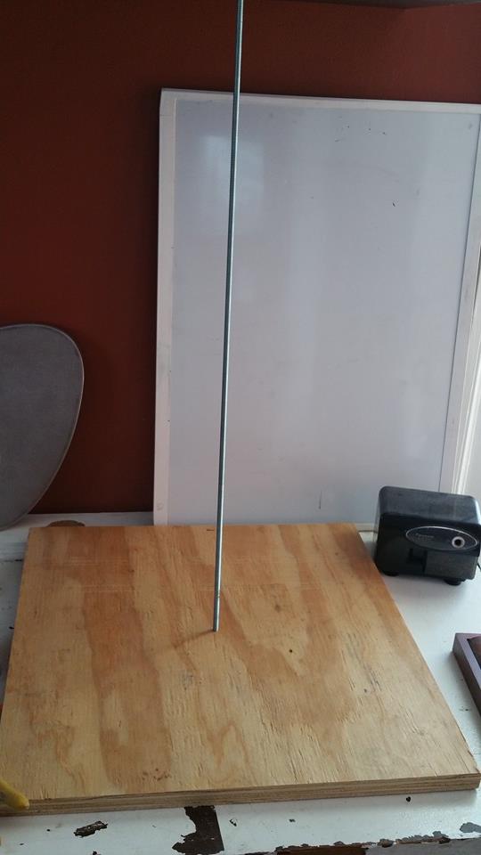

Also I started a rough assembly of it on a base. My intent with this kit was to design it so that a single 1/4" threaded rod holds it all together. I need to add some spacers to hold the top dome lower plate to the dome, but other than that, this is how it will assemble.
11002617_338360169701231_3229724834526970540_n.jpg10953245_338360196367895_2396226151442801023_n.jpg10991317_338360206367894_5980804713788536078_n.jpg10997332_338360839701164_2422024373917499718_n.jpg1907556_338360849701163_740075556315294844_n.jpg10991123_338360889701159_8056880702126967053_n.jpg10615428_338360906367824_8455524773323966912_n.jpg16829_338360923034489_4286580841275559853_n.jpg

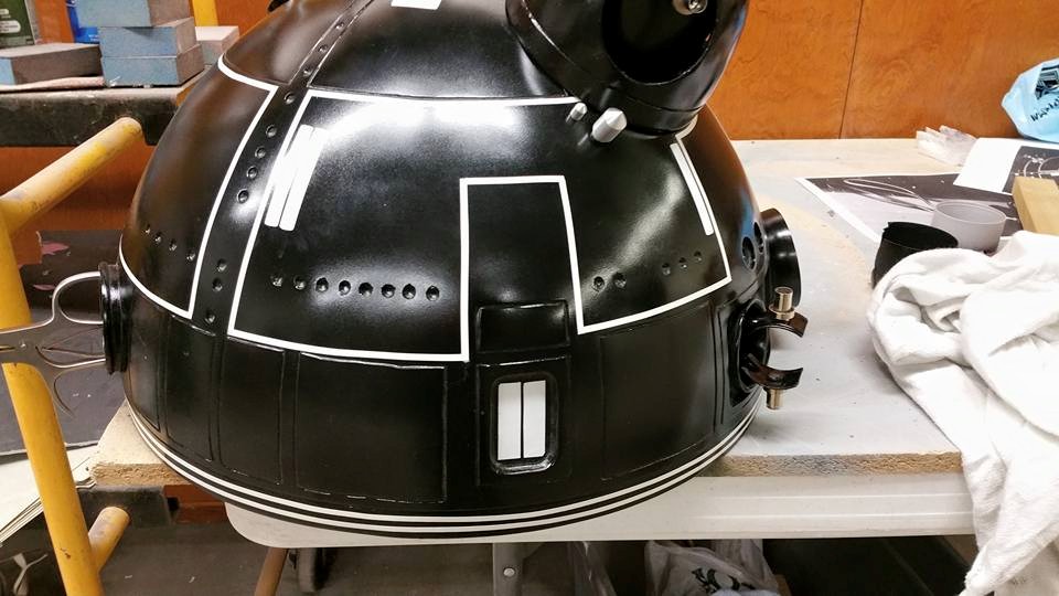

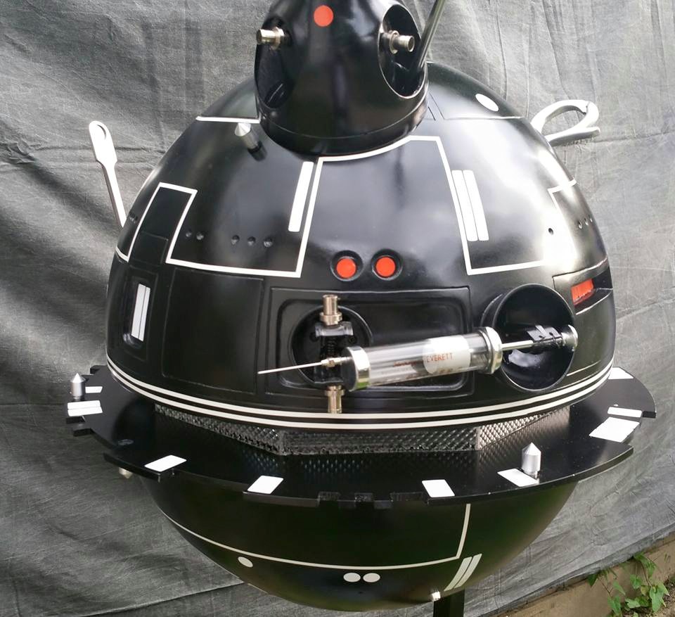

Alright....everything is molded and castings are being made.
The outer part of the topper is made in fiberglass and the inner part is rotocast resin.
The cups are all resin castings of 3d printed designs especially made for this project. I'm excited about the headway I'm making.
View attachment 452879View attachment 452880View attachment 452881View attachment 452882View attachment 452883View attachment 452884View attachment 452885View attachment 452886
