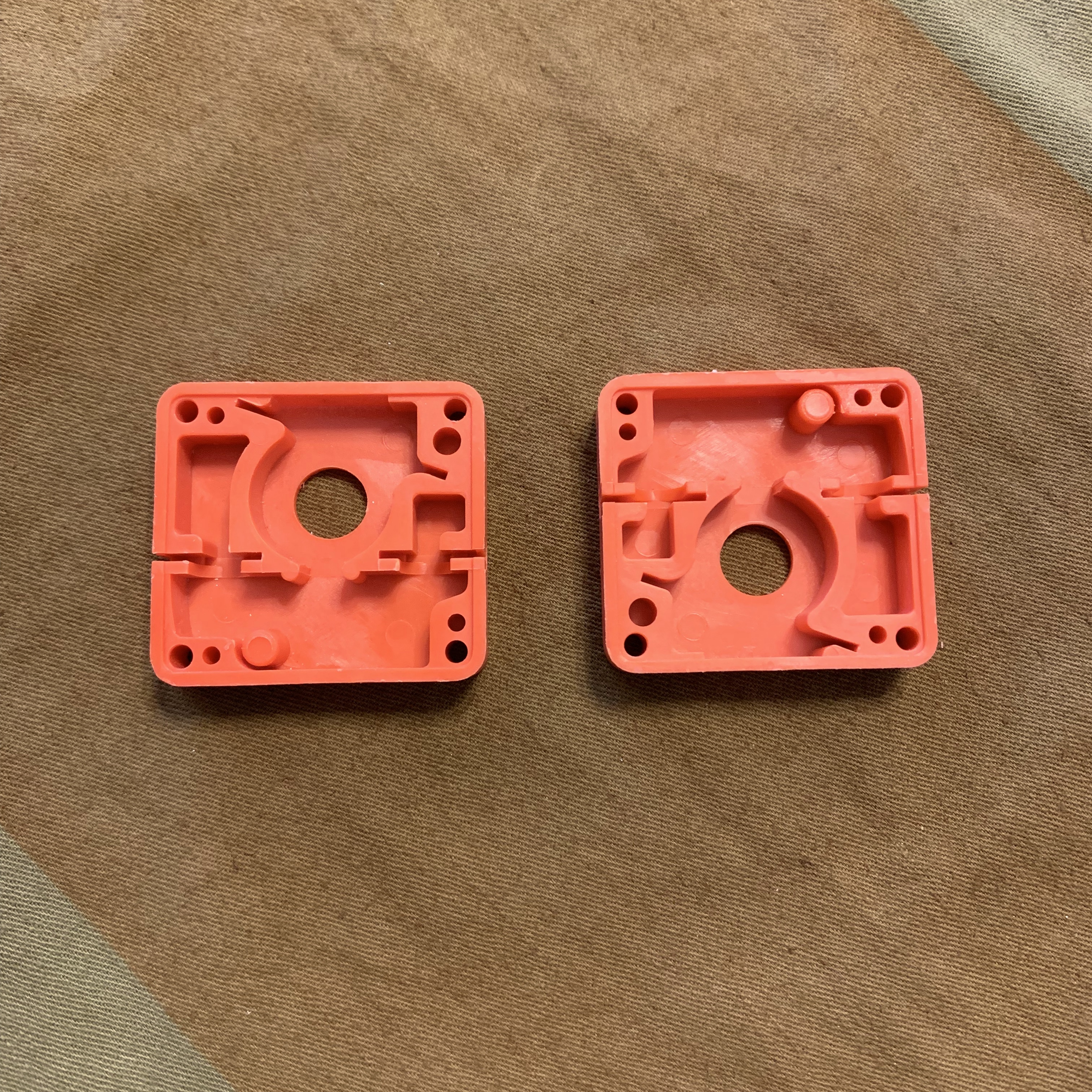

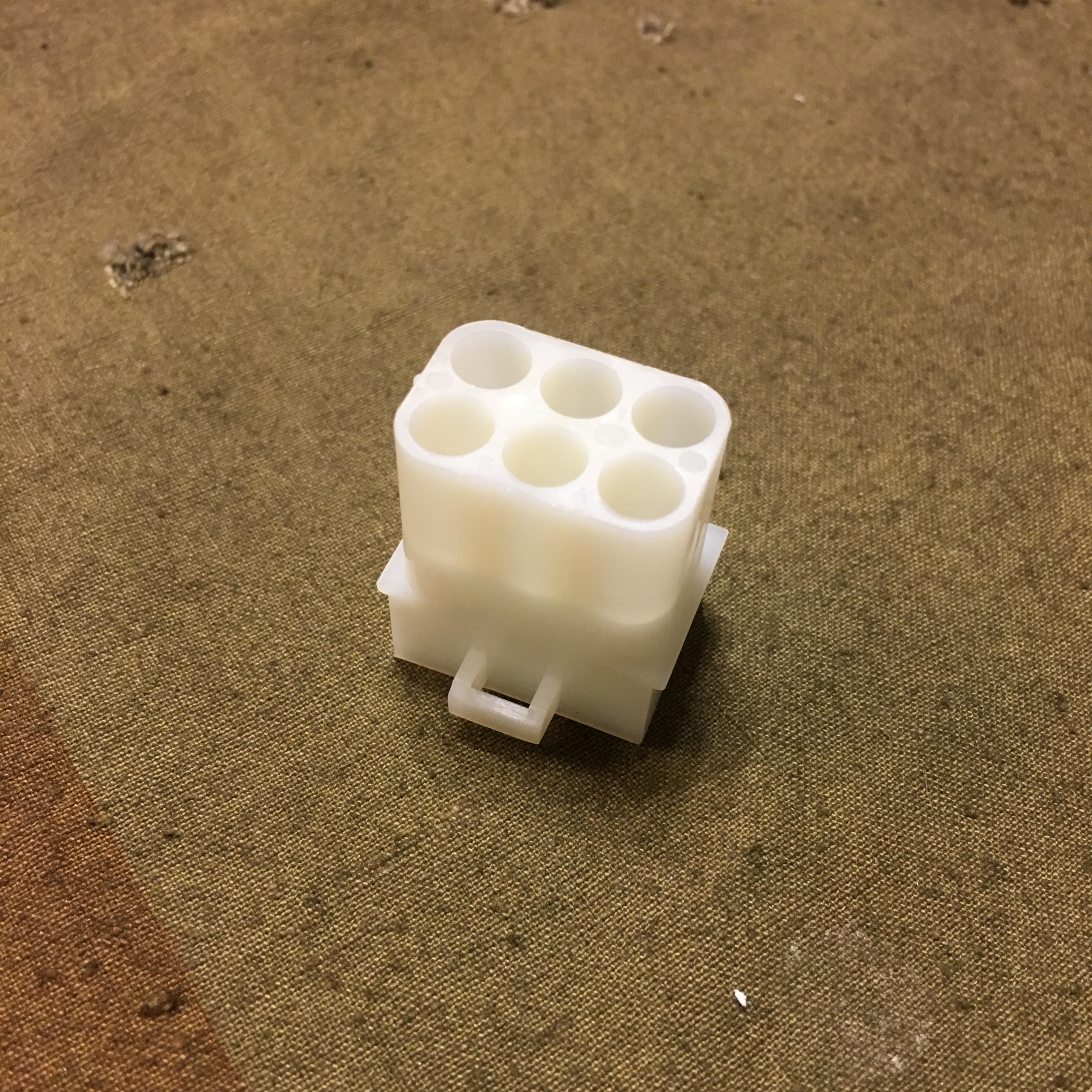

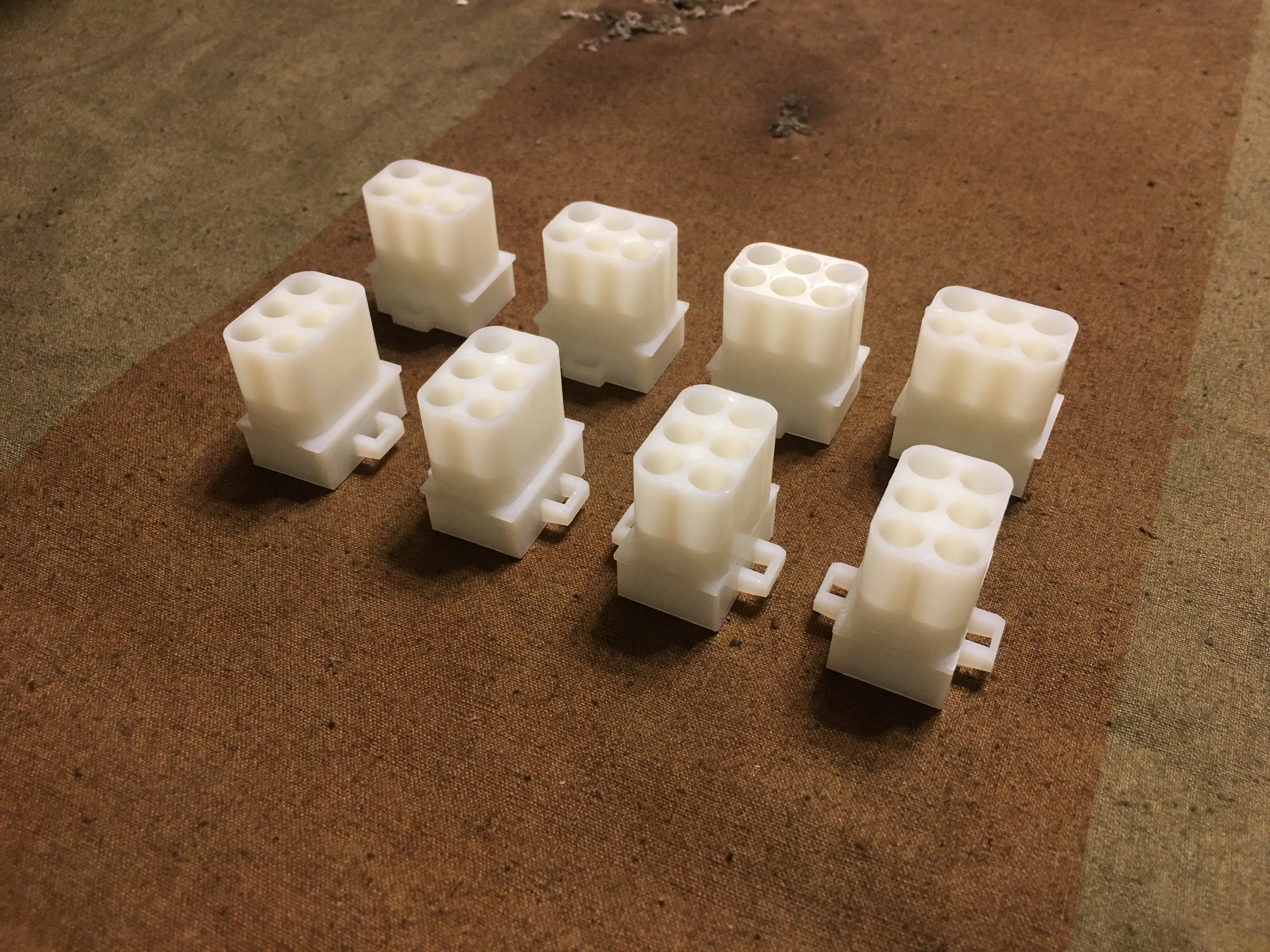

I'm still not entirely convinced the Molex Connectors we have access to today are the same model/version as those used in the filming of ESB. If you look at your molex's you'll see a line of 4 small circular markings in between the 6 hole pattern on the front face. Looking at any clear shot of the molex's in the film, you'll see that the two center ones of these appear to be actual holes (likely for locating/grounding pins of some kind) rather than filled in casting markings like on the new ones. I ended up drilling these two holes out on all the molex's on my build until I can find some more original ones
I thought that was common knowledge about the holes in the middle of the Molex connectors?
Of course, I left that detail out on my printed blaster. I do have a set of real Molex connectors, though, and they WILL get the holes drilled!
Nice!
Do we have any images of an actual molex manufactured with those small holes?
Not as of yet. It would be interesting to find what these connectors actually went to that they salvaged them from so to see what vintage ones actually look like. I tend to lean more towards the mindset of this being a manufactured feature rather than something added in by the film makers later on, but who honestly knows haha.

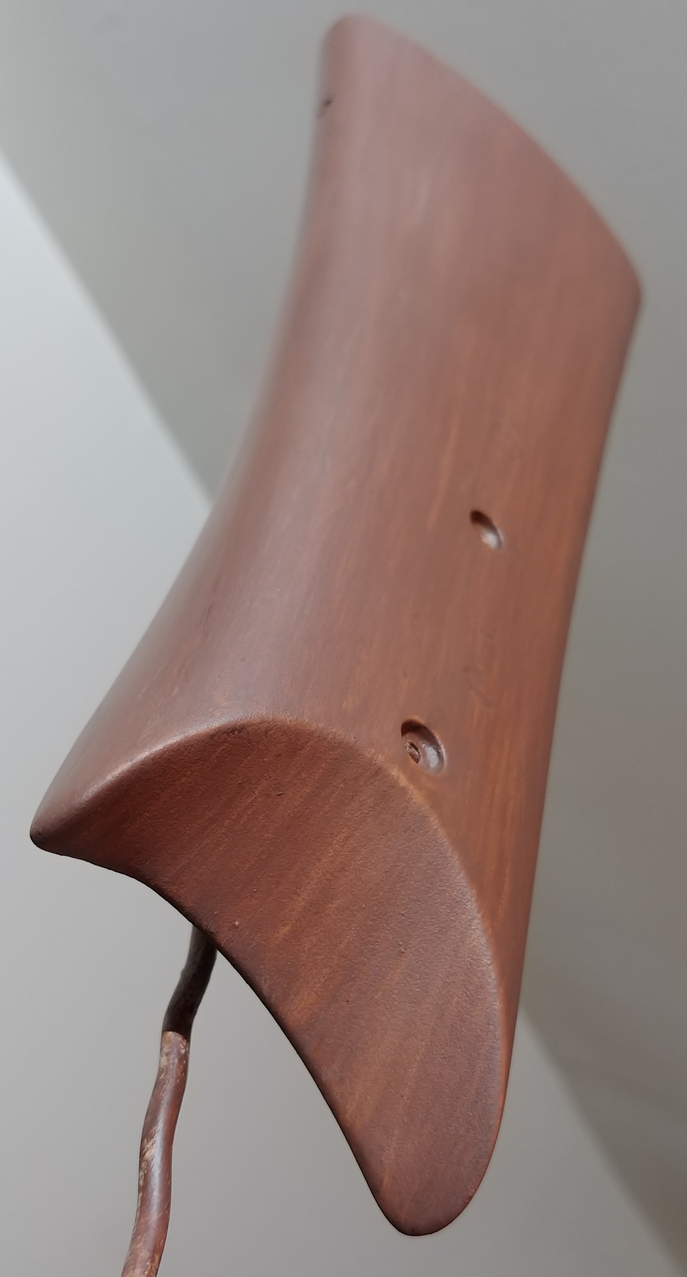

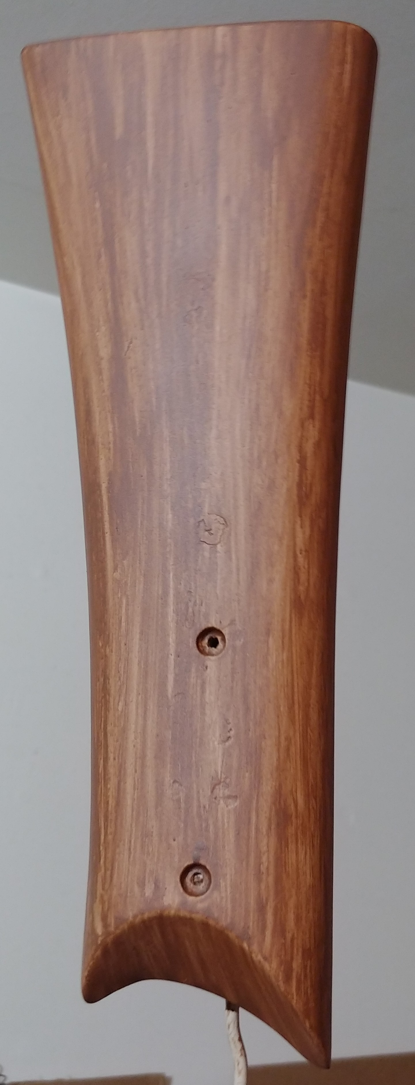

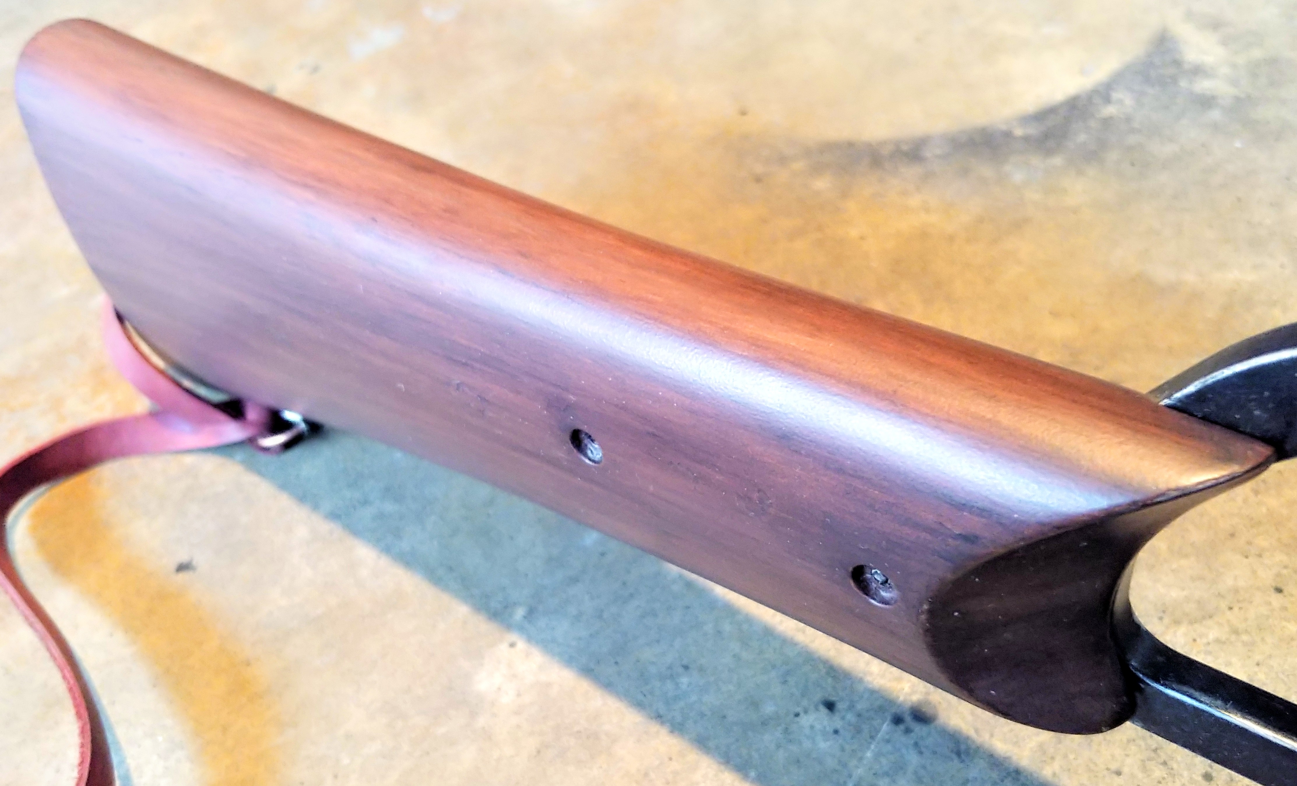

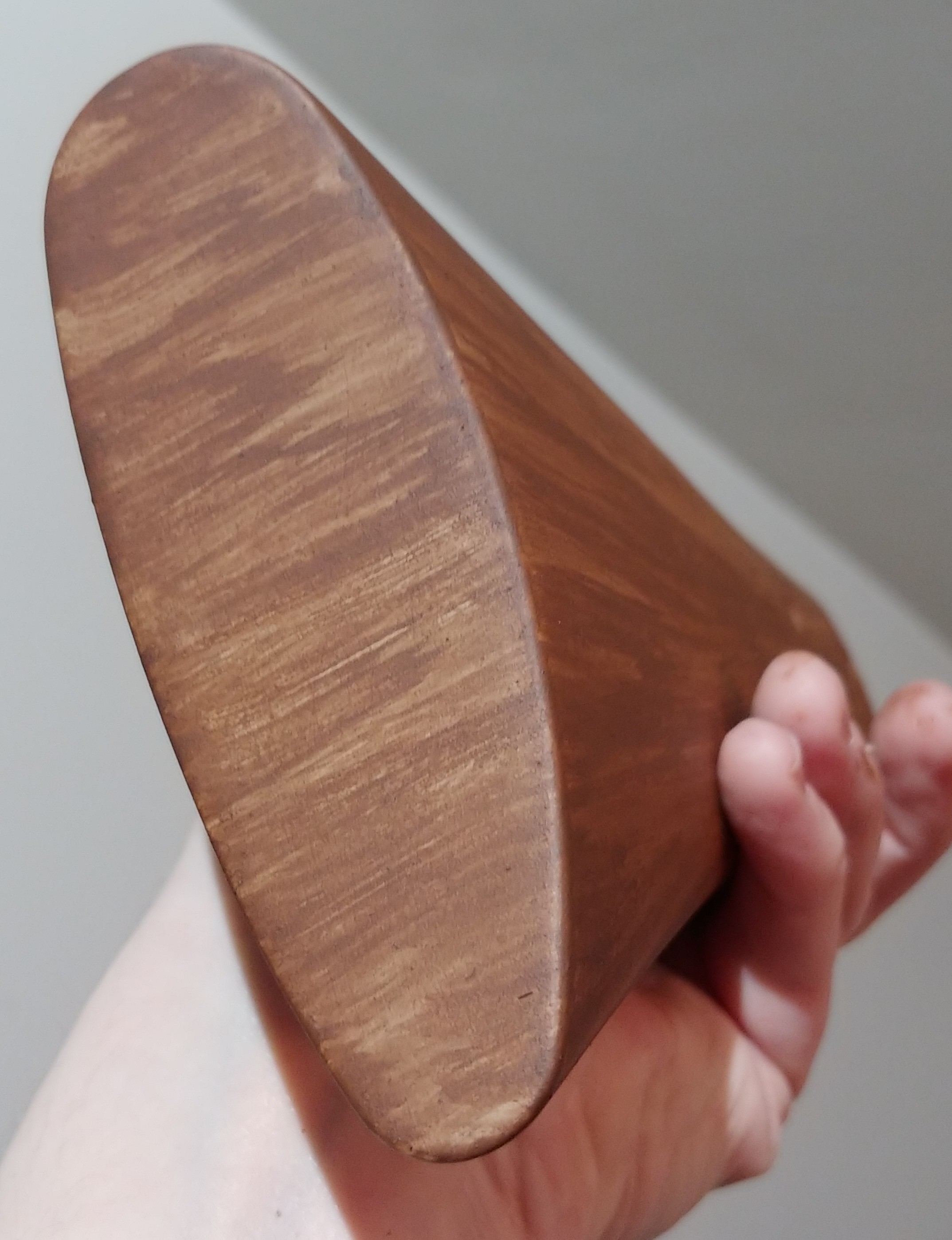

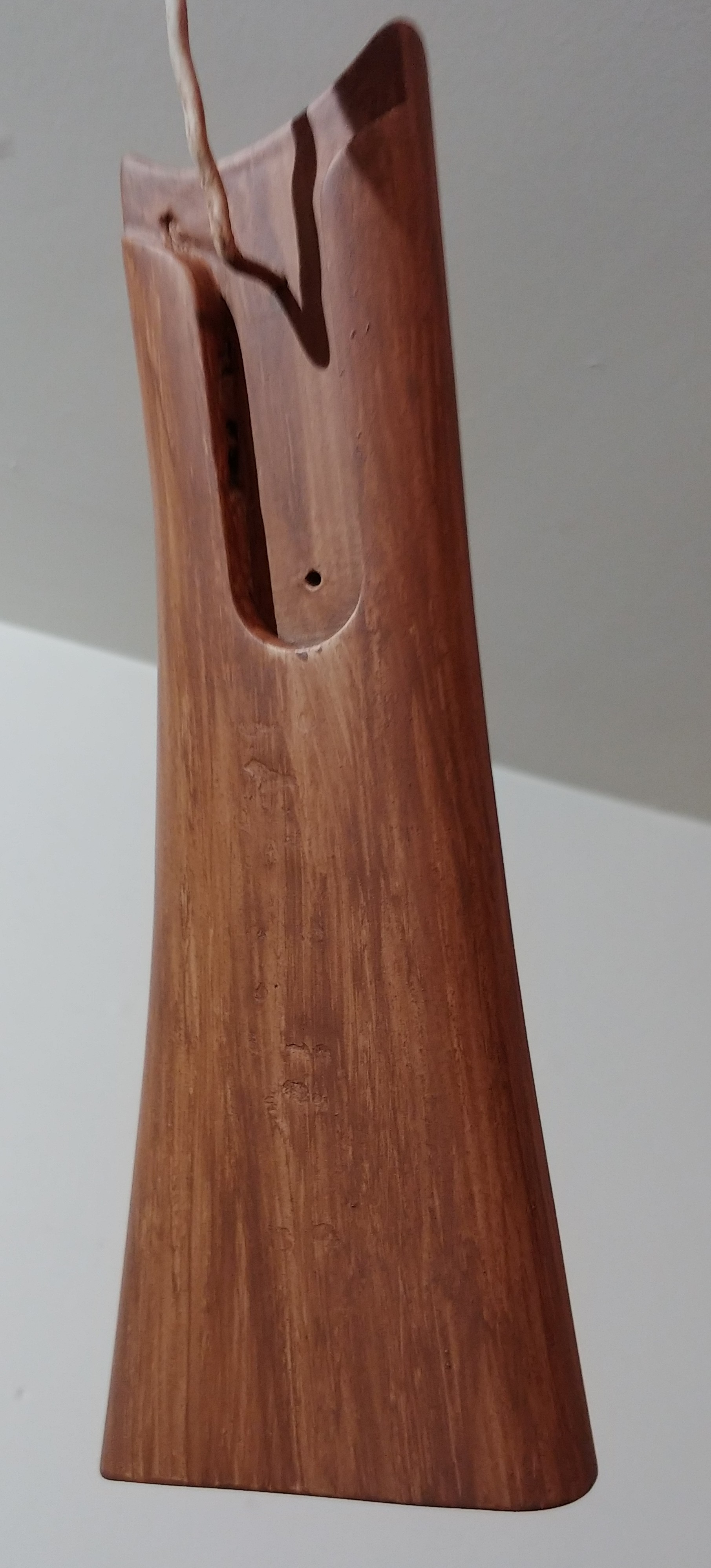

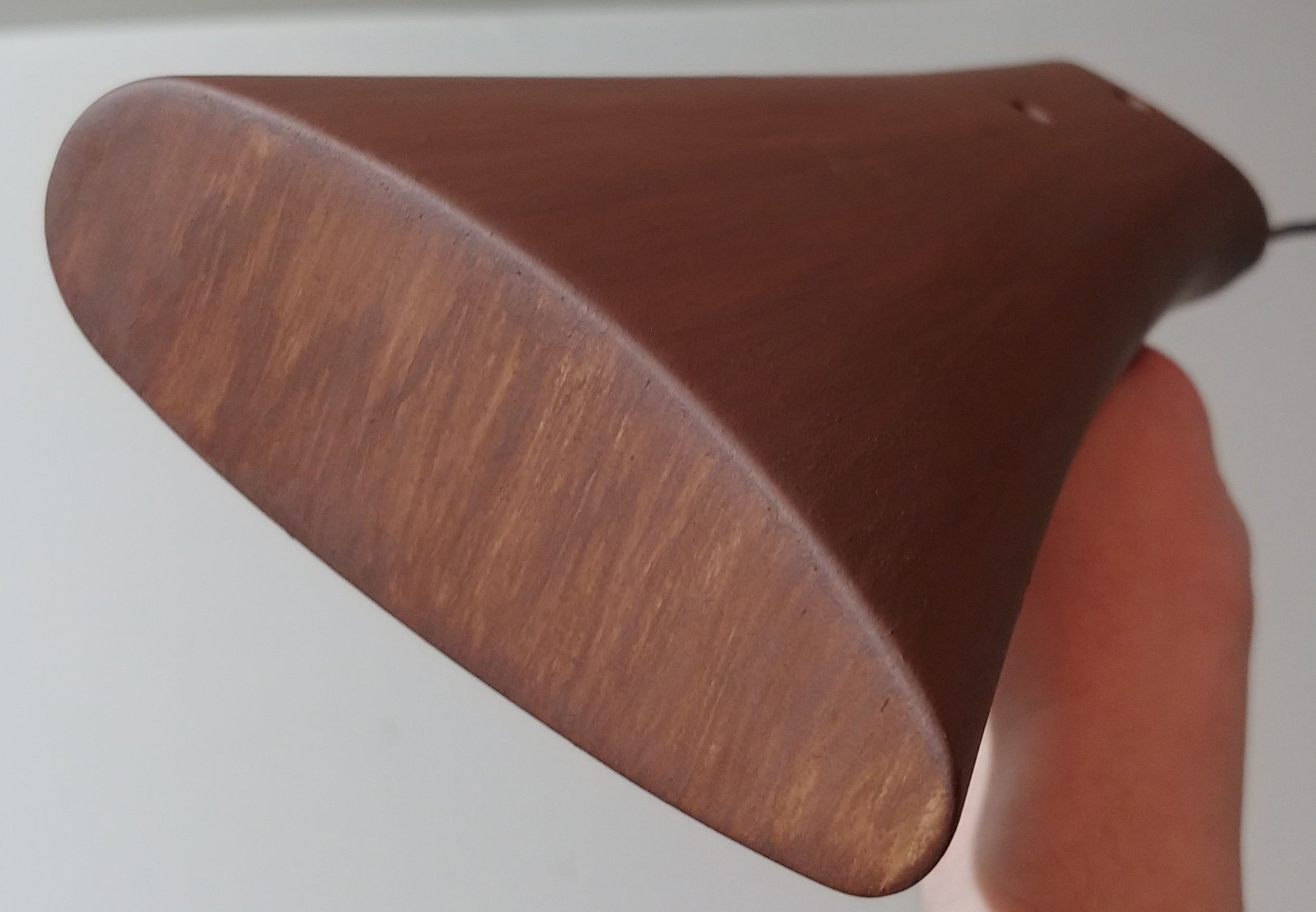

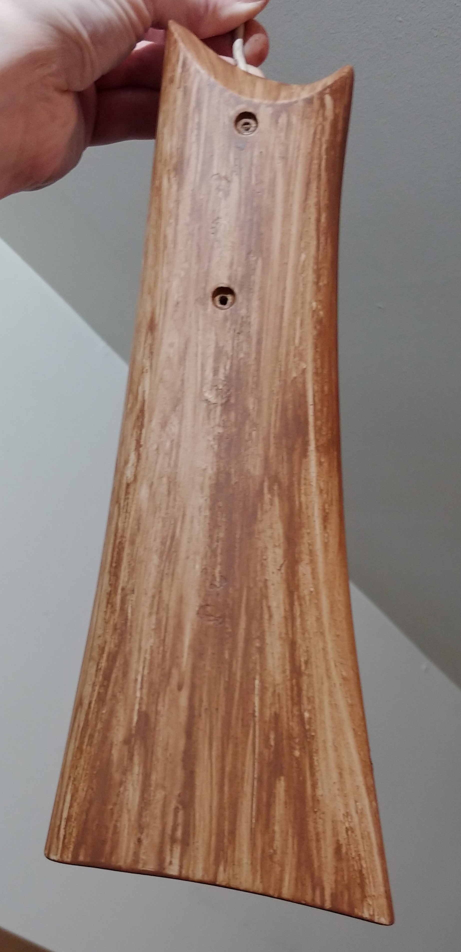

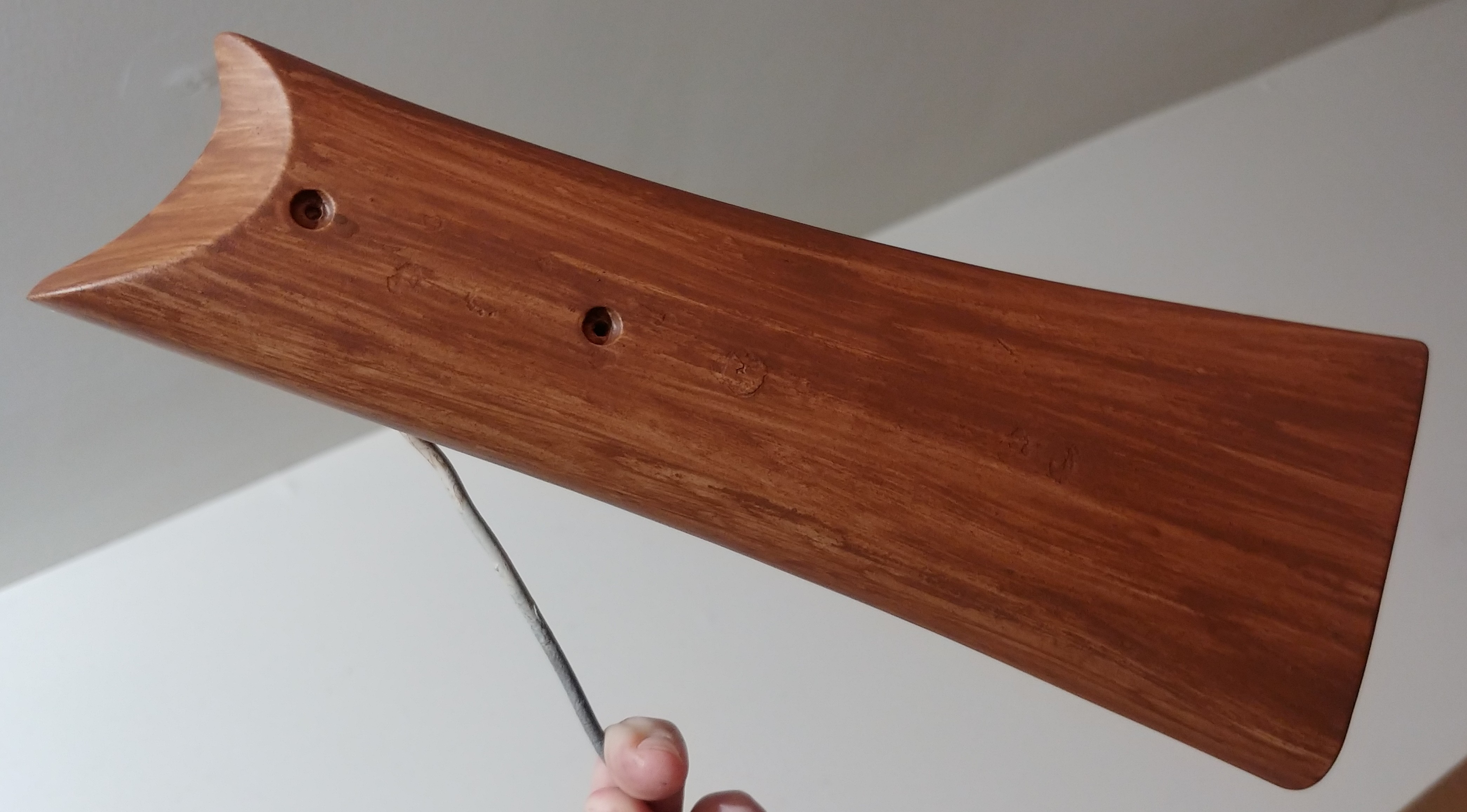

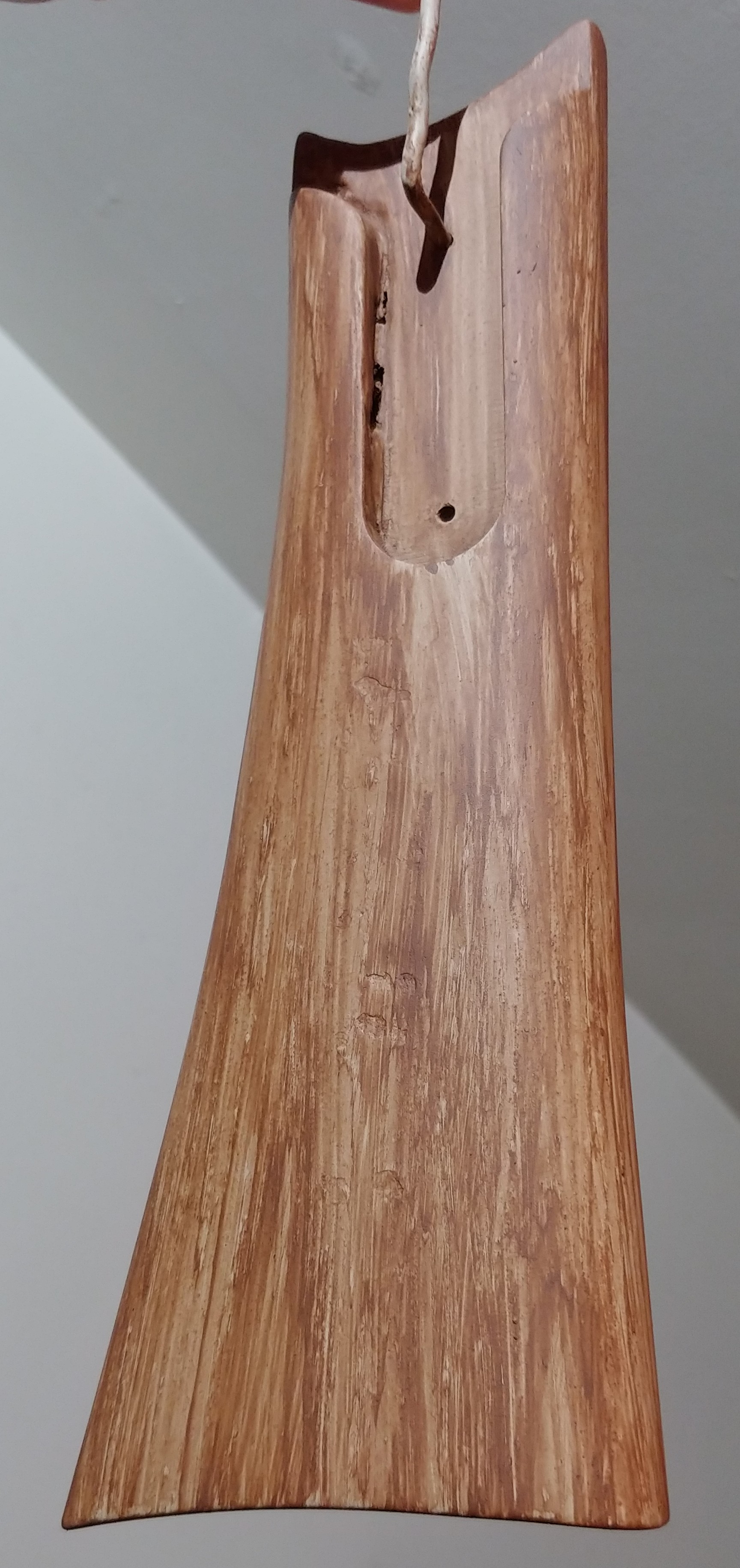

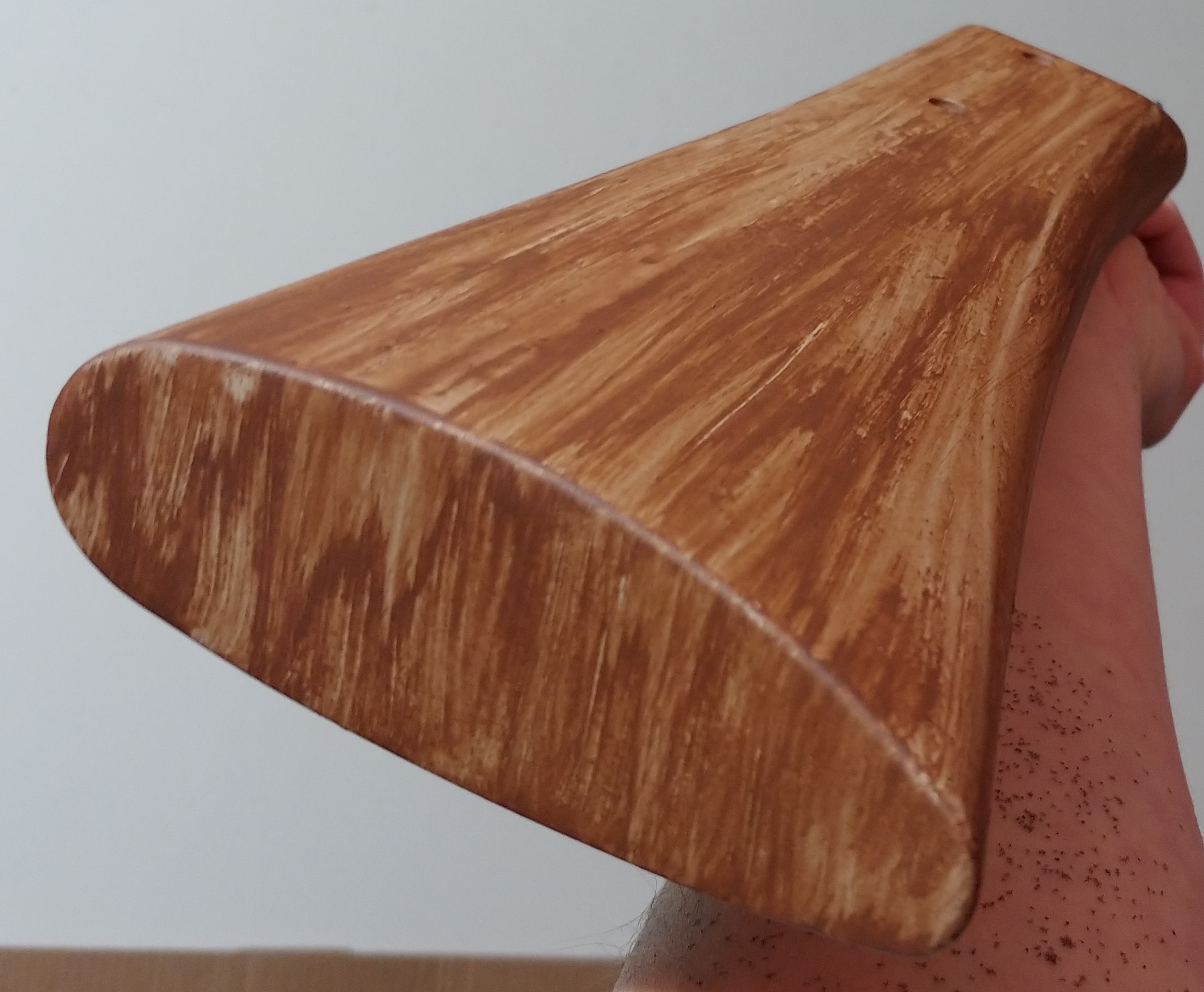

Here's the progression of this last attempt at painting my printed stock. Sorry for all the pics, I should probably put these in my thread, but you asked for pics, so I'll put them here. ;)
I believe that's 3 passes with various brown washes, and a touch of some highlights at the very end.
It may have been fine after that second pass, though. I just don't know when to stop, it seems!!

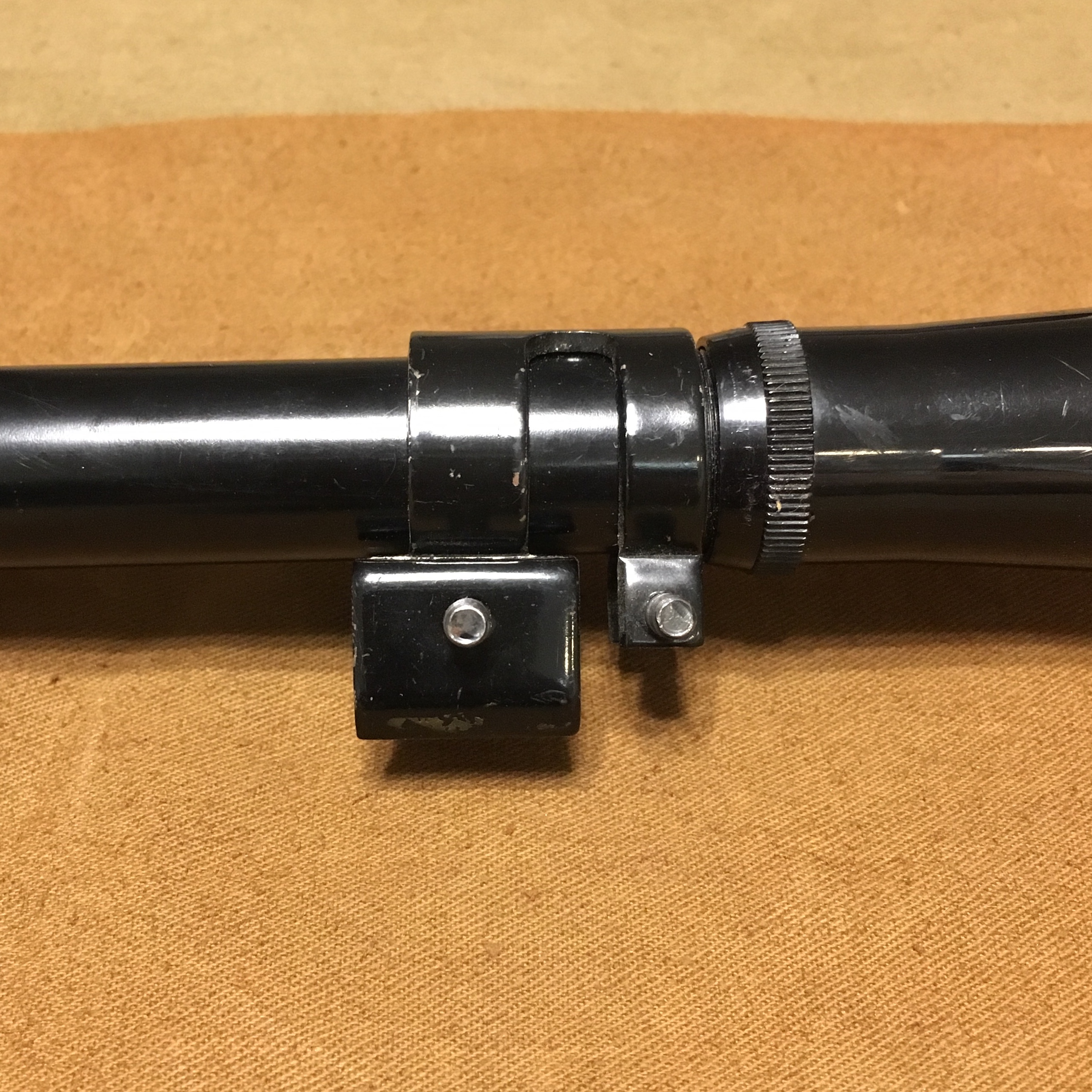

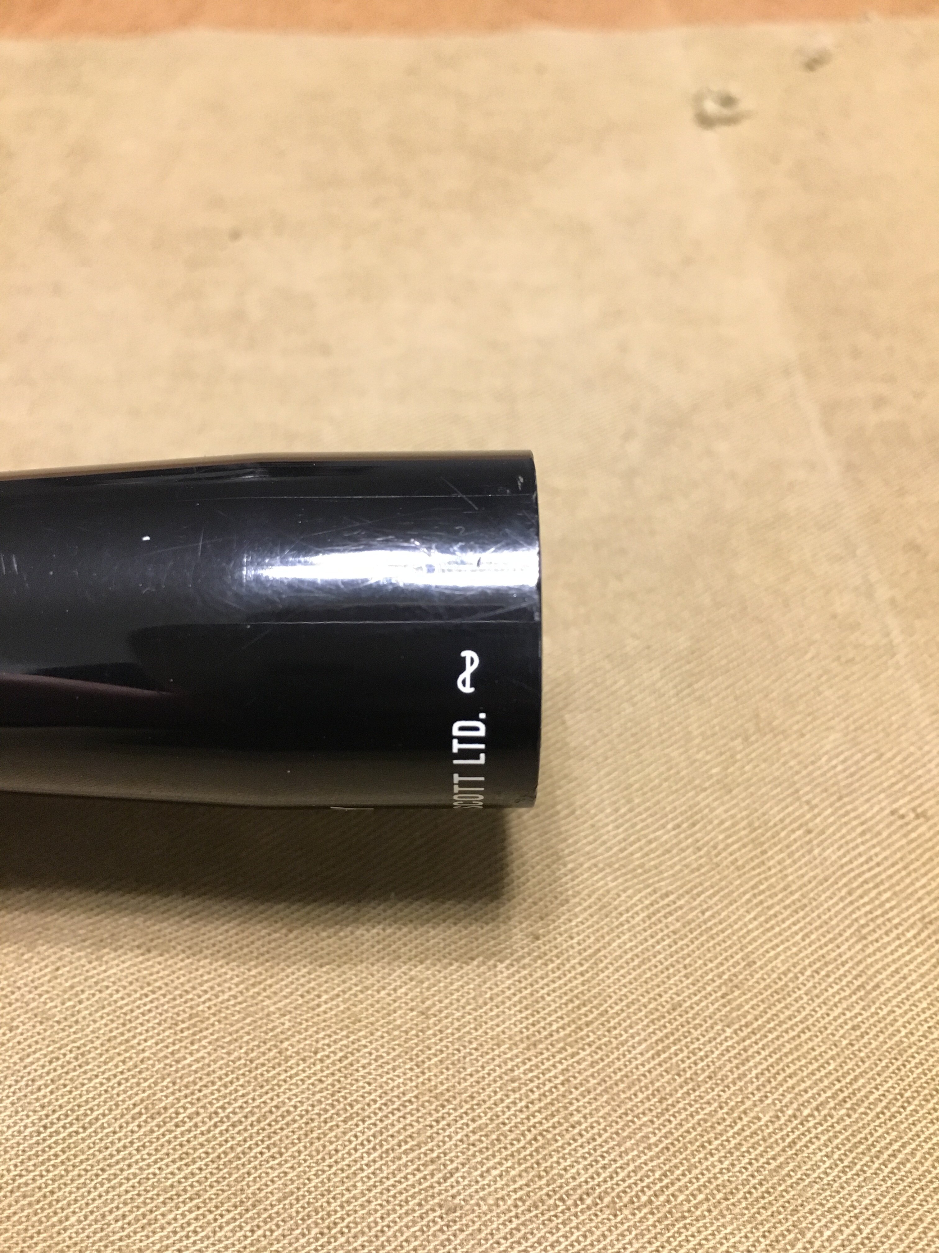

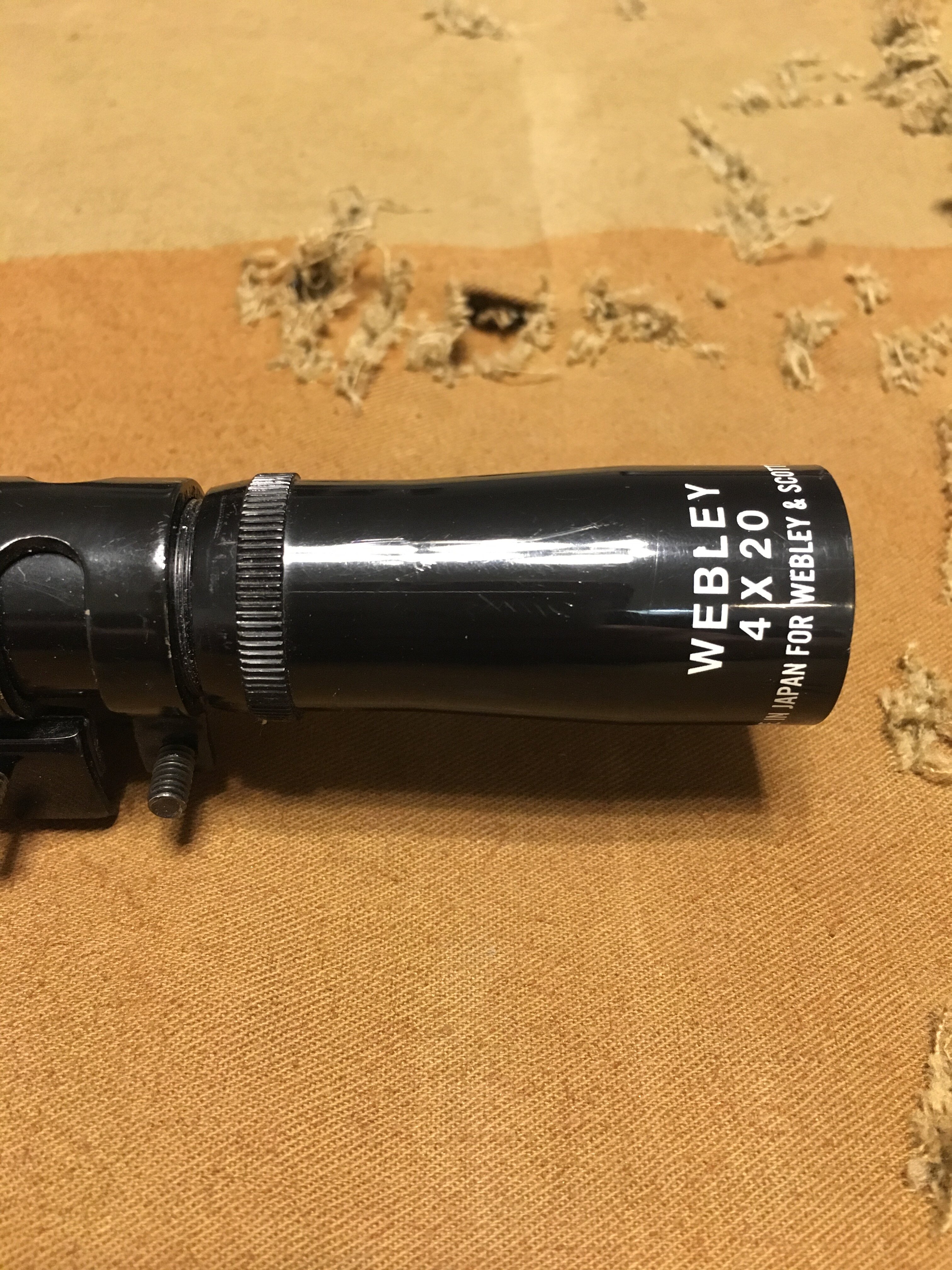

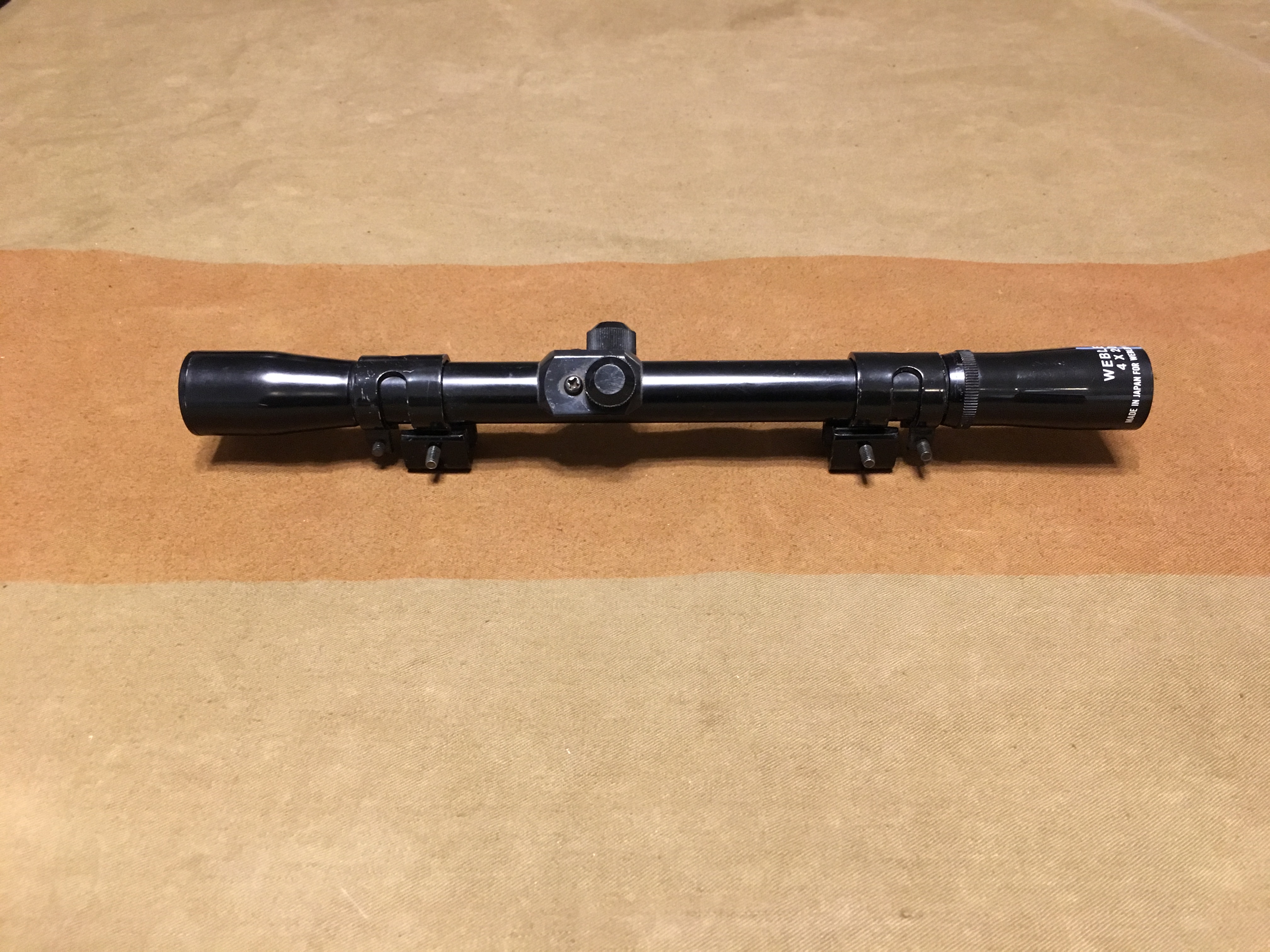

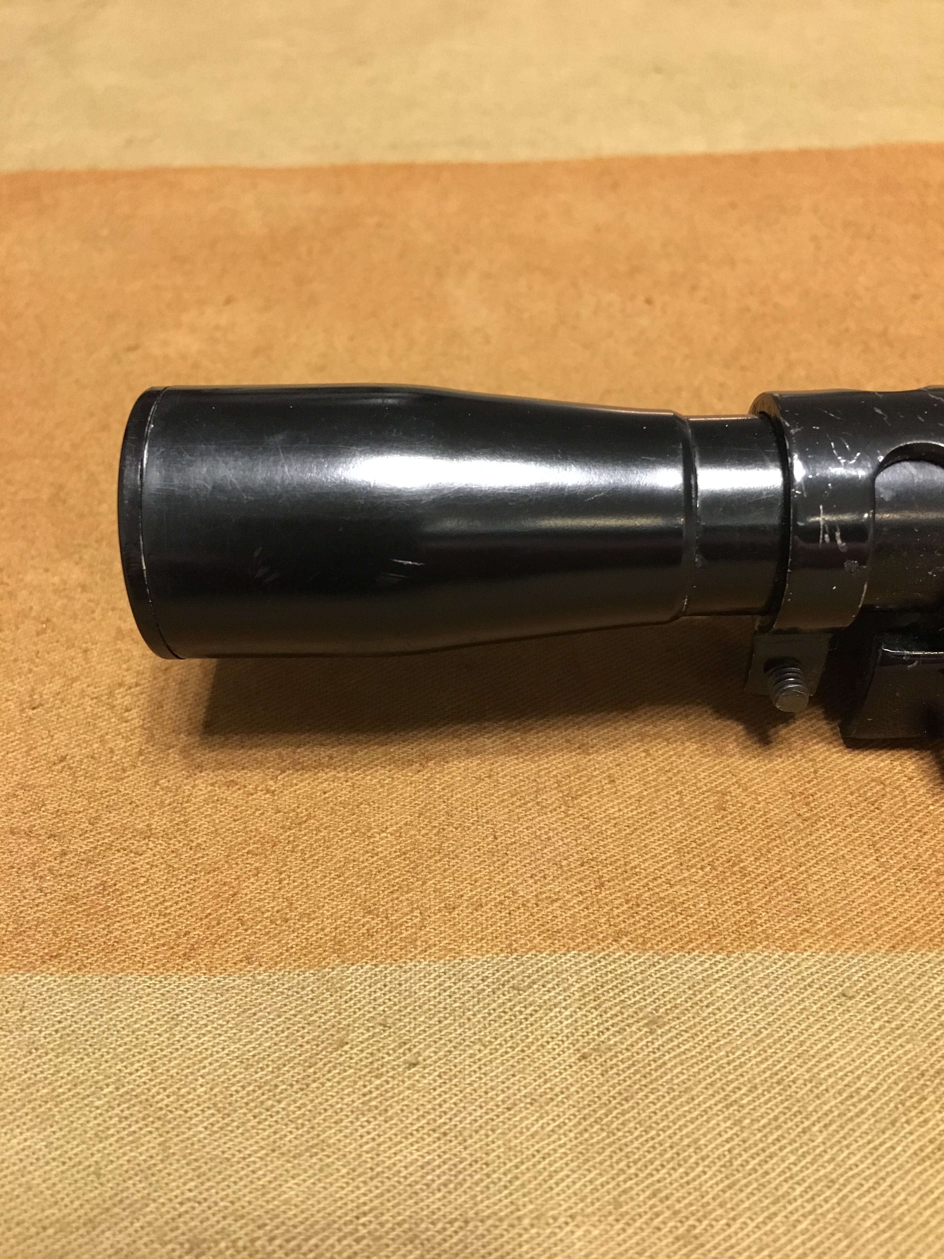

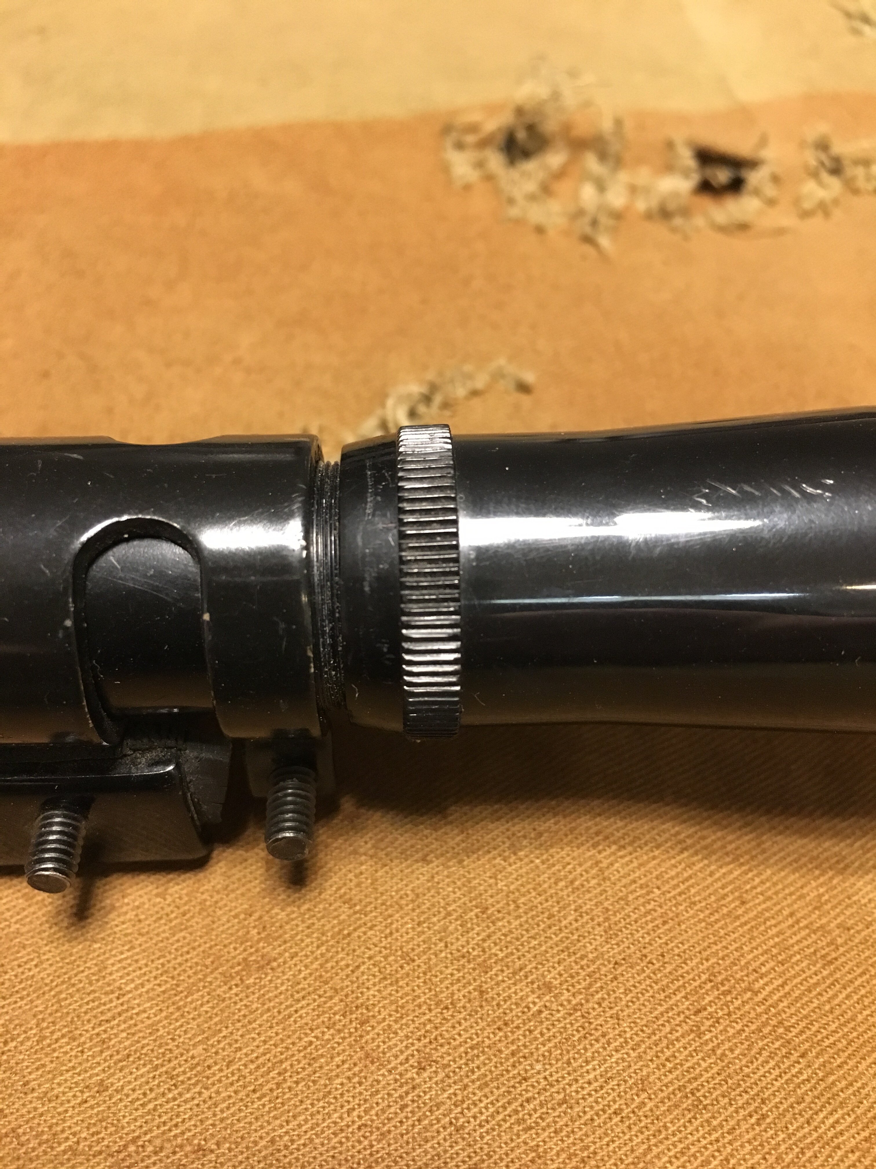

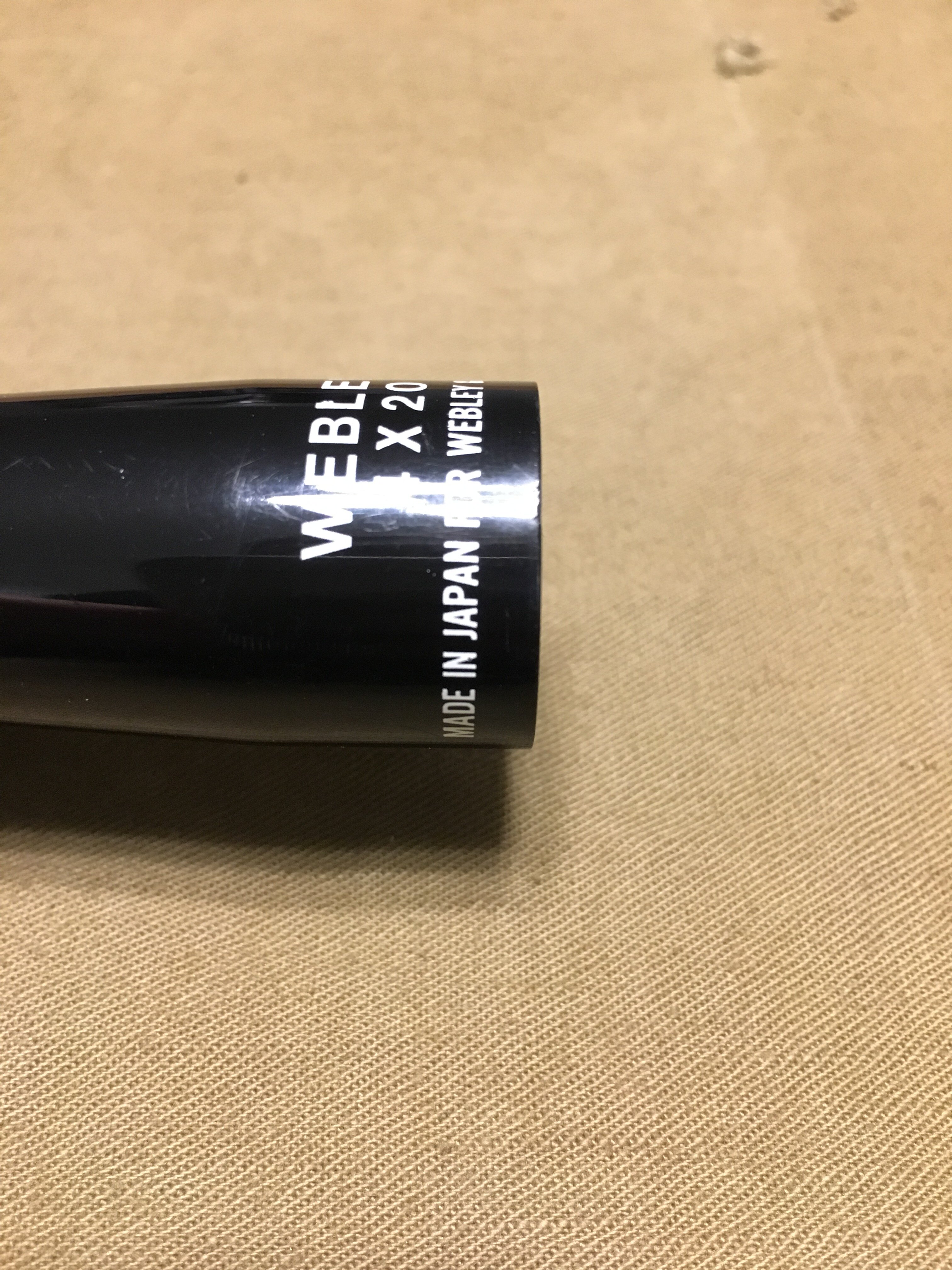

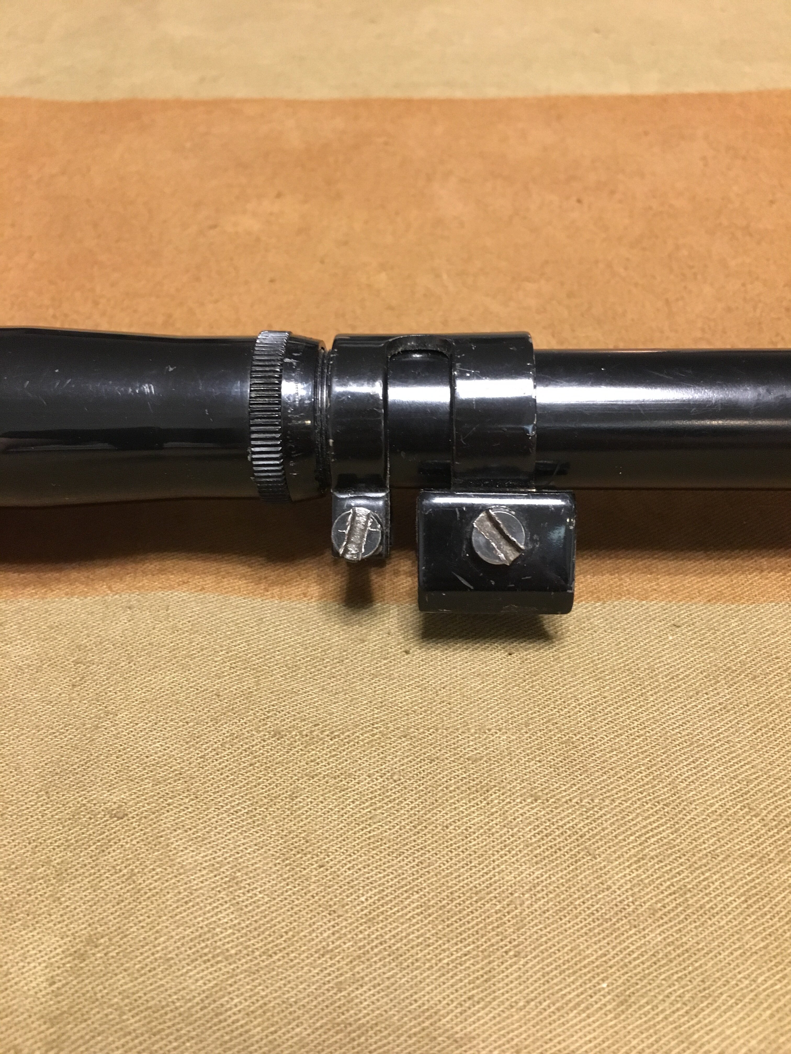

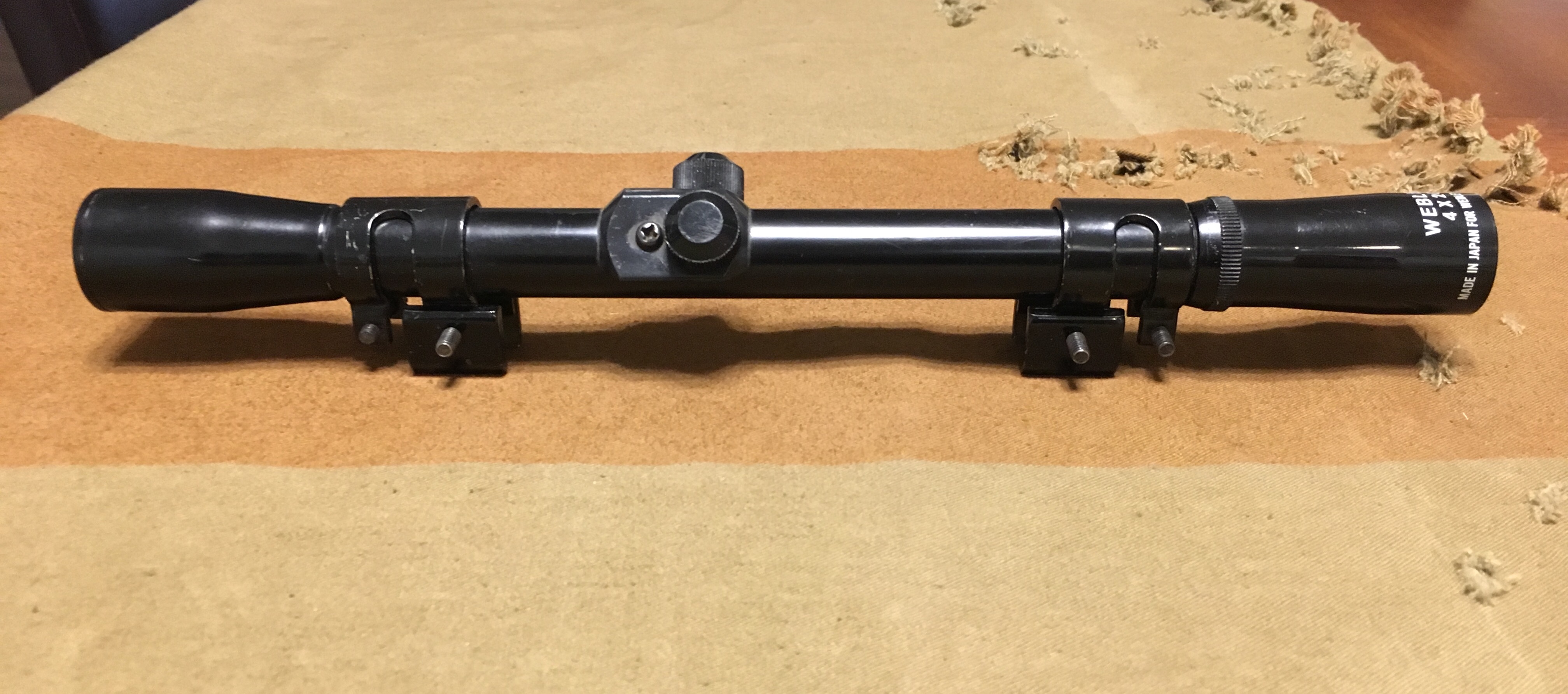

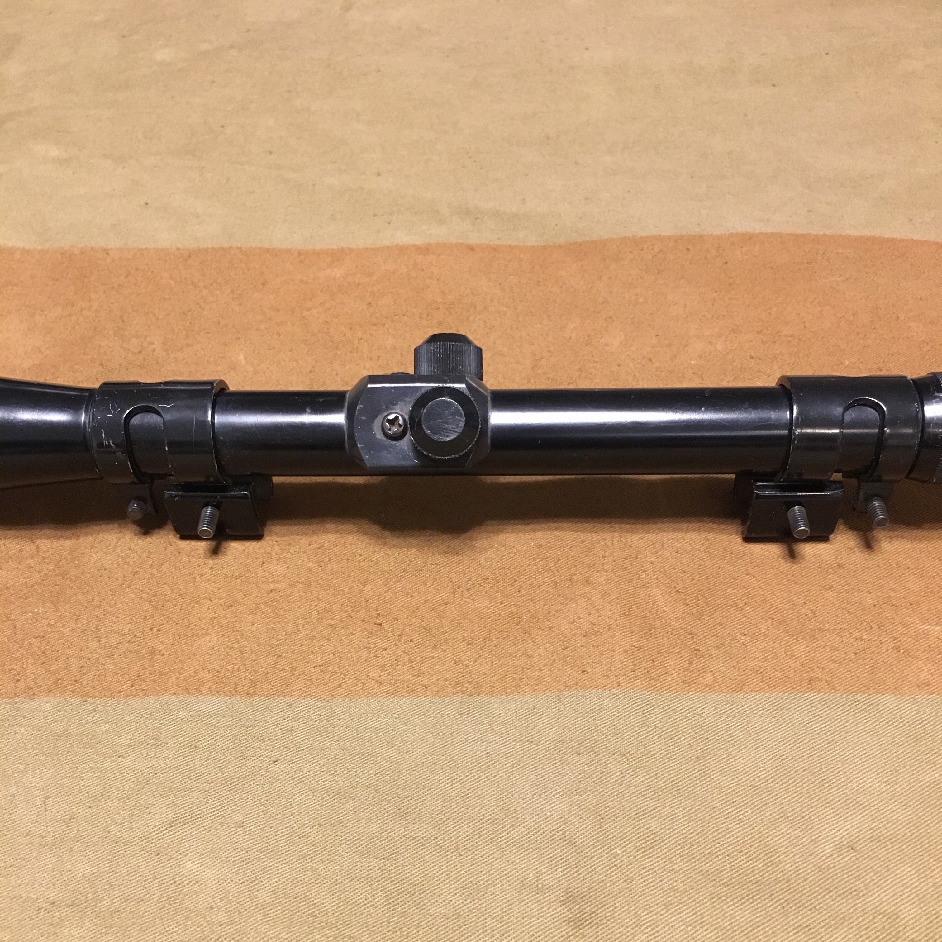

Recently got this found part 4x20 scope with accurate tall feet Hero scope mounts. Call me a sucker for brand matching but I love the idea of having an accurate found part Webley & Scott no.1 mkI with an accurate found part Webley and Scott 4x20 scope to sit on top. Keep in mind there are many brands of 4x20 scopes that fit all the identifiers of the screen used scope. I’m just glad webley made one too
Important identifiers:
Plastic eyepiece
Made in Japan
Infinity sign
Correct retaining ring
Correct optical bell with bevel lip
Windage adjustments about 2/3rds offset behind the eyepiece
Tall Fett Hero scope mounts

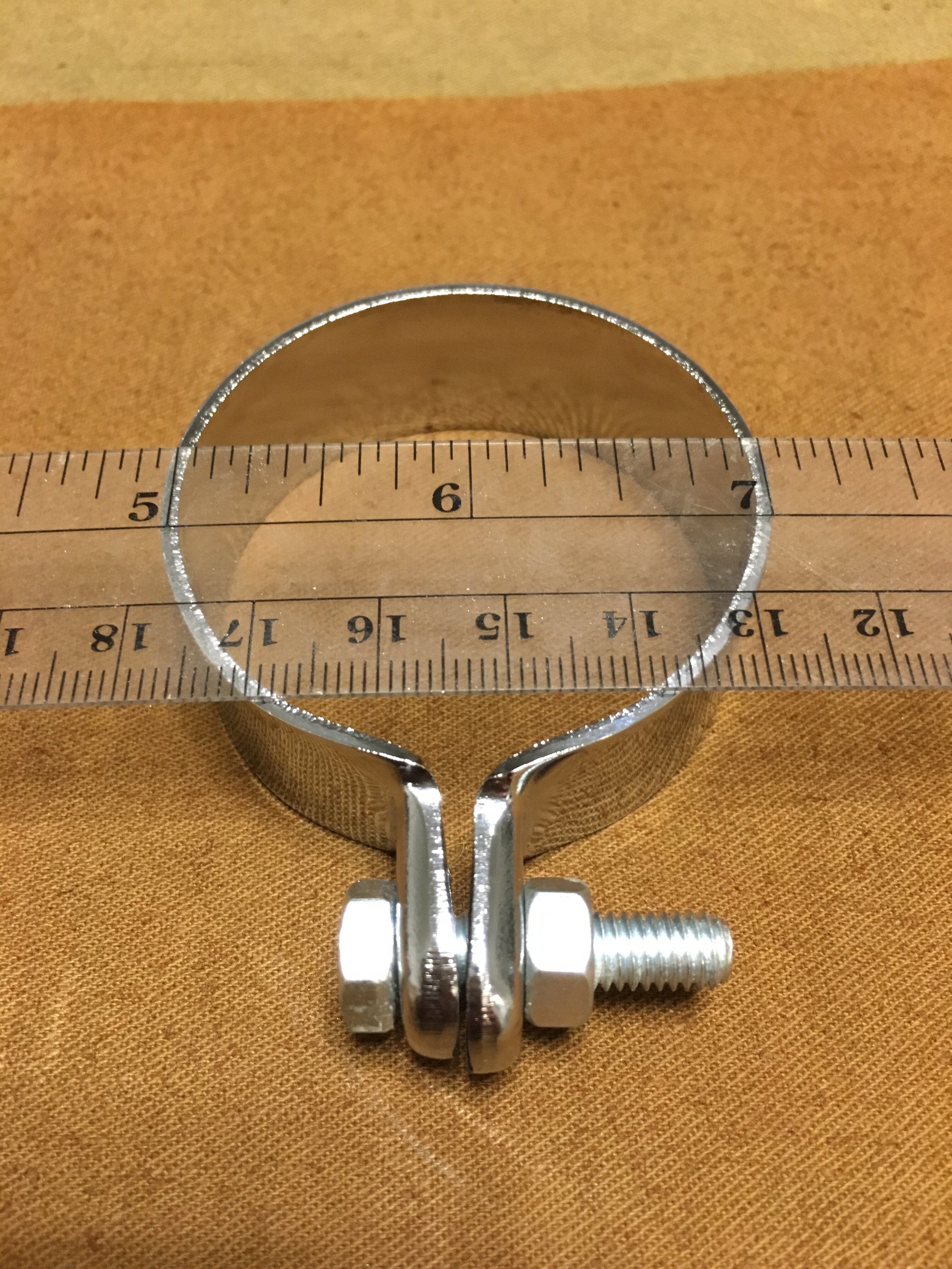

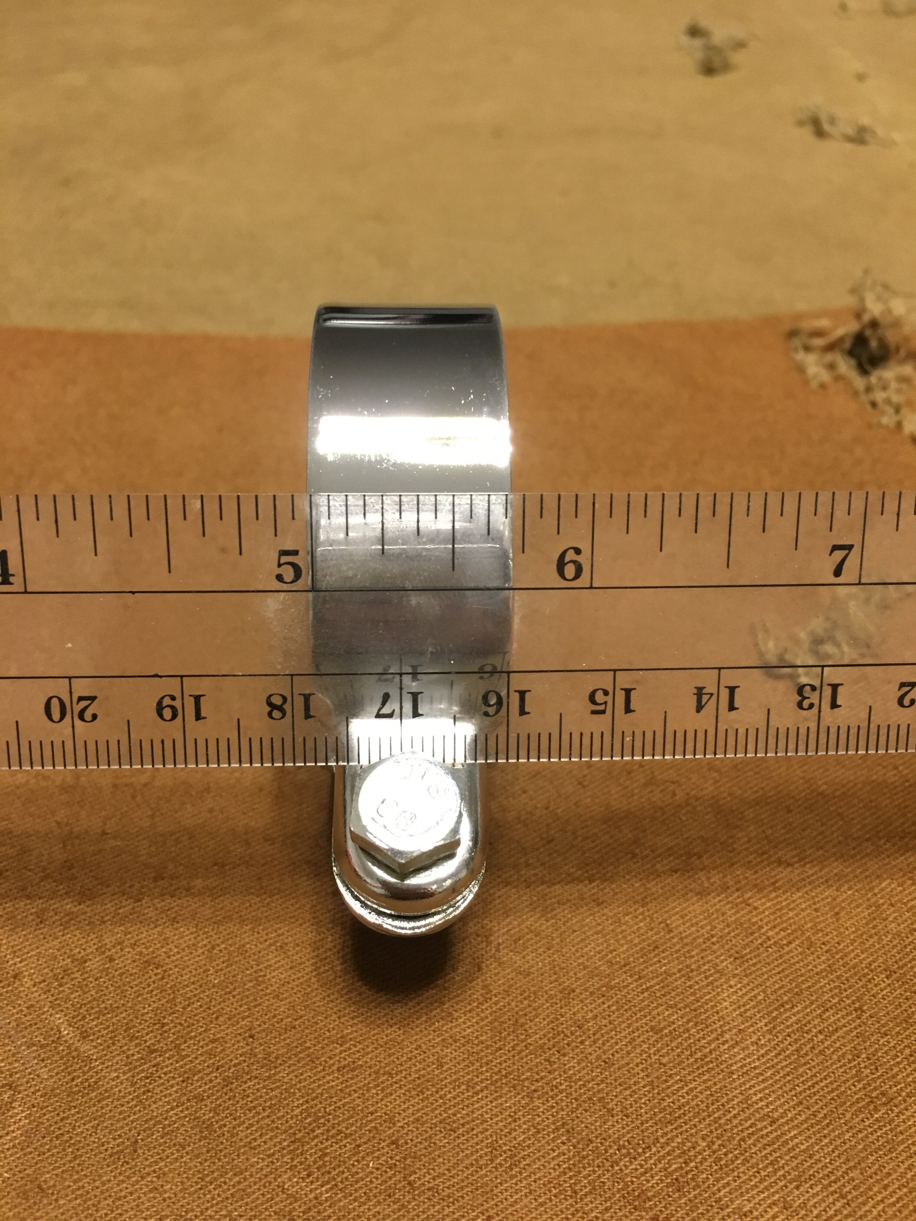

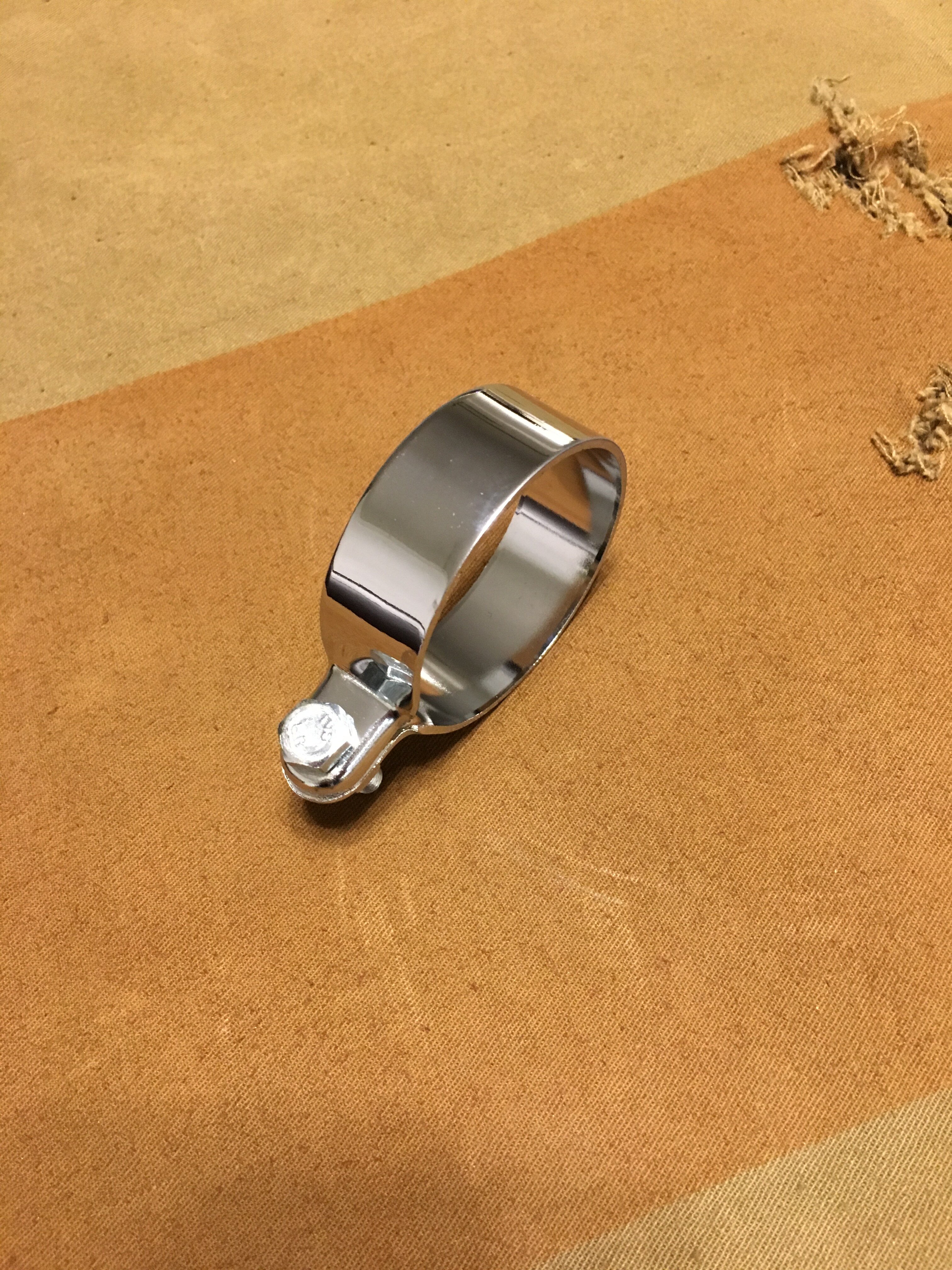

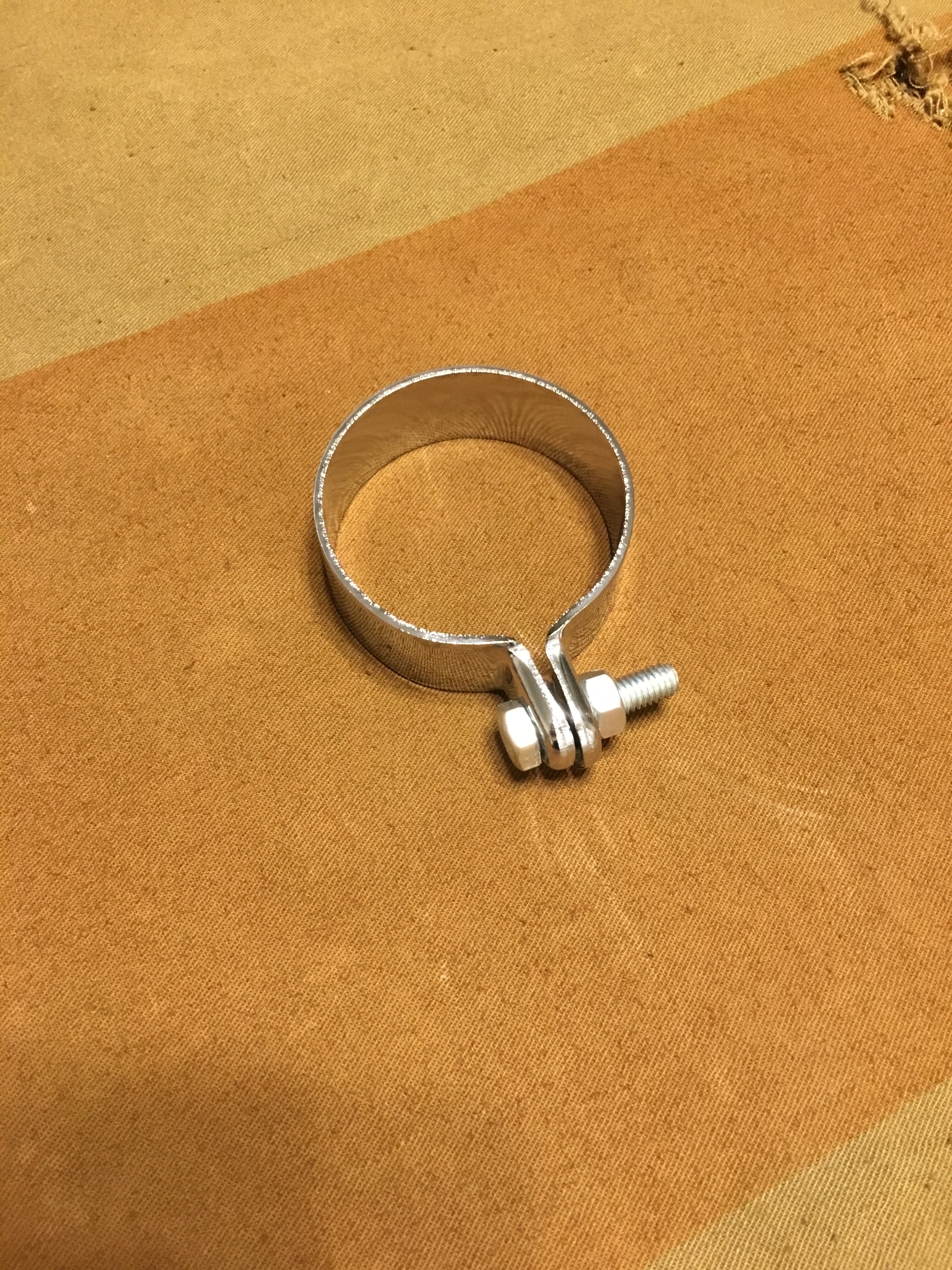

Not necessarily a found part yet since I don’t believe it has been 100% identified but this piece comes very close to what we see in reference photos as the pipe clamp that goes on the back barrel mount. I think it’s the best actual clamp without modification that I’ve seen yet. I don’t believe I will have to grind it down to fit inside the barrel mount but we’ll see when I get those.
ID can be less than 2 inches which fits perfectly towards the back end of the webley barrel
Width is just under 3/4 of an inch or approximately 11/16 of an inch
Yeah Marv just shot me one of those to try and modify my mounts to fit as well, and everything was going swell until I realized the width was 11/16th (about 17.5mm). For a second I thought it'd be as simple as extending the width of the clip because its not that big a difference, but then I remembered that the width of the clips is limited by the Molex Connectors to something around 16-16.5mm in order for them to just slightly extend beyond the front of the clips while the back of the Molex's act like a Stop on the back of the clip, as seen on the Hero blaster. So one would have to trim at least a mm off the pipe clamp in order for it to hide underneath the clip. The bottom tang on this one also extends a lot further below the built in one on my current version of the rear clip which is set at the estimated length of the Heros
There's a lot of weird stuff going on with that rear barrel clip/clamp and I've never really been able to make complete sense out of it because the math just never really adds up engineering wise. It makes sense to me that it would be a separate internal pipe clamp such as this underneath the rear clip, but the major issue I have with all of the ones we've seen so far is that I don't see any sort of separation line between the clip and would be pipe clamp in any of the reference photos, which means at the very least they would have to be exactly the same width as one another.. And perhaps more importantly the wrap around band on the plastic clip would have to be VERY thin in order for it to both fit one of these pipe clamps underneath it but also not appear overly bulky on the blaster like modern clips do. Almost about the same thickness as one another assuming the pipe clamp band is of a similar thickness to this one, but this would in turn make the plastic clip itself very fragile on its own if they are two wholly separate parts from one another... It's just weird..
Shoot, I was hoping it wasn't as wide as your plastic barrel mount. Well, 1mm isn't too bad but yeah the bulkyness is my main concern. My initial plan was to grind the inside of the barrel mount down as to make a cavity for the clamp to reside in and then use JB weld to fuse them together. I just don't want it to be too bulky.

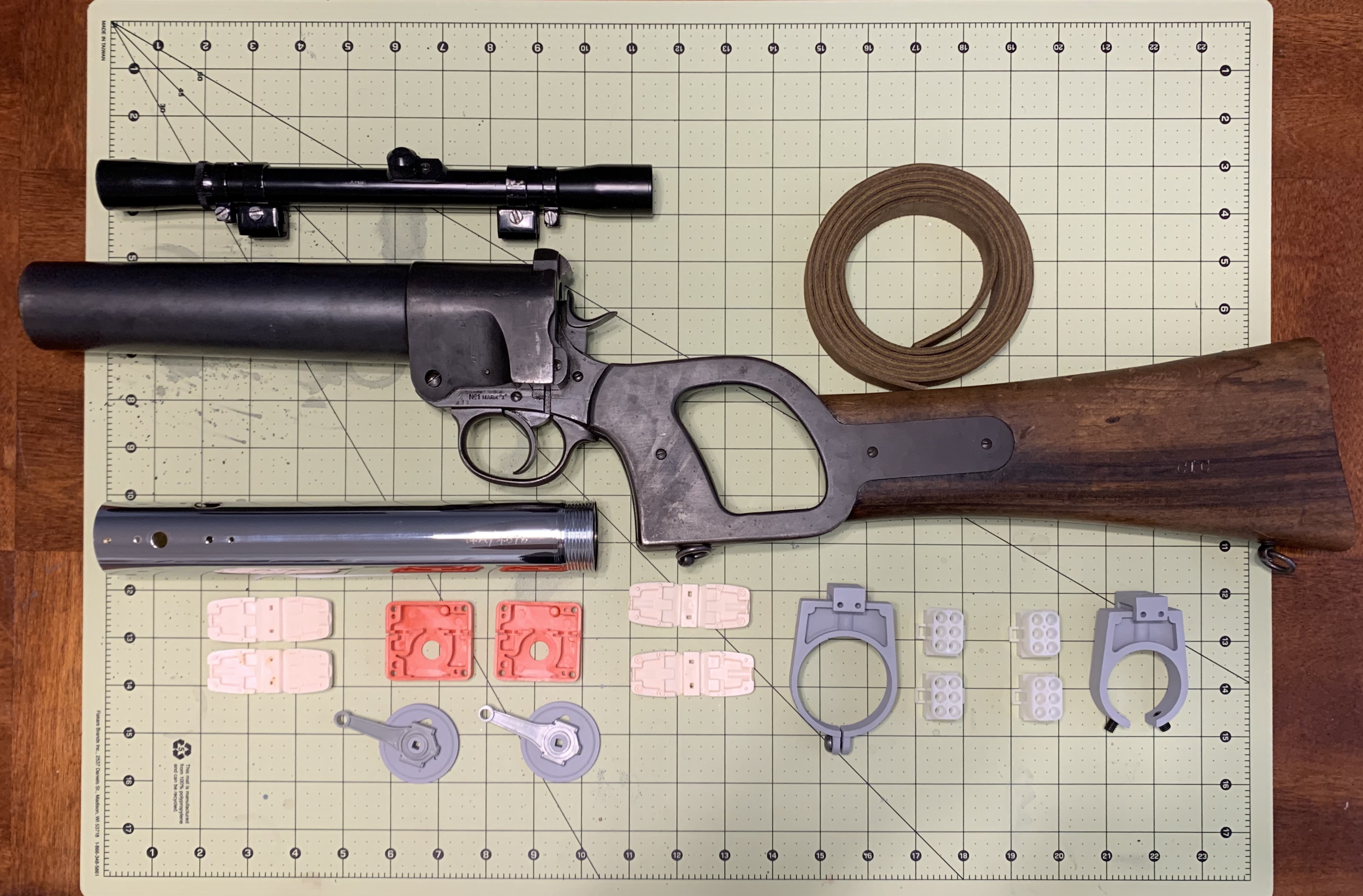

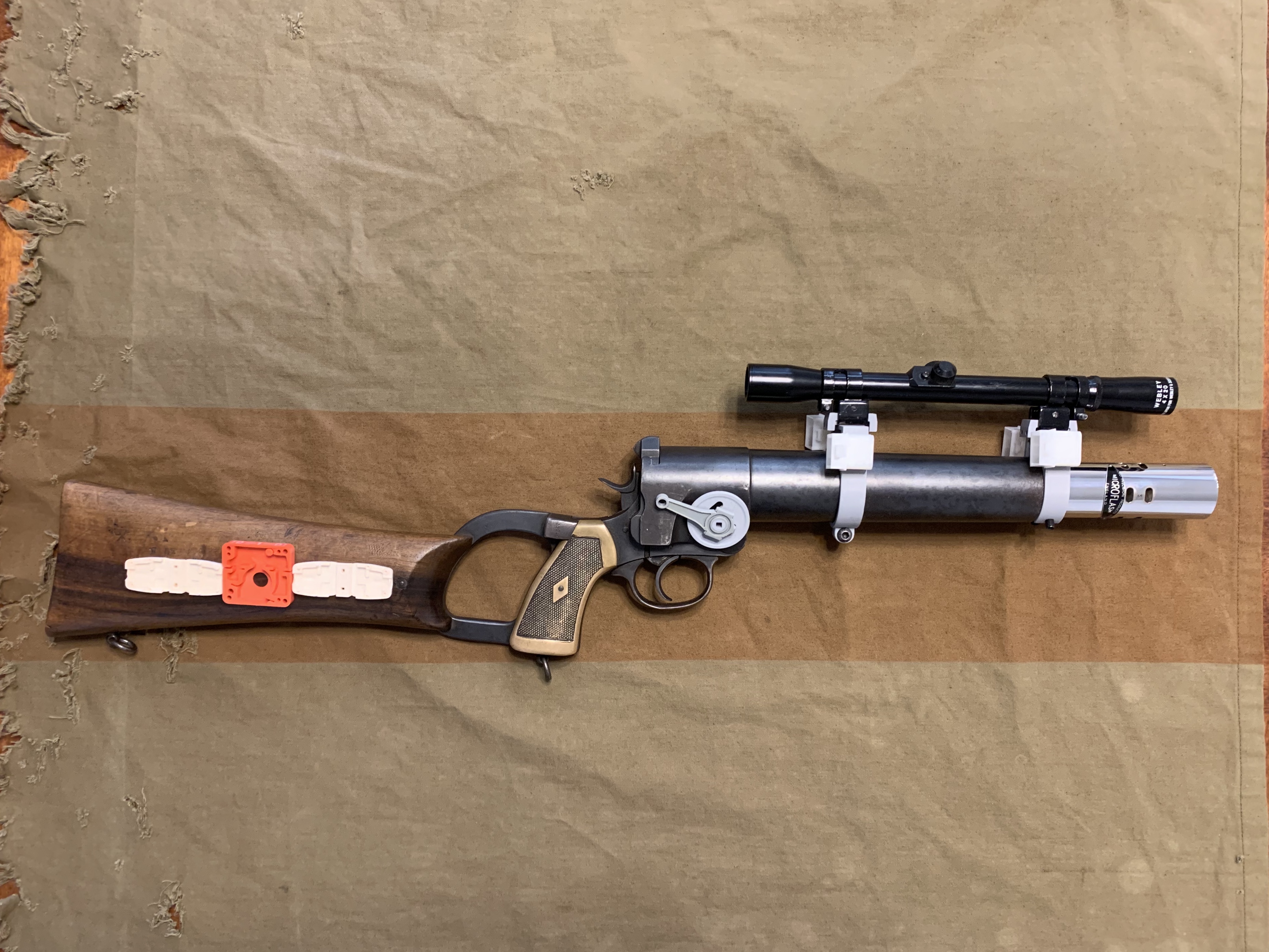

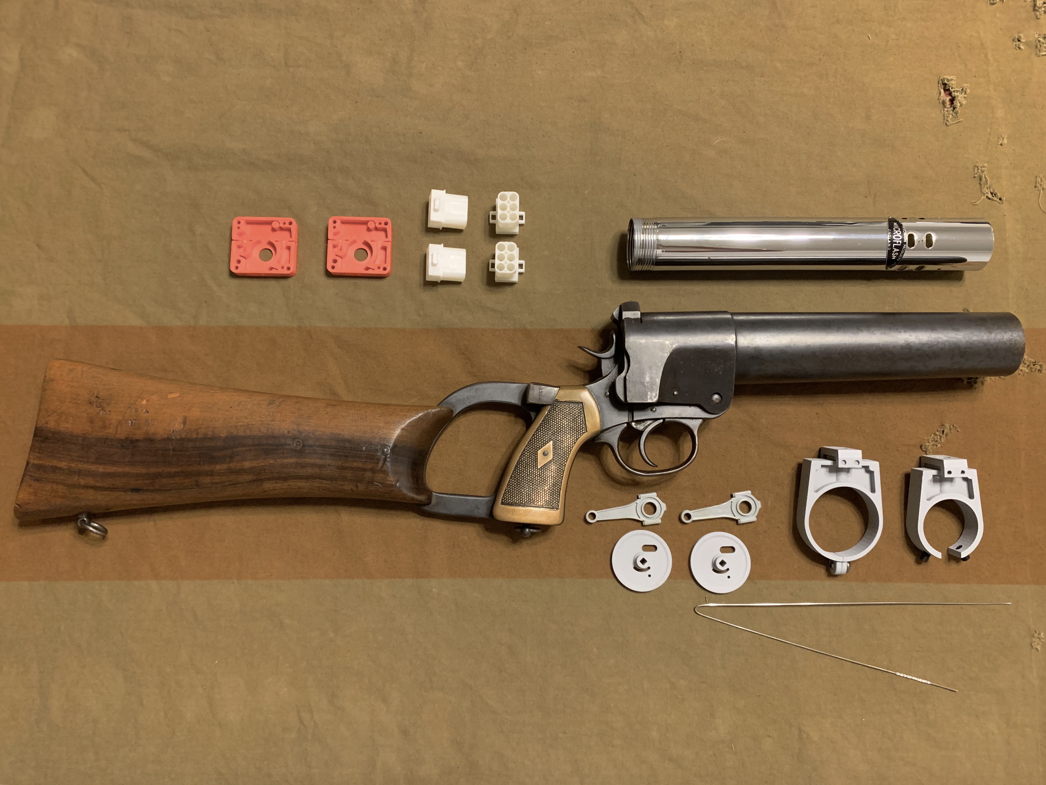

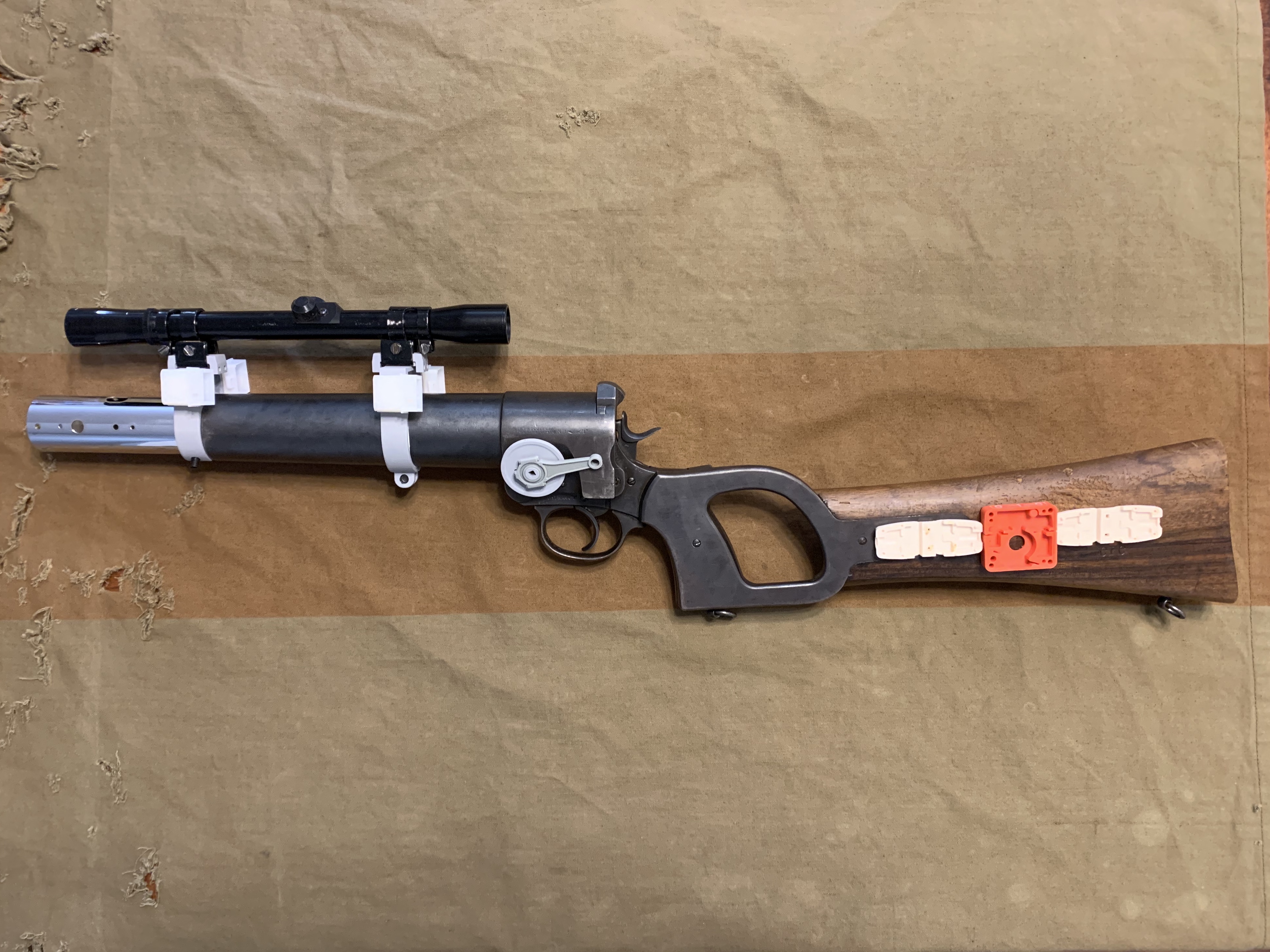

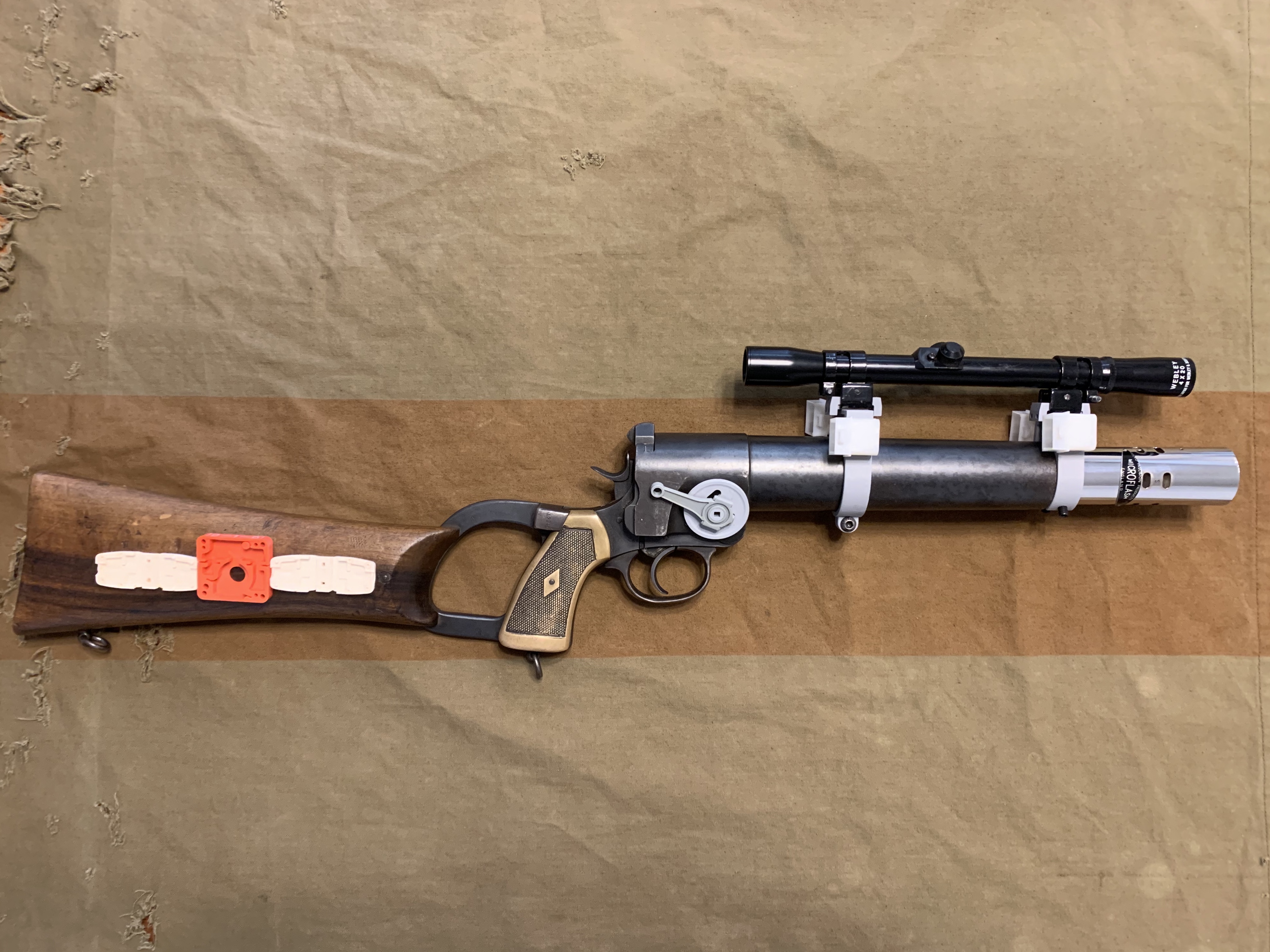

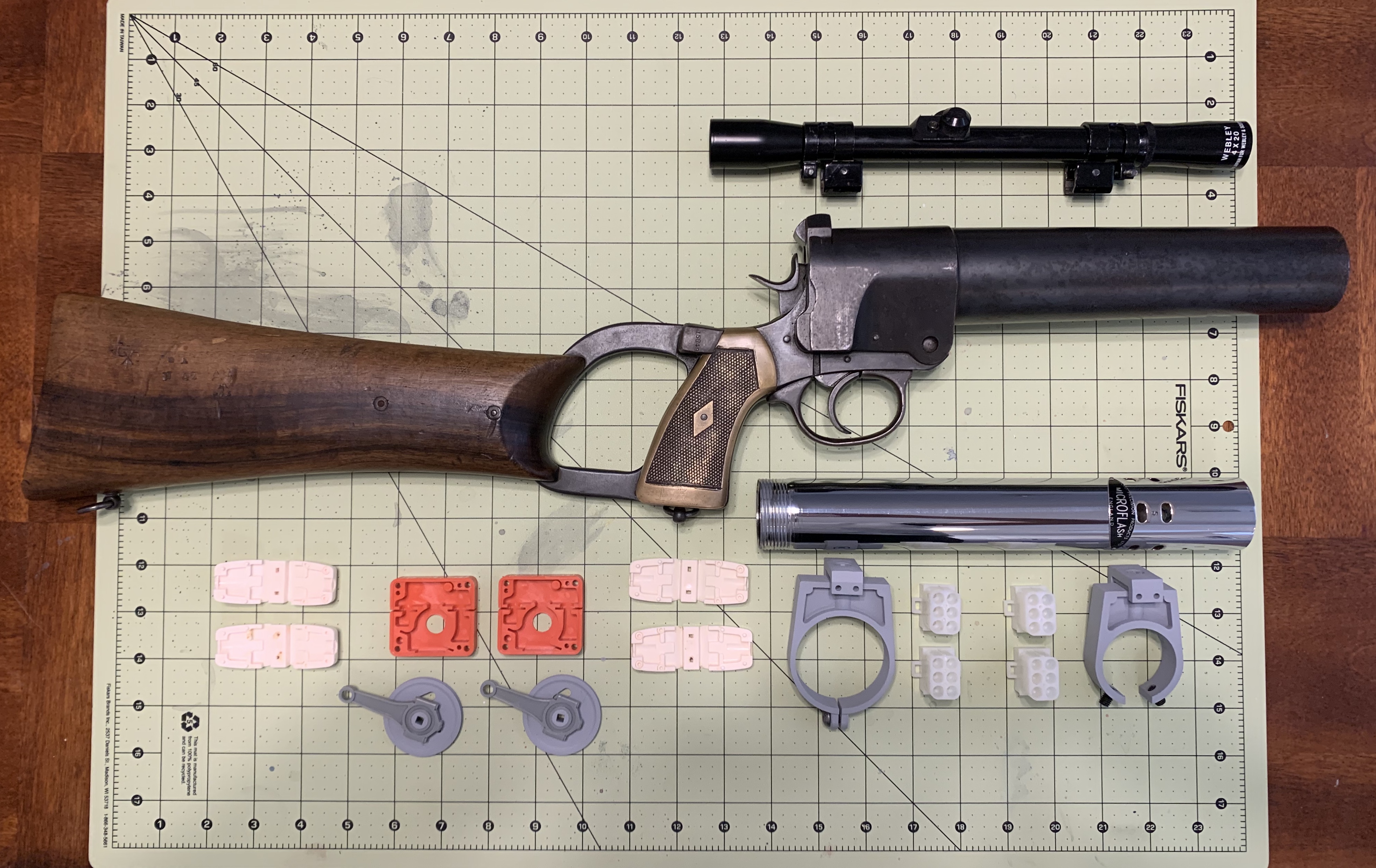

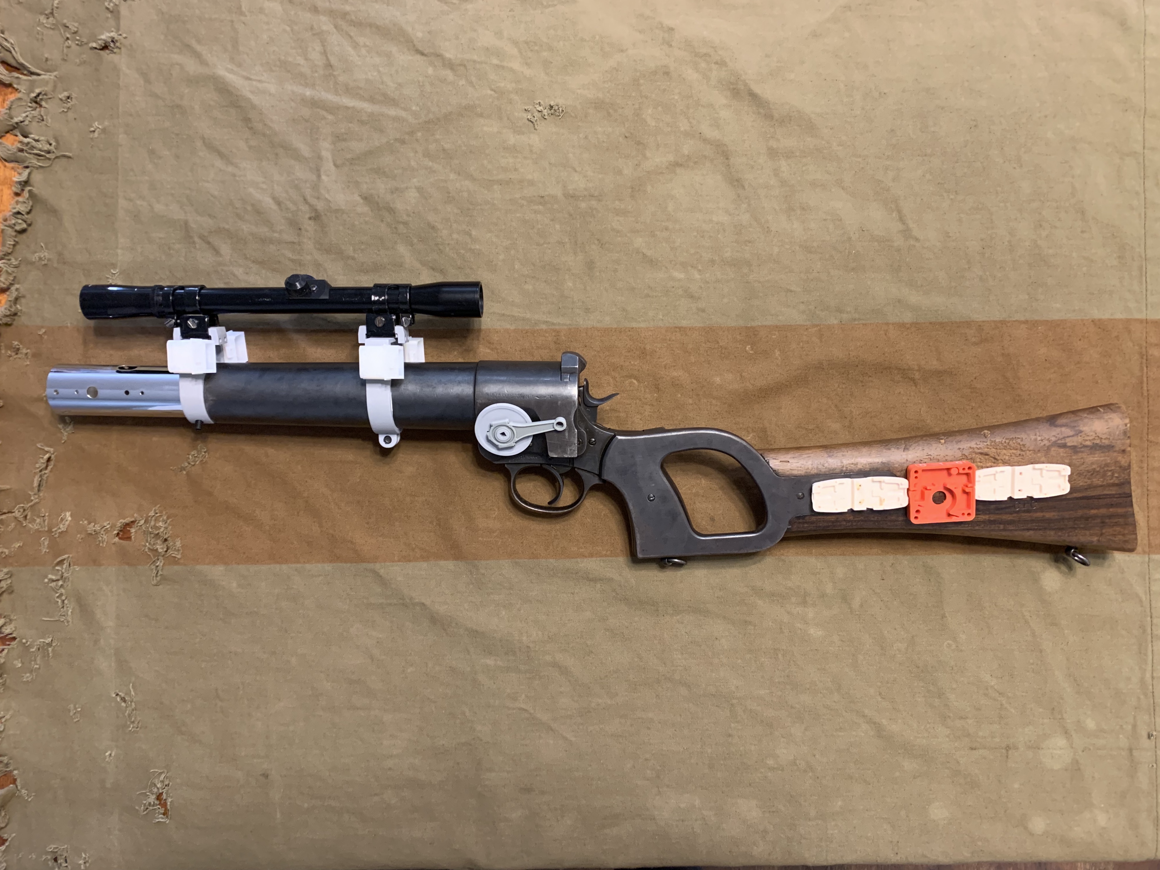

Getting close here. Almost have all the known found parts for this build. Recently received these beautiful barrel mounts and breech discs from a brilliant member that totally hooked it up. My scope is being borrowed and being molded by a friend at the moment and I have some AM LMK plugs in the bullpen. Can’t wait to start assembling and detailing.
Alright!!! Finally, I have everything that has been identified and is now in order for this epic, found parts, Boba Fett, ESB, EE-3 Blaster build and will now start the assembly and painting process.
Disclaimer: (Nothing will be permanent or damaging to the original and historic Flare Gun)
Actual Found Parts List:

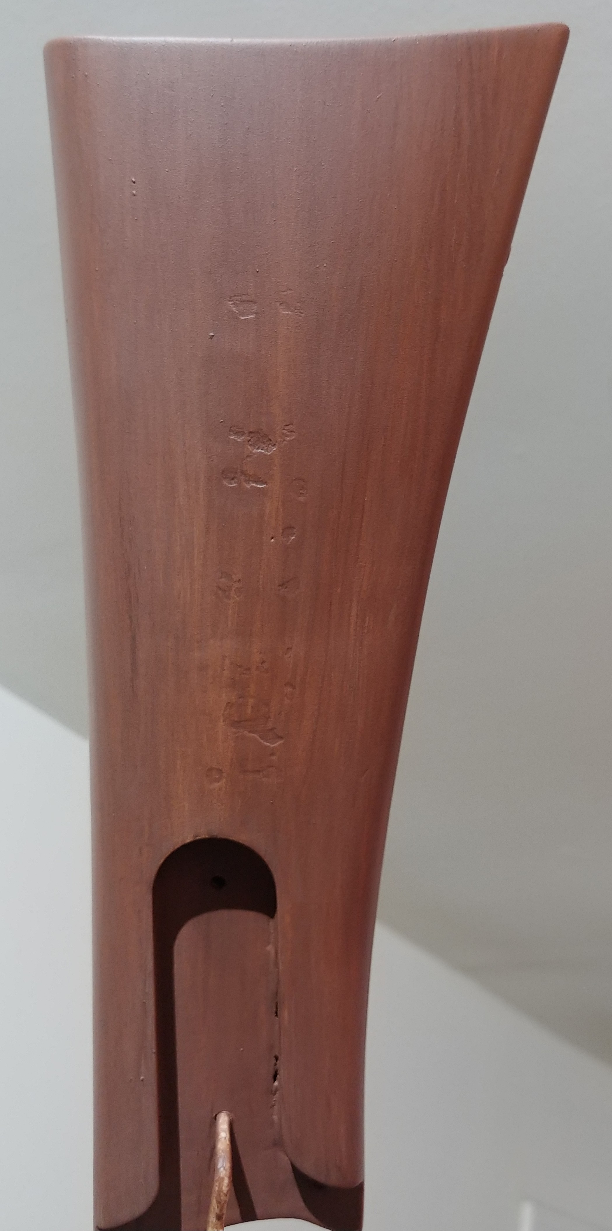

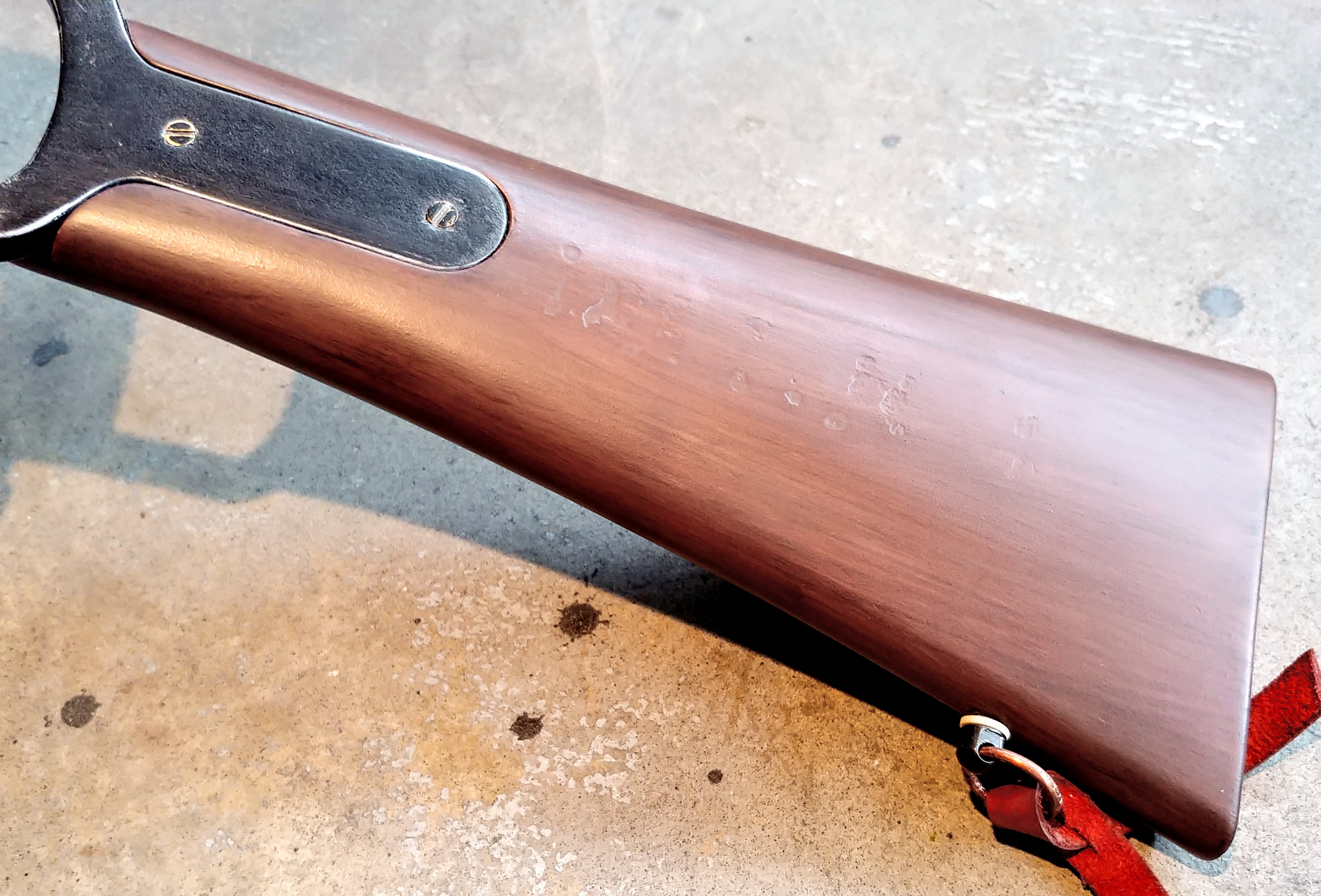

Webley & Scott No.1 Mk1 Flare Pistol
- Serial # 15849
- Original Bluing Finish
- Original dated stock
- Served and stamped in WWI 1917, WWII 1942, 1943
-Original sling rings
Resources... miscellaneous-webley-and-scott-flare-gun-information

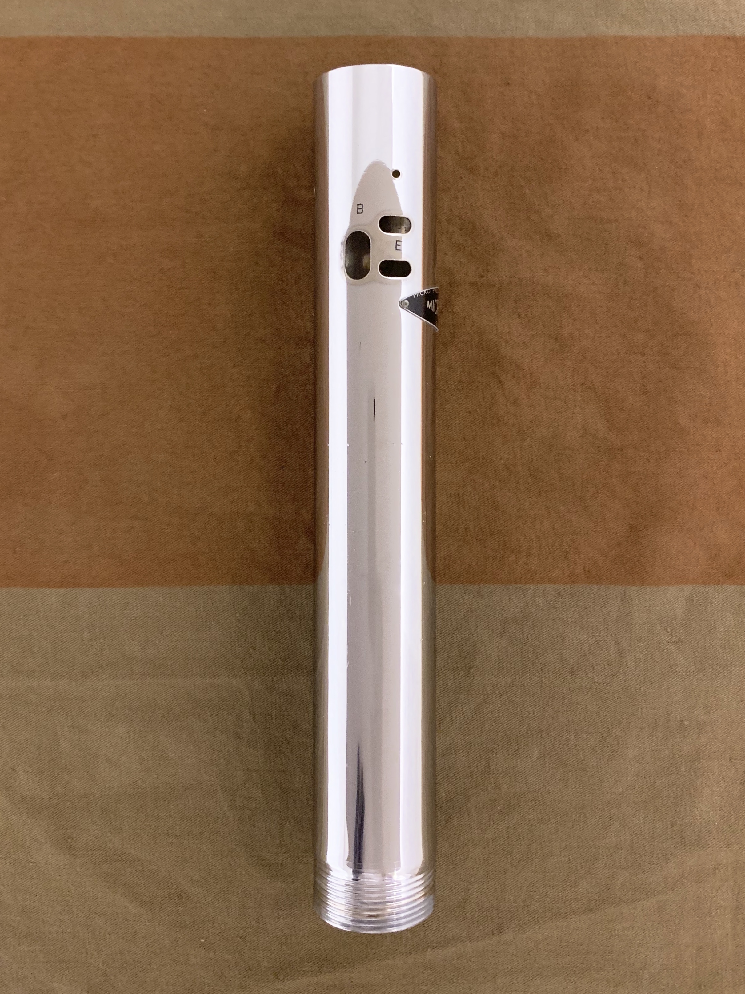

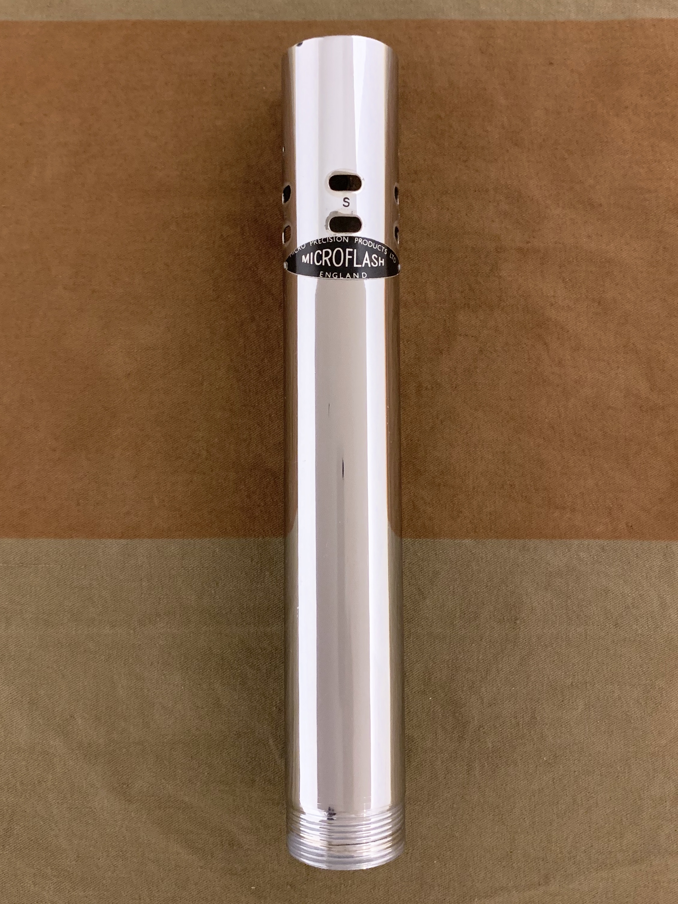

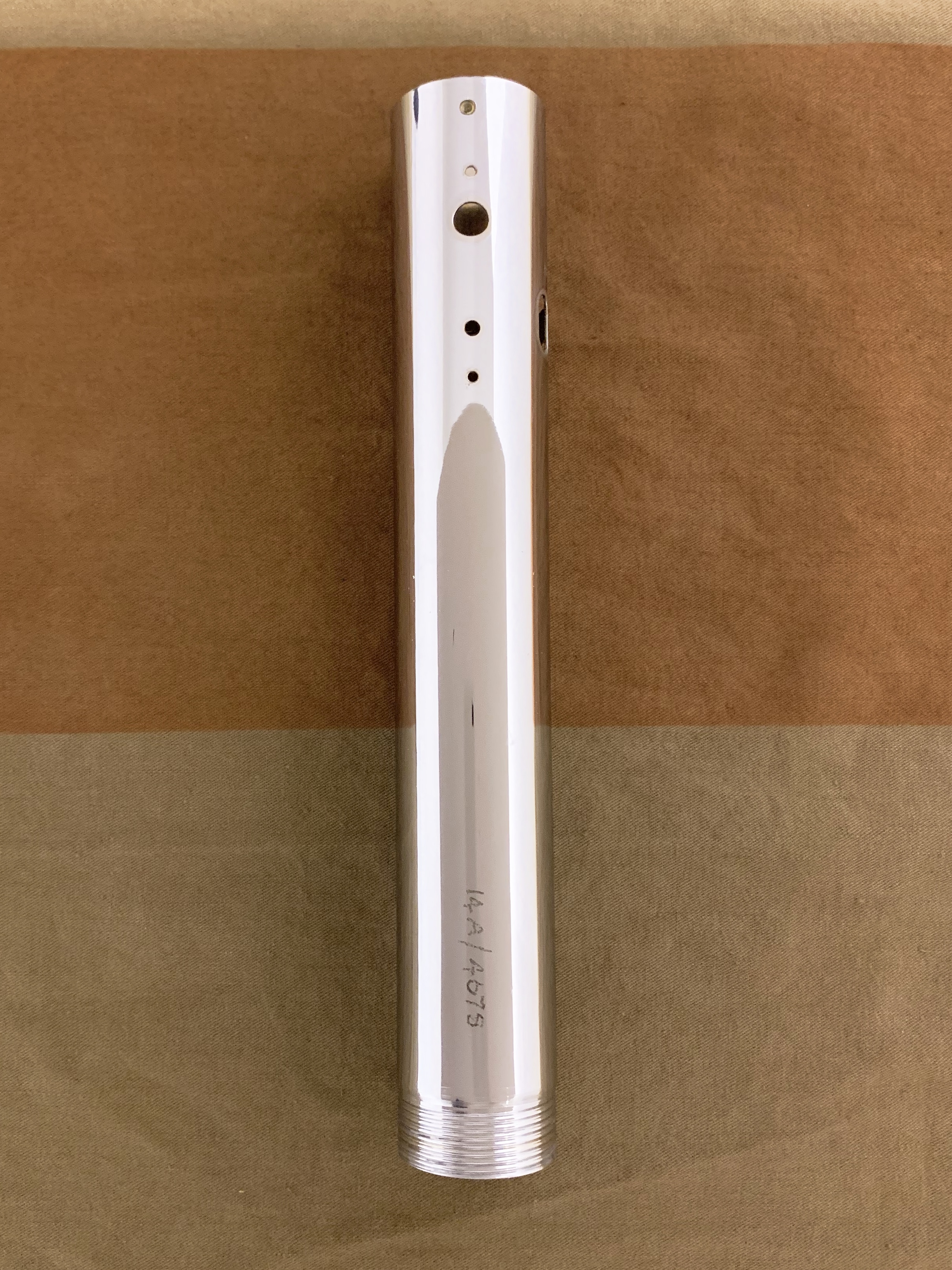

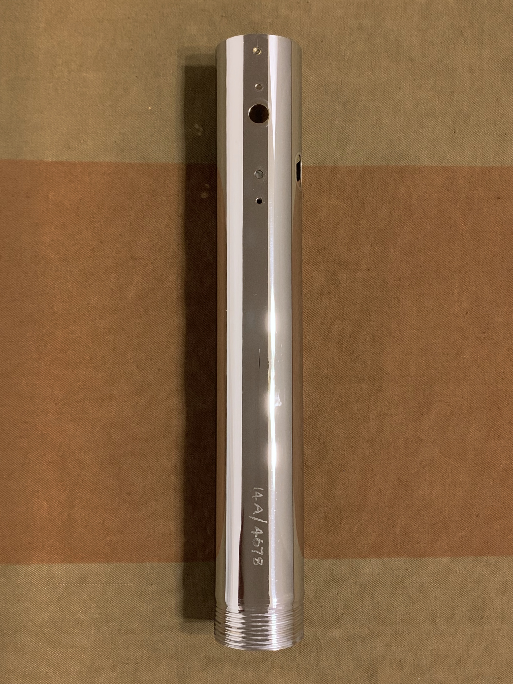

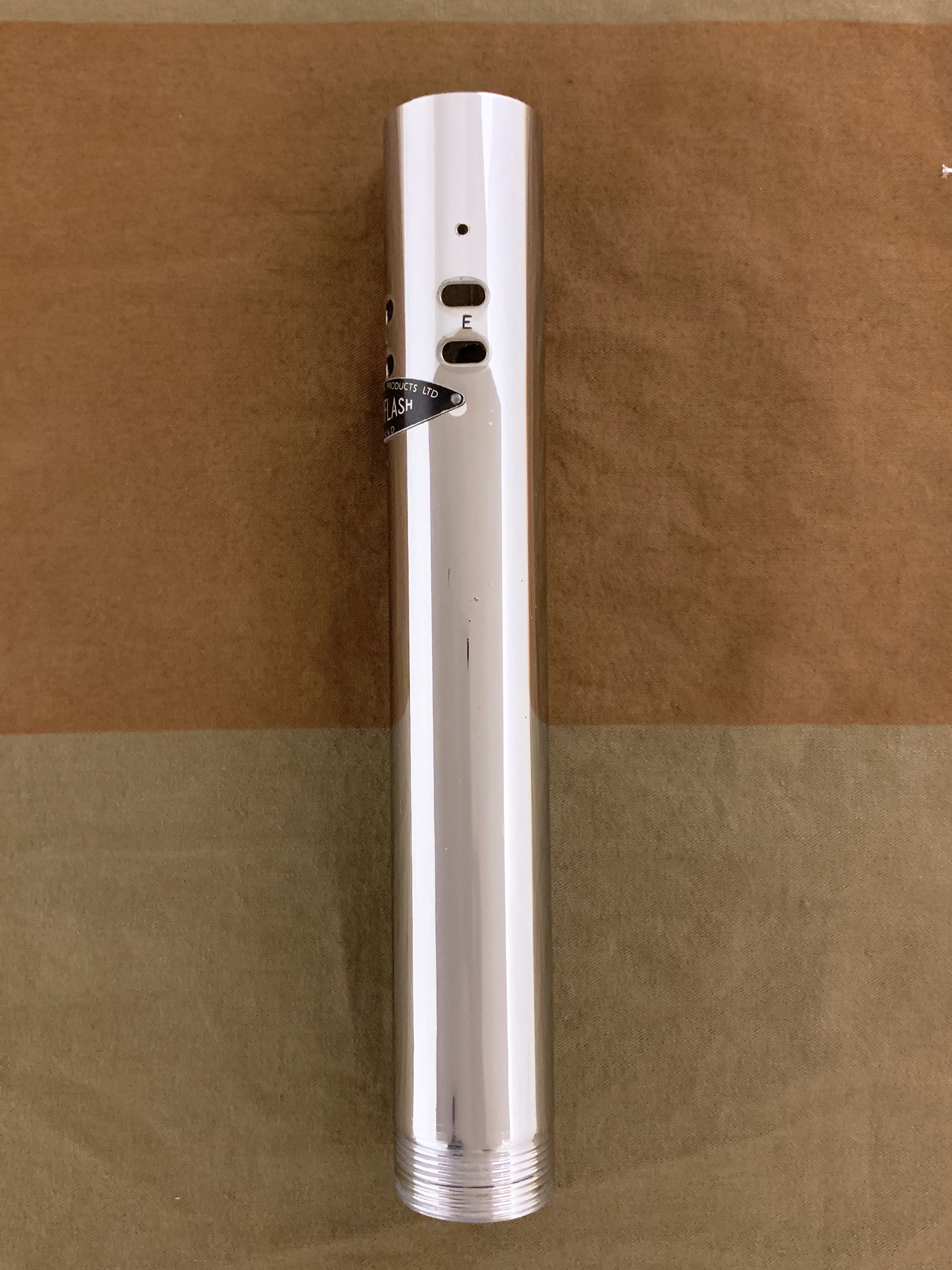

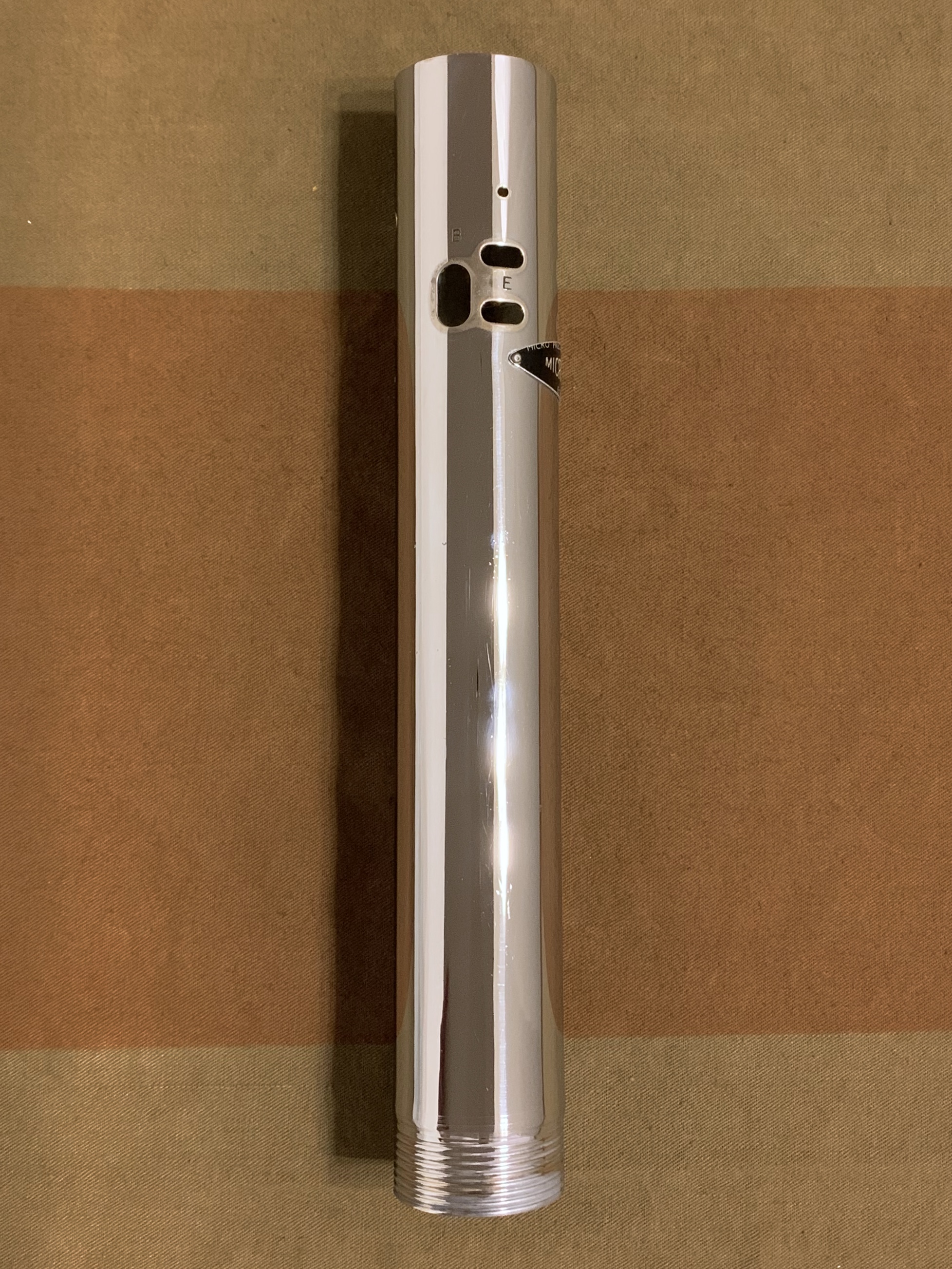

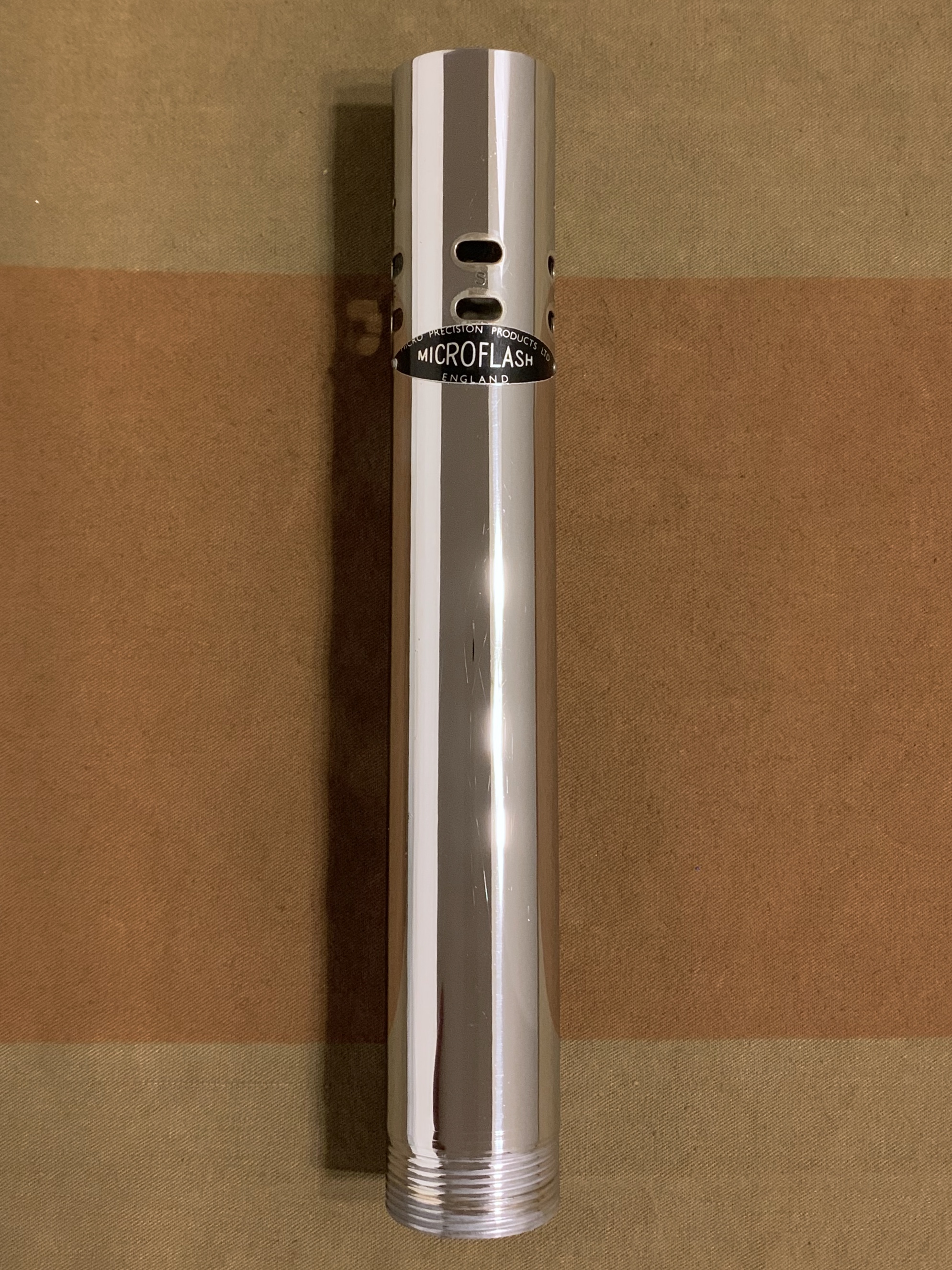

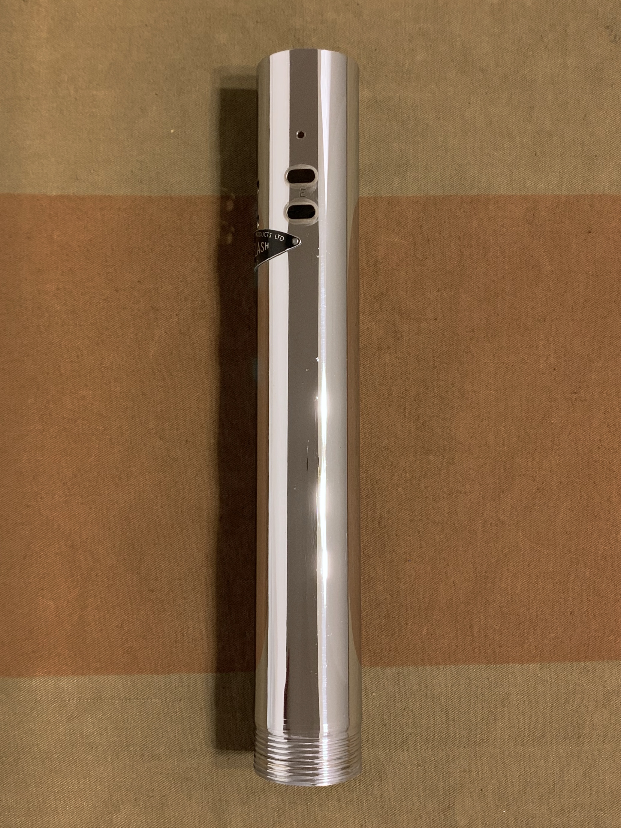

Micro Precision Products (MPP) Micro Flash
- Correct Variant Large B-Port
- Royal Airforce (RAF) military stamp
- Serial # 14A/4678
Webley & Scott 4x20 Scope
- Assumed to be all original
- Correct plastic eyepiece
- Correct locking ring
- Correct tube
- Correct windage and elevation screws
- Correct objective bell
- Correct screw in ring
- Correct tall feet "Hero" scope mounts
Resources... ee3-vintage-scopes-and-scope-ring-types
LMK AM Aerial Earth Plugs
- Quantity (4)
1970's Revell Visible V8 Piston Rods
- Quantity (2)

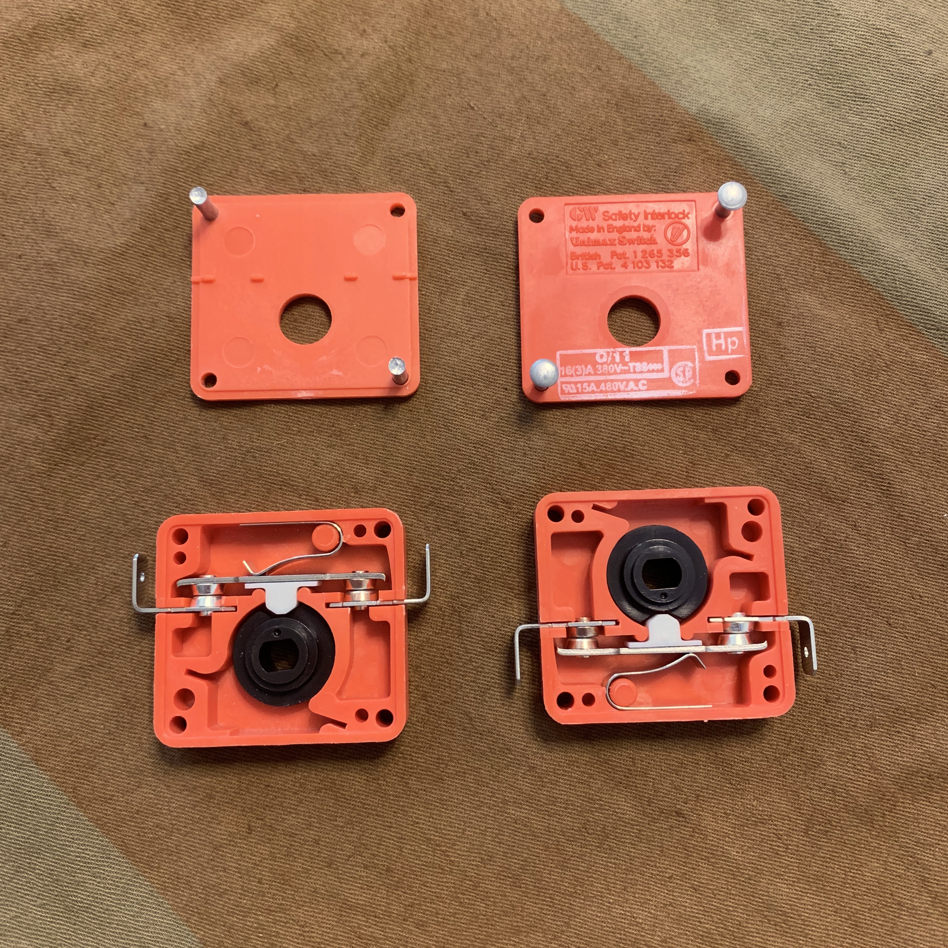

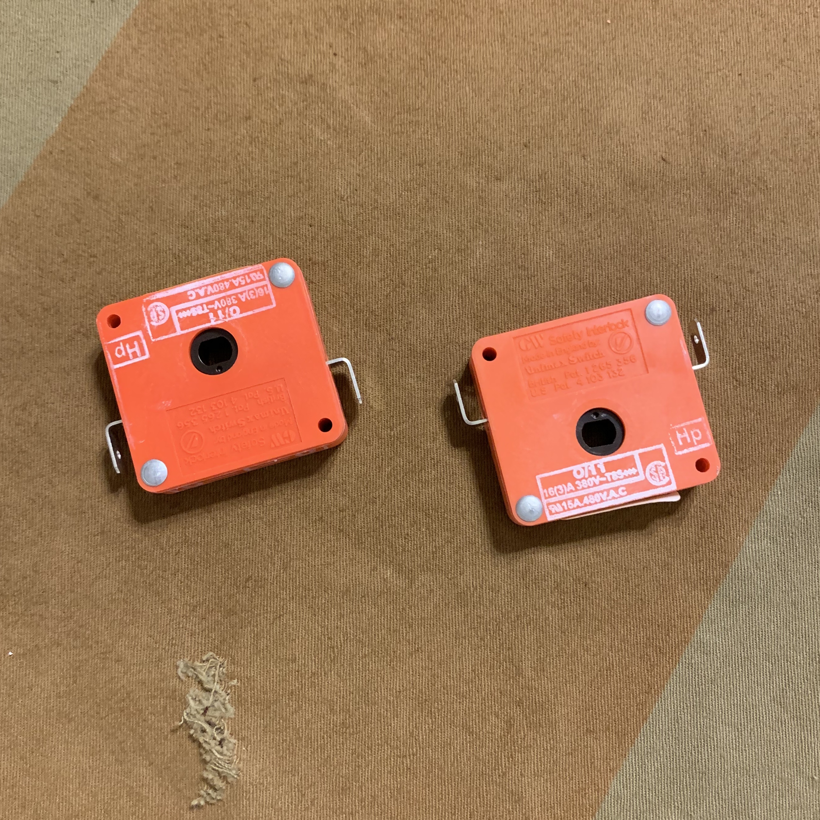

Unimax Fail Safe Switch type "O"
- Quantity (2)
Mate-N-Lok 6 way Pin Housing
- Quanity (4)
- Disclaimer - Exact Variant Still unknown and unidentified
Resources... PartsofSW
Modeled/Extra Parts List
Breech Disc Greeblie
- 3d Printed
- Modeled from reference photo's
-Actual Disc Greeblie used Still unknown and unidentified
Barrel Clamps
- 3d Printed
- Modeled from reference photo's and after vintage pipe clamps
-Actual Pipe Clamps used Still unknown and unidentified
Scope Mount to Pipe Clamp Mounts
- 3d Printed
-Actual mounts used Still unknown and unidentified
Miscellaneous Nuts and Screws
- All metric sizes
NEW FOUND PARTS DUE TO THE MANDALORIAN
Leather Sling
- Recently discovered leather part made from the hide of a Mature female Blurrg before mating.
- Just Kidding... Amazon.com leather, 18mm wide by 3mm thick, medium brown.
