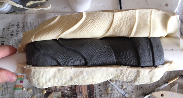

Here is a shot of the final mold.

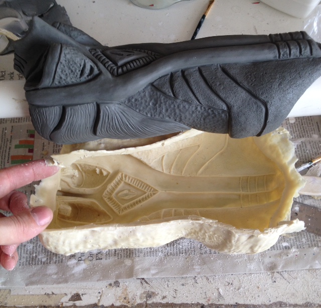

NOW - This is the moment I have been waiting for did I have a nice mold and sculpt or just a very long learning experience ?
Started to peel back the latex slowely - Things looked really good !
Then TA - DA the latex peeled off perfect even in the inset areas and the sculpt was intact.
Now just let everything dry really good and on to the next step.
I built up the latex really thick and it does seem really floppy ! I still plan on making a hard mold of this sculpt to practice for the 1/2 mask sculpt but it's looking like the resin gauntlet is the way to go.

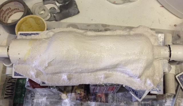

Interesting that you used a loose mold instead of fixed/ boxed style 2-part mold. Don't get me wrong...It looks fantastic. Just never seen anyone use a mold/negative without a reinforcing shell.
This is my first experience with any of this stuff and I went with what I saw on the Utubes. There is a plaster 2 piece reinforcing shell around the latex mold. You can see it in the first picture. What would are the advantages of having a box be ? I assume that your talking about building a retaining box around the sculpt and pouring plaster over the sculpt with the latex on it.
I've been playing with it to see how things fit and one mistake I did make is there are no "keys" or larger features in the latex to hold it solidly in place in the plaster outer mold. It fits in there nice and the deep texture kinds of holds it but I would use some larger protruding features in the latex to sort of lock it in the outer shell better.
The sculpt is in perfect condition so I might scrap this mold and just make another based on any suggestions from you guys and gals so keep em coming.
Just meant that I usually see folks do a two part silicon (as opposed to latex) mold that once the mold cures has a boxed shape. The main advantage of that is that you have the space to set in registration keys so the two halves "lock" together.
Ahhh. Got it. I'm not that advanced for silicon yet but I plan on ordering some soon. I went with your advise for my next mold and built a "box around the object and poured in the plaster with the keys. It worked a lot better. Thank you for getting me thinking.
my pleasure. I'm planning a one piece mold for a small item that may turn into a two piece should I decide to make a hollowed variant. Even for that one I going with a boxed frame and registration keys. It may just be a matter of preference.

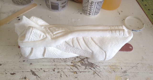

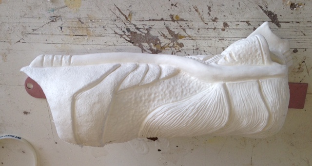

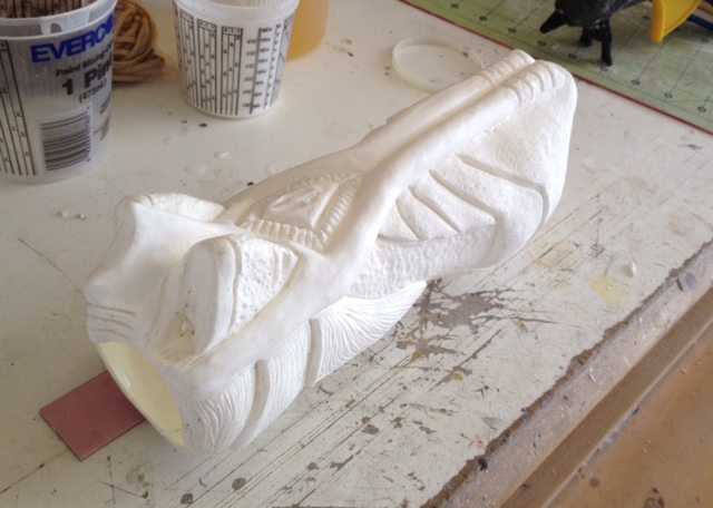

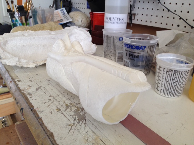

I went do to my local paint and fiberglass supply shop to pick up the Ultracal for my 1/2 mask mold. They stock a few different products from Polytek. I picked up some Easyflow 60 casting resin. I figured at least I could give this a test and see how everything goes. I slush casted the mold with 3 coats. It went really easy. The material set up in about 6 minutes and after 15 minutes everything de-molded great. Here is the final product.
The part that came off the mold is really nice, every detail showed up. It's a nice hard shell. I split the piece at the mold seam at the bottom and there is a bit of flex to it. Hopefully enough to get it over my daughters hand. I would say that the 3 layers of the resin has a good thickness but I will try 2 layers on the next run. For my 1st time making a piece from a clay sculpt and casting I think it turned out really well and I learned A LOT. This opens up the door for many more molds in the future.
Are you going to use this for all the armour or just for peices that are not on the main torso.im thinking more about using worbla for the chest armour to get a correct fit and resin for other parts
I did a 2nd mold using 2 coats and trying to get a really even coat. The 2nd part came out a lot better. With the slit at the bottom on the mold seam I'm able to slip it over my daughters hand and on her arm. I just need to figure out what to do with the seam now.
