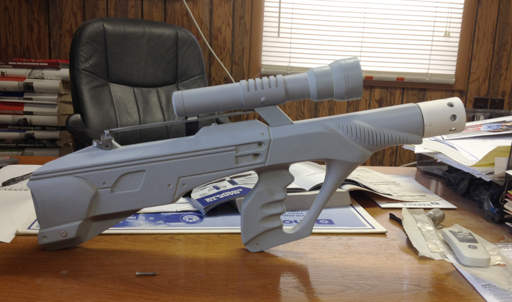

Been getting a little bit done. This is mainly PVC wrapped with styrene to create the right thickness. I'm trying to leave it hollow with the front part detachable so any ambitious Peacekeeper prospects can install some sort of light.
Also waiting for warmer and dryer weather before I even think about ordering fresh silicone and resin.

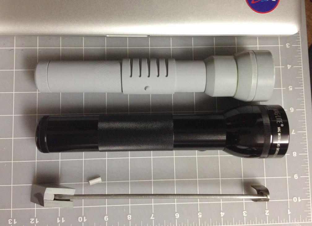

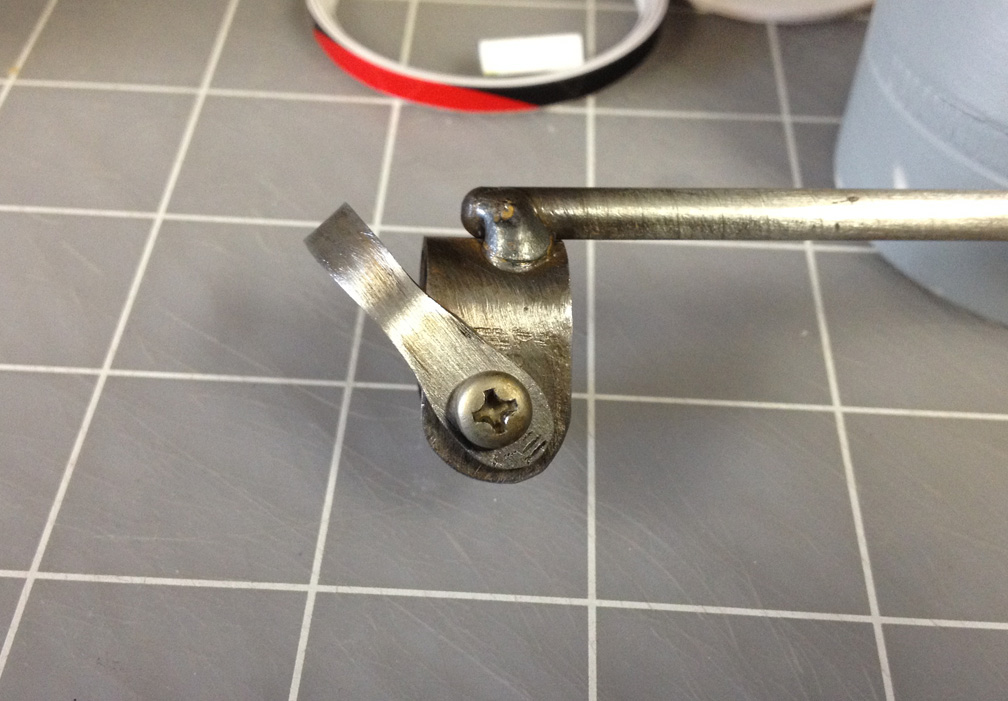

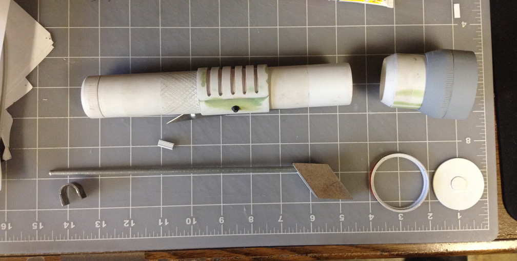

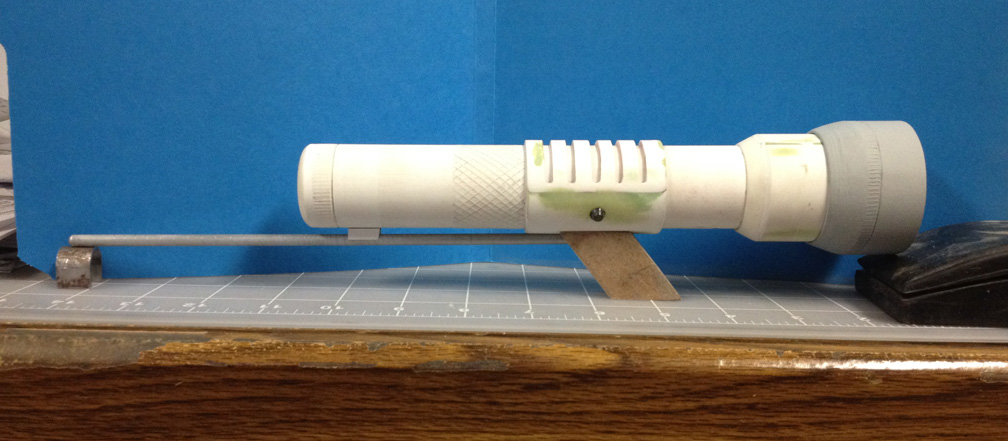

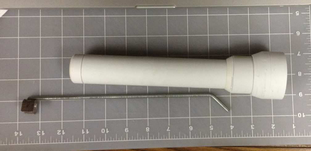

Got a lot more detail done on the "scopelight". Still trying to leave the head separate for user-installed lighting possibilities, and hopefully a clear lens that can be glued in with a retaining ring. I'm still trying to locate the correct small shackle, which is what attaches the rear to the pulse rifle. I have a few prospects though, in the form of a couple boating supply shops I hope to visit this weekend.
Earlier in this thread, I said the scopeflash was based on the 2 cell Maglite. I was wrong. Here's a side by side comparison. The one I built is made from calculating it's proportions using known sizes of the pulse rifle. The proportions are very close, but the size is slightly different. But, my 'known sizes' could be wrong, or my calculations, or my assumption that it's based on the Maglite.
Anyway, I'm too far down this particular rabbit hole to start again. So, onward!
No luck finding the correct size shackle (which is where I began to question my sizes), so after a couple experiments, I came up with a homemade, passable version. The scope is pretty much complete at this point except for some cleaning up and priming to seal it. I may try to clean up the ridges at front and back. I temporarily stuck it on my pulse rifle master with tape and I'm satisfied with the look.

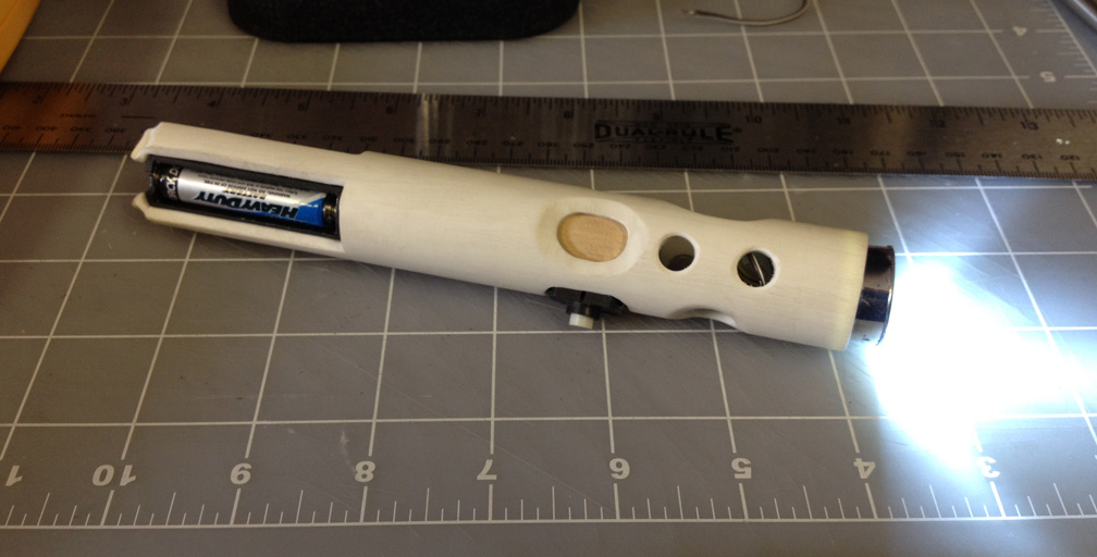

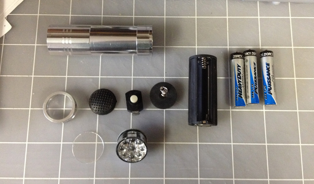

Then I found this cheap LED flashlight. I disassembled it and my nephew (who likes to build lightsabers) is advising me on how to mount it on a removable chassis that can be placed inside the final castings. I may have a simple solution to make this sucker light up!

Look out now! He's gettin' into 'lectronics!
Got this little thingie worked up. It only took me a day to figure out why it wouldn't light up. One of the batteries in the holder had to be reversed. Yeah. I won't be dangerous anytime soon. LOL
It should fit easily into the final castings. I may be getting ahead of myself, but I had an idea and I ran with it.
I guess I need to order silicone soon so I can get started on new molds!

lol Don't you hate that? Something so easy and we over think it. I'd probably still be trying to figure out it needed to be reversed. :rolleyes Glad you solved it without a lot of trouble!
