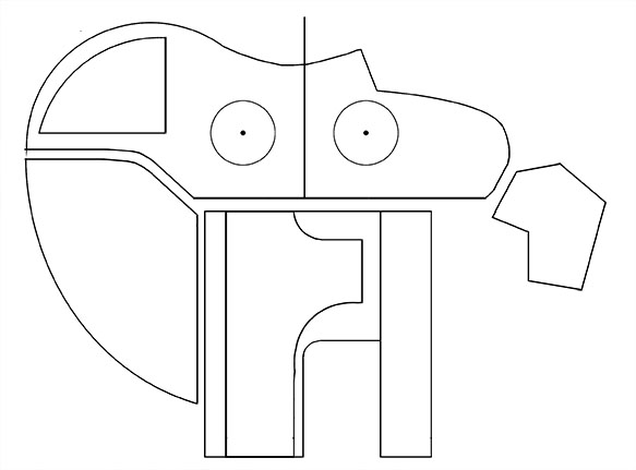

I wasn't happy with the back panel I did before so I am remaking the entire back panel.... here is my digital design for the risen panels... I am cutting these in polystyrene and then sanding and shaping them further so they are just rough designs.. Back Pannel Patterns.jpg
Seriously, I'm running out of adjectives... The new back shell is a massive improvement!
After the huge delay on this project, getting almost daily updates is like mainlining meth.
Awesome work!
