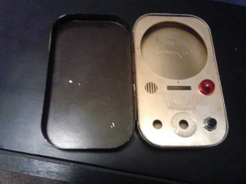

Please forgive me if this has already been discussed but I have a question about the faceplate installation. The rectangular cut out under the lens. Does something go under there between the plate and case or does it just stay as an open cut out?
The chipping on the paint may be that you did not prime your box. The primer help the paint adhere to the metal. Without it the paint will continue to chip. One should clean, prime and then piant your box. Even with primer the hinge will chip. The ones on the show chip at the hinge. I hope this helps.

Got a painting question. It's always seemed to me, that the outside has some sort of texture to it, so I just got a can of Rustoleum Textured in chocolate brown & a can of Krylon coffee in satin for highlights. The plan is primer, brown, coffee, 0000 grit steel wool, then repeat the 2 paints & steel wool 3 times.
I of one that has done the plastic wrap for the highlights, & the QMx has hand painted highlights, so just wondering if anyone has tried the texturing route?
Looks like I'm returning some paint.:thumbsup Thanks for the help guys. NMR, I've spent a lot of time searching your posts on the Farnsworth, so thanks for chiming in.
