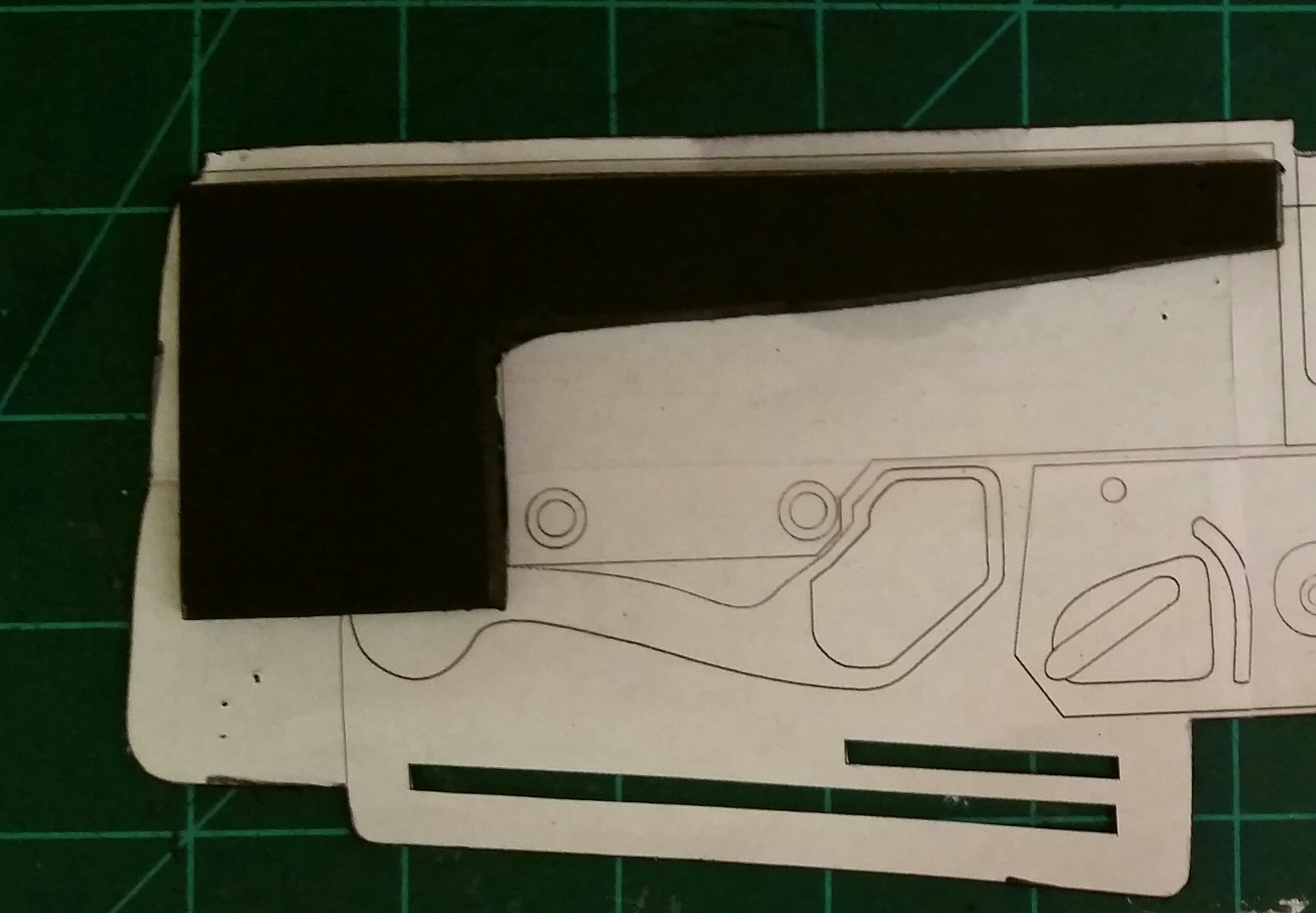

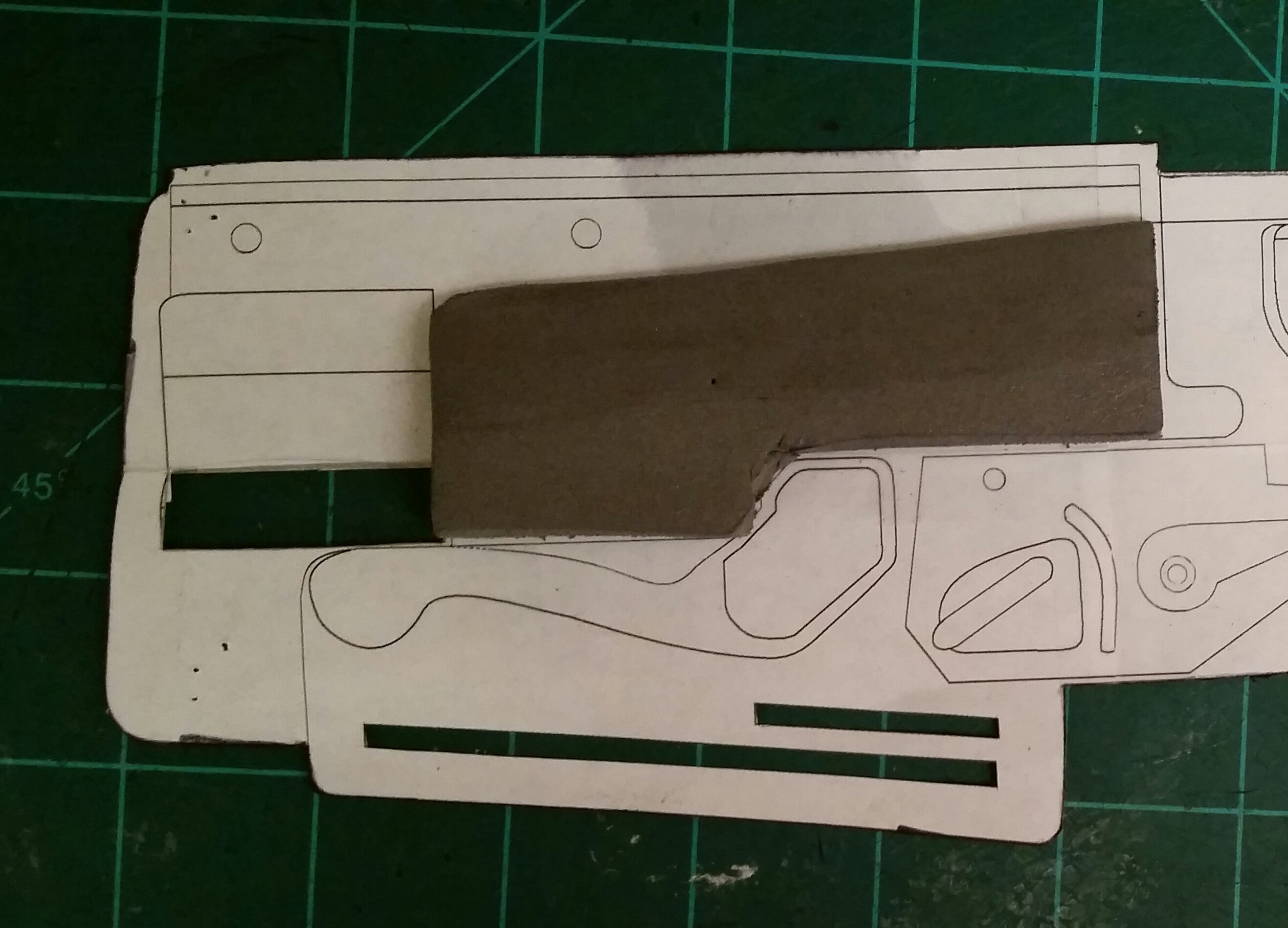

Here's my build of the 10mm pistol from Fallout 4! I made a blueprint in inkscape using screenshots from the game as reference. This is only my second real attempt at making a prop gun, but I think it turned out pretty good!
I started off with 2 layers of 1/2" eva foam cut in the basic shape.

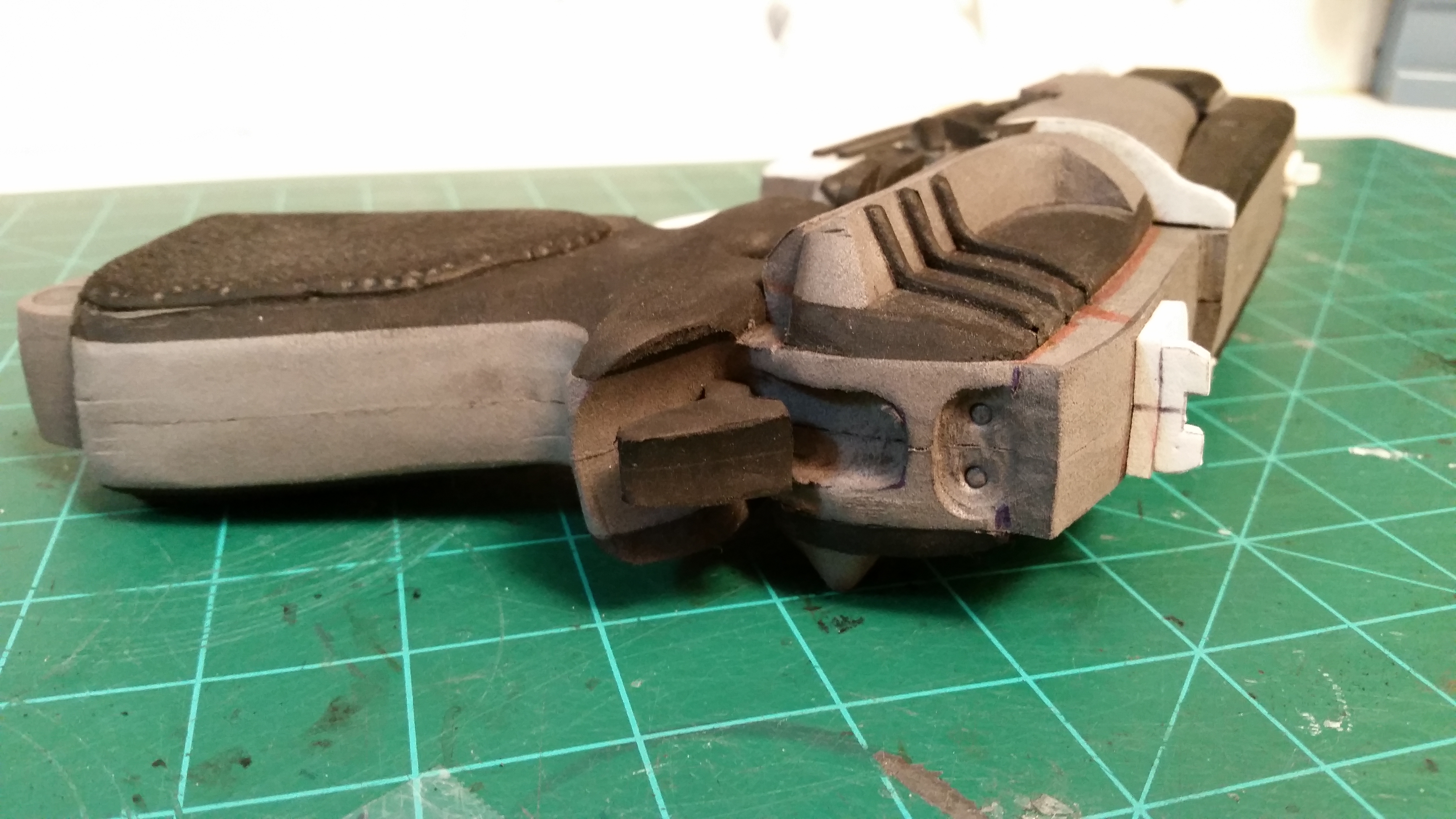

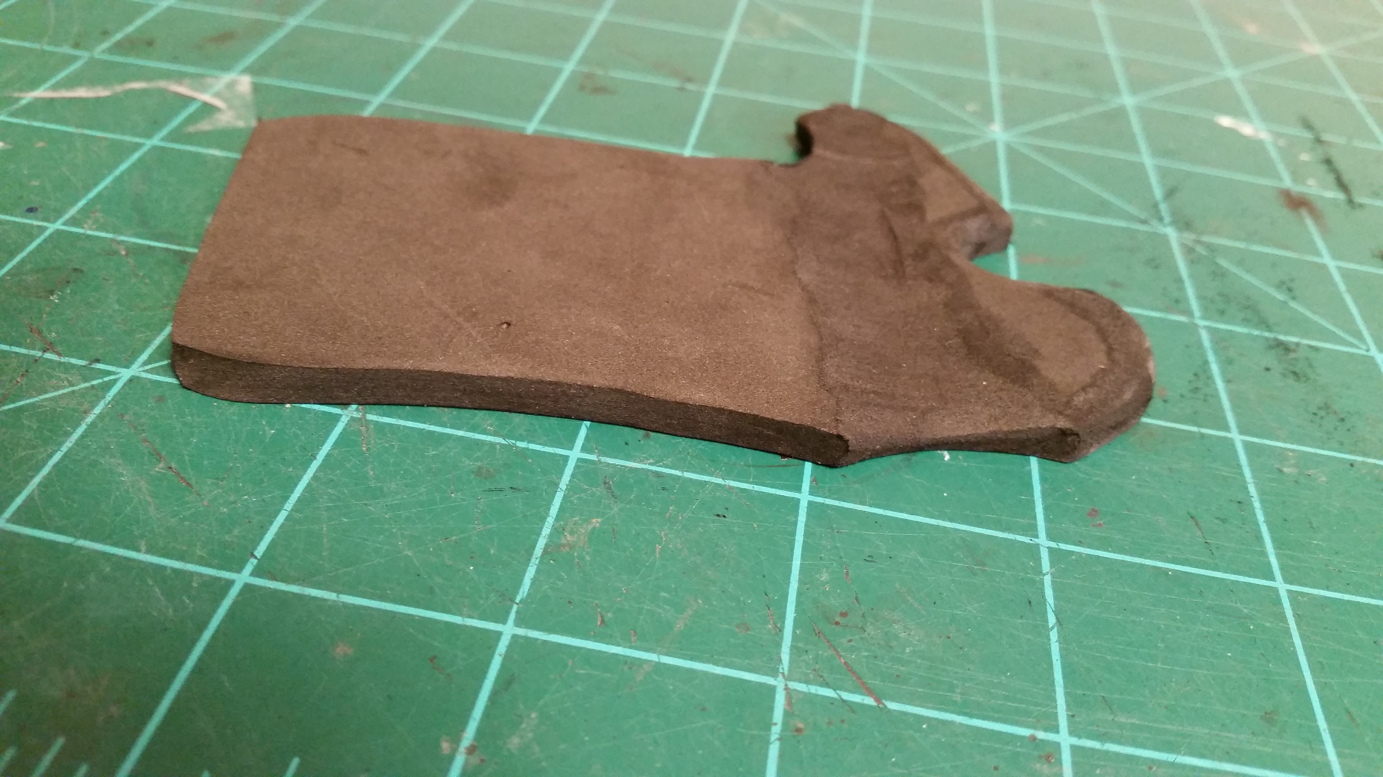

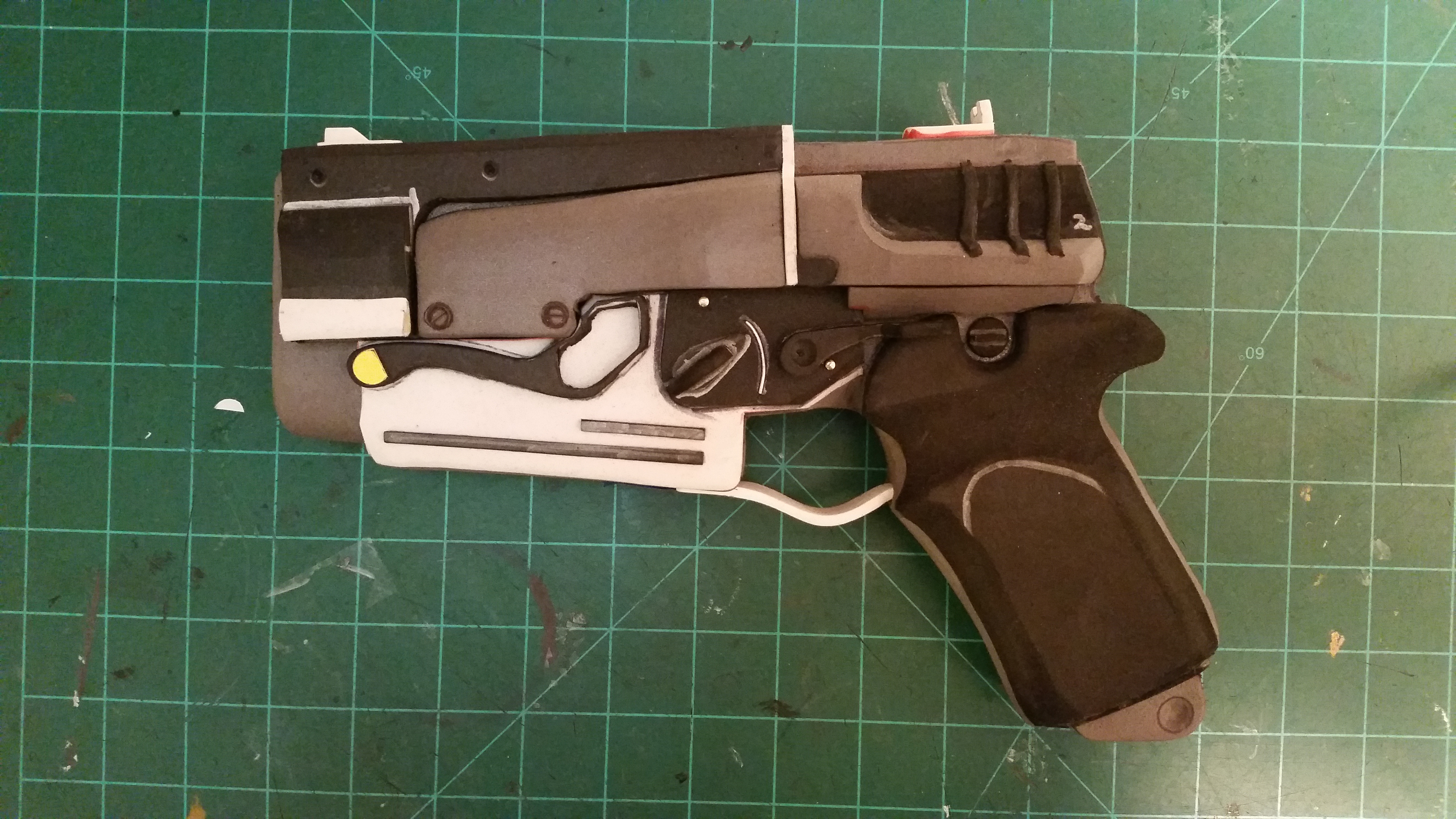

Here the gun is with some of the layers glued down. I just continue to add layers, getting more detailed as it goes.

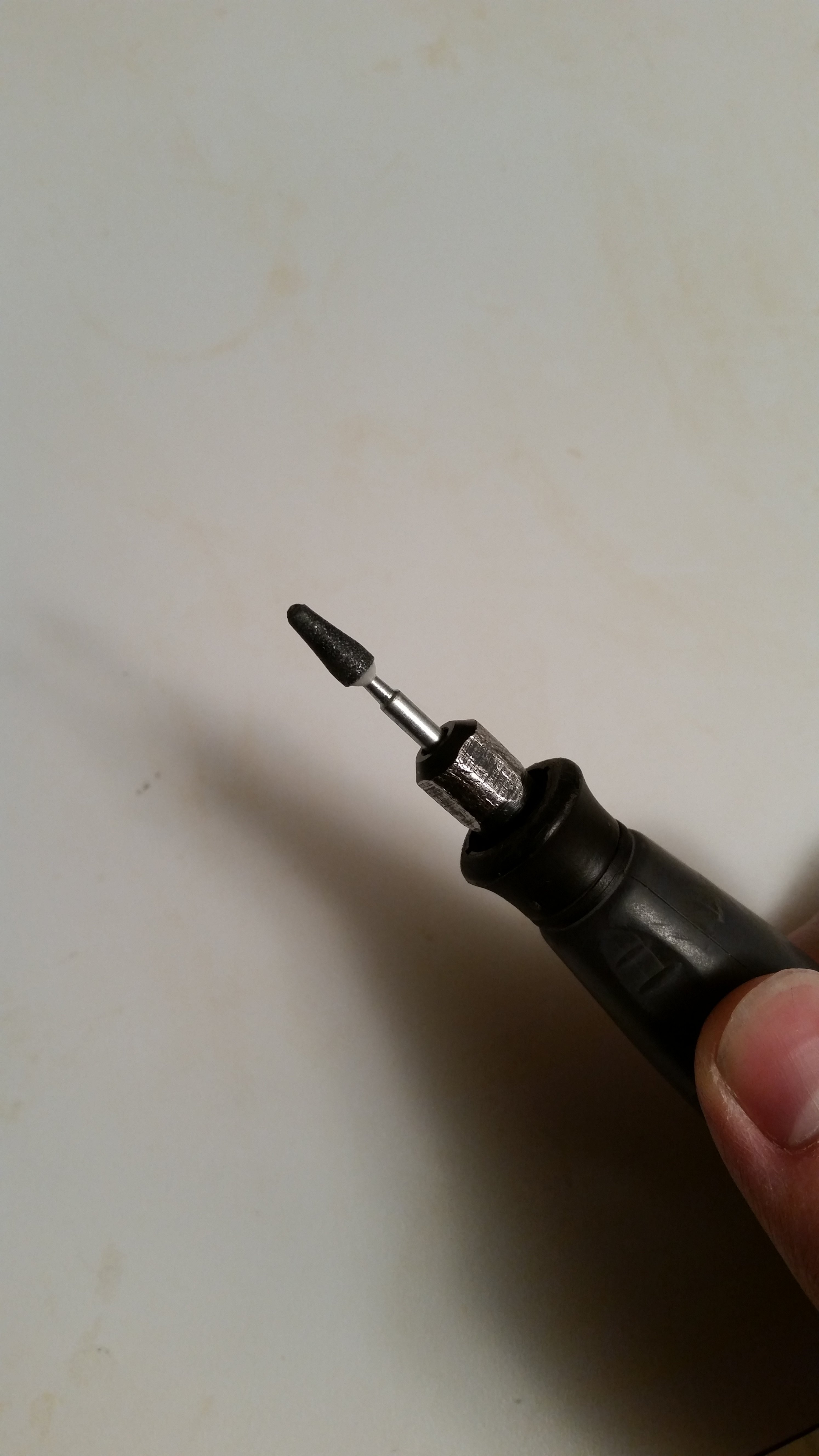

Some shaping done on the grip before gluing. For the rounded notch I used a smaller, stone, dremel bit to get it smooth and rounded
Here I cut out these notches that are supposed to be above the trigger section.

After gluing down the grips, I did most of the shaping on them. I also did a bit of shaping on the gun in general. Rounding out some parts and added the bevels where needed. It helps to have reference images while doing this. I left the game running quite a bit just so I could look at the gun in game.

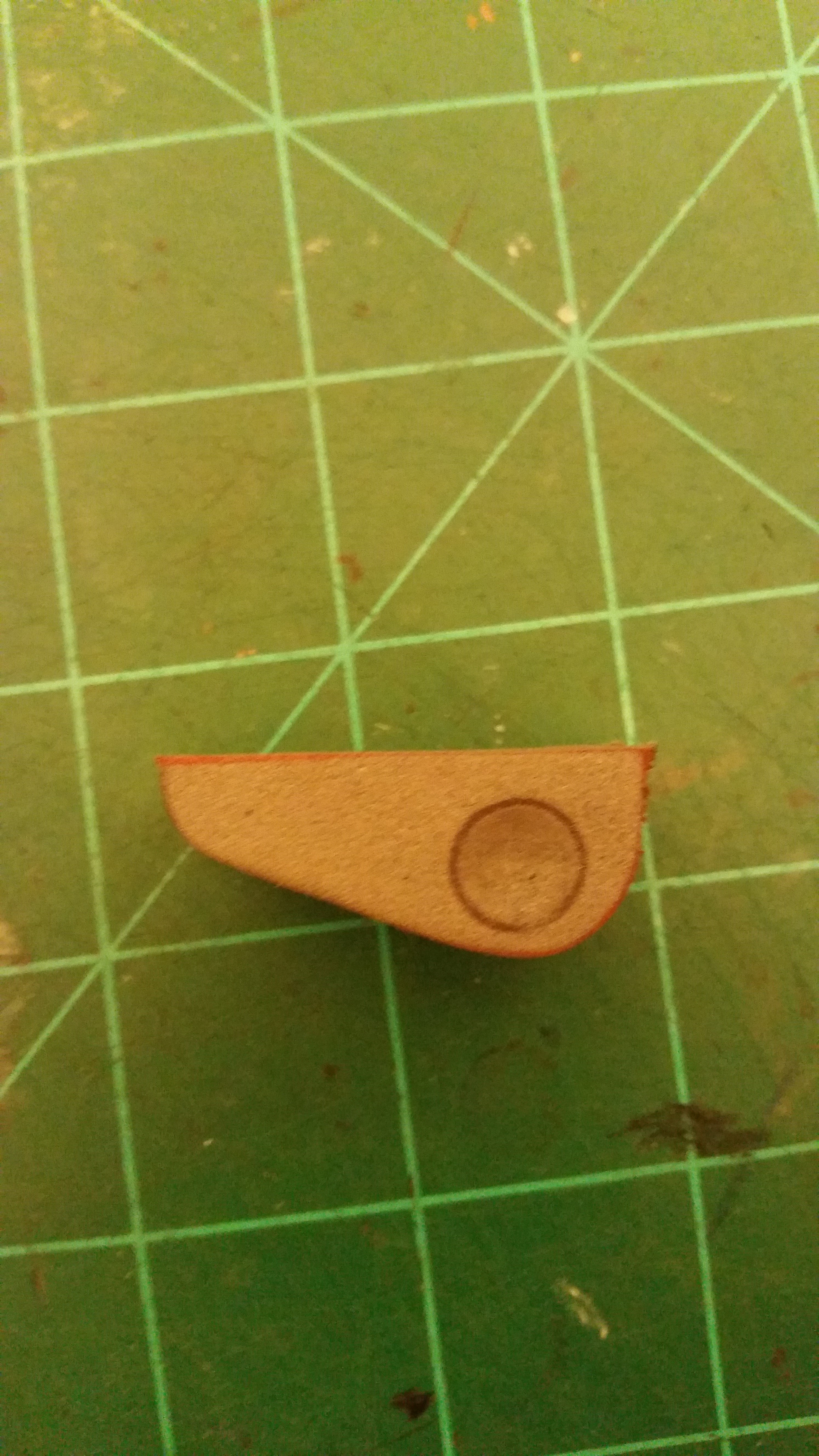

This thing was made from 2 pieces of 6mm craft foam. Then I dremeled the indent with a rounded bit and shaped it some so it would fit properly.

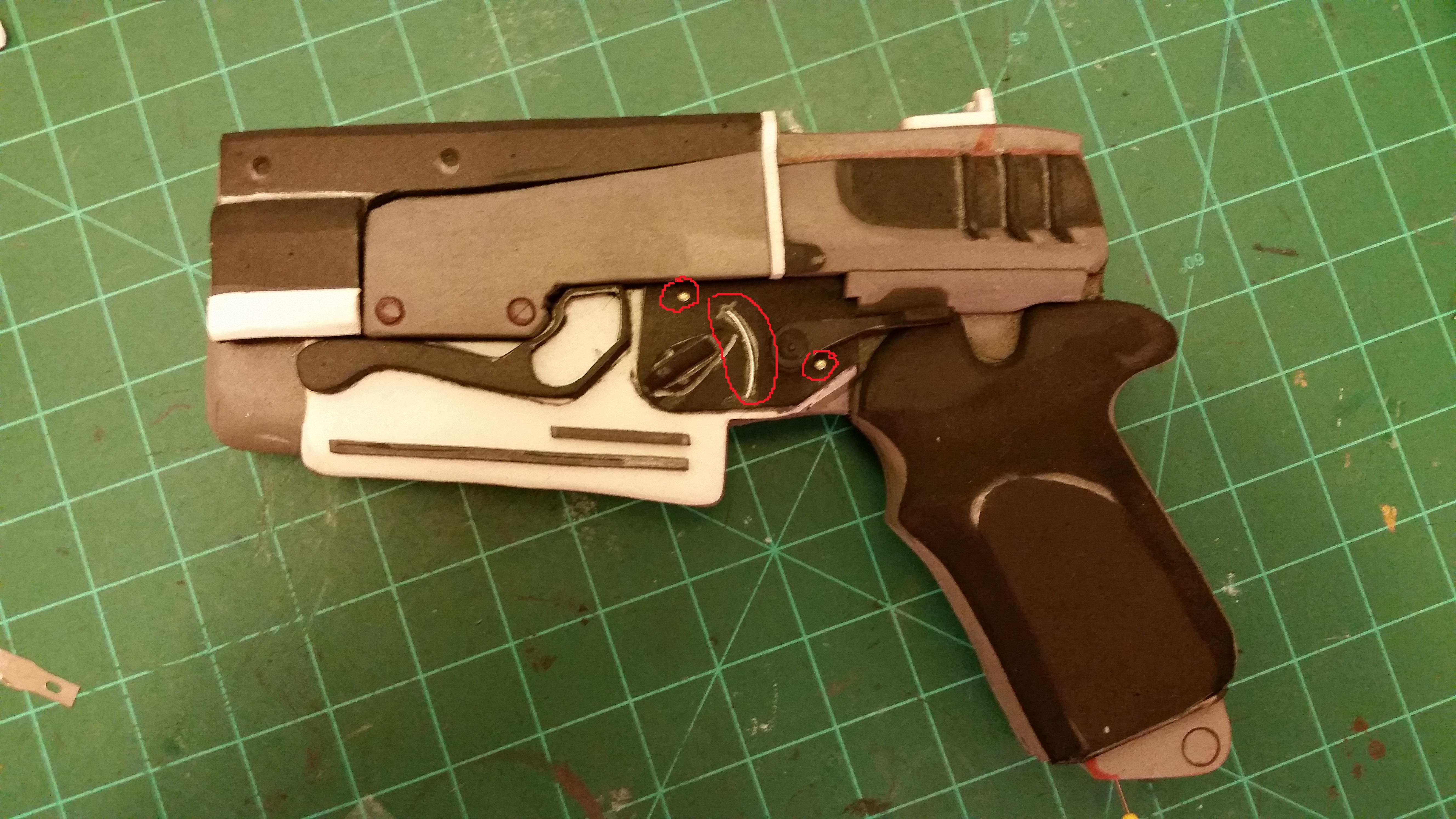

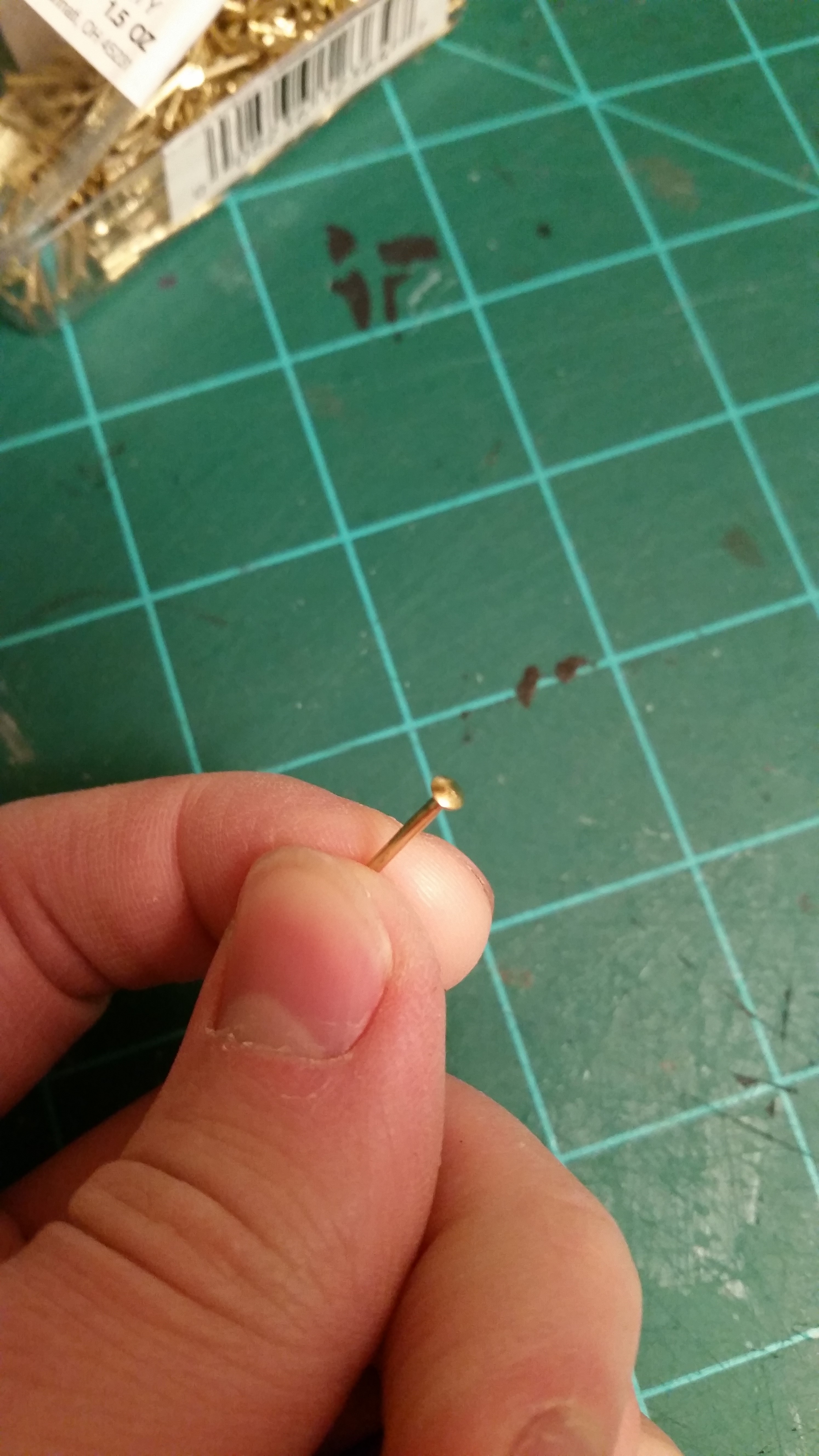

There are 2 small rivets(?) on each side of the gun, so instead of trying to make those out of foam, I just used these small brass escutcheon pins that I found at the hardware store. They aren't long enough to poke all the way through, but I cut the pointy ends off just in case. These were superglued in.

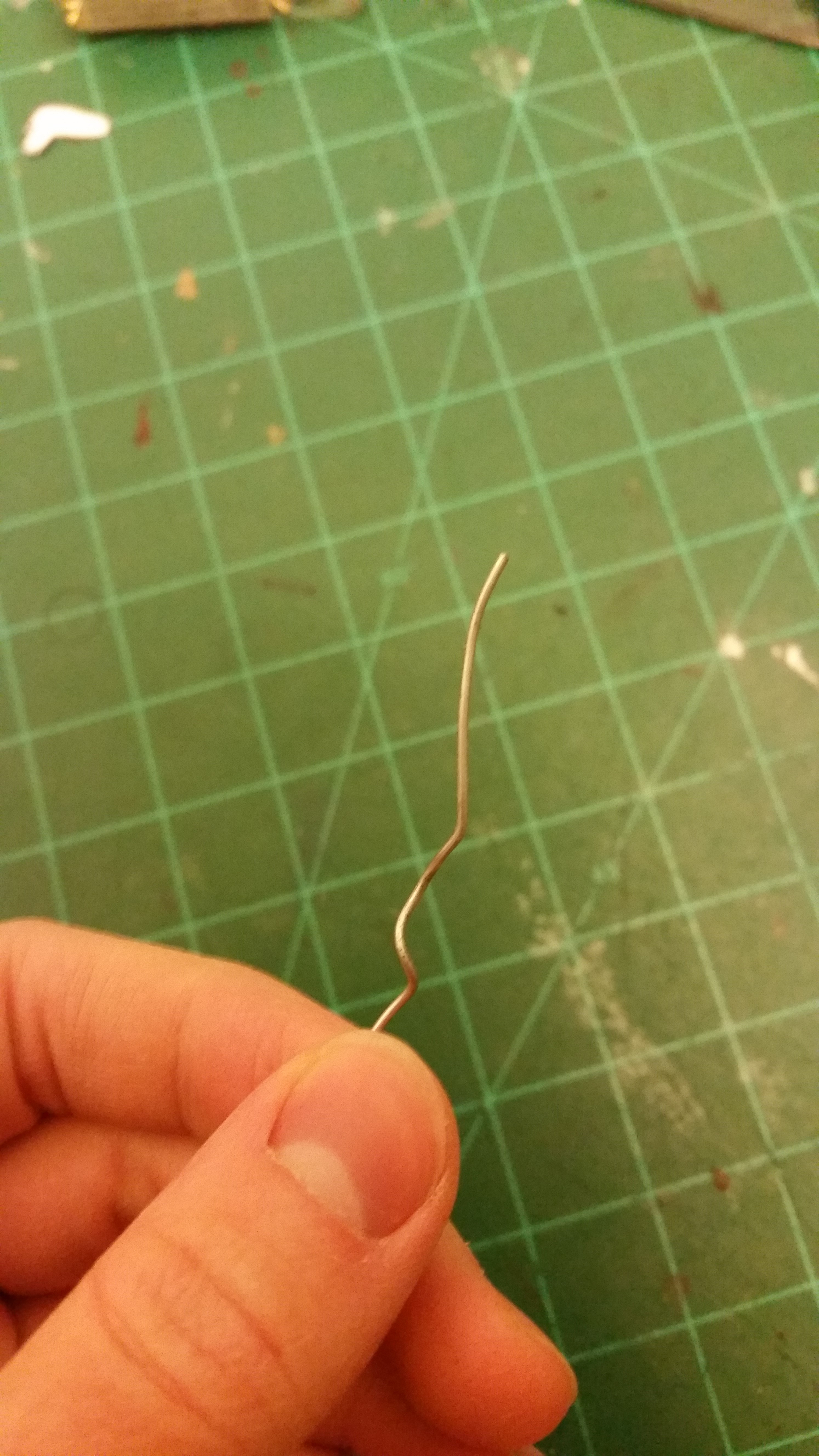

I also used some wire! I just had this lying around so I'm not positive what size it is. It's steel wire and it was the right size though. I just cut small sections and bent them into shape. Then rounded off the ends with the dremel. These were also superglued into place. Here is an image of the wire and pins circled.

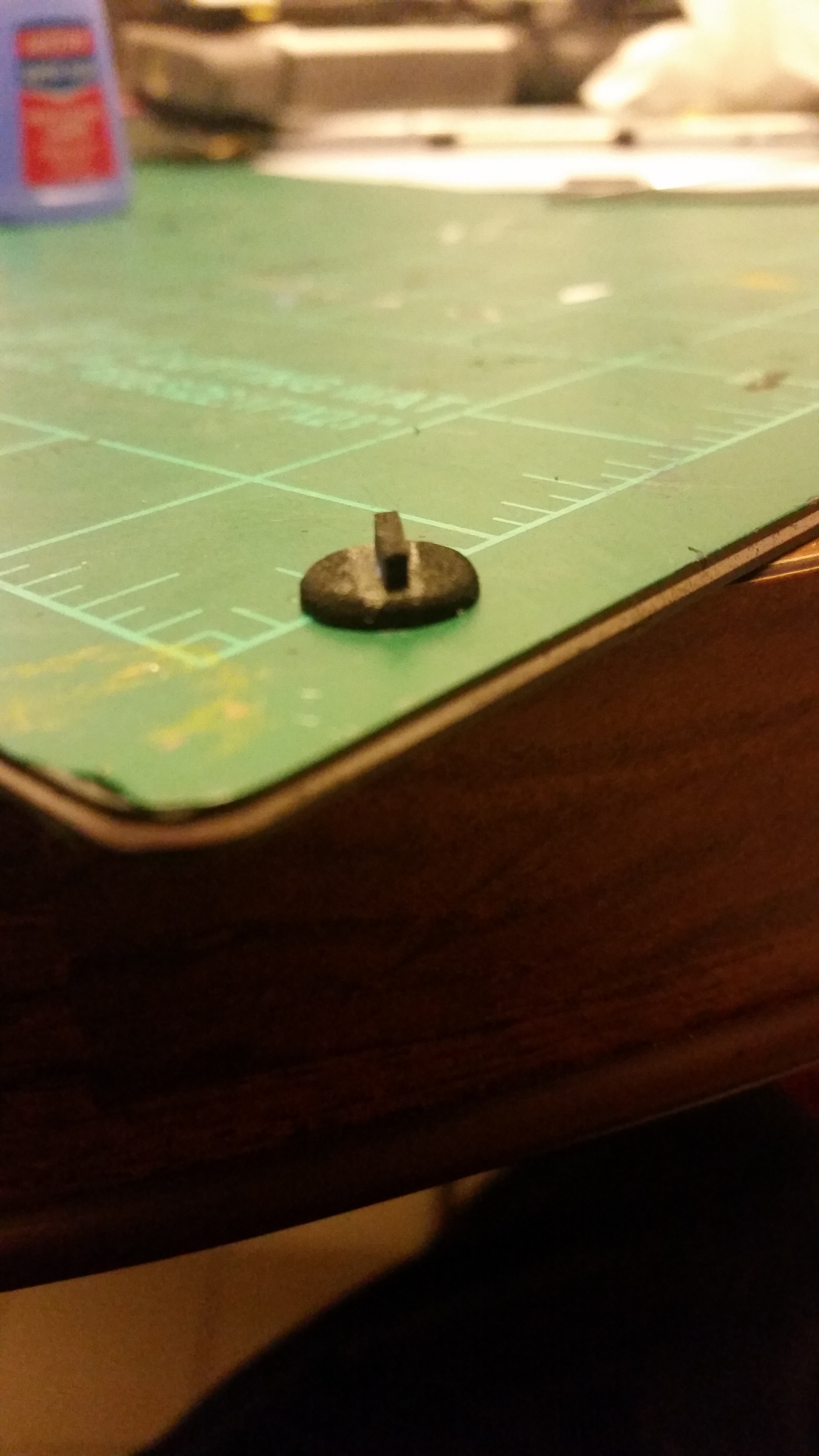

To make this disk thing I used the cap of a fine point sharpie. I just pushed and twisted in on some 2mm craft foam and it cut out a perfect circle! Then I added a small strip of foam on top.

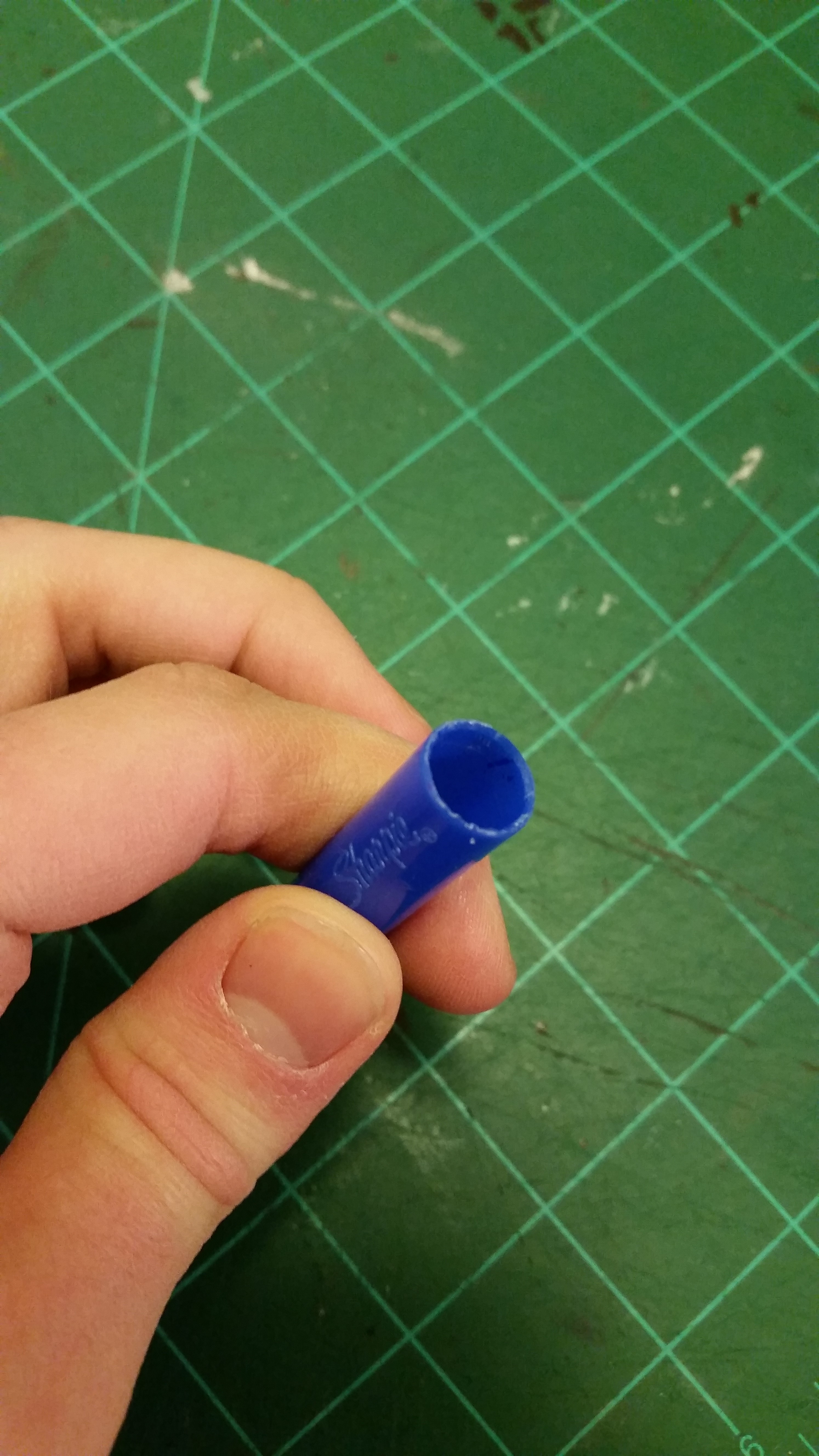

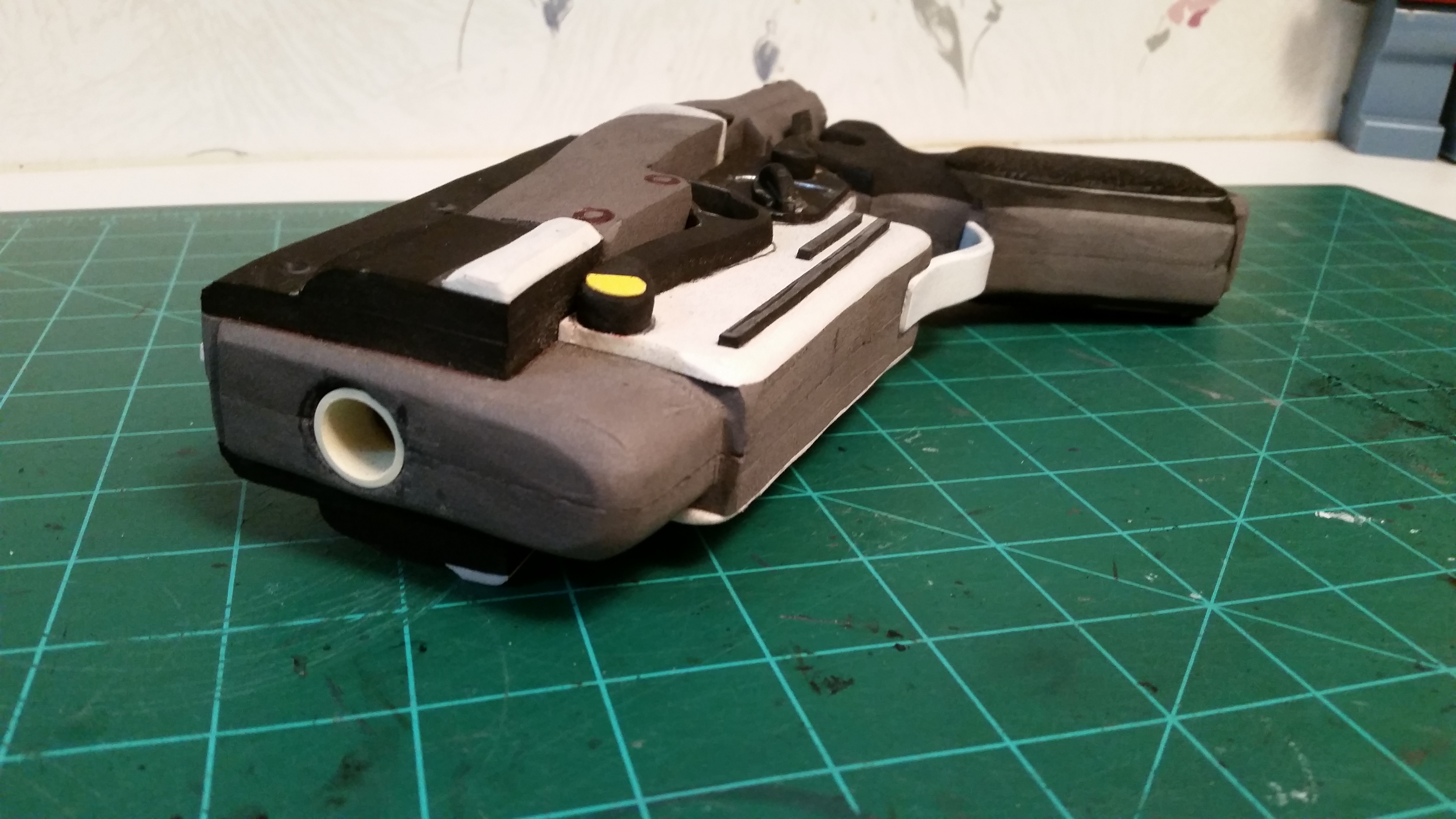

A hole was dremeled out for the barrel and then a piece of 1/2 cpvc was glued in.

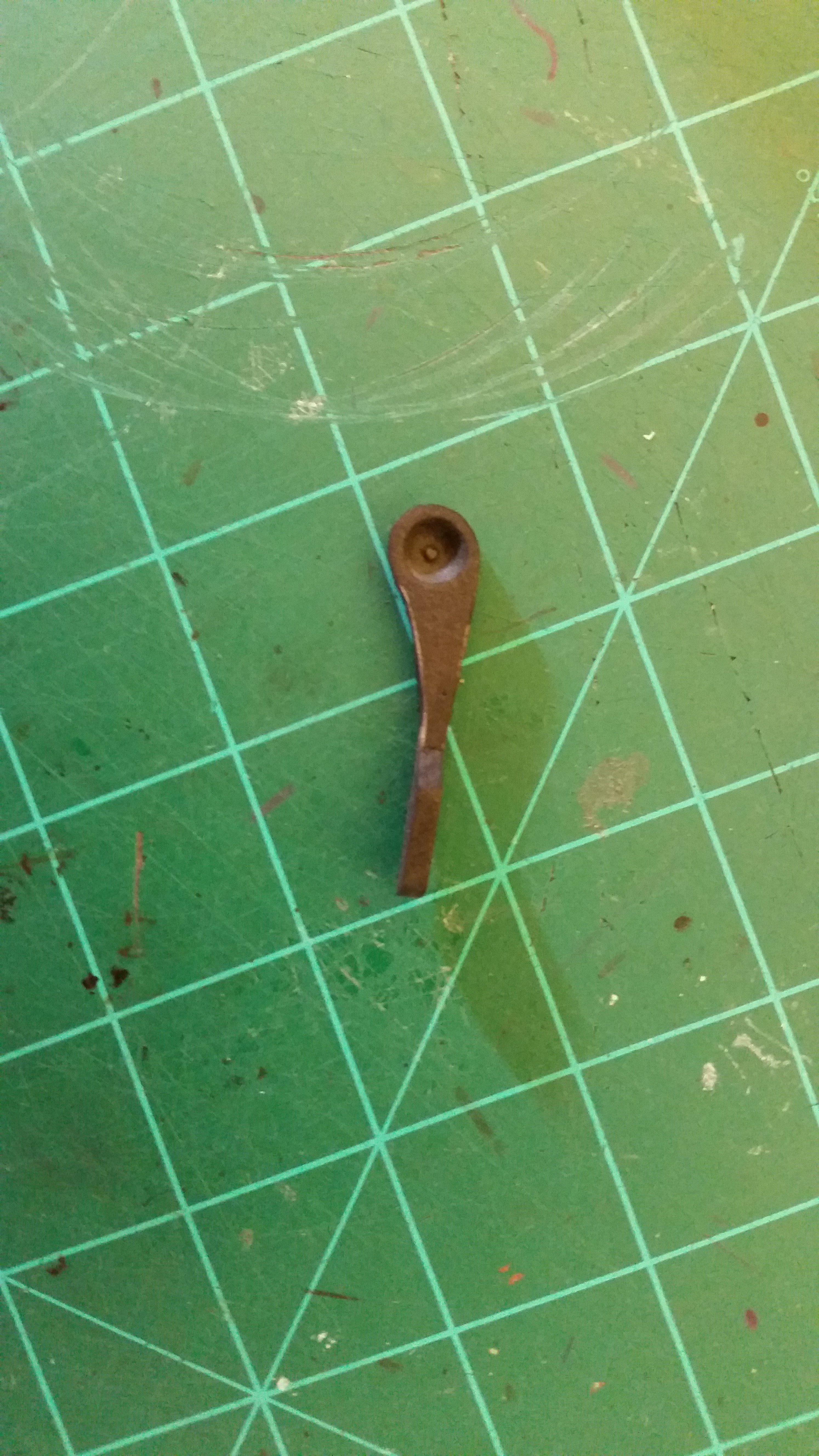

The Hammer is 2 layers of 6mm foam. I also dremeled out some details in the back here.

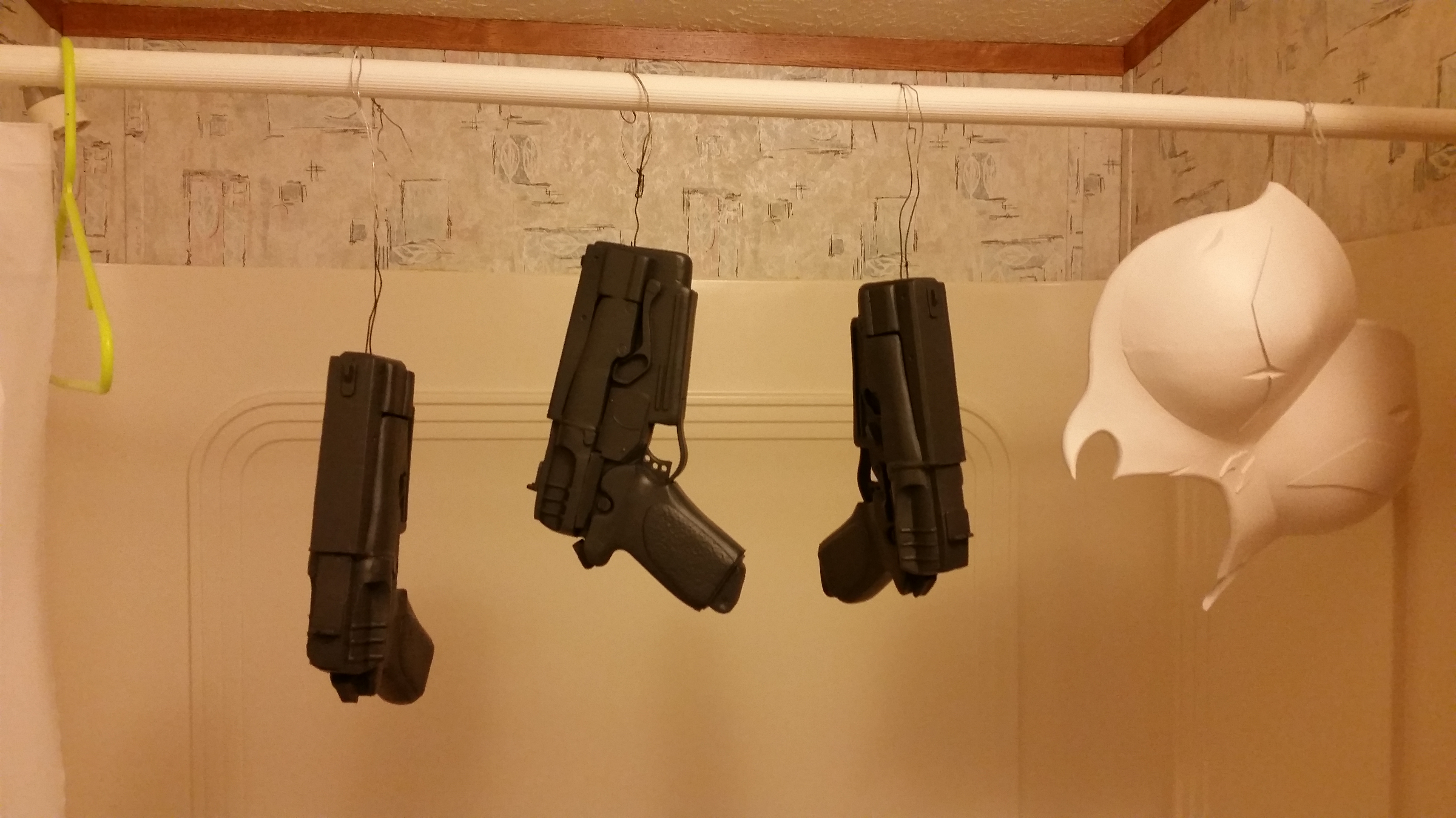

I just sealed these with Plastidip. Alternating grey and black. Here's my high tech drying rack. The shower.

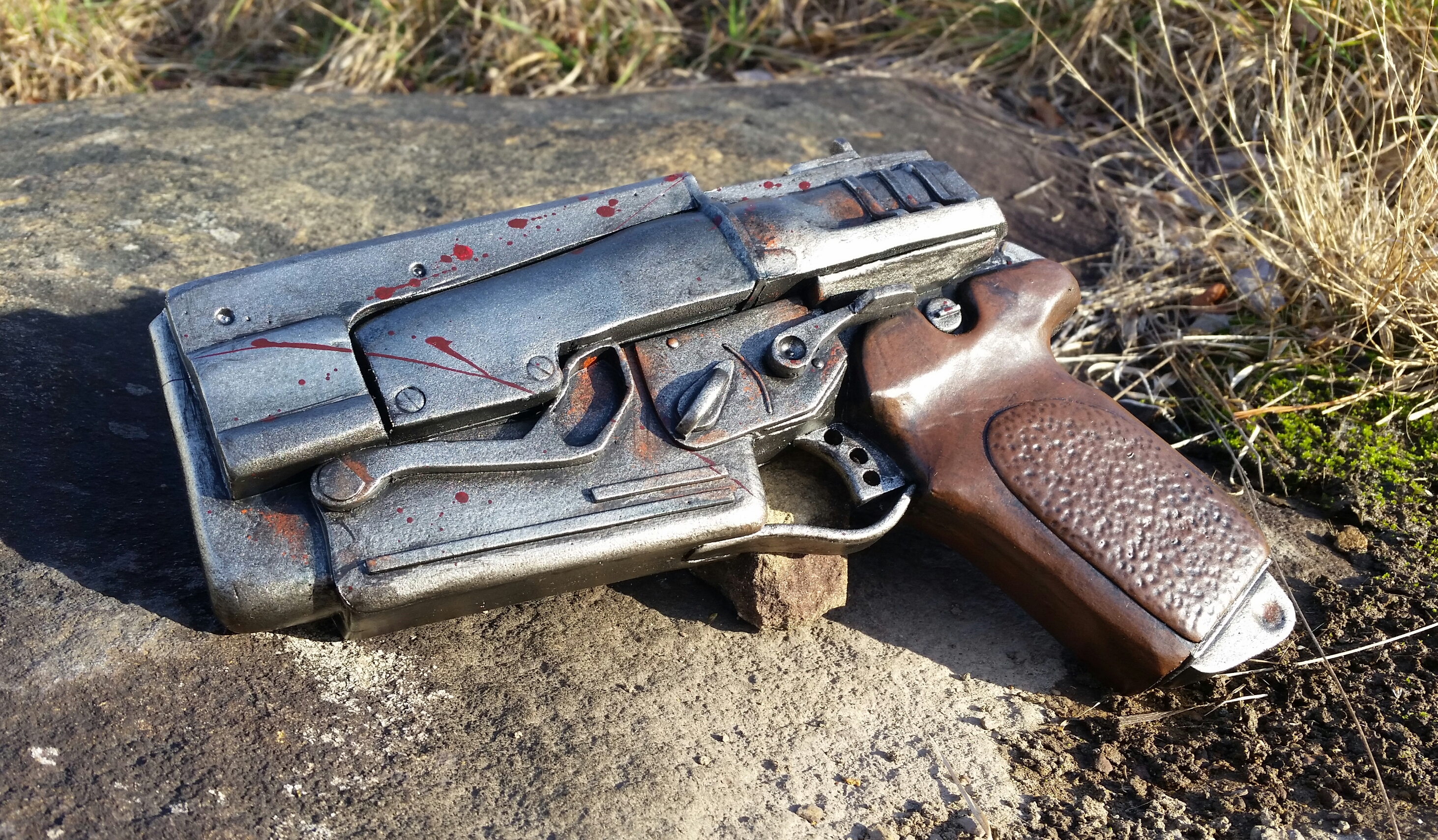

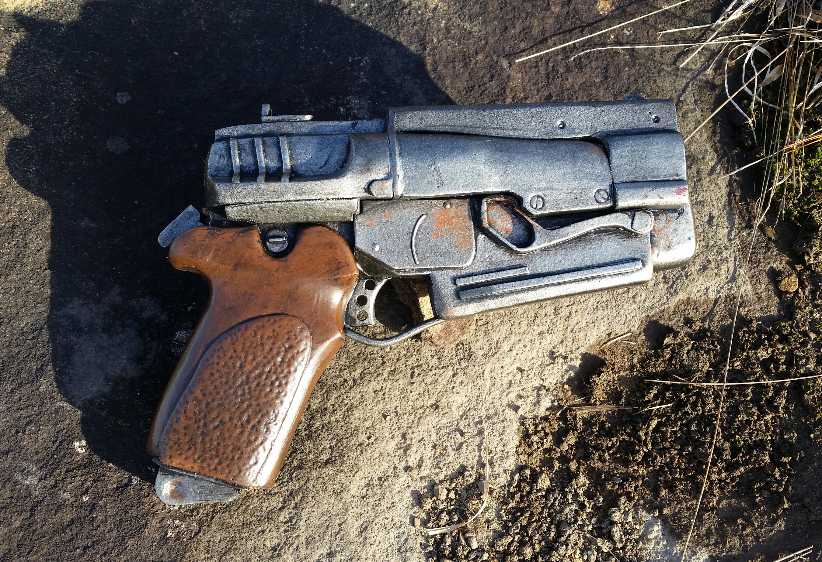

After Plastidip, I base coated it with a flat black rustoleum. For the silver I used Design Master: Modern Metals Champagne Silver. I like this silver, but this paint tends to have problems becoming cloudy and white. Sometimes warming the cans up in water helps, but not always. I usually just try to do very light coats and hope for the best. If anyone has recommendations for a dark silver or gunmetal, let me know!
The grip was painted with kyrlon leather brown. Then I clear coated with a flat clear coat. My preferred clear coat is Rustoleum.

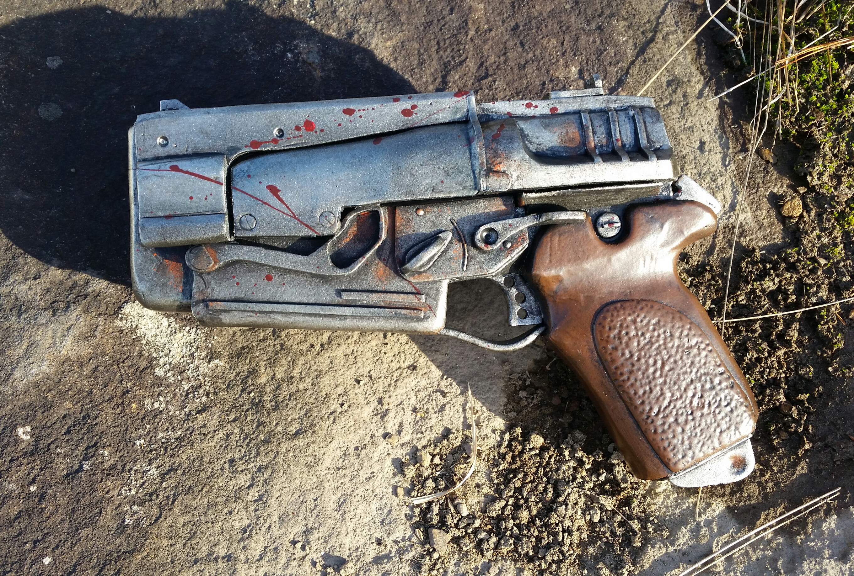

Then on to weathering! I forgot to take progress pictures for each stage of this, but basiccally I added black and dark brown washes to darken it up a bit (this is just some pianted mixed with water, slathered on the gun, and the most of it is wiped off). Then burnt sienna mixed with some brown for "rust". I also did a very dark blue (almost black) wash in a couple sections. Finally a bit of red for blood spatter. Then another coat of flat clear coat.
