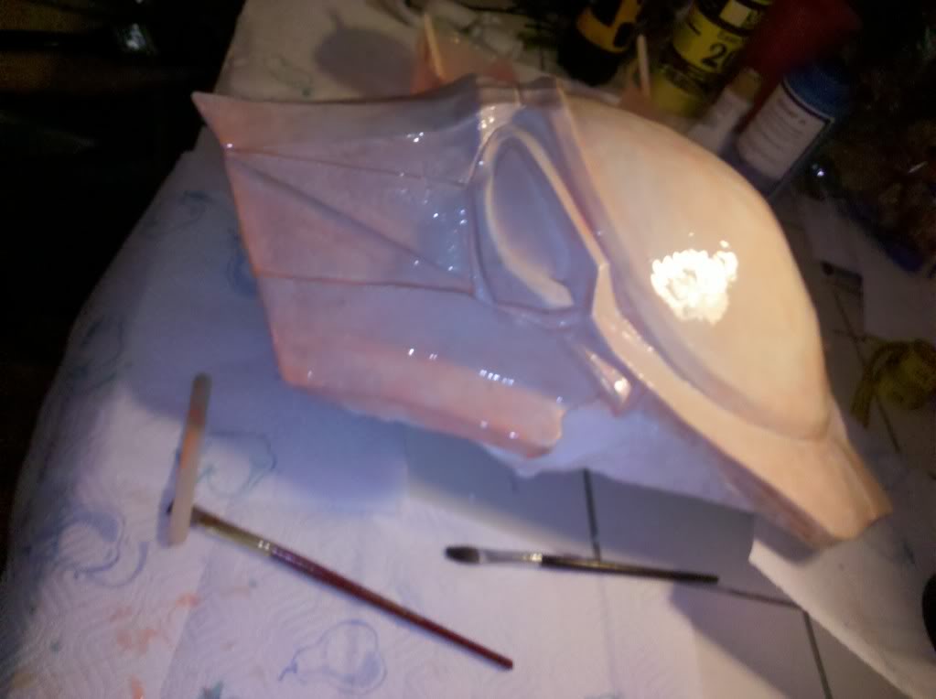

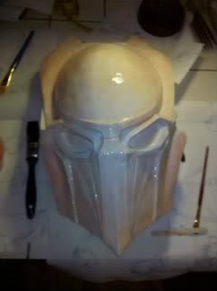

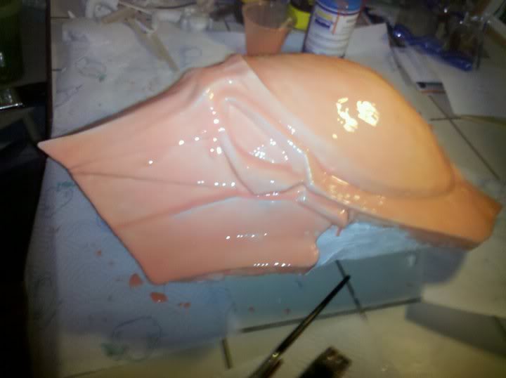

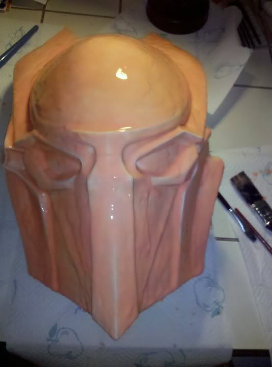

Here's my first layer, the detail/beauty coat:
Here you can slightly see the clay lip at the bottom of the sculpture.

Yea, I plan on doing more then one. Plus, the gallon is only $50 more then one trail kit too. But, somehow my layers aren't looking at thick as yours does. Perhaps I'm not putting enough silicon on, but there are some deep undercuts and spots on the bio though too.
Third layer added, same as layer two. I'm going to add the thickener to the fourth layer too and fill in the undercuts, eyes, and other area's that might make getting the mother mold off difficult. I'm going to prep the keys too, but I think I may add them on during the forth layer though.
I think the flash and overall lighting may make the look like the silicon isn't that thick?

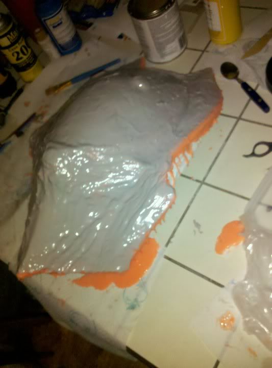

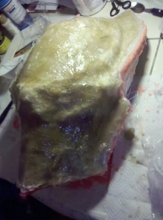

The Rondo layer is added. I'll let it cure for about 1.5 to 2 hours [it says 30 min. cure time for the bondo and 1.5-2 hours for resin]. The matte layer is next, then a little bit of the rondo again and I'm done.
how thick did your silicone end up being?
I think around a 1/4" thick. I put on the fiberglass last night and coated that with resin today, so I'll know for sure later today. I'm kind of nervous if both molds are thin. For some reason I always believed that both molds had to be really thick. I'm going to be ordering my resin today, and I'm using Smooth-Cast 320. I couldn't find the pigment on their site, so I think I'll just go pigment-less and go with the white. That and I don't think it's a major issue as far as the color of the cast. It will be primer, painted, etc... I could be wrong though.

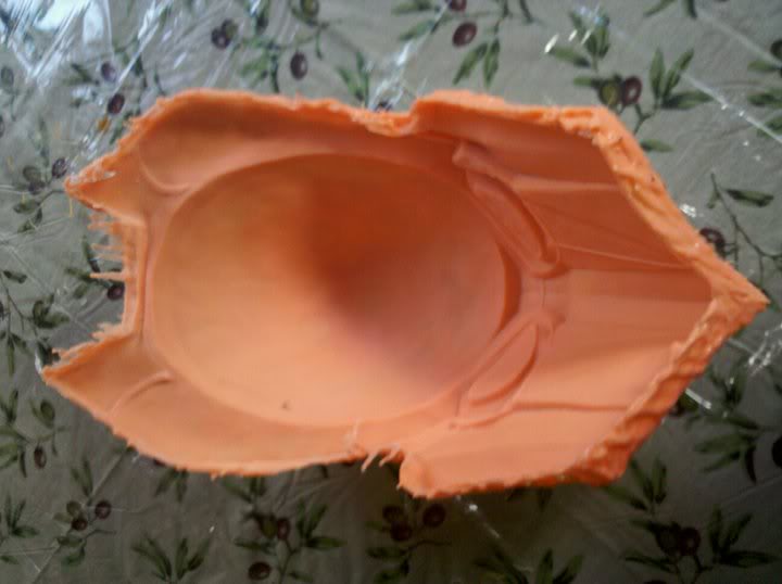

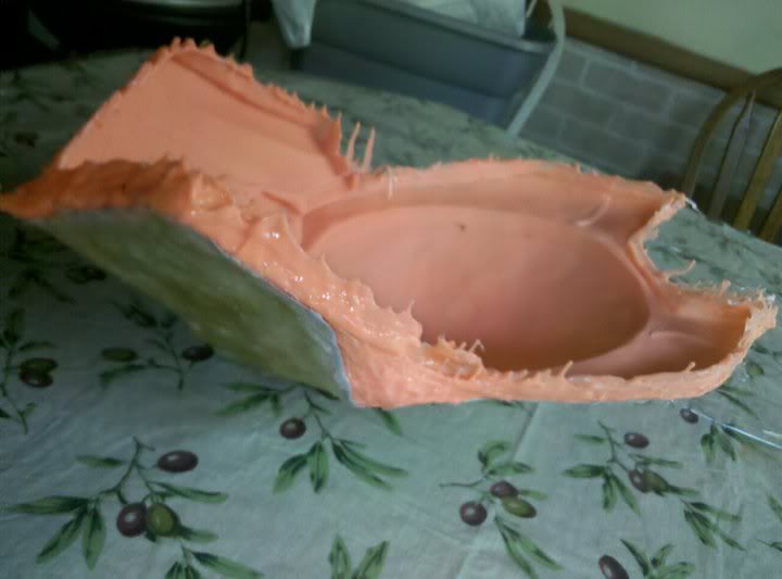

It's all complete, mold done. Both molds turned out thinner then I wanted it to be, but when the silicon mold is in the mothermold, it seems like it will be fine. Next time I mold a bio, I'll make sure that the molds are thicker. Although I do remember reading somewhere [or maybe on the Smooth-on video] that the recommended thickness is 3/8"?
Everything turned out okay and the detail looks good in the silicon mold. There weren't any spots where it got either mold got hung up and after working it with a long screwdriver, the mothermold popped off. I did find out what a "pigs ear" is in fiberglass though. lol But overall both molds look okay to me. I'm still nervous until I actually cast one up, but I'm happy as hell that I finally molded it the bio and have my first mold ever.
Big thanks to hez for all the help and answering a ton of questions!!!
On to the pics.
With the mothermold on, before I took it off.
Silicon mold inside the mother mold.
Another angle.
I imagine with the silicon being rubber, that it isn't that firm leading to the "pancake" flip flop it does outside the mothermold.
