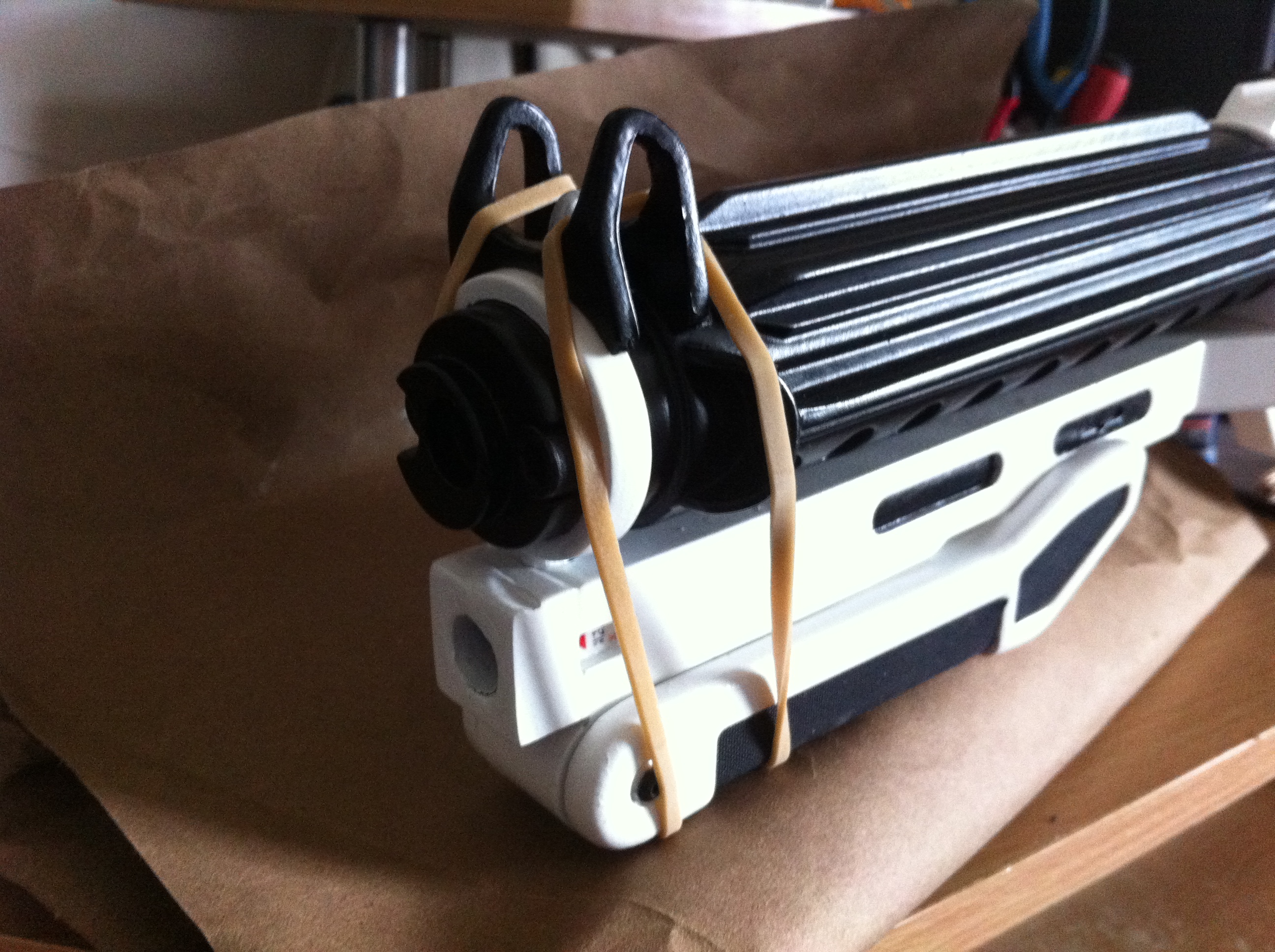

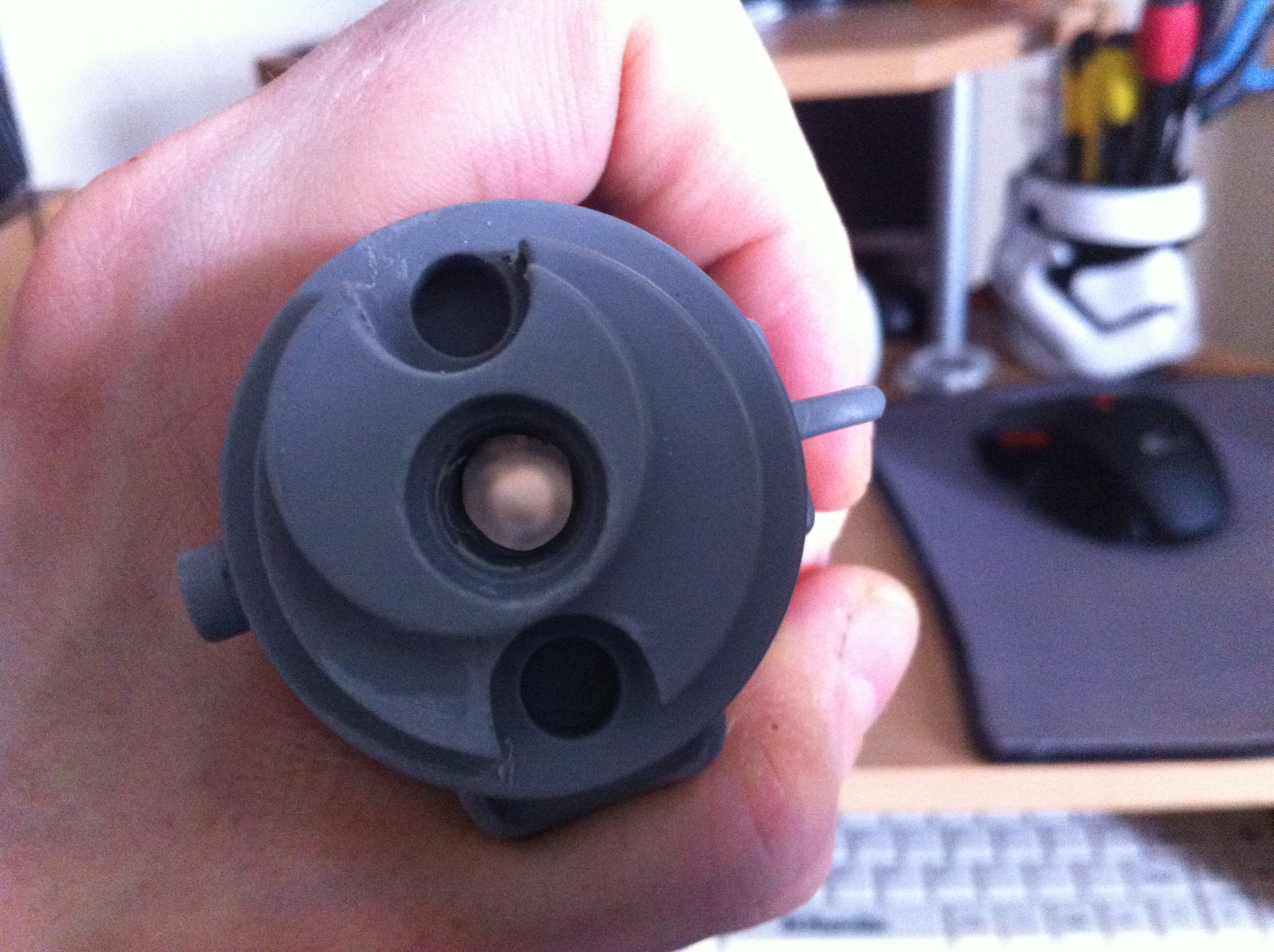

I did not cut off the end of the barrel, I was drilling holes as shown on the picture View attachment 616061 View attachment 616060
Then I grab a long rod and put it in the front of the barrel (first pic) and literally hammered the plug out. (do not drill the plug out from the front, just the barrel)
I hope it is understandable... and sorry about my english Im a hungarian.

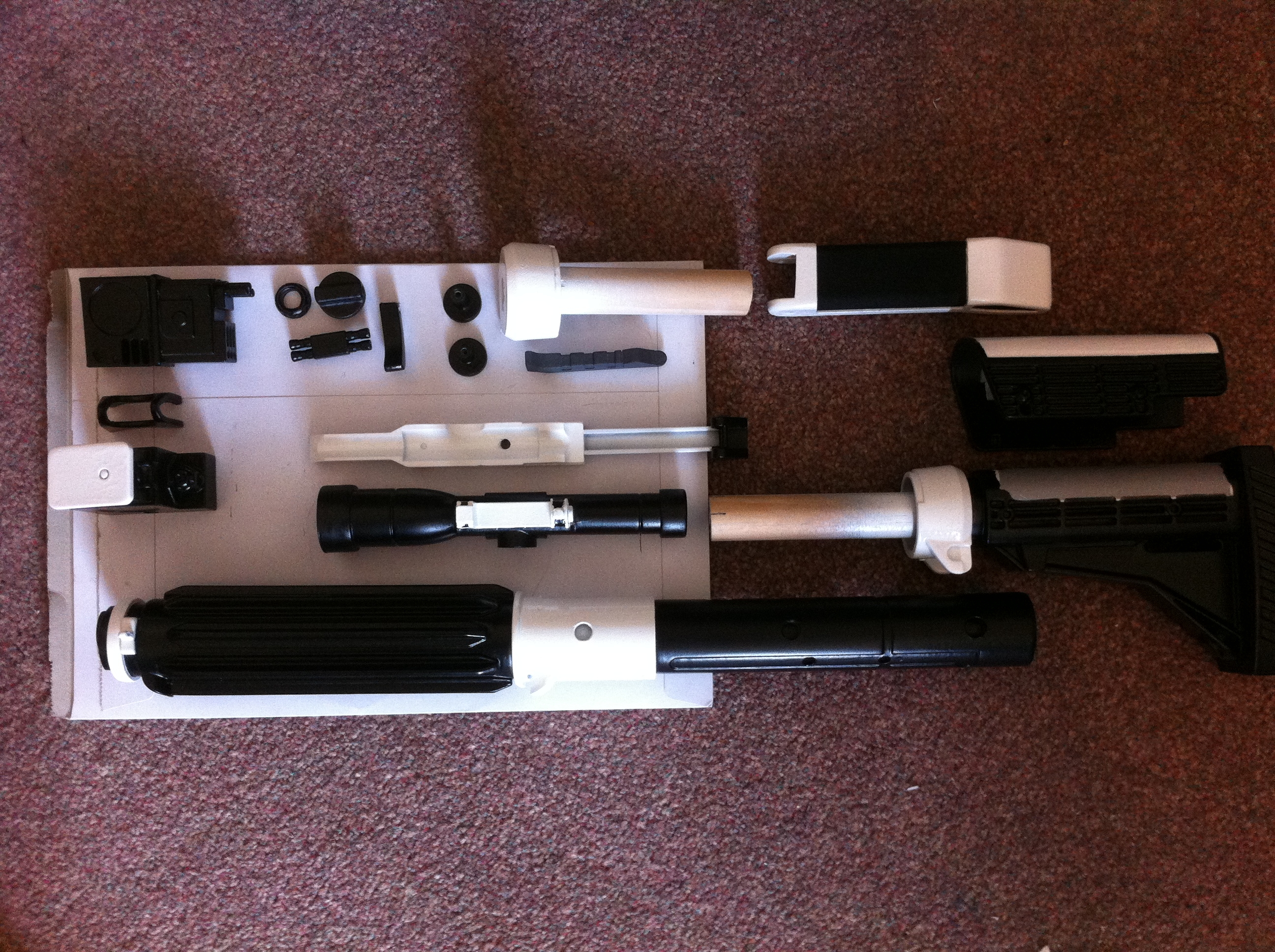

Your English is perfect! Thank you for all of the information. The hammering is a great solution, I look forward to watching your progress. So far I've only trimmed and loosely fit mine together. Now I am modding it a bit with auto body filler. I also am using magnets to fit some of the pieces together
Here is my progress so far:
I put some long screws through the stock from side to side to make it more accurate.

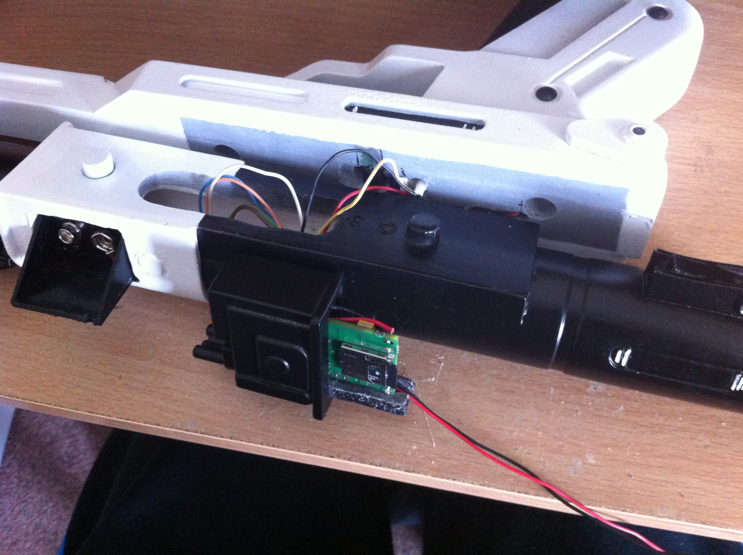

I'm back and I finished the electronics.
First put the trigger and selector button in place, I used green stuff (epoxy clay) for the selector and hot glue for the trigger.
Then I added the crews as well.
IMG_1423.JPG IMG_1427.JPG IMG_1428.JPG IMG_1430.JPG IMG_1435.JPG IMG_1436.JPG

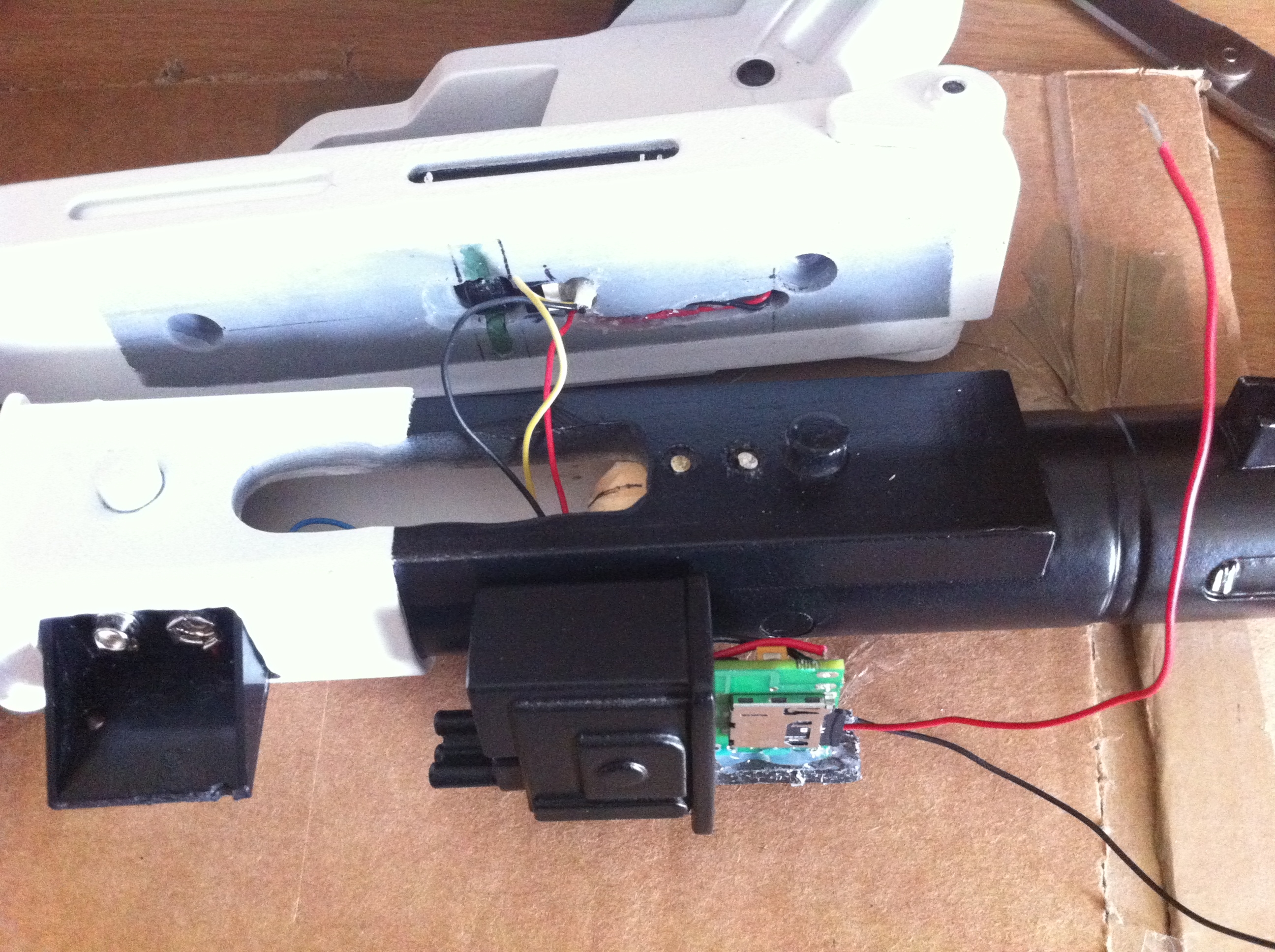

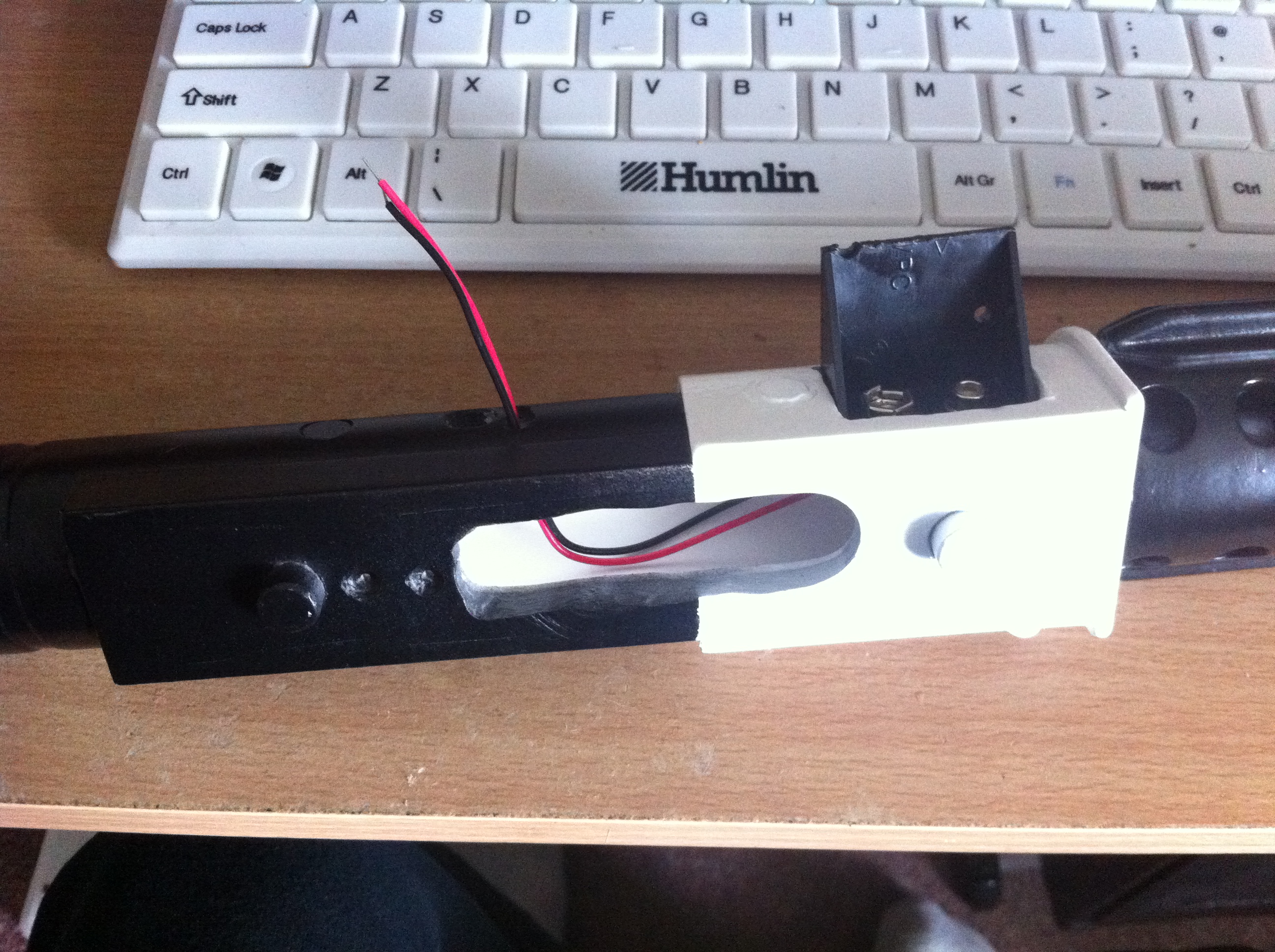

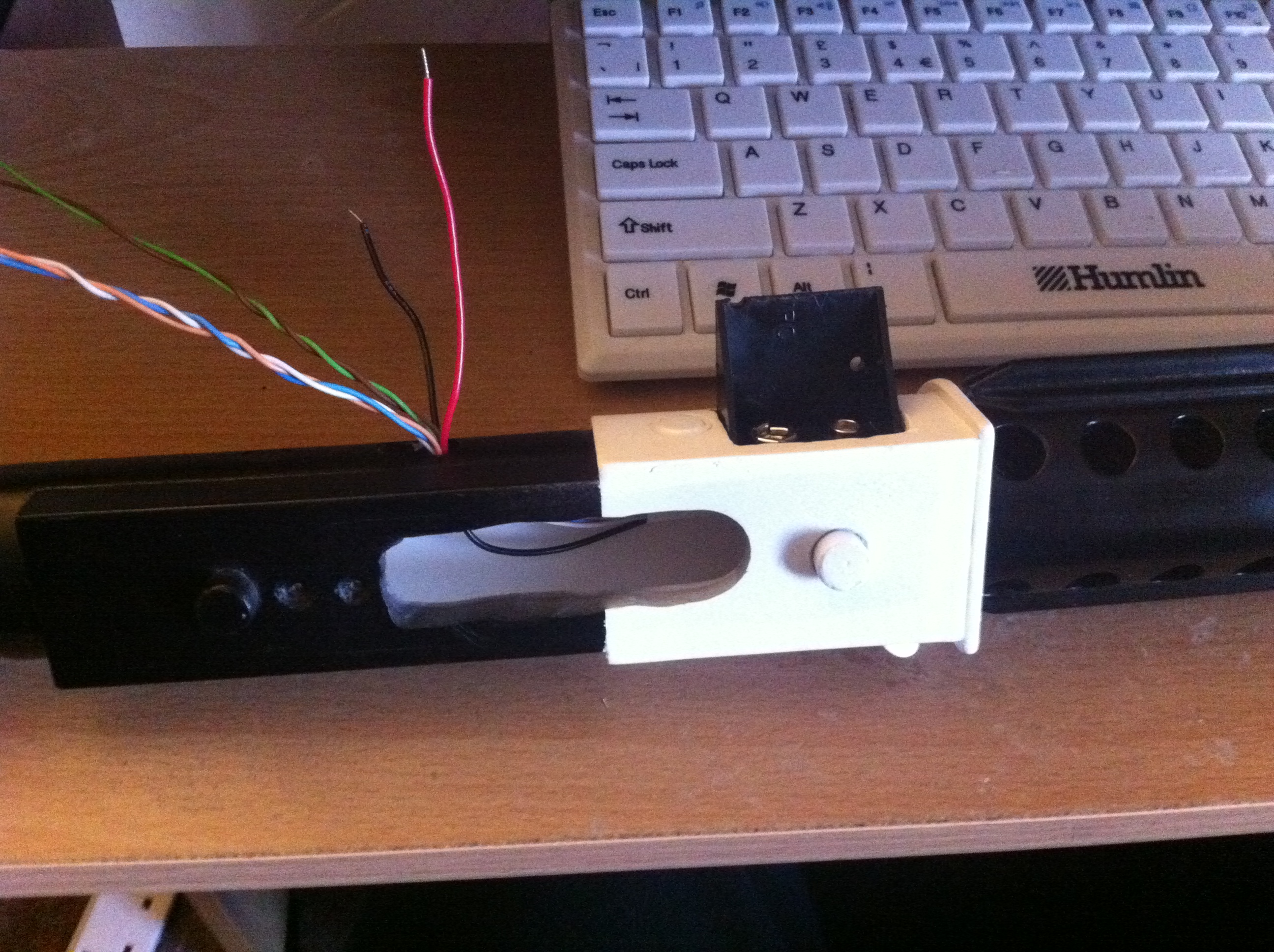

Next step the led and speaker install in the chassis. Glue the battery holder.
Place the wires to the right place.

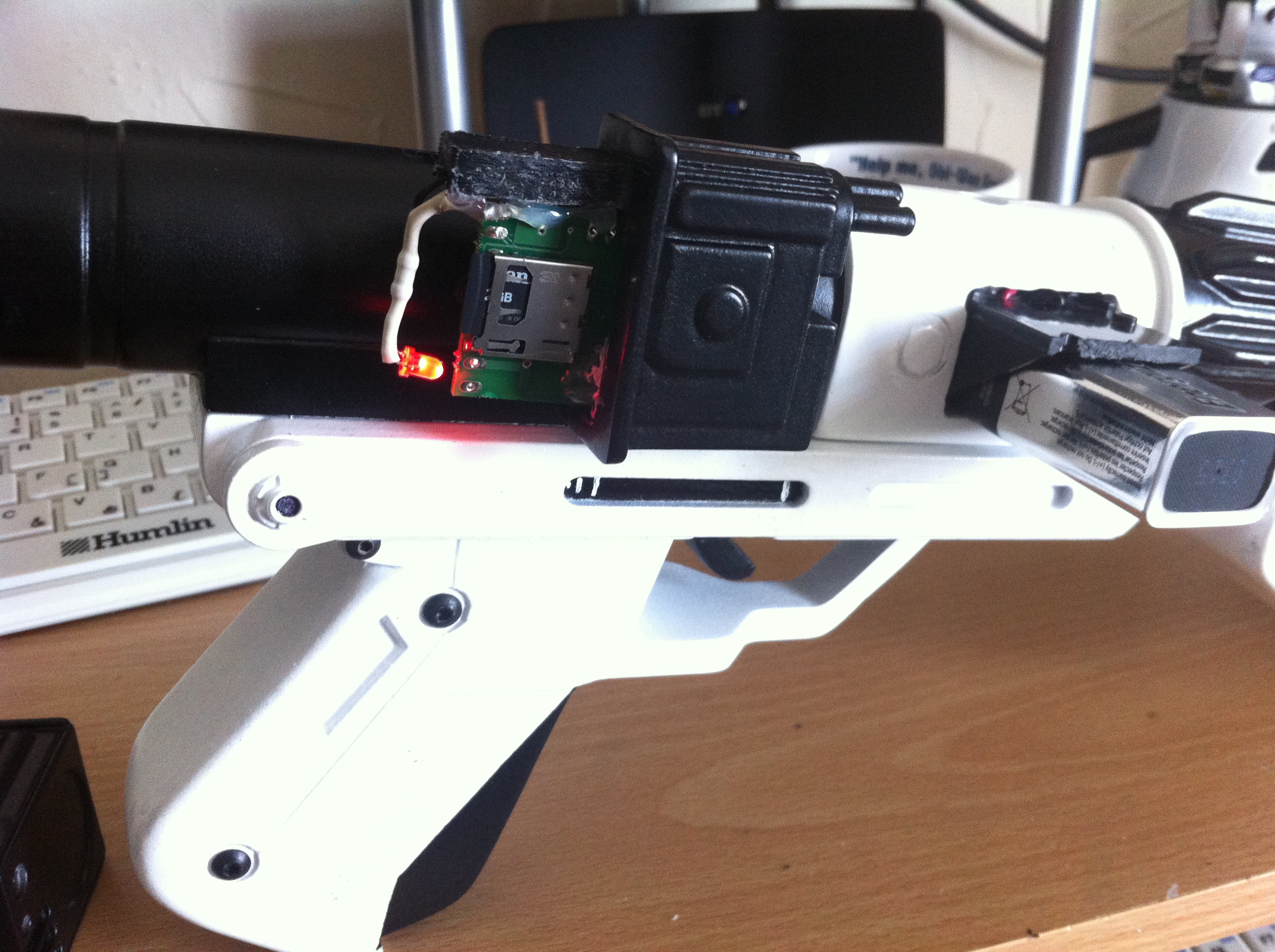

Begin soldering and testing. Then put the plug with the magnet in place. (that's gonna hold the buttstock)

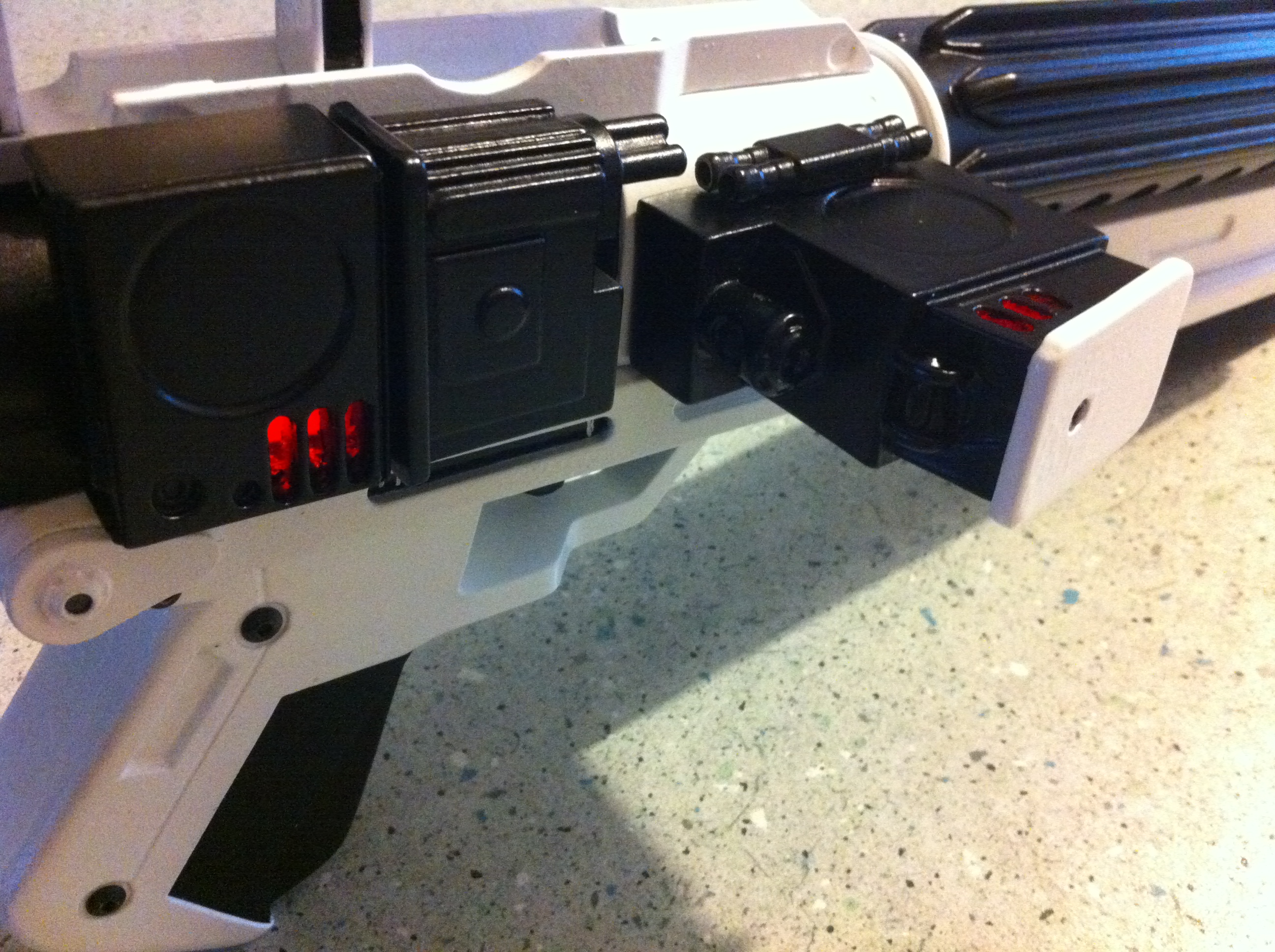

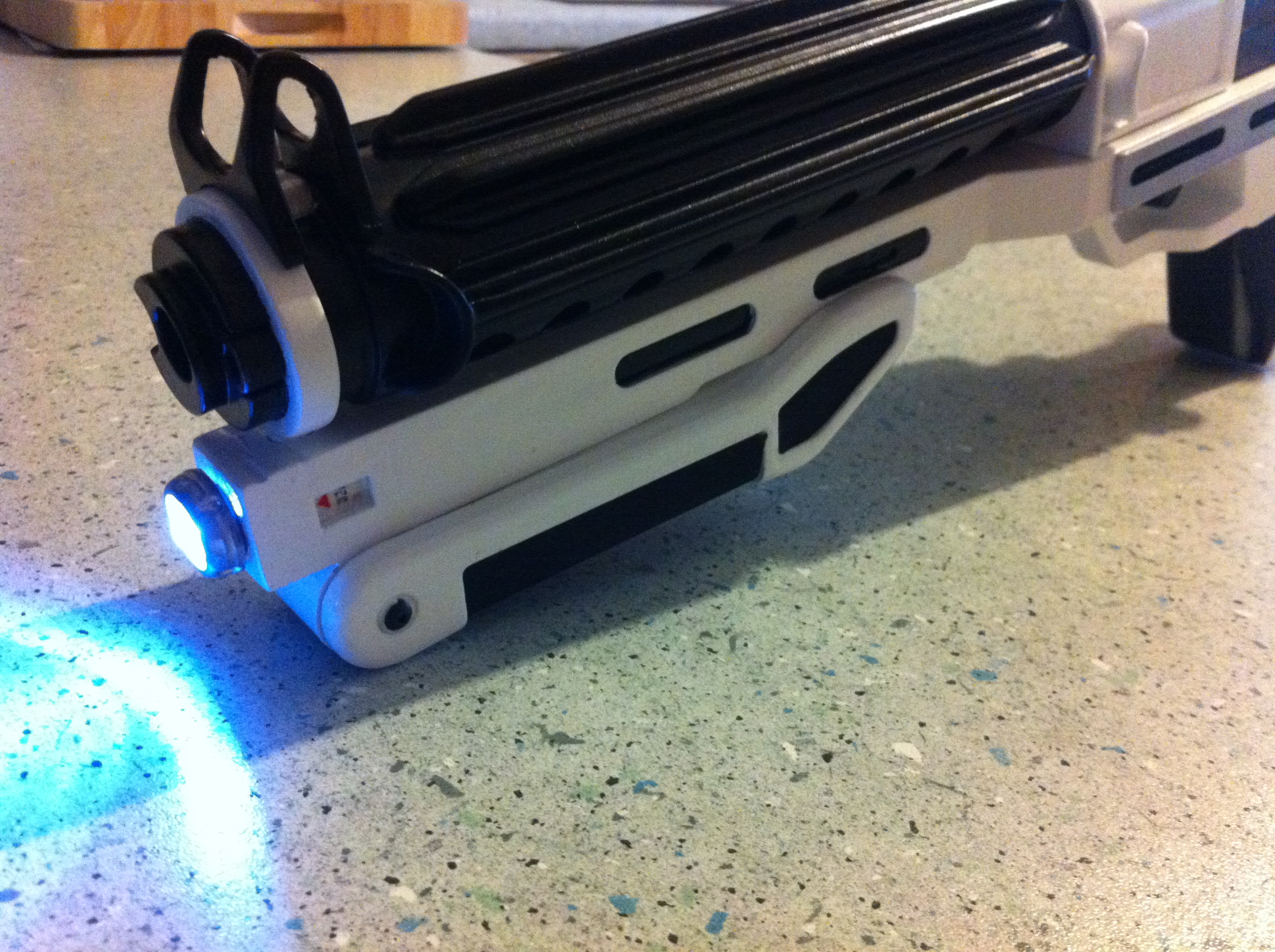

I need to do something with the red led in the counter to make it bright. But I'm happy with the result, the weapon is working perfect and it is very loud.

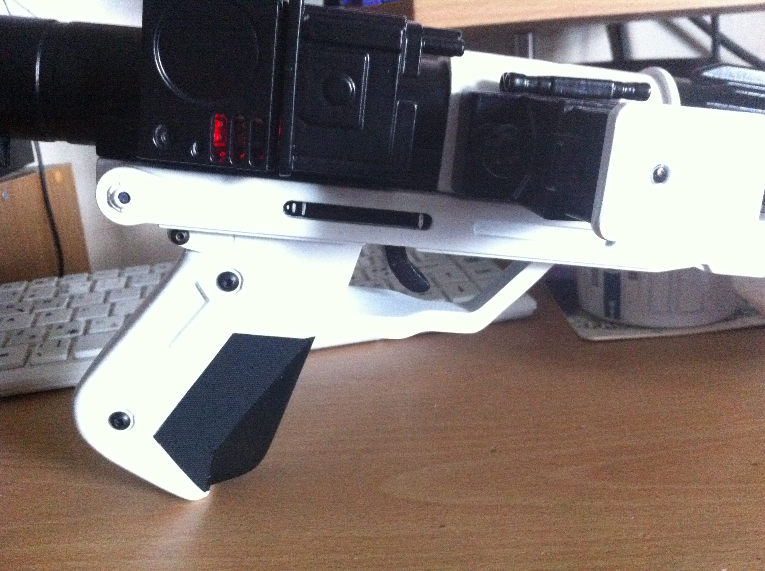

Finished the grip as well.

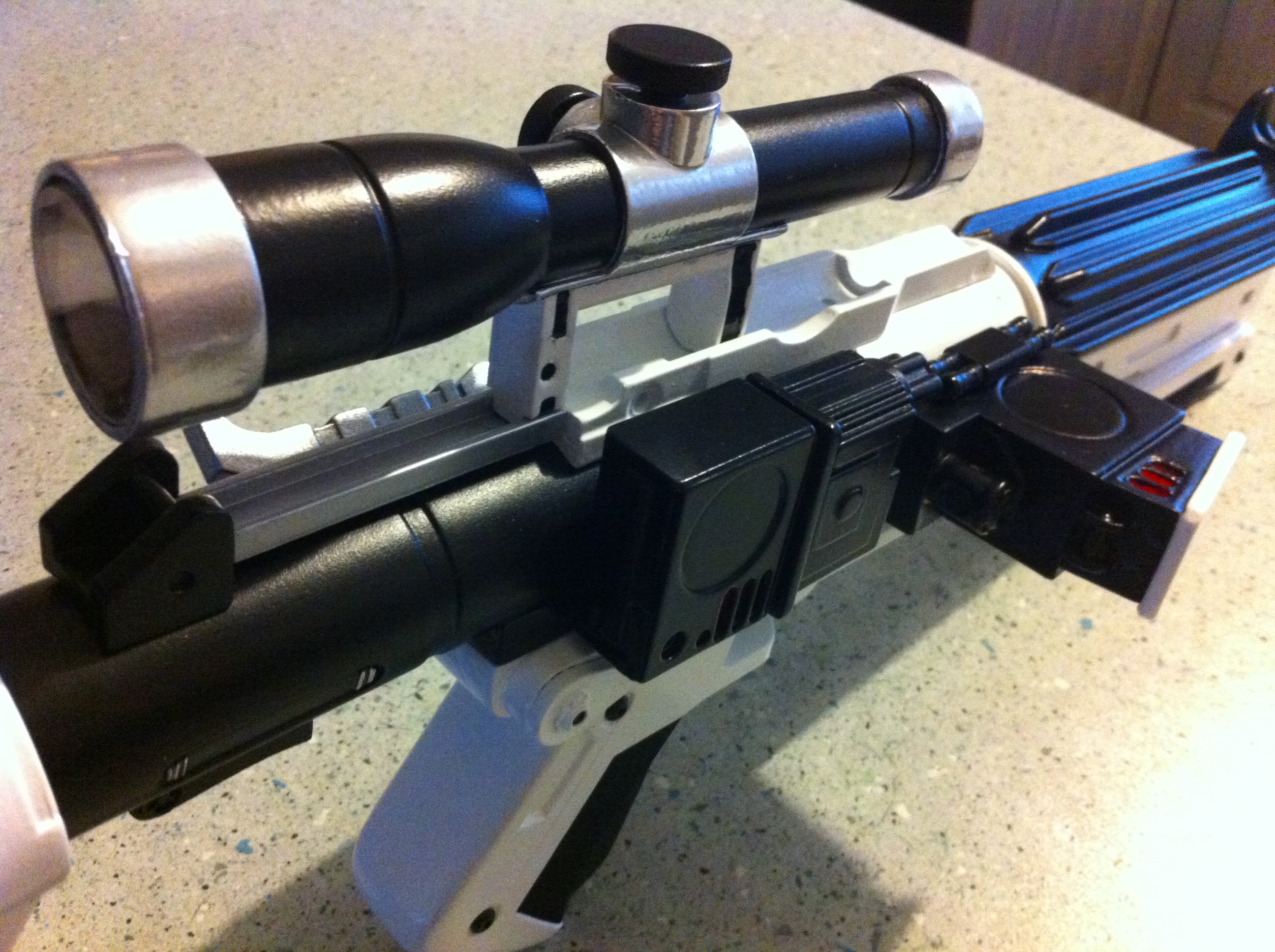

Next step to put on the greeblies, the front flash light and the scope.
Gyurma
Re: F-11D Blaster kit modification for BlasterCore electronics
Made some stickers, with double sided tape and I printed out some details on see through foil. Not perfect but it will do it for me.

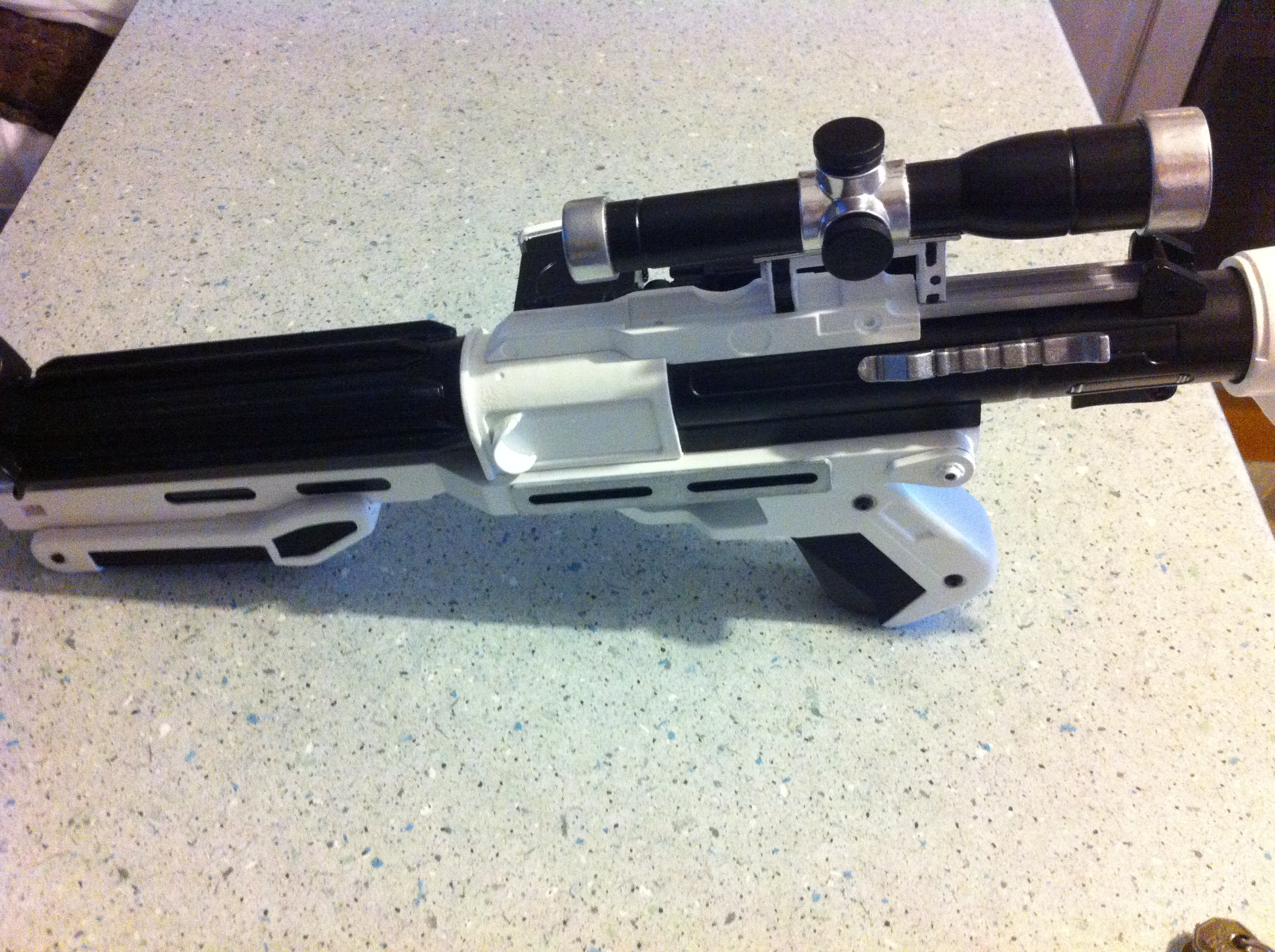

More masking and painting.

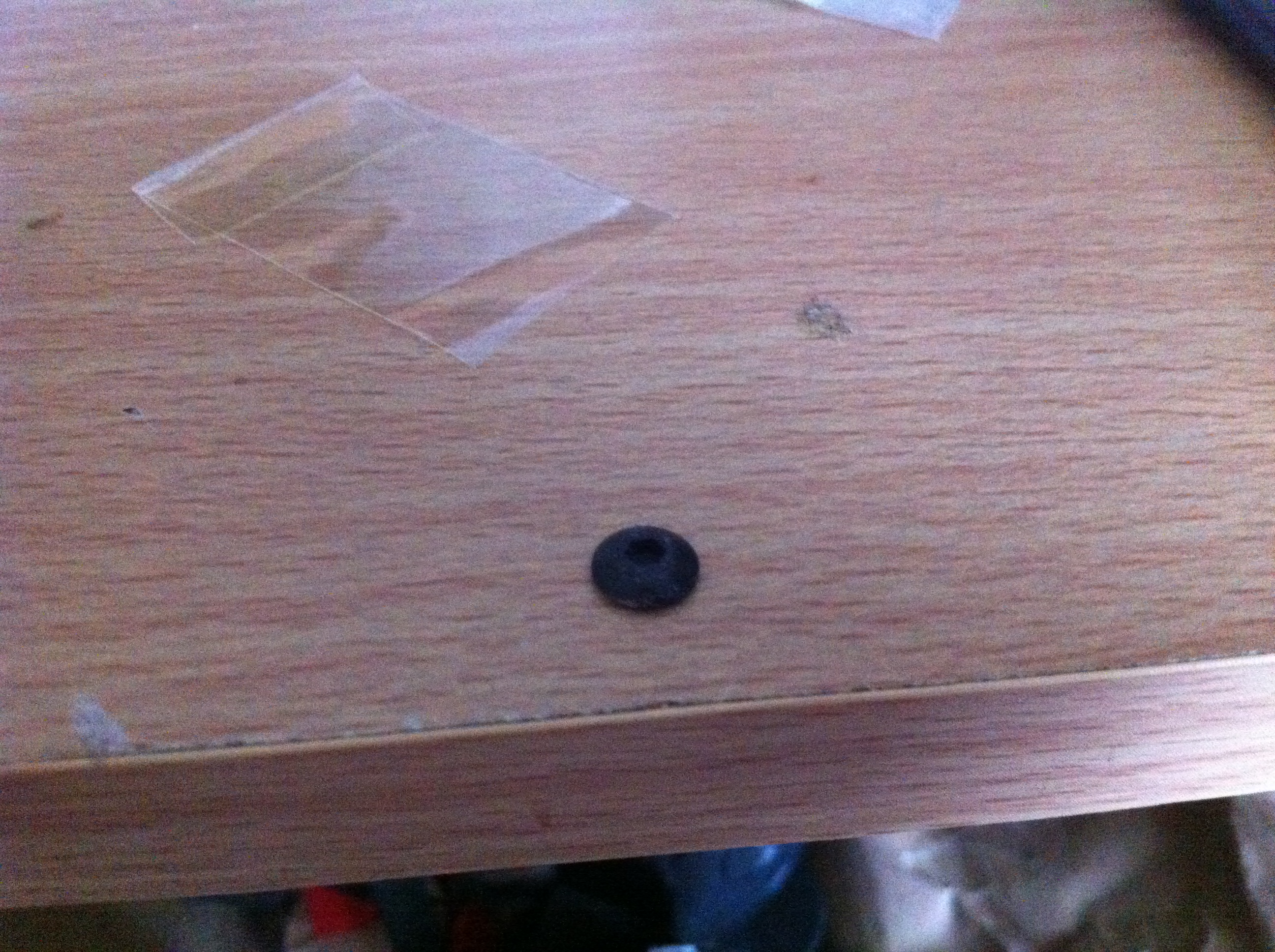

Cut off one of the screw. This gonna hide the selector/reload switch

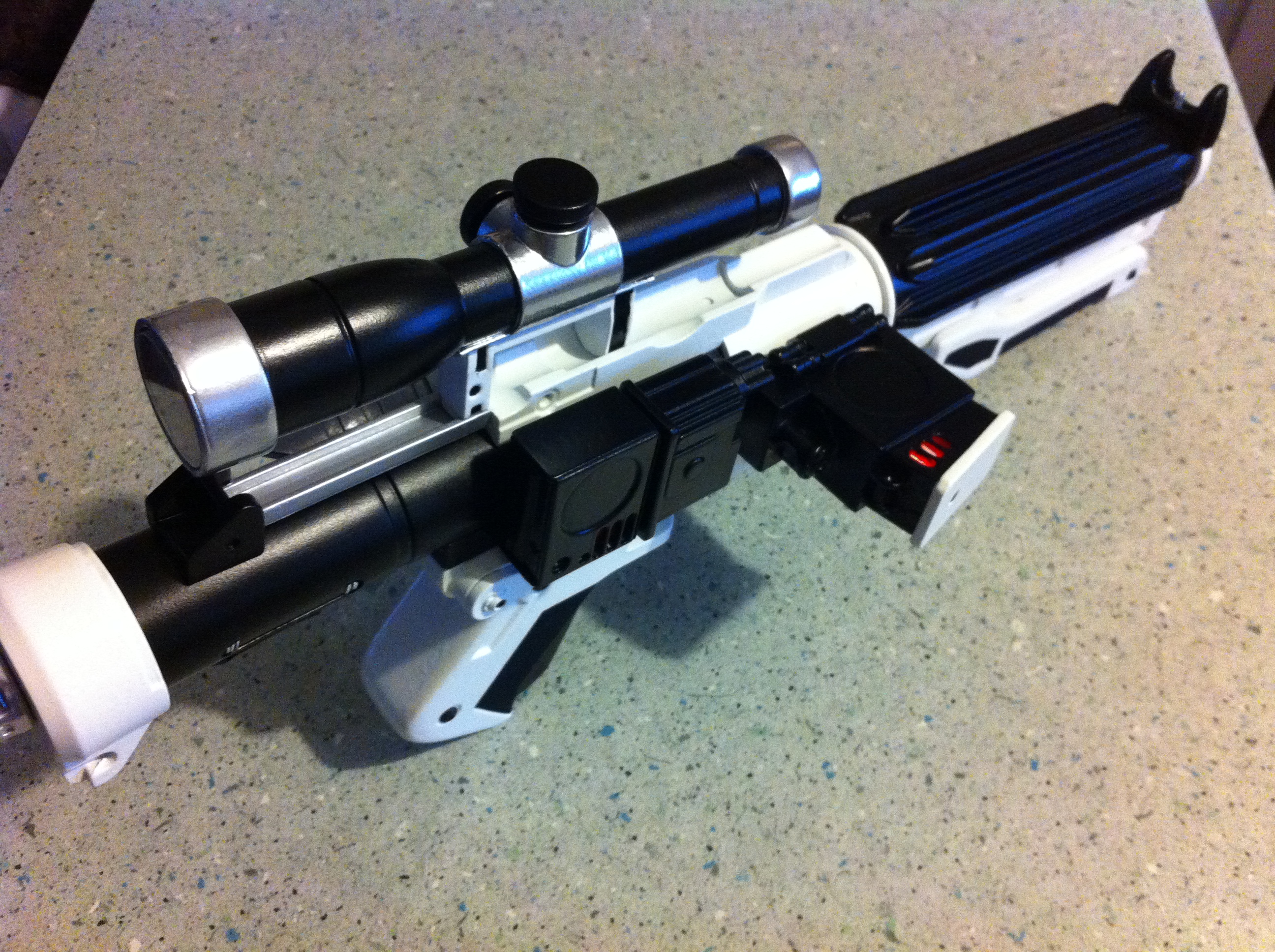

More glue and decals.

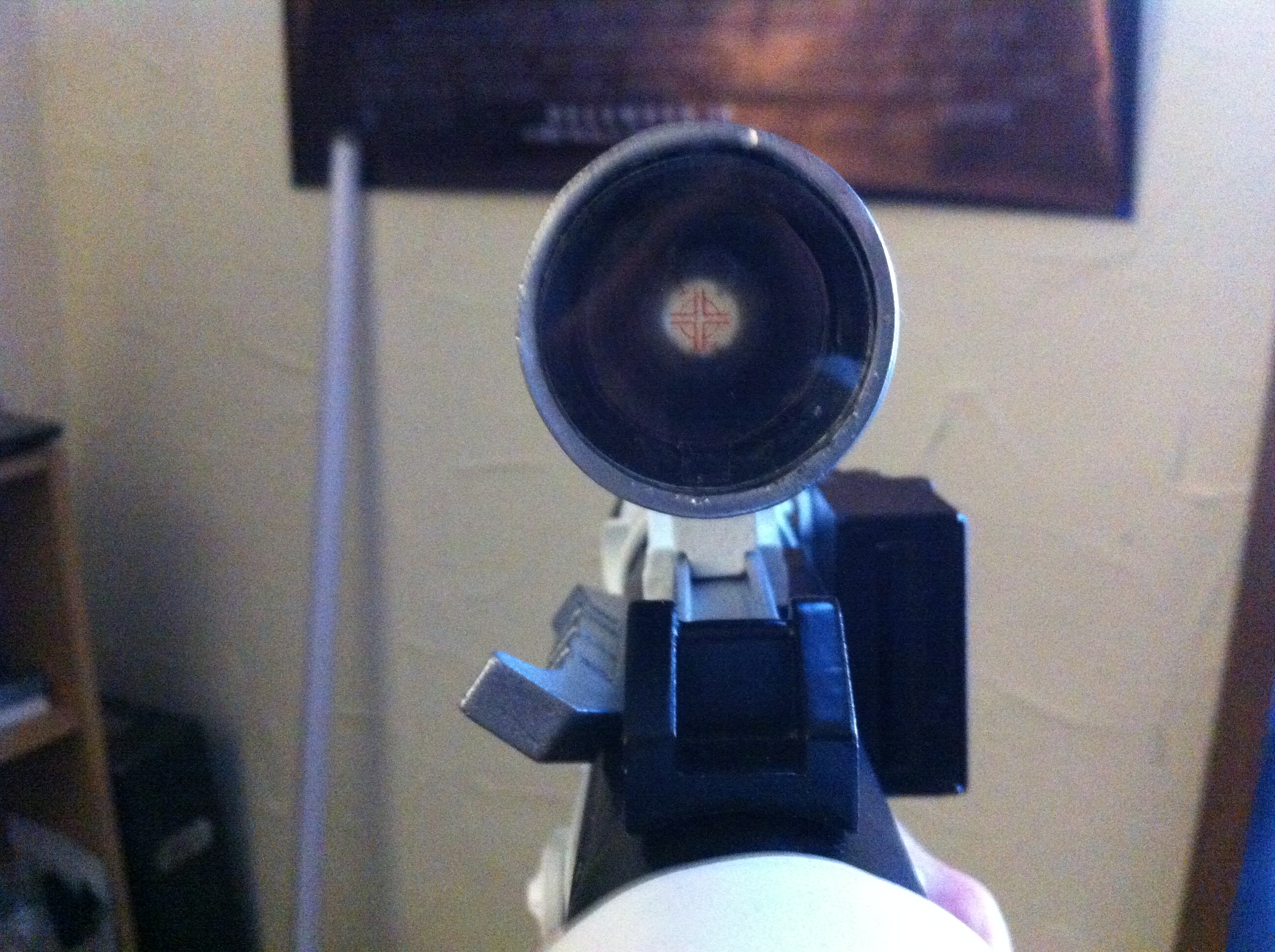

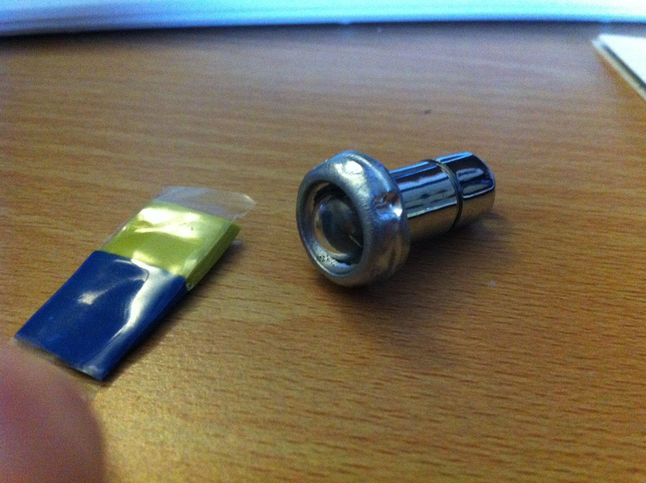

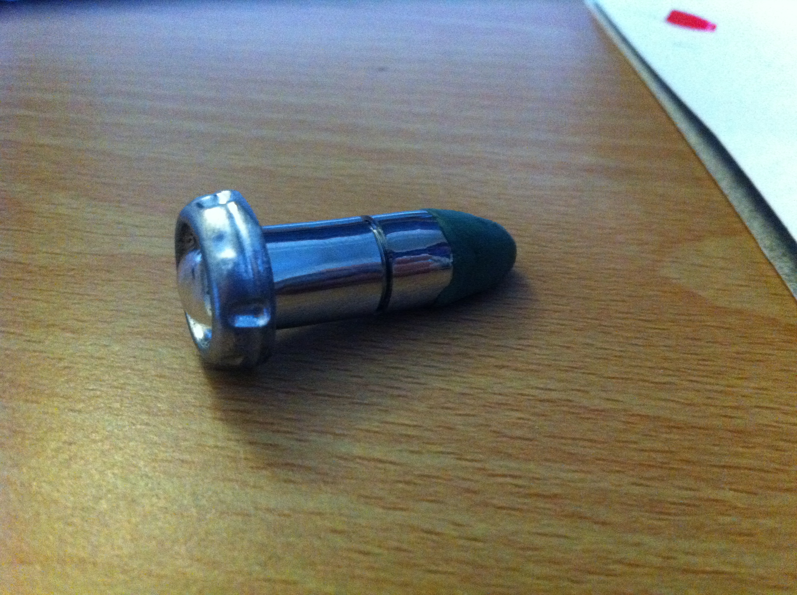

Install the target light with green stuff.
Very nice, well done! Is the black flat or satin, and is the silver an aluminum coat or something with a little more chrome in it?
Gyurma

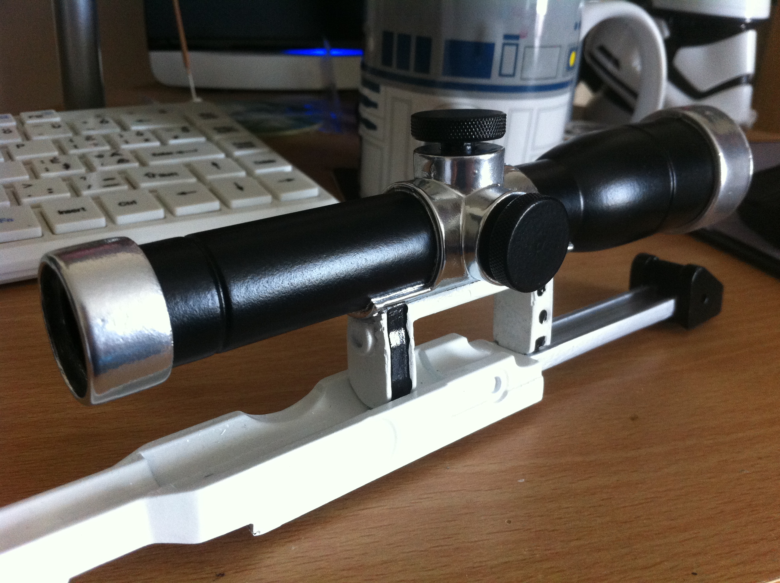

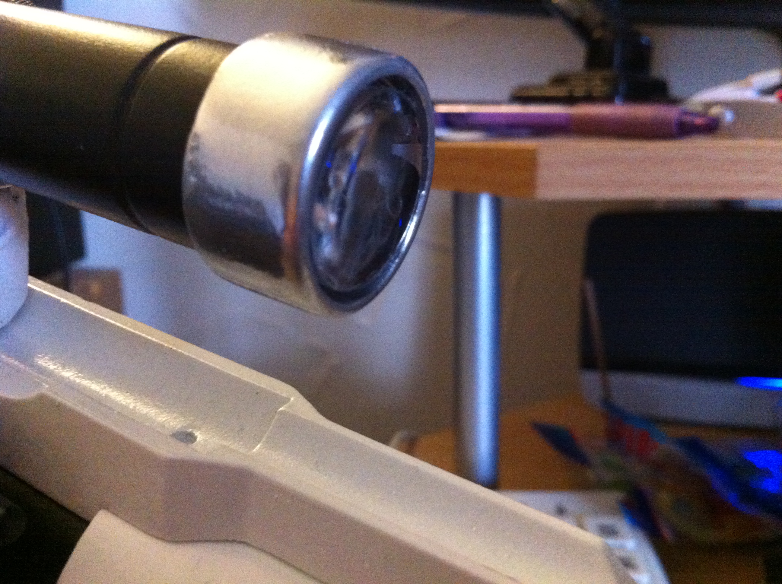

I used this for the whites...
and this for the black, the chrome is a chrome spray paint... avoid it! It is looking nice, but I was painting the scope 5 day ago and it is still come off when I give a wipe with cloth. Also I tried to put protective coat on it but it turns grey. The rest of the metal paint is rub n buff.
Next step to make video from the working thing. :D

Gyurma - Question for you buddy!

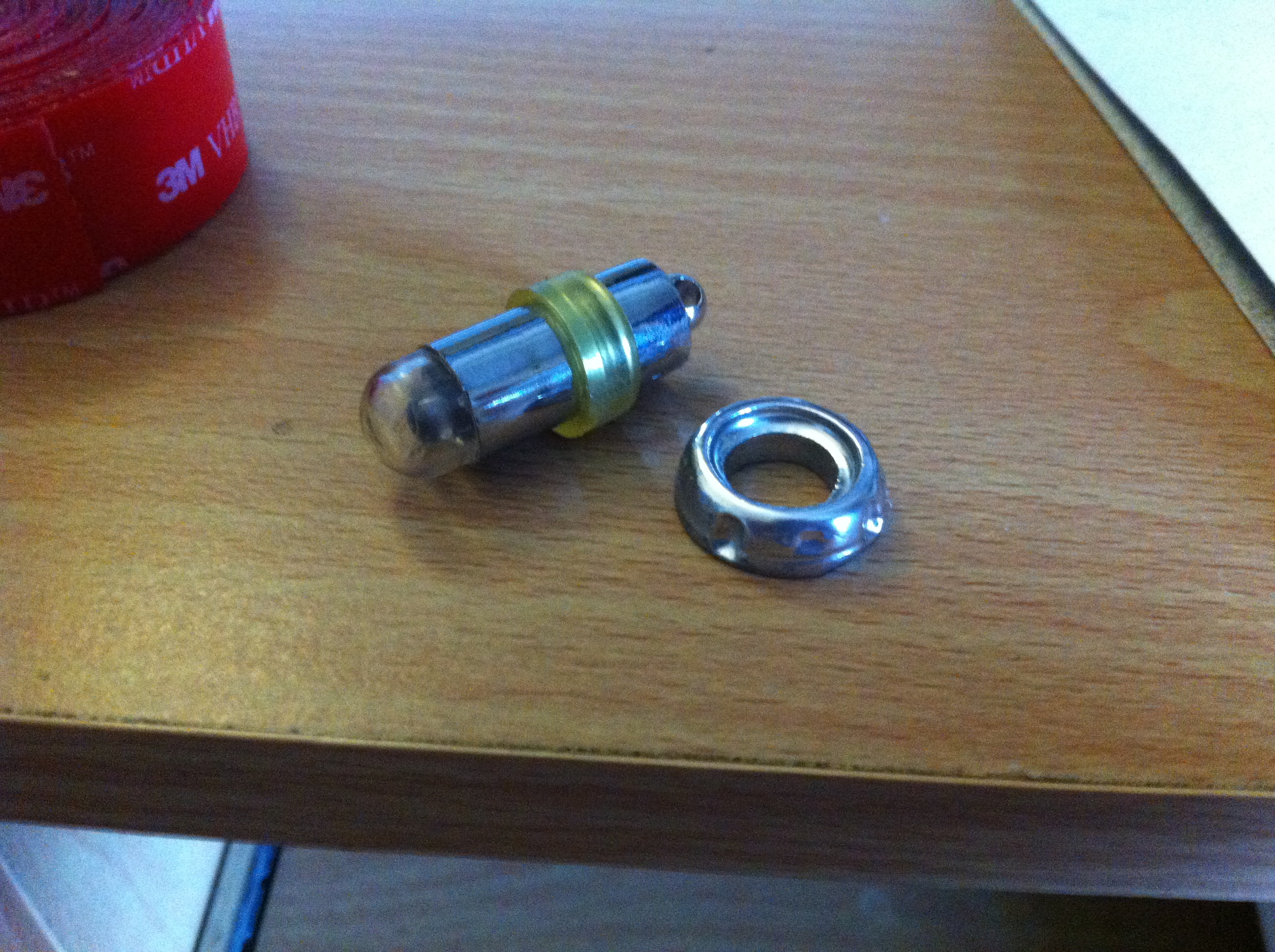

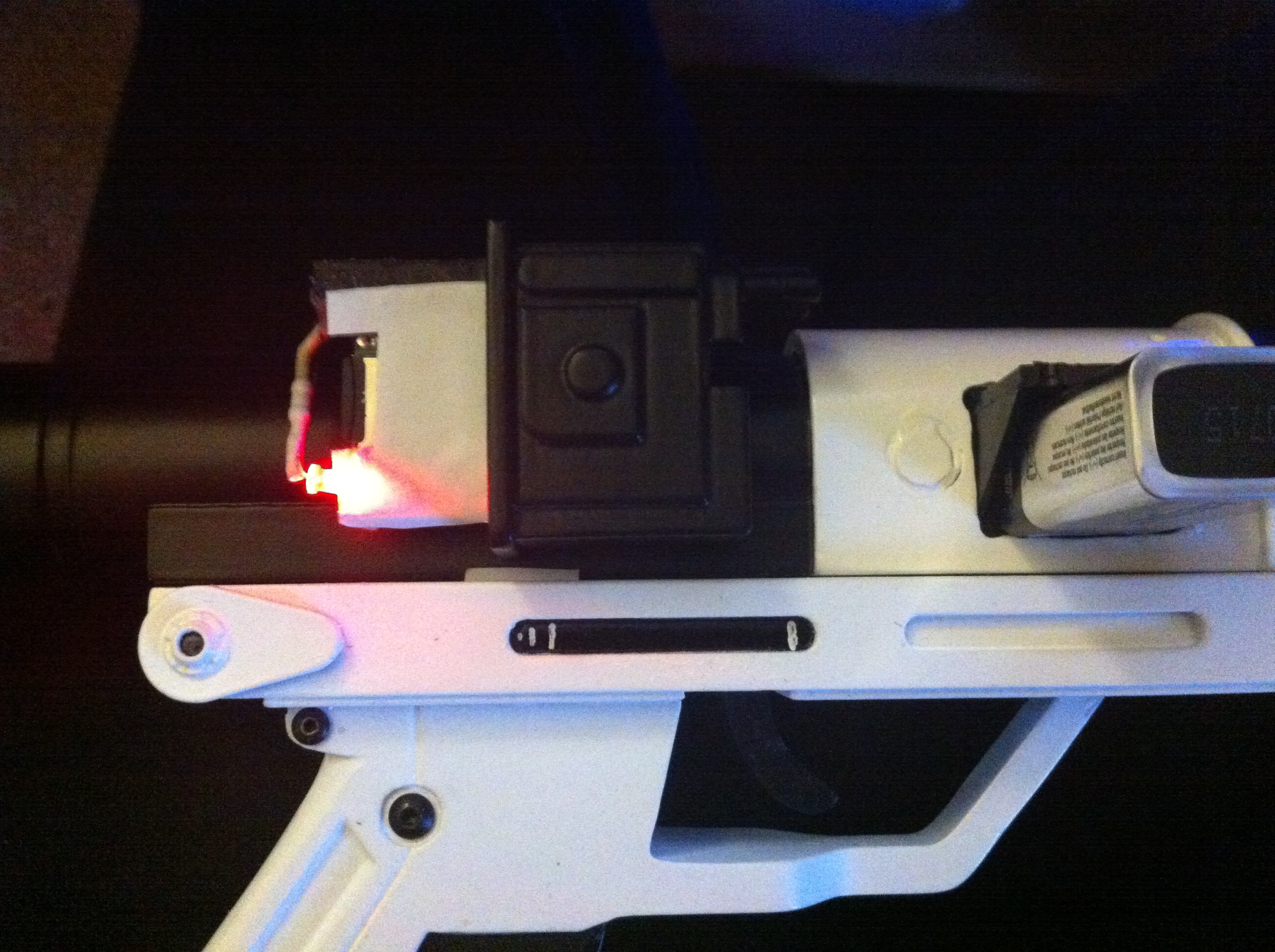

I think I have a similar kit that I am just getting around to putting together. I see that you modified the "MAG" with the 9 volt to power some of the internals. I'm first of all curious what size magnet did you use on the MAG, and how well is it working?
My questions theme around the red light ups on the blaster... so my second question is in regards to the "COUNTER". Is your counter fixed and just draws off the same battery source as the other lights and soundboard? Or is there a separate LED that is in the counter? if so, how do you have it set up for both attachment, and the ability to access the electronics to change a battery.
I have have 2 battery powered LEDs that should fit into the Counter and Mag... and I'm just trying to pulse the best way to plan to have them attach to the blaster.
Gyurma

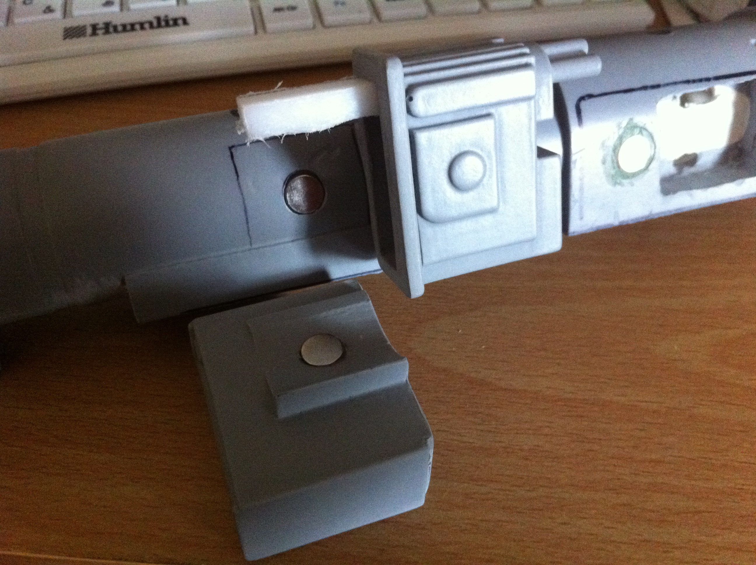

Re: F-11D Blaster kit modification for BlasterCore electronics VIDEO ON PAGE 2 COMMEN
The magnets are N50 Strong Small Disc Neodymium Magnets 8mm x 2mm Round. And i do not have any problem with them, they are strong! But the Counter housing and the MAG need to sit on something.
The Counter "lid" is sitting on this white plastic I glued in to the Counter IMG_1155.JPG plus the magnets.
and the Mag is sitting on the 9V battery holder. I do not think the magnets are strong enough by them selfs.
If you check out the video above in post #35 you can see the access to the electronics and battery.
I use plecter labs BlasterCore so all the LEDs are powered with that 9V Battery. (except the MAG LED because i just forgott to wire it in, so that one is a ballon light)
But to be fair everything is in this build shown picture by picture and you can check out the video as well, do not over-compicate this, putting two LED in it is prety easy.
I hope that was helpful.
