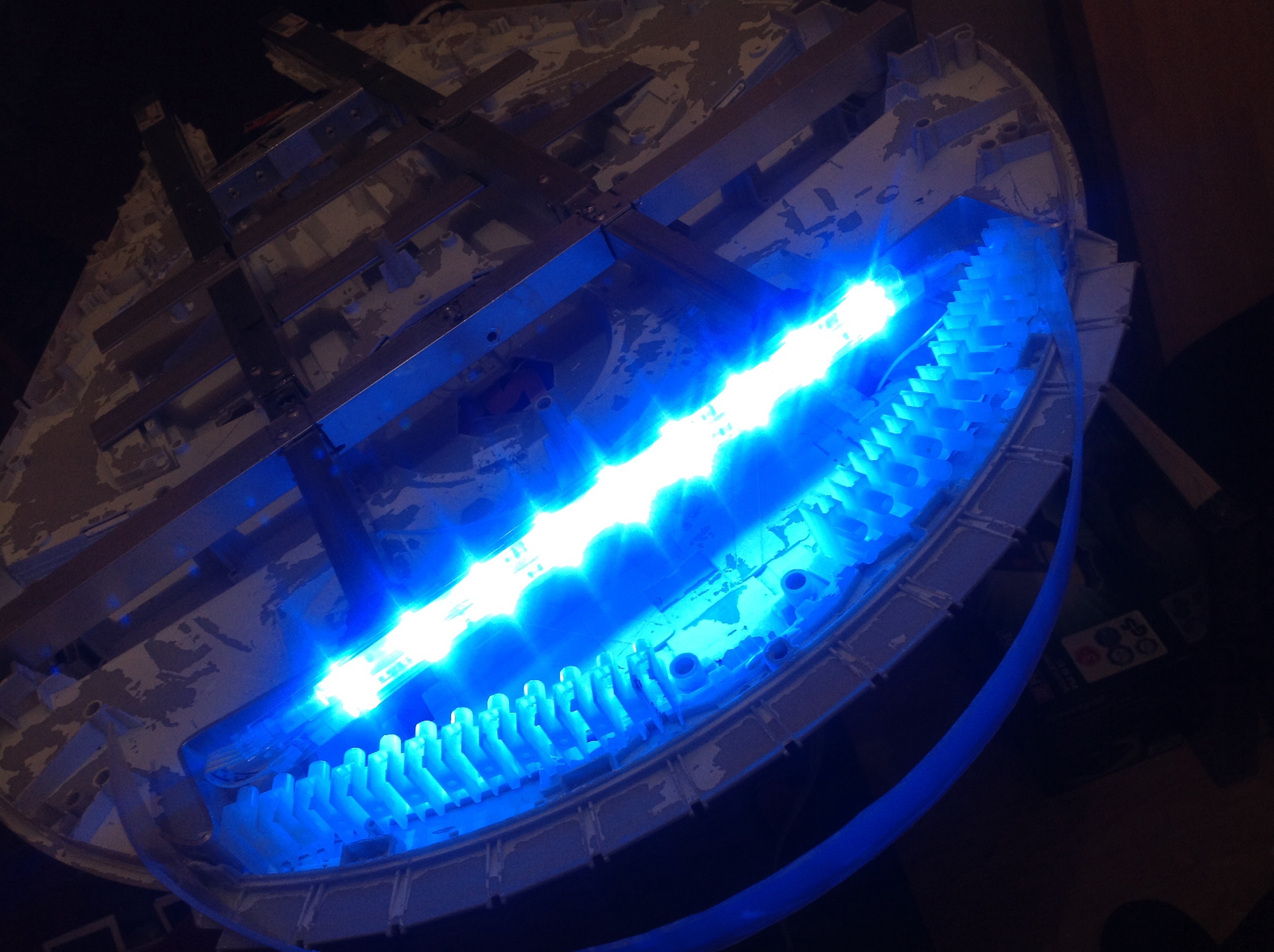

Hi all,
i´m new here in this forum and started my first modeling ever, with a Hasbro Millennium Falcon :)
I have also a question about the rear engine. What kind of plastic can i take for a diffused effect with Led´s?
Like this one: https://www.youtube.com/watch?v=T9SYshyfXco at 5:50
I tasted a Acrylglas opal white 79% in 2mm and there is no diffused effect :( i can see the individual Led´s???
Hope someone has a tip for me?
THX

In one of the shots there I bought a plastic waste paper bin from ikea and cut a strip out which diffused it nicely , cheap bin as well

If it does not get warm at all you can use regular photocopy paper or a white plastic bag cut in to strips. My favourite is that thin flexible polystyrene packing sheet used to protect nes TVs.
Also you can try moving the LEDs further away to avoid 'hot spots', that may make them easier to diffuse
Jim
