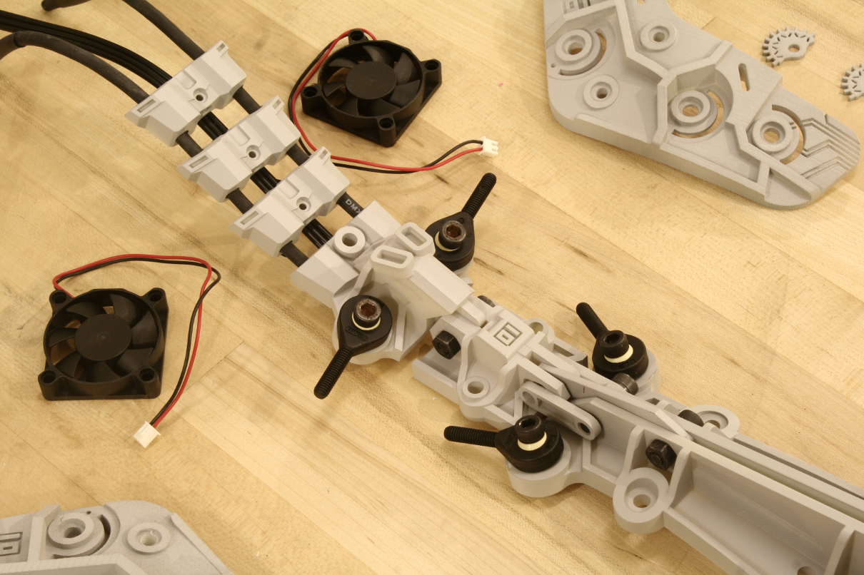

Are the computer fans meant for cooling your body? I think that's a good idea. I just hope that the grill on top is intake, not exhaust, cause it's aimed at your face. :)
The fans are mounted kind of haphazardly, but I think there is a way to orient them to designate where the intake and the exhaust directions are. The movie suit has vent holes in the same place, so I decided to install fans to give the vent holes a reason to exist.

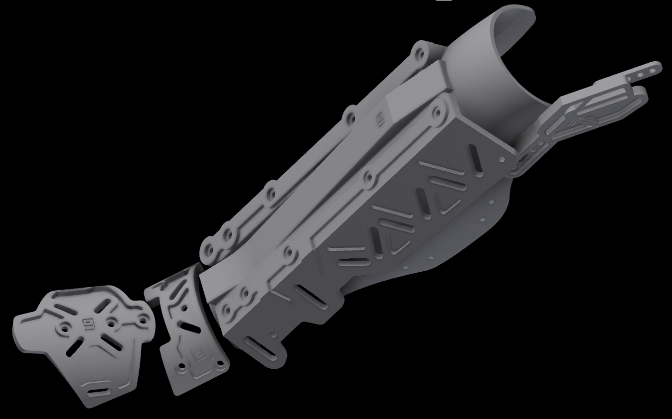

When you are making your suit, note the forearm bottom piece has a rail it slides apart on, to support people with different limb lengths. I made mine of several parts, but didn't see the sliding separation until it was too late (don't want to spend two weeks to redesign). The upper arm does the same thing, and I designed that one as one piece as well because I couldn't figure out how to make it slide. Of course my upper arm is not screen matched at all (didn't like the screen version with Kawasaki on it).

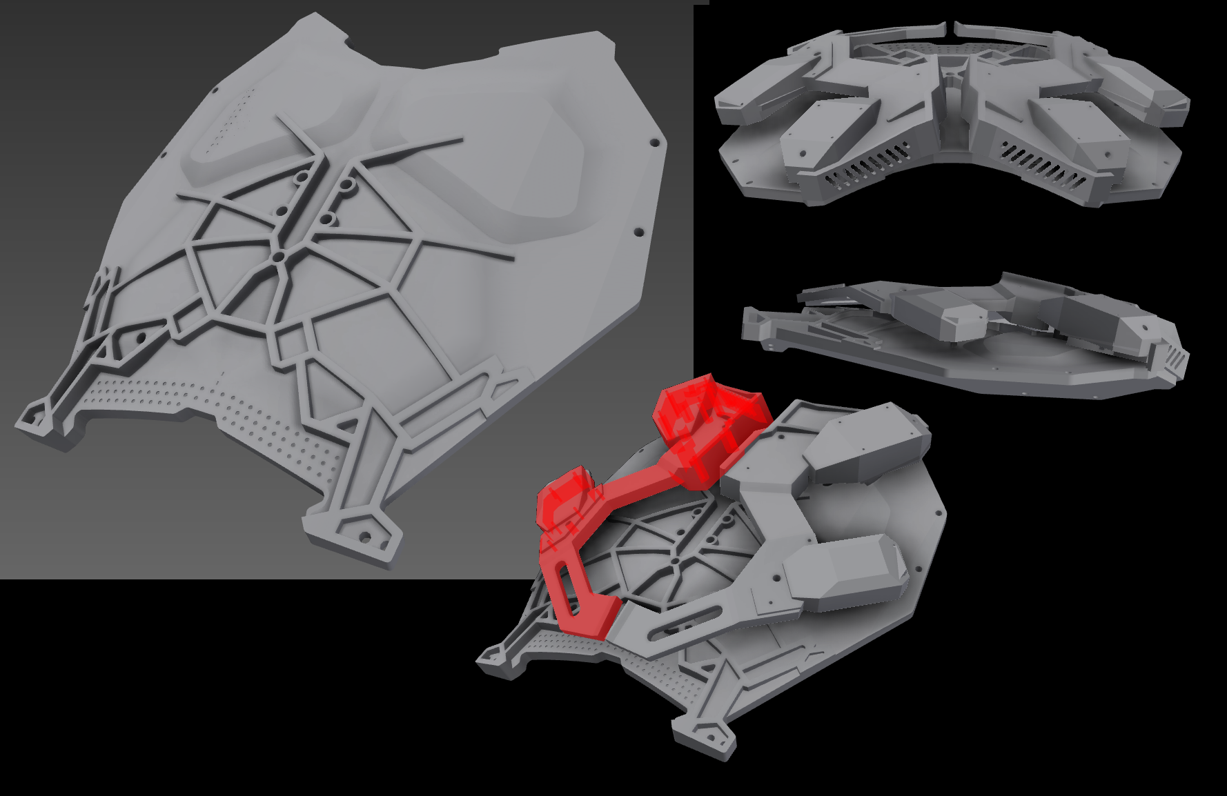

Moving on the chest base, the bend is approximated for now. The ridge geometry is not an exact screen match, but it's the best I could do with references I had last year.

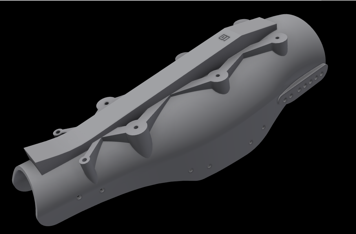

Having some issues with organic shapes (Inventor is unable to fillet). Since the edges are easily accessible, I may just sand in post.
Received and primed many of the exoskeleton costume parts. The chest model has a lot of unexpected complexity, will take another week or two.

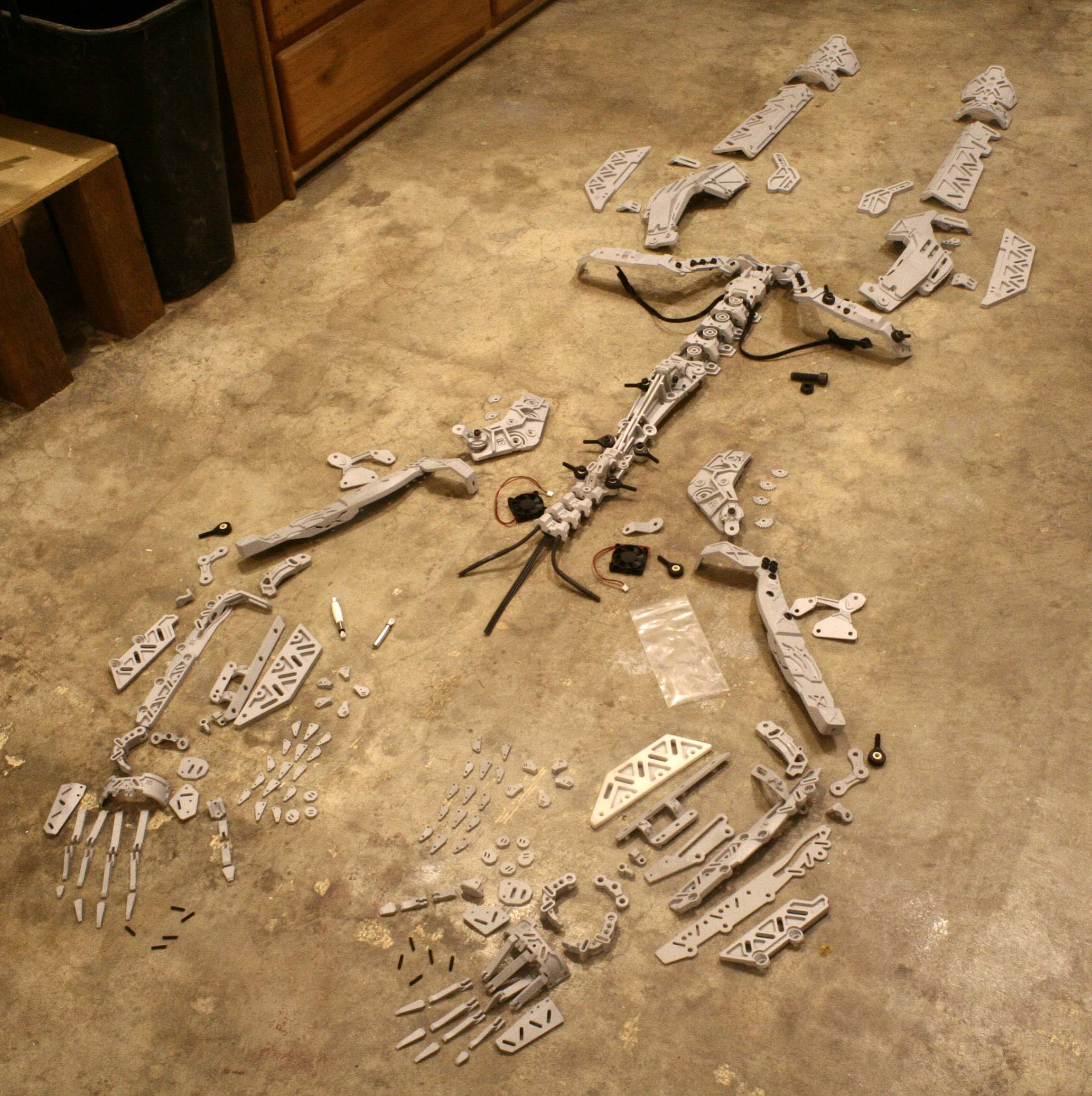

Oh yes:eek; seeing that Exosk laid on that table is a sight to see (and appreciate the effort behind its construction). Great work and eager to see the next update:cool
Amazing photos. May I ask where you bought the rod end bearings and how much they cost? Are they metal or polymer? I did some research and the cheapest I could find are 2.2 euros per piece.
Thanks for following my thread and all the encouragement! The bearings are polymer, which is supposed to increase their abrasion resistance in real-world applications. I ordered directly from Igus because that's where Weta got theirs. They ship from Germany, I think my order was around $100 for 24 pieces. Then I noticed that I was 2 short (plus I plan to make two of these suits) so I will order another batch at some point. Ordering was a bit weird, they call for confirmation early morning on weekdays and don't take most of the usual credit cards.

looks strange all laid out, a bit like terminator C.S.I but i recon its gonna look well good when worn

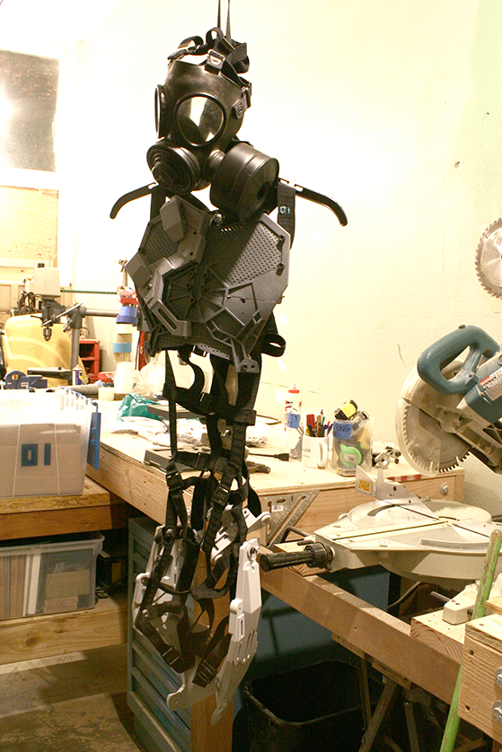

Worth the effort? I think so. Thanks to a fellow RPF member who helped me prototype the chest parts (fits on first try! The months I spent on this piece paid off).
Fans slide into the chest plates as envisioned. The batteries too.
And the fans work!

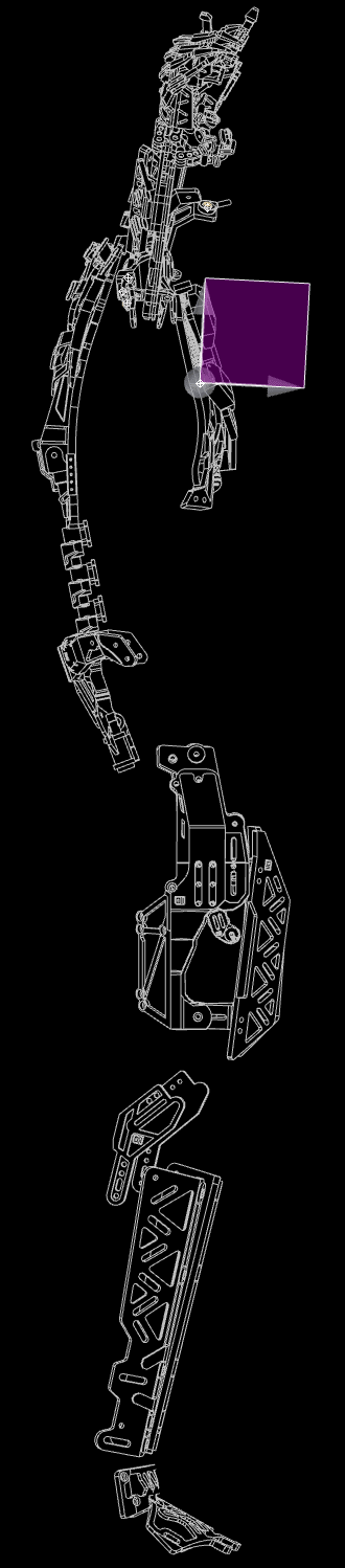

Pre-final piston lengths, unique pairs:
Back Bottom: 100mm
Back Top: 50mm
Back Middle: 35mm
Tricep: 130mm
Leg: 130mm
Clavicle: 100mm
Hip Front: 95mm
Hip Middle: 75mm
Hip Back: 70mm
Shoulder Front: 90mm
Shoulder Back: 115mm
