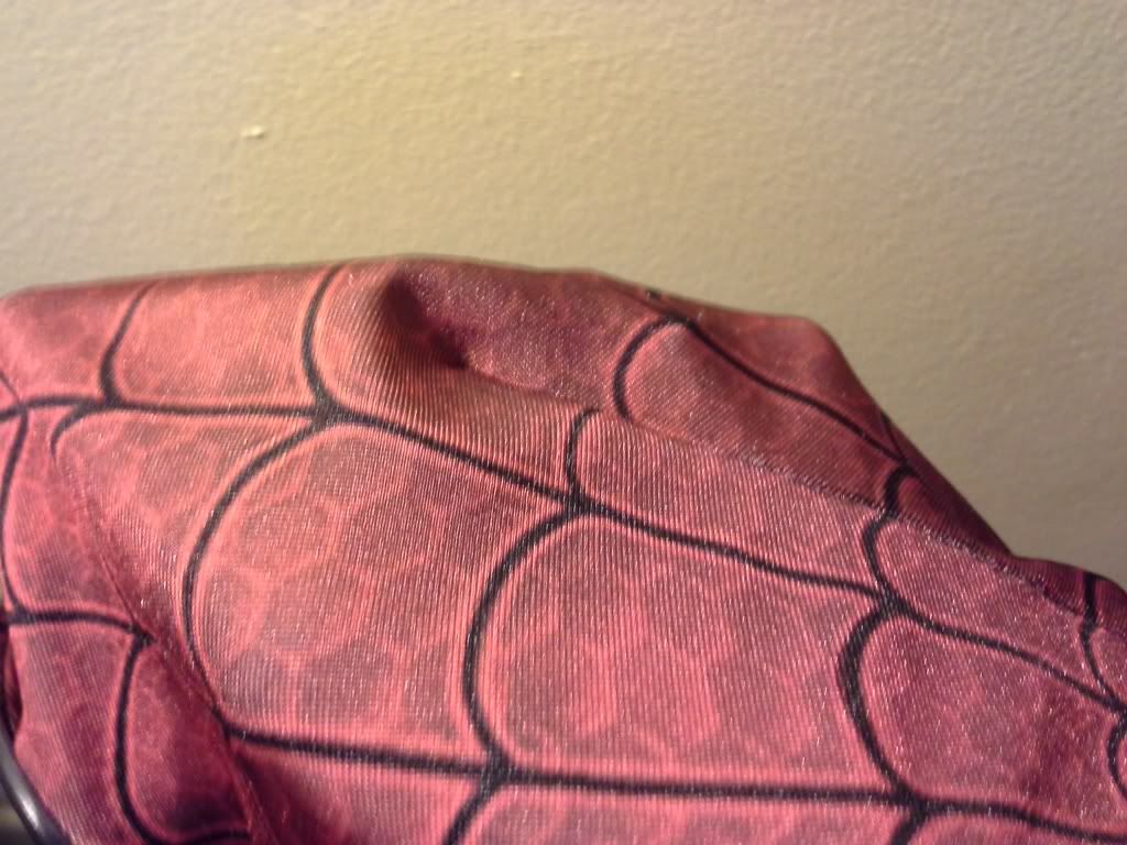

Spiderman neck/ mask. How do you sew it? Can't figure this out. No search helps.
I have searched this forum and superhero hype and other related forums for an actual answer but haven't found one. I know that you sew the () area together, but when I do I get this weird ripple where the chin should be. I know how the rest of the mask goes together. It's the neck/chin area I'm having a problem with. I have plenty of images showing where things need to be sewn, but they aren't helping me figure out how to sew the chin/neck area without bulking up and wrinkling weird on the chin. Does anyone have any advice on how the neck area is supposed to be sewn that prevents this? I have Orhadar's Spider-man print.

If it's wrinkling up weird, you're using the wrong tension settings on your machine. Did you just ask this question on the Gunhead Designs facebook page?

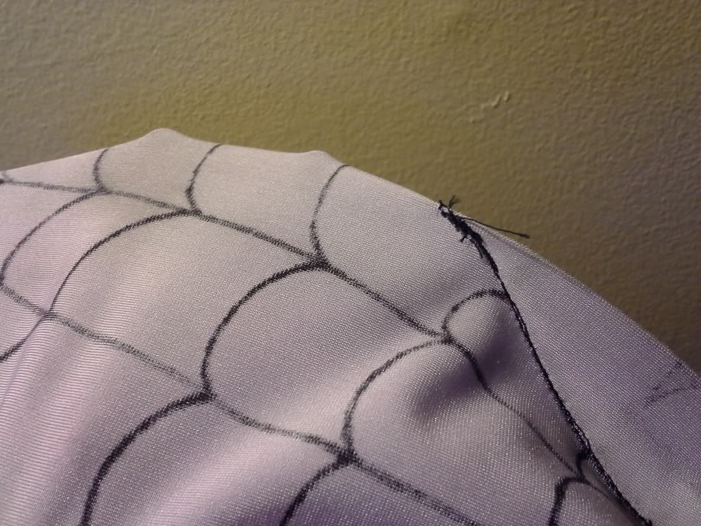

The problem is when I sew it, it ends up like this
V
The v is the weird way the chin puckers. Sewing the () shut is no problem, but toward the "face" it does this weird pucker. Maybe I'm just not sewing the seam placement properly?
Once I get to where the arrow is pointing, the whole thing goes weird.

Well you're always going to get a tiny pucker at the end of the seam, but it lays flat once the suit is worn. Just make sure the transition is smooth. I'll upload a picture of mine in a few minutes.

No worries, and thanks for the compliment! My phone's still being finicky about uploading the photos, but I'll edit them into this post when they're ready. Basically it shows how you want the end of the seam to meet the fabric edge at a gentle angle, like a tangent line coming off of a curve.
Long-awaited edit: Here are the pictures of the inside, and then the outside of that seam.

On top of your help, I figured out something else I was doing wrong. I was trying to sew ONLY the black weblines together, instead of merging the seams together at the top point. You've been a huge help! Thanks! :D

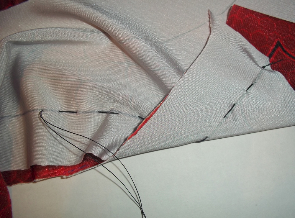

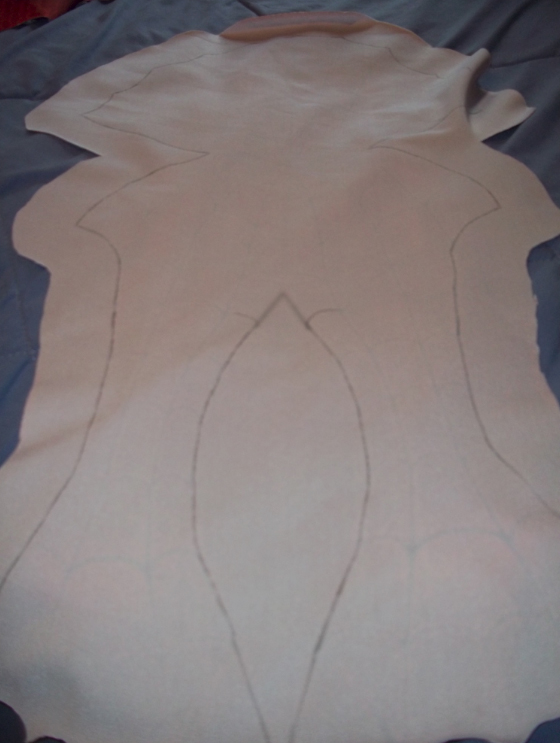

Well everyone, I finally have some progress and advice for everyone. :) This is my absolute first time sewing spandex/lycra. Keep that in mind when you notice the stitching isn't perfect and in a lot of places it looks sloppy. I'm doing my best and learning as I go. Now for my progress and advice.
After cutting out almost all the pattern pieces (I still need to cut out additional hand parts), I decided to start with the extra mask that came with the print as practice for the main suit. Below is the front of the mask.
After cutting out the patterns, I traced the seam lines from the front, through the fabric in pencil onto the back of the pattern piece. I'm doing this with ALL the pattern pieces to make it easier for placing the seams together.
To make sure every thing lined up and would not slide out of place while machine sewing the fabric together, I sewed along the seam lines by hand.
Below you can see the seam looks good already, just hand sewn. Eventually the hand stitching will be removed.
Using the zig zag stitch on my machine, I ran a line of stitching down next to the straight seam line/ hand stitching. I removed the hand stitching afterward and then stitched a straight seam over the line I had earlier traced out.

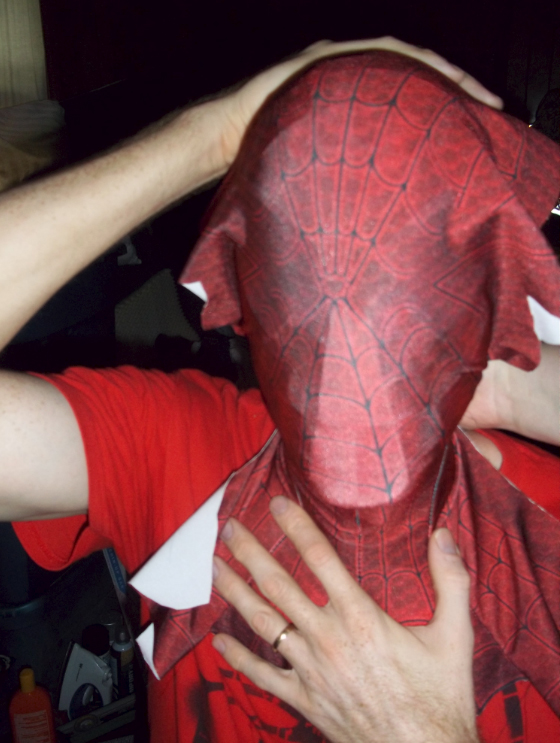

Here is a photo of my mask so far, stretched by hand with the help of my wife, over my cheap store bought face shell.

Well, it isn't perfect but it's coming along well. Worked more on the mask today. Still need to add the final back pieces together. It's a bit difficult to get the seams to match up perfectly, but Lunaman's marker idea should cover that pretty well.
If it looks a bit weird, it's because I'm wearing one of those cheap toy Spidey masks under it. I still need to sand down the thing. I'm not sure I'm going to use it at all honestly as it feels like it's too small for my head. I do like how it rounds out the nose area though. I'm wondering if I can just attach some fabric under the mask to get the same result.

I know it isn't a huge update, but my mask is pretty much finished and that's a big deal for me. It isn't perfectly sewn, it's my first time making ANYTHING with spandex myself and I think I've done a great job for a first timer. Here is my mostly finished Spider-man mask. I need to fix the seams with black Pigma Micron permanent markers. It's not really easy to get the seams to look right without going over them like that. Thanks to Lunaman for his topic on the rpf for this tip! I'm also going to add a zipper to the back as well. Also as you can see in these pictures, there are some weird puckering areas I'm going to go back seam rip and sew again. This hasn't been easy for me, but I'll say this. Having this extra mask to work on helped boost my confidence level when it comes to sewing the entire costume myself. The mask has been a real challenge for me and even if it, and the entire costume doesn't turn out looking like a pro did it, I'll know that I put in the time to do my best and I'll feel so much more satisfied with the costume, than if I had just paid for someone to make it for me. There's nothing wrong with paying for someone to sew something for you, but I get more satisfaction out of doing things myself when I can.
