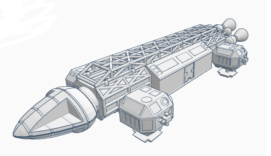

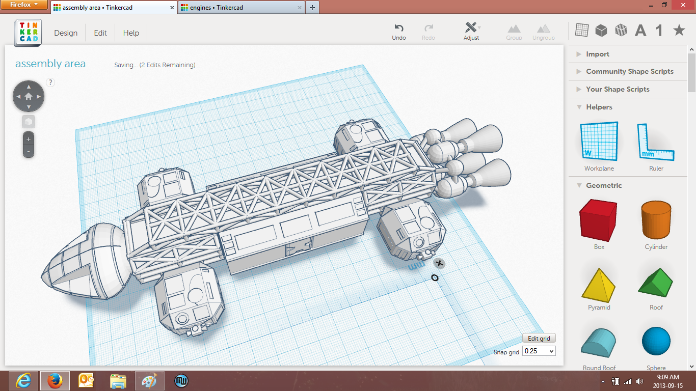

Lately I've been tinkering around with a free online 3D program called Tinkercad (https://tinkercad.com/). I got into it only a few weeks ago because my work recently bought a Makerbot 2 and I needed to learn to use it. Tinkercad is quite easy to learn and you use and modify various shapes like cubes and spheres etc. It's free and online so any objects you make are stored on the internet and the files convert easily to STL files to use with a 3D printer. So this past weekend I got ambitious and built an Eagle from Space 1999. I used my Dinky toys Eagle I got for Christmas back in the mid '70's for reference, so maybe not super accurate, but it looks like an Eagle to me. I built the model in about 20 components, my intention is to print it. So for anyone wanting to try this type of modelling, I recommend Tinkercad.
So you basicly end up using the programme like lego and manipulating the blocks the way you want by dragging vertices?
Kind of like that ya! You make you're own lego pieces and place them where you want. You can also use the shapes to make holes or to cut parts off of other shapes. If you've ever made stuff in Little Big Planet, it's kind of the same idea. There is also cut and paste, duplicate and a ruler, mirror and alignment tools. The frame work on my Eagle model is just lots of skinny cylinders of varoius lengths. I made one side, then copied and pasted it to the other side. You can morph the shapes just by draging their sides or corners, or by placing the ruler tool and entering the variable, so a sphere can be an egg, a cube can be a flat sheet etc. I have no experience or training in any kind of CAD drawing or anything like it, I've been using Tinkercad for less than a month and just in my spare time.

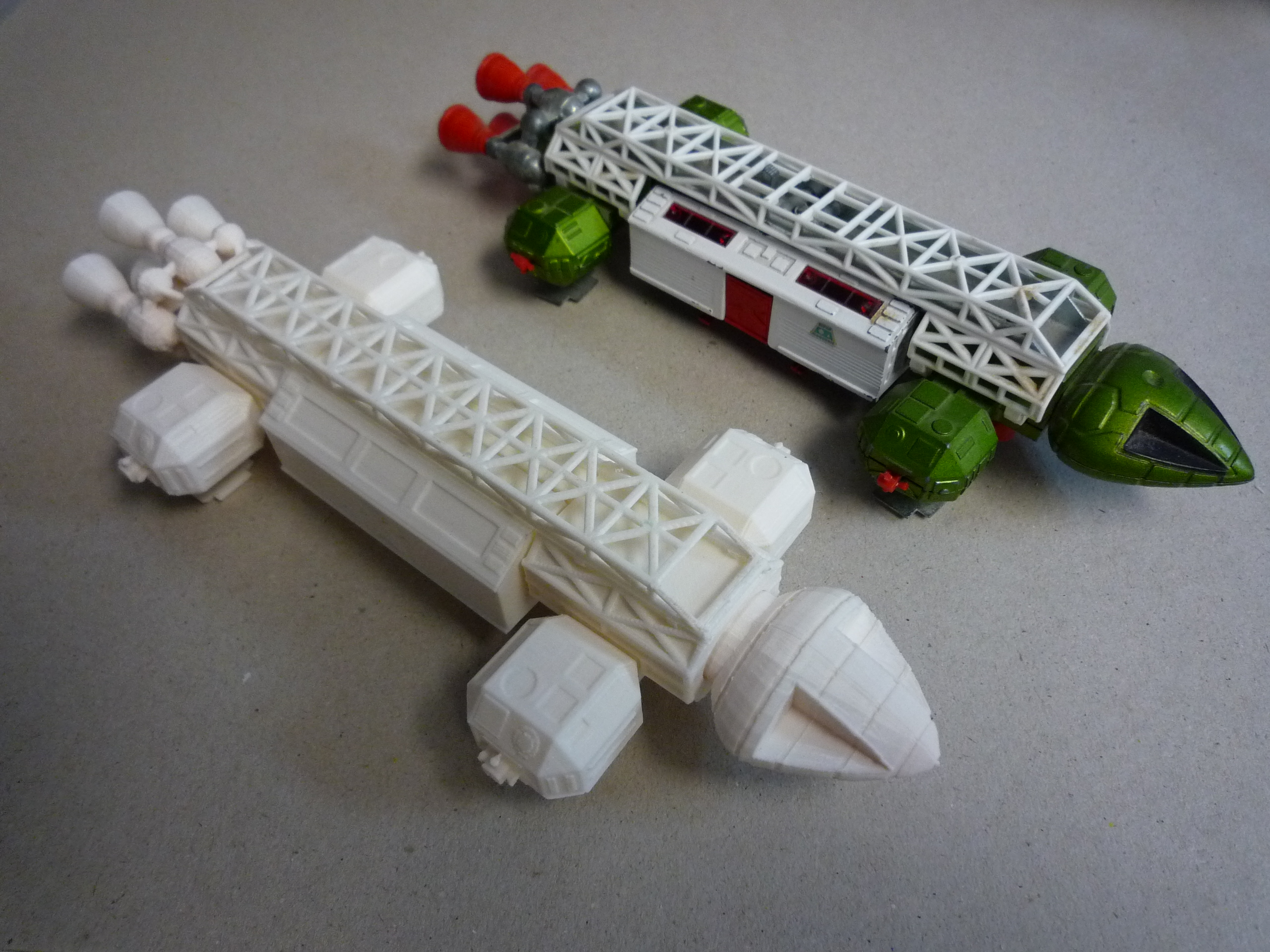

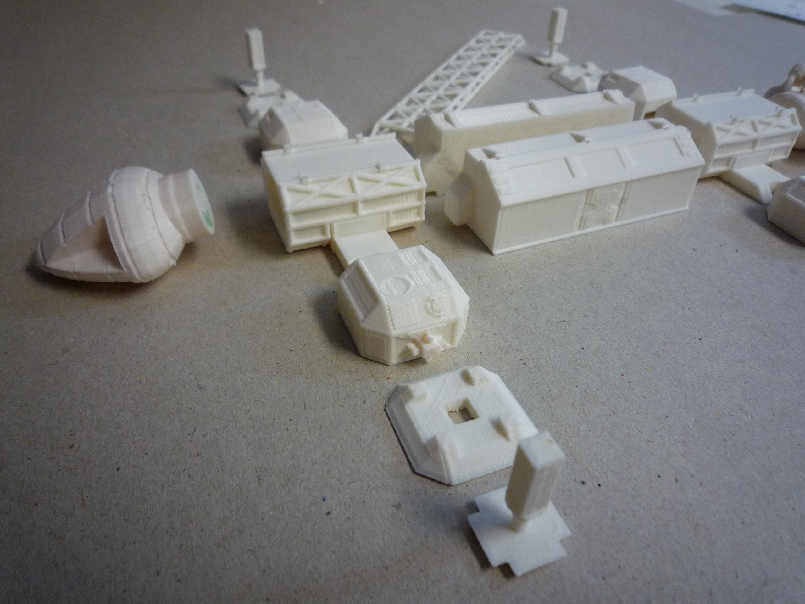

Here's the printed product, it was done on a Makerbot Replicator 2, standard resolution. I printed just the top support frame 60% larger (original length is 5.5 inches, +60% is 9 inches) and the detail is way better. The MakerBot has trouble doing small stuff.
Wow, that's nice! If you don't mind me asking... how much did it cost you to print it out?
Well I used the printer at work, it costs about $2700, the filament costs about $50 for a 1kg roll, so 5 cents per gram, the model weighs 88 grams so $4.40 cents. The makerbot prints the object mostly hollow, filling the inner space with a honeycomb structure, so you don't use too much material.
