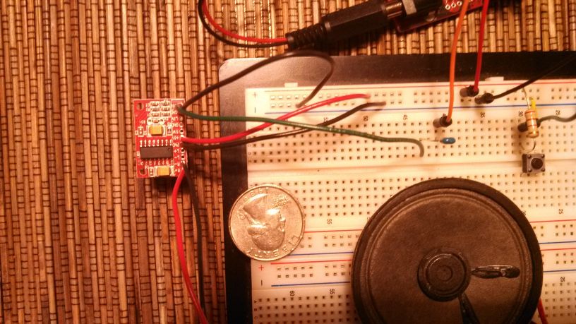

If you're up for a little soldering, there's a great tiny amp available easily on ebay. Search for "PAM8403", they're usually about $4.00 delivered from China. I have one of the red ones. It's surprisingly good for something so small and inexpensive. Take a look at the picture, the quarter is there for scale.
