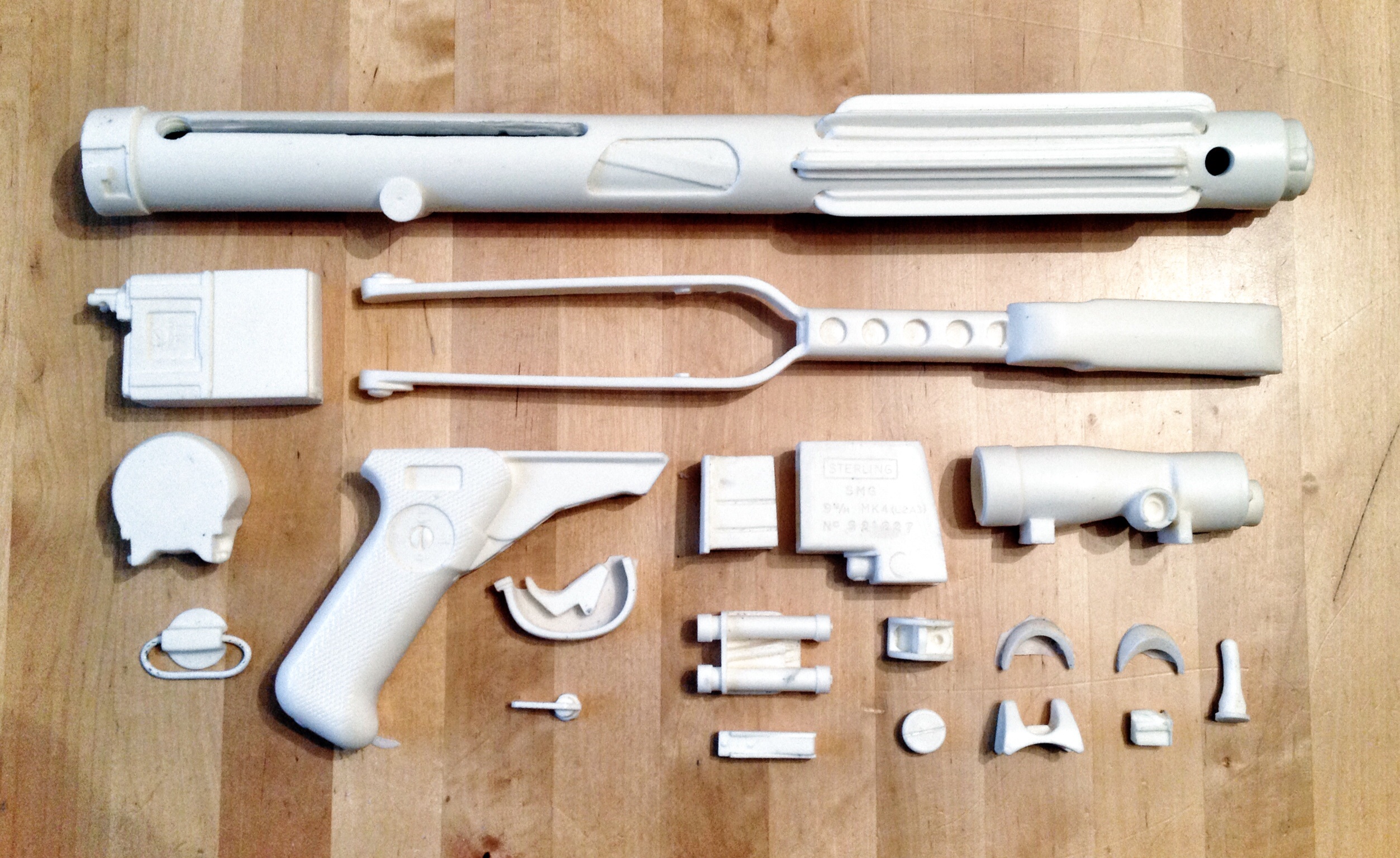

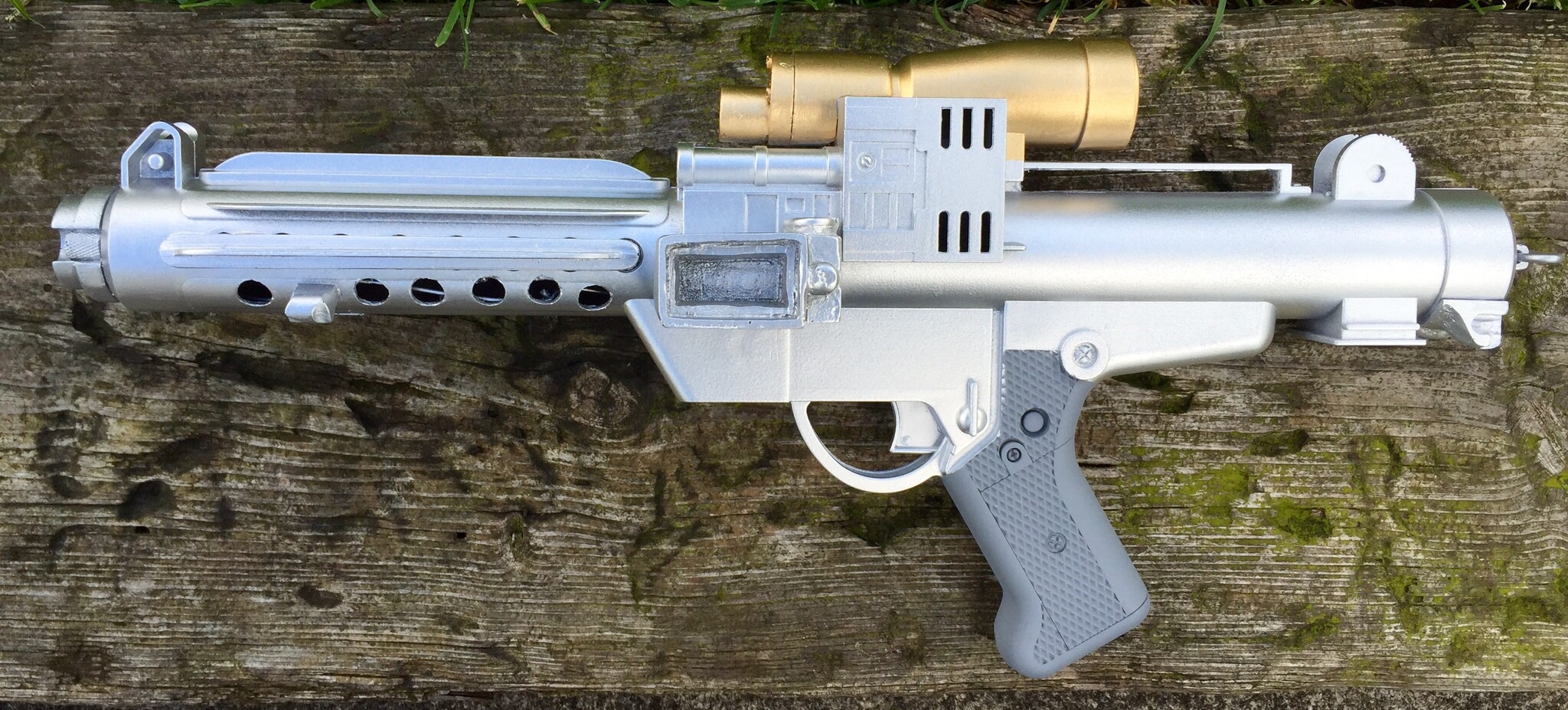

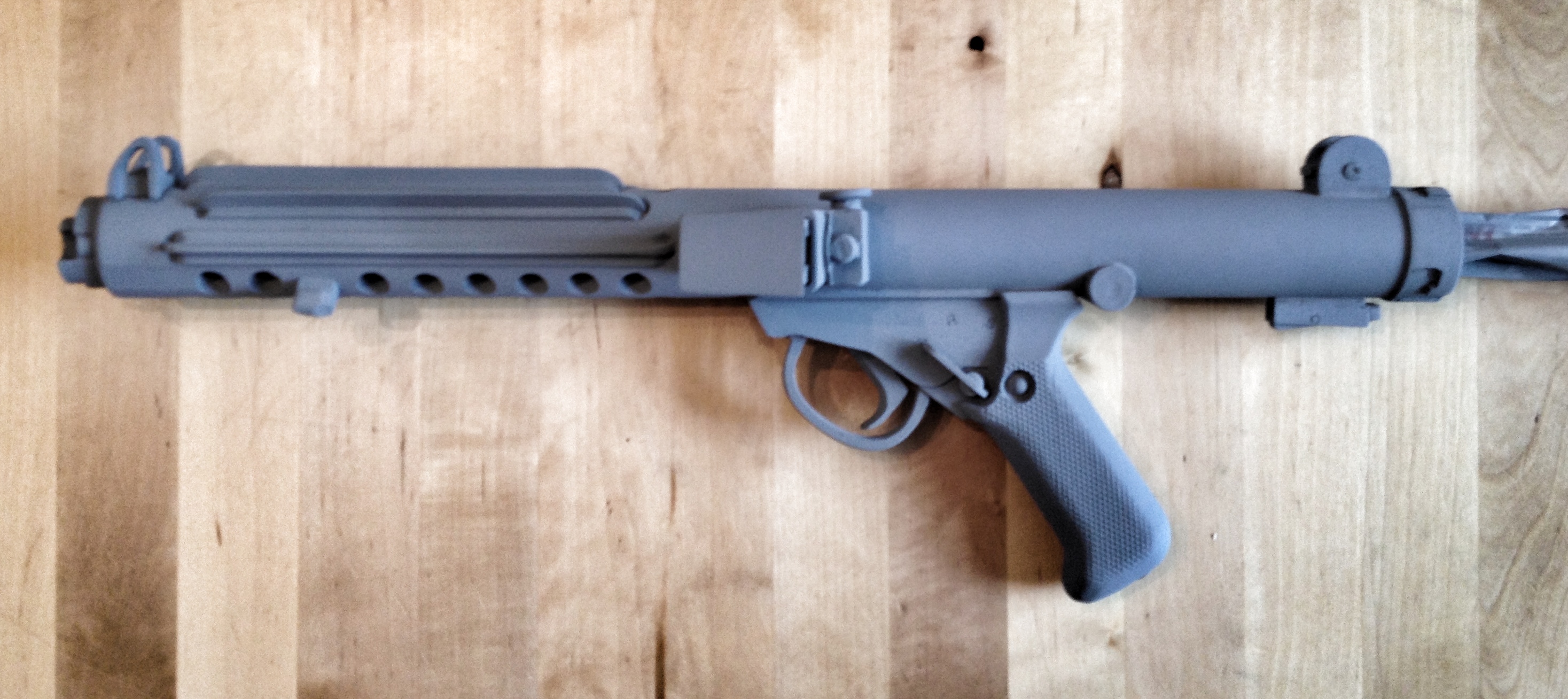

Ok so I know these have been done hundreds of times in the past,
I've had the Doopydoos E11 Blaster on my watch list for over a year but never felt confident that I could build it & that mostly came down to the fact that you have to do the scope rail yourself & I wasn't sure I was up to it :lol
anyway finally decided to man up & order one.

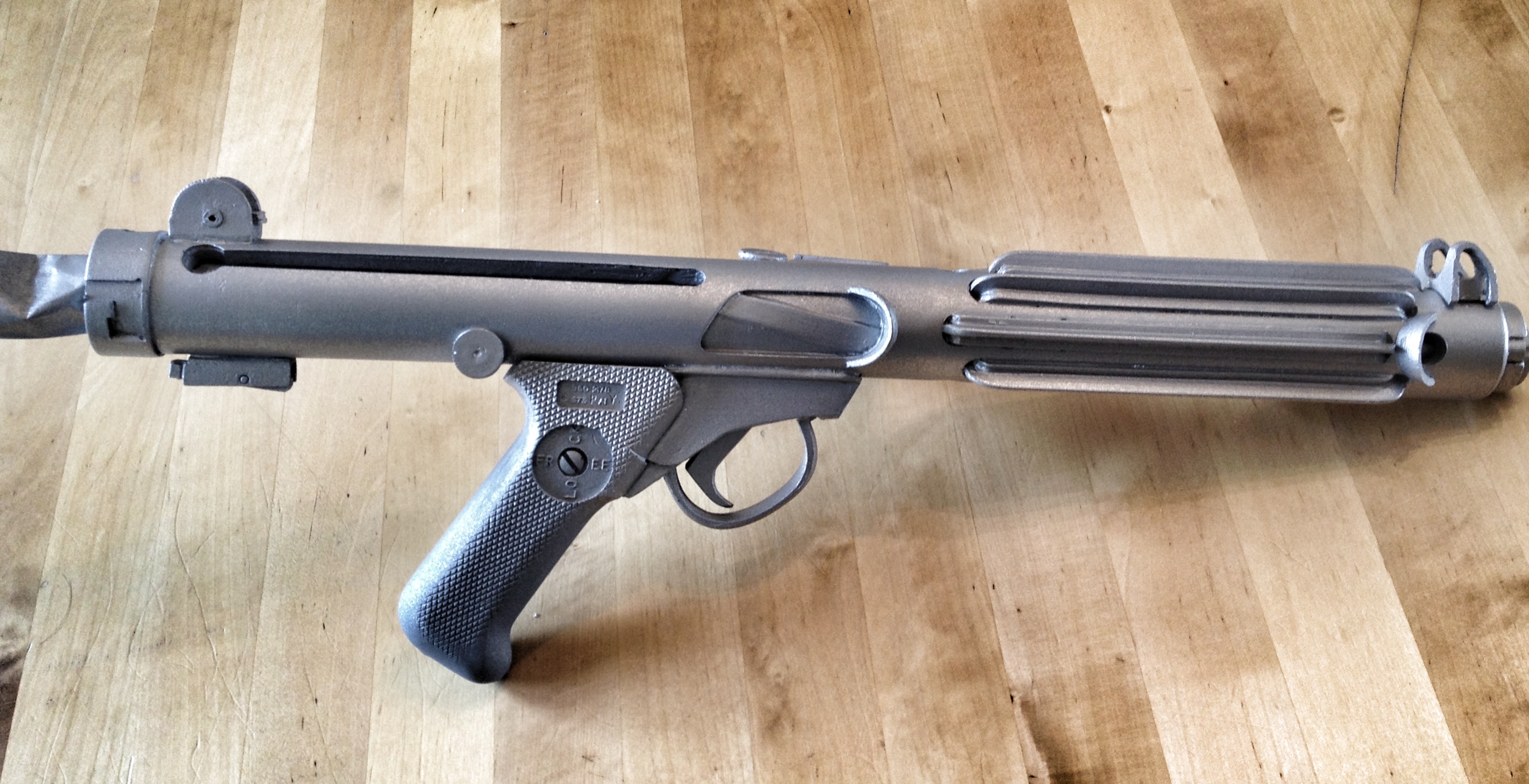

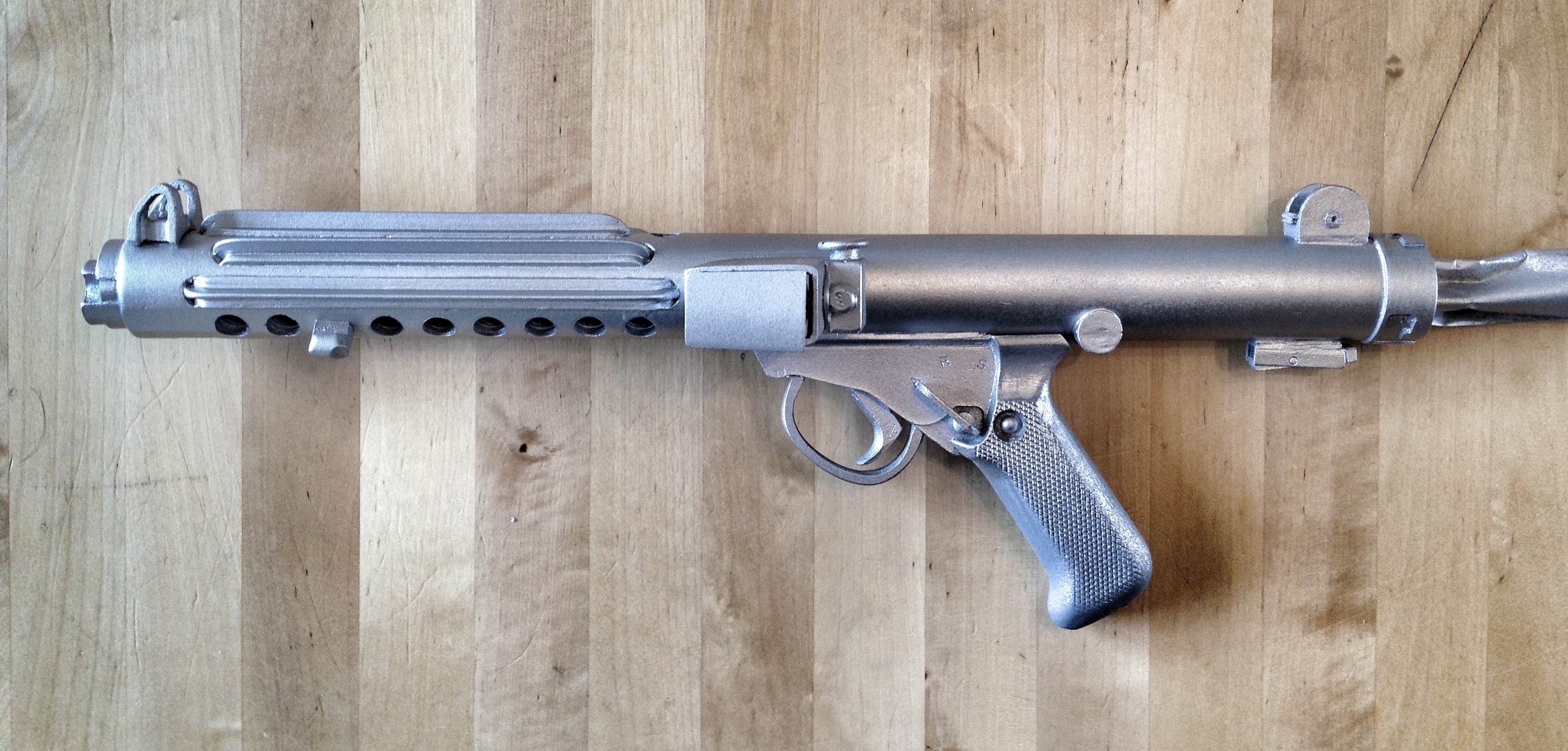

As with all the other Doopydoos kits I've had the casting was very good & didn't need too much clean up or filling
quite a lot of parts on this one but it went together easily enough (hopefully with everything in the right place)

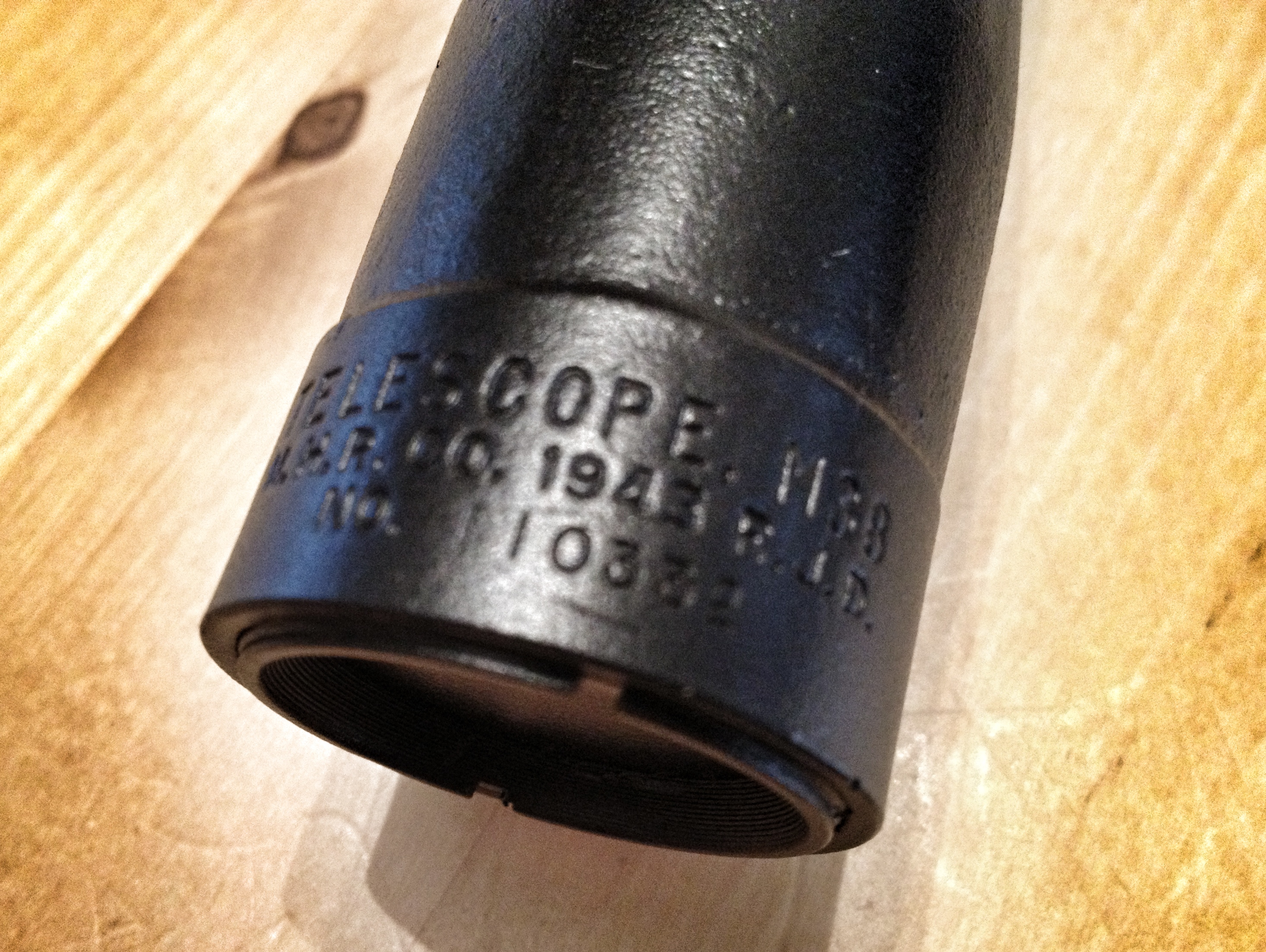

I primed it & then gave it a silver undercoat, brass on the scope
I got some aluminium strip which I bent over the edge of the table & then notched with a hand saw to use as a scope rail
I found an old bracket to use to mount the hengstler

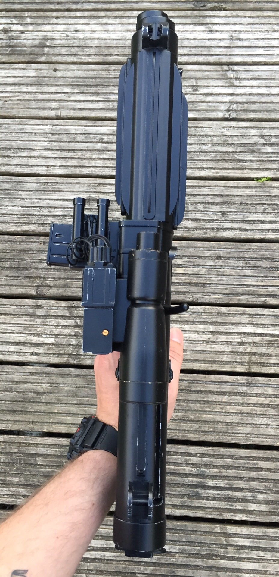

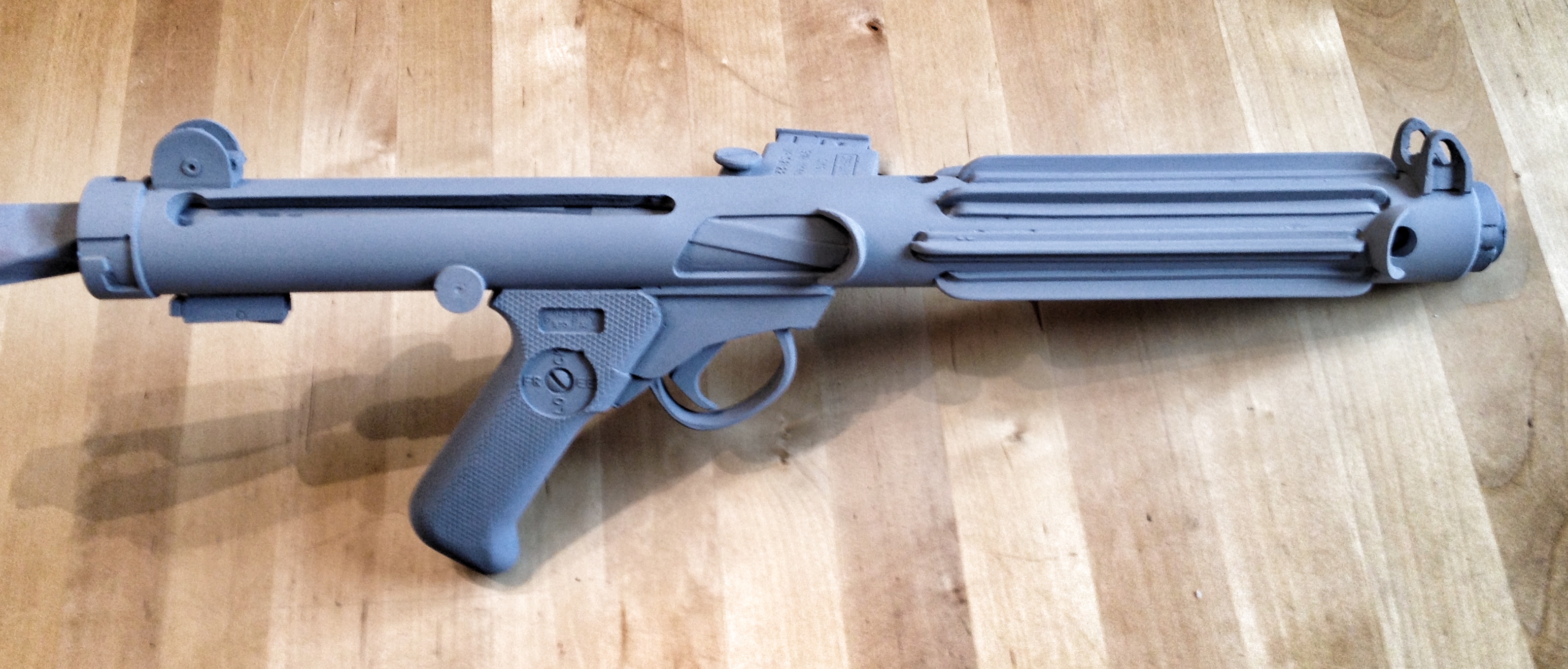

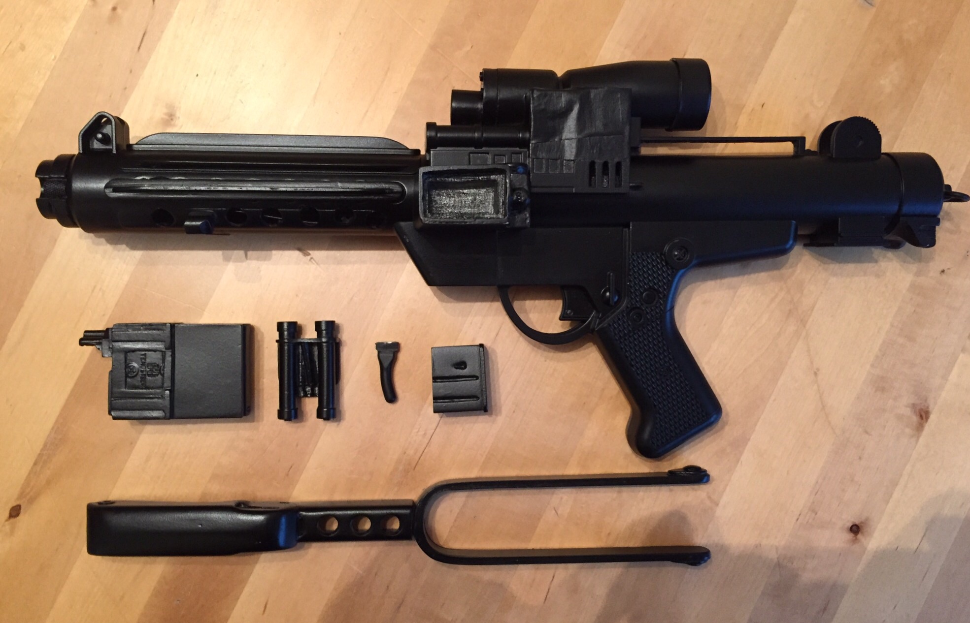

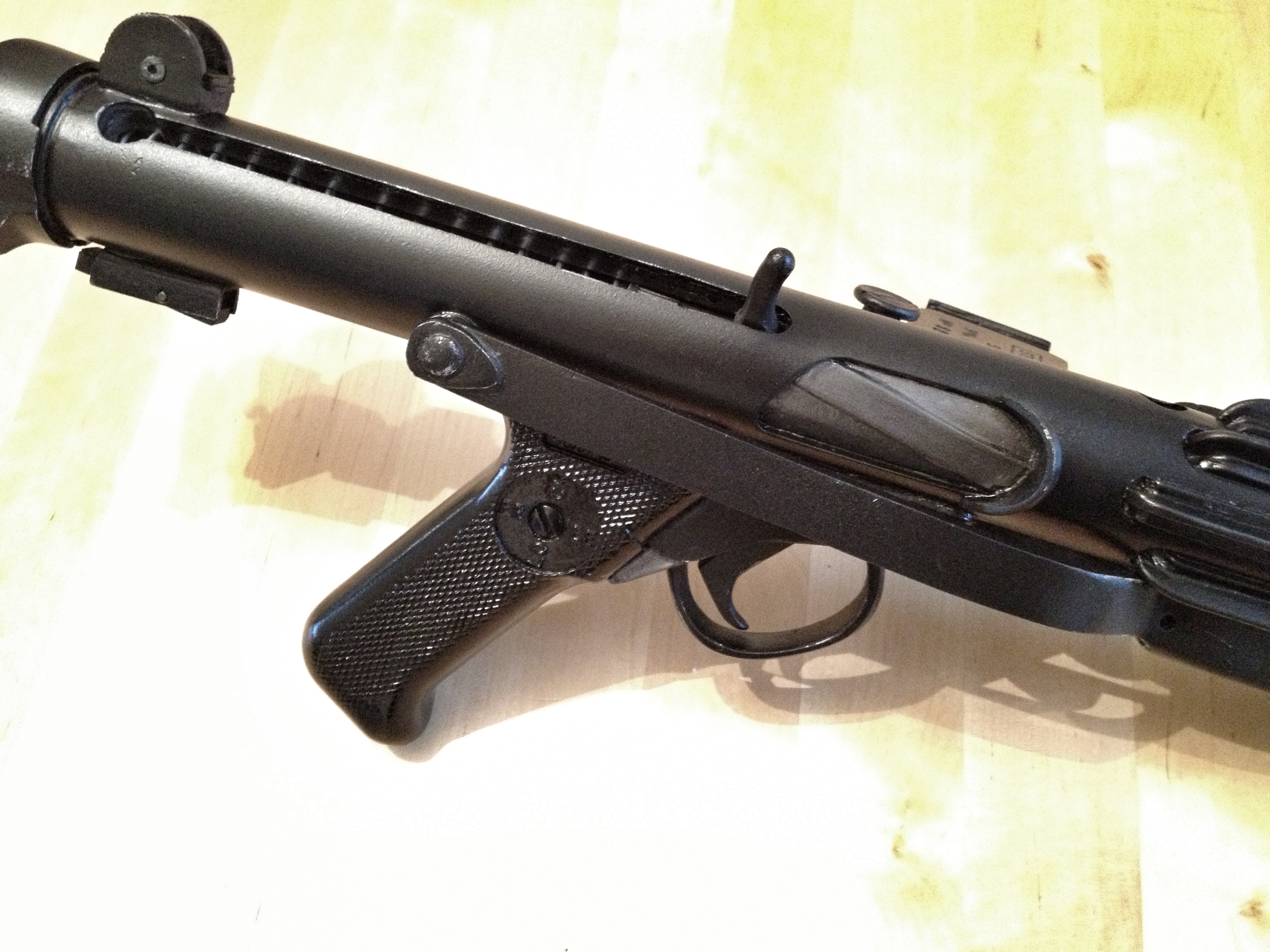

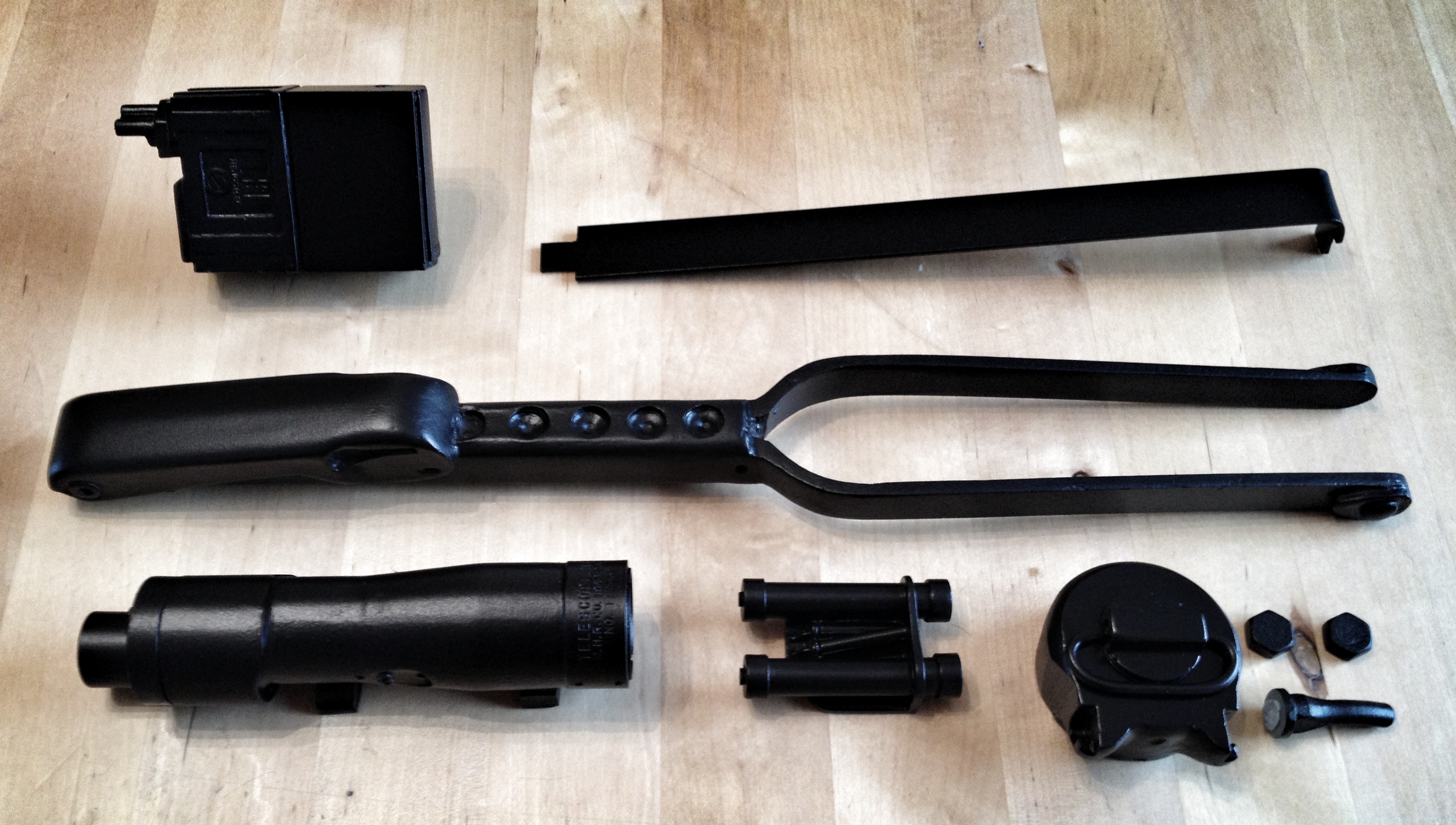

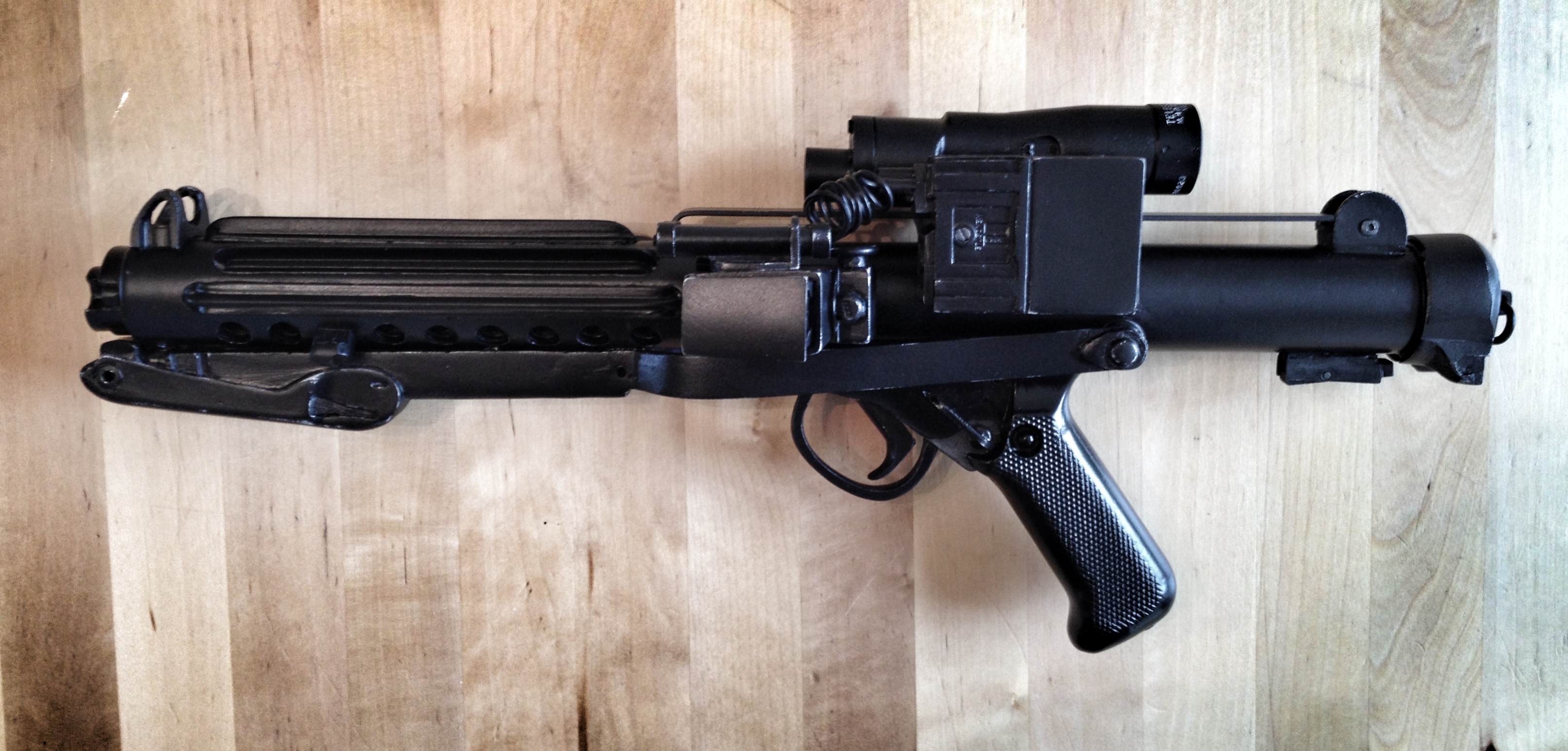

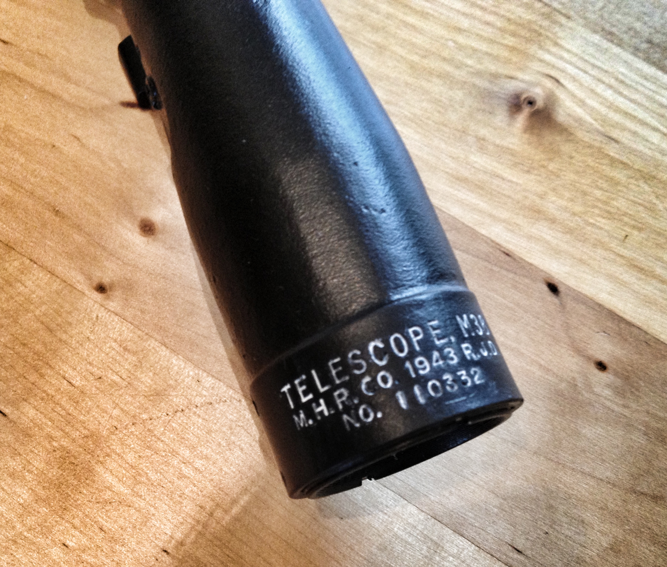

Sprayed the whole thing satin black (with gloss black on the grip)
I used a toothpick to paint the white lettering into the scope
I filled the joins & drilled an extra hole in the underside of the folding stock
I used some memory wire to make a spring & an old glue stick as a bolt
initially put together without the Hengstler or cylinders

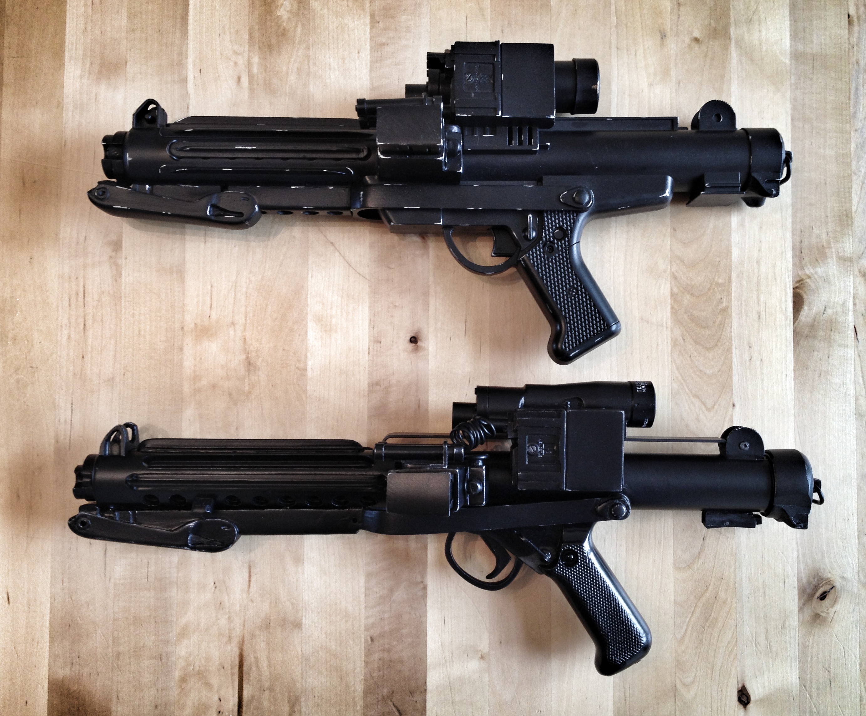

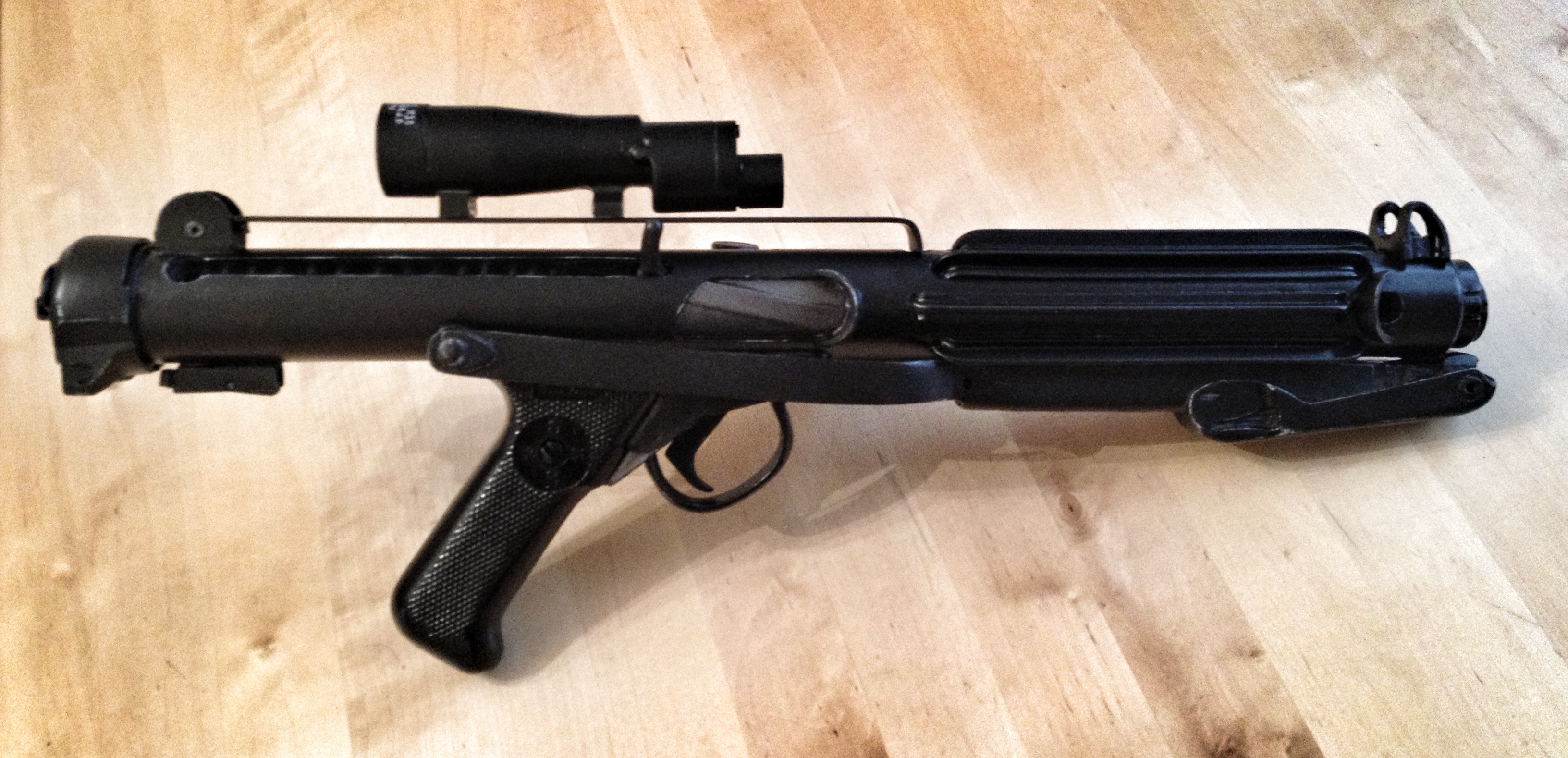

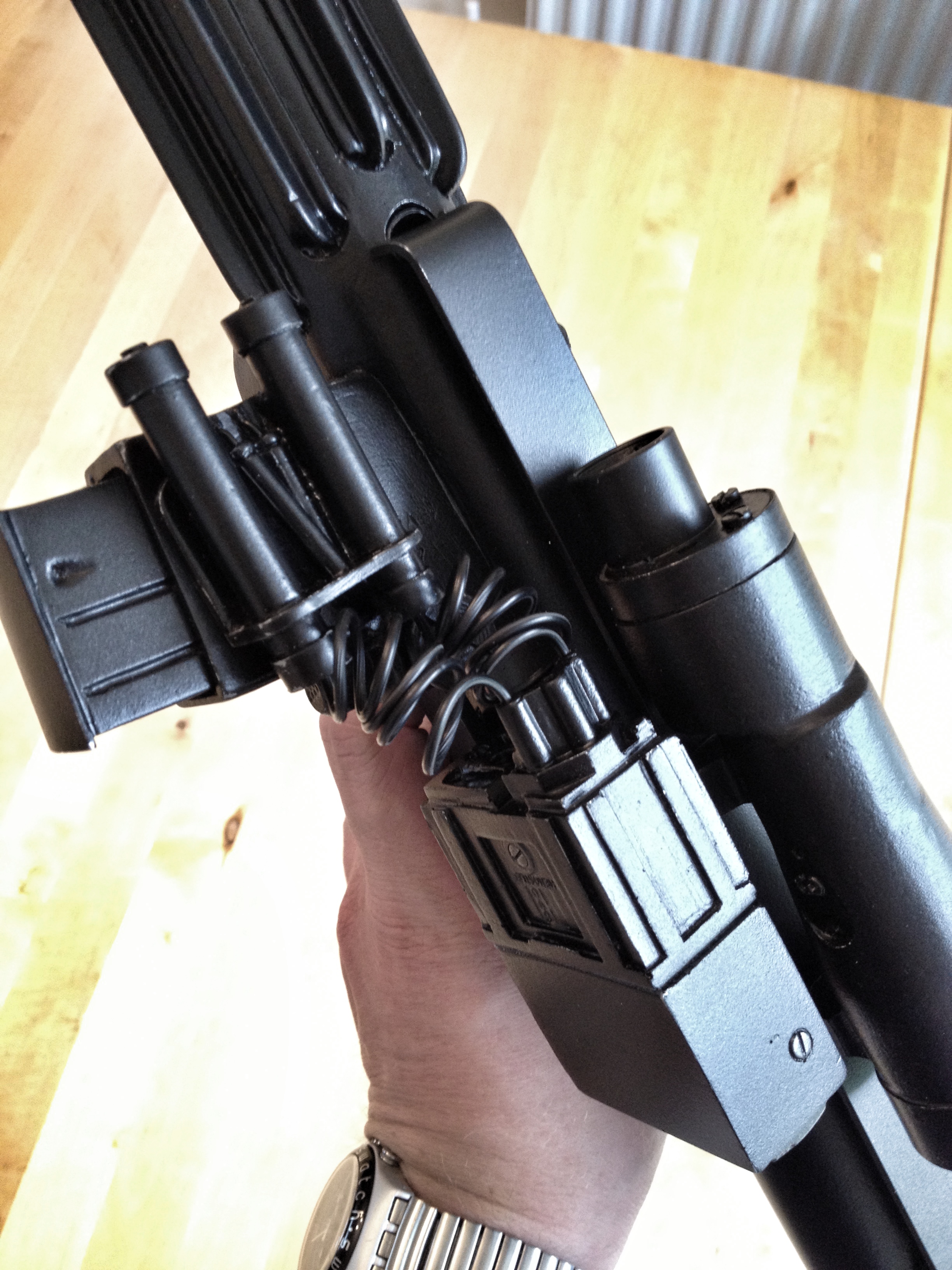

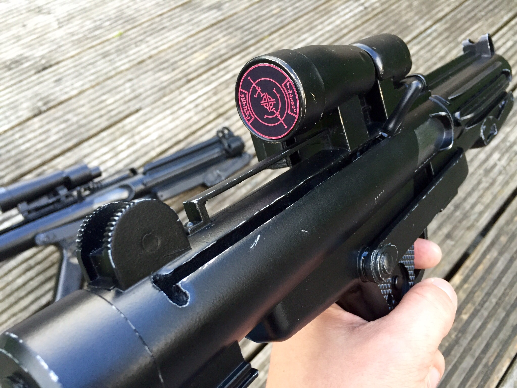

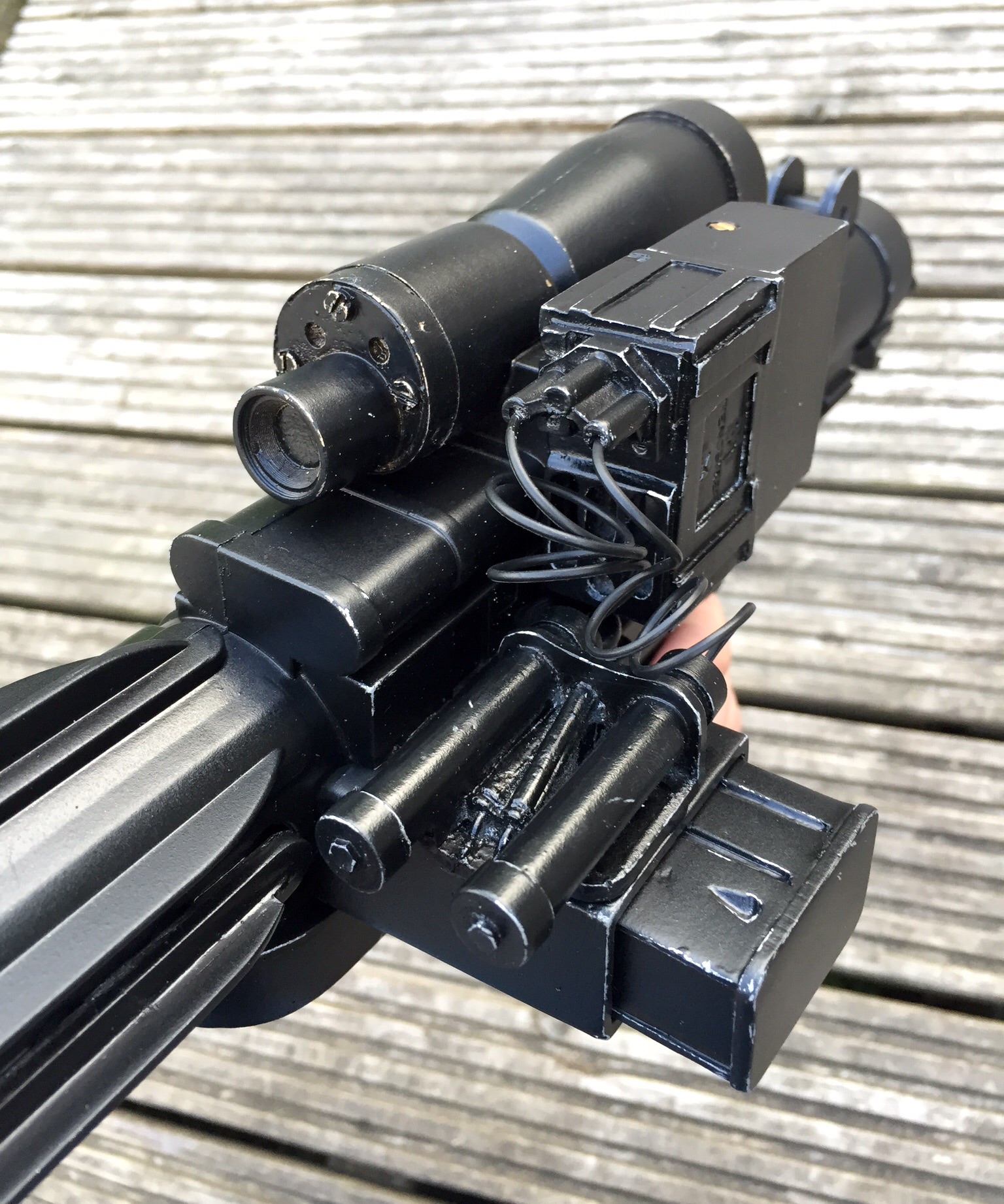

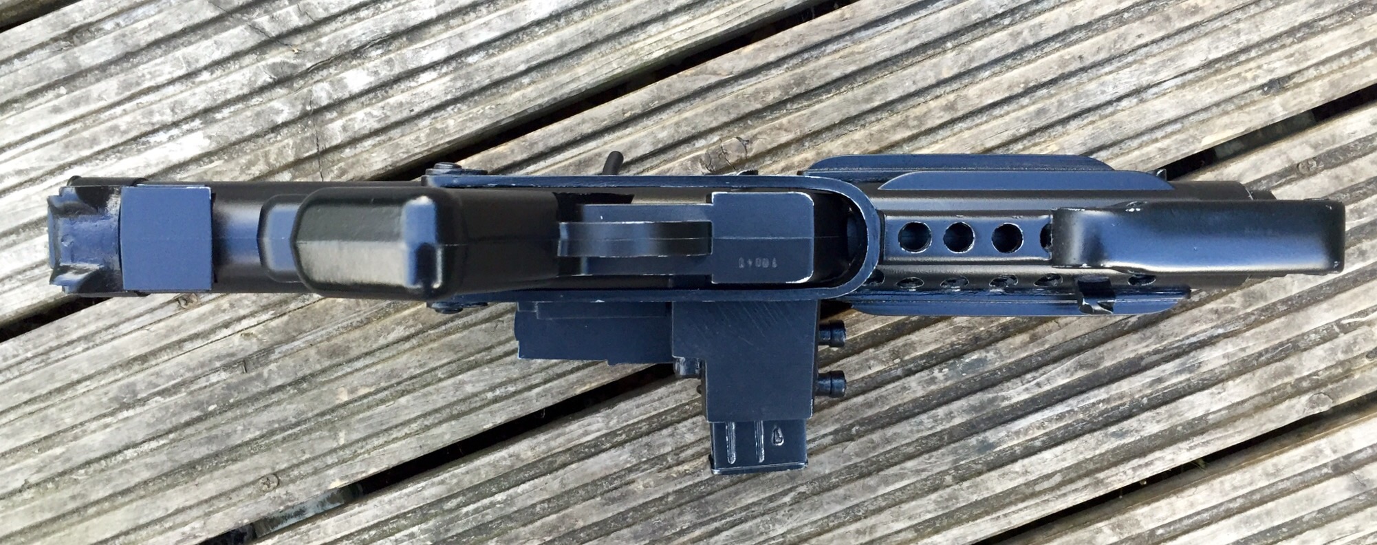

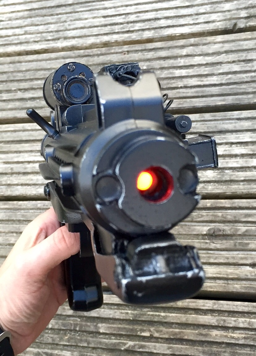

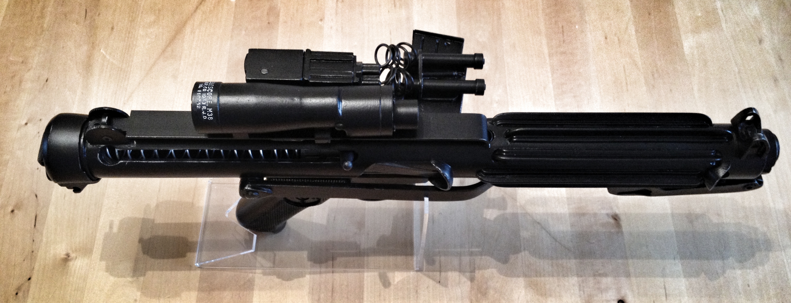

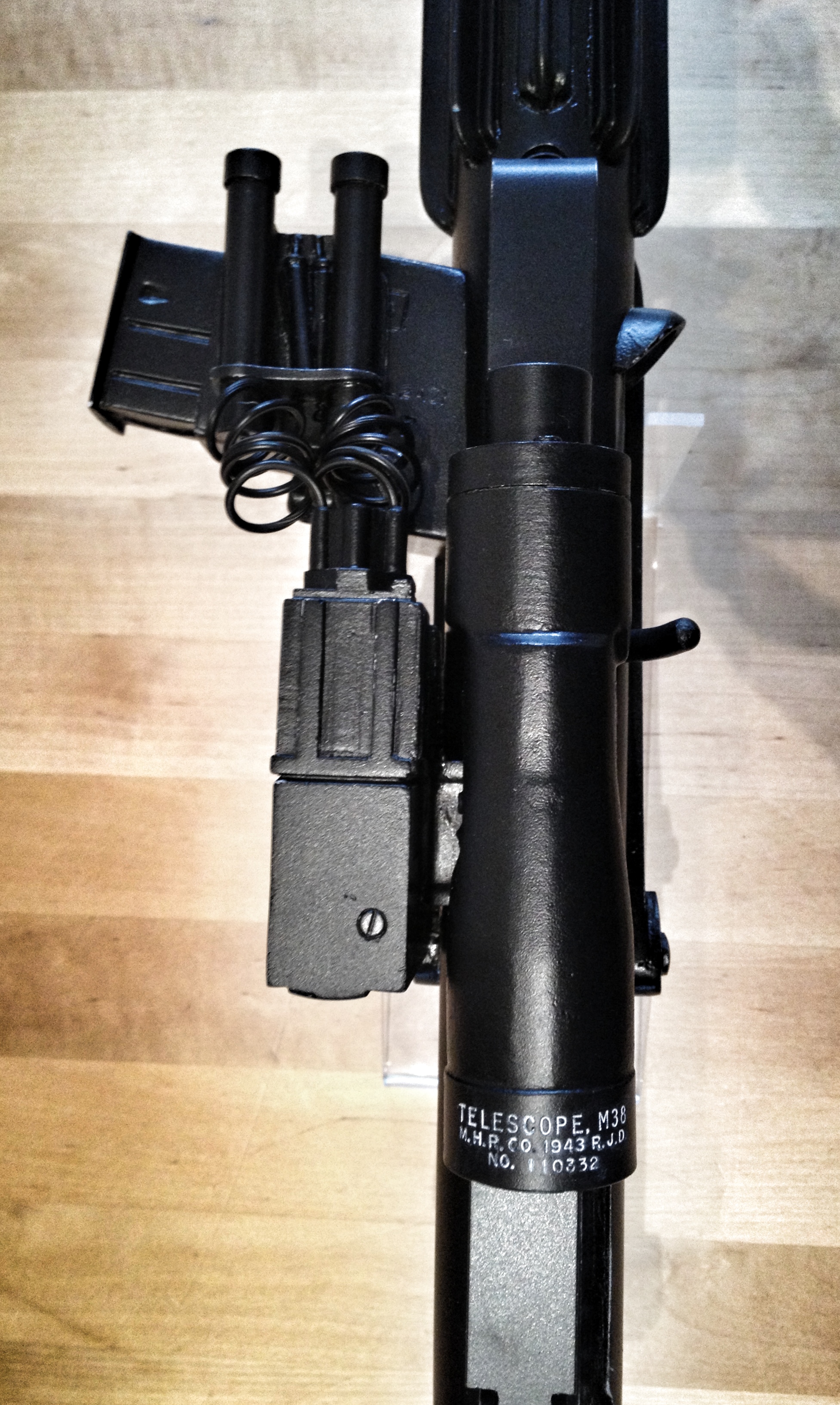

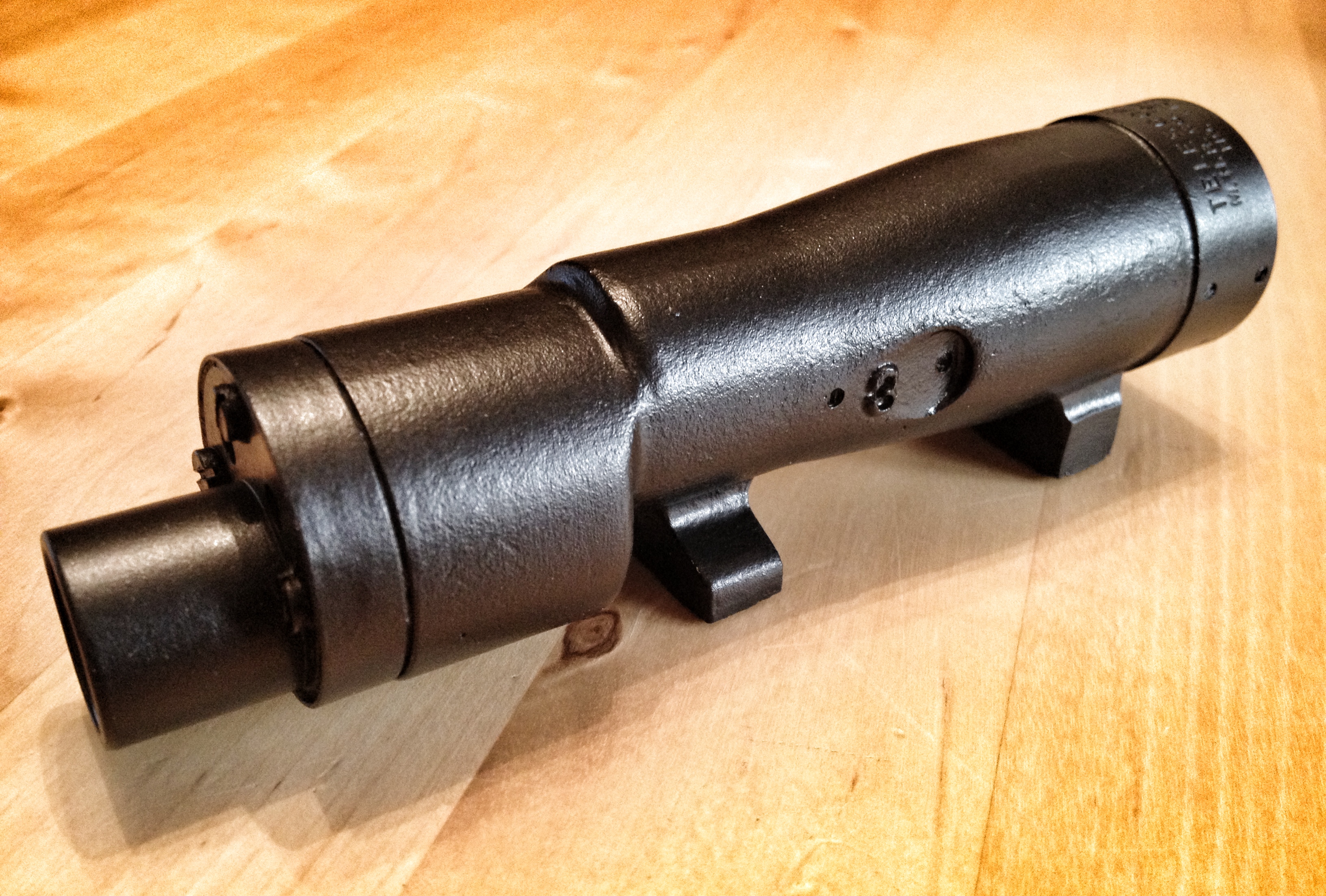

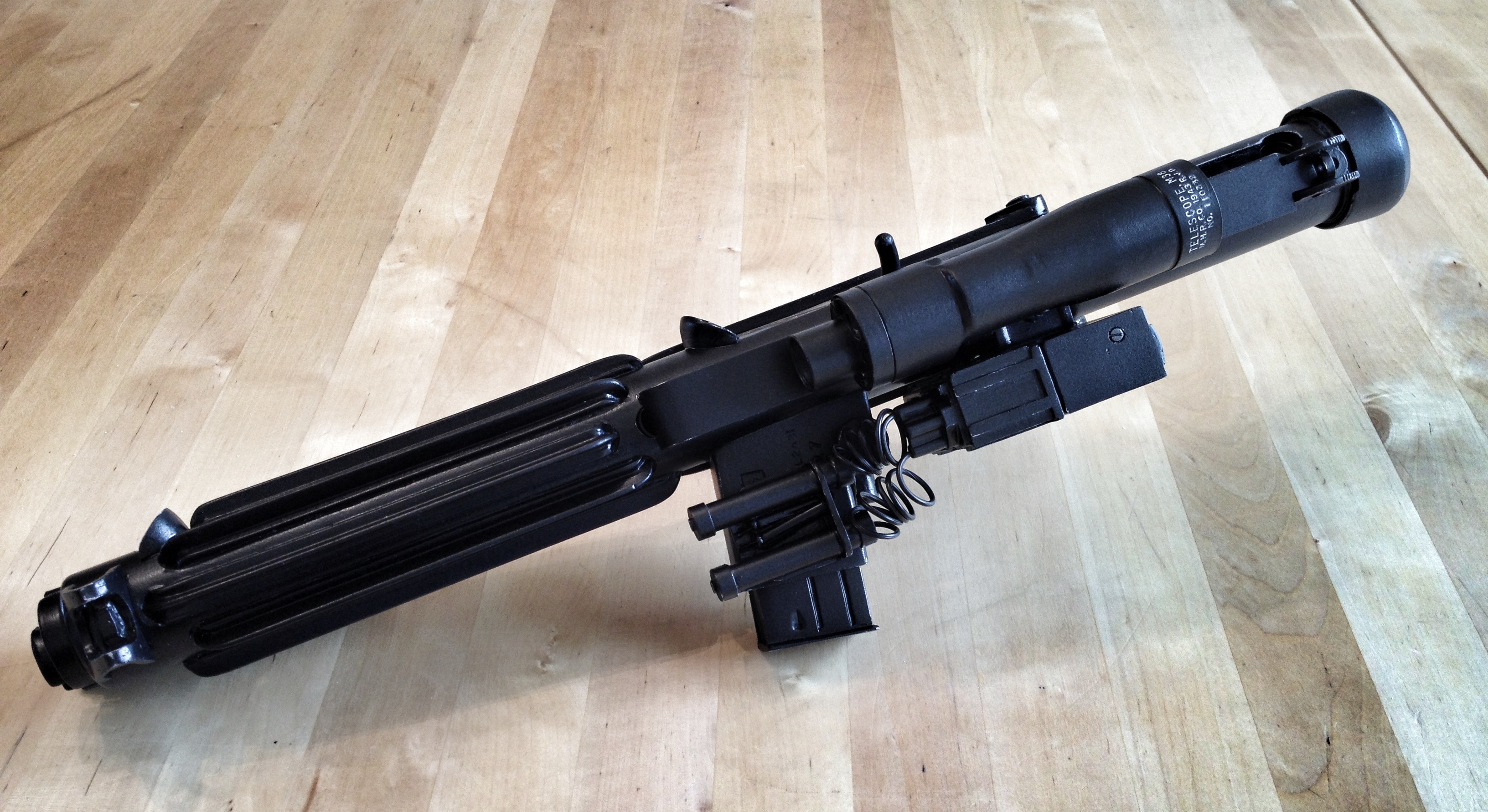

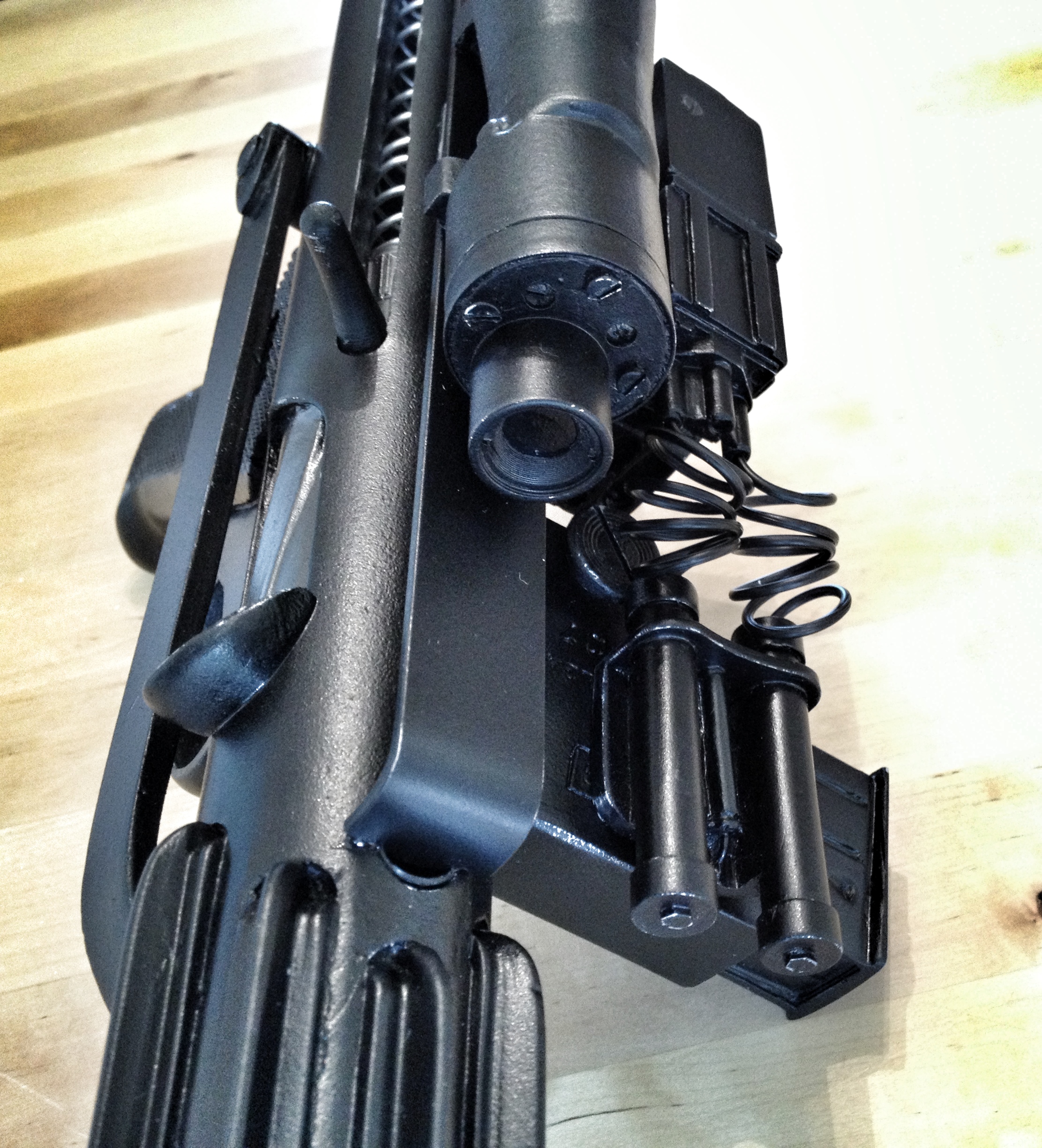

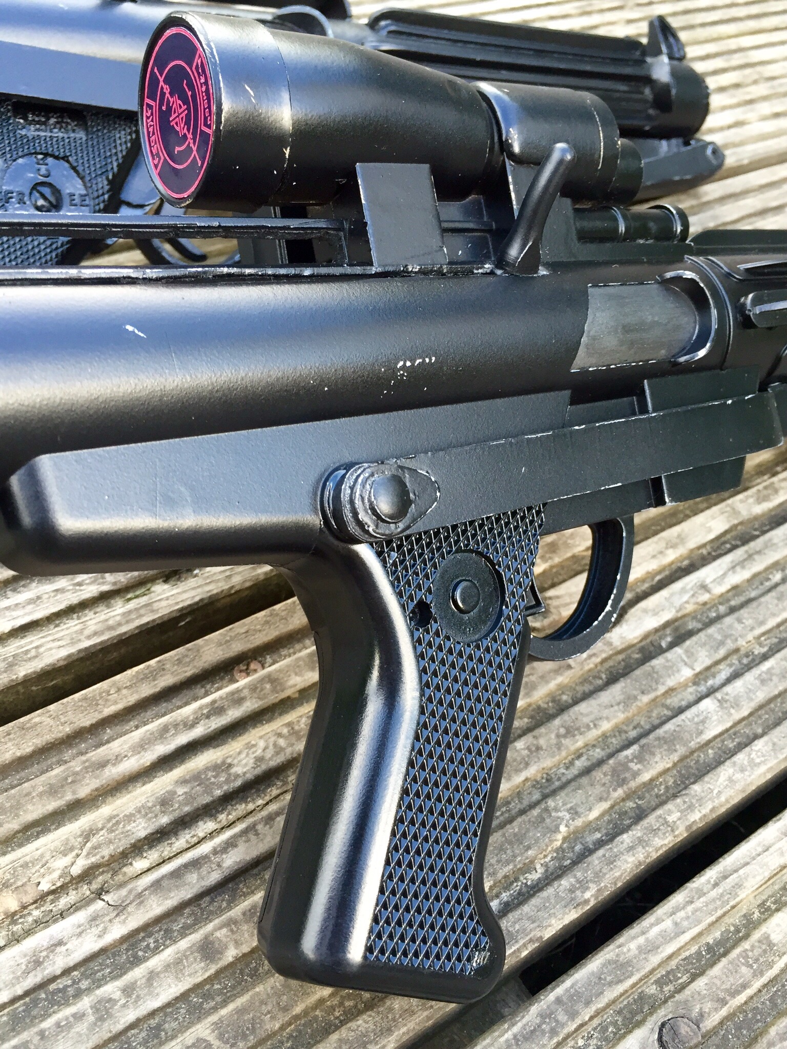

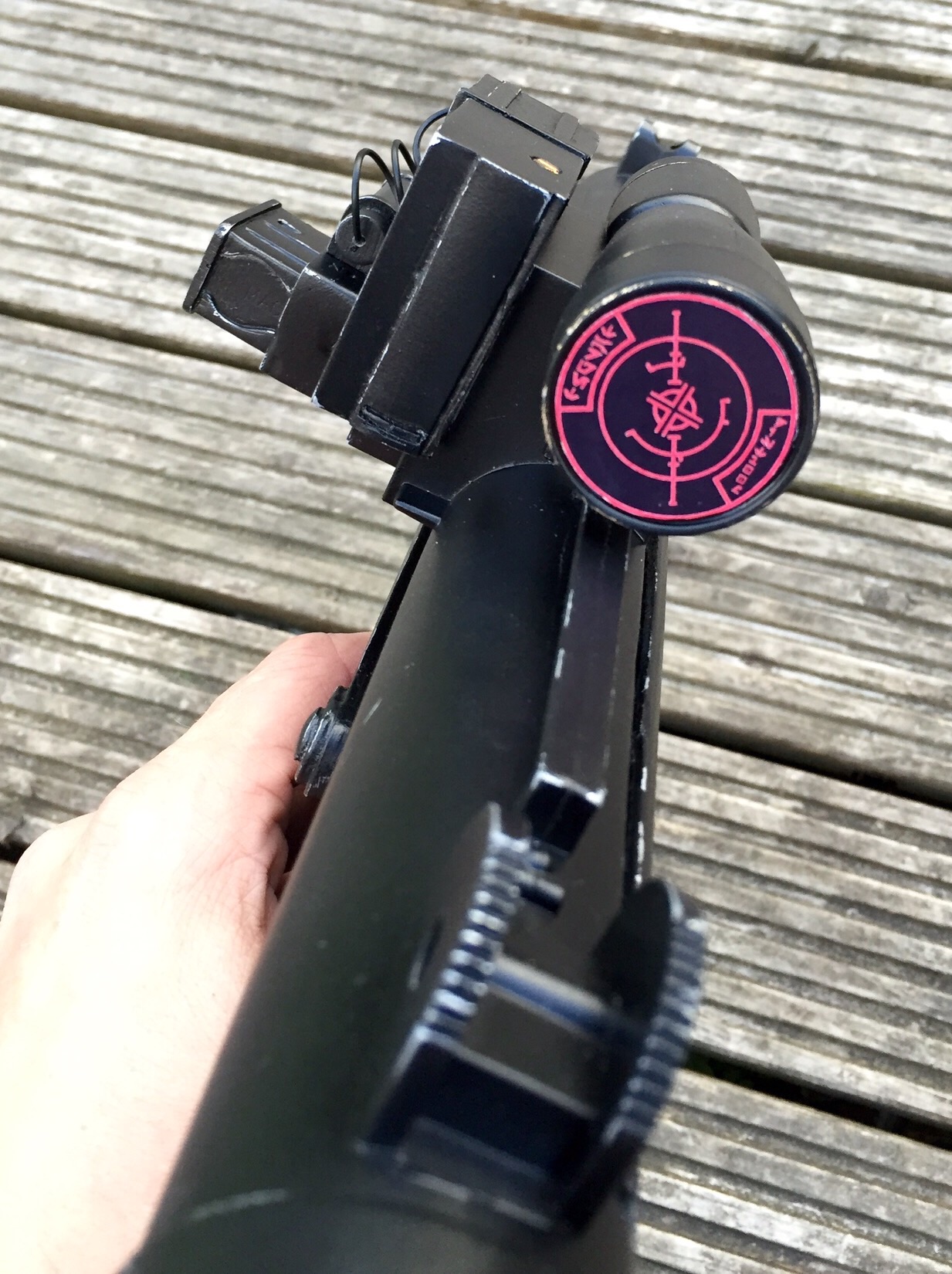

Finally put it all together with Hengstler & Cylinders (nearly didn't add them)
I also added the coiled wires (from an old charger) they're just slotted in to drilled holes not glued
I found some nuts which I filled & painted to put under the scope
I've given it a very light (for me weathering) just to give it the knocked about look
The scope didn't work out to well, don't think the brass paint was thick enough because when I tried to weather it went straight to the primer :facepalm

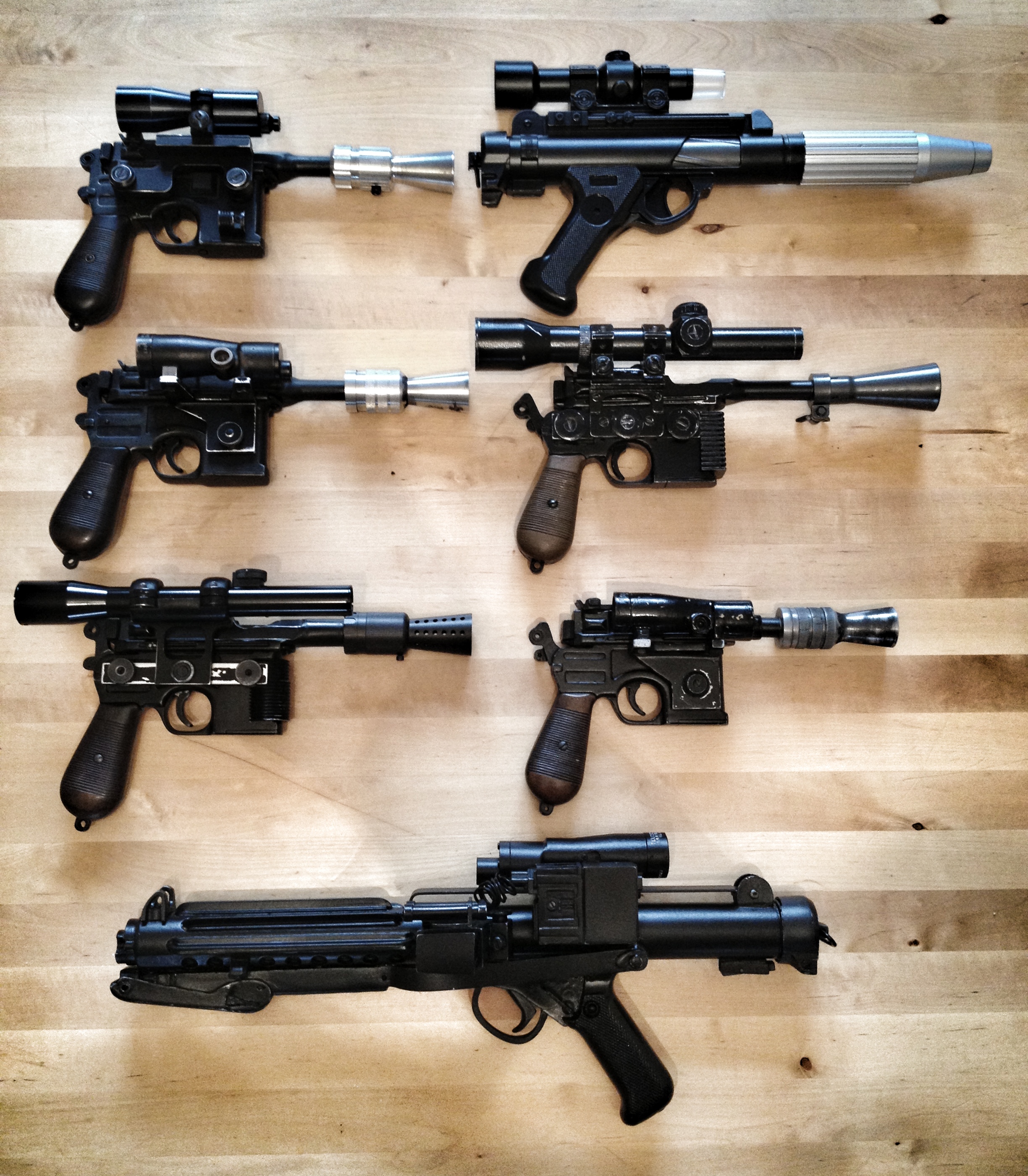

Anyway I'm pretty pleased with how this has gone & I think it's an improvement on my Hasbro blaster
I really do like the doopydoos kits
I'm no expert on the E11 & I know that there are some details I could improve but this is a first attempt & now I've done one I suspect I may give one another go at some point.

On the brass paint issue on the scope, have you triedgiving the brass a coat (or 2) of clearcoat prior to the black? I find it helps preveting weatherig going through to the primer....
Your mileage may vary, however. But it works for me...

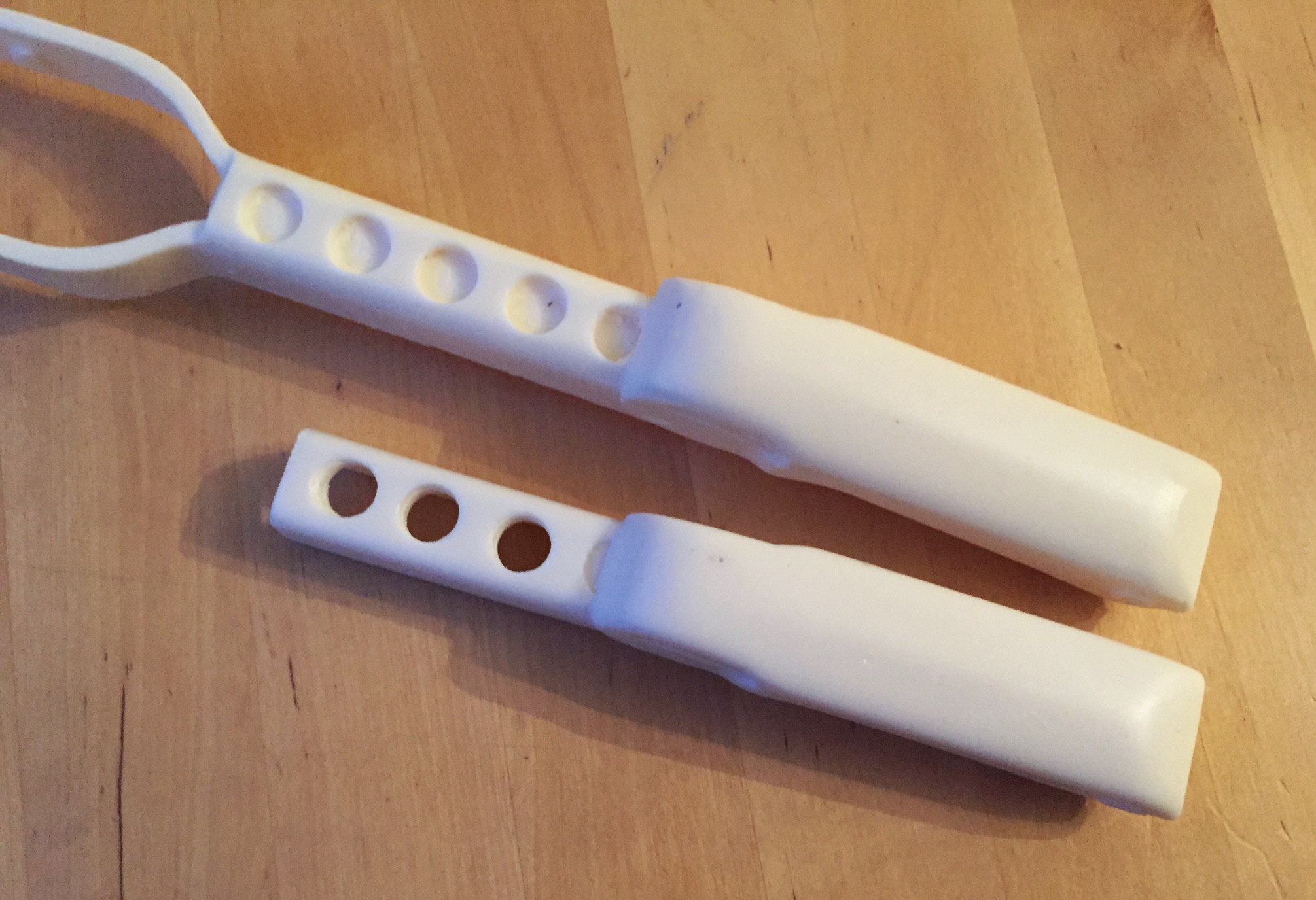

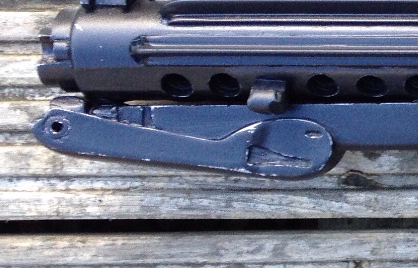

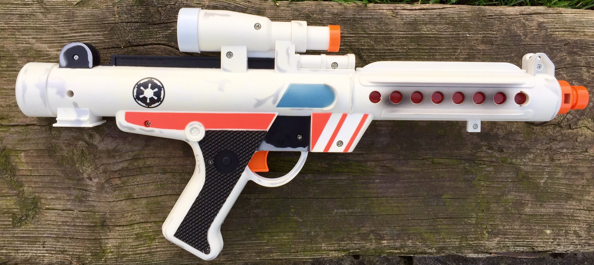

I seem to have a renewed enthusiasm for building in the last few weeks, I've got a Doopydoos E-11 kit & a Hasbro/Doopydoos kit to make
I've started on the clean up & prep but was wondering about the folding stock part
the holes on the bottom are very shallow I was going to drill a little more depth but wasn't sure if I should go right through?
I did on the hasbro one as it's only thin & figured it'll look better (& the hasbro will always be pretty inaccurate anyway)
but I'm not sure about the Doopydoos, I know there is a rod type thing in there on the real ones so you wouldn't see right through
not sure what to do with the indented part on the side of the front piece either looks like that could be drilled out also (I left as is on my last one)

For added realism, you could drill out those holes in the bottom and put a timber dowell or aluminium rod in there to replicate the rod of a real stock. And yes, ideally that little triangular section would also hollowed out. Be careful not to hollow out too far because if you have a look the main section of the stock would be visible at the top left corner of the opening (if you get what I'm trying to say...)

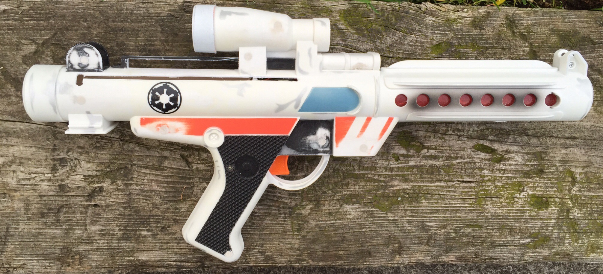

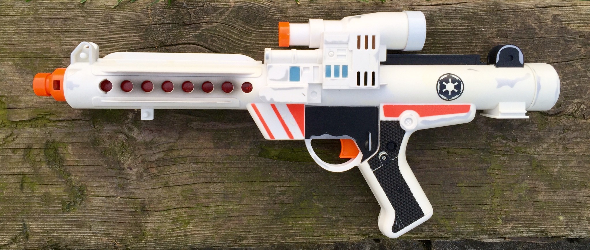

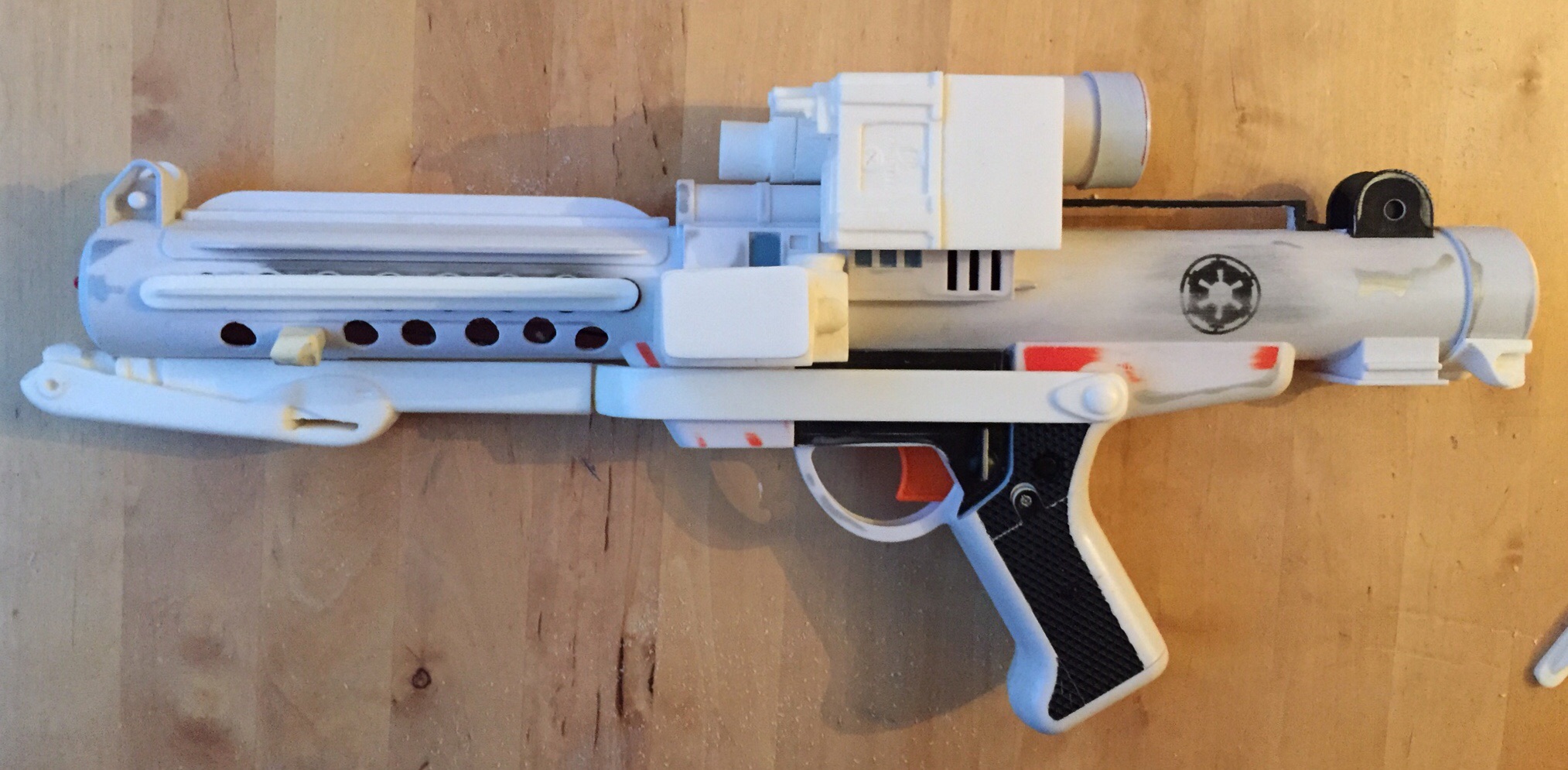

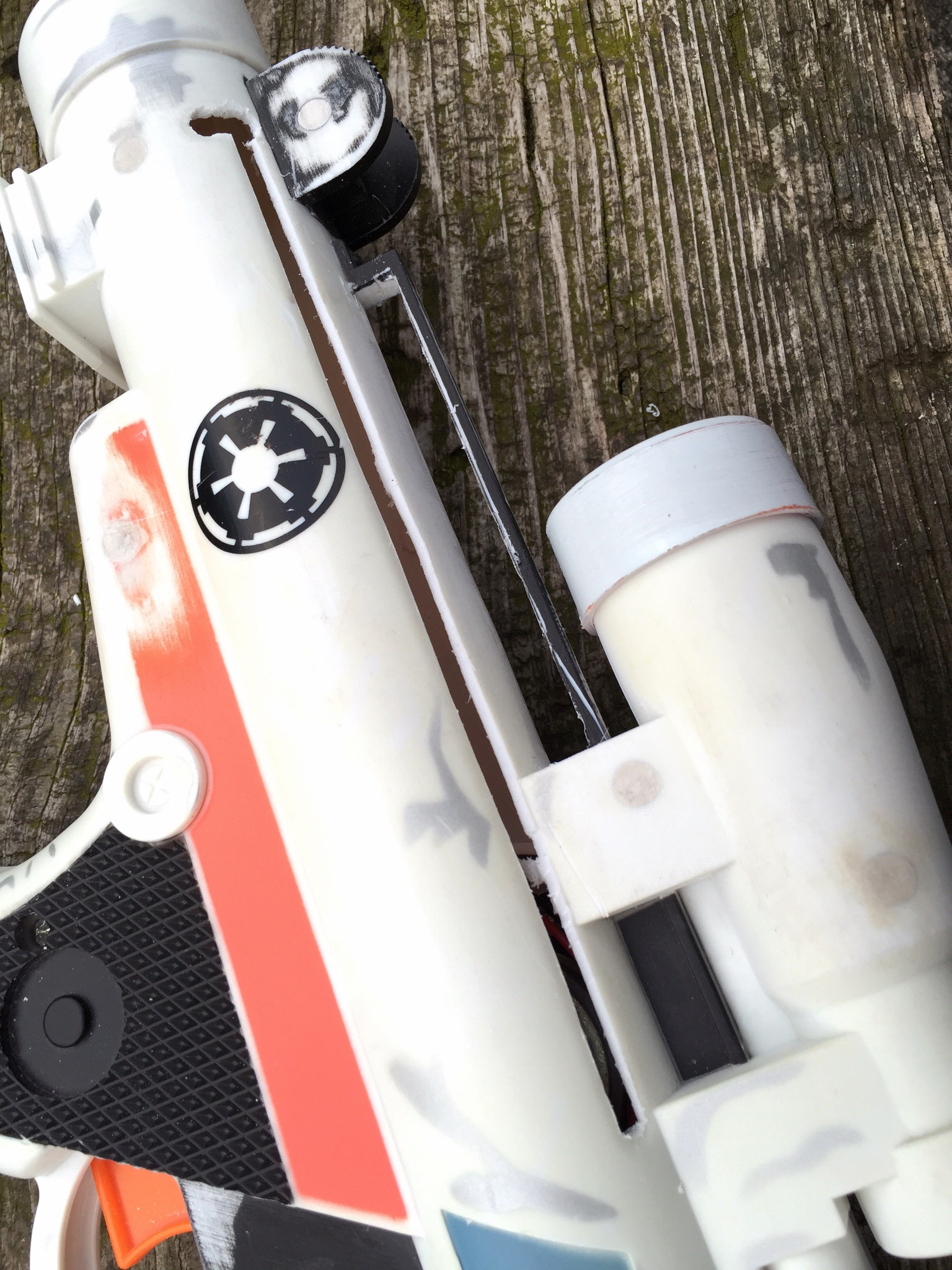

I started on my 2nd Doopydoos/Hasbro E-11 & thought I may as well document it here
I've had the kit & the blaster kicking around for a while since I found a stack of the old Hasbro blasters in a discount store (wish I'd bought more now)
I only intended to do a quick paint job as this is only to be used as part of a costume but I seem to have done a lot more prep than on my first one :lol
I drilled out the holes under the folding stock & the triangular section,
I sanded off the bottom "T-track" on the left hand side & did my best to drill an extra set of holes & added a bayonet lug (last hole was a bit low :facepalm)
I cut out the section under the scope rail & also the slot for cocking lever
obviously there are loads of inaccuracies that I'm not going to even try to fix but I figured a few little easy details might help the finished look (I didn't do them on my first one)
but really this was supposed to be a quick easy build

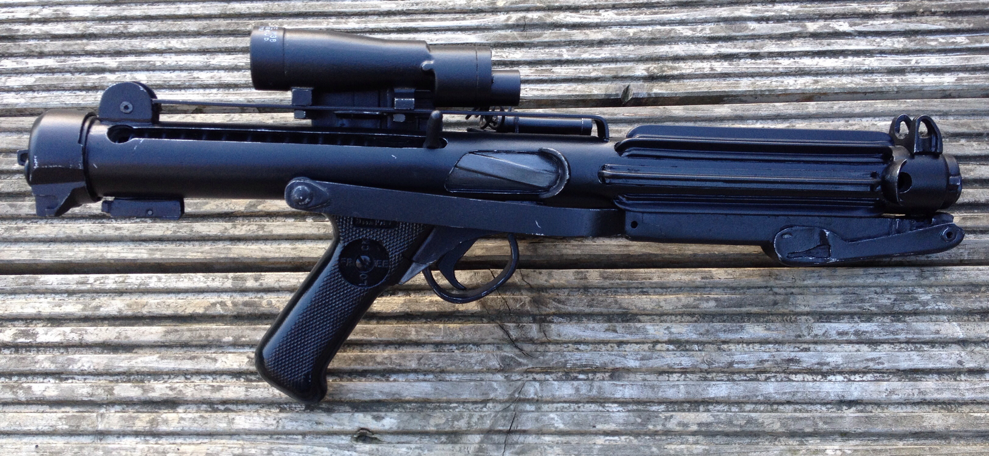

Enjoying building this more than I thought I would (& it's taking longer)
undercoated & sprayed black, decided I'm going to gloss the grip to be more like my Doopydoos
hopefully be be able to put it together soon & then I can start weathering (my favourite bit :lol)

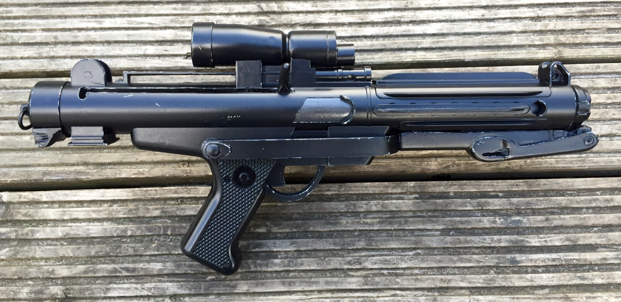

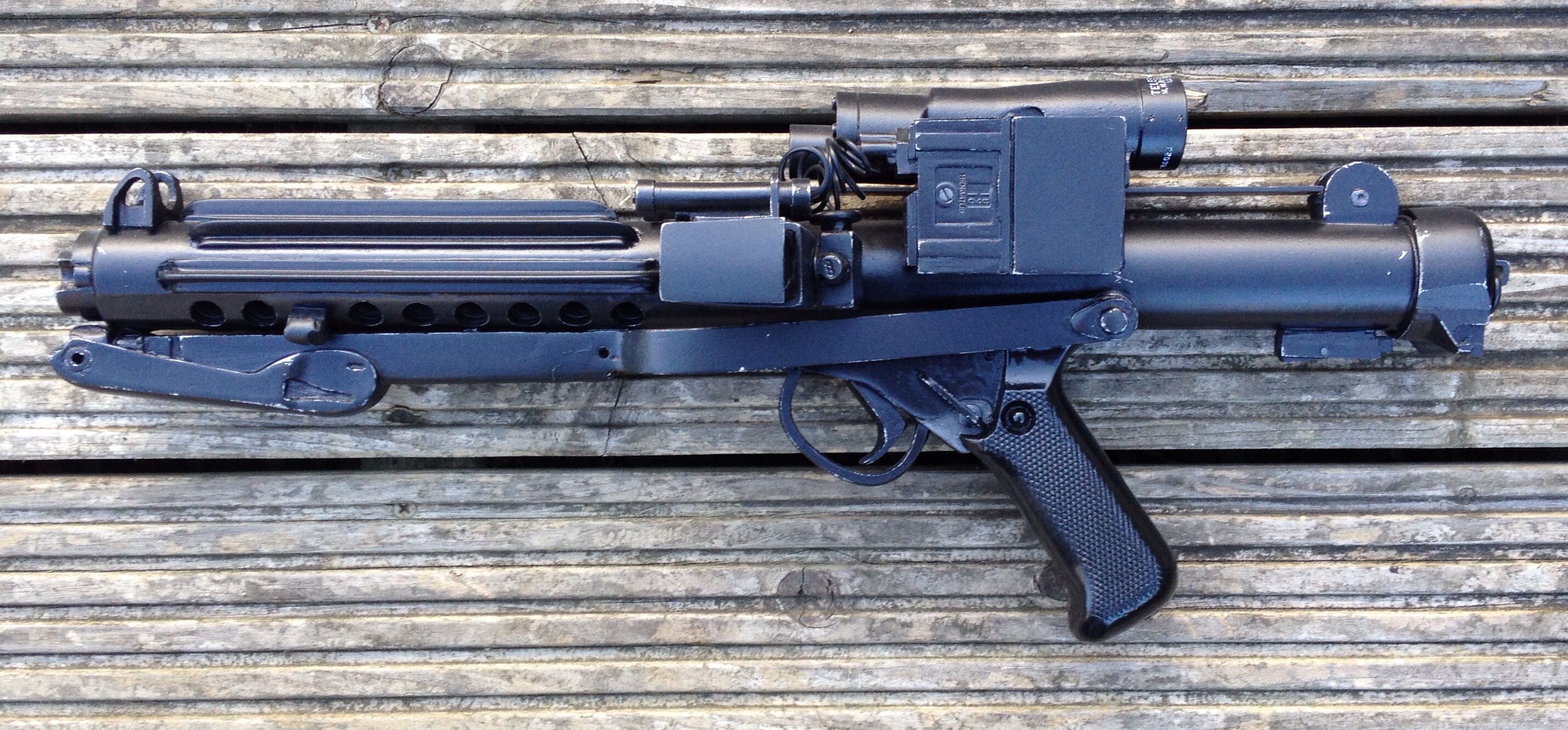

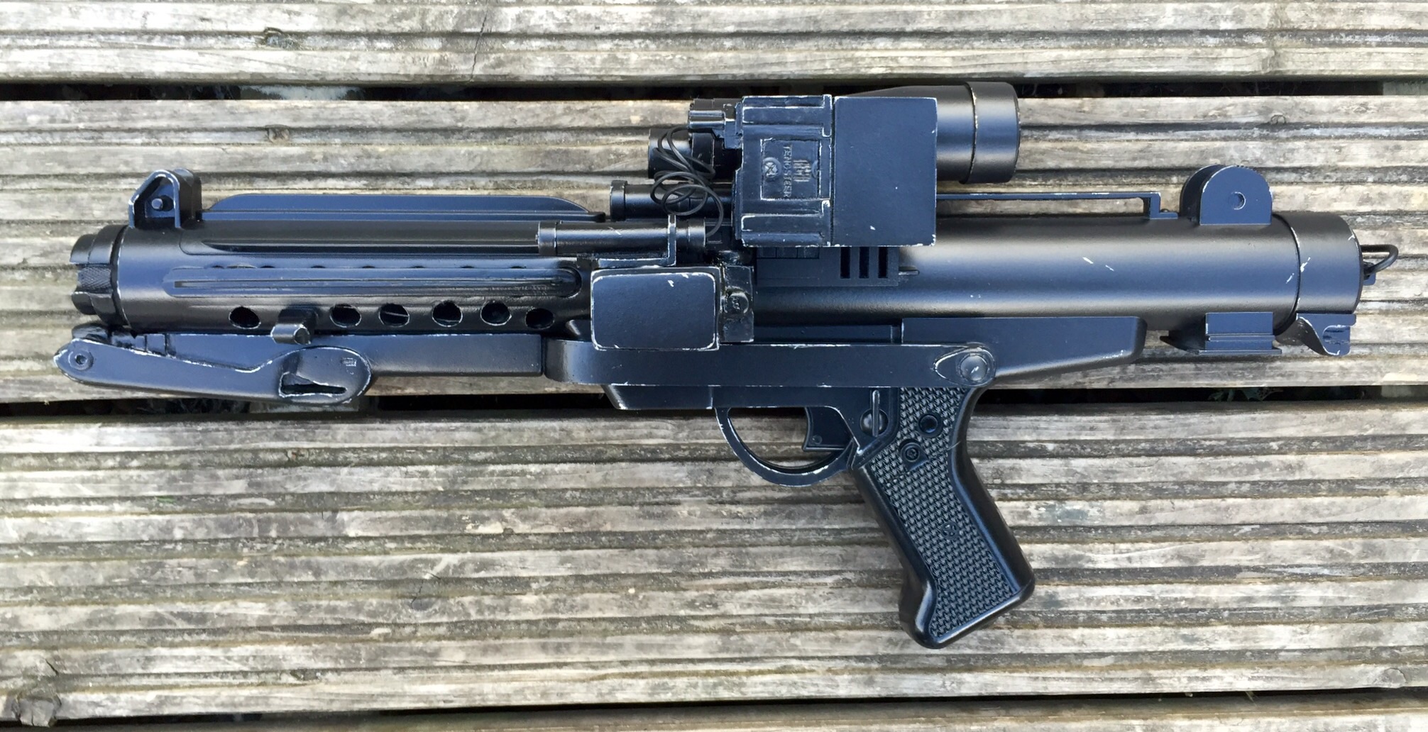

Got it put together & weathered
pretty pleased & feel that it's turned out better than the first Hasbro conversion I did
