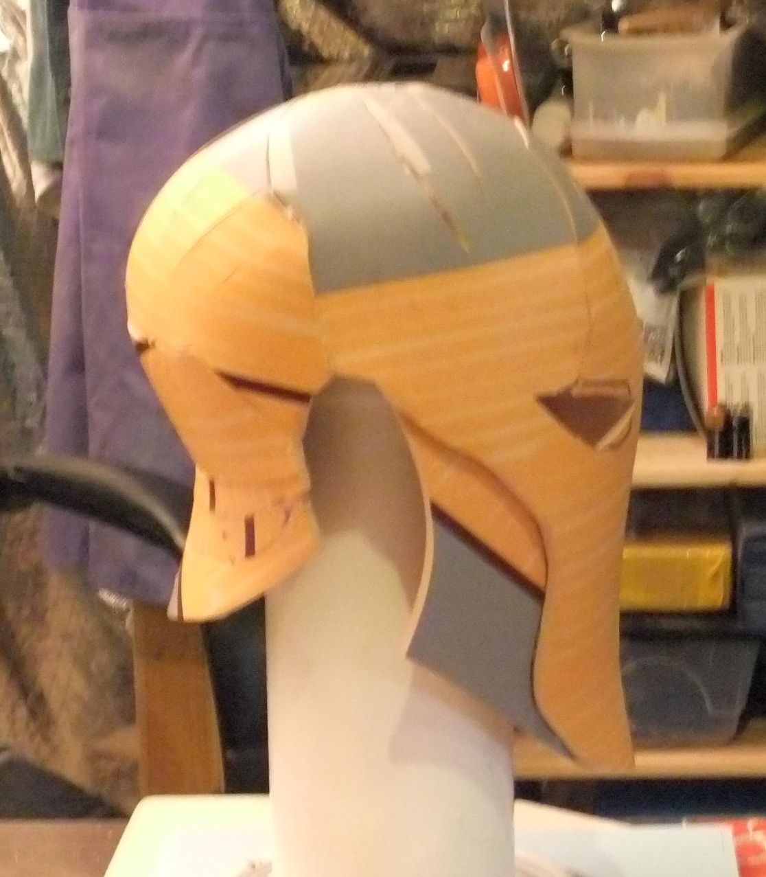

So,
i used the excellent foam pep file from JFcustom as a base for my build.
I modified the foam pieces to suit the size and shape needed.
I then coated the foam pieces with resin to stiffen them up.
Monster clay is then add to the armature, so i can start blocking out the shape.
The eye shape and positions will be fixed later with the raised trim.
Dr Fate helmet 1.jpgDr Fate helmet 2.jpgDr Fate helmet 3.jpgDr Fate helmet 4.jpg

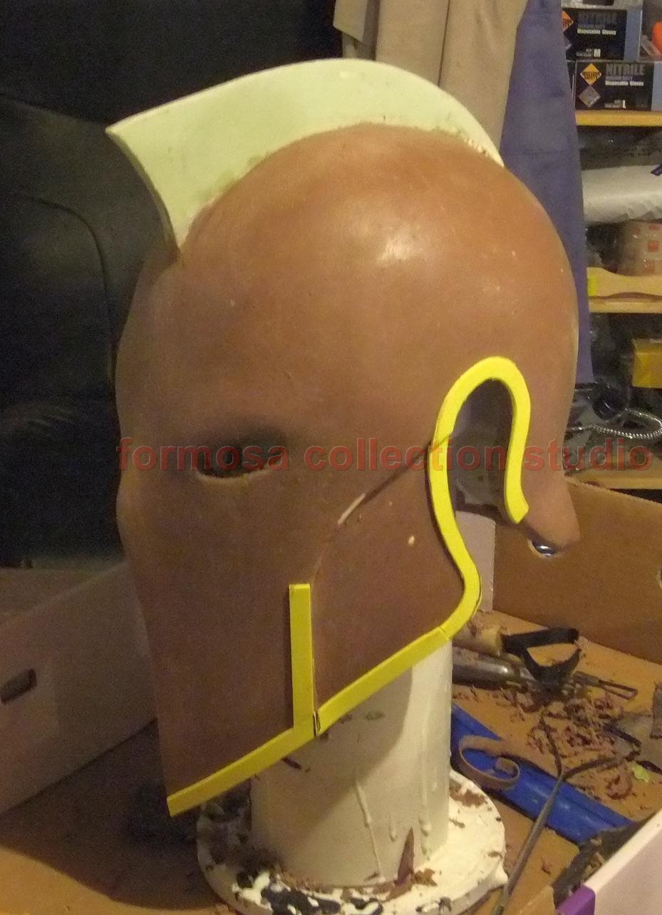

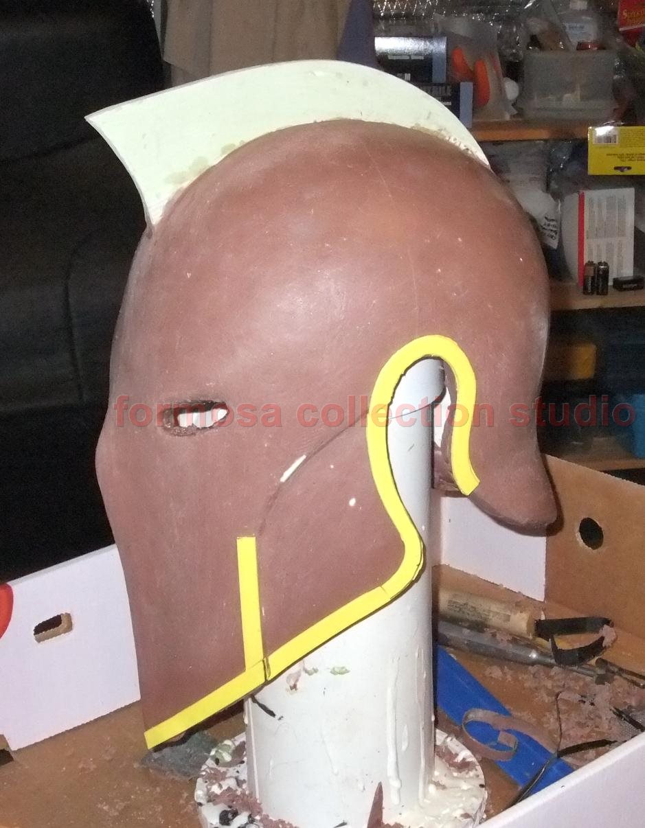

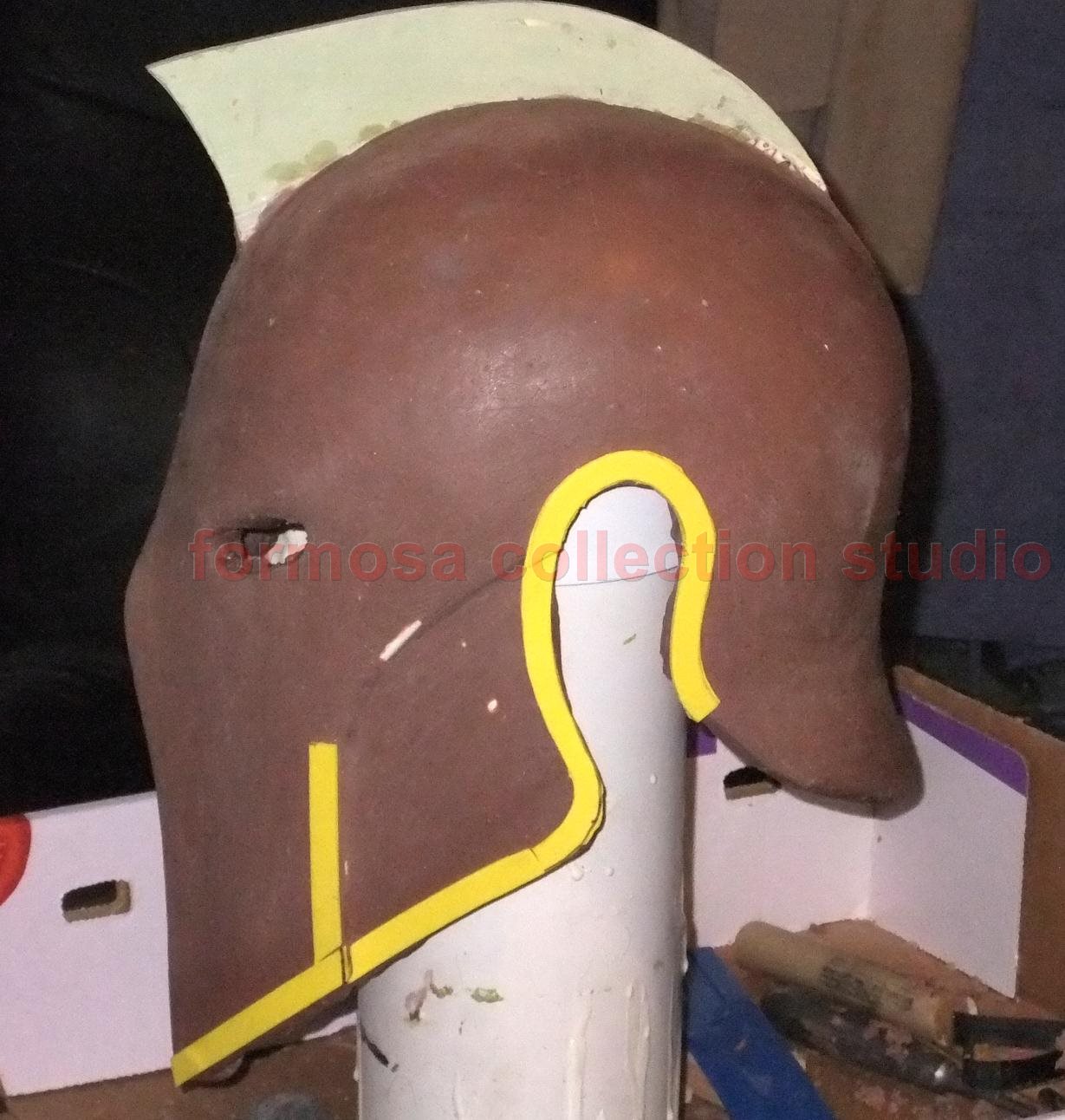

A little update.
Smooth the clay some more.
Thicken up the fin some. Not sure if i like it.
Trying to decide if i want to fix it later after the waste mold / cast is made.
Use some foamie strips to do some preliminary layout of the trim.
