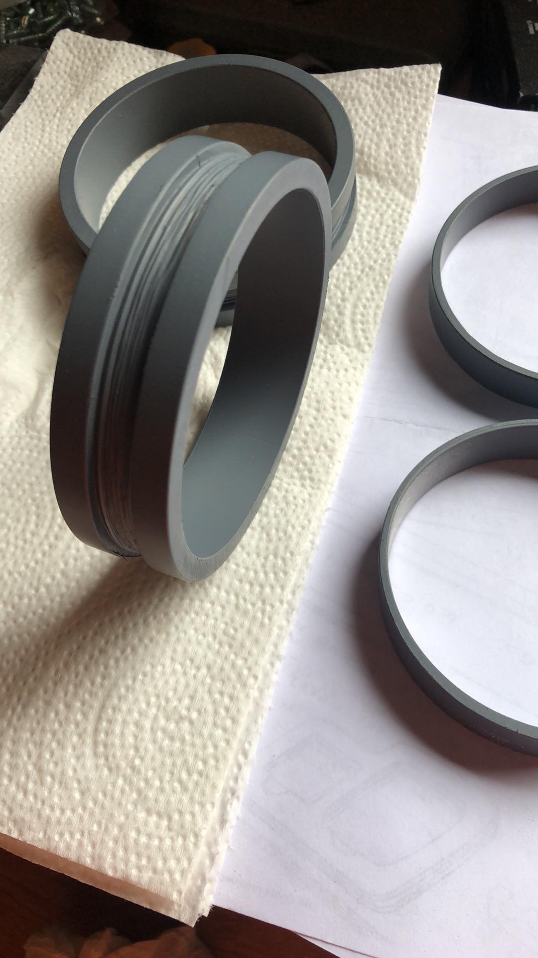

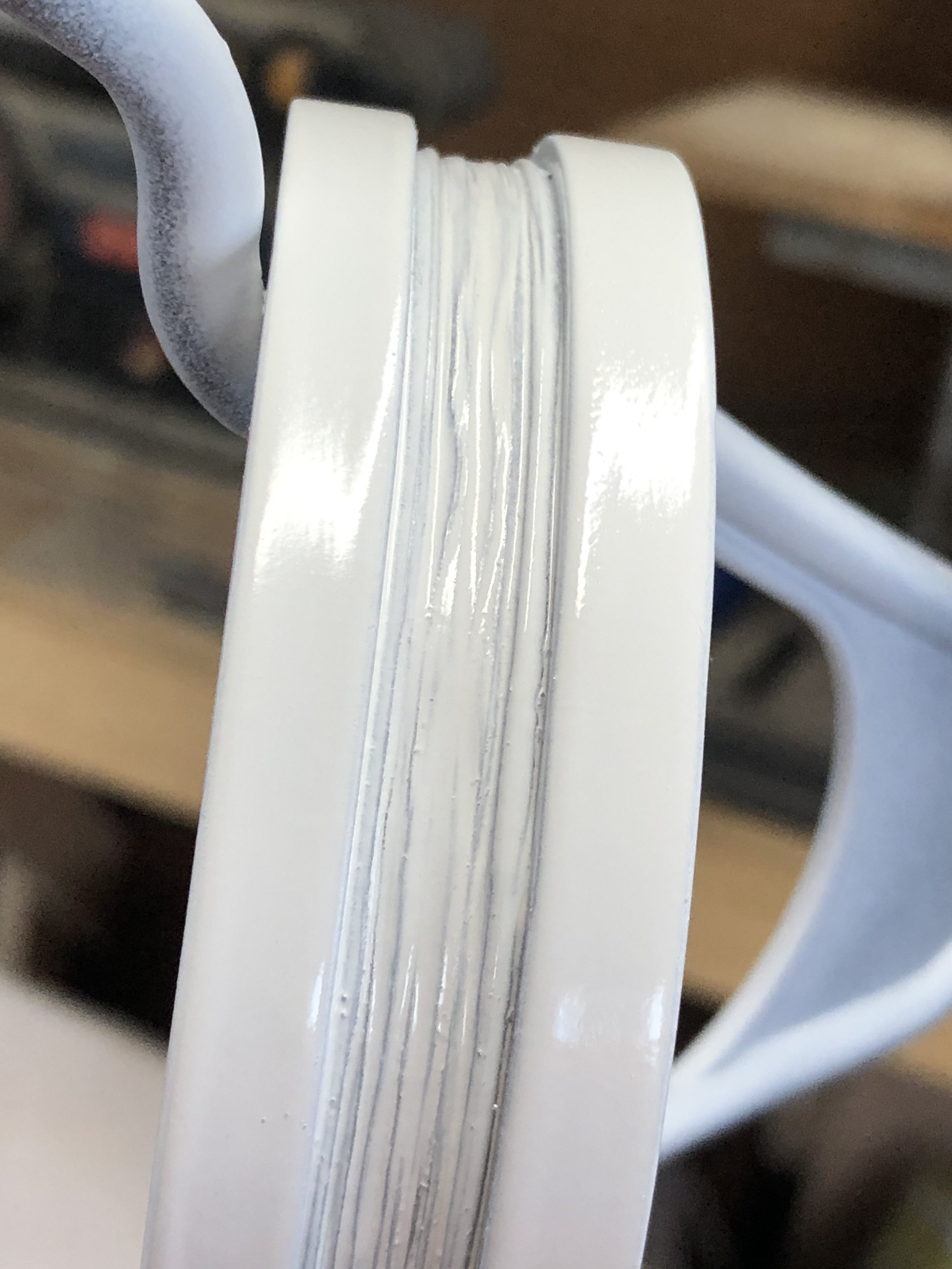

Had a paint mishap with the first set of jacket cuffs I made so I had to halt and cut a new fresh set.
The cuffs are cut from 3”pvc pipe coulper and the center section for the grey rubber band was carefully dado cut out with a tablesaw(don’t attempt this unless your comfortable and proficient with a tablesaw as this was a real dangerous maneuver).
Once the grey primer had cured I did a wet sand with 220 and 320 grit sand paper.
I then did a paint test of the burnt orange I’ll be using over a white, grey, and silver primer base. The winner is the white primer, the other two dull the color imo.
Paint used is lumière burnt orange thinned to a 50/50 mix with a home brew thinner of 70%water and 30% isopropyl alcohol(91%) and applied with an airbrush.
And the 320 wet sanding and cleaning the cuffs where reprimed with white. Think I’ll do a 400 wet sanding before final paint. And most likely covered with alclad gloss clear coat(which I’ll be testing first).

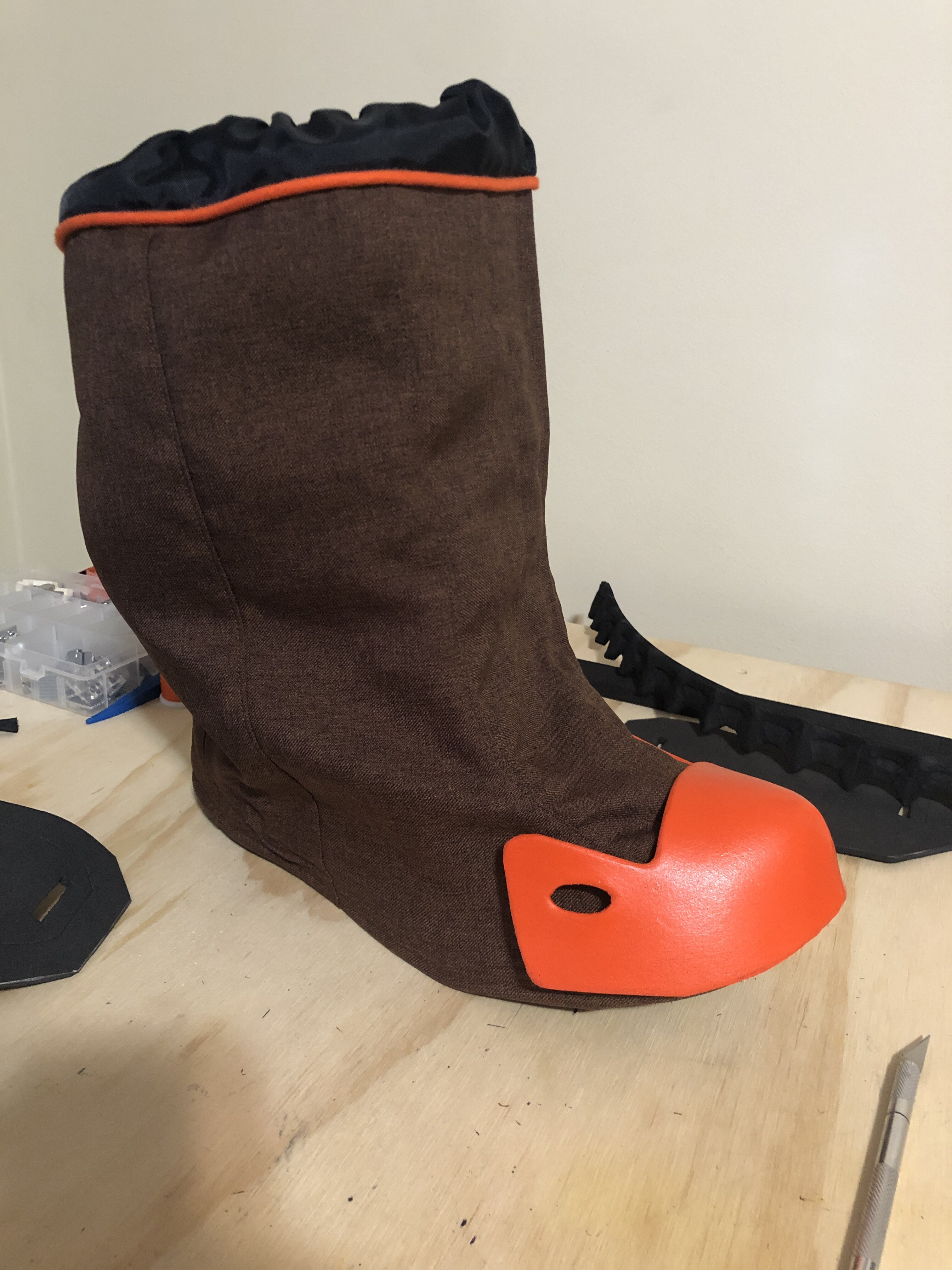

Progress is slow right now but I’m still giving this suit all the time I can. Been working on the boot pieces to try and button those up. Cutting the treads out of a strip of 10mm thick foam and sanding with a dremel. Think I might paint those with black plastidip to make them look more like rubber.
Toe plates are 4mm foam made from a tape pattern and painted with Angelou’s orange leather paint.

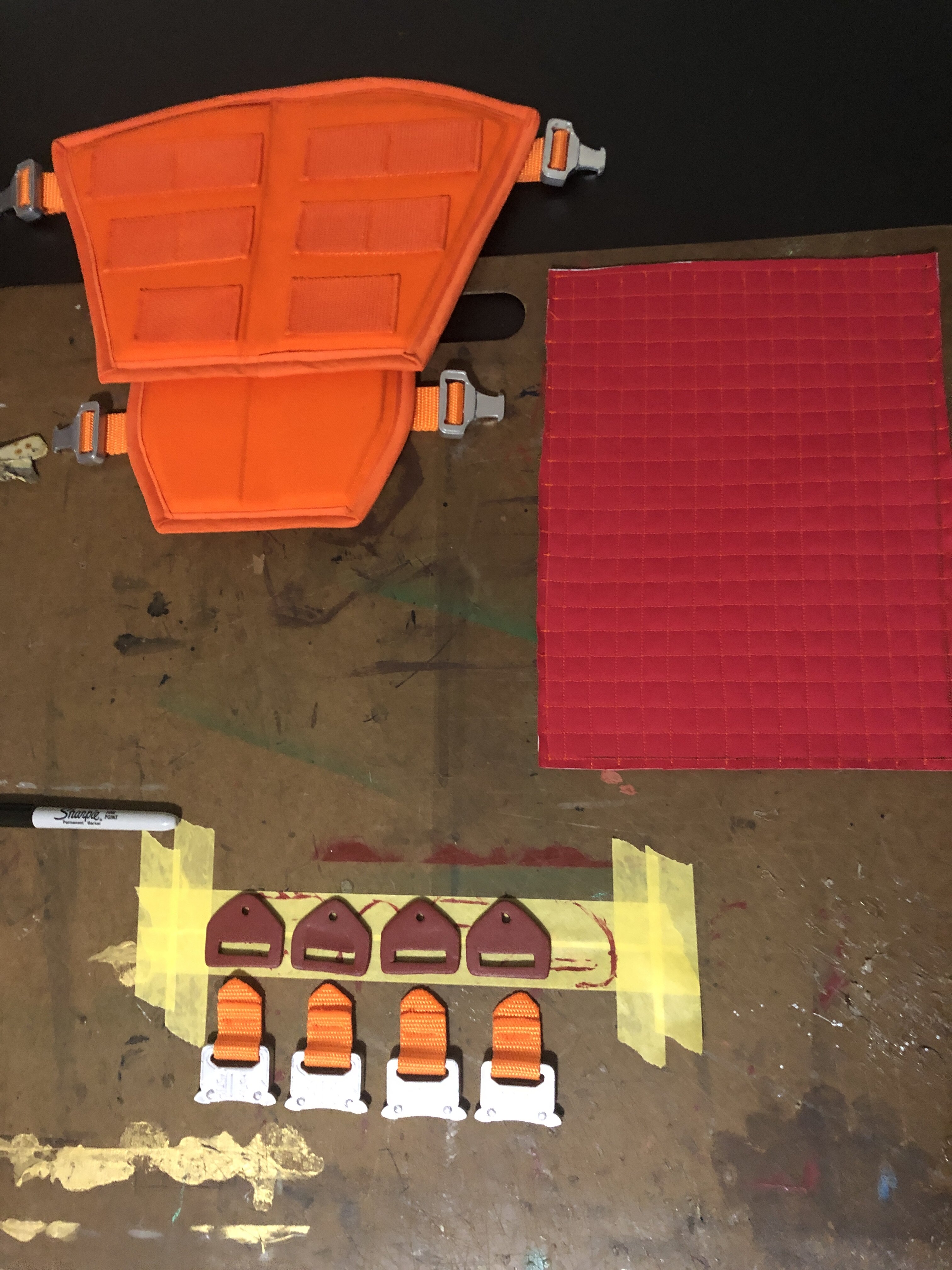

Also finally got ahold of some orange bias tape to finish the ab pads. Recently painted the metal buckles a shinier silver and once i paint the orange straps I’ll be able to attach them to the jacket.

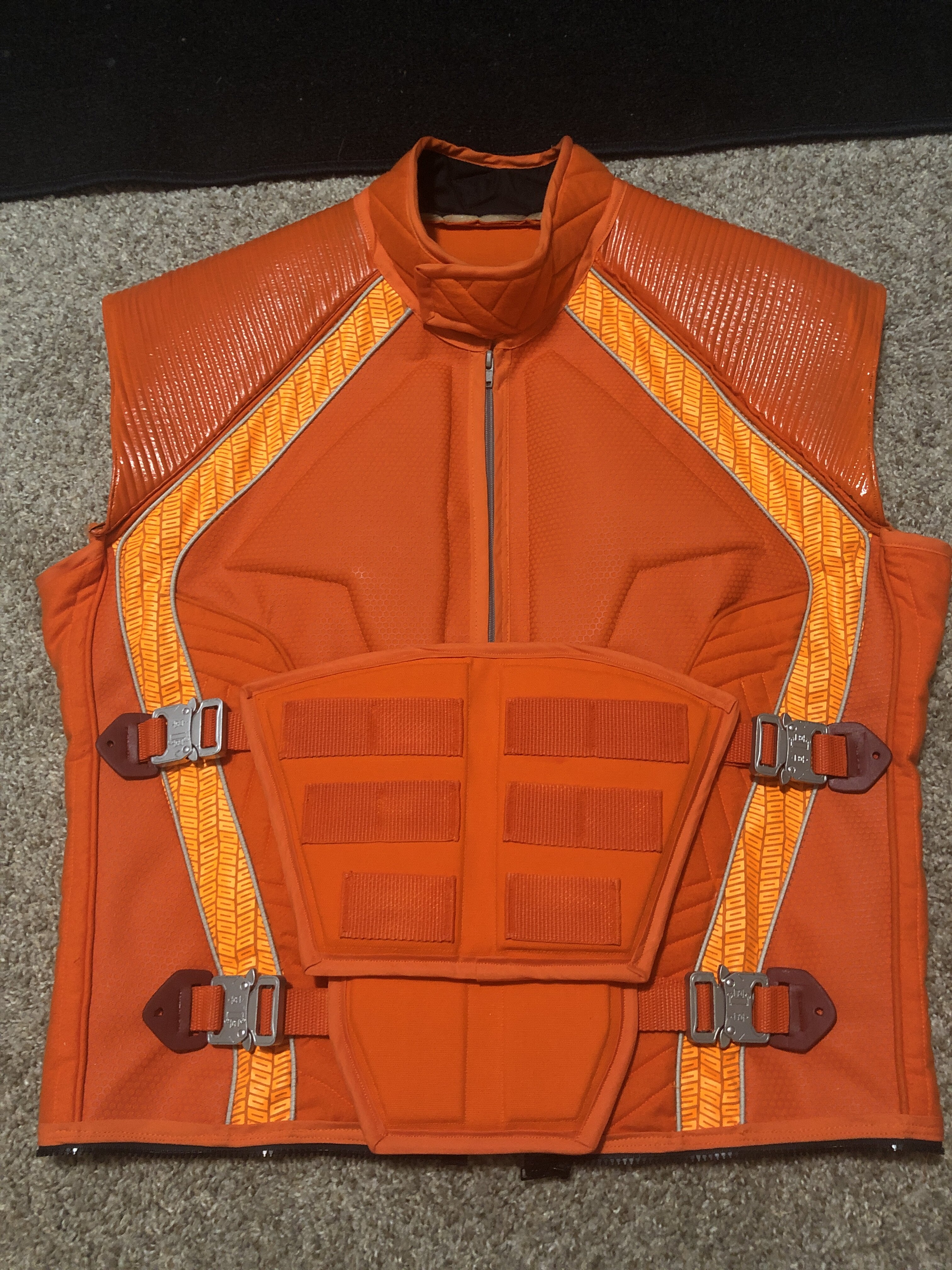

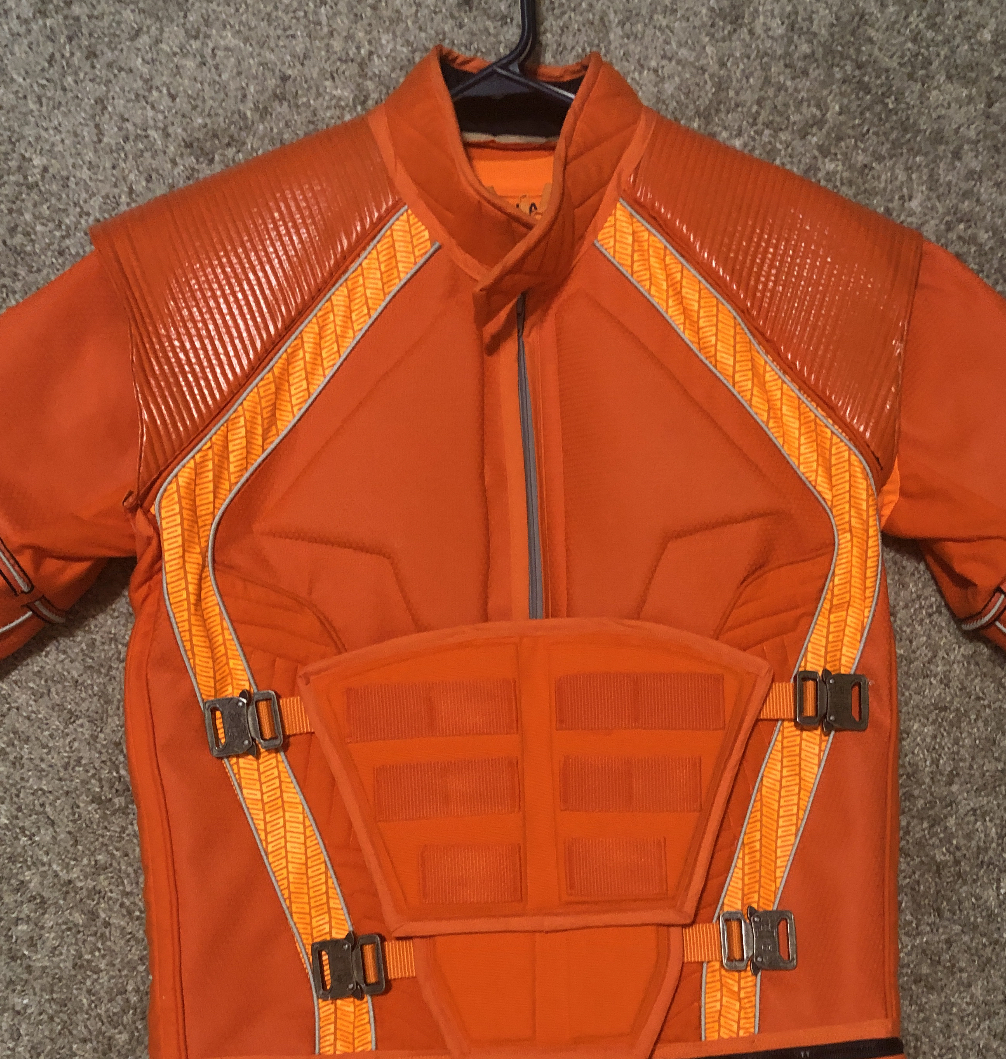

Lots of progress the past few weeks.
Finished up the ab pad and it’s buckles, just need to Chicago screws to hold the red plates to the jacket. Also attached magnets on the collar to keep that closed. Vest just needs shoulder bells to finish.
Also sewed my red quilt pattern for the palms of the gloves. Used a utility red fabric a piece of stabilizer and so felt give it a quilted like puff while also staying thin and foldable since it’ll be the palm.

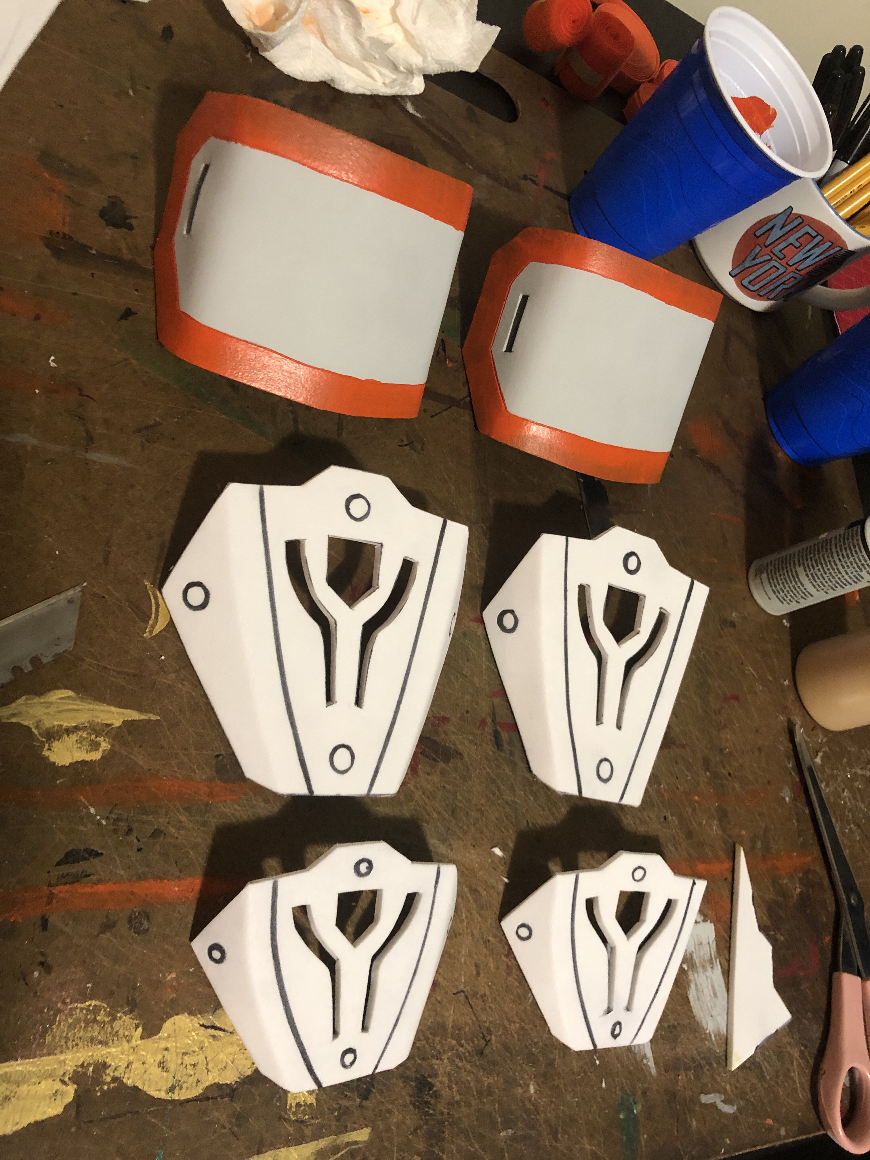

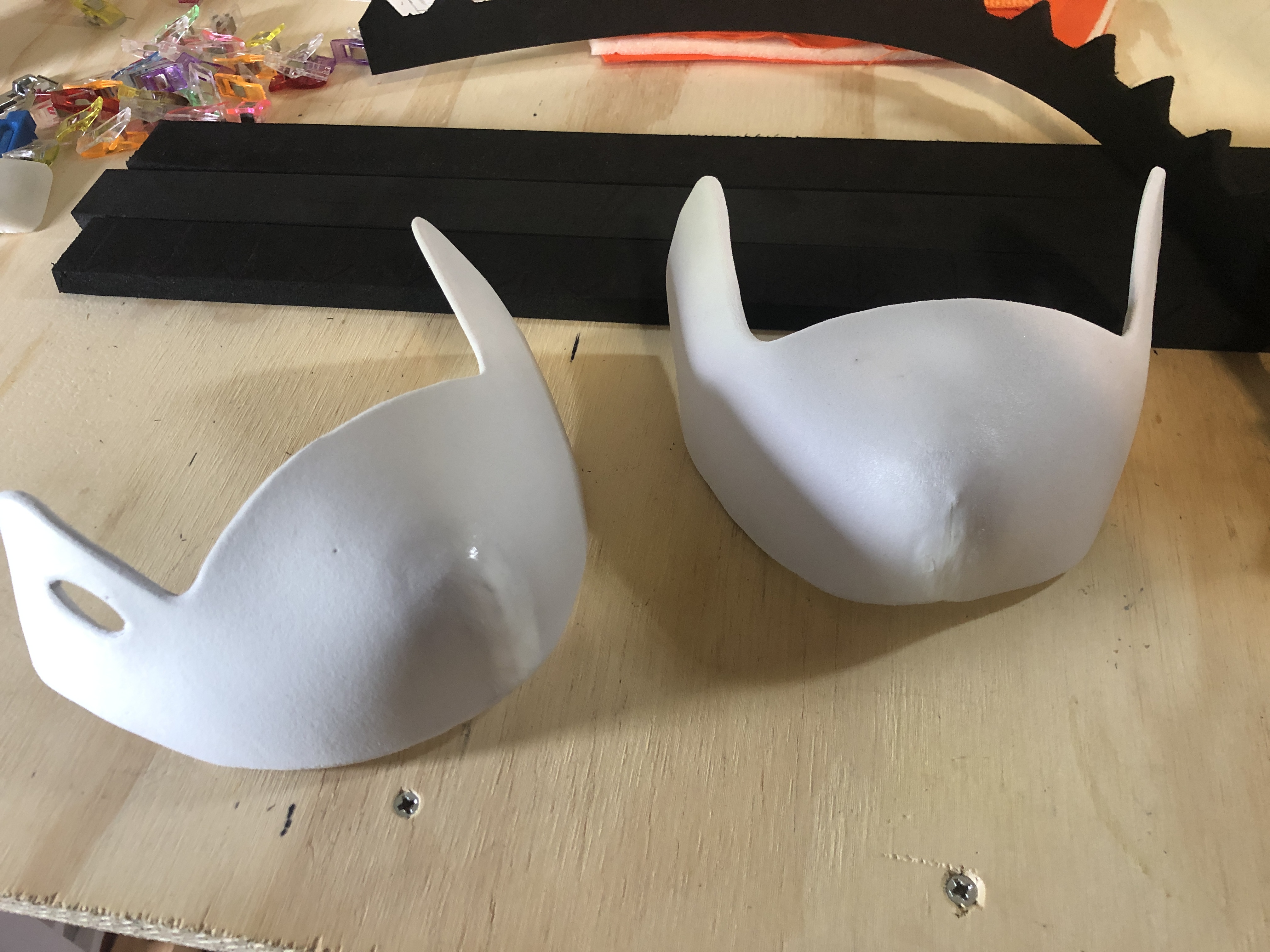

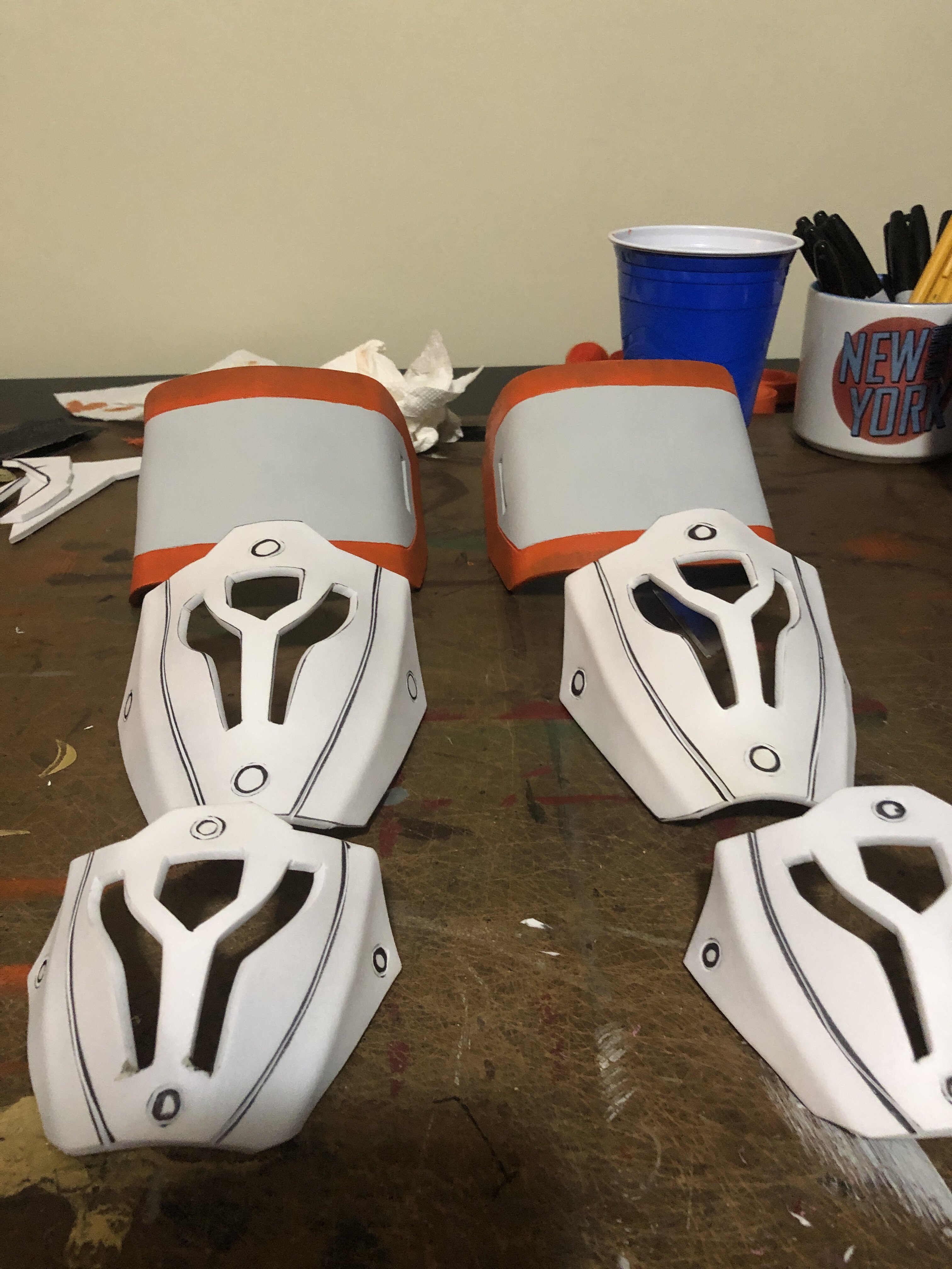

Hand drew the patterns for the knee and elbow pads. Made them out of 4mm foam and heat molded them into shape. The knee pads will mark the finish line for the pants.
I also have the ankle guards being painted to continue finishing the boots.

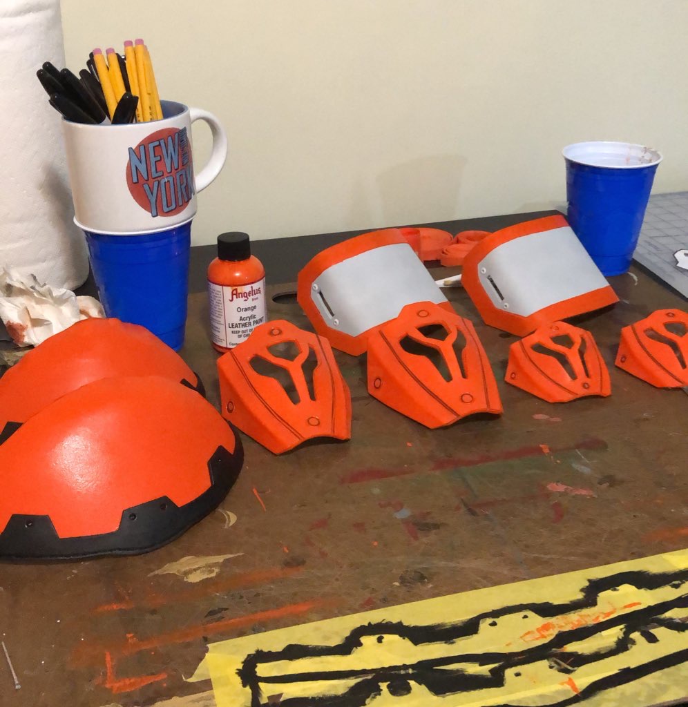

Started painting all the foam parts(A few coats to go) and made the shoulder bells too. The black piece on the shoulder bells was done with a piece of 2mm foam and they were run through my sewing machine to give a stitched look on their bottom edge.
Also added a small detail, boot guards now have pop rivets placed top and bottom of the strap cut out. Since the boot covers are thin foam I pulled the rivets off their rods and glued them into place as opposed to popping them.

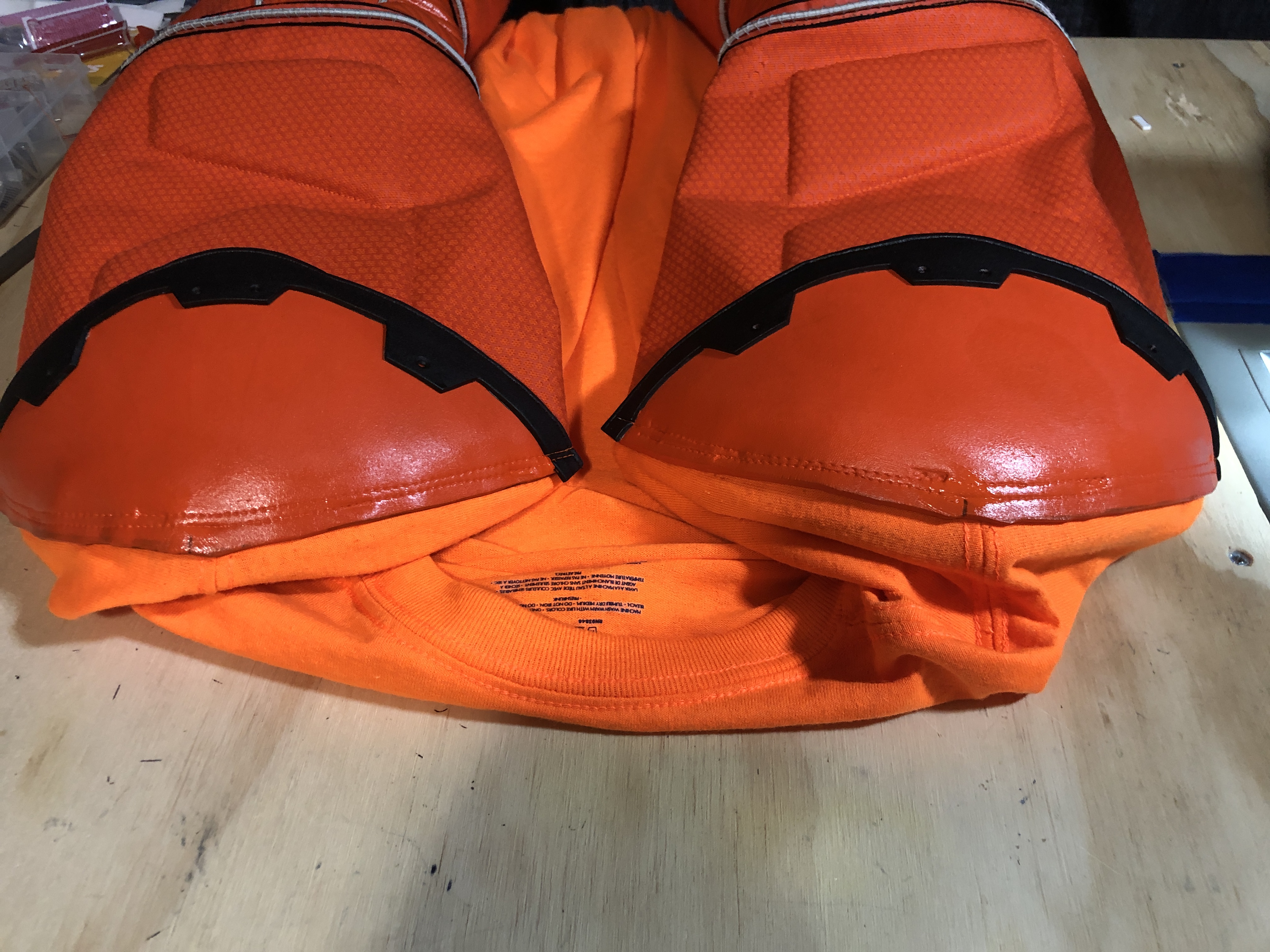

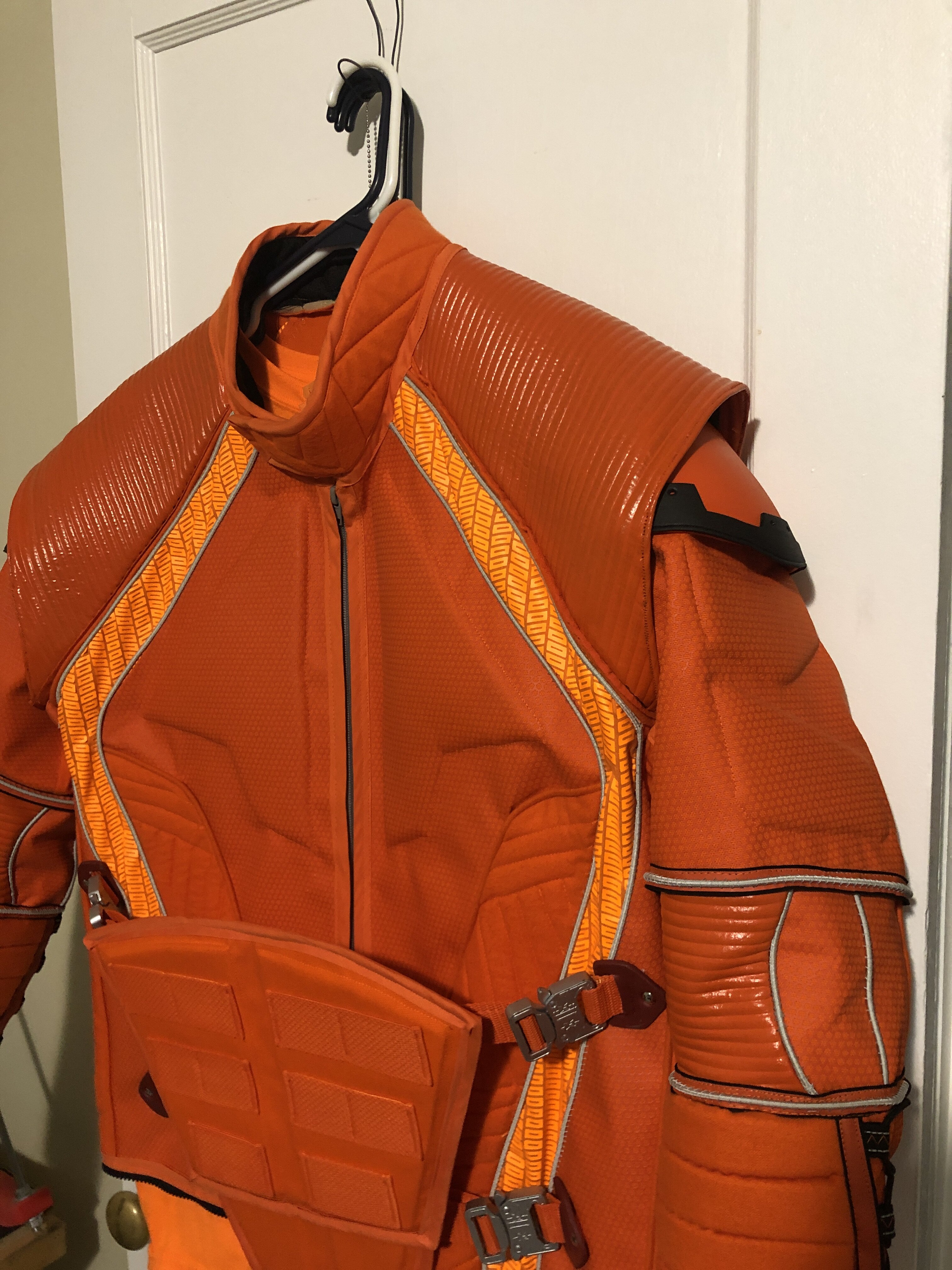

Decided to attach the shoulder bells directly to the sleeves, it’s far easier to move my arms and put the suit on and off this way.
used a longish stitch, 3 on my machine, and sewed them to the canvas portion of the sleeves. Because the canvas doesn’t stretch they should be safe from being torn or ripped when I move my arms around.
Also loosened the tension on my machine as to not perforate the foam. Too short a stitch and too tight and the sewing machine will pretty much cut the foam so don’t do that lol.

For the red plates that used to secure the four small buckles to the stomach area, how did you make them, or are they hardware parts?

Buckles are 1 1/2inch and 1inch straps.
I was going to use abs plastic for the red plates but a closer look made me think they were a softer material, I went with craft foam painted with angelus leather red paint.
I actually got to see wills suit at comic con up close and was able to see things like the zipper. Seeing it in person made things like that pop out in other pictures way more.
