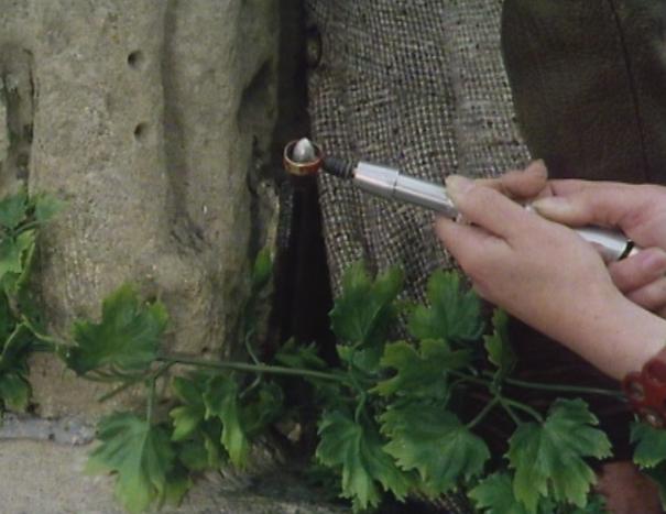

Right. I know it should be smaller than the magnet, but looking at the last picture you posted something just looks...Off about it, either the emitter looks to small or the halo looks too big. I was wondering if we could get a clearer shot of the emitter in the halo so I can directly compare it to the screen caps I linked.
Re: Doctor Who Machined Classic Sonic Pertwee/Baker/Davison Kit
I based the Bullet off of this shot, Which is extremely clear compared to the other low resolution photos presented in that thread. I'm not sure what you see, but I will be re sizing the Halo structure in general, since the shop must have used an outdated model when they produced the Aluminum Ring instead of the Brass one.(It doesn't match my most recently updated drawings).

Comparing your full shot of the Sonic to this cap (http://vignette2.wikia.nocookie.net...ial_ivy.jpg/revision/latest?cb=20141028214934), to my eyes at least, it looks like your emitter head is a little bit small. I think this might be due to the your emitter being shaped less dome like and more like an actual bullet.
Also, this thread here(http://tardisbuilders.com/index.php?topic=3130.0;all) shows off a good look at the back of the emitter without the magnet and you can really see that the diameter gets quite wide. (This is of course assuming that there was only one emitter from the Pertwee to Davison era which is uncertain)
I'm assuming this is the picture your are referring to.
Looking at that image and comparing your full shot of the Sonic to this cap, to my eyes at least, it looks like your emitter head is a little bit small. I think this might be due to the your emitter being shaped less like a dome and more like an actual bullet.
Also, this thread here shows off a good look at the back of the emitter without the magnet and you can really see that the diameter gets quite wide. (This is of course assuming that there was only one emitter from the Pertwee to Davison era which is uncertain)
I can't see the hyperlink that you've tried to use in your sentence. I get a 404 error.
To be completely honest with you, if you think my emitter head is small, you're welcome to measure all of the screen caps and average them together. I had excluded the ones where the cap is too low of a resolution to see clearly. Then, I scaled them up, measured them, and averaged them together. If you think it is small, please scale the piece and tell me what your measurement is. We can compare them. Otherwise I truly don't know what you are referring to, and I'm not sure what you'd like me to do about that. I've changed the shape of the previous bullet, but without any numbers, I don't know what you mean by too small or too big.

What I mean, is that when I compare the pictures you have provided with the screen caps it looks (To my eyes) like the diameter of the emitter is about 1-2 millimeters too small. I The reason I think it's too small is from what I can see in the build pictures your emitter straightens out (Like a bullet) while I believe that the emitter on prop has a very small area in which it straightens out sort of like a dome
