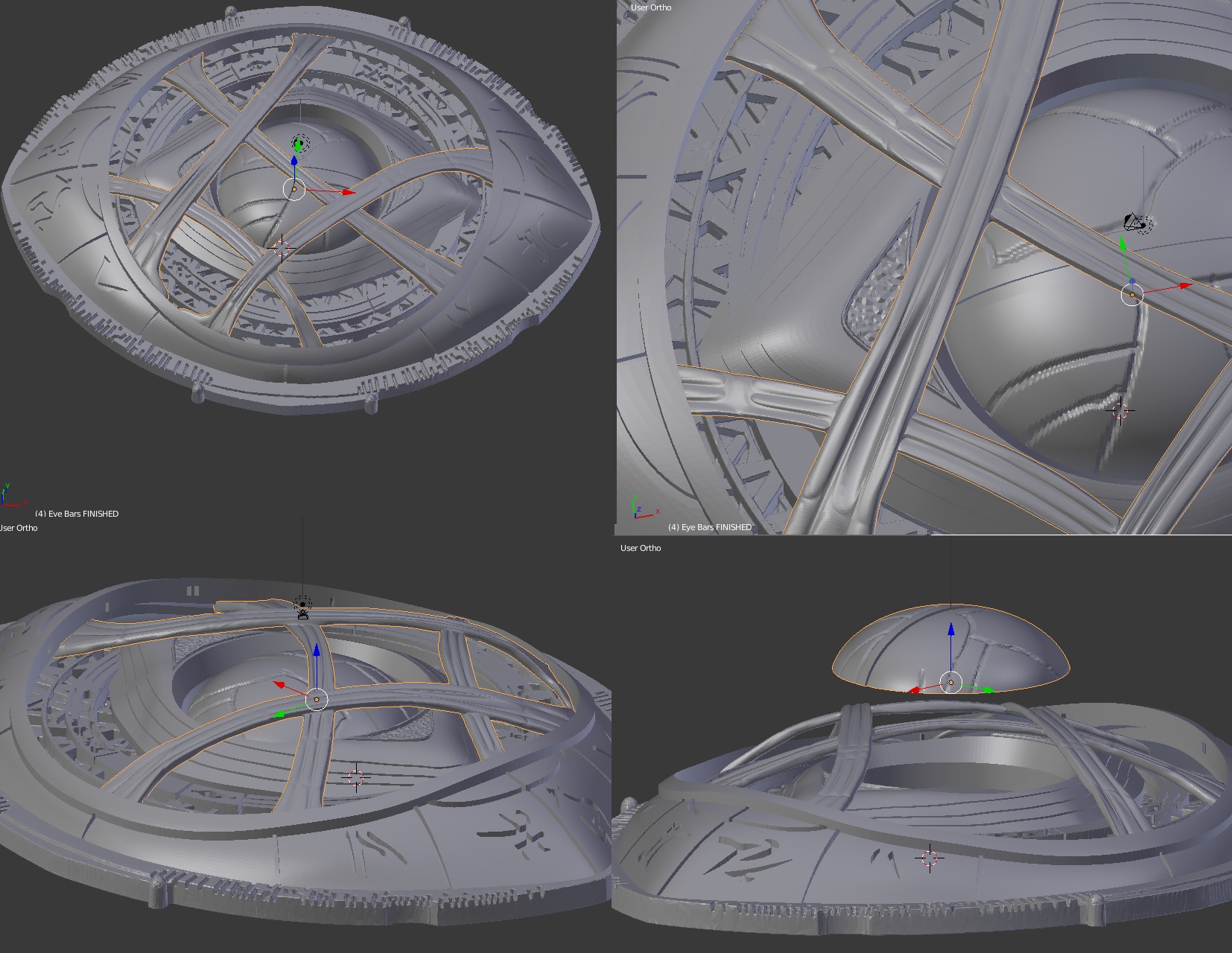

Just need the center, eye ball, and then the engravings.
Just a point of interest that I don't think I've seen pointed out yet: according to this picture and the Hot Toys figure, at least sometimes, when the Eye of Agamotto is active, the cross bars "open" to leave the center jewel unobstructed.
I might make 2 eye bar versions then.
I just have a few things left to do, like make everything solid and join them together. The "bars" and "eye ball" will stay separate like before in case you want to print it yourself.
I was also able to get the "runes" engraved really deep into the model. They'll definitely show up nicely when blackwashed.

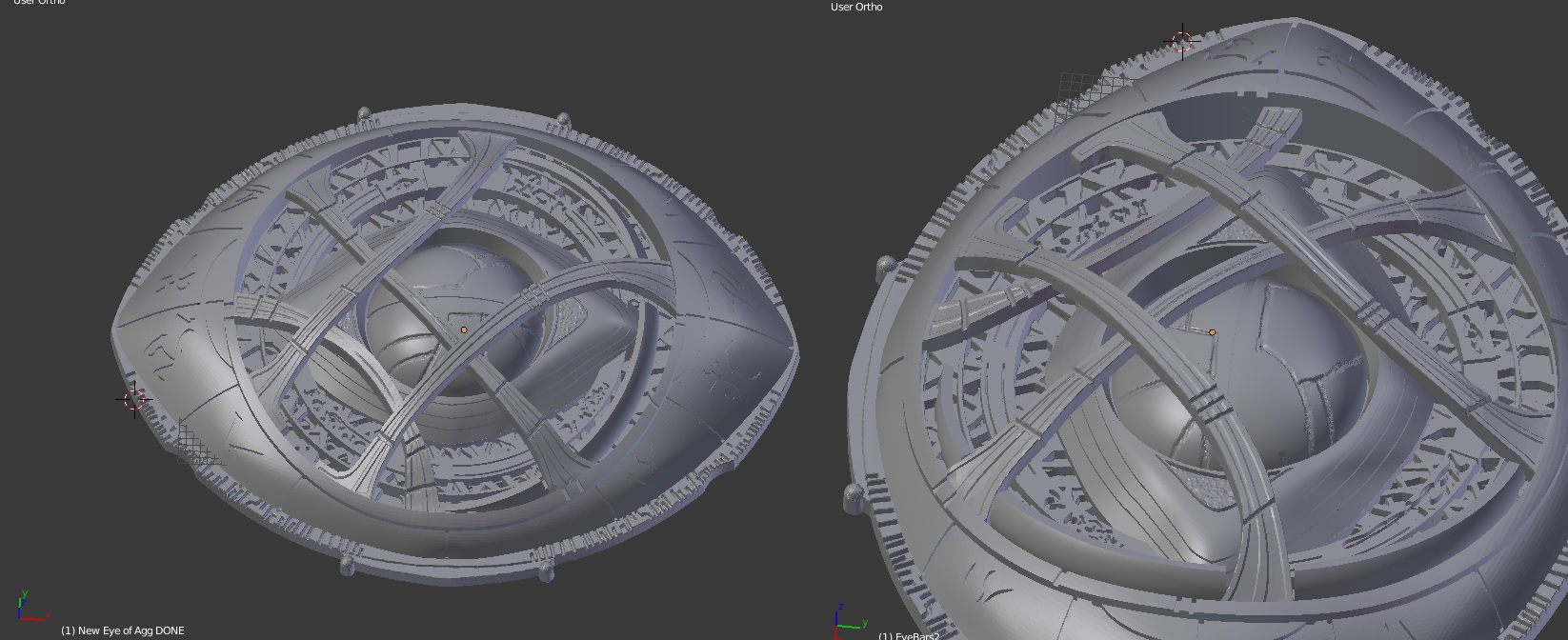

The new Eye of Agamotto is finished!
I'm going to see if my printer can handle the detail. If it can't, I'll add it to Shapeways and print it that way.
If your printer can't handle it I'll bet mine can, given how the X piece turned out last time! :cool
I think it's because something weird was going on with the "dome" (inscription part) and the printer decided to make random triangles that weren't visible, which basically made a LOT of the detail solid. Which really sucks because it was printed at 100 microns and it took about 6 hours at 35% infill.
I've been trying to fix the problem for about 4 hours now. :/ I might have to remake the "dome".
Well, I'm kind of glad my print failed, because I forgot to add a few other details. I would have finished, molded, and cast an inaccurate piece again! :O
It is now, in my opinion, the closest thing we'll have to a screen used version. There is one bit that isn't completely accurate. I had to cut out small rectangles on the small "crescent" shape so the "Eye Bars" could fit properly.

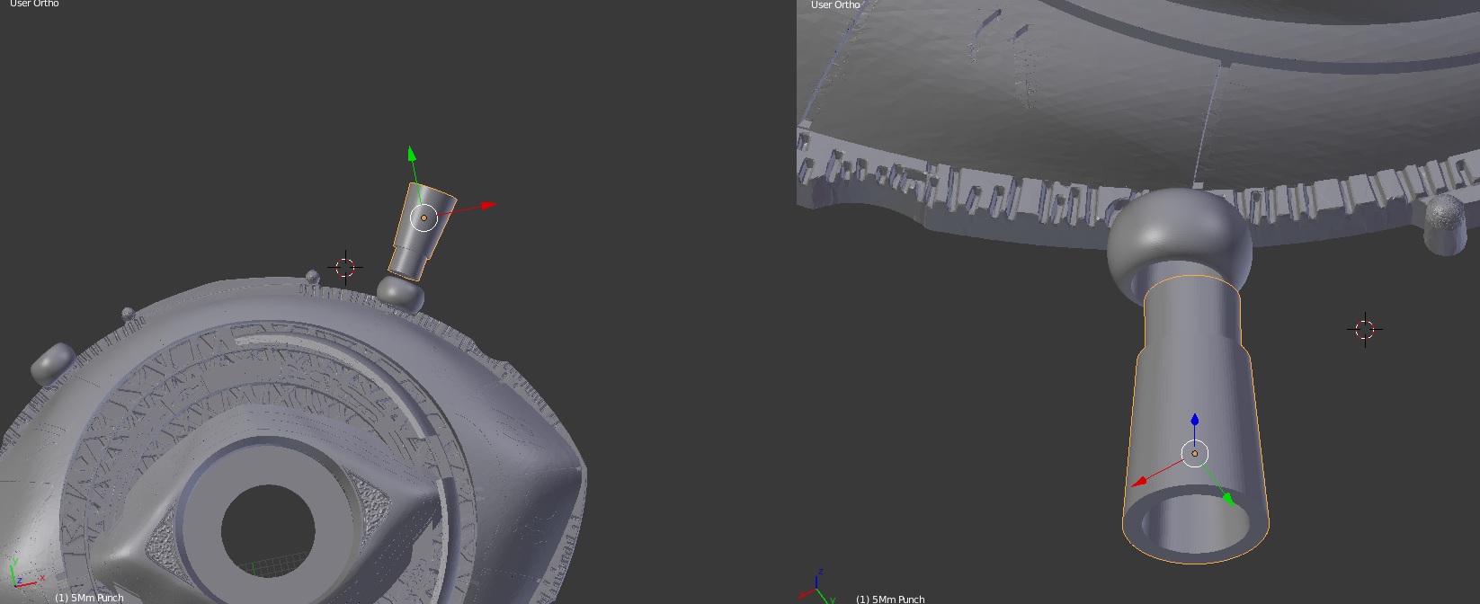

Last piece to the puzzle:
It can fit a 5-6mm cord.
I'll add the parts to Google Drive. The main piece is 24~ MB :eek

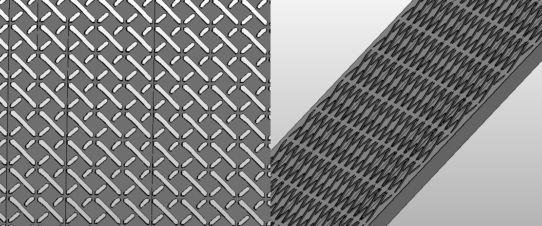

So, I had an idea. You know those "X"s that make the Ankh? Well, since everyone doesn't know how to screen print (and I really, REALLY don't want to make one just for this) I was thinking, maybe I could make a 3d printed stencil you can push ink or puff paint through. Each X "should" be .125" (1/8th") wide.
This is 2.2" wide by 8" long, by 1mm thick. I have no idea if my printer can make it. Considering it had problems with the Eye.
https://drive.google.com/open?id=0B3J6vajd9j1wMzBSMUhMWWNMekE

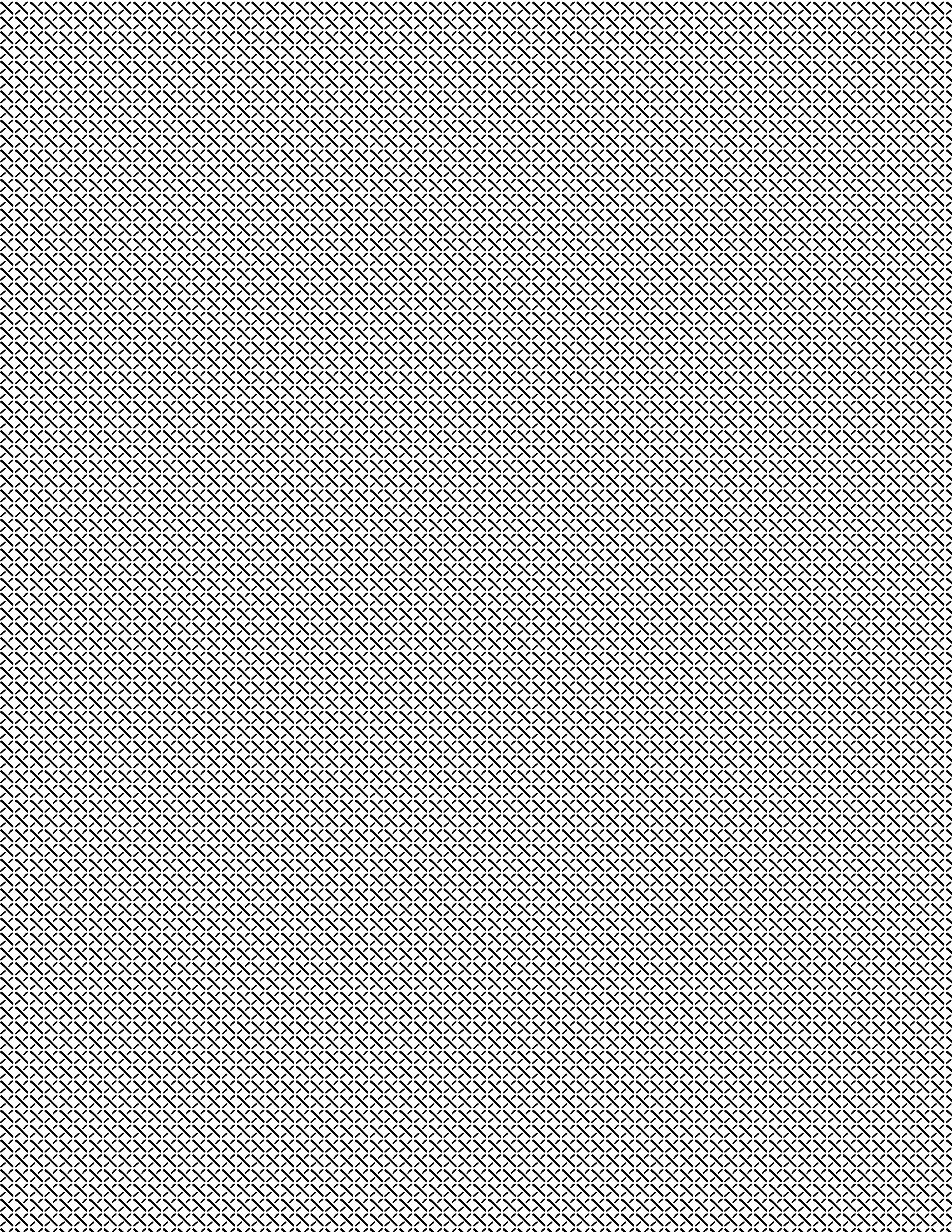

And if you want to make a Screen Print version (PNG file):

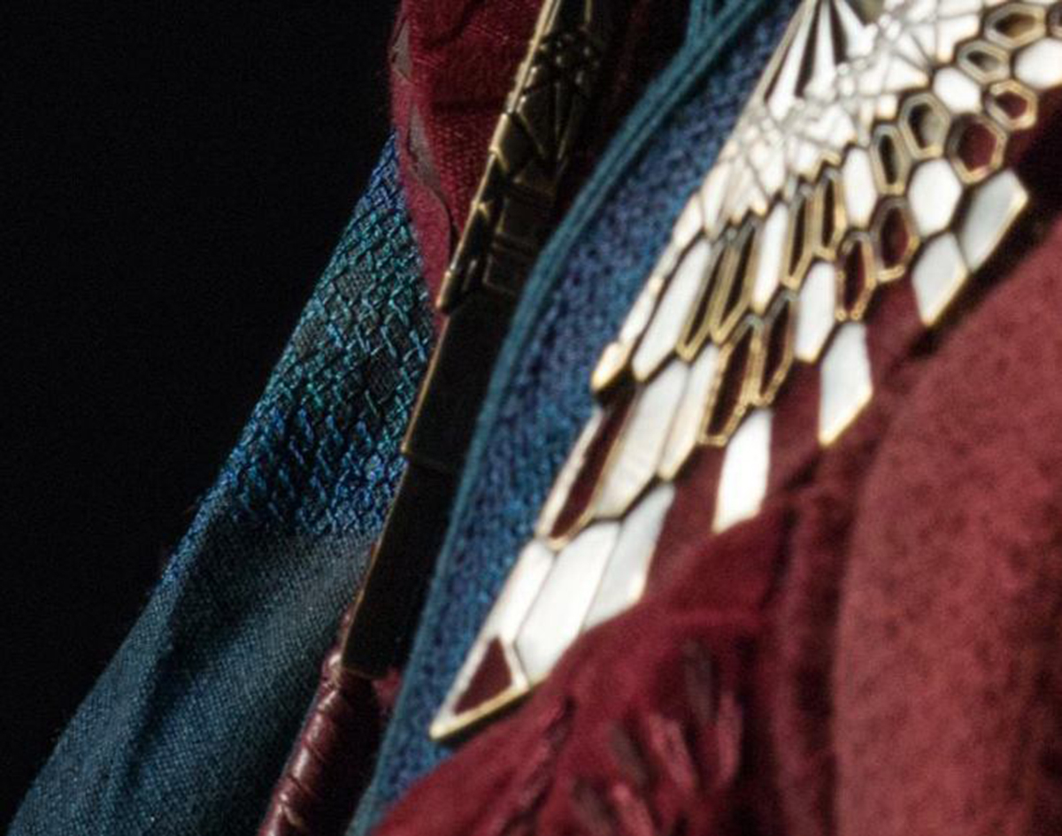

Hold up! In the close up pictures those x-es, seemed cross stiching, and only along the edge of the tunic. I thought the 'wings' of the 'ankh' were bleached in? Where are those hi-res pics when you need them.
