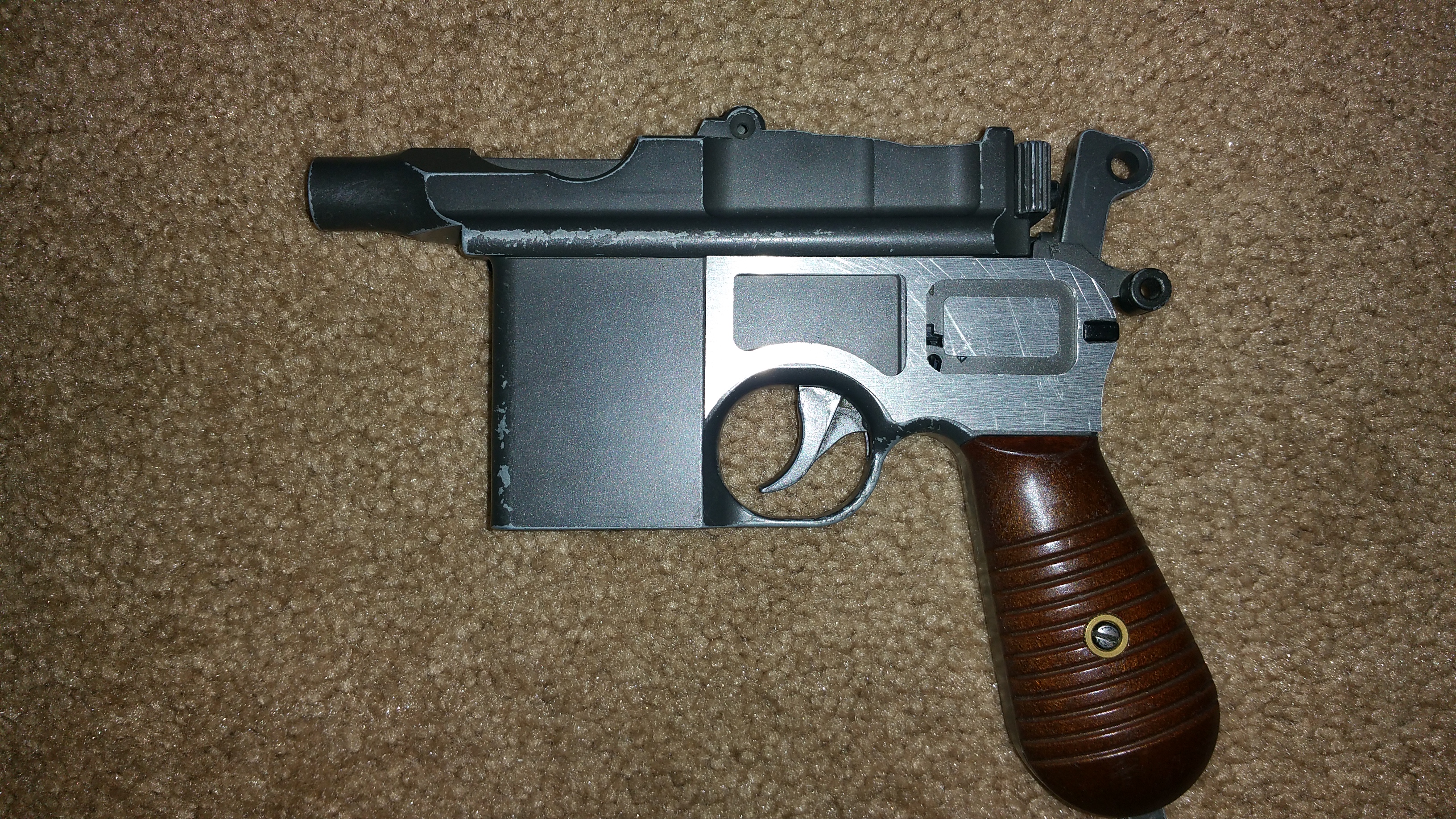

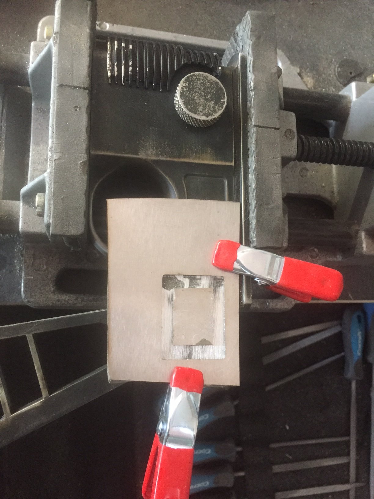

This is really rough and I am using it as a template, but here is the other side of mine. v2 will be ALOT better. This took about 40 minutes in AutoCAD and then about 5 minutes to cut. I couldn't find my deburring tool so the edges are a little rough.

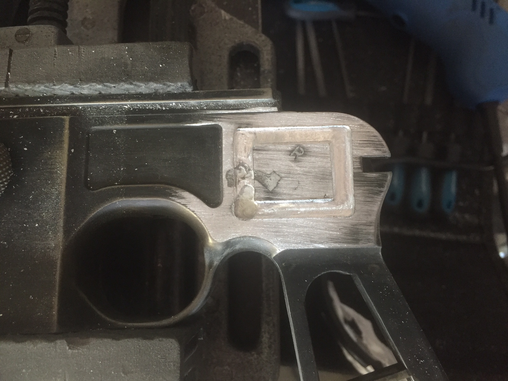

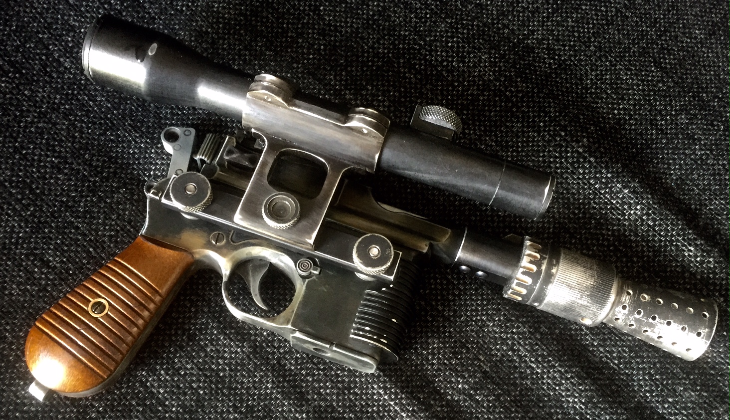

Feeling the pressure of the left side , i figured i had to get mine done also , but i didnt want to put that plastic piece on so i figured id try to mill in the box in the metal of the gun with my dremmel tool.
first i made a template out of some stainless sheet i had in my garage , to use as a guide to get the edges straight , then i used double sided tape and stuck it to the gun View attachment 634286
Then i first cut the edges with a cuttingwheel on the dremmel , and milled out the rest with a milling bit.

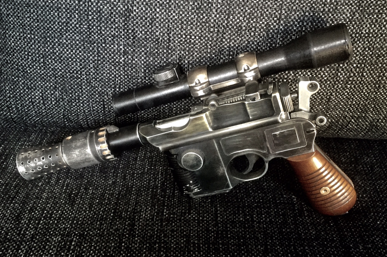

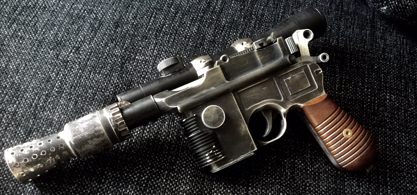

Result looked like this , then some blueing and weathering , and i must say im pretty happy with the outcome
View attachment 634290View attachment 634291View attachment 634292View attachment 634293
Im calling it done for now , might do some more work on the grips though :O)
