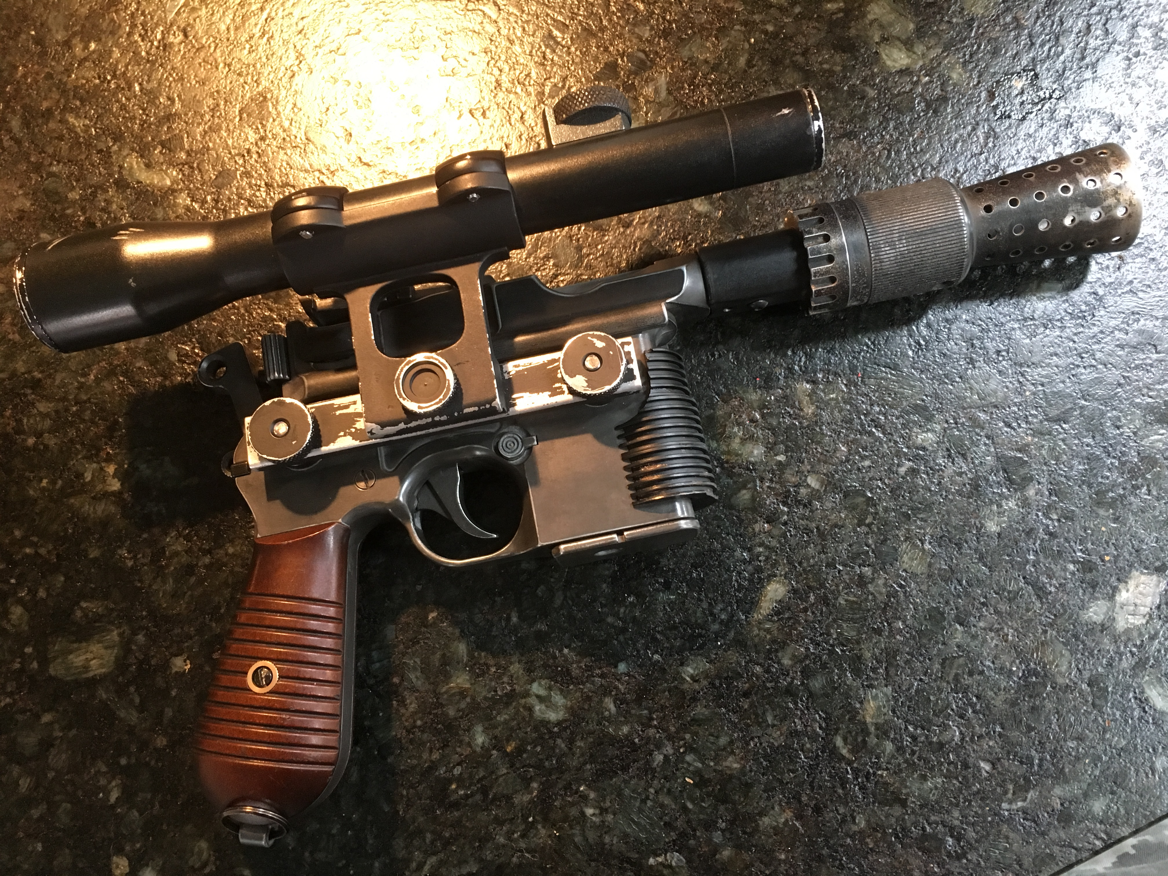

I still have more work to do, but it is slowly coming together. This is such a great piece to have in my collection already.
No one wants to show the other side, lol
The scope mount is not attached yet on mine. SO this is the only way to show it (with the scope delicately balanced to get the shot). For the record, I have not done anything to the other side yet, since I am holding out hope for a more elegant solution.

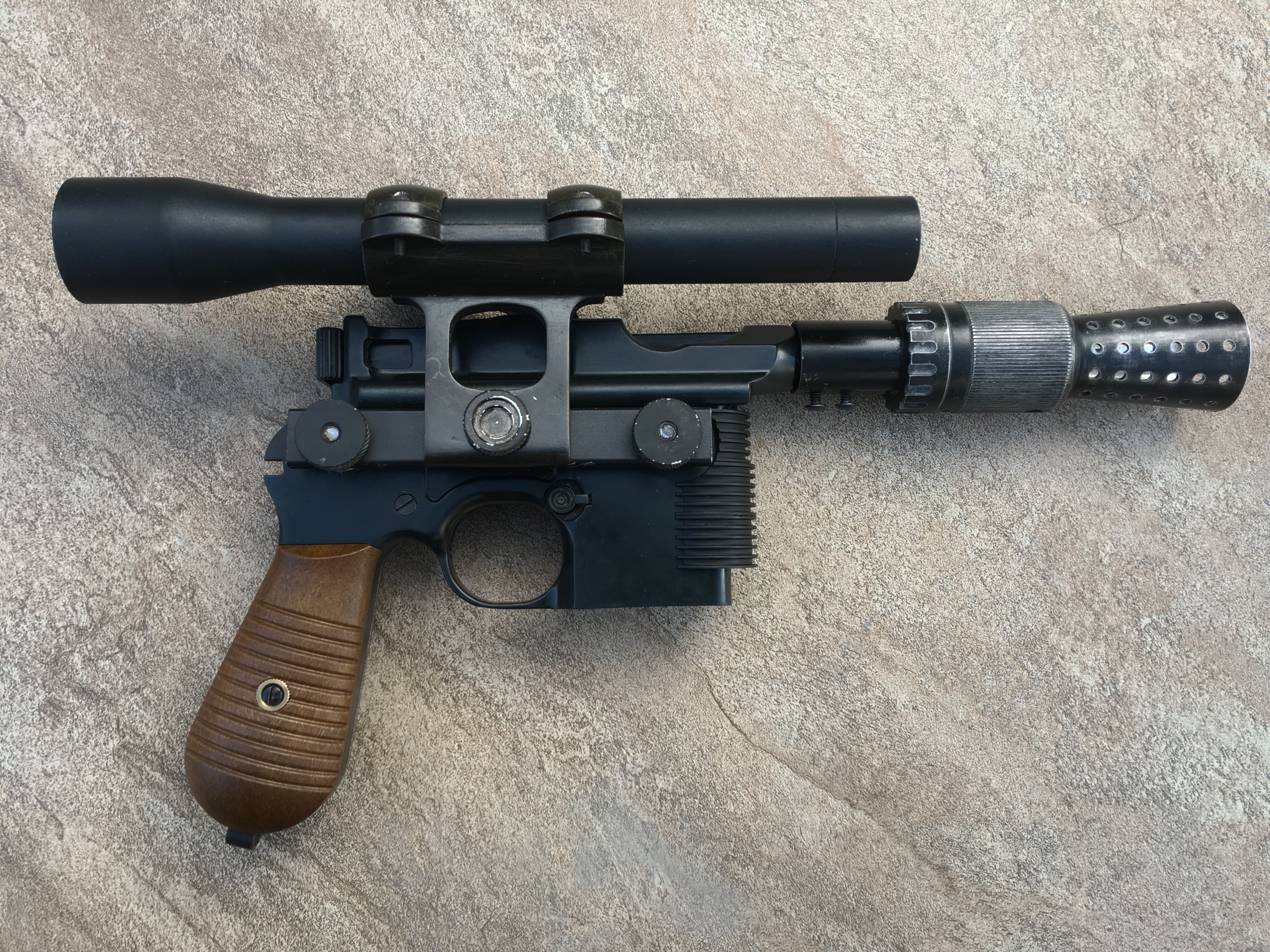

heres my effort. its not perfect but i love it.
the kit was great fun. As is the current trend the plate side is not shown. ;) i have left it with the dummy switch as i could not find a neat way of doing it. with the switch removed and the post glued in place there are still locating holes visible in the receiver and as i have stripped and blued the gun rather that painting filling could end up looking worse.

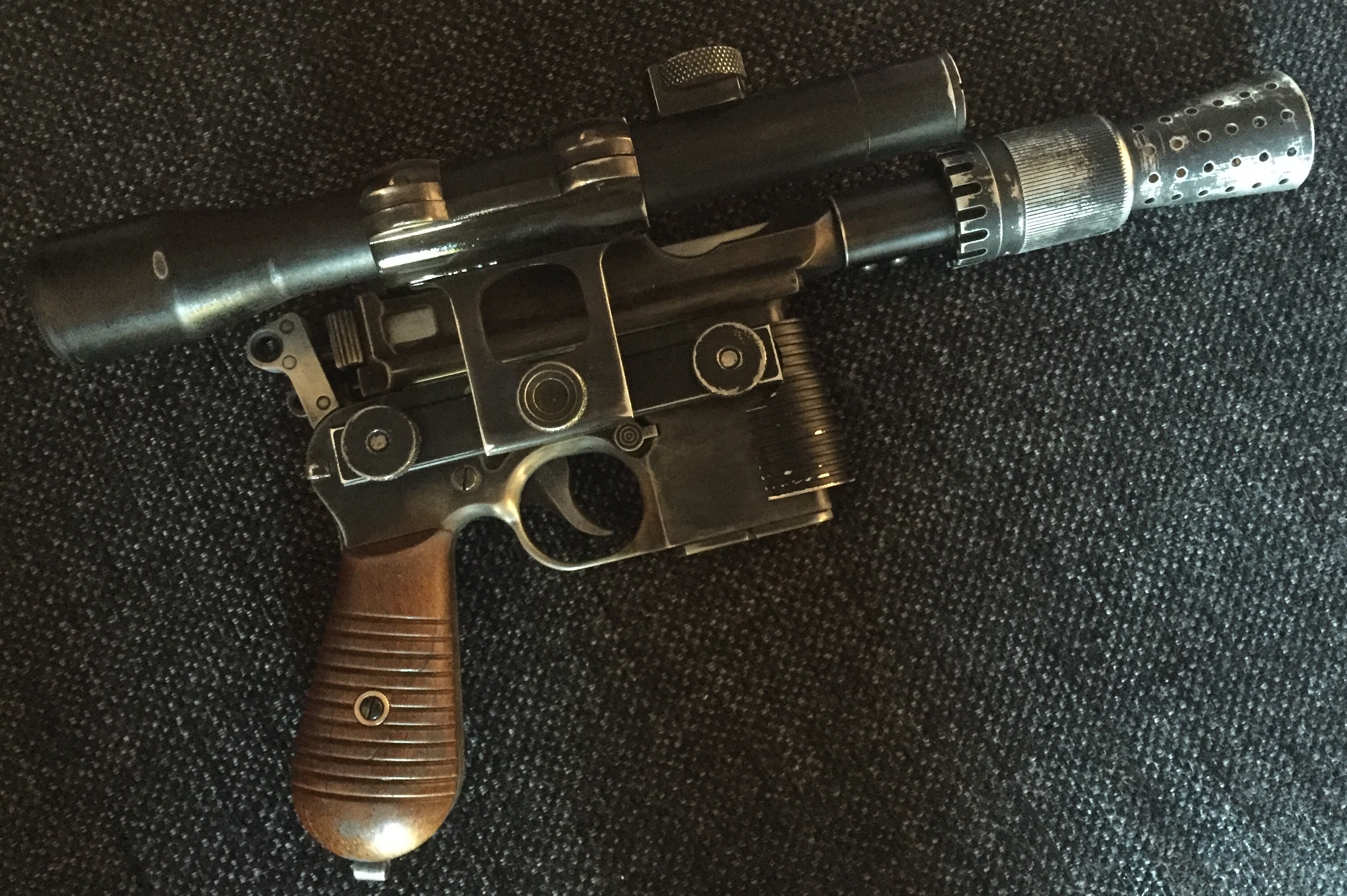

Am I really going to be the first to post the other side? Just got done the CAD model from the launch bay prop. I've been working on projects for other people but I'm about to cut my left side. It's the first piece I'm working on.
