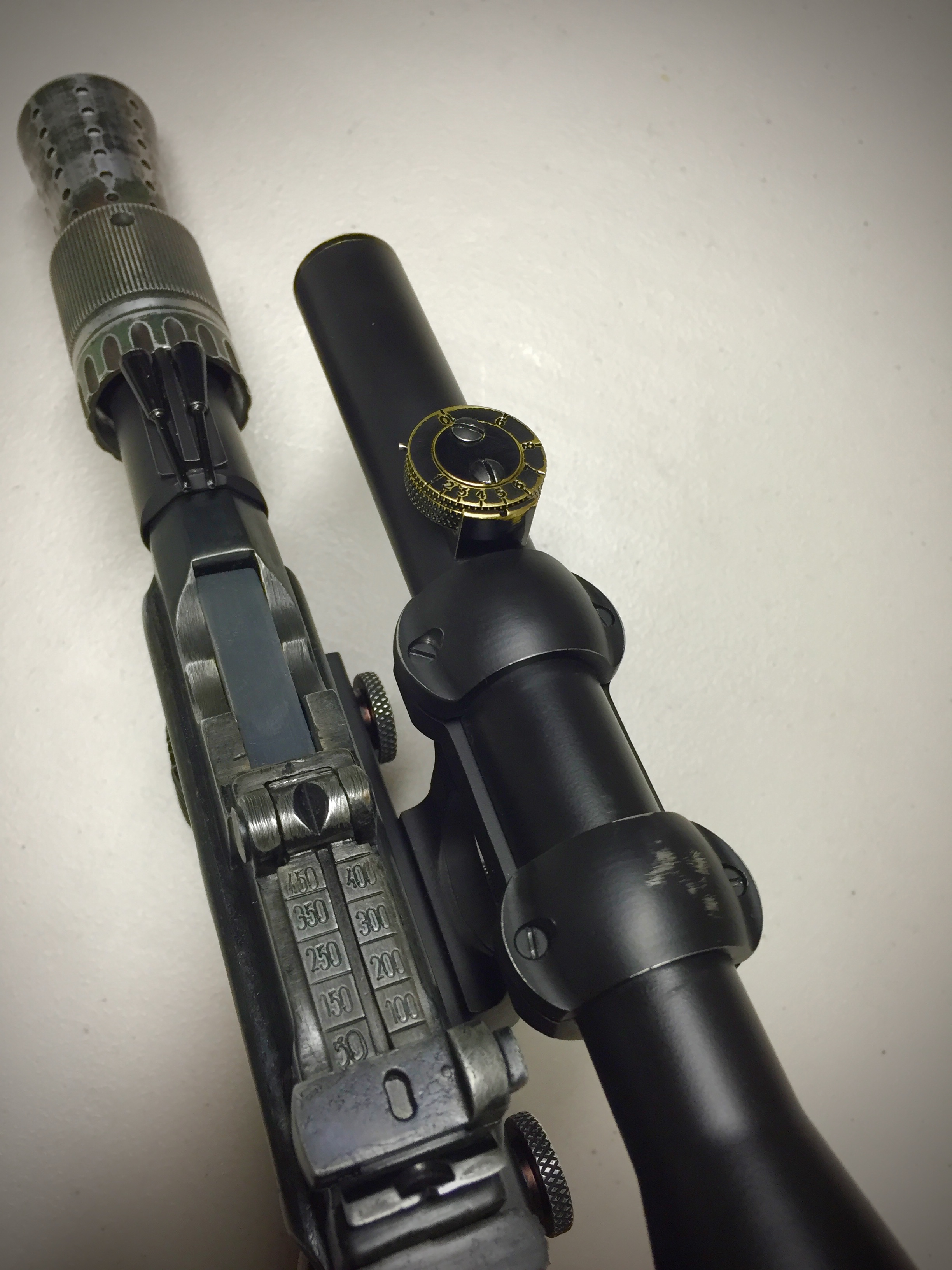

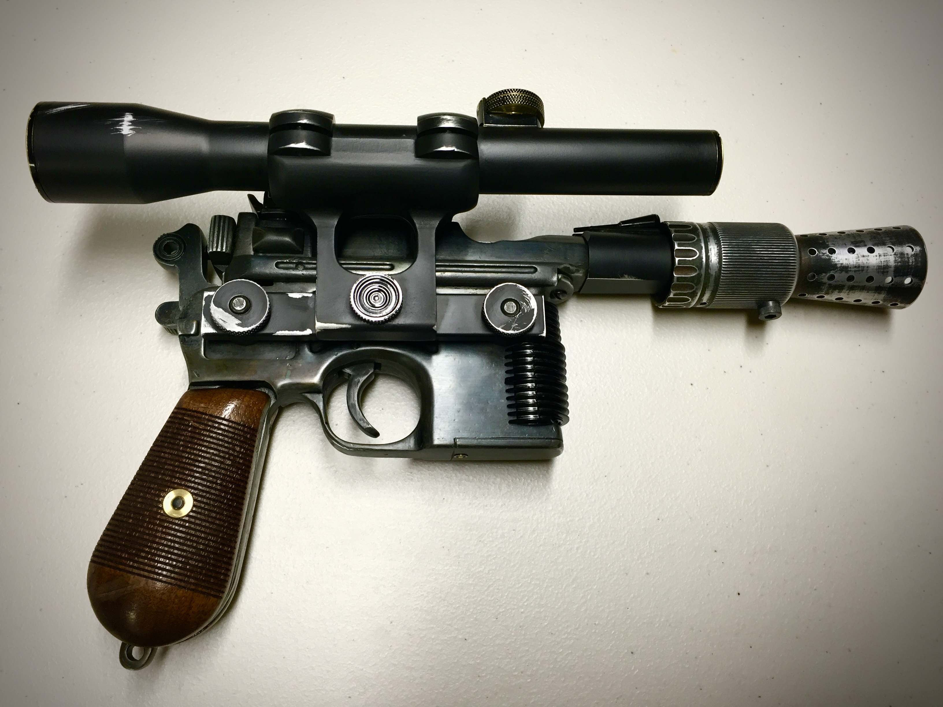

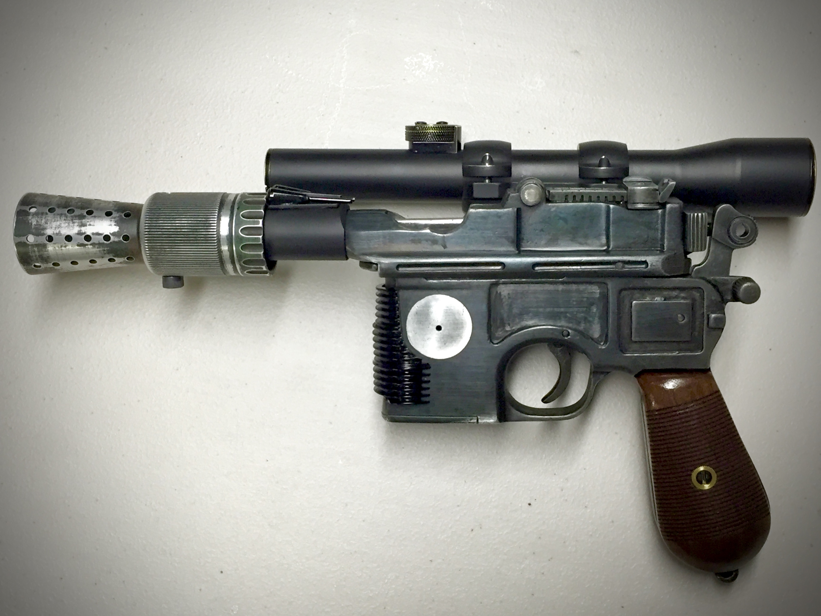

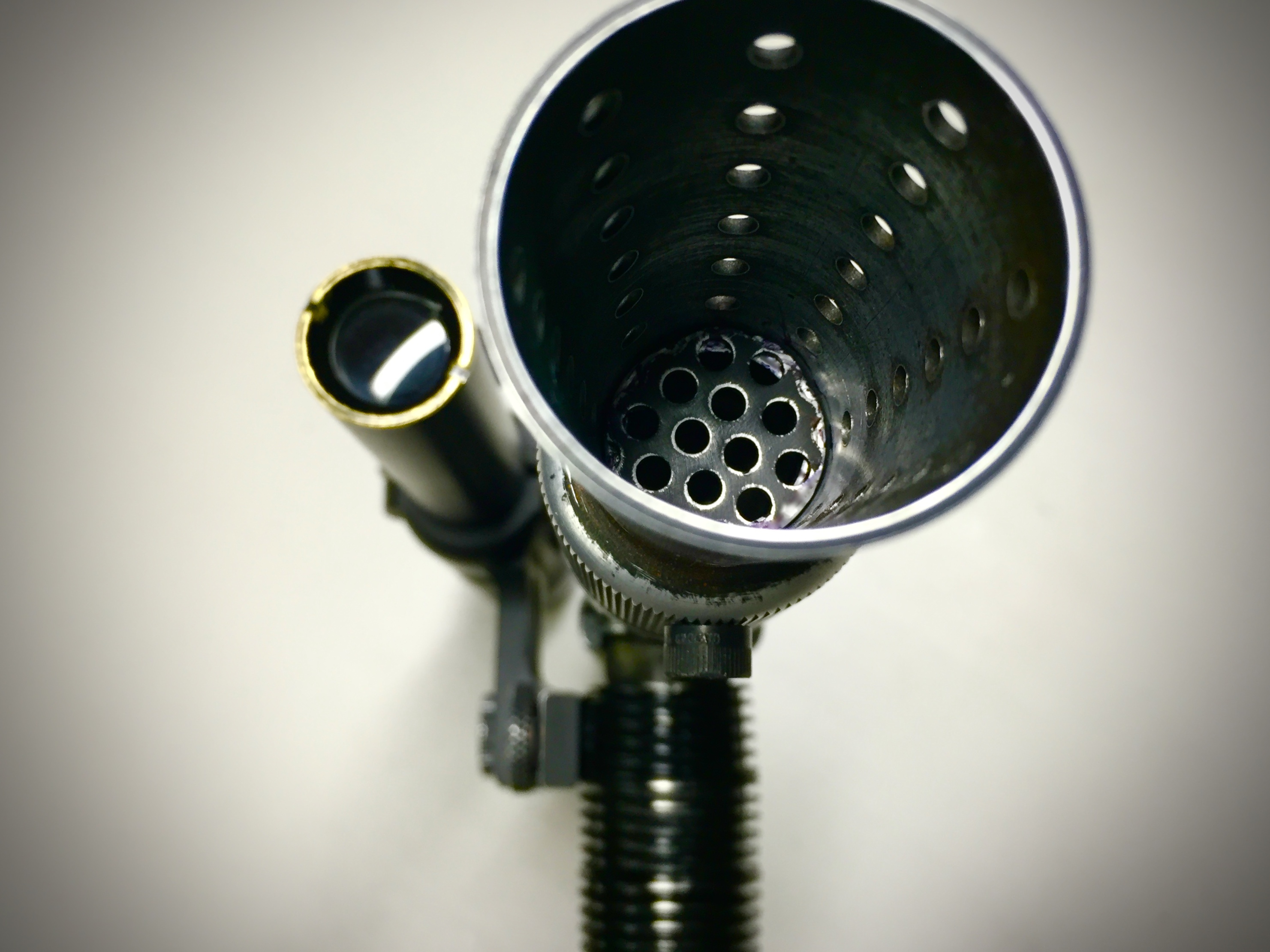

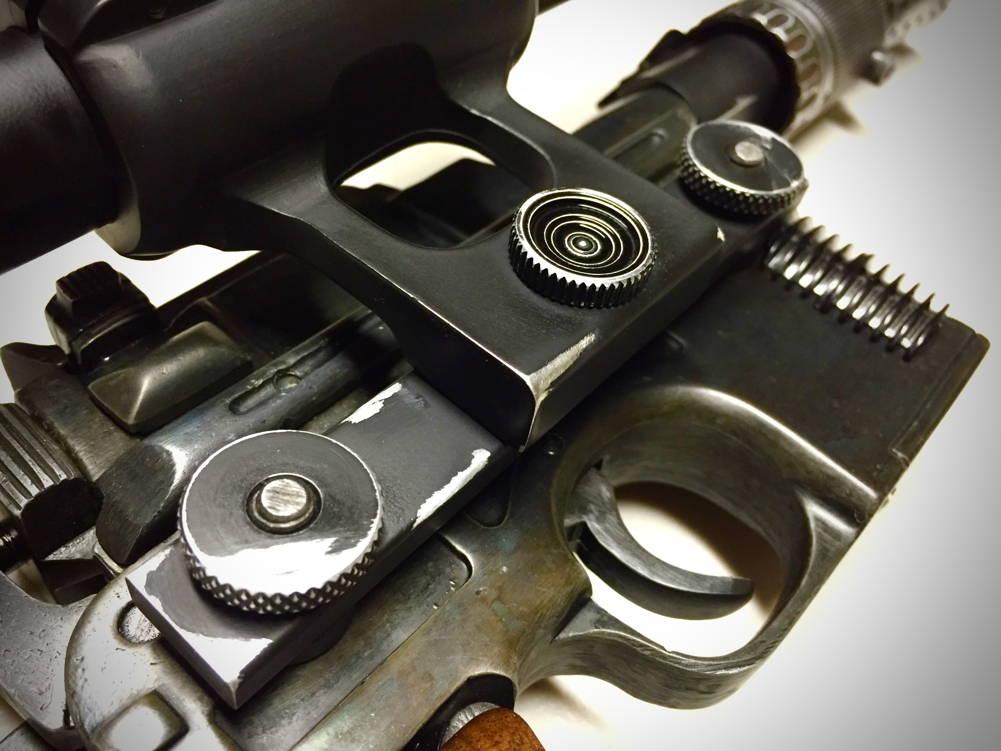

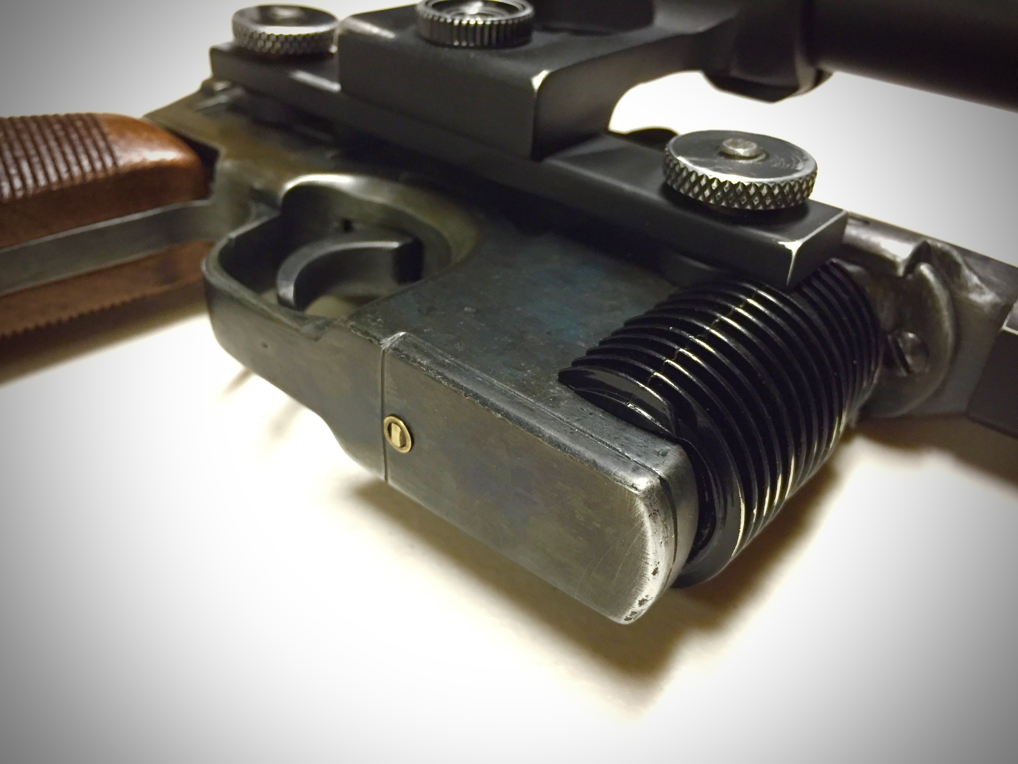

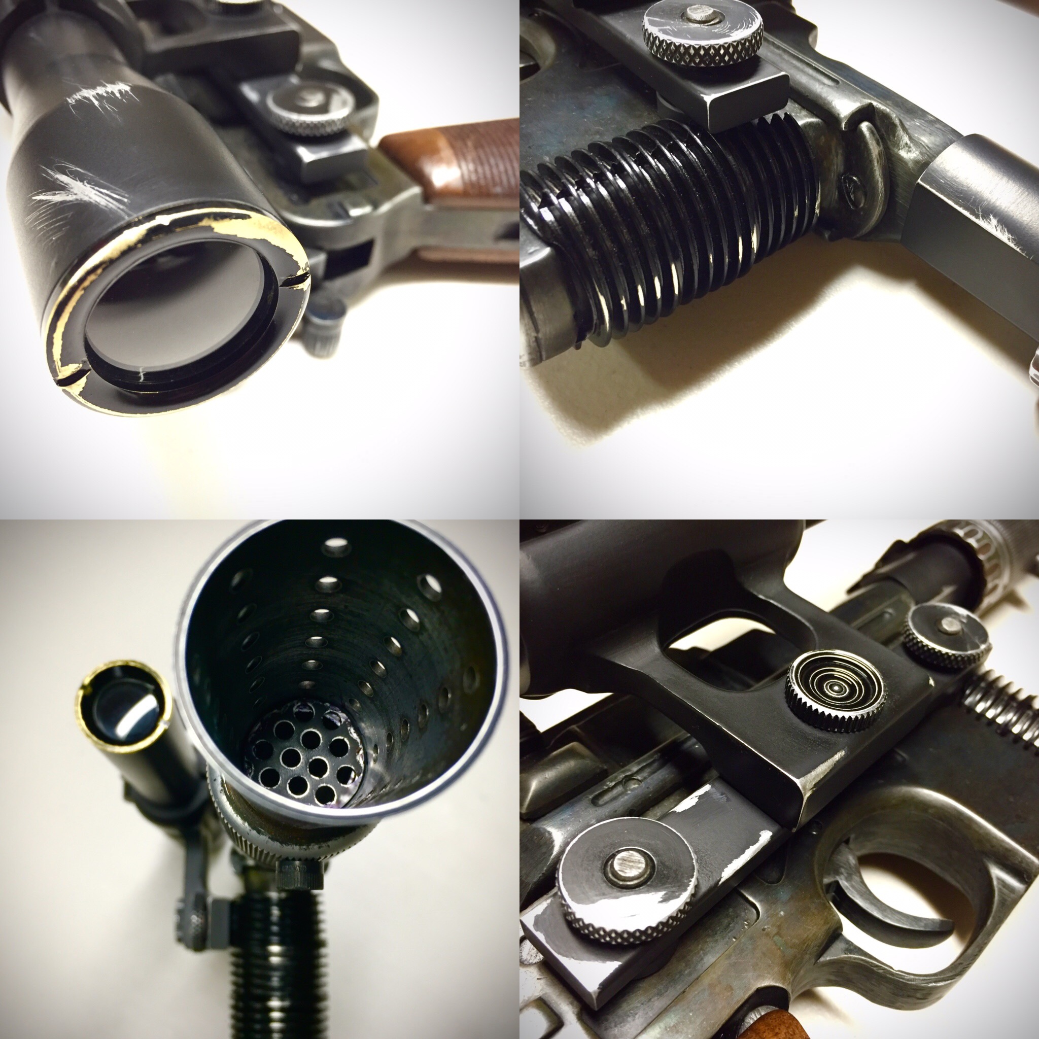

Pics of my "DEC" blasters. I have built 7 of these kits and just received 2 more! Quality is remarkable. I just pre ordered a TFA kit. Check out my site, PKaneProps.com for more pics. image.jpegimage.jpegimage.jpegimage.jpegimage.jpegimage.jpegimage.jpegimage.jpeg

Yes, The Grill from the ANH kit has the same trapezoidal shape inside but narrower. It may not take too much to file and make it fit. The actual grill on the ANH HERO is less round due to the way it was cut to fit. If you notice the grill in my HERO above, the side view is less than "round" You could make it work like this.
Place the mag bottom against the bottom of the grill and scribe a line. It may just make it.

Pics of my "DEC" blasters. I have built 7 of these kits and just received 2 more! Quality is remarkable. I just pre ordered a TFA kit. Check out my site, PKaneProps.com for more pics. View attachment 577316View attachment 577315View attachment 577314View attachment 577313View attachment 577312View attachment 577311View attachment 577309View attachment 577310
Wow...nice work. You been busy !
