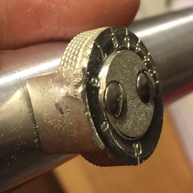

I'm still new at finishing these pewter cast pieces. I get the filing and sanding the sprue and general clean up. My question is, how does one "fill in" defects? There is this ugly divot in my scope wheel that I don't know how to fix....
You can try to clean it real well, add some flux to the dimple, then add a couple drops of solder. Dave uses low temp melt pewter (300F) so you cant solder it the "right" way by heating the work (the pewter). You're definitely going to get a cold joint and need to use a solder that melts under 300 F. You could also fill it with something like epoxie sculpt and paint over it. Or you could try and attach a small ball of solder/ tin with epoxy then sand/ file it.
Hmmmm.... I already have poor soldering skills. I probably will have to go with the route of "fill and paint".... Appreciate your suggestions.
On those knobs some guys take a small needle file and go in the knurl pattern to make it more defined
the large rounded side of the knob has to be filed/sanded to blend in, there should be enough to take off
