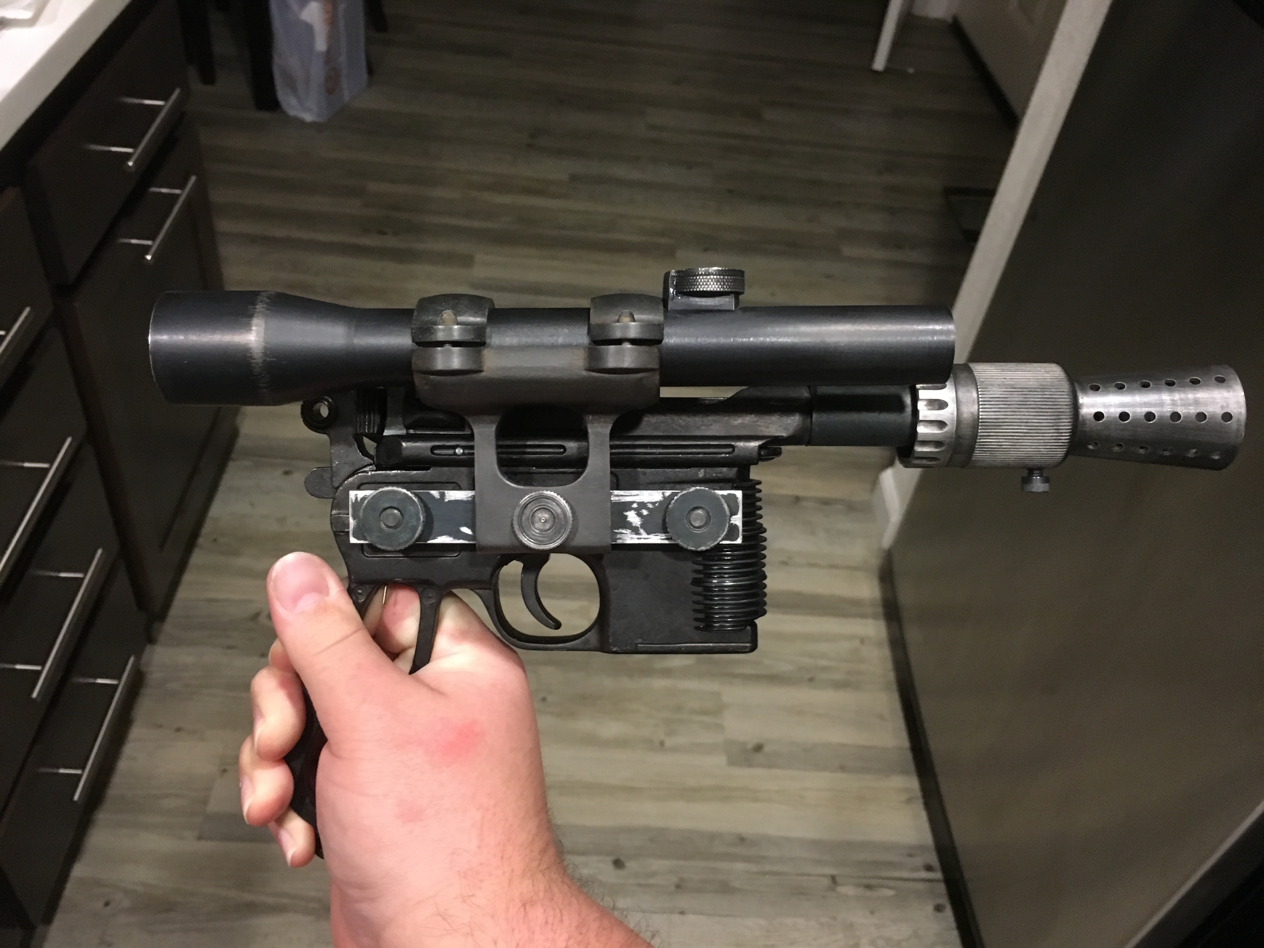

One concern I have - maybe someone could shed light on this - the scope mount clamps do not touch the scope mount when screwed down, they are tightened as far as they can go.
Any insight?
They are not supposed to touch. If they did then the clamps would not be able to create the friction/pressure to tightly hold the scope and it may slide around. Beautiful work BTW!
That's what I was thinking but had to check. I know there are so many who are virtual experts on this prop, so I don't try and assume anything.

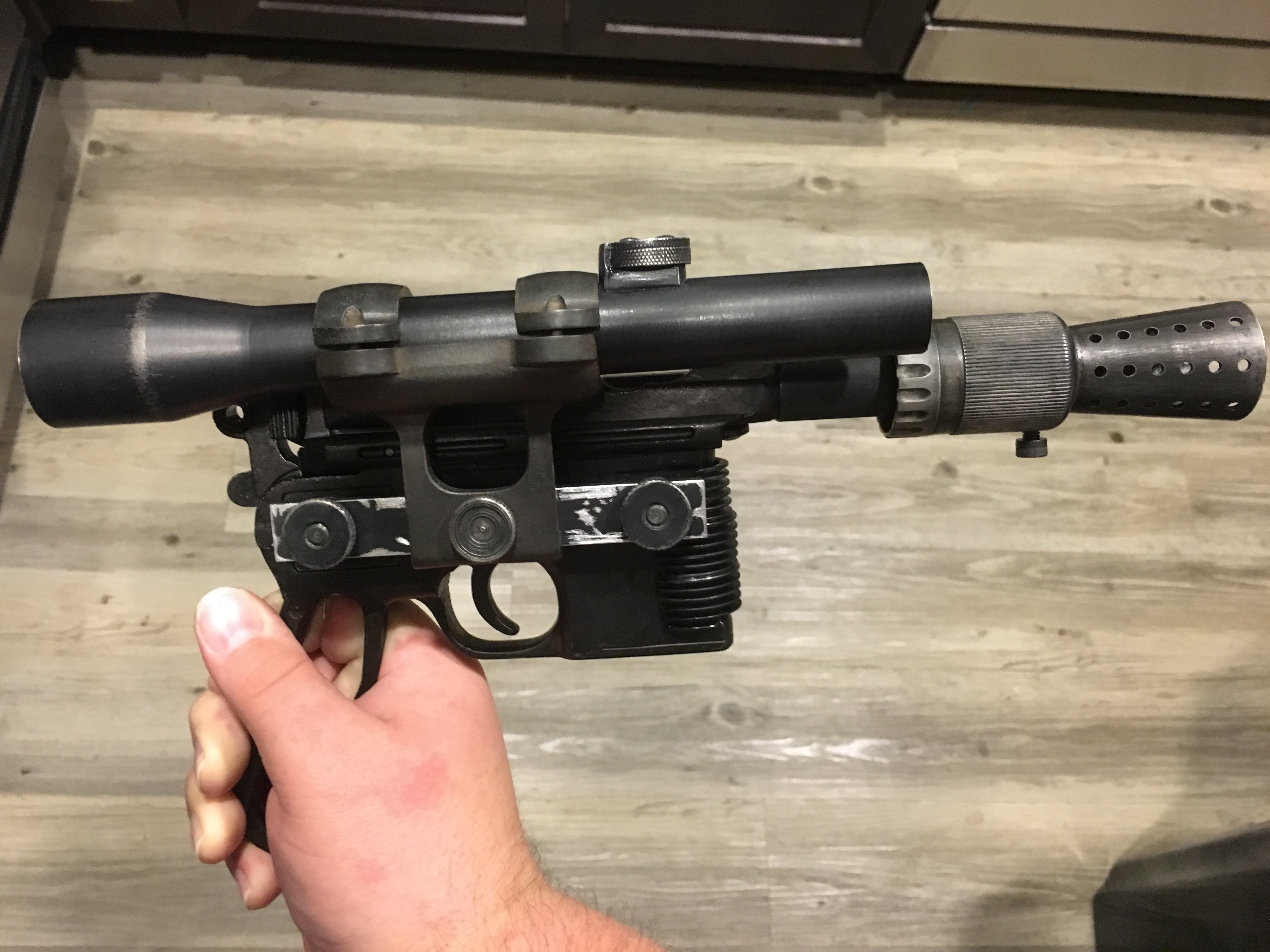

A friend of mine noted that I painted my scope flat black. While I considered using regular lacquer paint, for the scope and mount, I used Cerakote Gun Coating. Strong stuff and is exceptionally smooth and durable. I quite like the look.

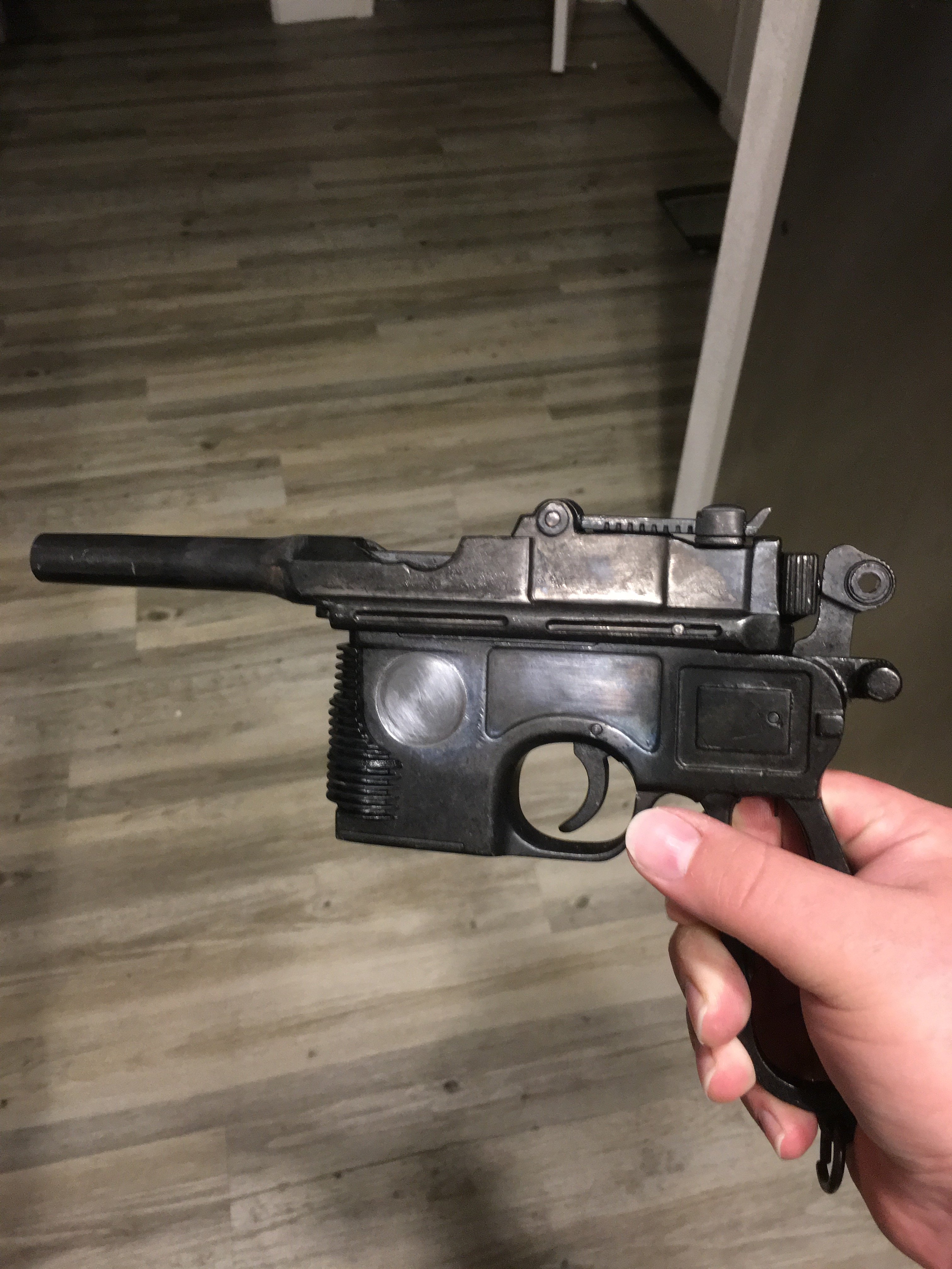

Oh, man. I don't think I can get into it; no one man has the attention span to handle the epic tale of fits and frustration that I had putting this together. The short or it is: a lot of trial and error.
Here are some keynotes: Didn't bother sanding Denix, I had worn the finish down to the point where I liked it and just cut the barrel and sanded the hump in the back down so the bull barrel sits properly on it; blued the barrel and flash hider first, drilled a hole in the barrel so the thumbscrew sits flush on the flash hider, filed the trigger and trigger guard, cut one of the threaded rods shorter (the back) so they look somewhat flush when put together, had to blue the cast pieces twice and ended up darkening the final color over an open flame (it really works!), grill and bar mount is painted with spray paint, used "English Chestnut" Minwax stain and sealant for the grips, oven cleaner for the brass bits, Permablue for pewter, Aluminium Black for aluminium.

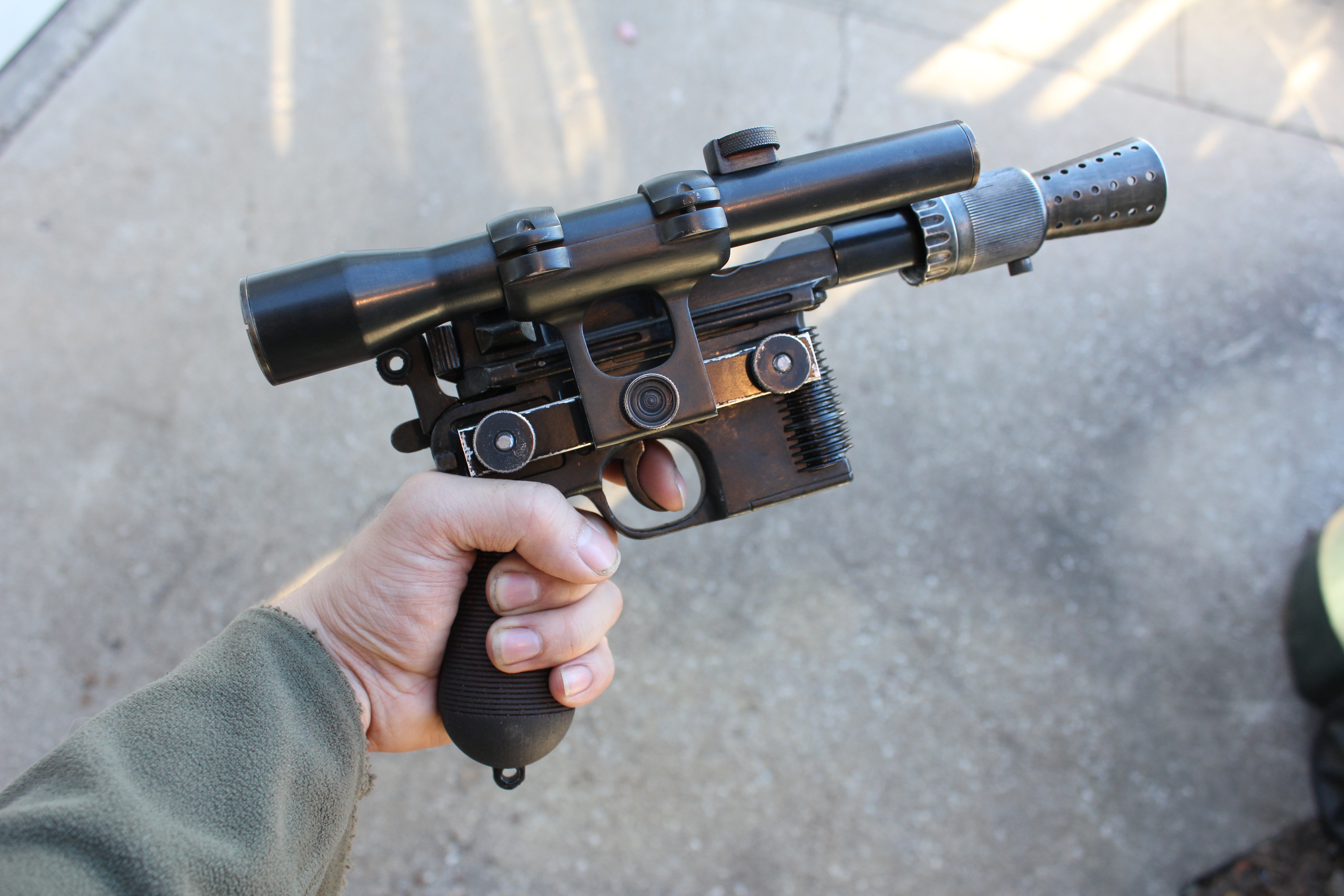

Hey guys. Nearing the end of my build. Just wanted to get input from some of you experts on anything else? I still need to do a little weathering on the scope bracket bottom, and add the brass and glass to the scope. Haven't secured the bull/flash yet, just screwed them on for looks. I know my scope bracket can look a little light because in darkened it with AB, didn't paint it. Does it look ok? It can look dark in some light and greyish in other light. I kind of like the contrast.
Also, I have plain walnut grips. I've heard some say they use oil to darken them instead of stain? Anyone able to elaborate? Thanks guys!
