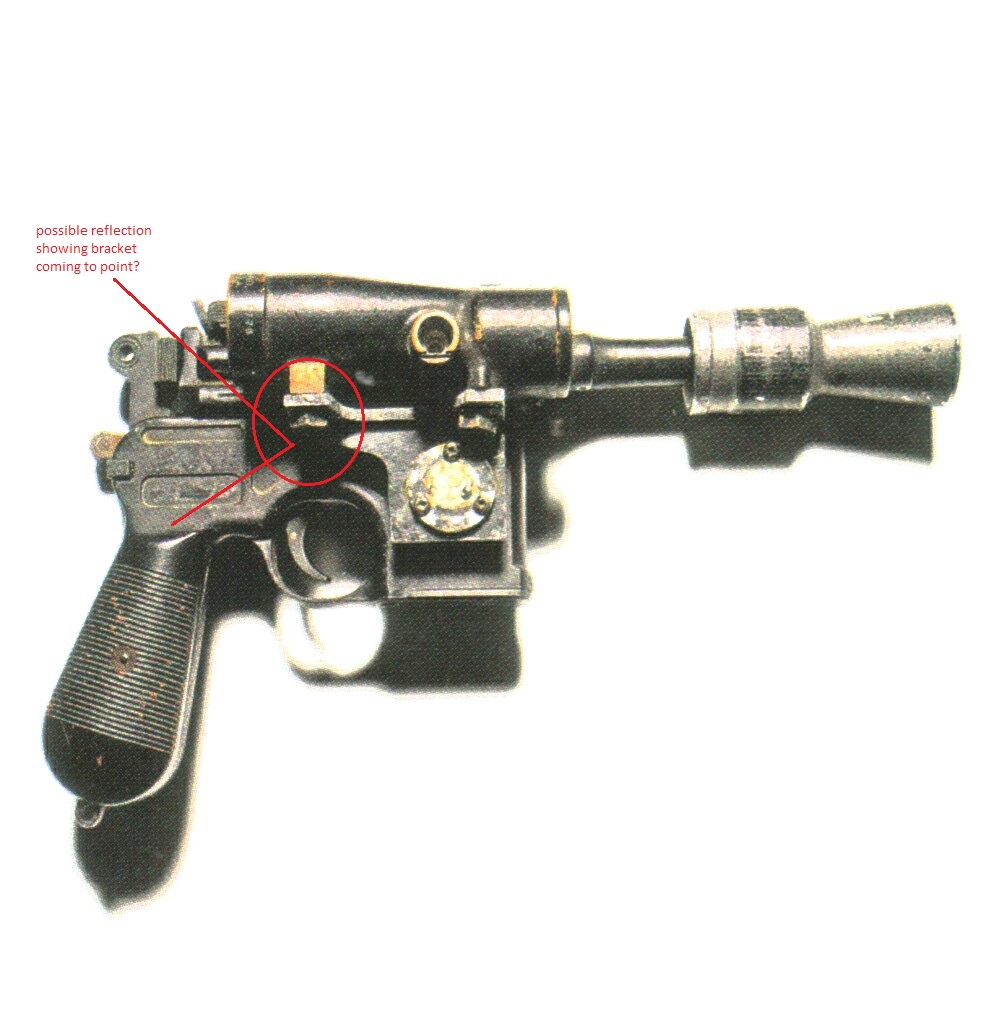

There's a spot in the shadows that may provide a clue. It may be the edge of the bracket as it continues to a point like you've got it drawn.

Perhaps this has already been said, but to me it seems as though the "L" Joint on the bracket is not 90' Degrees. I mean that if you were to look at the scope from the front it would be leaning in towards the blaster by about 5' degrees or more?
Ahh .. wait a sec.. studying Boba's drawing I can tell from it he sees that too.. I think ..
Sorry :)
Oh and Happy Xmas All !
Edit: I forgot to say I agree with the shape outlined by Boba, that looking at the shadow and the other clues, as was mentioned, it seems accurate.

I also don't understand what you mean. Are you saying that the vertical part of the scope bracket isn't parallel to the side of the mauser?
That has been discussed in the case of the Bespin Mount but s far as I know there are no front shots of the Hoth version.
Re: DL-44 ESB Blaster Discussion - Scope Bracket Starts at POST 118
I think he basing his conclusions in the fact that you can see the heads of the nuts holding the scope angled into view. I would say that since that it is not the angle of the viewing position as you would also see more of the bottom edge of the mount. Therefore the angle of the mount between the base and the top is slightly more than 90 degrees.
The whole blaster is tilted though because you can also see the bottom of the mag plate.
Hi ..Just to clarify I can see that the perspective may be exaggerating the effect but I am wondering if there is more to it than that ?
Here is just a quick estimate of the angle (not reduced for the perspective) .. It might not be there it might just be lens angle (i.e. wide angle).
I may be wrong ? as the difference is quite subtle?
I doubt the actual bracket is angled like that. I'm pretty sure they just used off the shelf angle aluminum but even if it was machined from a block of metal it would be difficult to create that angle.
I'm sure it is just an illusion created by the anlge of the photo

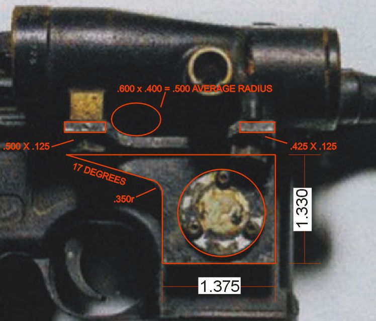

I did some more work and this is what I have so far
Odiwan - Most of our measurements line up but you have the height of the vertical part of the bracket set at 1.400 which is .060 (1/16") less then what I came up with.
Where do you think the top edge of the vertical is in relation to the bottom surface of the top flat scope mount section.
I also have no way to extrapolate the inside dimensions of the cut out of the top part of the scope mount. I determine that it may have been cut with a 1/2" cutter by averaging the elliptical radius created by the angle of the photo. I will have to just make the rest of it idealized.

Looking good to me, but I somehow still see the possibility of a slight radius at the rear and of the mount, no pointy edge.

The only way to get a radius at the back of the bracket is to change the vertical dimension to 1.400 which is what you came up with but I don't think it fits the bracket correctly
I'm trying to get this to work but with the clearly defined angle and clearly defined back edge it just doesn't seem to work.

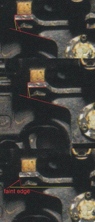

Could you have the back corner of the scope bracket in the wrong place? I'm seeing the edge of the rear 'prong' at a different angle in the photo.
Definitely saw that faint edge, but it still seems it would come to a point. Maybe not.
Kurtyboy - I have tried pulling these angles every way and each time it comes to a point
In the first frame of your picture I think you have too much angle on the back prong and in the second you have it too straight. My angle is represented by a yellow line n the top two frames
I have added what I think is the right angle and I also include a horizontal line that demonstrates what I believe to be where the vertical and horizontal parts od the bracket meet
As you can see it comes to a point.
I can decrease the angle to create a slight radius but it won't be accurate
I change the angle of the lower back edge from 17 degrees to 16 degrees and I increased the radius to .500"
Full disclosure the thickness of the lines are covering up the fact that my line do not perfectly follow the image. I use super fine lines to define the object and then thcken the so they show up in jpeg format
If everyone likes this I will proceed and create the print. if not I'll continue to tweak it.
http://i131.photobucket.com/albums/.../ESBBB/ESBScopeBracketHoth007_zps8a54b891.jpg
Looks good to me.
