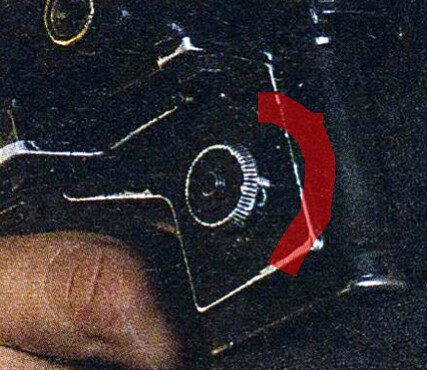

That looks better for sure.
Does the center of the knob inside the knurling look a bit inset to anybody else? It could be the weathering on the edge of the knurling, but it sort of looks that the knurling goes higher than the center section of the knob.

That is a natural side effect of creating a knurl. As the tool is pushed into the metal it forms the knurl by crushing the edge and the edge will expand outward.
Normally a shop would clean it up with a pass with a cutting tool, but the prop department may have just not worried about it.

I still think the straight section should be taller, and the angle for the knurled section looks a touch off.

I just did some averages and this seems bigger then convectional wisdom
Averaging the elliptical marks I come up with an OD of 1.080" and the top edge of the Knurled section is .810
Can anyone confirm this?

45 degree may be too severe...
Let me dig up some Luke reference photos.

Here you can see the thickness and placement of the spacer, and the thickness of the mount.
Han's knob on the mount seems to be nearly the same as Lukes, and the mount while only slightly different is generally the same shape. There are slight differences of course.
I've SEEN better cleared pics of this angle up close and in my face, but don't have access to it unfortunately.

I just cut and pasted the .800 drawing onto the bracket and it fit perfectly so the 1.080" is way off.

The knob on the Luke blaster looks straight to me - not angled like Han's. The knurling also looks finer.
I didn't think Luke was holding a different prop in that head-on shot. The knob does look like it's missing the bevel though, trick of the camera?

It's there and the same prop, what you're perceiving is due to the depth of field blur. The bevel is still there. ^_^ Although I admit, it may be more slight than the Han one.

It's hard to say, I think the flash hider is playing tricks on our eyes in that pick. Not to mention, the flash hider looks black in that publicity still.

The bottom (unknurled) part should be the taller part.

30 degrees looks much better, though.
