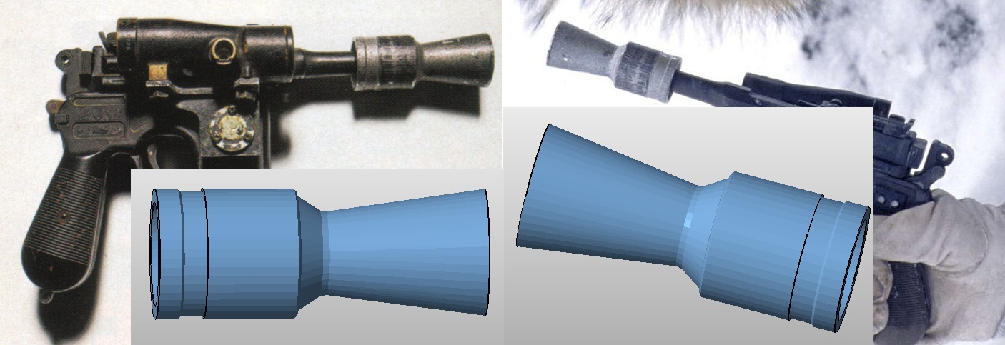

I made a 3d model of this muzzle. Here is a comparison of my muzzle with the available shots.
Let me know what you think?
Dan
Re: DL-44 ESB Blaster Discussion
That looks pretty galdern close to me!
Maybe bring the back end of the knurled section forward just a touch, and make the back ring a hair thicker.
I'm not seeing the flat section where the cones meet, but it might be there...
On an earlier version, the knurled section was a little shorter, but then I realized that the drawn on knurling doesn't reach all the way back to the end of that section, so that's why it might look a little long here
Dan
Hey Dan
I received a Hoth muzzle from you a few years ago and the proportions seemed slightly off. The new 3D model is much better, but I´d still shorten the length of the taper right behind the cylindrical section...it´s a tad too long IMHO
I am a firm believer of the drewn knurling myself.
Check the few available refrence pictures and pay attention to the light reflecting from the KNURLS, which would be possible if these are recessed/ raised areas. I tried the painted on knurling effect on my latest HOTH Dl44 WIP and even if not accurate, it´s much closer than anything else I´ve seen so far
