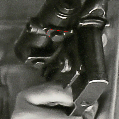

Here you get a good look at the height on the straight part of the knurled mount knob.
Sorry, this is the shot I'm talking about. Good shot of the profile of that knob.

My guess is that it probably moved around on its own due to the single point of attachment. Mine used to do the same thing when I simply used the knob to tighten it in place. After slinging it around and pulling in and out of holster. I finally used an epoxy to fix the problem.

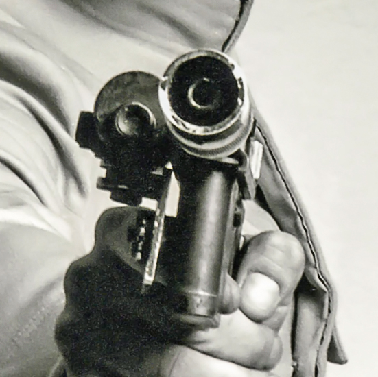

ok got my stuff:
It looks to me like a lot more doesn't line up on Mark's prop, maybe because, again, there's like one point of contact. It looks like the mount tips towards the receiver and maybe even towards the magazine portion as well, but the screw doesn't tilt (?)(in this shot the blaster is tilted up and the first bolt is in darkness) and it even looks like the rear bolt is crooked. Maybe I'm seeing things.
Yeah, the whole body of the magazine is tapered, it gets thinner as it reaches the front.
Mind. Blown. does it also get skinnier towards the top? I'm seeing two degrees and that explains why it doesn't point straight. Thanks!
