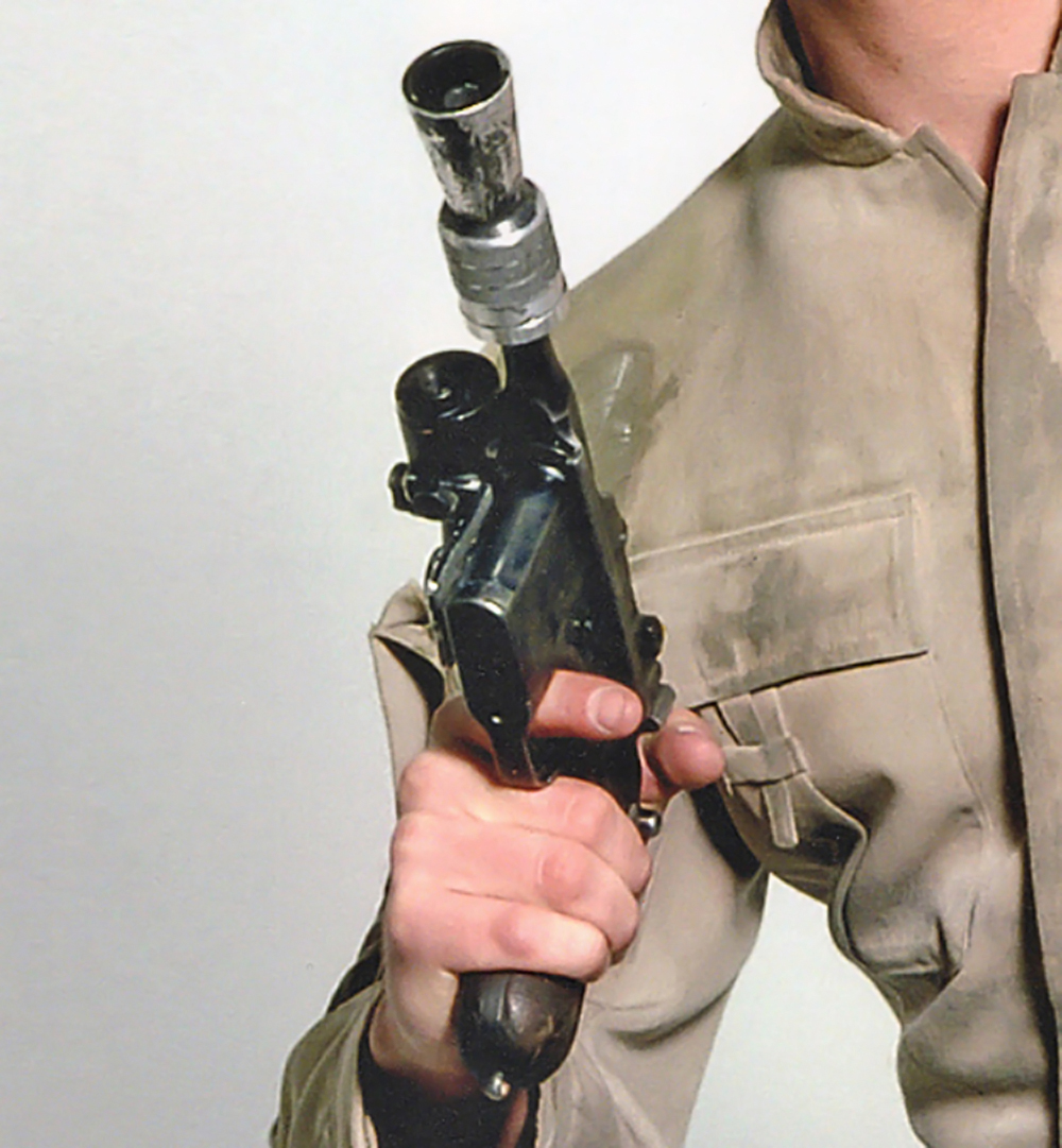

Is there actual evidence that shows that Luke and Han's real mausers are two separate mausers and not just one shared live fire weapon?
Hammers, magwell bump, Luke's trigger all look like real parts to me just from those photos.
Also, Luke's safety looks real in this photo, and there's no question in my mind those are real wood grips.

Just curious, what are the tells in those photos that indicates Mauser and not MGC?
hammer, trigger, mag well, lines, dimensions, everything actually. For me MGC is very easy to spot... like a Denix... unless it's KPax's super modified MGC... then it took me a minute to notice.
But yes those are the real deal.

Looking at all three of my real Muasers, my Denixes, and my MGCs Boba's measurements are pretty much spot on.
I am using the real Mausers as a base for all my comparisons since the hero blasters were real. The Hoth, I'm letting everyone else worry about. I like the Luke so that's my focus.
Anyway, the Denix is larger than the MGC and real Mauser.
From base of mag well plate to lowest edge on upper receiver we get this:
Mauser: 2.222"
MGC: 2.285"
Denix: 2.337"
So to me boba's measurements work on a real Mauser. The 1.25" width of the base section MIGHT be a tad small... needing to be a little wider, especially for the Han Bespin, as they look slightly different, otherwise it's good. Say 1.35"?...
the rest checks out on real Mauser.

The first one is from the same shoot. The scratches all match anyway. The second one from the Bespin set, doesn't look to be as scratched up...
