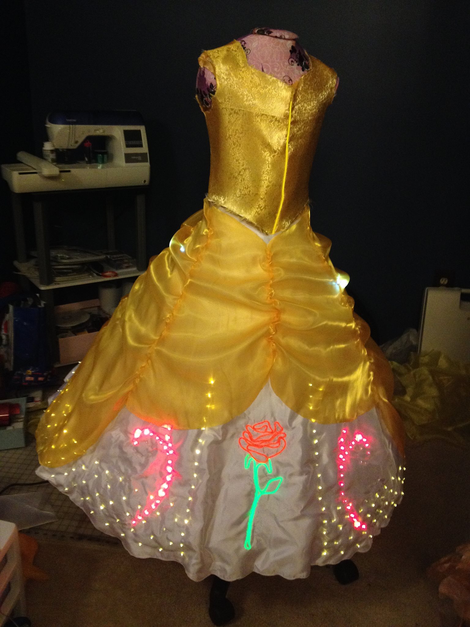

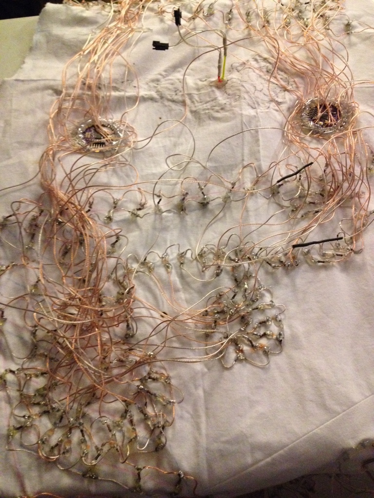

So I finished hooking up all the lights on the bottom of the dress!!!! Whoohoo!!! Now just have to install and hook up the twinkle lights at the top of the dress. So about 40-50 more and I'll be finished hooking up lights!! I'll be able to start sewing again [emoji4]
Re: Disney's Belle Costume
I finally hit the halfway point of the dress!!! Lighting is all wired. I think it looks beautiful!!! Now for the cutting and sewing of the rest of the dress!!! Time for sleep now.... More work tomorrow :)

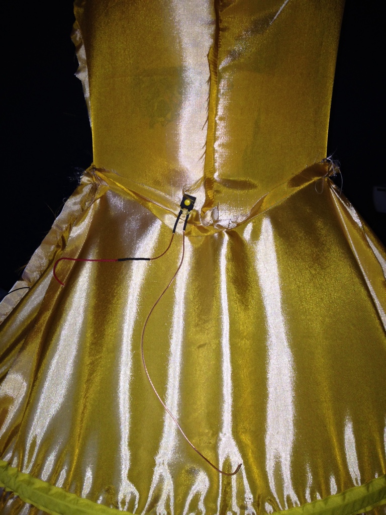

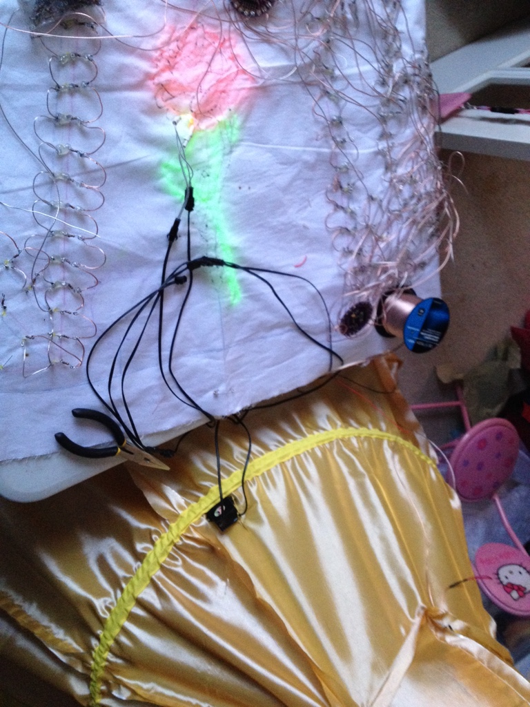

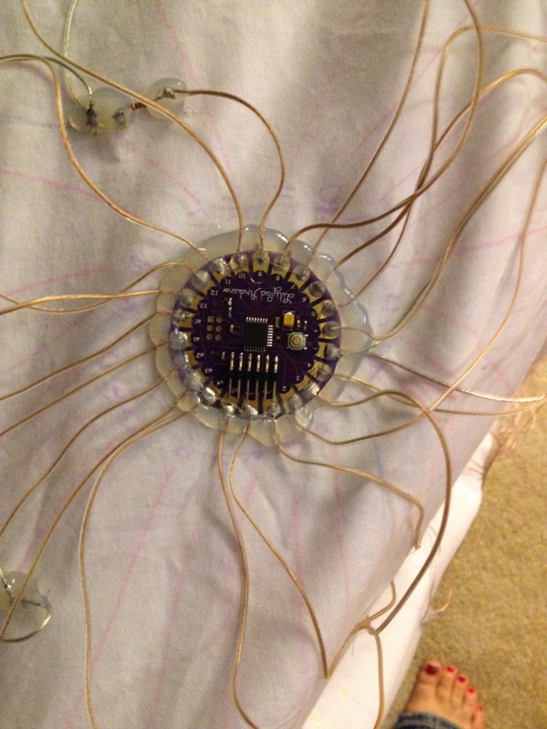

So one of the things it forgot to mention is after soldering all the wires I used hot glue to insulate and protect each of the connections, I'm using stranded wire and solder can still be kind of brittle. ALLL these connections still have to go through me constructing the rest of the costume not to mention the trip down there. We are flying and after looking at this crazy wiring batter packs and 4 lighting computer chips I've decided to ship the costumes ahead of time. My fear is that they will X-ray my checked back and go WTF is that!!! Delay my luggage to have the bomb squad call and worst case scenario would be the slash my costumes looking for c4 lol. My mother suggested I just call TSA explain the situation see what they say lol I said they've seen nothing like this and i wouldn't trust the answer I get :) better safe than sorry!!! To many man hours to risk it!ImageUploadedByTapatalk1421805897.108444.jpgImageUploadedByTapatalk1421805925.652987.jpgImageUploadedByTapatalk1421805949.726571.jpg

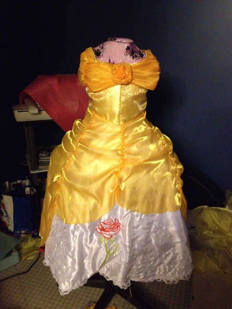

Ok so I got the yellow panels sewn and gathered. I used my heated cutter along the bottom so it wont fray but I still think it will look better hemmed. Or maybe gold piping along the bottom. Either way Happy with this fabric and color and length of the panels. ( Few adjustments still needed but yeah.. ) I think i'll use the lemon crystal organza I have for swag around the skirt... we'll see :) I also decided to NOT go with the white crystal organza over the lights. It mutes the color too much in my opinion, especially in the EL wire. ( you can compare this pic with the one from the previous post to see the difference)

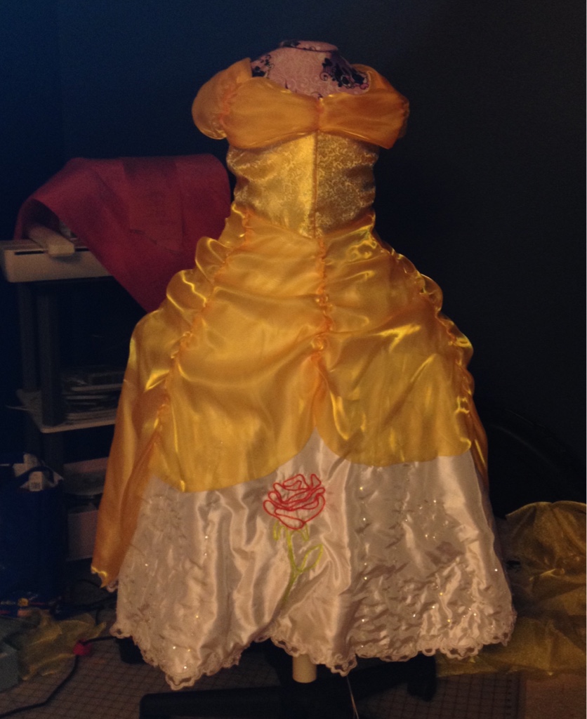

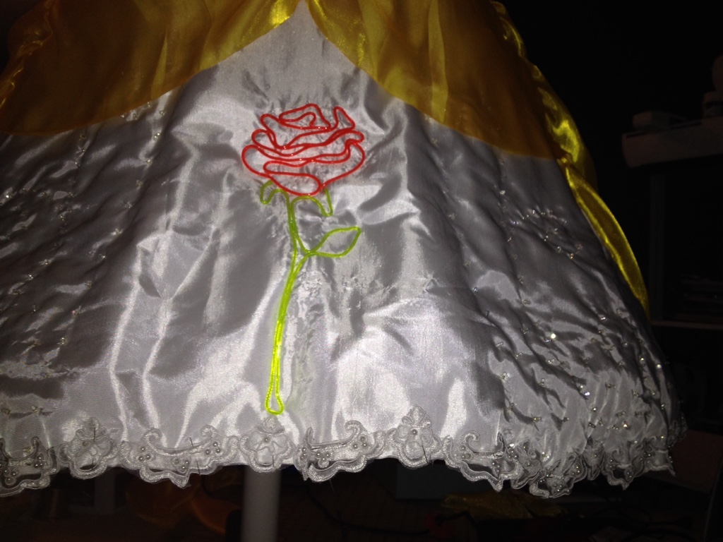

Alright got the liner seen to the dress and the sleeves on it. I have not put the bottom hoop back in it yet but....ImageUploadedByTapatalk1424568273.991815.jpg

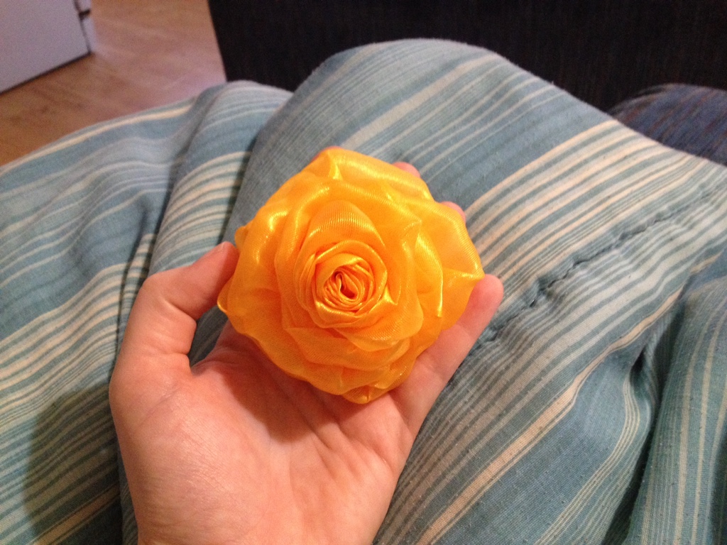

And here is one with the rose I made for it pined on. I'm trying to decided if it's too big should I try and make a smaller one. Remember the bottom poofs out more once I put the hoop back in :)
This is with the bottom hoop in :) I think the large rose is ok... Lol I'm so judgie lol
