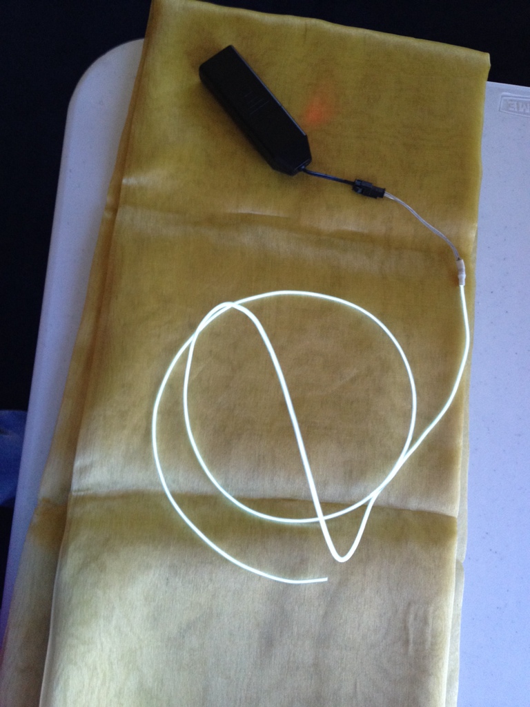

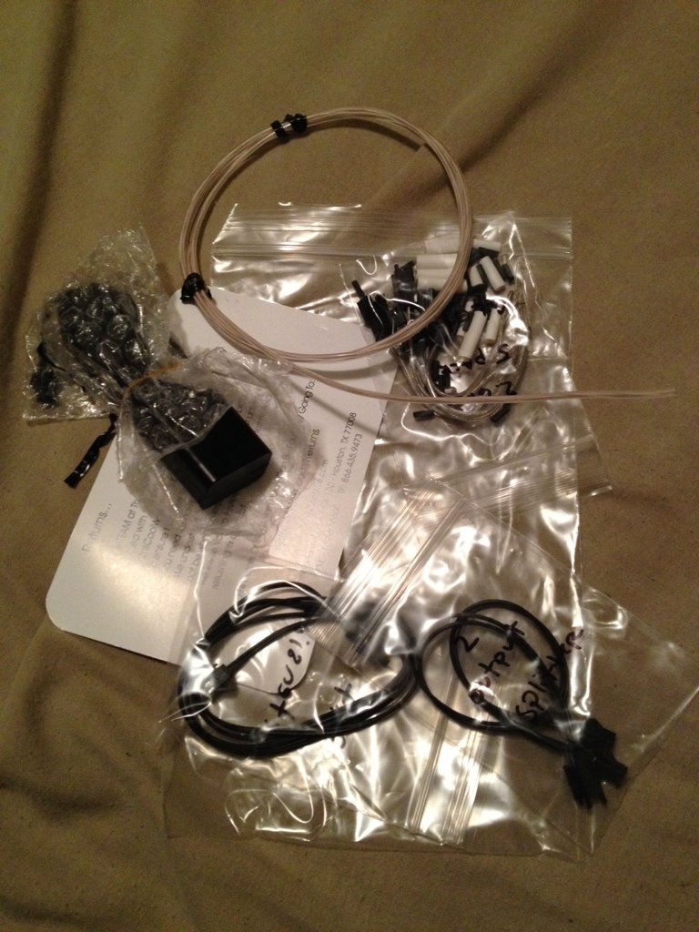

Alrighty!! Getting excited!! Most of my stuff is here from china ( so much cheaper to buy my supplies!!) sorry USA I love you but I can't afford paying 95 cents per LED light when I plan on using hundreds :( plus I I buy them in usa they were probably still made in china anyway!! Anywho paid between 2-4 cents per LED. Big difference right!!! My sheer gold fabric came in and I hooked up my EL wire and I think the piping will look awesome!!!! Here are some pics!!
EL wire off
EL WIRE ON
What my piping will look like during the day
What my piping will look like at night!!!

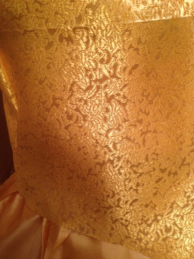

So I got the lining of the dress put together :)
And this is the beautiful brocade fabric I'm making the bodice with :)

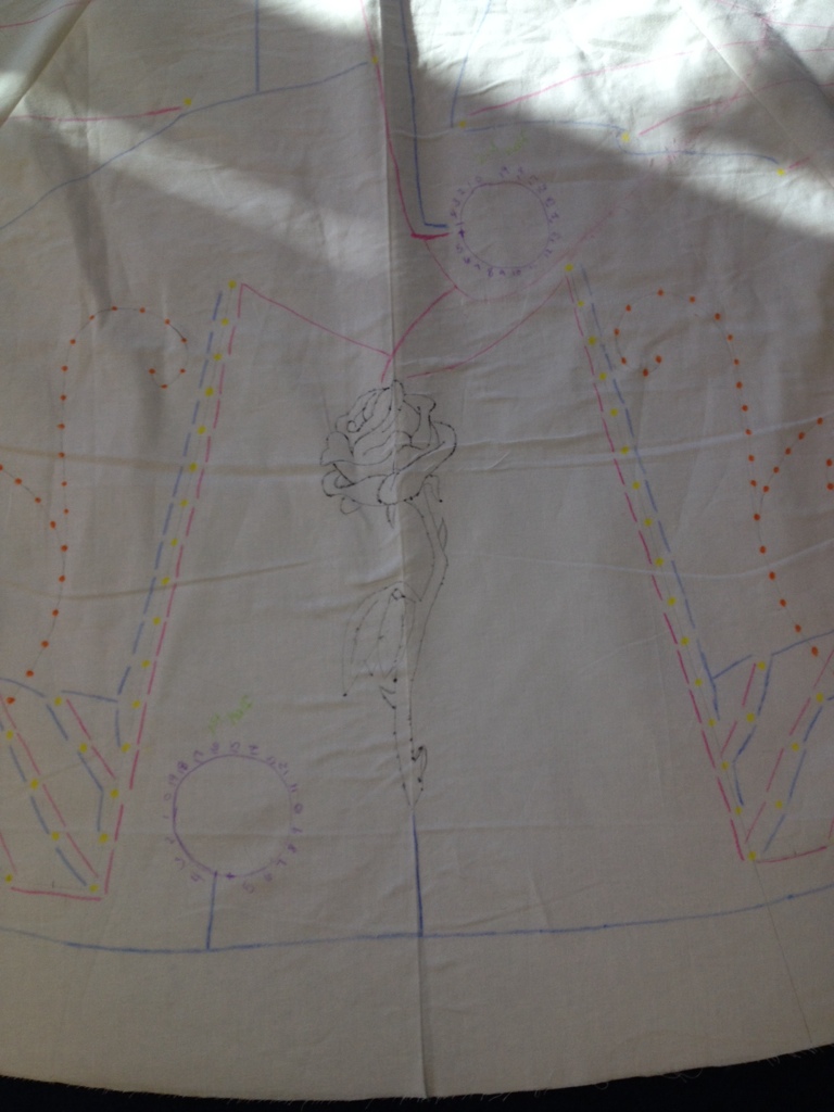

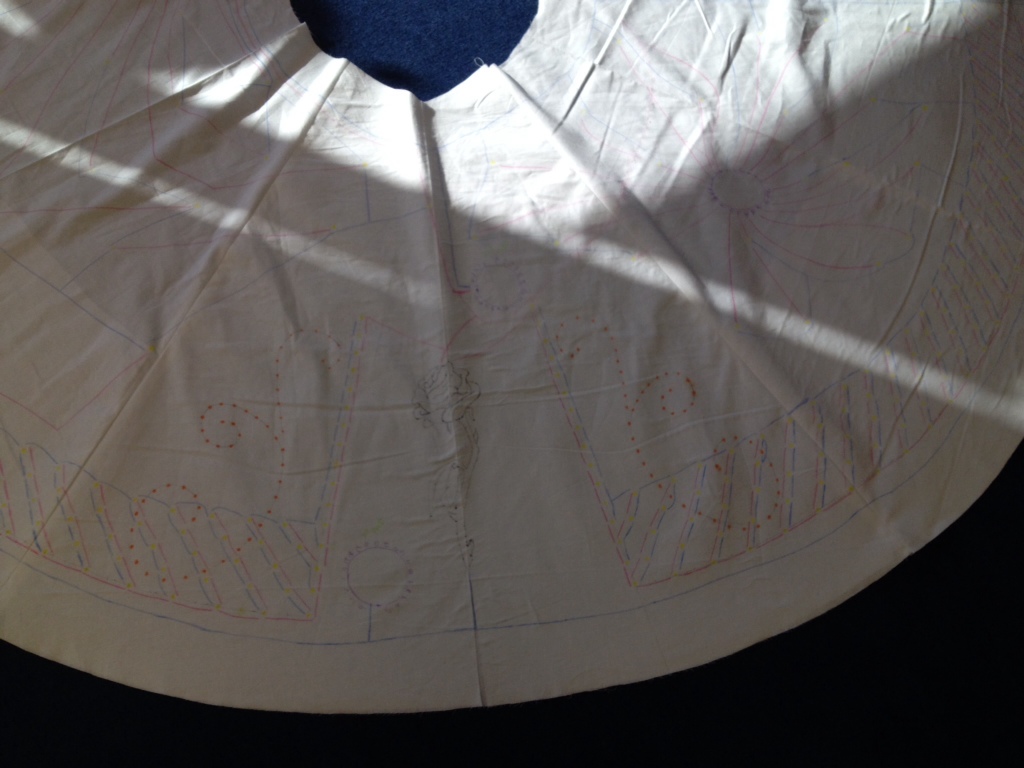

Update, I got the muslin skirt put together and the interfacing ironed on. I used different colored drafting chalk to draw the lighting design and the wiring diagram on one side of the muslin skirt.
. ImageUploadedByTapatalk1412354642.703093.jpg ImageUploadedByTapatalk1412354656.117847.jpg

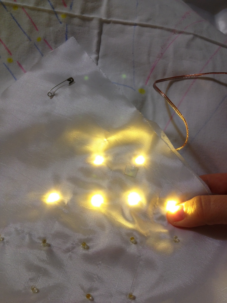

I'm using a faux silk taffeta for the top layer of the skirt. I've got it put together and safety pined to the muslin later to hold in place. I sewed a lot of the long straight lines with conductive thread with long leads before I attached the top layer. I used my sewing machine because it was faster and neater for long distances!
I've stared poking the lights through. This is very time consuming but I really hope it's worth it in long run!!!
I've not seen any projects of this scale using the conductive thread! I really really hope it works once it's all wired!!!
