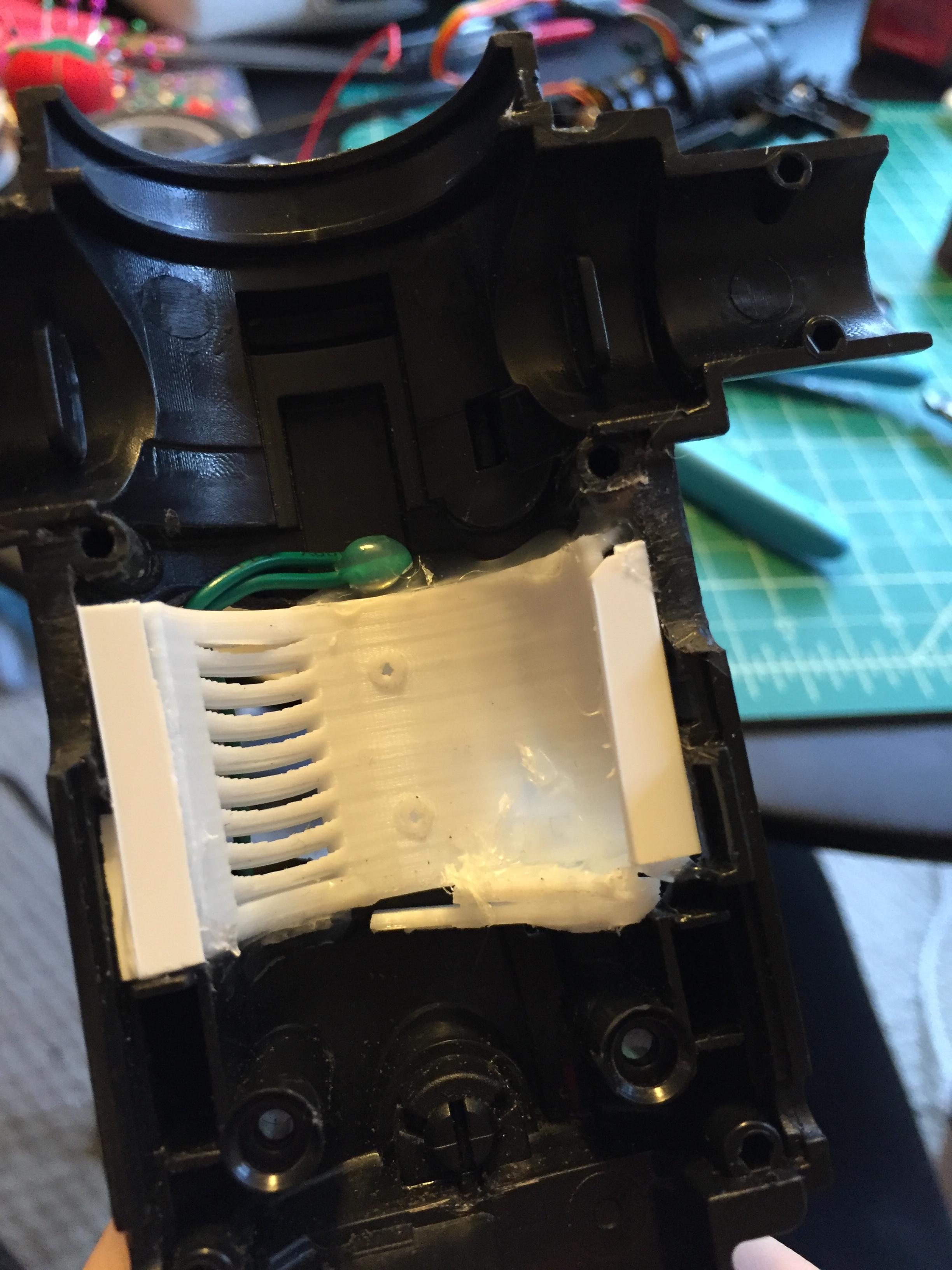

So it's kind of blowing my mind just how well standard-sized parts fit this thing. It's coming together really nicely, I think.
For the side emitters, I got the 7/8" OD Thin Walled tube. Note that I did not do anything fancy to the tube itself.
To make sure the tube slides on all the way, you have to Dremel off the little raised bits that held the original side-emitter tubes in place:
http://i.imgur.com/amvNCAO.jpg
I'll let the rest of the pictures speak for themselves:
http://i.imgur.com/LzBJzjf.jpg
http://i.imgur.com/CyoxgcU.jpg
http://i.imgur.com/xjLr2Hy.jpg
It could probably stay on with friction by doing one wrap of electrical tape around the emitter part, but I'm going to try using countersunk machine screws to hold them in place and keep the screw flush with the tube.
Using some of the excess after I trimmed down the main blade, I made a little custom holder for the lens/LED that'll sit at the bottom of the blade sleeve:
http://i.imgur.com/KuYiNmw.jpg
http://i.imgur.com/f7vjxWY.jpg
