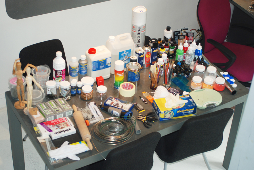

Step 2 : buying some stuff because all I have is ....hummmm... nothing. A couple of nights later :
Step 3 : Buying some extra stuff to survive all the working nights
Step 4 : Telling my wife that working on this project is essential for my brain development and YES I will not paint the living table (of course I was lying)

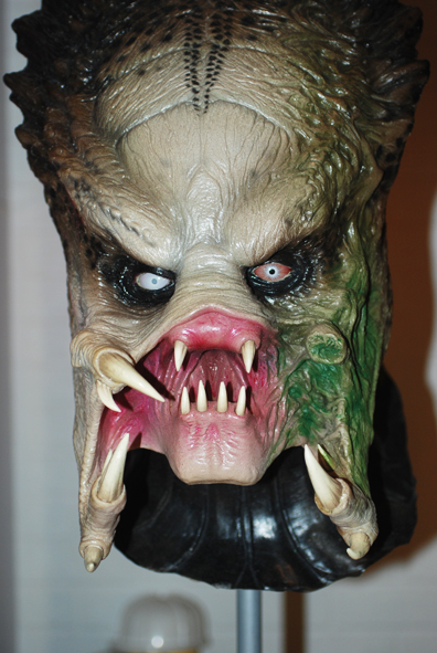

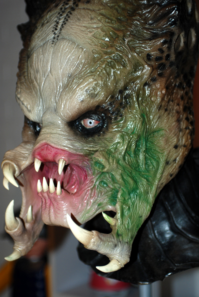

The Celtic Pred Bio Mask

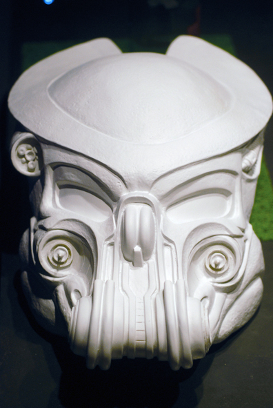

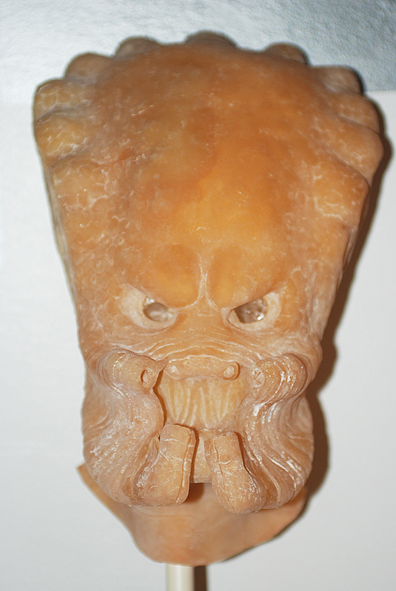

I put my greedy hands on a resin celtic mask

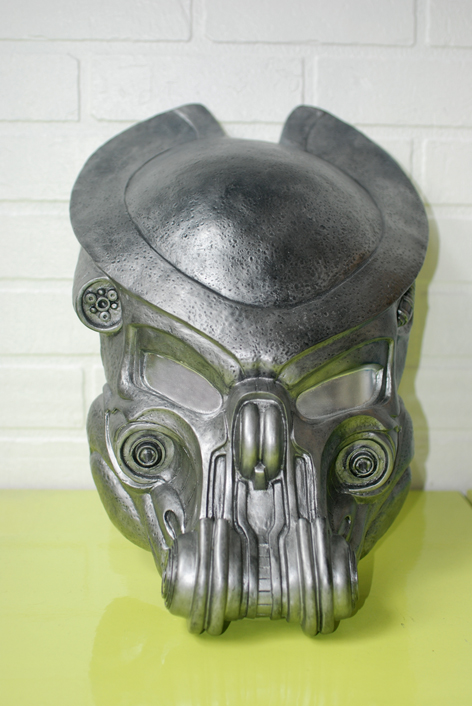

After cleaning it, I used a badger airbrush and auto-air colors to paint it (autoair colors website) and full catalog
I thought airbrush may be useless but it worst every dollars i spent ! I'm using a Badger 100.

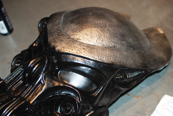

I used a white primer color to layer all the mask.
Then I painted it with two layers of pure black.
Using bolt gun metal paint from warhammer (Boltgun metal paint), i use dry paint method on all the mask.
Using chrome ALCLAD2 lacquers chrome ALCLAD2 lacquers , I painted the eyes. Not sure it is the final result i want but I will considering some improvements.
I recently buyied Eyes mesh Eye Mesh from don-jarr and I will test it very soon ! In progress !!!
Finally i used water based satin varnish to protect the mask

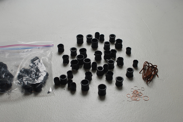

A big thank you to Joe (Bambooie) for his great job and for the very smooth transaction. You are such a pro !
Received my shipment and it was like Christmas day :rolleyes:

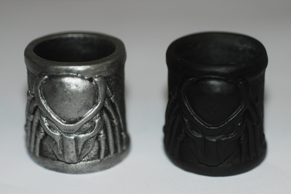

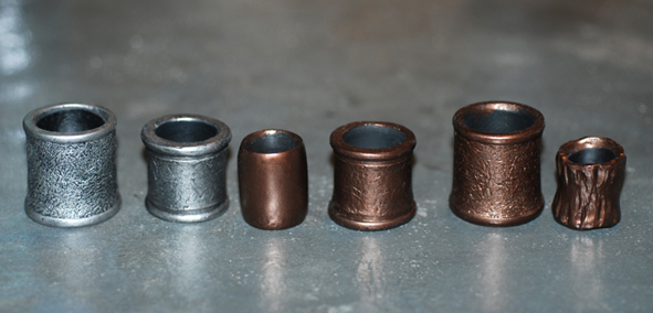

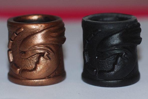

I chose P2 style beads, looking for more "Elder" style.
After getting ride of the major beads flaws, I used some milliput to remove the air bubbles holes.
I sprayed warhammer chaos black undercoat then 2 brush layers of boltgun metal, added some shadow and dirty effects with black ink and then glossy varnish
I sprayed warhammer chaos black undercoat then 2 brush layers of warhammer brazen brass, added some shadow and dirty effects with brown wash and some red shadows with chestnut Ink ink and then glossy varnish
Aplying the same method, I painted other bids with bolt gun metal and Tin bitz color to add more colors:
As I'm planning to have some more custom preds mask, I started to make my own stuff.
I would like to give a more personnal background to my preds as uratz doing really succesfully.
Using supersculpey and a plastic tube I reproduced a large P2 bead to customised it in differents ways.
They are pretty much the same size that bambooie's beads so they can easily be mixed with the ones I bought him and fit well to my dreads.
Using RTV181 silicone with slow catalyser, i produced 1 part molds to cast my works.
Slow catalyser gives better results and very flexible molds
Using polyurethane resin and black pigment i produced some new beads.

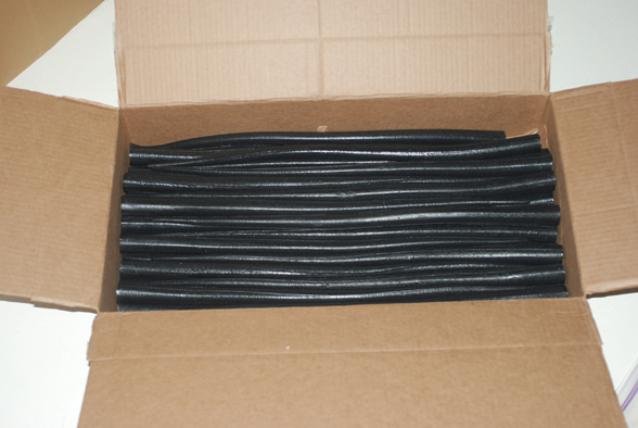

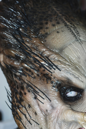

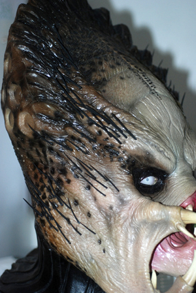

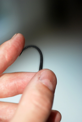

I tested different ways to build good looking quills : sculpey (good but very fragile, latex but was a wrong way, resin but was heavy and expensive and boring to cast).
I have good luck with air drying foam. Easy to use, easy to mix to obtain infinite colour tones, flexible, and so easy to glue with araldite !
Here is the result :
Need 100 quills for the mander wolf mask !
Quills will be shortly available in the buy and sell section (available in any colour you want ! )

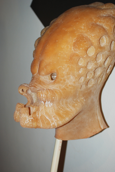

The Predator 1 raw mask (Usurper's version)
I bought to Usurper a P1 mask. He is a very guy and so easy to do business with him !
Thanks again Lee !
He cast me a mask in 3 days and the result is perfect.
I'm planning to paint and stuff it

Over two weeks to make good looking quills. A bunch of neurons dead !
Paintninja
Welcome to the "Homeworld"!
Splendid bead worx, looks great!
If I may, an easier way to do quills though may be to simply purchase
fake plastic palm grass from your local craft outlet then paint the tips black,
a light coat of permawet and cut to desired length. Glue em on with superglue,
worked like a charm for me. Excellent worx though, keep up the good work! :)
