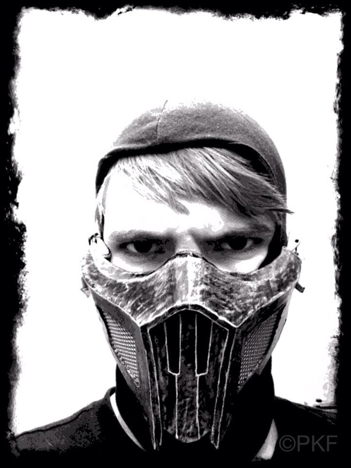

Hello everyone, my name is Daniel and I am new here.
First of all I am fascinated by all your work (I looked through the whole thread) and I am so motivated to start my own Mark VI suit now!
I am not that experienced with pepakura (all I did is a mortal kombat noob mask)
I watched the hero tutorials but I still have got a few questions, I hope that you can help me :)
1. Do I have to print the templates on cardstock or is it ok to use normal paper?
2. What thickness of foam do I use for different parts? I heard that it is better to use thinner foam for some parts of the suit.
3. Scaling: I am afraid that the default size won't fit me well, so I measured myself this morning:
Height 5 feet 9.6inch and I weight 154.3 pounds (I am a Freerunner and rather athletic)
Head width: 22,6
Shoulder-shoulder 20,5
Chest 41
Shoulder elbow 13
Elbow hand 11,5
Abs 32
Hip-knee 17,5
Thigh 21
Shin 24
Bicep 11,5 flexed 12,5
Knee-ankle 18
Shoe size 43
Torso 21
Hip width 36
Could you tell me the scaling factor for the parts (e.g. -20%)? That would be a big help for me ;)
4. Would you recommend doing the helmet in cardstock/resin for more detail? (I plan inserting leds and maybe a motorized faceplate)
I would be really happy about an answer, thank you :)
Daniel xx

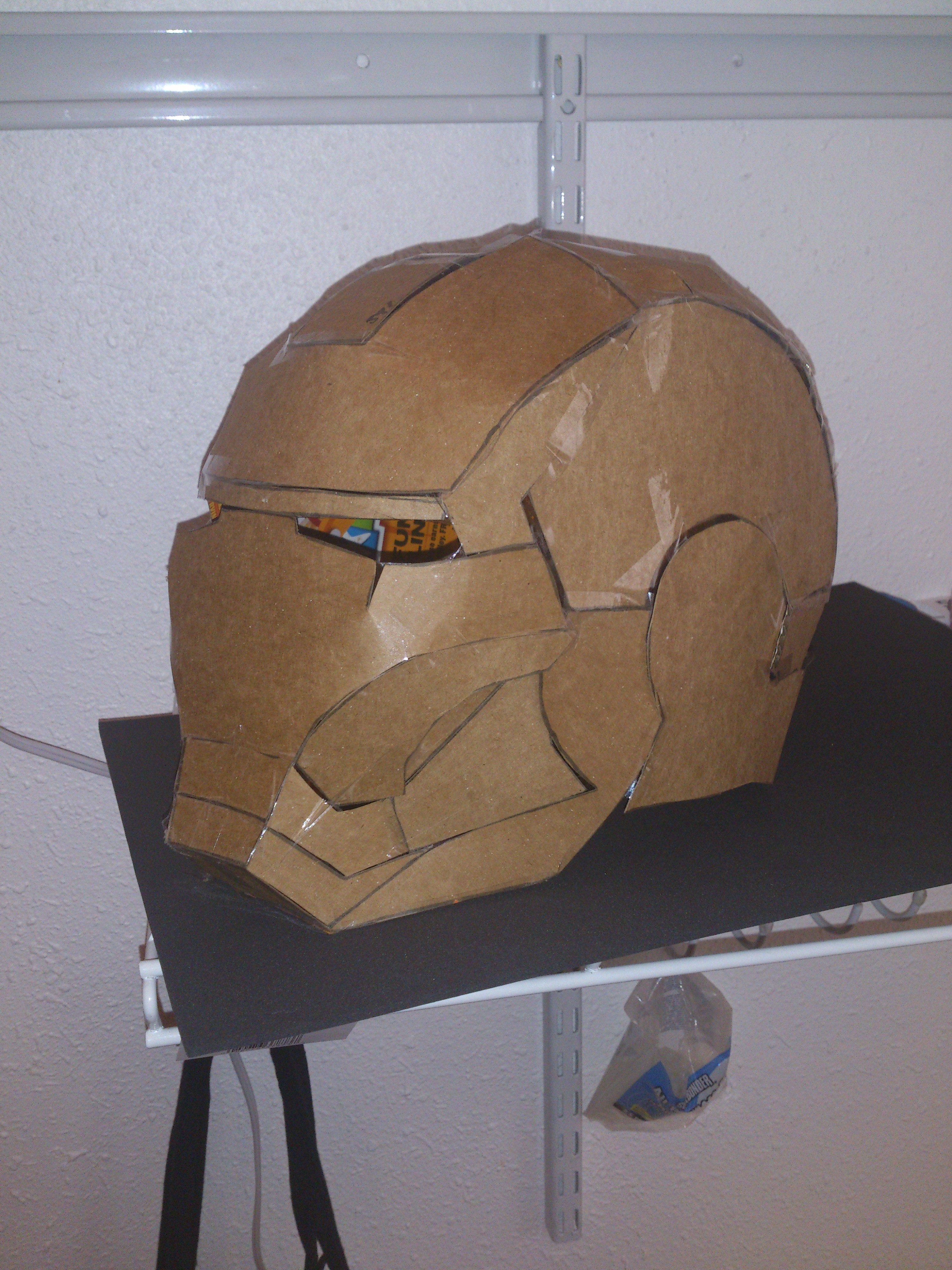

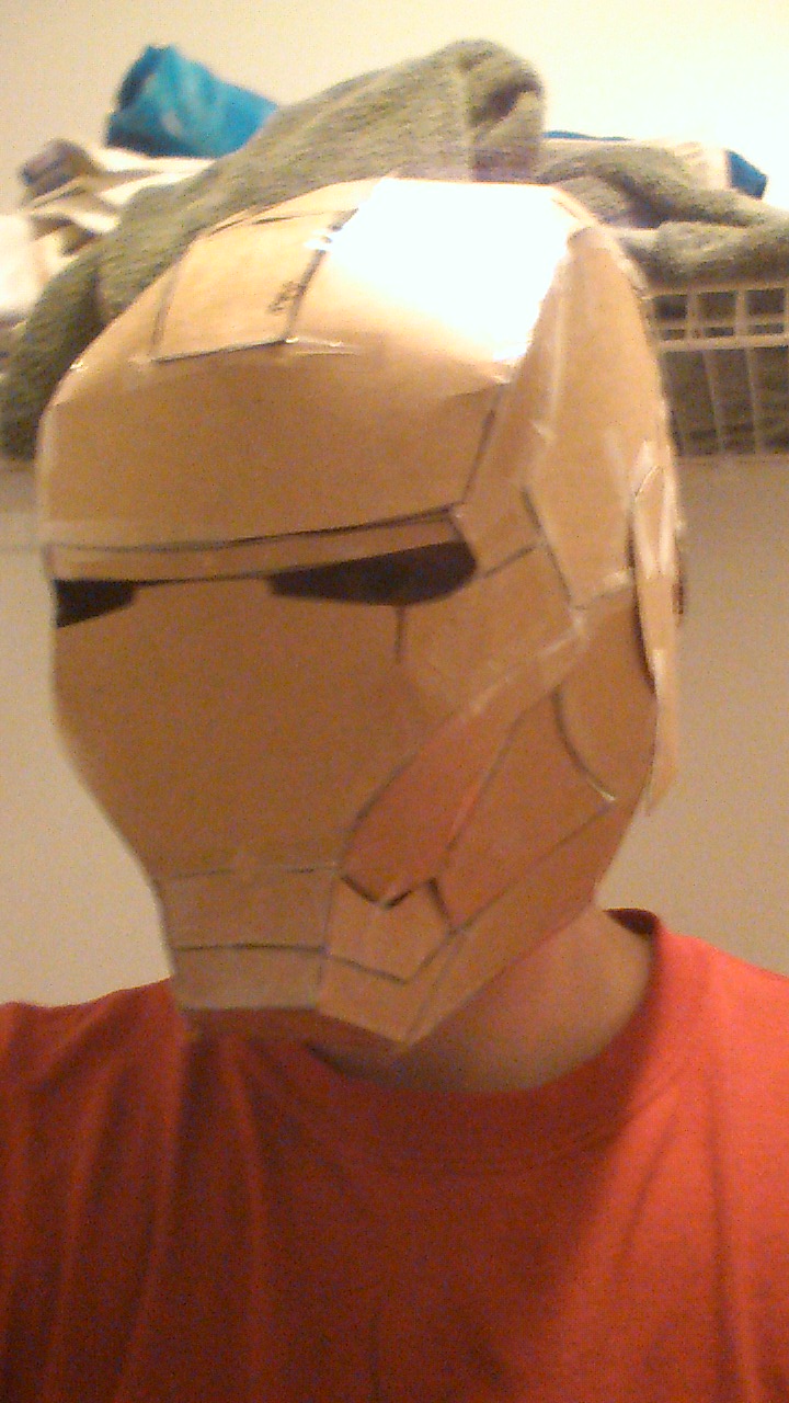

Well, after watching Iron Man 3, and finding myself with a somewhat open summer, i decided to start making my own Iron Man suit.
I started with a cardboard helmet just to make sure if fit, (ive always thought i had a huge head), and it did fit! Im 6.0-6.1", so im going to stick with the default scale and start working on the foam build today! Can't wait to start getting the pieces put together
This is what the helm looked like, (pretty rough around the edges, but for a test build i thought it turned out alright, ill probably save the foam helm for last, i want it to be perfect.
