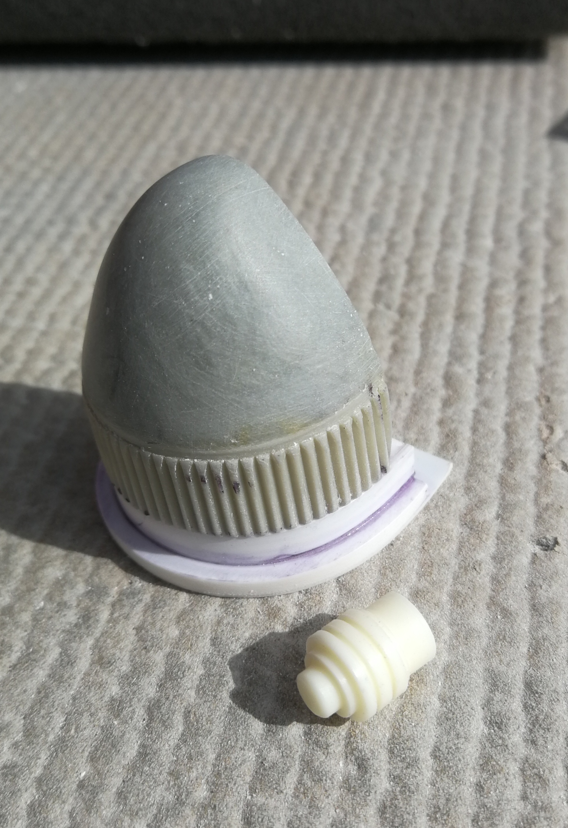

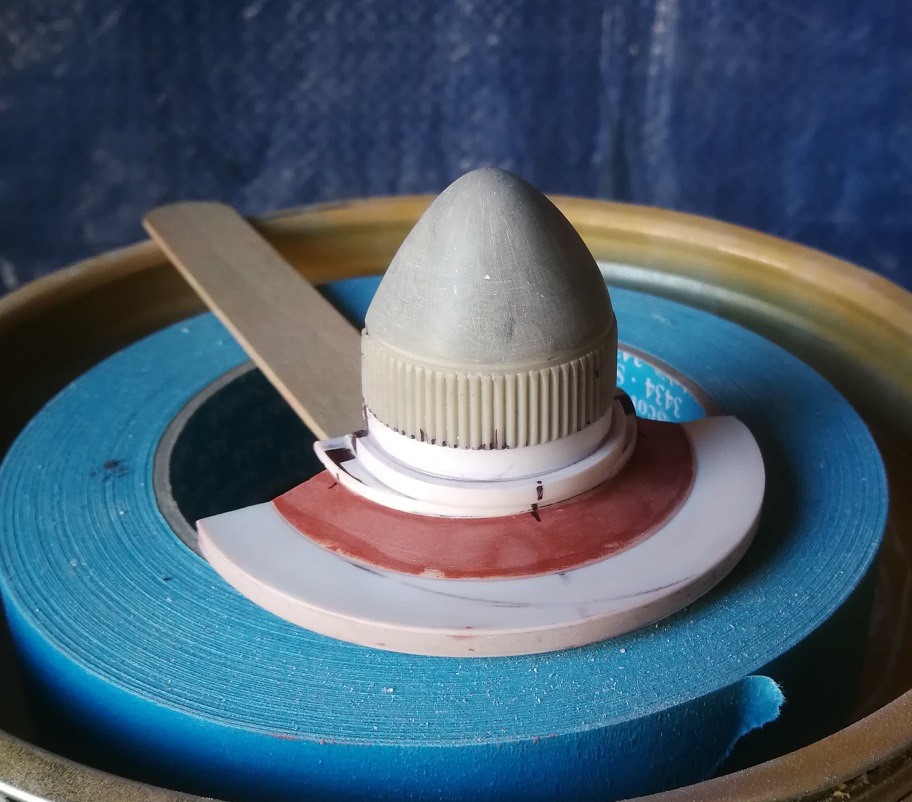

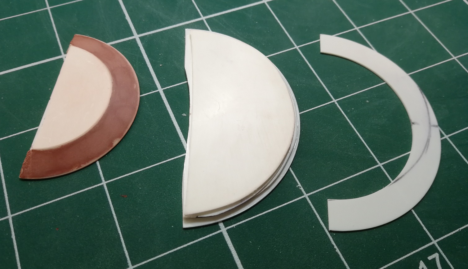

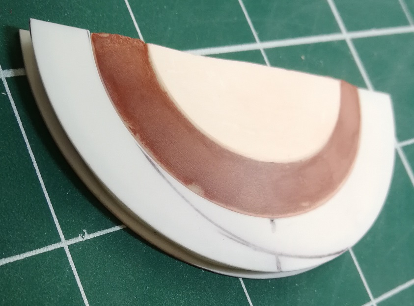

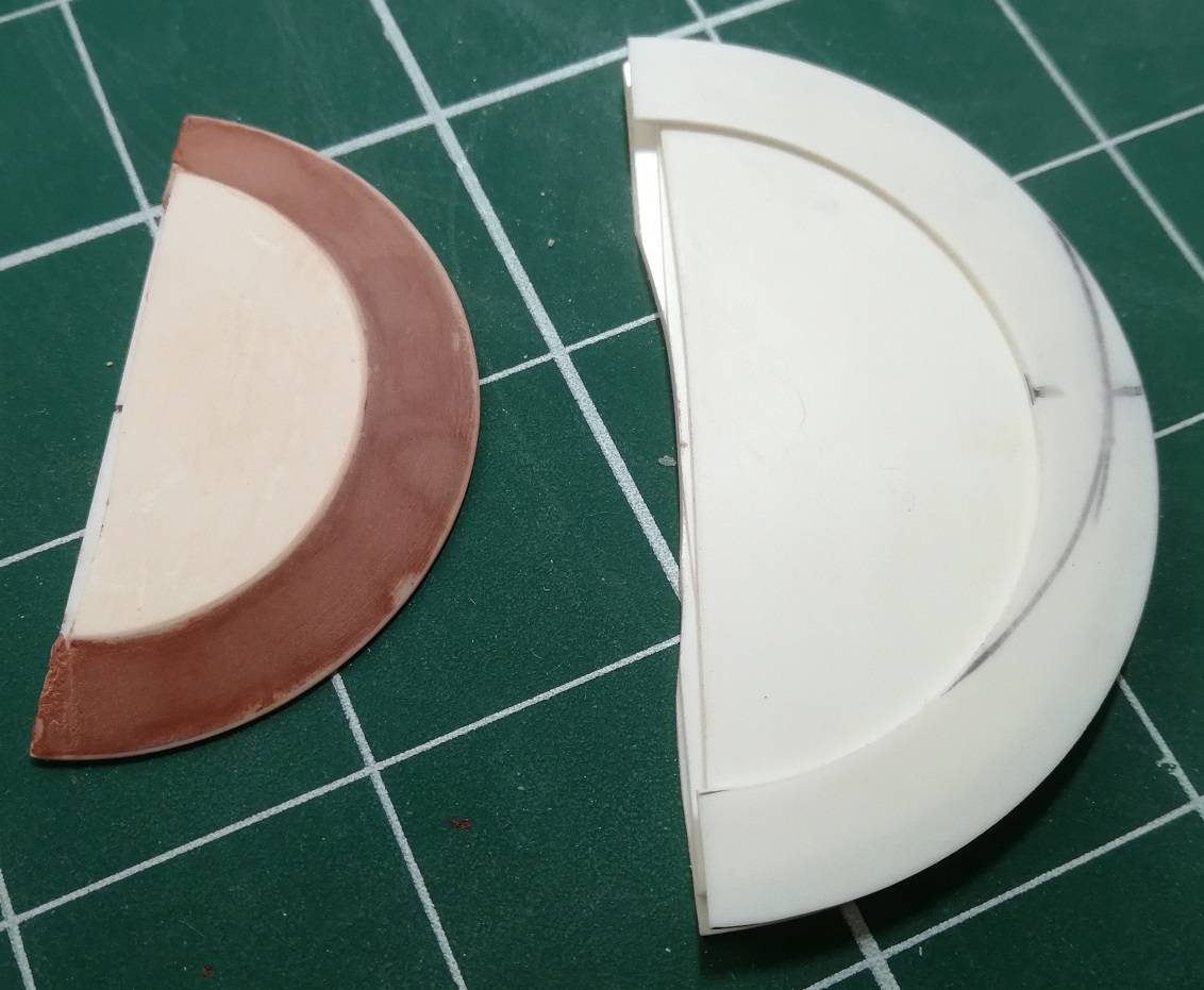

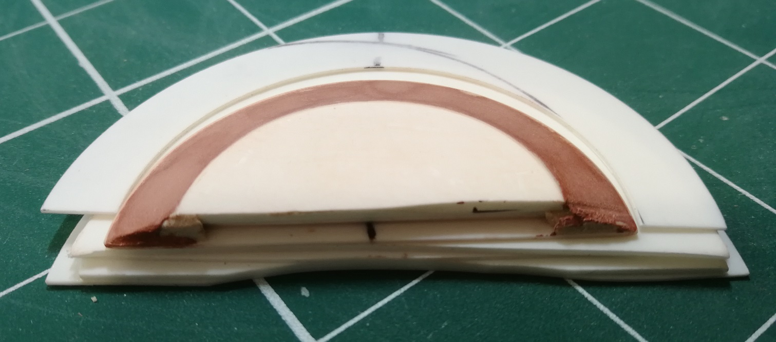

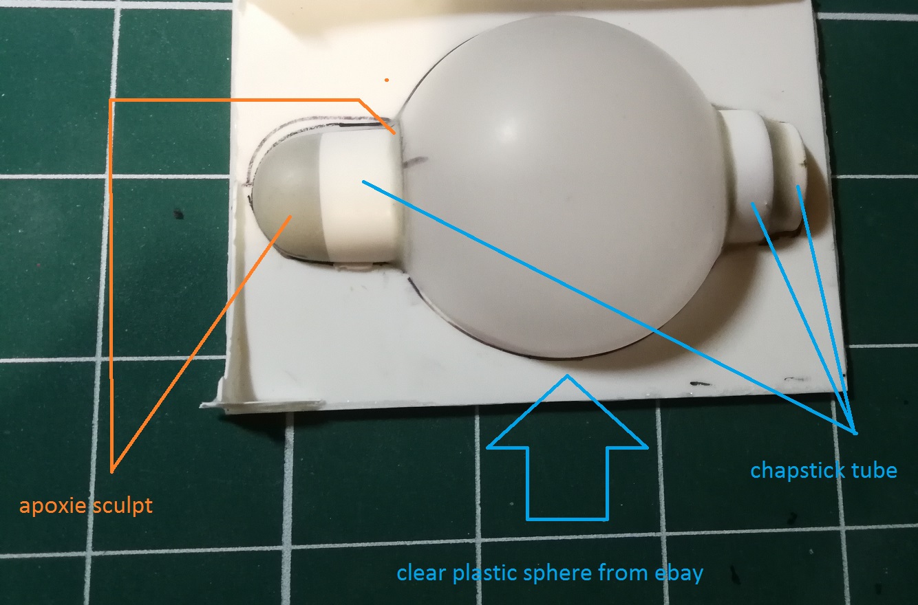

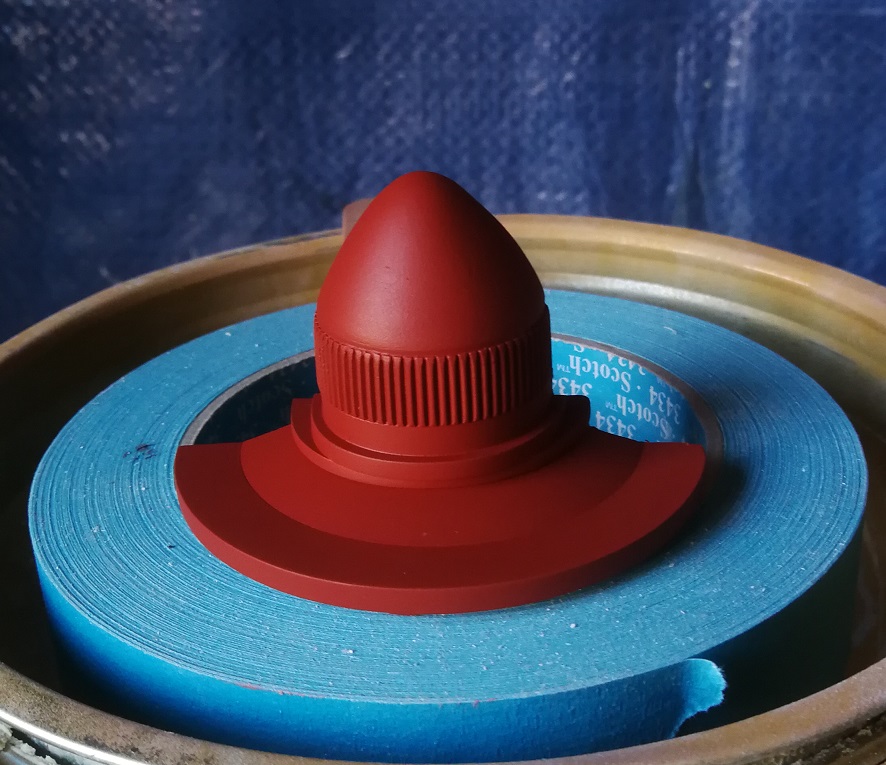

did some more work on it today, the front nose piece WIP. apoxie sculpt top bit, a cast from a meguiars car polish bottle top had a close match to the lines, the real droid one is pretty wonky. plasticard for the lower layers....
and i decided to do a test cast of the front tusk which came out really nice, i was worried about air bubbles (no pressure pot) but talc saved the day.

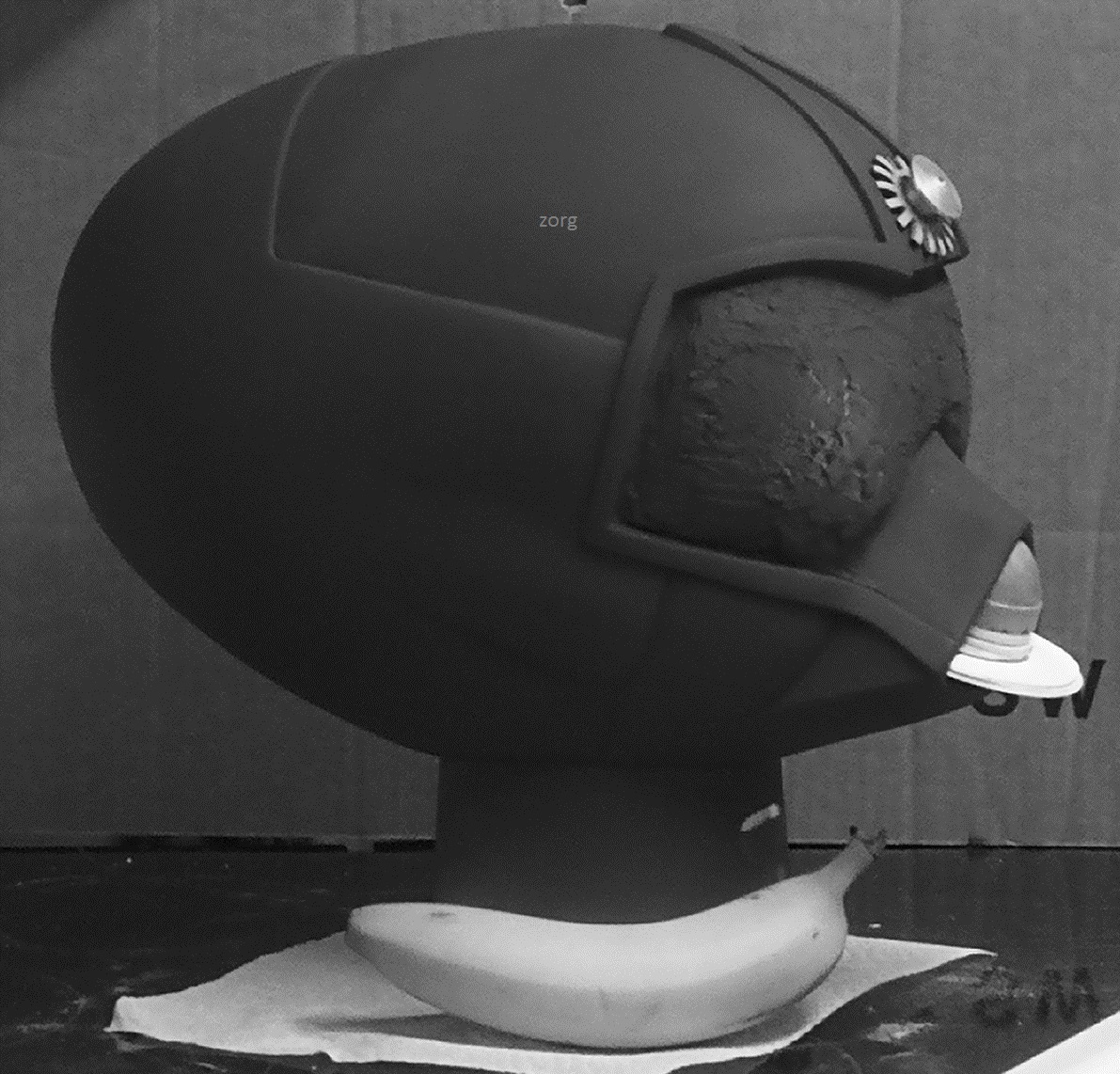

i did quite a bit on it today, the neck hole mainly and boring stuff. but happy with the progress. IGNORE THE EYE LENSE!
here is a low rez image of WORK IN PROGRESS, all areas are subject to change. some areas are not done yet obviously. i need to move some lines, add some lines, bring other parts out, if you see something out..... i know about it trust me. i just want to get it in the ballpark before i start the final passes cleaning it up. there are pin holes, scratches, wonky lines and filler that still needs sanding but i will get to it all.
wanted to slap some primer on it just to see where i'm at,
it was just a patchwork of filler, paint, and drawn lines. now i can see a better overall look.
BANANA FOR SCALE!
P.S. that is not the neck its a paint pot..........
