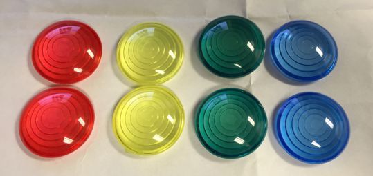

A bit of an update.
A bunch of the bezels were sent off to be chromed, awaiting those to return to see how they look and determine any size modifications might be necessary for them to fit.
While we are getting bubble free casts, it's about 3:1 casts with one or more bubbles to bubble free casts. Being anal about what a bubble is.
We are wondering if the back of the lens should be matted out since seeing right through there is a hot spot on the LED.

On the LED hot spot; why not make the entire housing deeper and allow for a diffusion sheet to be placed?
It doesn't have to be as deep as a real panel lamp housing but making it deeper would improve the look by having the LED set farther back plus a possible diffusion sheet

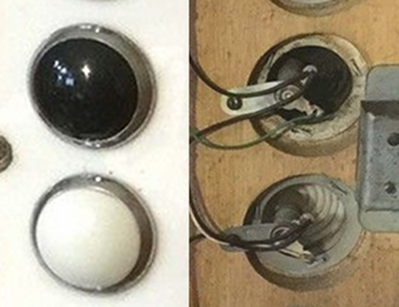

Going by the lenses in the larger lamps, the even glow look is all down to the quite rough matt texture on the inside together with a fairly large clear round bulb sitting almost all the way up to the plastic.
Here's a look at the back, you can just see the size and how far in an original bulb sits. The opaque lens then gives a full and even glare.
Do you think that matt effect would be possible with just a coat or two of matt varnish? If so, would buyers rather matt their own to get the effect they're after?
Looking real good.
We have tested matte paint, but today we're going to media blast the back of some as a test as well. For me, I think it's better if it comes out of the mold ready to go.
Definitely can offer them clear and let people do what they want to with them.
