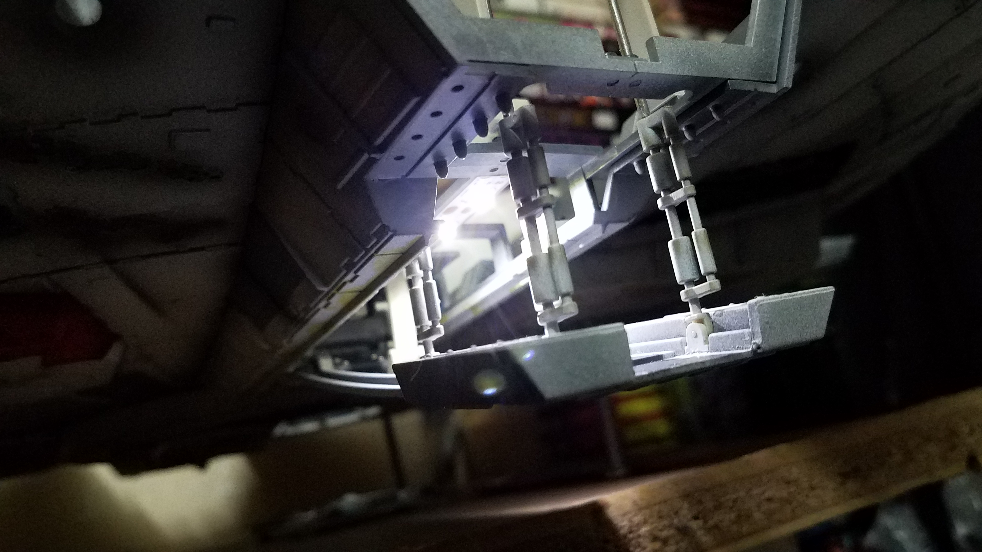

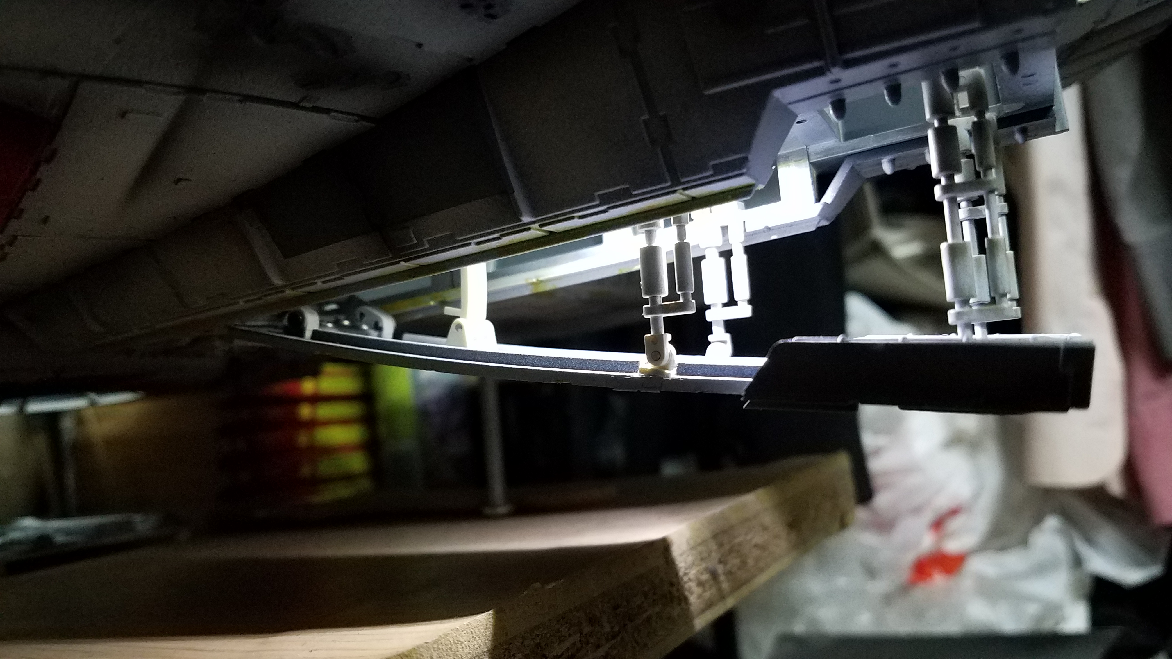

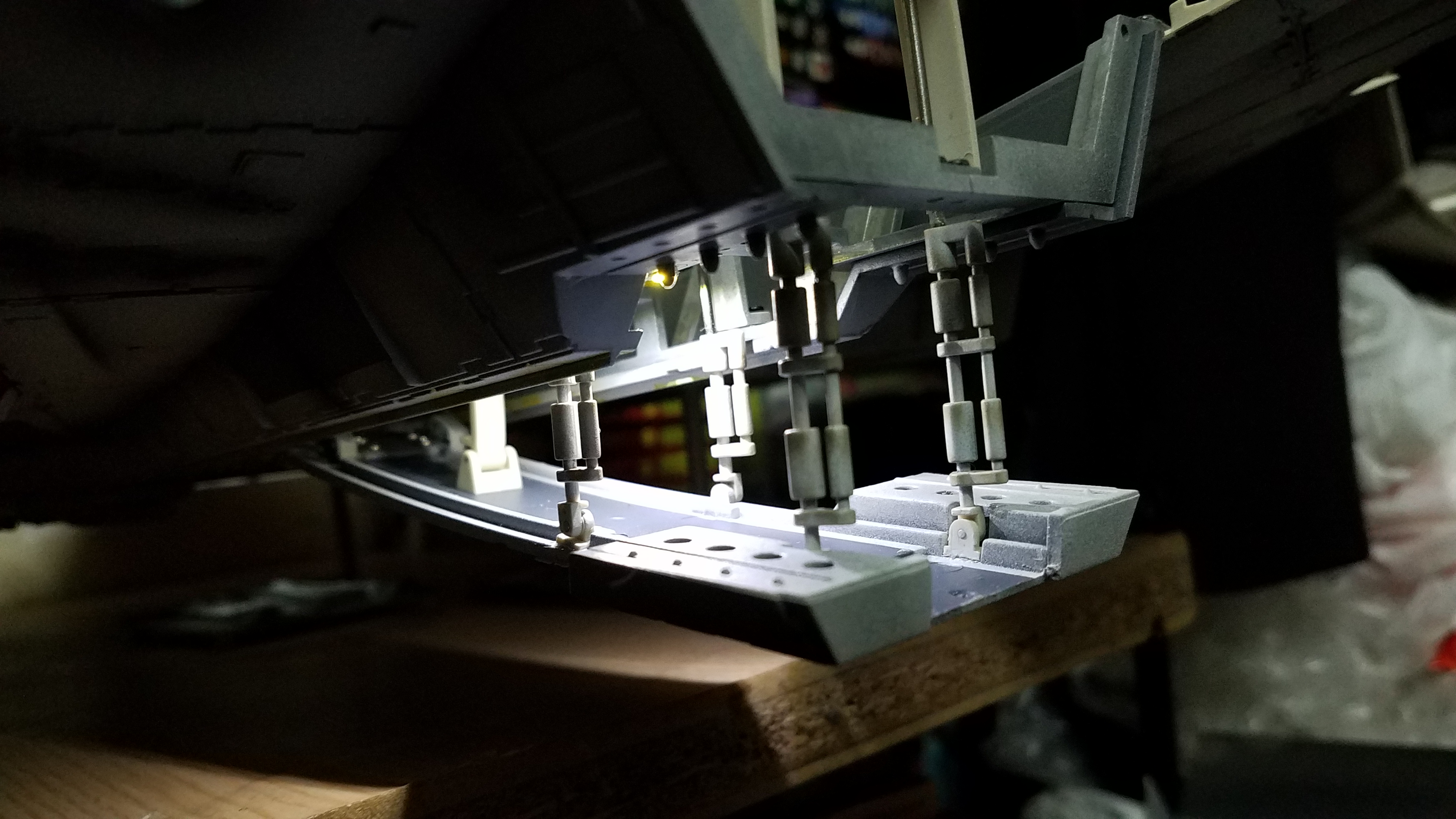

Need some help. I'm wondering if any of you have had a similar problem like mine? Regarding the ramp, I have run a test and it seems to work. However, the ramp bulges slightly when it opens, basically the motor seems to push down a little more than the space the actuators give. The glue seems to hold so far but I'm kind'a worried about something breaking later on.
As you can see above, the ramp is slightly curved where the motor is pushing down. Once extended you can still hear the motor working which produces the curve. All actuators are extended fully, and when it's closed the ramp sits flush against the framework with no gaps.
Any suggestions? Or is this like totally normal?
Are the actuator's range of travel maxing out before the motor stops? Like the actuators stop, but the motor pushes a little further?
Is so, you may be able to play with the switch contacts that stop the motor to get it to stop a tad sooner.
exact.. i fixed mine like that ...
