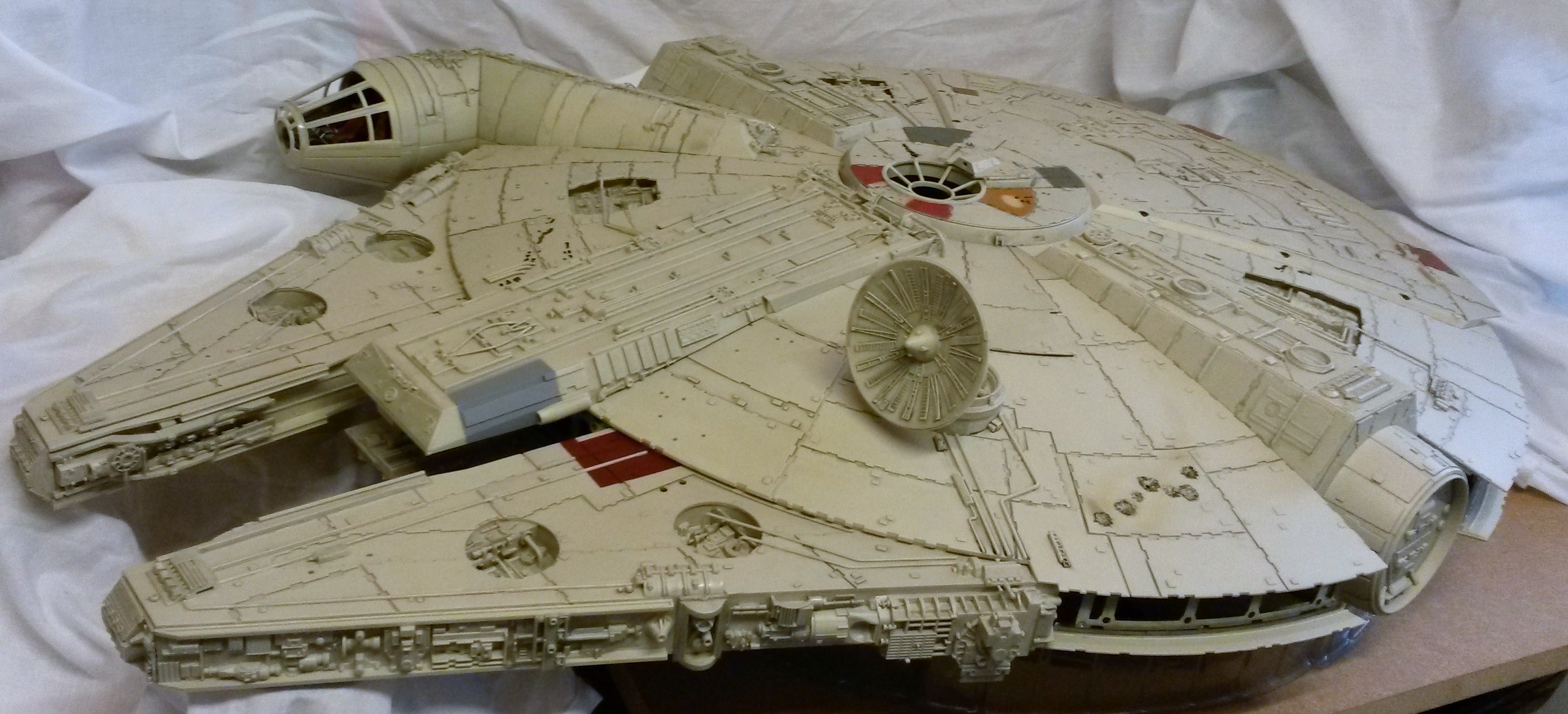

Issue 92, some parts set roughly in place for a quick photo so be kind!:D
