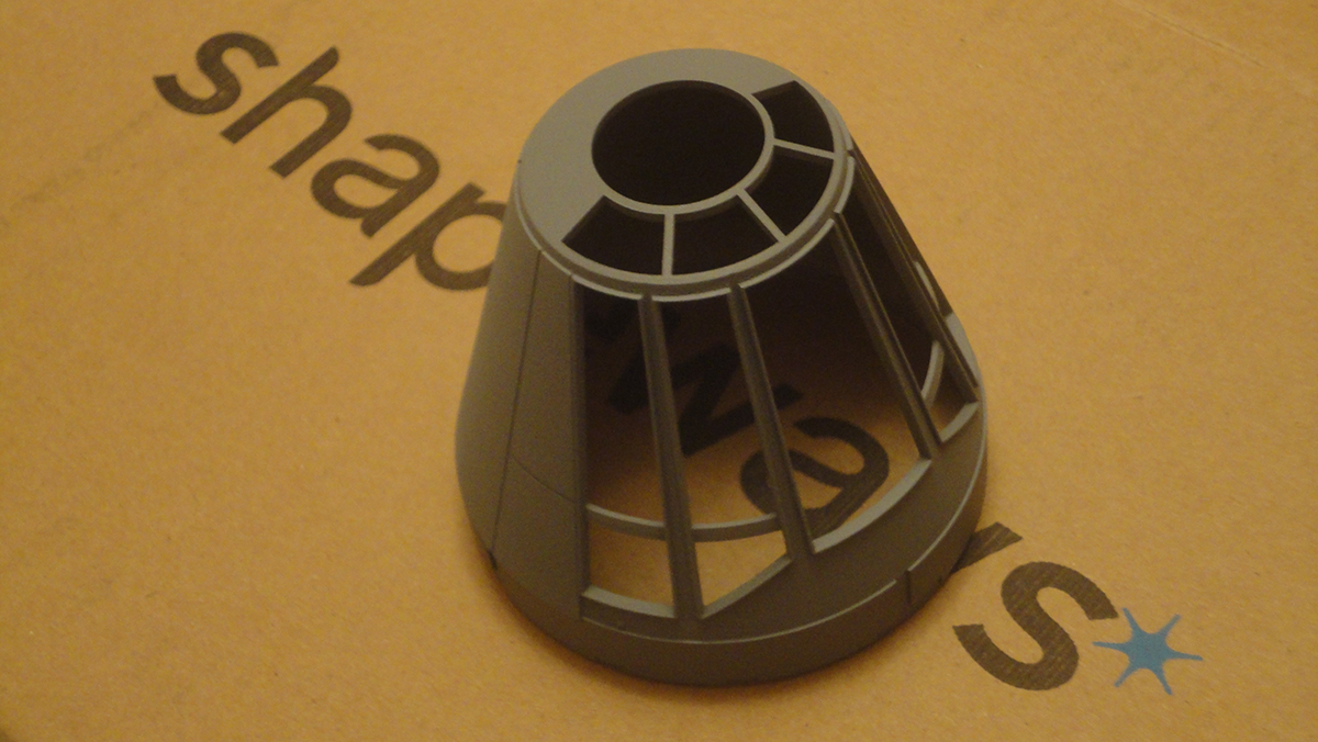

Here's my nose cone (SpaceInScale). This one was painted by a member doing a build diary on 'buildmillenniumfalcon' forum. Member sjw2511.
If you click the link you'll also see pictures of it in primer. Even in the best print material, they sometimes require a little sanding, but i am also getting a test print from another source that prints a lot better and requires practically no finishing, and is also a little cheaper.
Even though i only have the cockpit canopy and turret window on there at the moment, there will be a lot more coming up. I will be making both the inside and the outside. I've been doing the rivet counting and making everything i do as close to the studio filming model as possible. Hope you like.

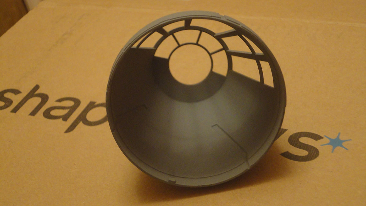

Here as a pic in primer with Deagostini cockpit tunnel, and Deagostini interior. I put the same grooves and notch on the inside, just like the Deagostini model, so it would line up and fit perfectly.
Judging by this photo, it looks like the diameter of the cone is a bit smaller than the diameter of the tunnel.
No. It's exactly the same dimensions as the Deagostini. There is a ring which has a larger diameter that is on the start of the cockpit tunnel, and that has a larger diameter.
I don't have either in my hand, but when I look at the pics, I look at the area BELOW the ring. There is a step there. It's only one side and proves nothing by itself, but it suggests. I'm guessing Gus76 has the wherewithal to notice the ring. Also, the step along the ring seems larger than the gap the ring presents on the tunnel on which it is molded. Since the response by Ebeneezer only addresses the ring, it doesn't fully address the issue.

Ahh, my apologies. I can see what you mean now.
It's the Deagostini cockpit tunnel which is wrong. The reason the diameter is larger in that area below the ring, is because they added the 0.5mm hull plating/armor in that area. On the filming model it had none in that area. I'm just copying the filming model as closely as i can. If Deagostini had not put the extra 0.5mm hull plating/armor in that area, they would be exactly the same diameter.
I just tried the Deagostini nose back on there, and it is also the same. Slightly smaller diameter.

Just a note about the longevity of liquid resin SLA 3D printed parts such as those made by Shapeways... In time they may warp, shrink, get brittle or have other issues. The process is really intended for prototyping and pattern making, not for final parts. After a couple of years you may start to see some problems, the larger the part, the more likely. To really create a part that will last as long as the rest of the model it's best to make a mold from the 3D printed part and cast it in a nice stable resin.
I have a new test print which i am cleaning up shortly, none Shapeways related. It is resin, and also almost layerless. A lot better than Shapeways best.
I will be casting this at some point and offering that a lot cheaper. Same with all the other CAD's i've done. Should be great to get these in resin finally.

I'm not trying to slam anyone's work, because I have shapeways parts myself, but there is something a little off about that cockpit cone compared to the 32" that I can't quite put my finger on after looking at the photos. Comparing photos I actually think the overall shape of the DeAgostini looks closer to the original filming model. IMO
I know what you mean... I see it too... the printed cone is more accurate to the 5' footer. However, something I have noticed is that they made the ESB cockpit longer then the ANH cockpit by about a foot.
