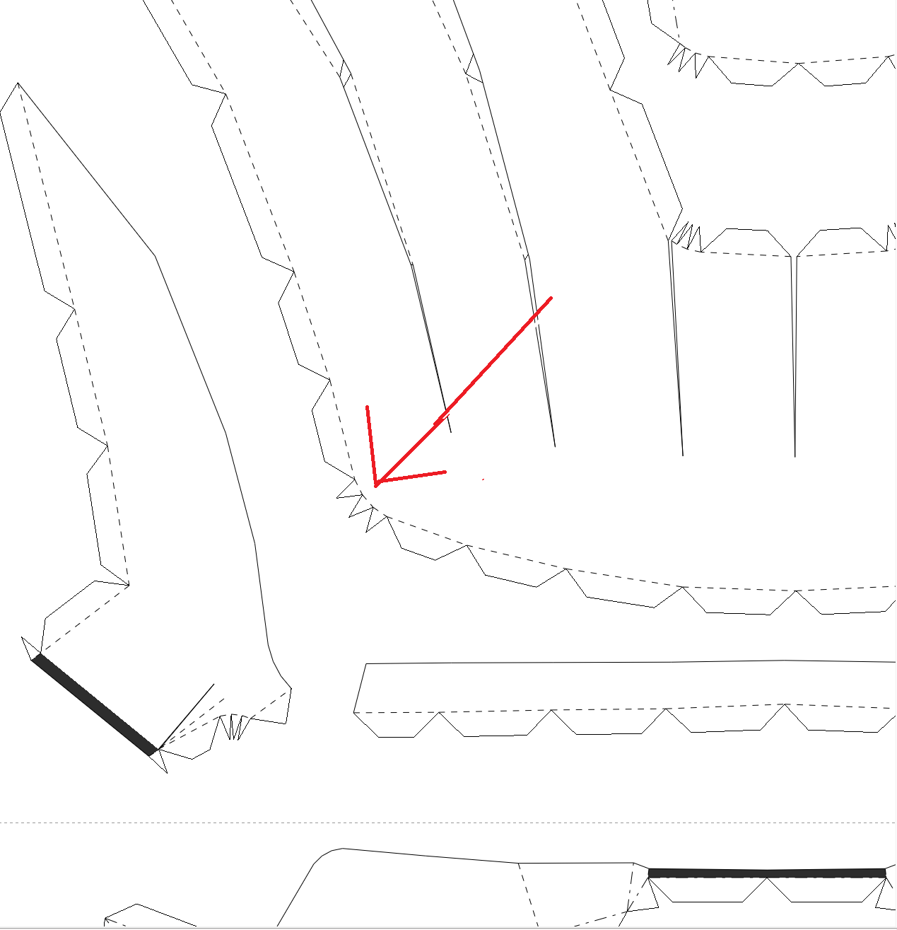

The "teeth" on the sides of the helmet with the thick black lines, how are we supposed to cut those pieces?

Howdy, sorry if this has been asked before,
that is done after the bondo stage, with a dremle tool or a needlefile.
I was thinking that you could use the printout as a pattern to scrap built the teeth. It would be way easier to cut out the shapes and glue them on a solid backing then to pep all the trenches, bondo, and sand them all out.

Sorry for uploading a picture, but how are we supposed to glue these little triangle pieces
sorry if this is a silly question im a noob
They get glued exactly the same as any larger tab - they're just smaller.

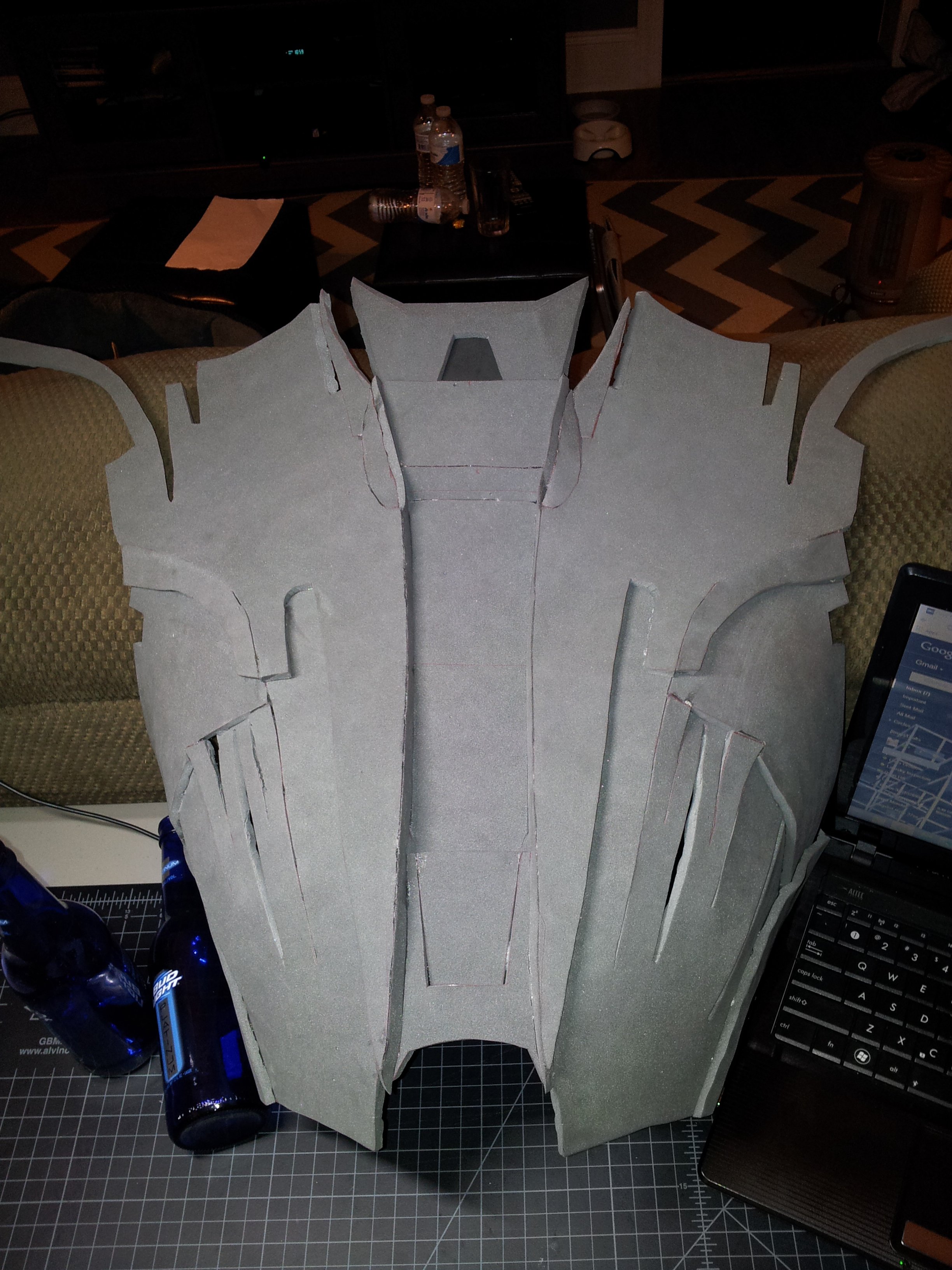

Current status of back. Yes those are Bud Light Platinum bottles holding up the left side. Dont judge. Thanks OP and foamers.
