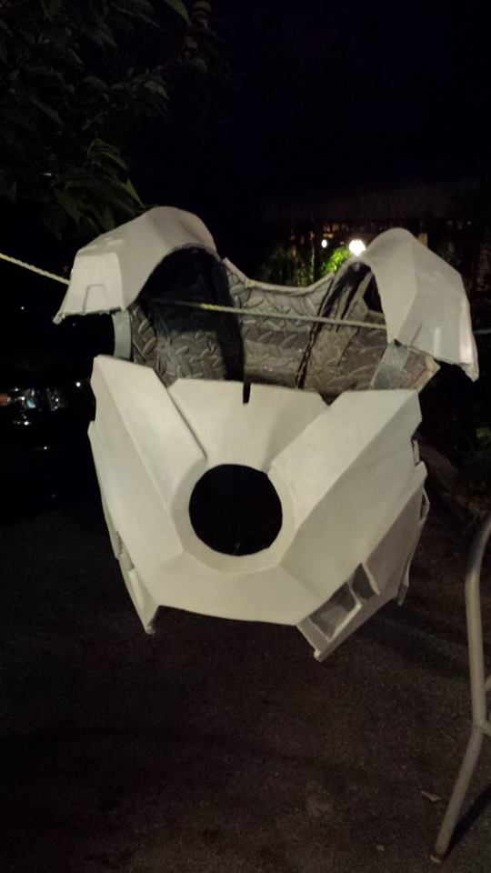

Just finish putting primer on my chest. For the chest I used 50/50 rondo: 1380422_10102140930080808_1211987739_n.jpg

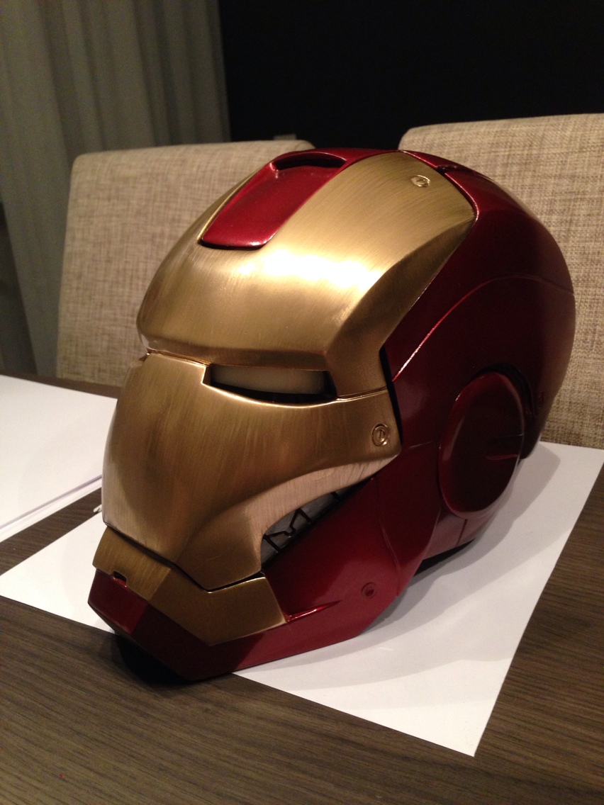

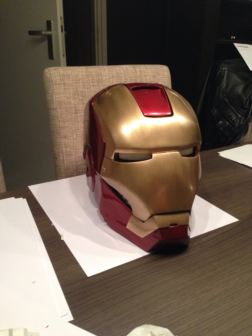

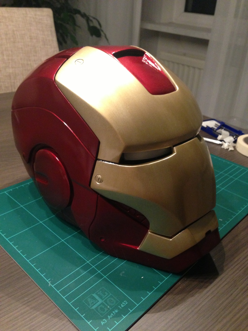

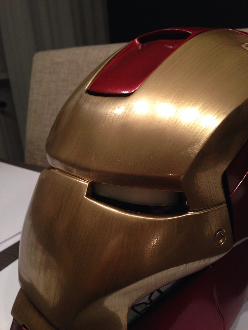

I am working in highspuit on my Mark VII suit at the moment. Upper body that is.
But i also decided after seeing some reference pictures of the real screen used pictures that i wasn't completly happy with my paintjob of the helmet.
So i decided to respray the faceplate to give it a real brushed gold effect like in the movie.
The outcome really made my day. :D:ninja
Before Pic:
After Pics:
Let me know what you guys think.
I bought a chrome-gold spraycan. Wich gives you a really nice shiny gold finish.
Once that has dryed for about 3 or 4 days. I used a sanding sponge and gently start making scratches. Some edges applying more pressure.
Its quite easy but i think the result is about the best it gets.

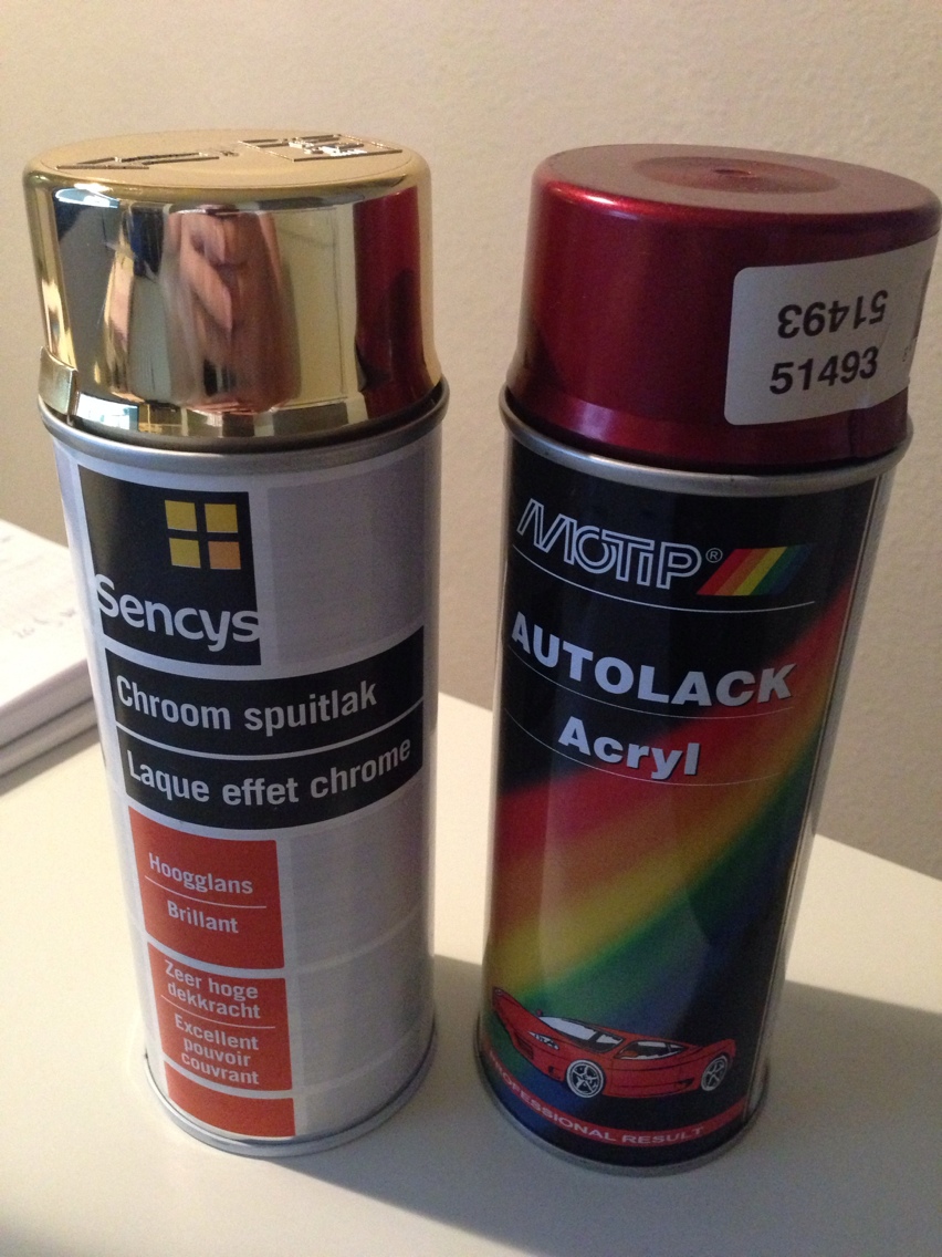

Sir you are a genius :D Can I ask you if you remember the RAL of the gold spraycan?
I dont have a RAL color for you.
The red i use for the top layer is manufactured by Motip. The color number is 51493. I google it and it should be ALFA ROMEO RED 132 or ACURA R-505P.
I also used a darker cherry-ish red as a base for the edges. The bright red is for highlihjting.
The Gold is from a manufacture for Interior design Paint. So its not really for outdoor use. The advantage however is that it will create an natural worn look when the suit is worn more often.
Heres a picture of the spray cans.
I wouldn't have imagined that the chrome paint would be so...well...not so reflective. Good to know as I can find this manufacturer in Belgium.
