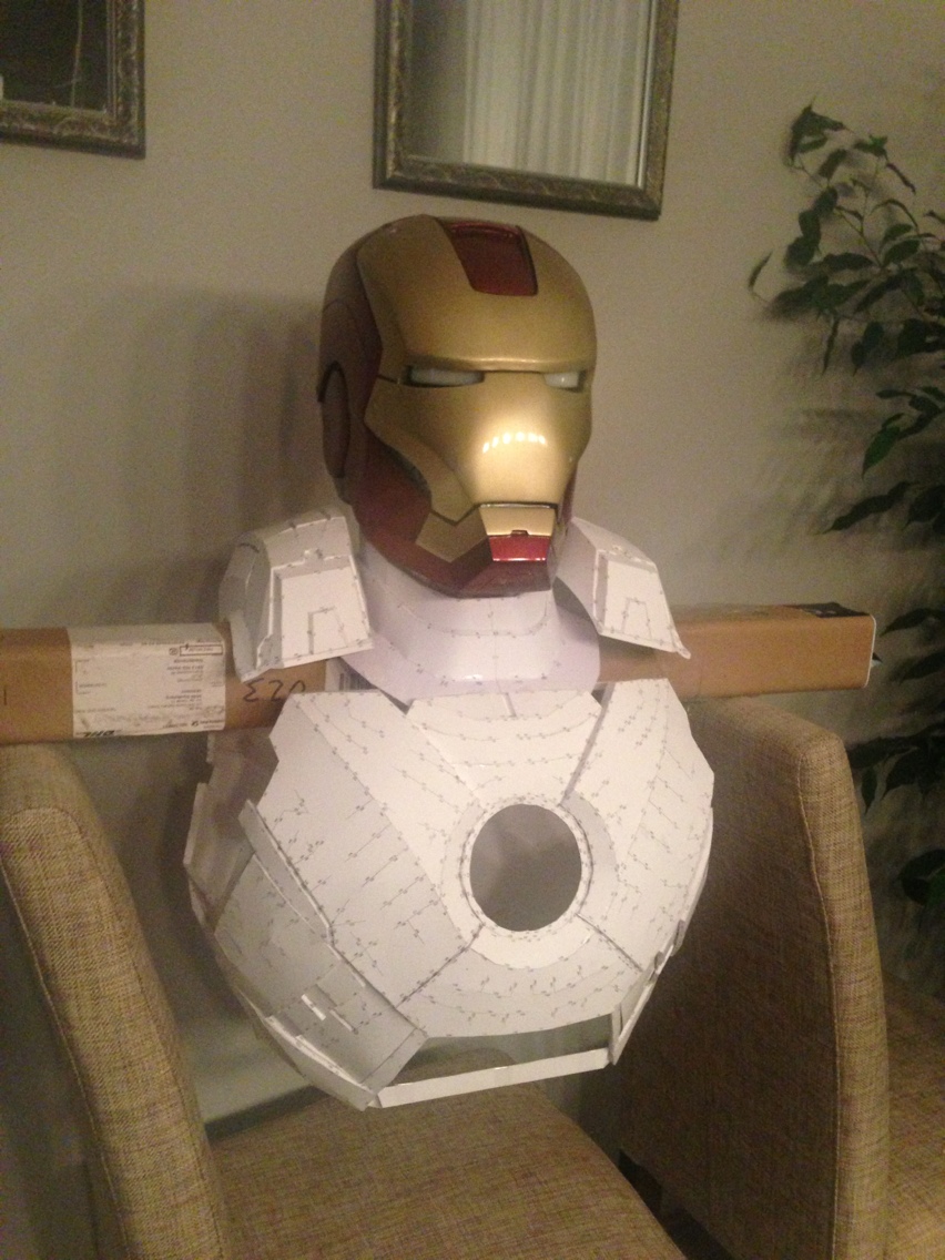

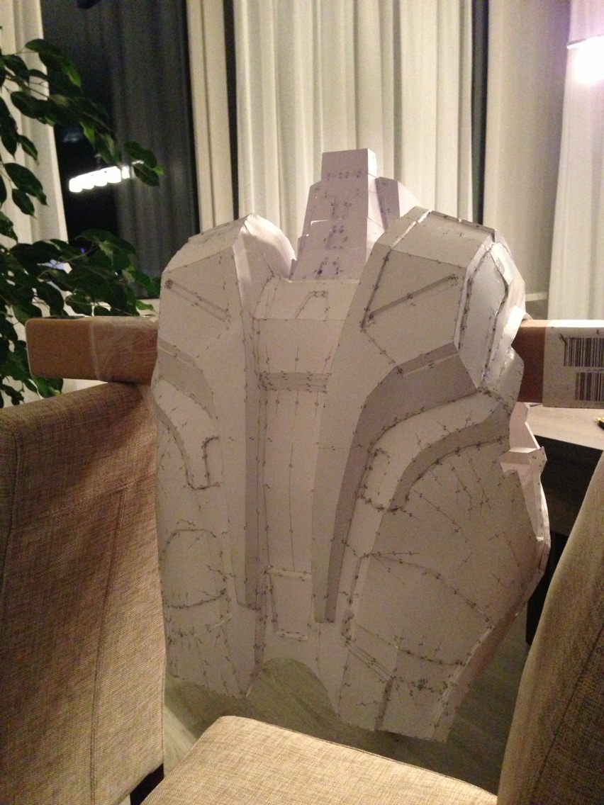

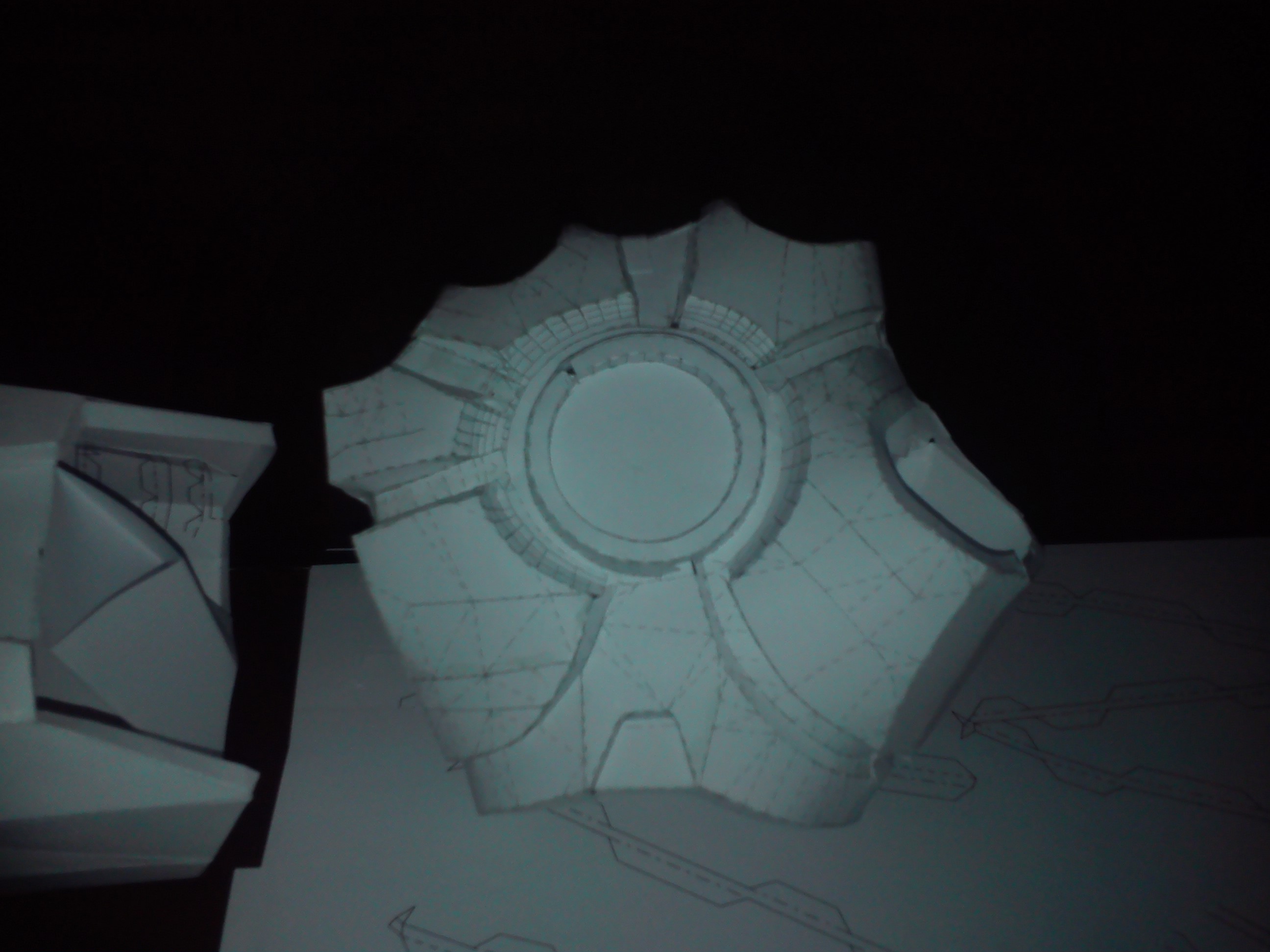

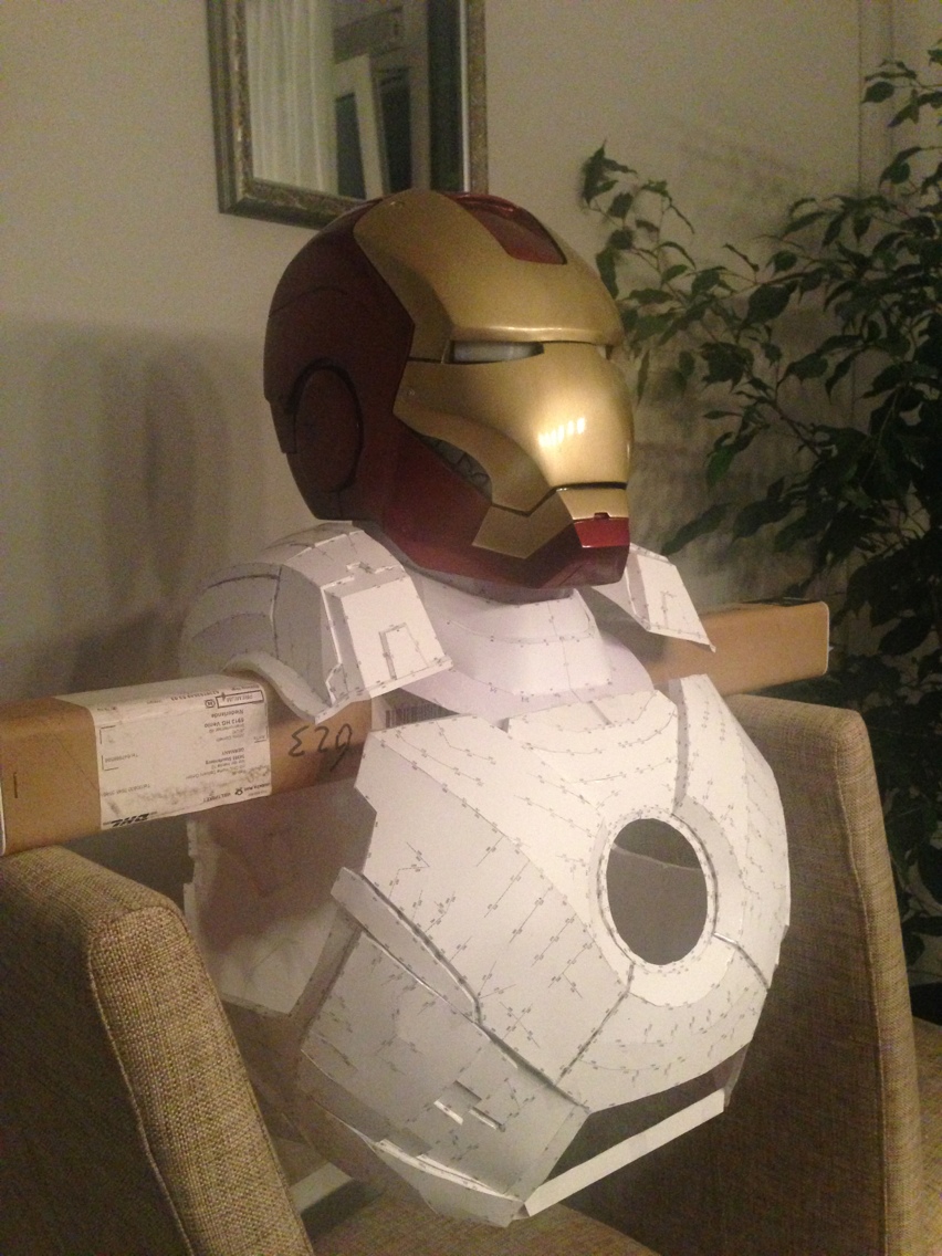

Here's a quick update on my progress. Finished pepping 2 of the most difficult parts. Back and chest.
What do you guys think? Start resin it so that it is form solid? or finish pepping the rest first?
Looks great. If you have a safe place to put them then you can continue pepping. If not, I would definitely at least coat with resin... you can fiberglass later. Of course, it doesn't hurt to resin/fiberglass it now even if you have a safe place to put it.

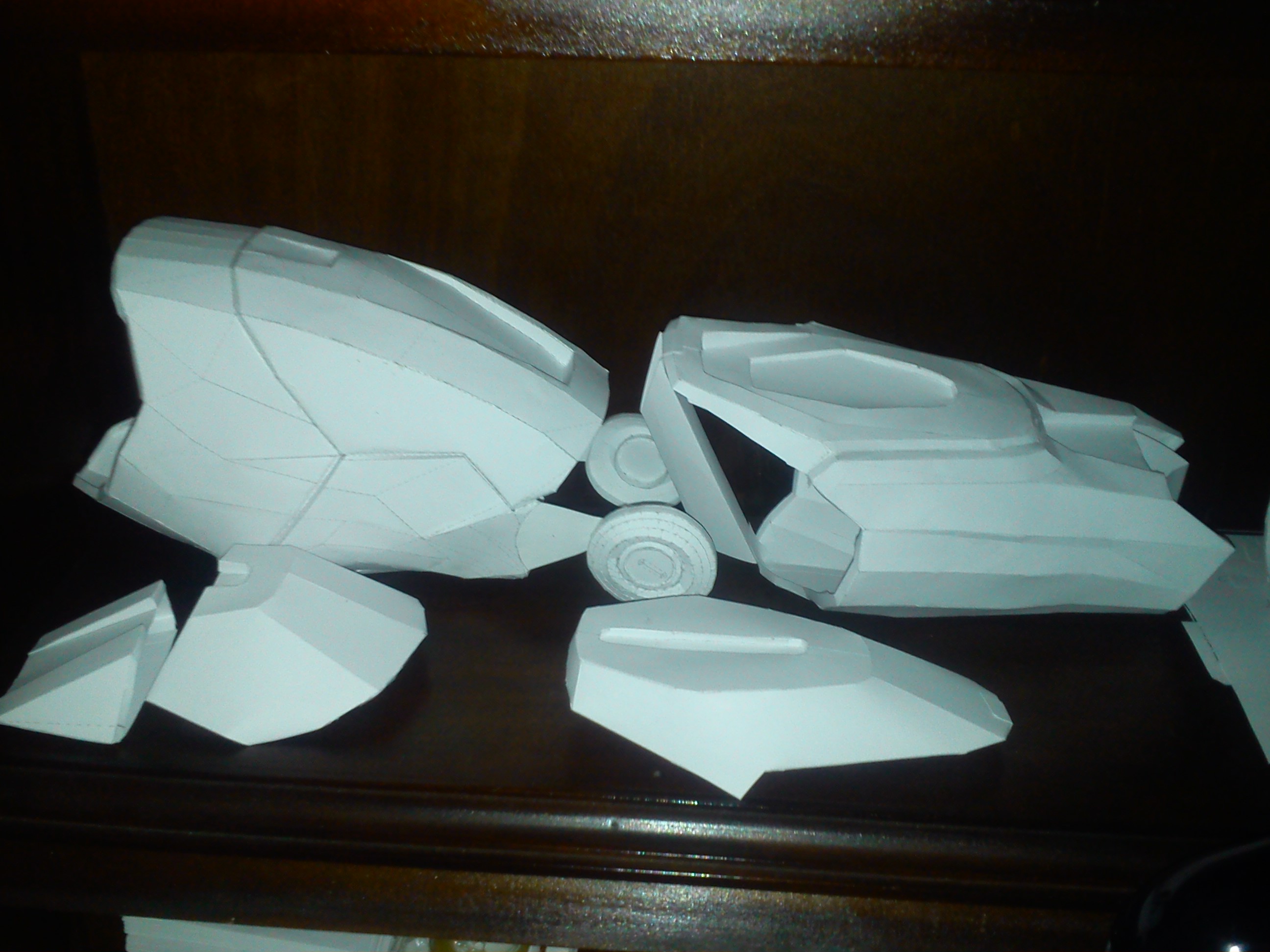

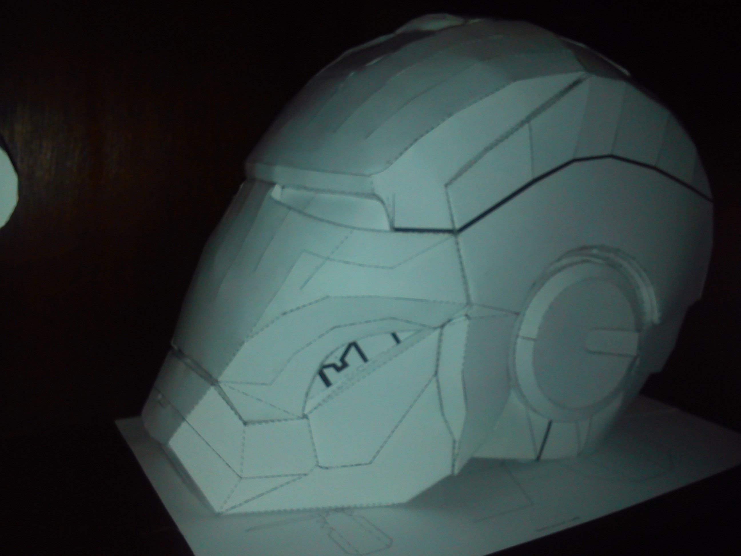

Here is my progress, it's not perfect but i like the result. :D
By the way, I have a problem. I wanted to start the fiberglass process and I've seen some videos on youtube to help me out, but I don't understand a couple of things: when they say resin, isn't it fiberglass resin or other type of resin? And what type of fiberglass should it be? Because the only fiberglass i could find is some sort of solid paste.
You didnt use the edge IDs???? it must haven been a disaster to pep without, no?
Are you kidding me?! I love the results of your work too! *PERFECT*
To your second question, fibreglass resin. You can use EpoxAmite too!
well, with the pepakura viewer opened, it wasn't too hard.

thank you! :D and i will try to find the resin then, thanks once again!

Sometimes, it's even easier without edge ID. The fold lines are easier to see.
I see you used Omarbou's files for the arm.
Re: Darkside501st's Iron Man Mk VII pepakura files - V2 Biceps Done pg 130!
true story.
yeah, i was thinking about after building darkside's forearm, cutting the pod, but then i saw omarbou's files, and i ended up using his lower forearm and handplate.
Looks great so far. You can also use urethane resin. If you are going to use fiberglass then you should use fiberglass cloth. Fiberglass mat is too rigid.
I rarely use the edge IDs anymore. Sometimes I still do on larger parts. I prefer to work with the 3D model using the program so that I can see the shape of all the parts before I put it together. It helps me to build them in an order that makes the most sense instead of just slapping it together and making the numbers match.
