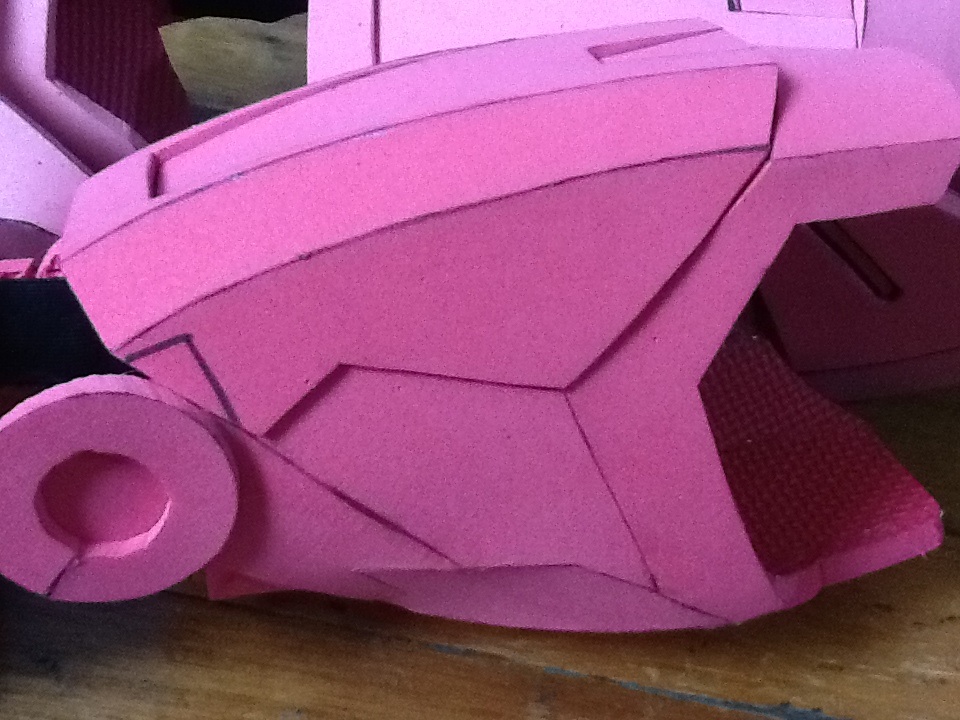

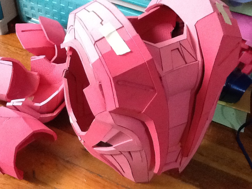

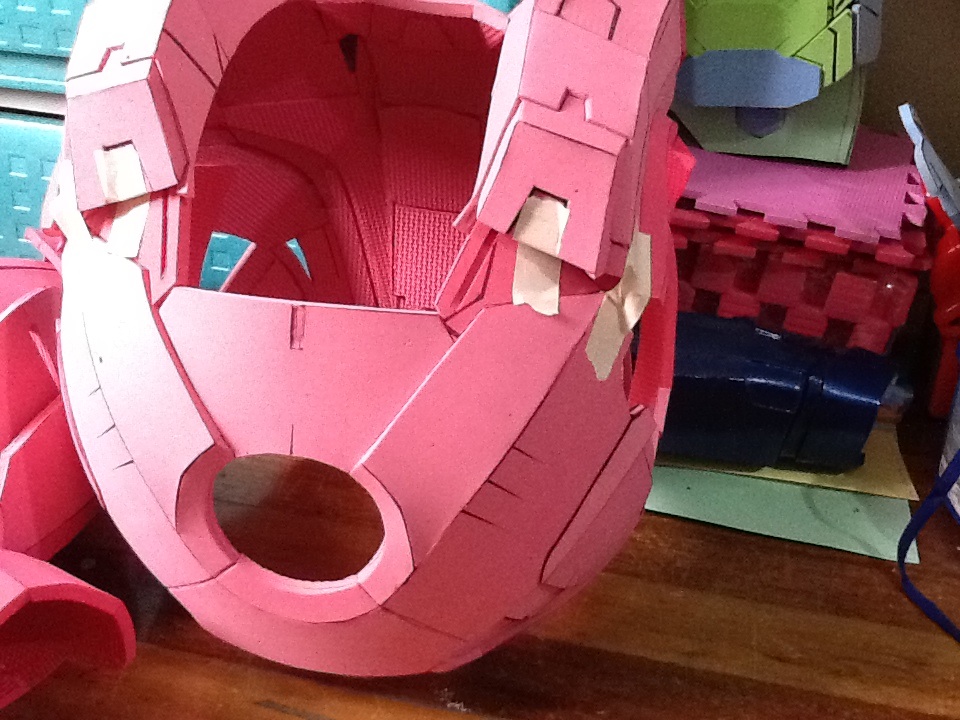

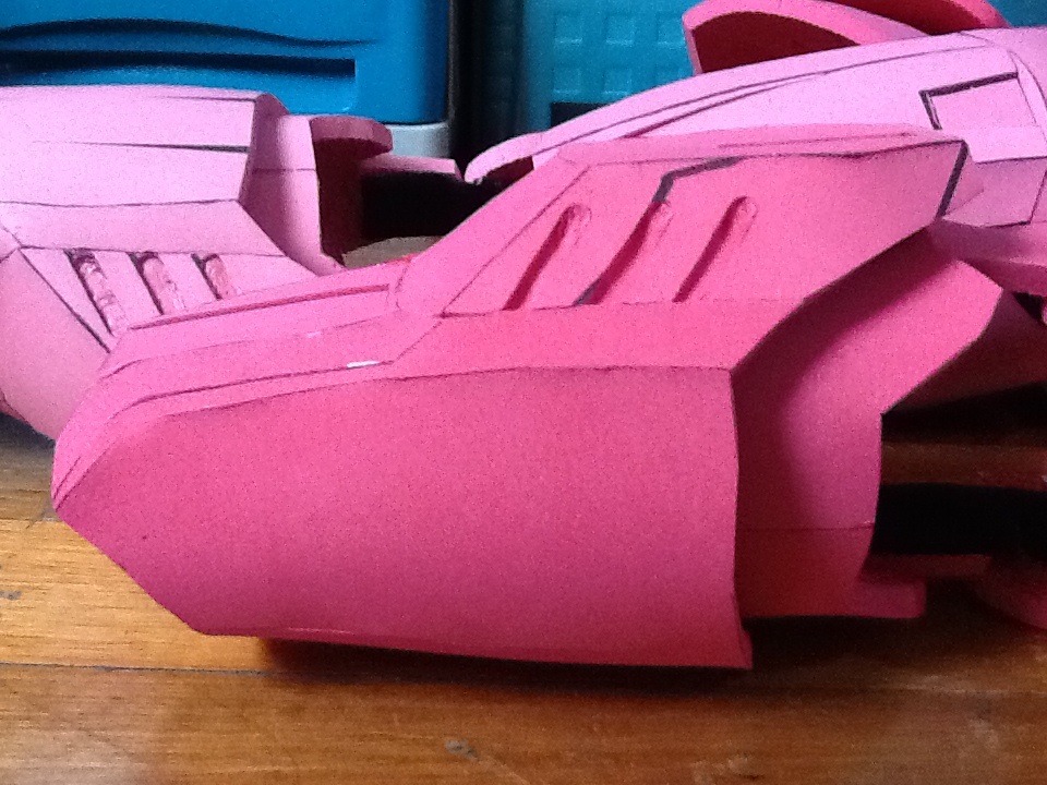

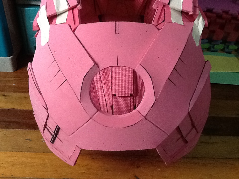

Ey, just wanted to post a few progress pics. Been working on this for a whole week now.I'm 5,6", 150lbs, sorta well built, i'm using 23scale for everything, and so far everything fits ok.But i'm working on the shins now and they seem to be a little short, i guess i'll make a new one. But was just wondering if all of the files were made to fit each other by default, like proportioned to each other at 23? I know you have to measure for parts as we all have different physiques, just wanted to know if certain parts are scaled smaller than some.image.jpgimage.jpg

Ey, just wanted to post a few progress pics. Been working on this for a whole week now.I'm 5,6", 150lbs, sorta well built, i'm using 23scale for everything, and so far everything fits ok.But i'm working on the shins now and they seem to be a little short, i guess i'll make a new one. But was just wondering if all of the files were made to fit each other by default, like proportioned to each other at 23? I know you have to measure for parts as we all have different physiques, just wanted to know if certain parts are scaled smaller than some.View attachment 218928View attachment 218929
Hey, you're the same build as me. :)
Yeah, all the parts are made to fit together but proportions might be a little off.
