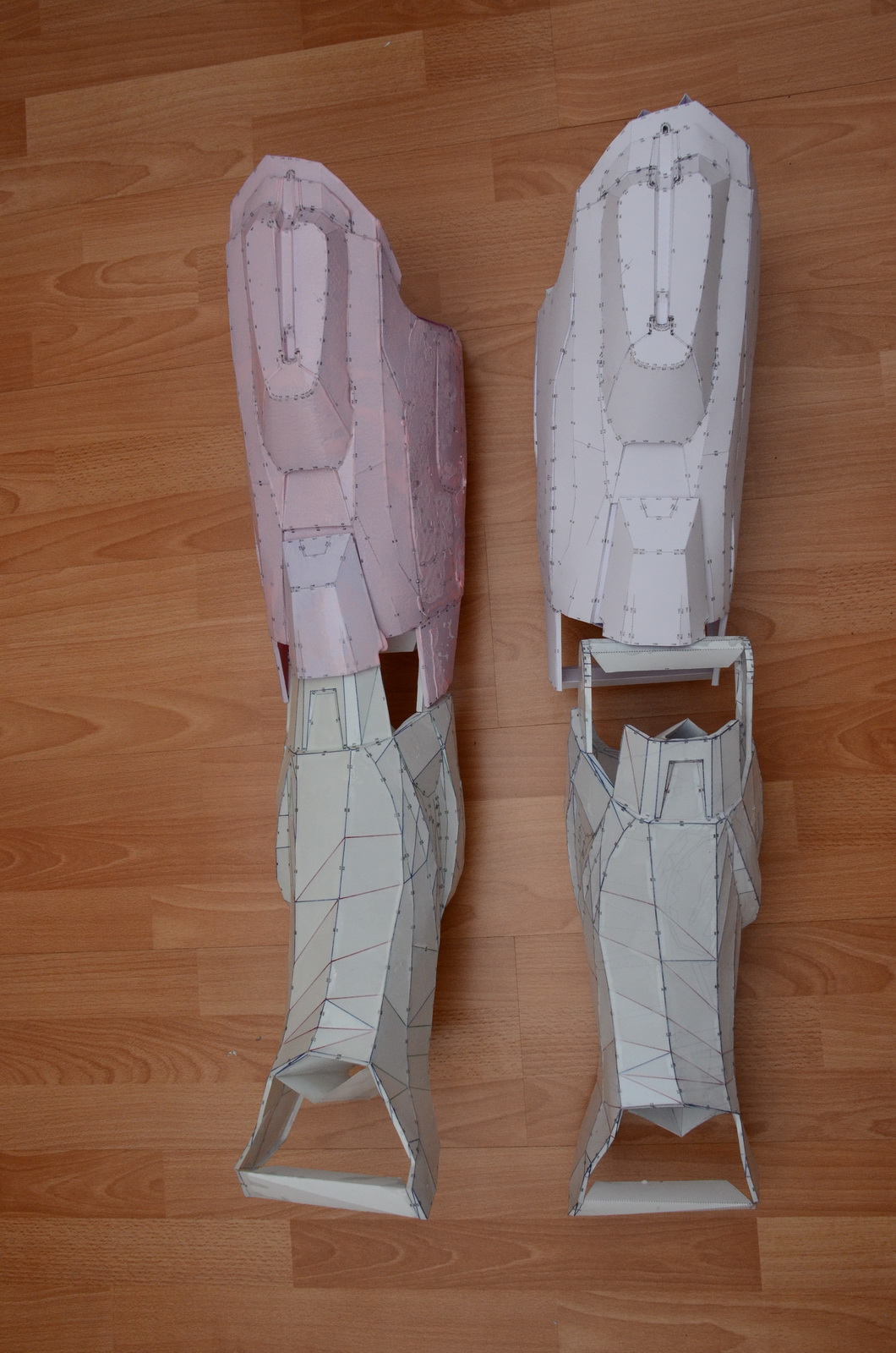

And so, the pepakura's journey is ending!
Should I glue the knee cap in pep stage or resin stage? Or maybe later in bondo stage to adjust it perfectly?
The knee cap should be floating but if you would rather attach it to something then it should be attached to the thigh.

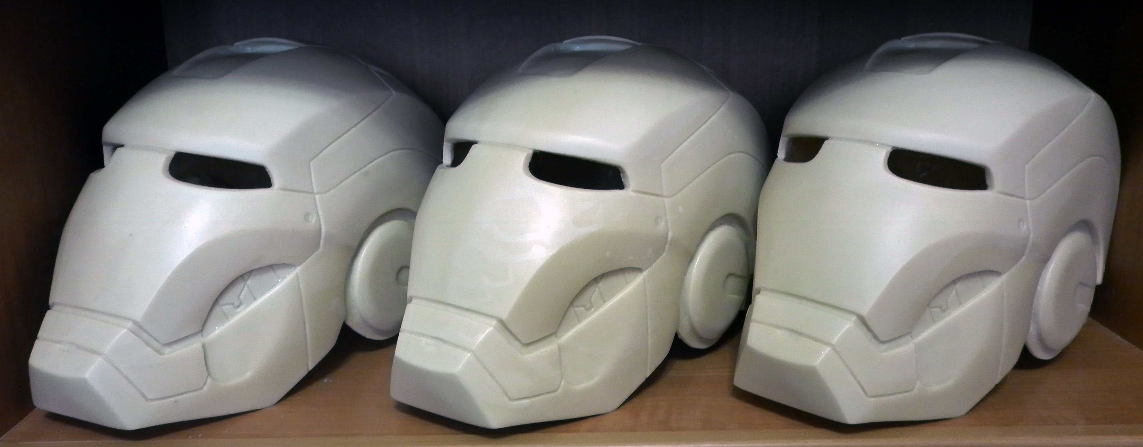

"childrens" of my helmet
Re: Darkside501st's Iron Man Mk VII pepakura files - V2 Biceps Done pg 130!
Looks nice! You gonna send me one ;)
They are yet ready. I want to add here servo-drivers.
And here one section behind is cut out. It is necessary to restore it and to make fixture on magnets.

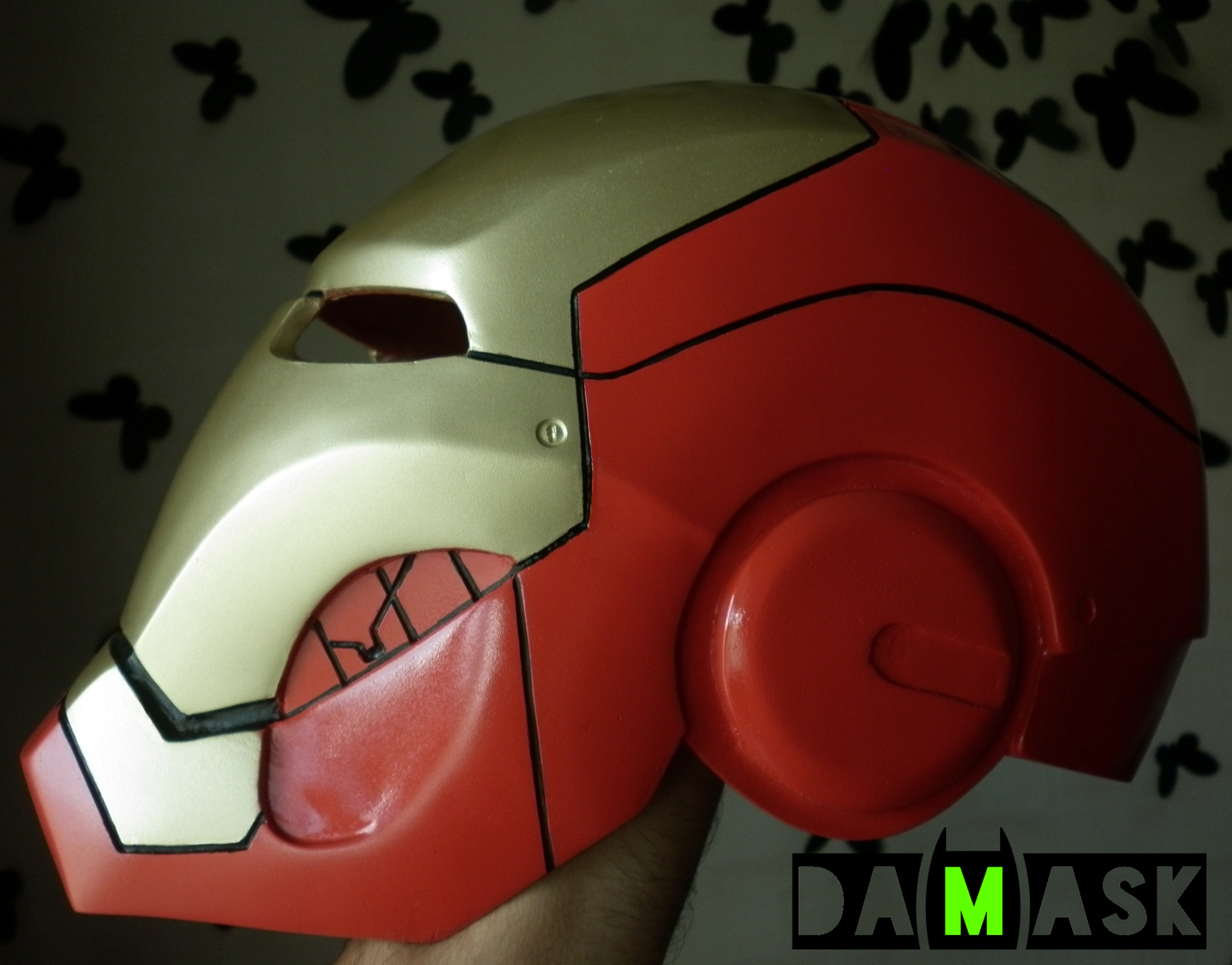

The painted helmet. Now I do internal finishing and eyes.
