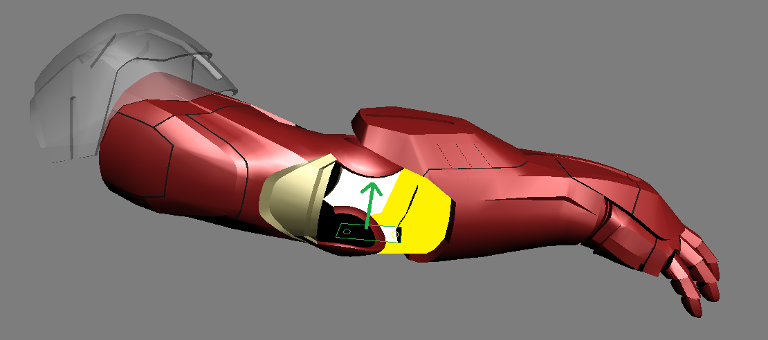

so u looks like facing problem with elbov joint.i made mine like this and it have only one pivot point. mobility was good enought as i expected. i've made some changes to upper forearm. how about this litle trick ?? mike ?
That is how most suits do it but the main problem with the Mk VII is that, to be 100% accurate, the circular part of the biceps is curved and this means that a straight 'fin' or 'arm' from the upper forearm will be hitting the curved circular part of the biceps. I could make this curved circular part of the biceps flat but then it will not be 100% accurate. That is what I would do if I could not come up with any other solution.

i totally agree !
this part was really hard to model for me too and i decided to go ahead and do the upper forearm to joint in the middle of the bicep joint but it is still possible to make a 2 pivot points joint !

how about if we make it with 2 pivot points ? if you give me side prespective image of bicep, elbow and upper forearm (isolated) . and side and front prespective of lower forearm. i'm gonna grab my sector and draw something that could help all of us

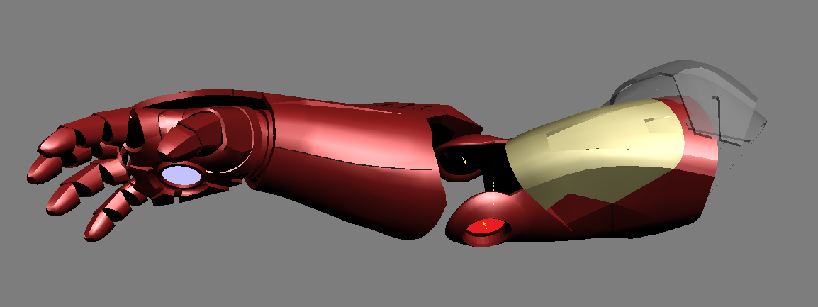

Well, I finished up the biceps today and I have some more pictures to show you all. Take a look:
[url]https://blufiles.storage.live.com/y2pK855QADaFPr6tDja-luTsa-dRWYBMbyPYsRMSQjaNwciPEir4HU1fAacBraMOchyVibetoTZ3Do7S5ljSe30SQ/Mk%20VII%20Arm%20-%201.png.jpg?psid=1[/url]
So I have always been a little stumped by the elbow joint. The curved circles that are part of the biceps wrap around the arm slightly and the upper forearm butts up against the bottom of them. It doesn't really make sense for a single pivot point in the middle of the joint. It seems more like the upper forearm slides over the circumference of the circle. However, that would make building the suit very difficult. The problem is if we just put a single pivot point then the fin that comes off the upper forearm will be hitting the front and the back of the circle and this will limit mobility. So I am asking if anyone out there has any good ideas for how to make this elbow joint.
I see what you mean. What about attaching a gold piece to the elbow joint on the bicep that slid over the gold forearm piece and underneath the forearm missile pod? I think the outer elbow wouldn't be a problem as it would be hidden by the elbow "pad". My other idea features something that would compress as the forearm bends up, either some foam with low density so it can compress or a plate that slides into the forearm kind of like a prop knife where the tip slides into the handle of the knife when under pressure and then pops back out on a spring when tension is relieved. Some ideas that will hopefully get others forming anyway. :)
hey Mike
do you have an idea how tightly the joint aria will fit an actual arm? my idea is that you could extend some of the joint aria inward just enough to let a tab from the upper forearm pass by the curved circles Mk VII Arm - 2 Idea.png hope that helps

Yes, this is the option that I thought of and what I am leaning towards, however, I am thinking that there wouldn't be quite enough room for the elbow once I do this. I might have to make the circles less curved in order to achieve a working elbow joint. Let me put a human arm in there are see what it looks like.

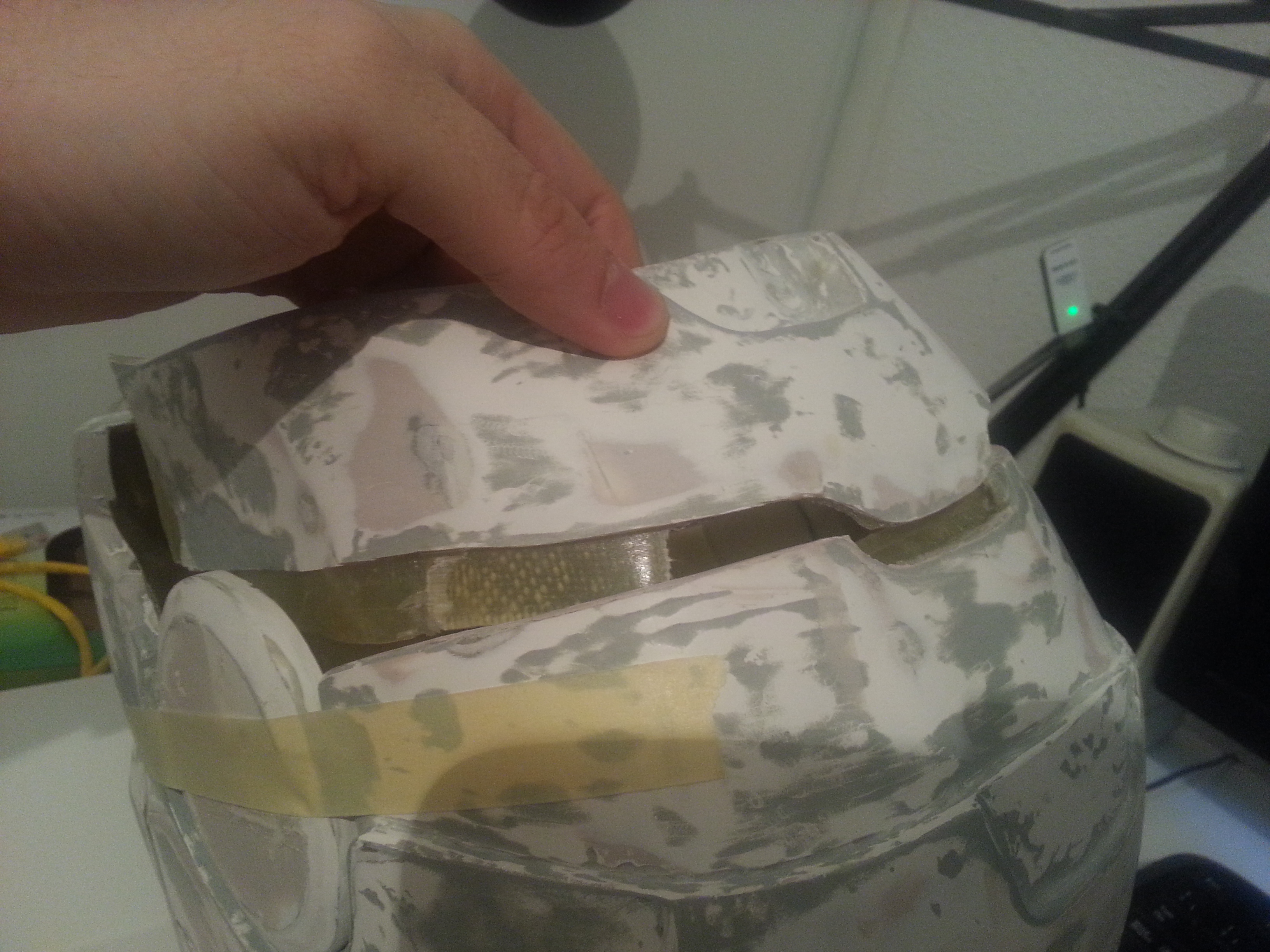

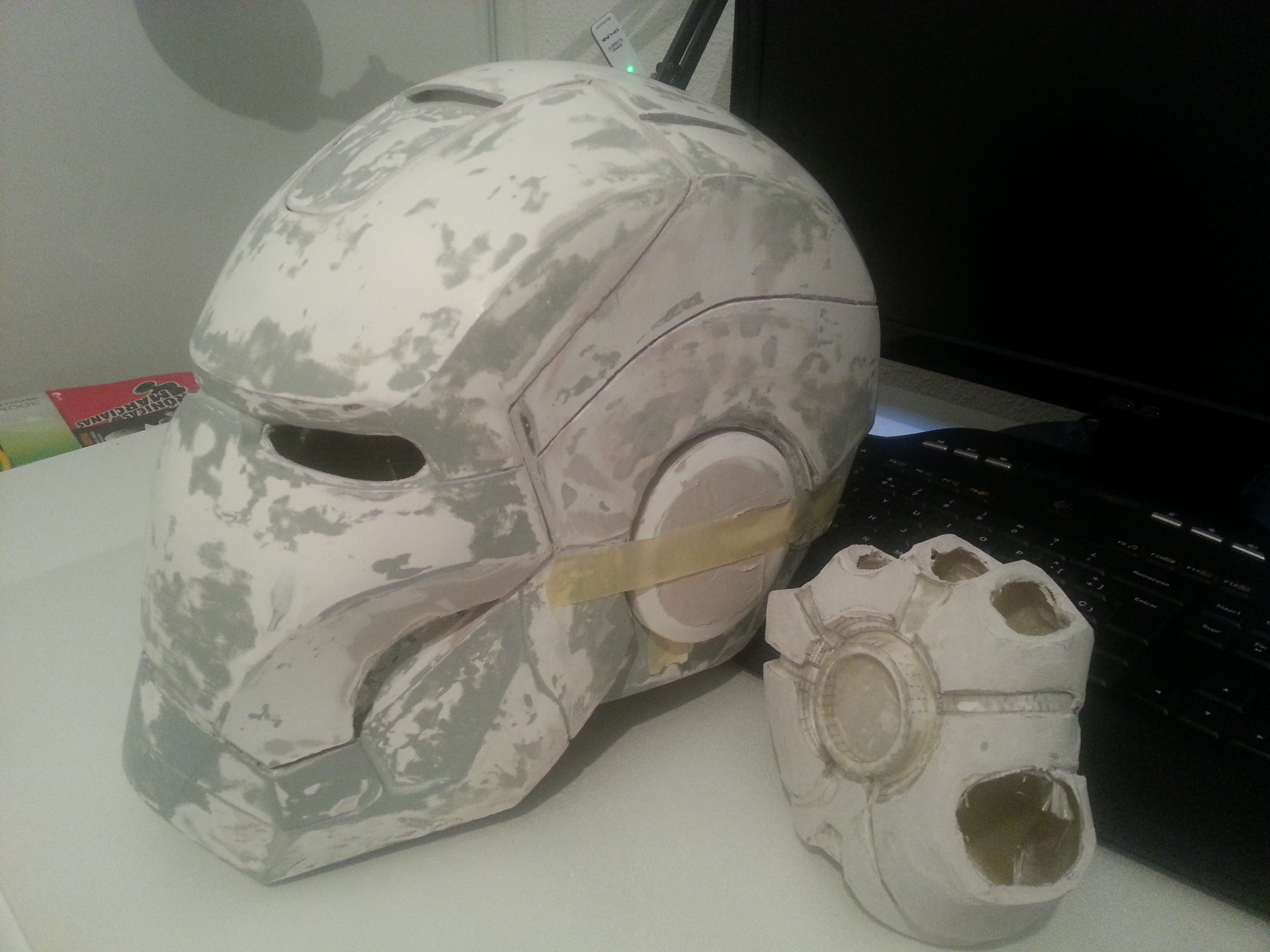

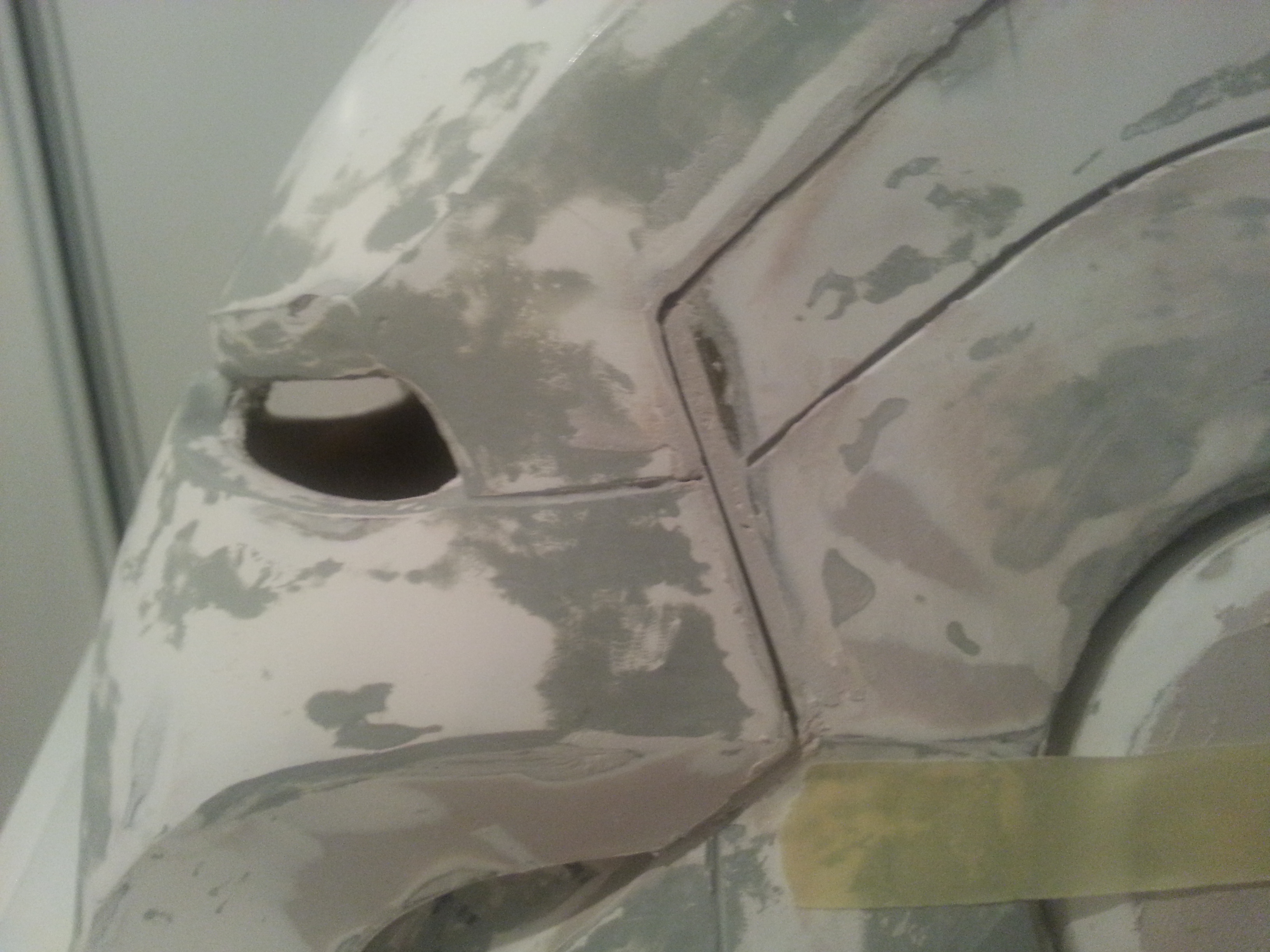

I haven't done much to my helmet in the past few weeks, but I would like to share some of the progress I have made.
This is how the helmet looks right know, along with the right hand:
Since last time, I have cut the eyes and worked on how all the pieces fit together, filling the gaps, shanding all cuts flat and making some support flaps so the pieces doesn't fall easily.

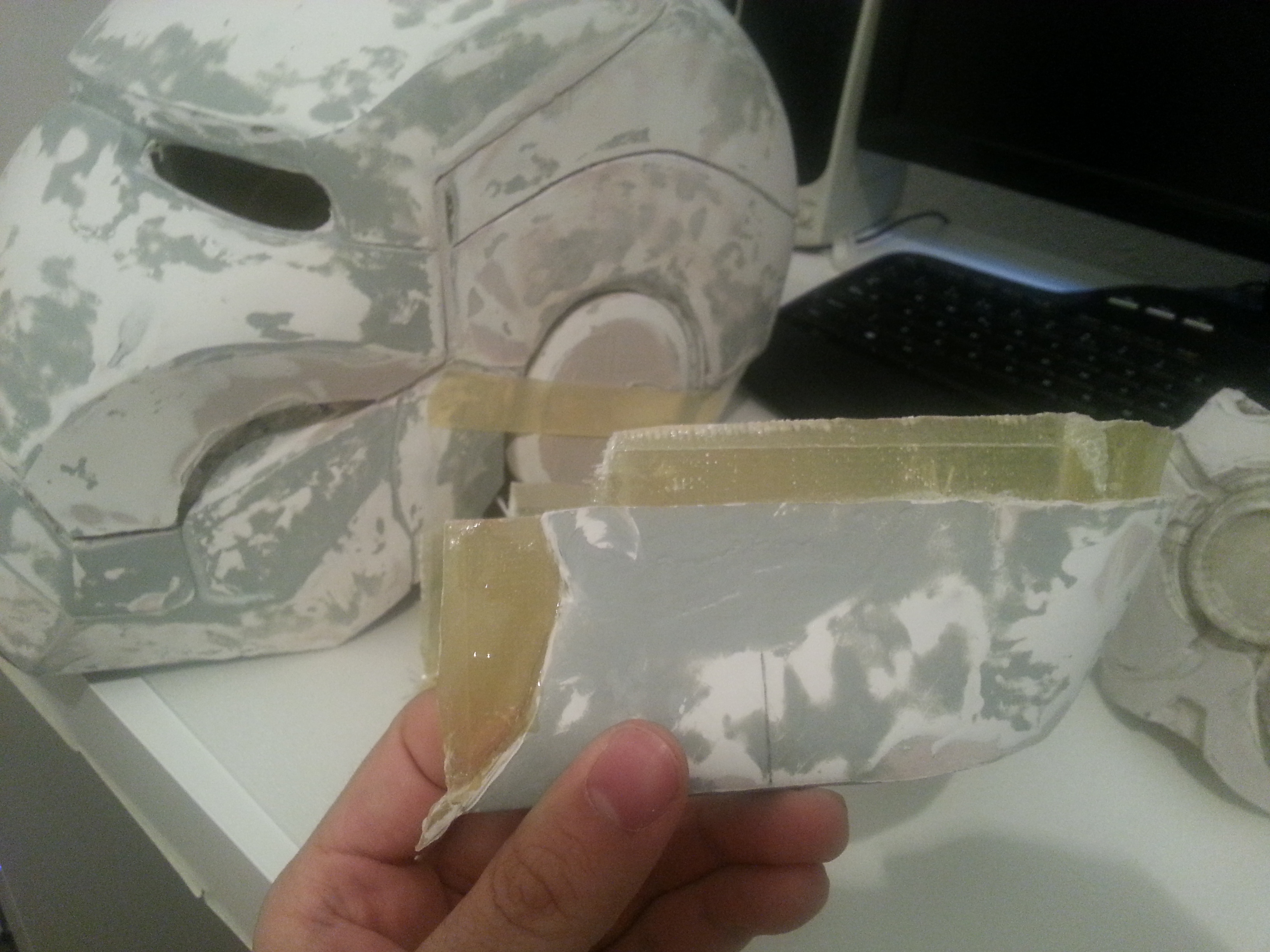

Here it's the fitting of the faceplate with the helmet, I still have to work more, but it's much better now:
Here you can see that I have put extra material in the lip and arround the theeth. This way the faceplate fits perfectly and stays in place. I will have to put filler over that fiberglass, figure out how to mark the theeth and cut the excess. I had to add these bigger flaps because after cutting the faceplate there was a lot of space between it and the theeth:

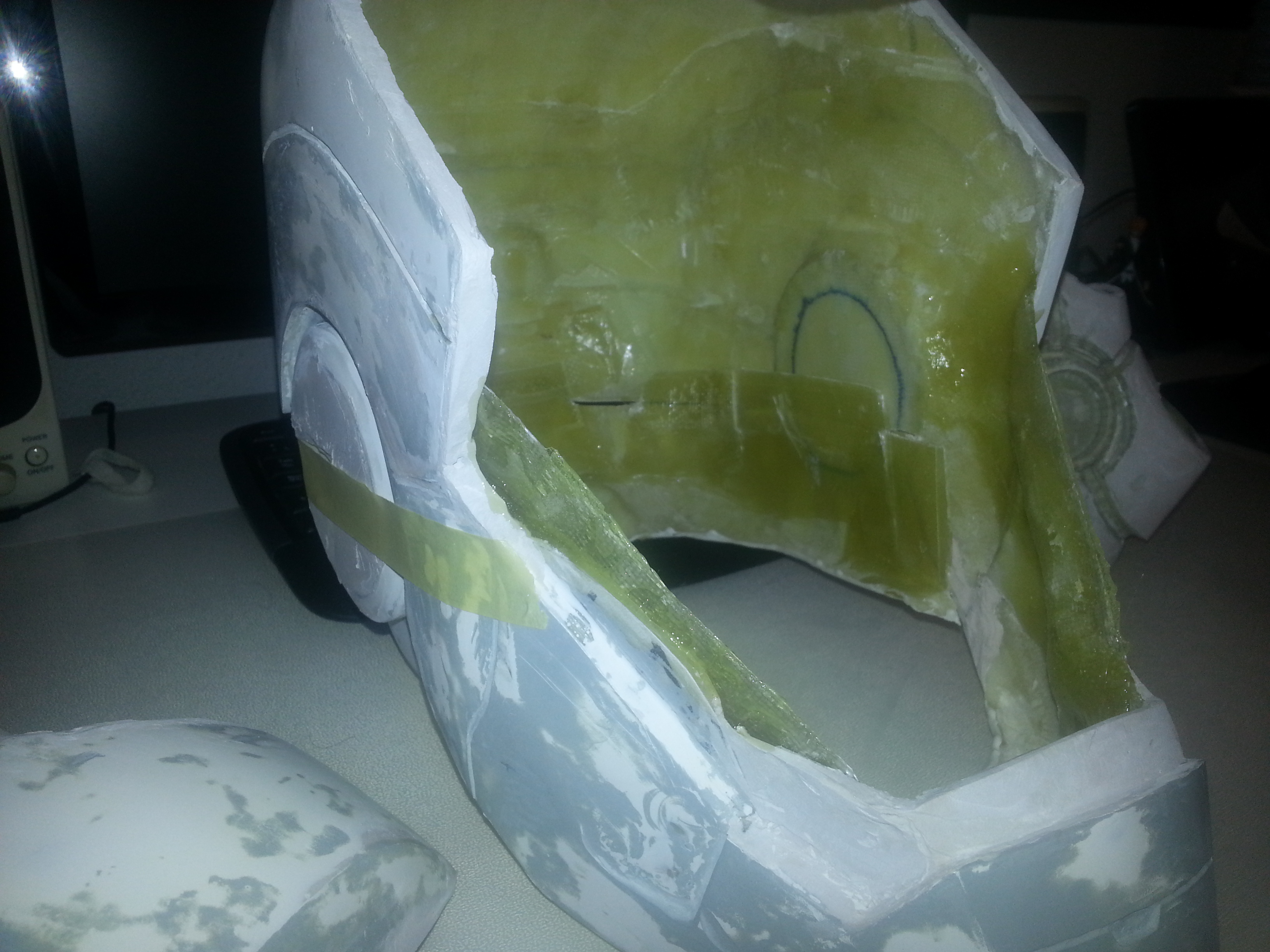

Also I'm trying to make it easier to attach the lower part of the helmet, I'm putting some flaps so it can overlap with the inside of the helmet, I still have to think if I'm goint to attach some magnets or any other to secure it:
This is the way it will attach, right now the piece stays in place, but it's not very secure and can fall if you force it:

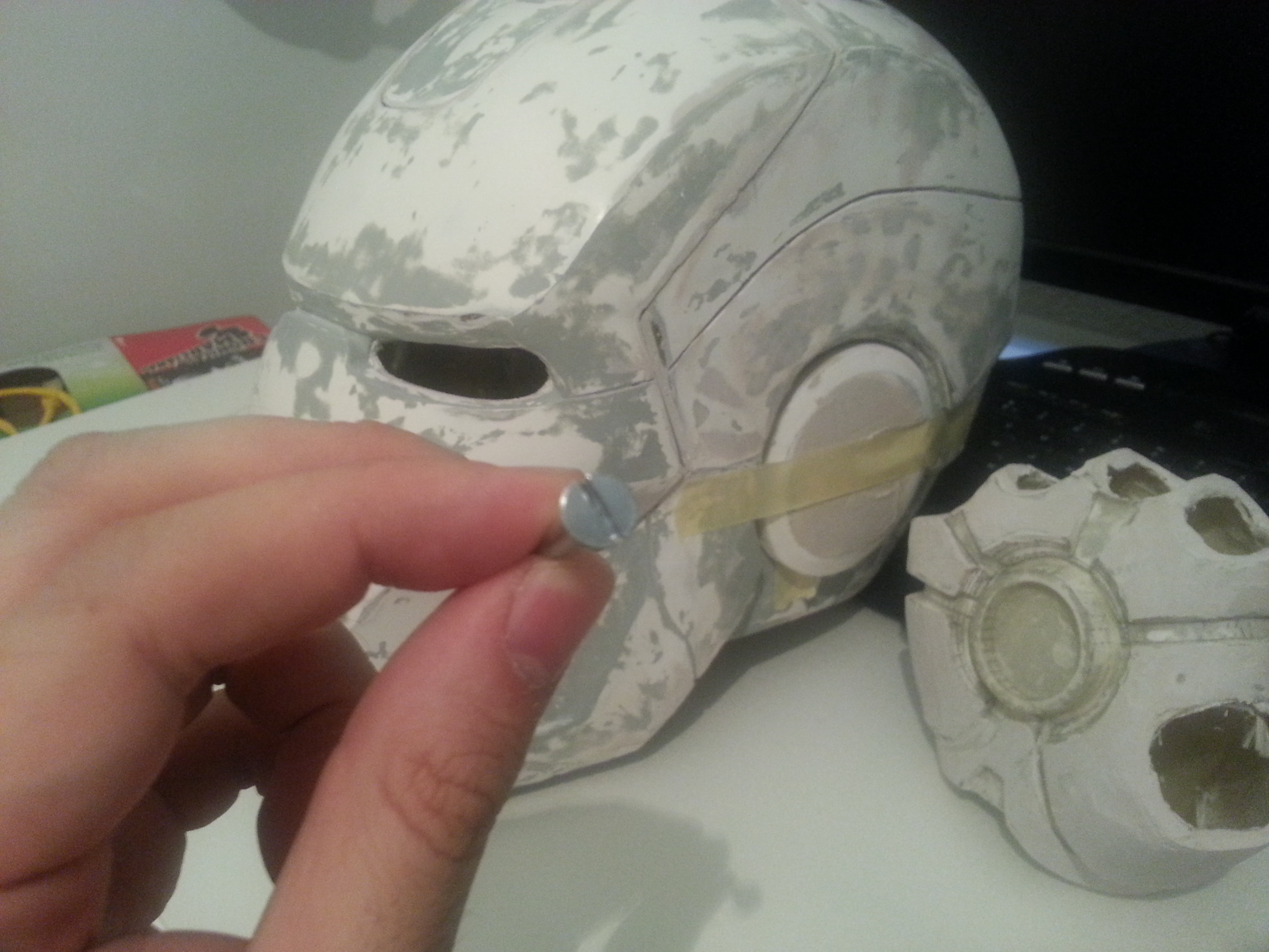

Here you can see the flathead screws I would like to use to make the screw details. I think that doing that detail by hand would be too dificult. This screws have a head of about 7.5mm in diameter, I'm planning to cut them, drill the holes in the helmet and put the screw with the head flat to the surface. Do you guys think this will look nice??
I hope next time I can finish all the edges, put the screw details and finally attach the ears. And I think I won't be doing a cast of this helmet, I like how it's going but I may build another one when I finish this...
