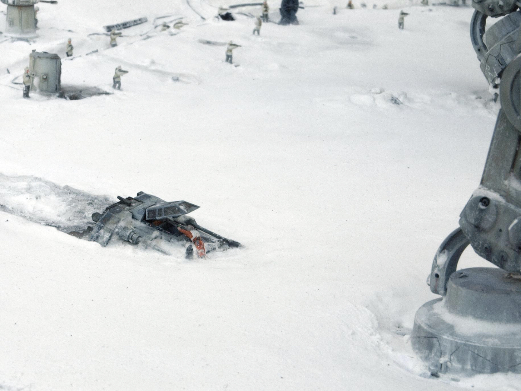

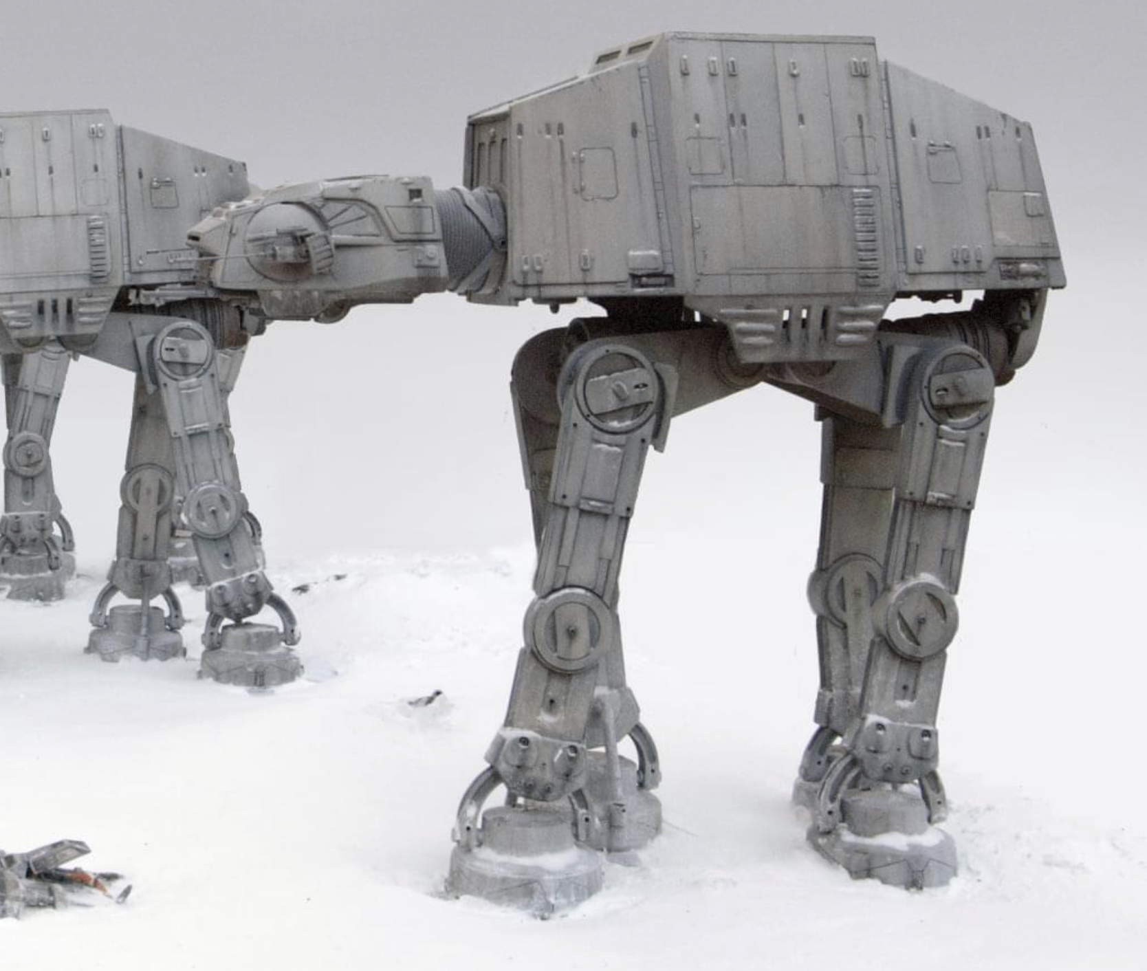

Chris Hart on the AT-AT Modelers group on Facebook made a fantastic diorama using interior wall filler mixed with water. It was the most realistic snow I’ve seen.
Here are some photos he had posted:

Oh, holy cow - that does look great! I'm not on Facebook - would you mind/be able to post some grabs of any text he may have provided there describing some of the 'how to' associated with these pics?

He said that he simply mixed with water and applied it with a brush. He said that if you want it to look smoother once it has dried, dip your finger in water and rub it along the surface. I haven’t used it myself, so you may want to do a test to see just how permanent a solution this is.

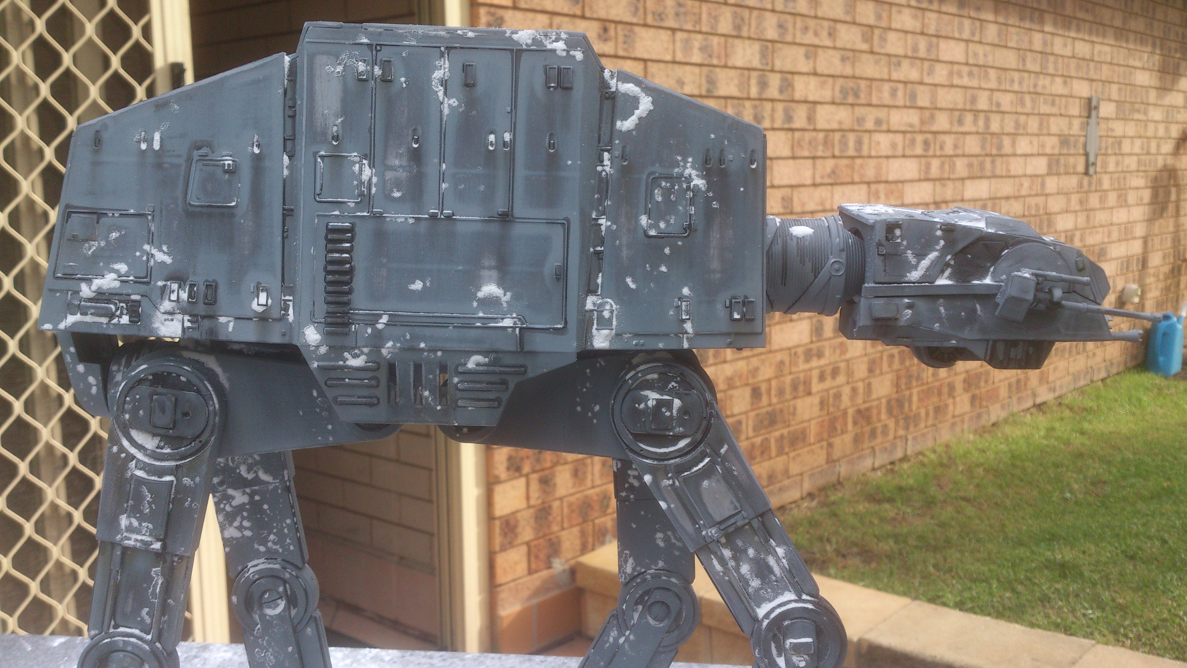

Hey Dan..great model.....here's my quick shot at snow.....i just covered it with talcum powder and used a plastic bottle with a small hole in the end and just puffed the powder off until i got what i liked.....mind you you cant really touch it after but why would you....easy to blow or brush off if you don't like it and try again.
With the advantage of falling/sticking where actual snow would really go - thanks!
joberg
Yep, the snow doesn't accumulates/sticks to movable parts...unless the atmosphere is very cold. I can see it more on the body than on the legs somehow;) Apart from that; great build/paint job:cool::cool:(y)(y)
