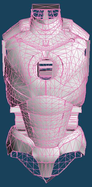

what i did for my scaling was i measured point to point on the chest. i used a flat tap measure used for making cloths, and measured my chest. then i used the measurements from the tape measure and converted that into millimeters and put that height or width into the the appropriate box in the scaling box in the 2d menu. I adjusted it to fix me tight, then added 10% for electronics to fit. Once i did that and got a scale factor number, i used that on the entire suit for all the parts except for the hand, fingers, and helmet. Those are a little different. i did a lot of trial and error to get those right.
you could also scale groups of parts together if you wanted to. as long as they are the same area of parts on your body. For instance, you can scale the bicep, forearm, and elbow together, or the thigh and shin. Parts like that can be scaled together while other parts are at a different scale. it all comes down to how you want your armor to fit, and if you want it to look like a uniform scale or not.
don't forget to take into account the thickness of your foam. I did not even think of that until i was almost done with mine. if you are using a thicker foam, your scale is gong to be bigger and if you used thinner foam the scale will be more fitted to you. You don't want to use thick foam any way, i messed up trying to use 3/8 on everything because at the time that was all i could find. 1/4 inch will be plenty big for main parts, and just use 1/8 on detail pieces and fingers. At least that's what i do.

Hey Everyone,
I decided it was about time I started my own thread on here with all my progress and updates for my Mk III Iron Man files. For anyone who doesn't know me I started work last year on a set of Iron Man pep files, I made it about half way through and then had to take a break to work on my Halloween wedding.
The wedding was a big success we dressed up as Disneys Beauty and the Beast, we had many Disney nods in our wedding design and wedding party costumes as well as a large haunted house with many nods to the Disneyland haunted house.
Now that the wedding is finished I've started up work again on the Iron Man files. I'm not going to post any new files until I've finished up the abs and finished tweaking the rest of the files to work perfectly with the abs.
In the mean time I'll leave some renders of the current suits progress and leave links to the older files in the subsequent post.
