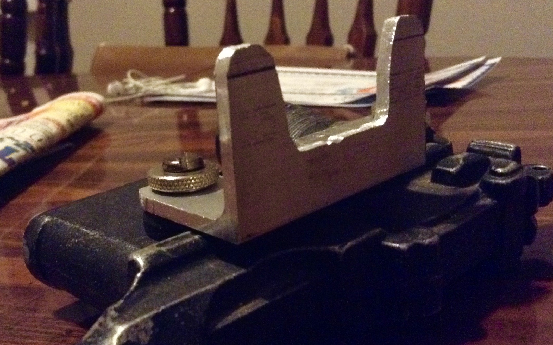

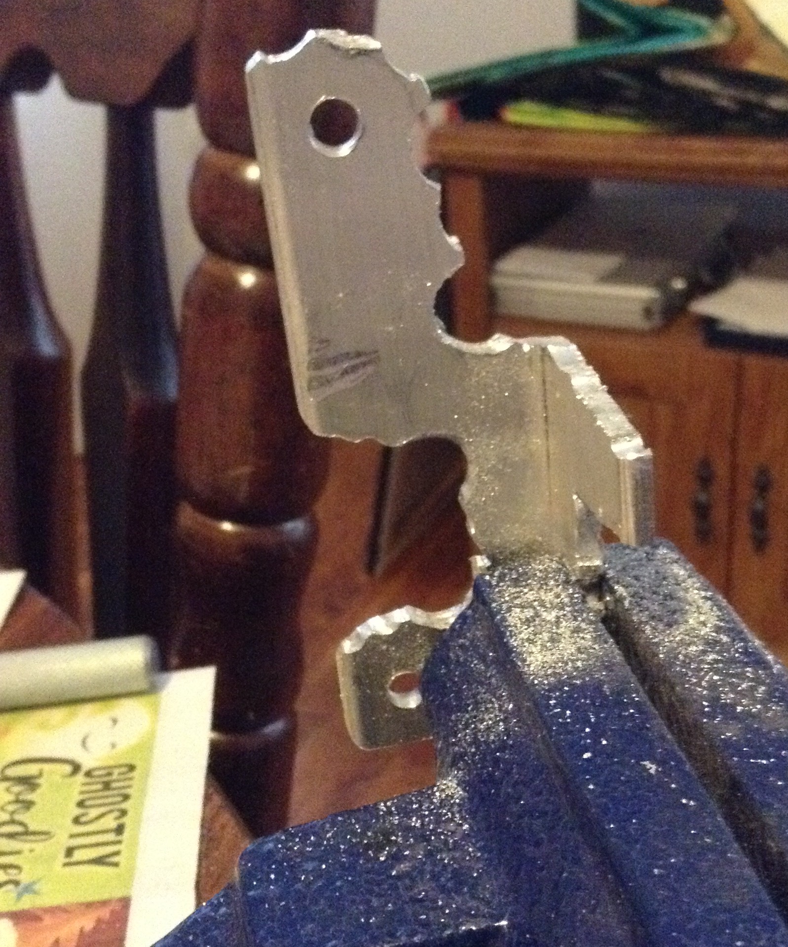

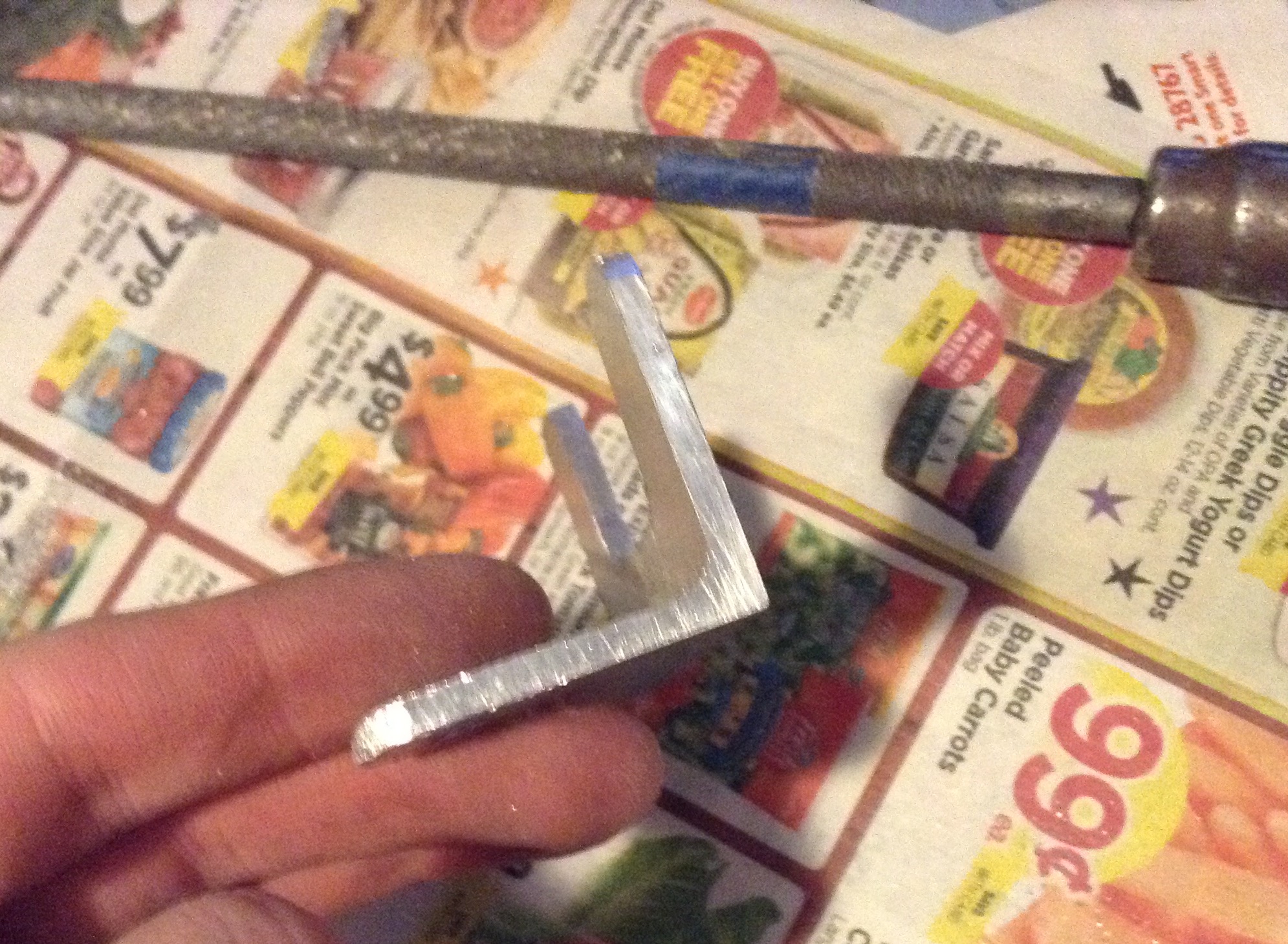

I got my hands on a Broomhandle Mauser toy (or USGI training gun, they were made for both) and some right angle stock of the correct width! I drilled into the gun (by eye, still have yet to find a good bench top drill press at my budget) and tapped for 10-32 screws. I then took a resin mount from Jedifather and used it as a template to hand cut my own mount. I don't have a jigsaw so I drilled a bunch of holes and knocked the shape out. I then took a small hacksaw and removed bit by bit until I could file it to shape. Not half bad!

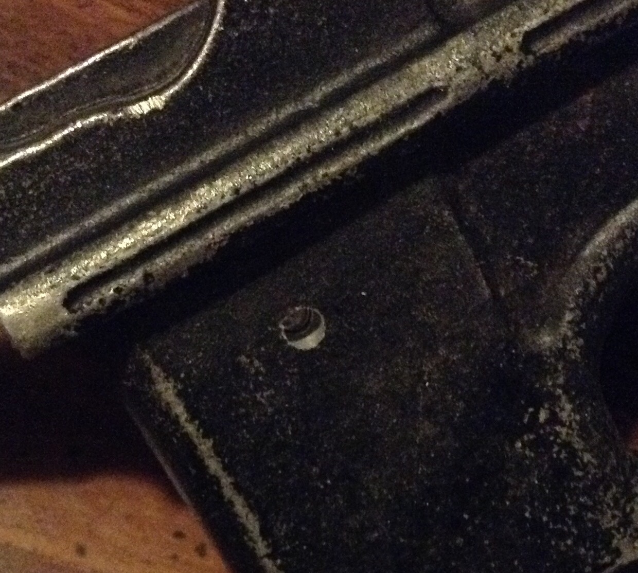

1) these mausers are small, the same size as a real gun, and the metal is soft. I drilled right through to the other side by accident.
2) I have Jedifather resin ESB scope mount knobs as spacers and service/Praco flash knuts that I drilled out. Can't seem to find a good metal substitute for either, I may just countersink these knuts and wait and replace them later?
3) I plan on finding a 7/8 pipe (right?) and making my own bull barrel. I then can use this flash hider I got from Jedifather (and drill it out somehow?) or I can find a metal one somewhere. Either way it will be easy cutting the gun for the bul barrel this time! The only thing I don't like is the lack of detail on the edges of the gun, but the handle is ROUND unlike Denix grips which are flat, it sits great in my hand!

looking good tom! thats some serious elbow grease sanding all that aluminum
Thank You! it seriously was, a brand new hacksaw blade ate through it like butter though, thankfully. It's still a little large, I'll have to re-shape it another day!
now to the rest of this bugger...i can cover my drill hole with a piston actualy

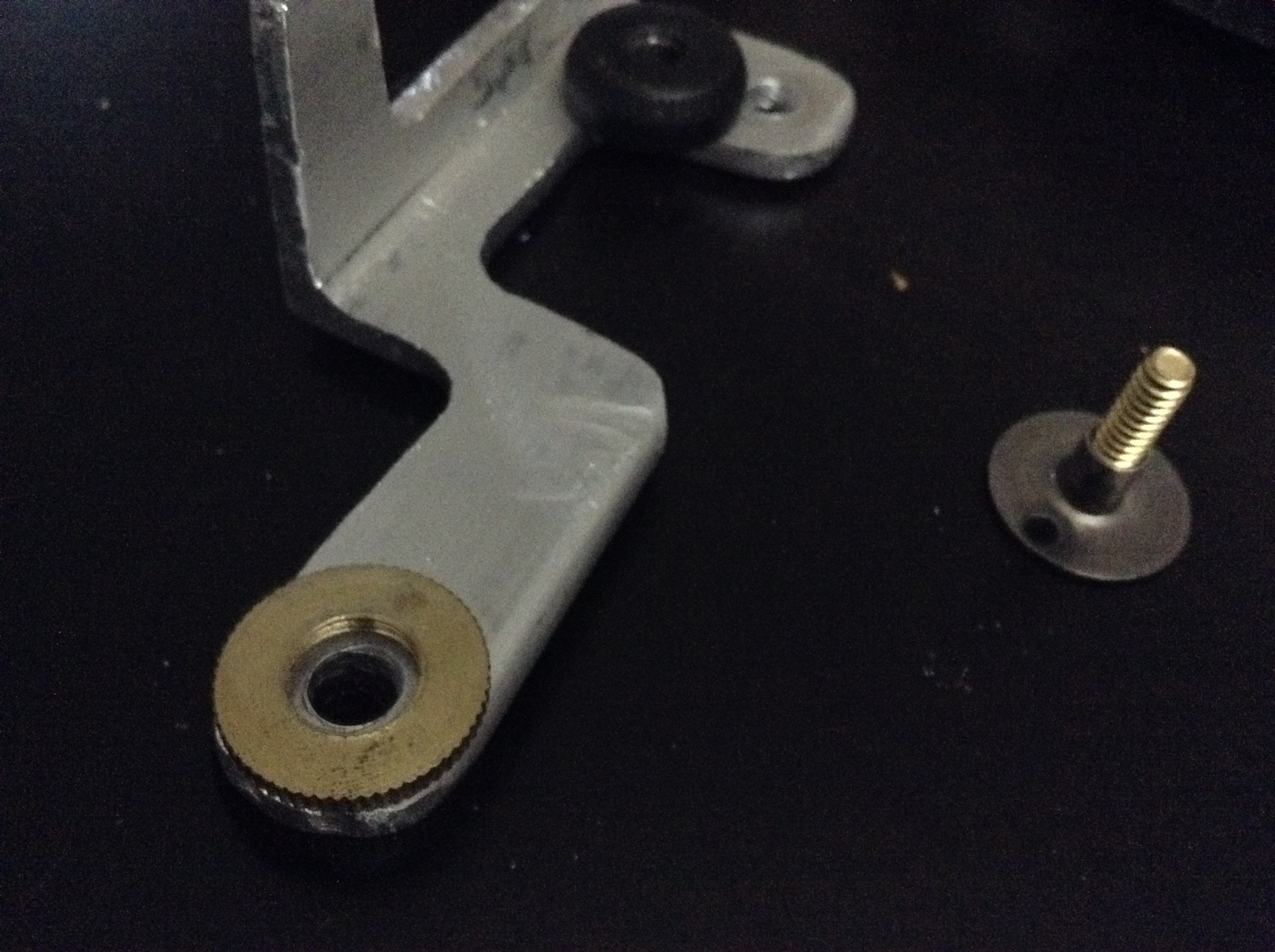

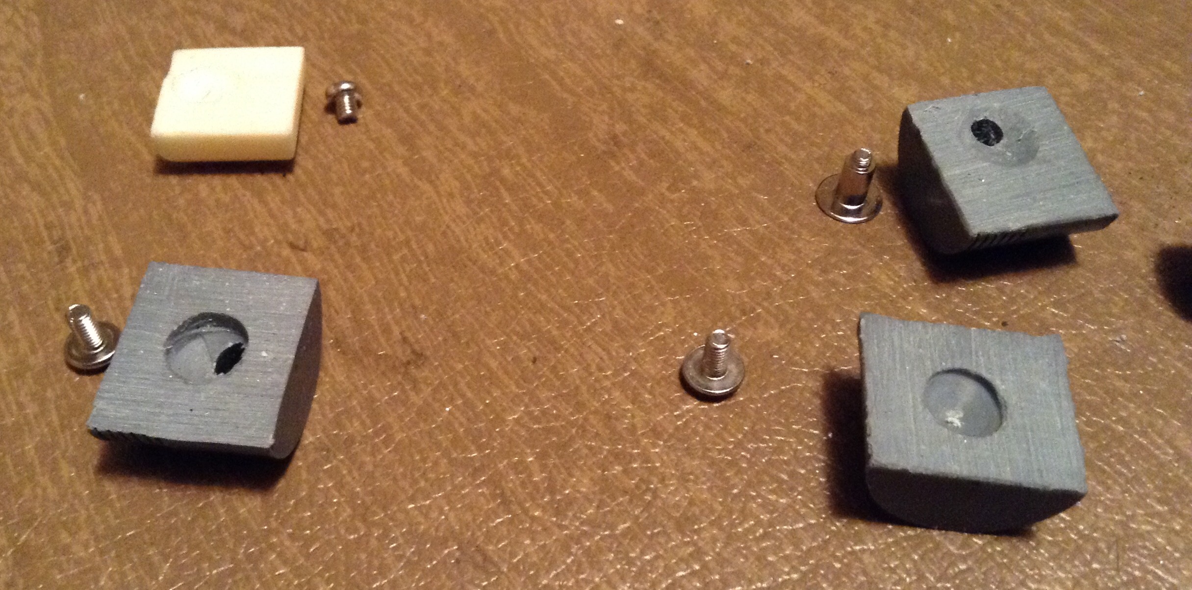

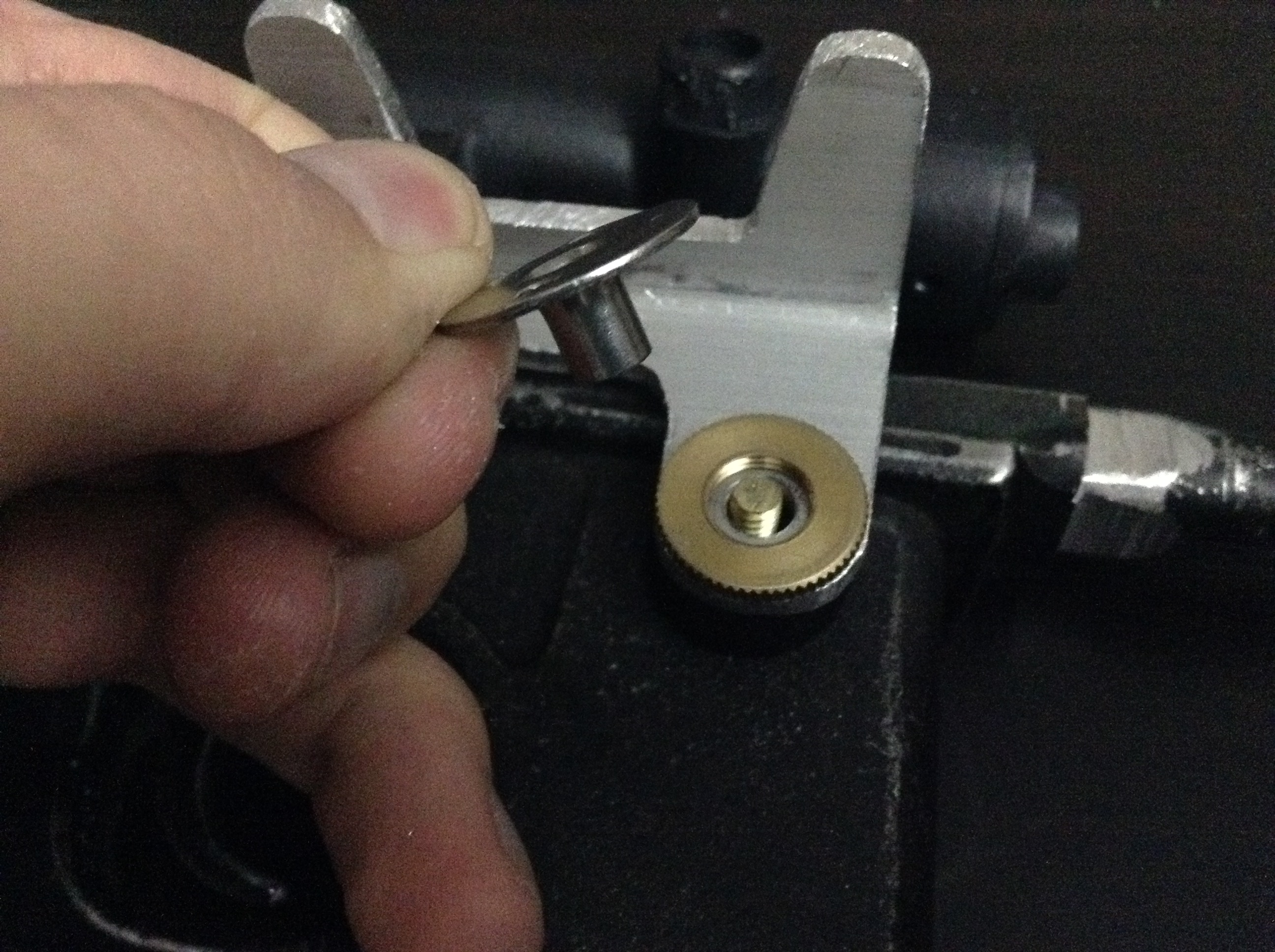

So, without nuts of my own I came up with a new system! Cut the heads off some 10-24 brass screws and used a lamp nut and a T nut together! (Found the 3/8 16 lamp nuts cheap and they were rather thin)
i also cut cut the barrel down for a bull barrel using a hacksaw entirely! It worked better than 4+ hours of rough filing. Also honed the bracket a bit more!

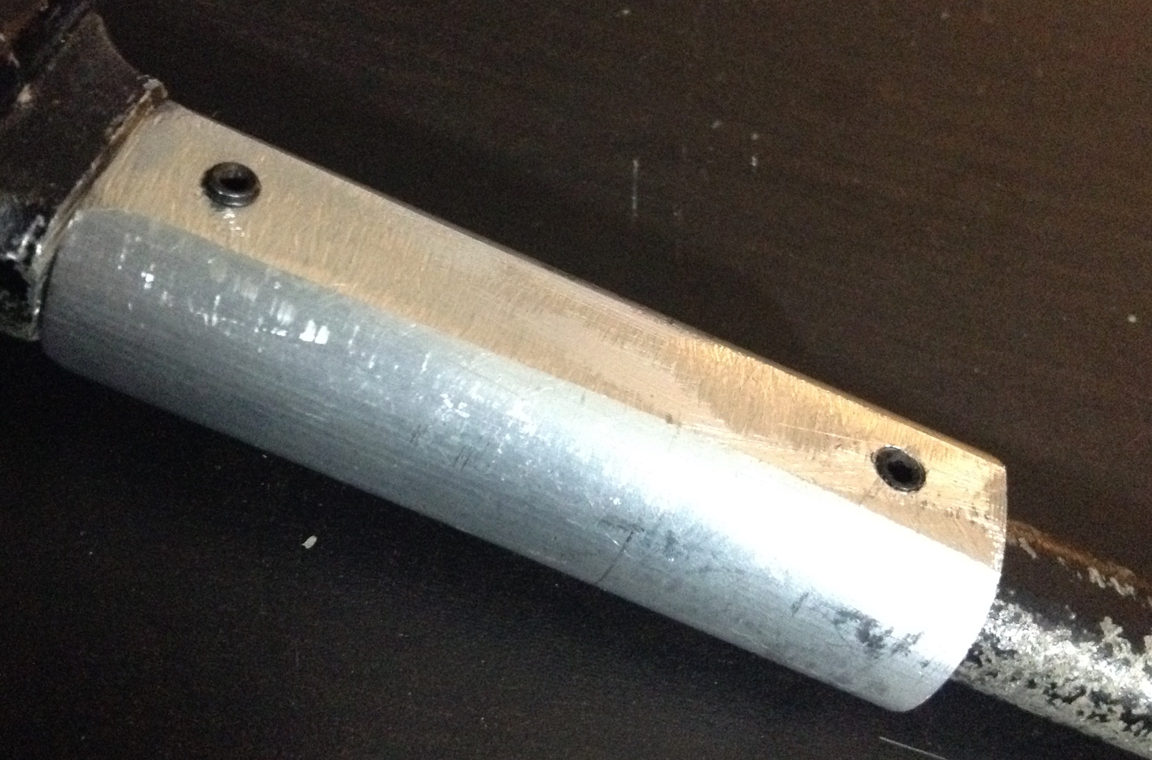

now I also got some 7/8" OD aluminum pipe offline. It had a pretty thick wall, at least 1/8 or more, as I needed meat to file and shape the bull barrel. I had already used a hacksaw to shape the gun and I used big toothy files to shape the scallops and a flat bottom that slightly tapers toward the muzzle!
in order to stick this in place I actually drilled and tapped two 8-32 .5" grub screws and screwed them in while I held the pipe centered around the barrel. It's rock solid. Only problem...filing the barrel means you don't get sharp corners and the barrel shifted forwards leaving a gap. I'm going to fill it with JB weld like ok my ANH blaster.

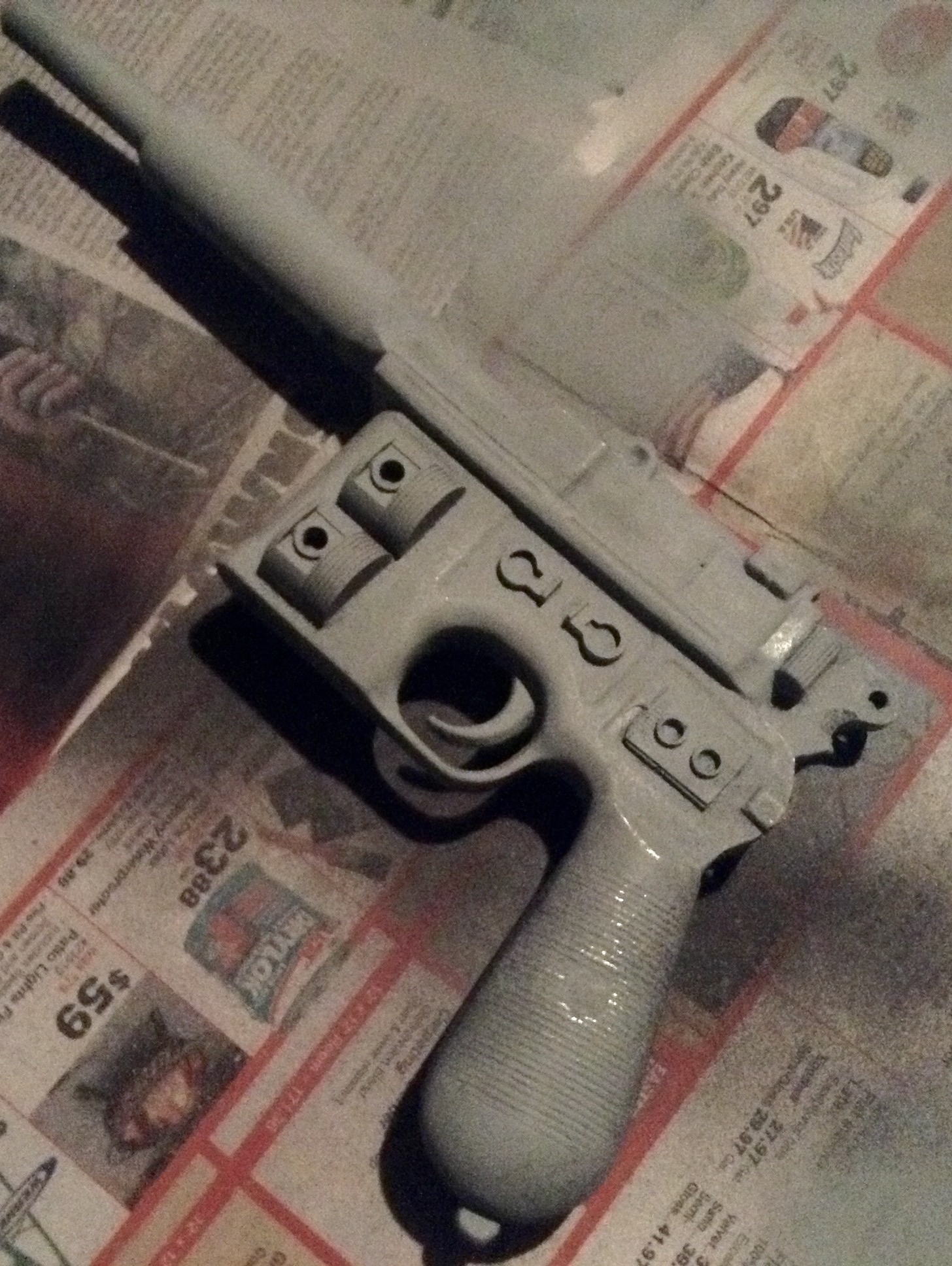

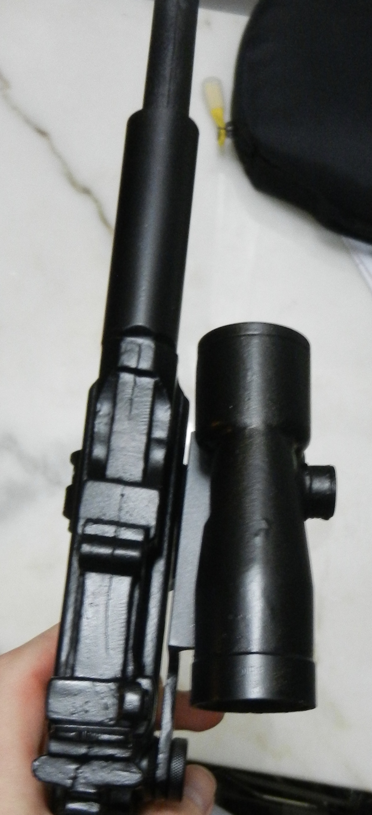

Some updates today! I puttied and clamped the scope in place by filling the holes for the bolts with putty and then squishing the bolt in there. C clamps kept it steady.
i dusted it with brass spray paint and moved into the greeblies. I found a small computer screw for each of the big parts and installed them literally into the gun, using some 5 min epoxy. Hard as a rock now! Now...what are my options on flash hiders? I have a resin one here but I realized I have no way of drilling a straight 7/8" hole :lol I found out Todds fit on here perfectly with the booster, but it will be some time until those come in

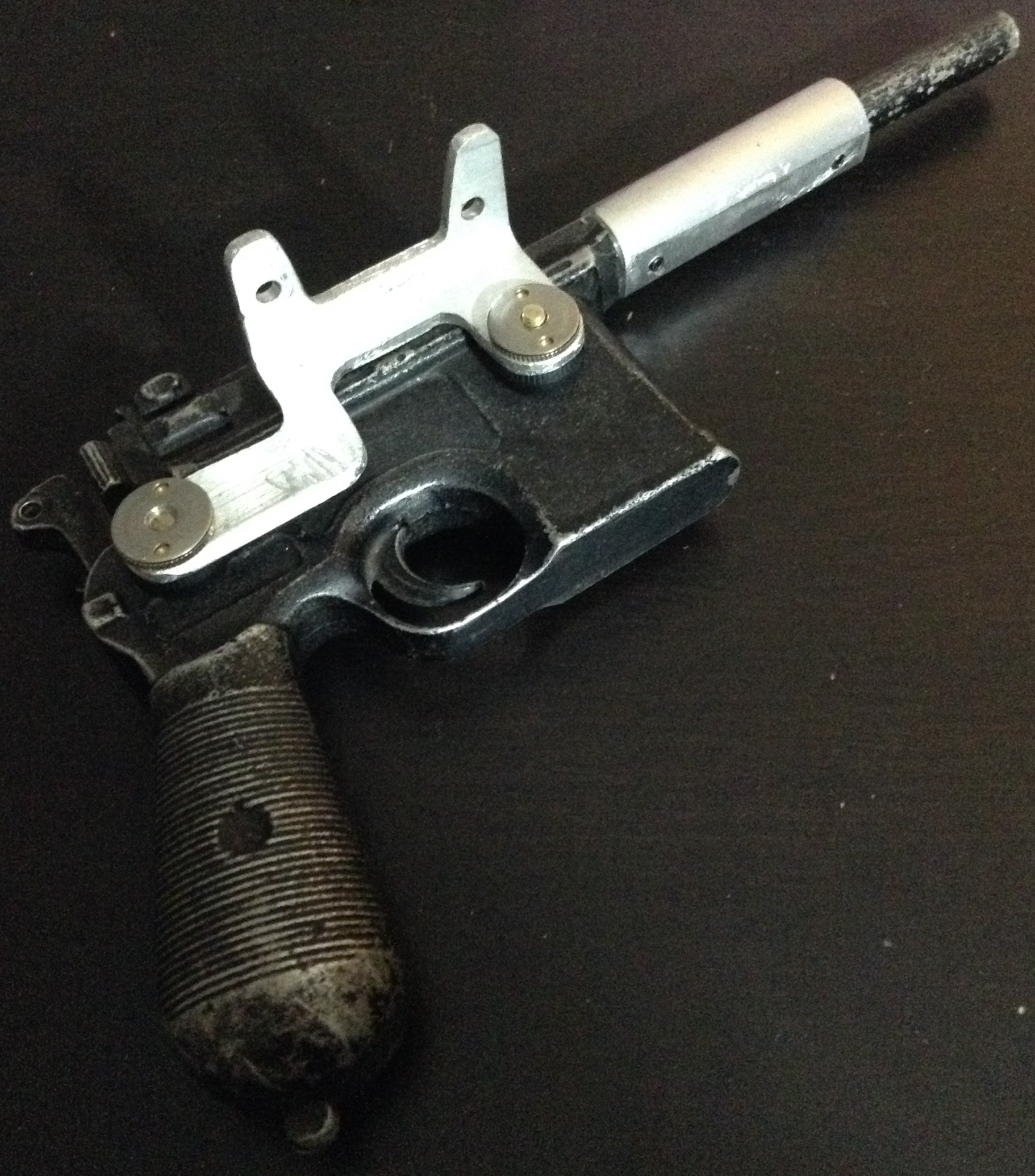

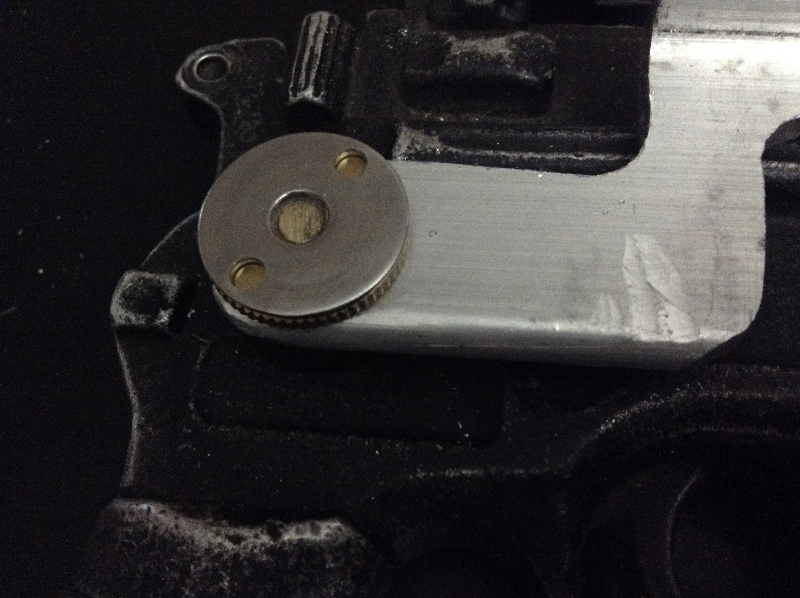

know anywhere I could score 3/4" OD 10-24 knurled thumb nuts or 10-24 thumbscrews with a 3/4 knurled head? I want to swap out these T nuts.
I picked up some diamond knurled McMaster Carr thumbscrews - best option I could find that wasn't ridiculously priced. They look nice! They are 10-24, with 3/4" heads and thread straight into the gun. I had to chop one shorter, since I found out they have a non-threaded portion under the head

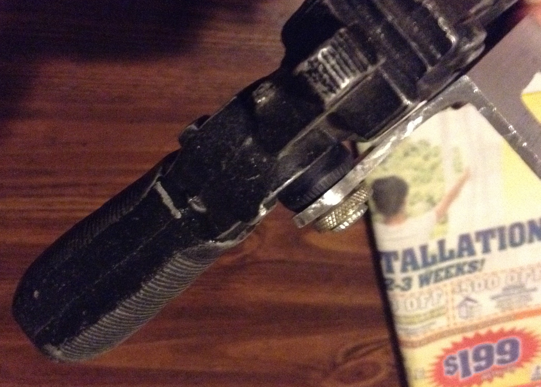

i cleaned it with acetone, hit it with light dusting a of automobile primer, which actually filled in some dents and dings! I wet sanded with really fine grit sandpaper before hitting it with krylon satin black. Dusting this time, until it was covered. It's an incredibly thick and smooth surface, don't have photos of the cured paint yet. Now I just need a flash hider!
i painted the mount and scope seperately and forgot to paint the knobs! Lol dusting black on the whole gun now

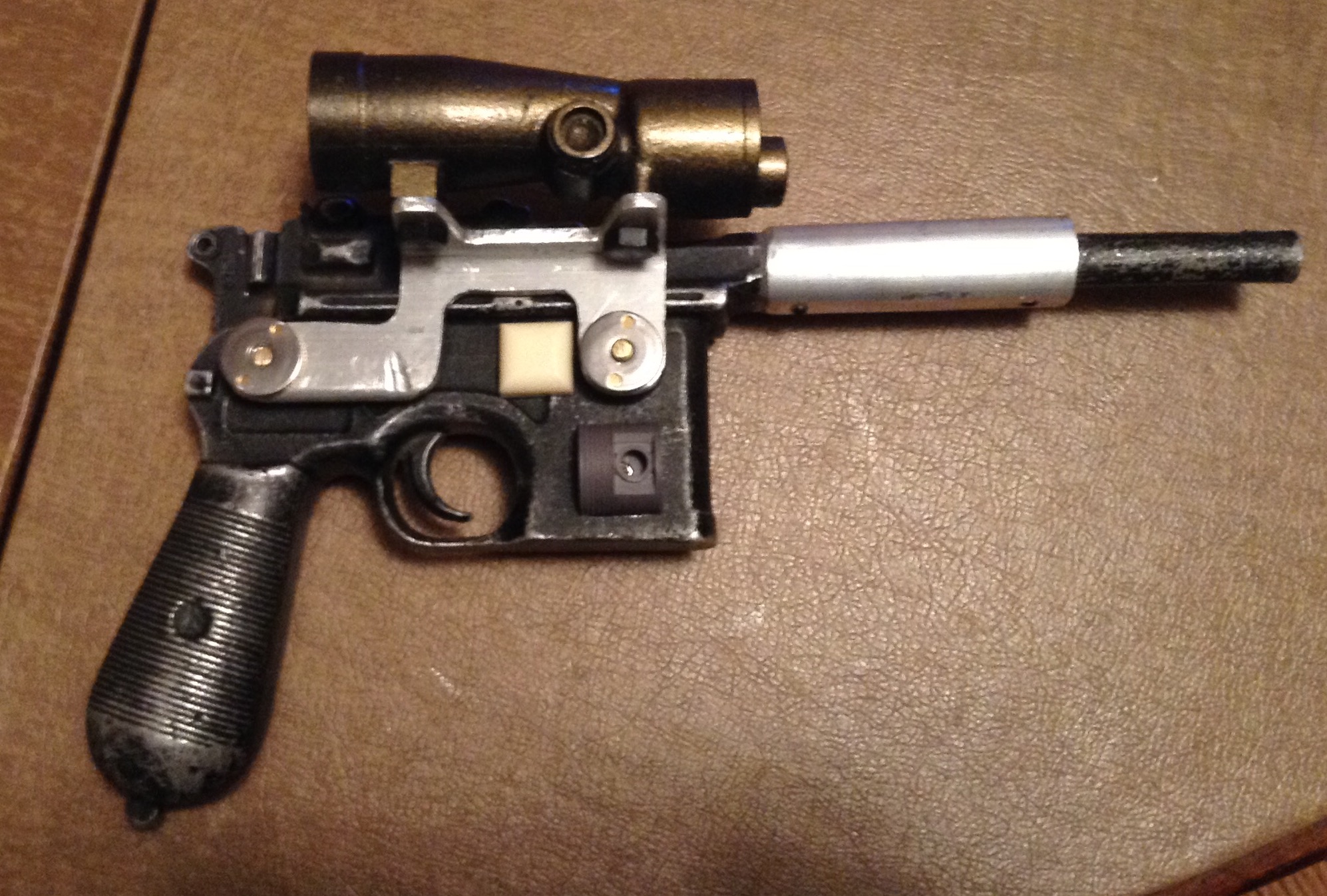

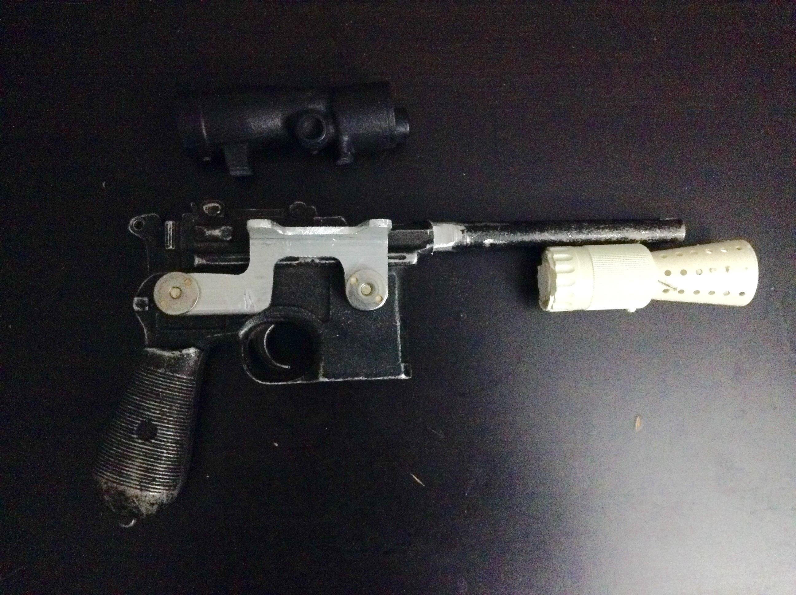

Here are some better photos of where I am now...
