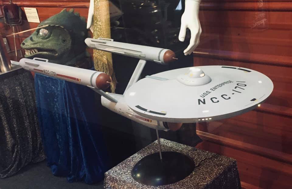

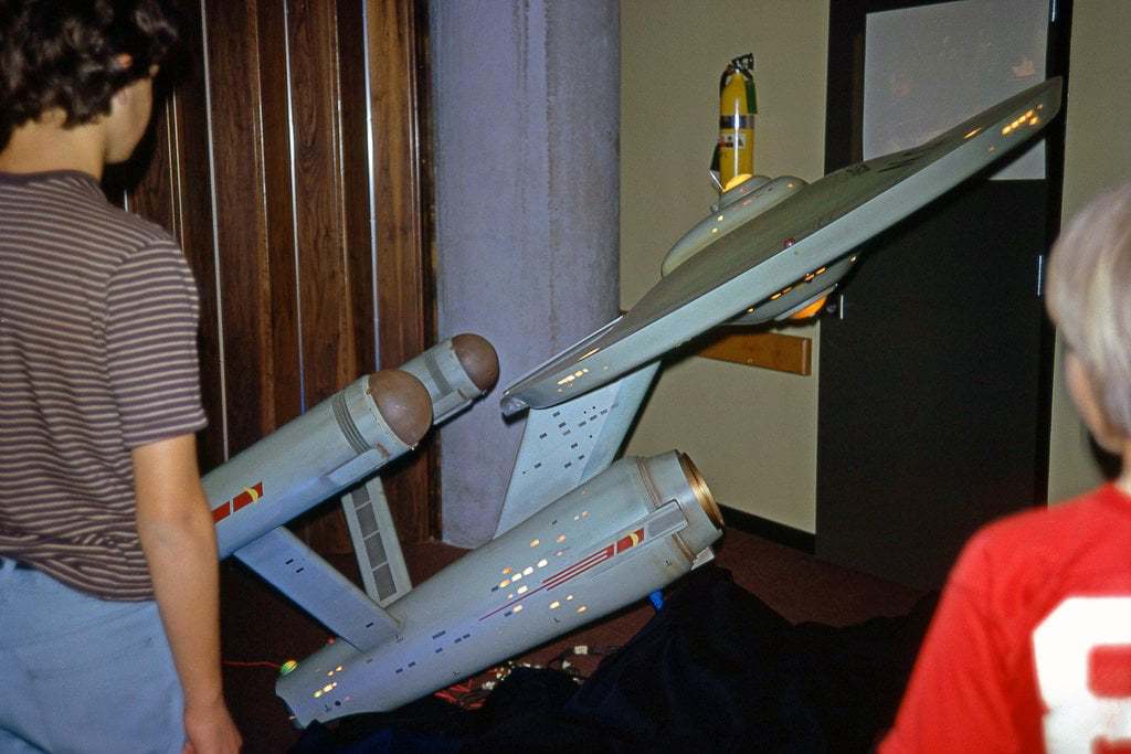

As I said in your private message to me, there are no correct Rattle Can color for the TOS Enterprise. You have to mix and air brush. Sorry, I exhausted ANY and all possibilities. That's if you want it to reflect the 11' Filming miniature...as close as possible! To me(and milage may vary for others), That's the fun. I used an extensive amount of reference material I have collected over the years as well as information gleaned from Gary Kerr.
Here is an example...The original before ANY "restorations"and my personal build. I will be doing comprehensive build video on YOUTUBE once I have the time.
The Pilot versions are a different animal all together...two examples of mine... First Pilot and Second Pilot...
AND the lighting affects the color...as evidenced by this shot on my Table in front of a Blue screen.
You have to adjust your painting to reflect scale. This isn't the 11' miniature. Best of luck. I'll go through my painting notes and find my formulas if interested.Gary Kerr has already given us the best info on the ship(Google Gary Kerr Enterprise).

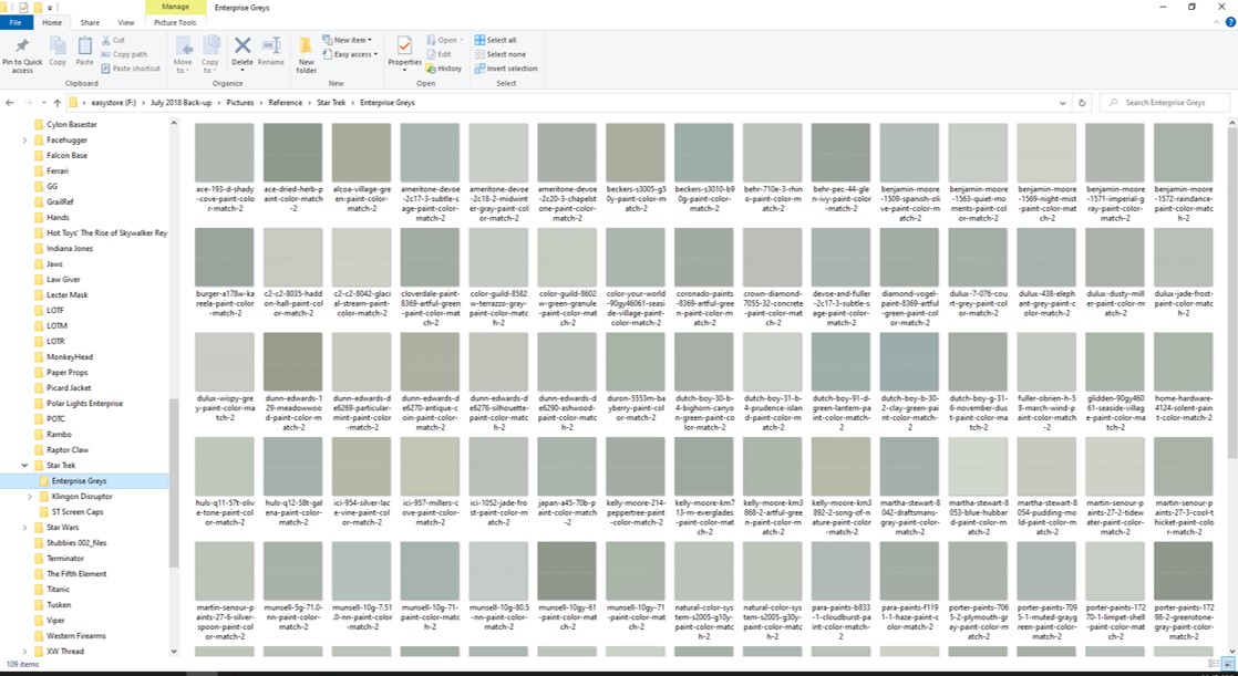

For the hull color, as mentioned, I'm using this site:
Have narrowed down 109 candidates, and will trim further...
Here's a glimpse at the results (and a hint at the process).
Bear in mind that in scrolling through 116 pages of 40 samples per page, each of this looked within the ballpark, though seeing them all together in Windows Explorer makes it much easier to chip away at the batch.

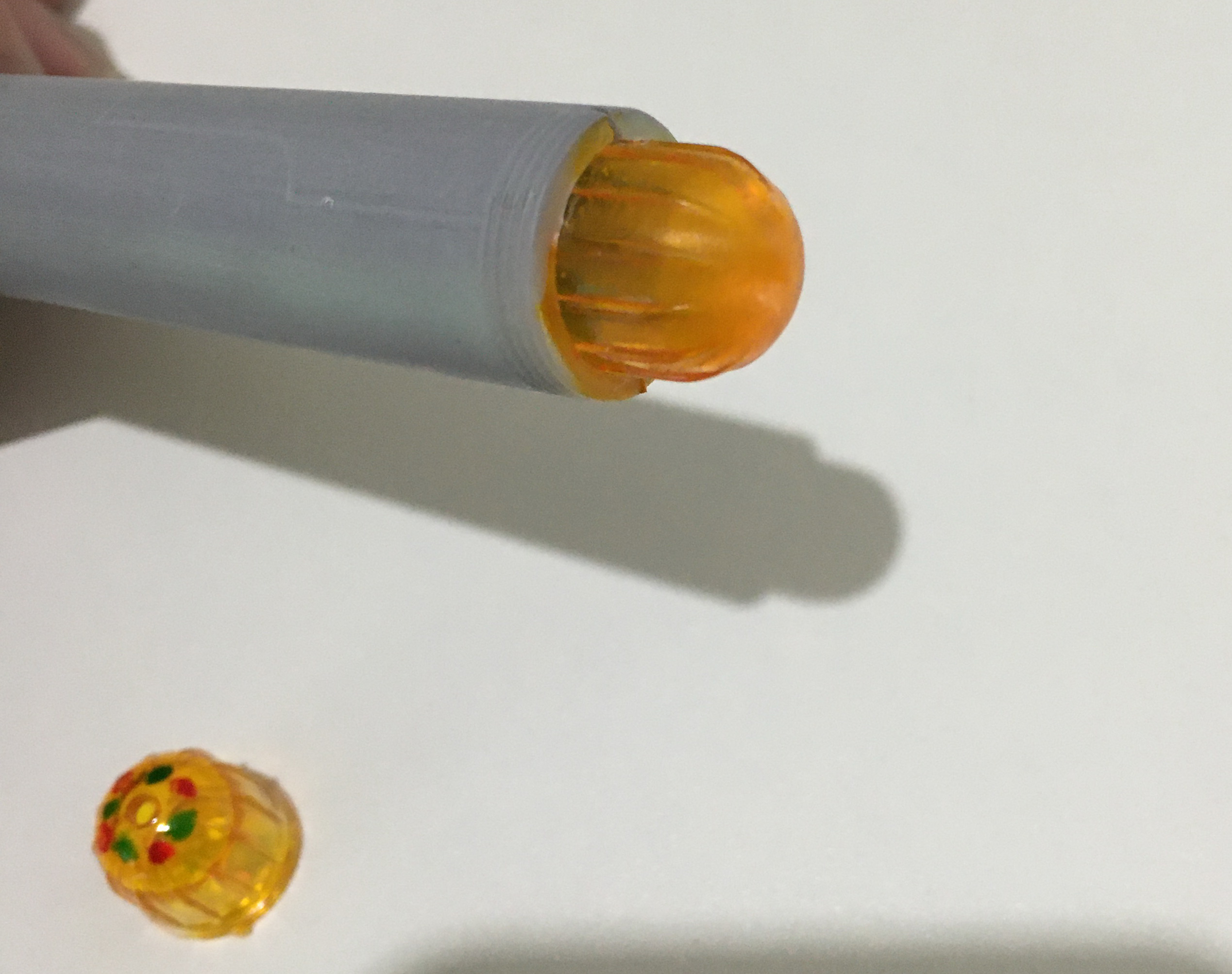

I find Tamiya clear orange (with clear stoplight red inner domes) to work perfectly well at 1/1000 scale. At that scale, the overall effect succeeds without one having to obsess over exact color matches. Flat gull gray for the hull, a slightly lightened gunship gray for the trim colors, a blue-green for the dorsal stripe, and so on.

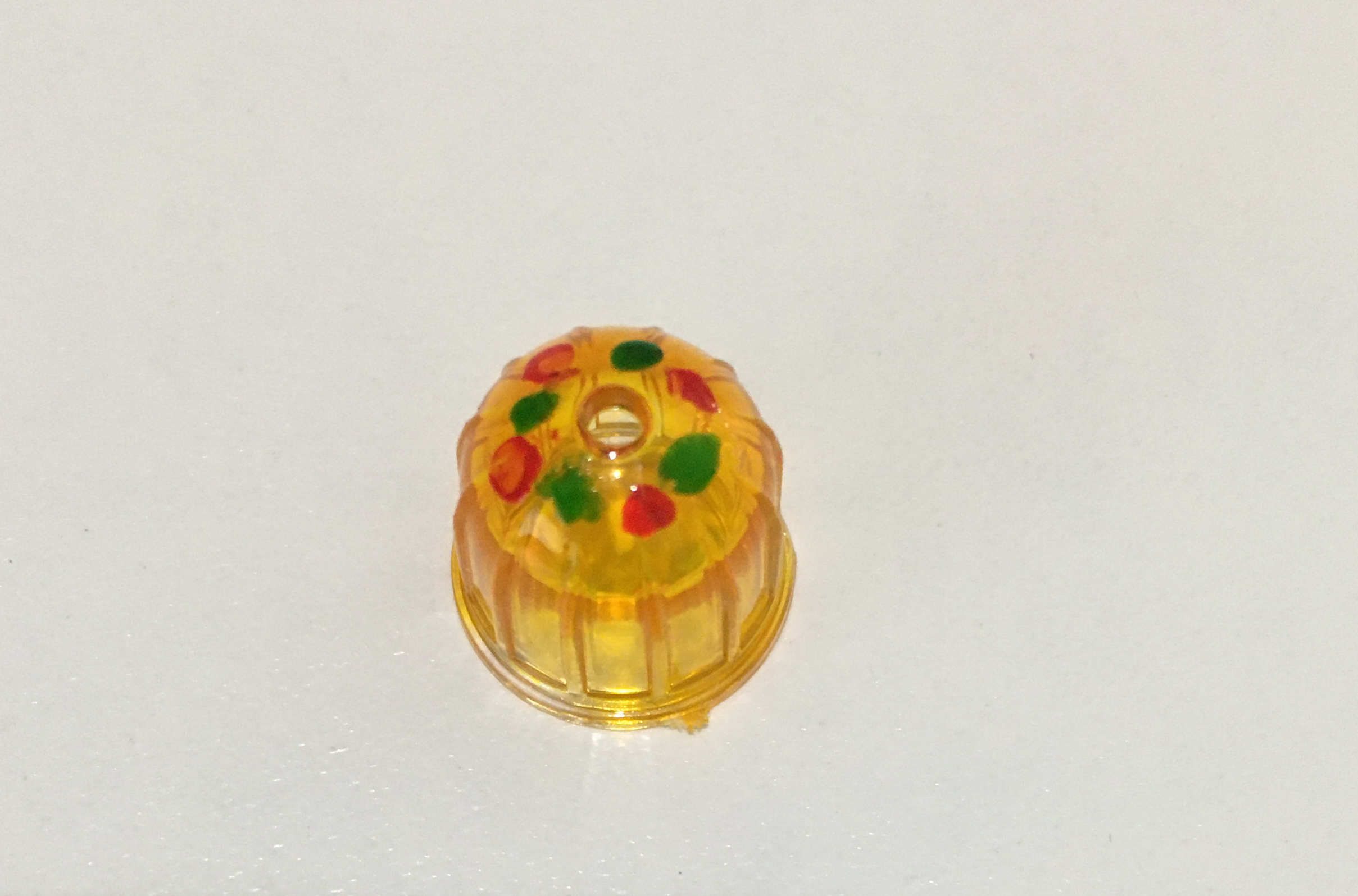

I was going to go clear orange on the inner domes then red and green dots; outer domes would be a combo of clear red and clear orange.
But...
Your way is easier and quicker.
Did (do) you add the "stripes" inside the domes for 1:1000 builds? If so, do you apply them to the outside of the inner domes, or the INside of the OUTER domes...?

I’ve done it a number of ways, over the years. Tiny strips of black or silver tape laid over the raised ribs of the inner domes, and/or dry brushing of the ribs.
Trying to paint or add tape to the insides of the outer domes would be a fool’s errand. That space is just too small to get good, precise, results. Using the kit’s ribbed inner dome parts works just fine (although, as noted, I’m working on making my own), and also helps give a sense of depth, since there’s a bit of a gap between the inside of the outer domes and the inner domes, just like the real model.

Here are the greys I have it narrowed to (from 109 selections):

Just be careful trying to match colors via compute screens etc...That's why I said Google Gary Kerr Enterprise. The word expert gets thrown around a lot, but in his case, Gary knows what he's talking about. Again, best of luck and have Fun...that's ultimately what it's all about!
PHArchivist
Totally agree... Part of the process for the on-line matching was comparing the color chips to the image of the original.
I have a two monitor setup, and made sure all images were on the same monitor.
Regardless, if I go this route, I'm taking a $40.00 gamble. But in the end, $40.00 isn't that much...

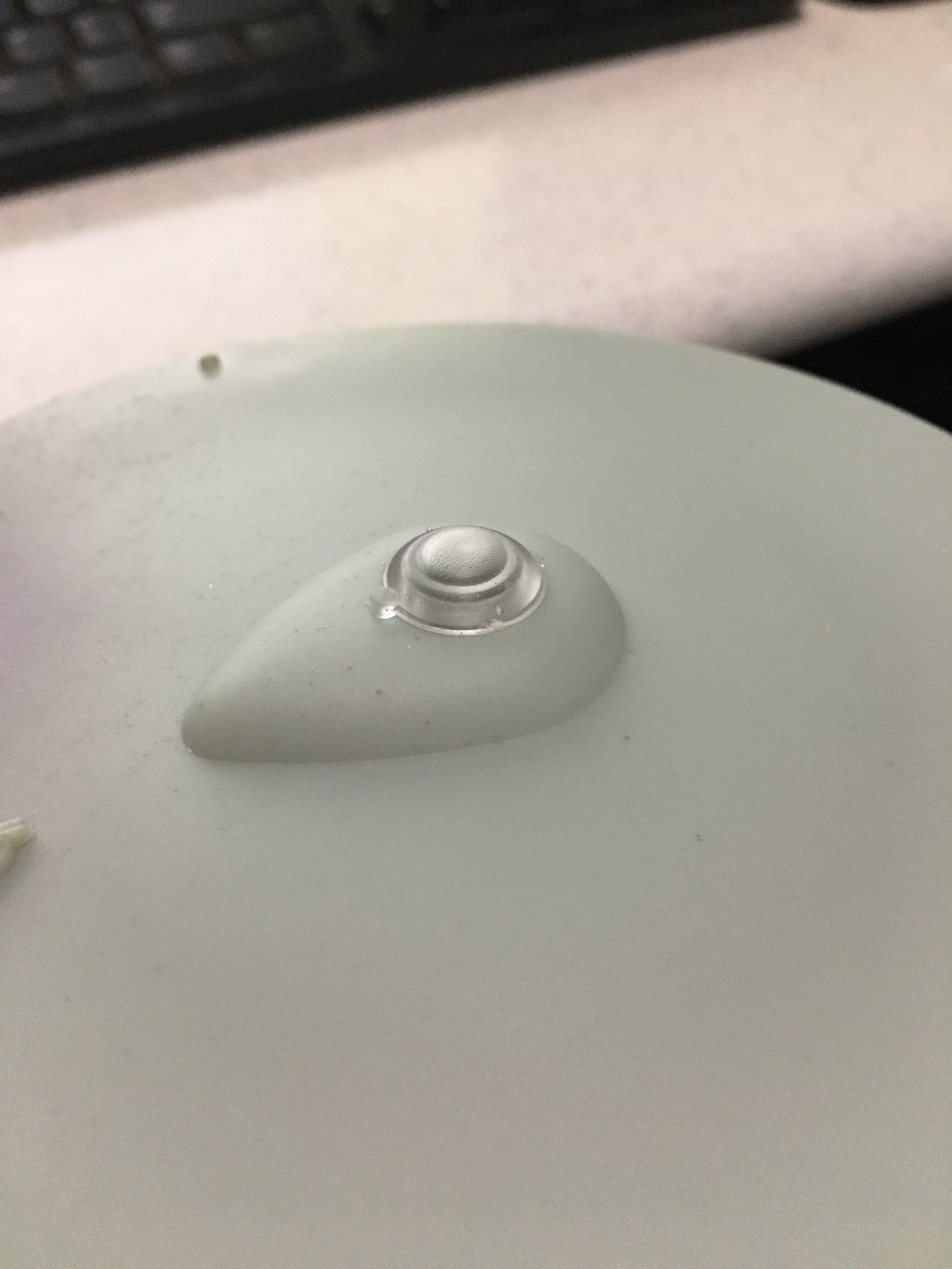

Here's an irritant - the entire bridge is cast in clear (not the dome only), and the separation line between the bridge wall and the dome is not clear.
Masking off the dome will be a bitch.
